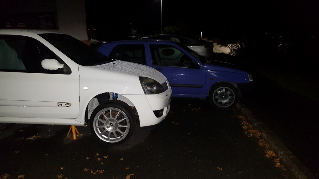

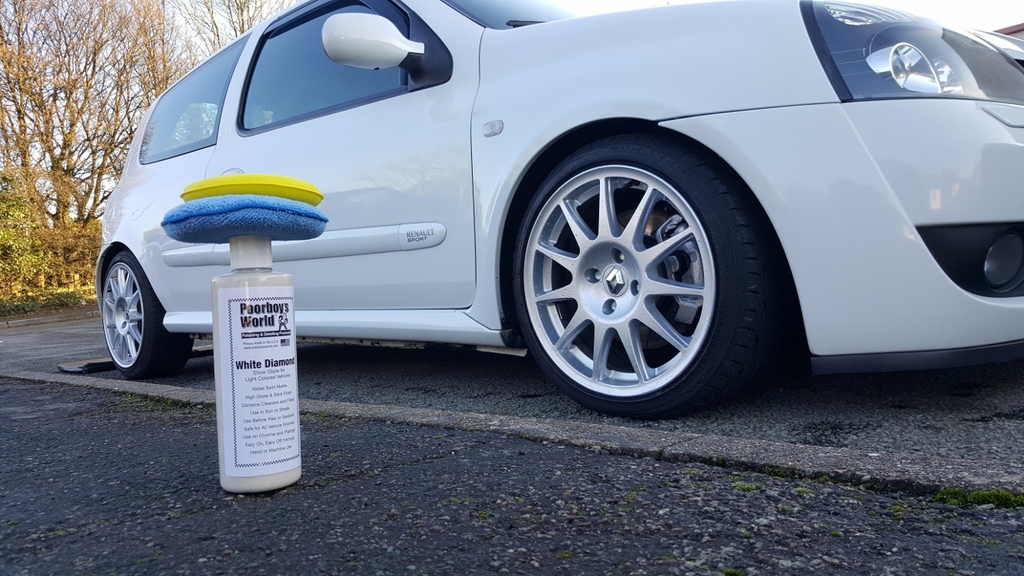

So now it was just the brakes to tidy up (so I thought…) then finished off with some Poorboys Wheel Sealant
AT LAST... all ready for it’s MOT… Considering it had already run out by this stage!
Happy Days… Stick my loose drivers door bullet back on and good to go...

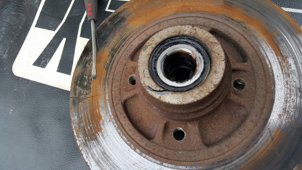

Until I saw this… !!! 😂:laughing::smile::smiley::persevere::anguished::cry:😢

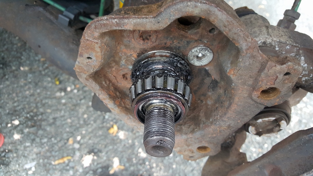

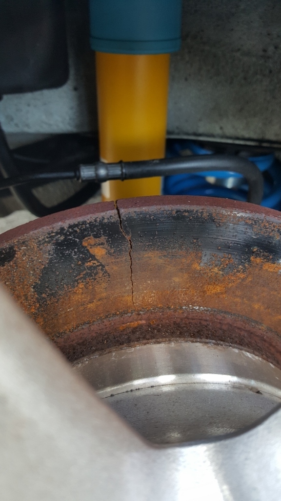

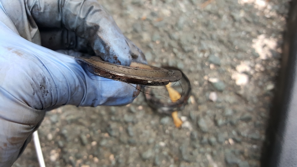

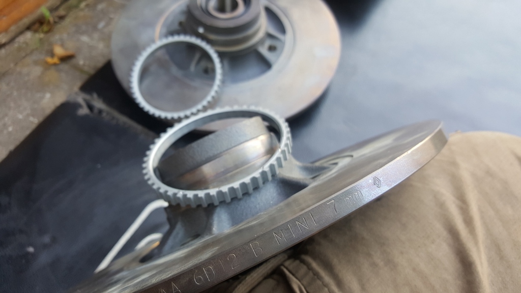

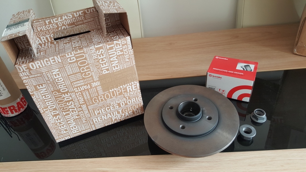

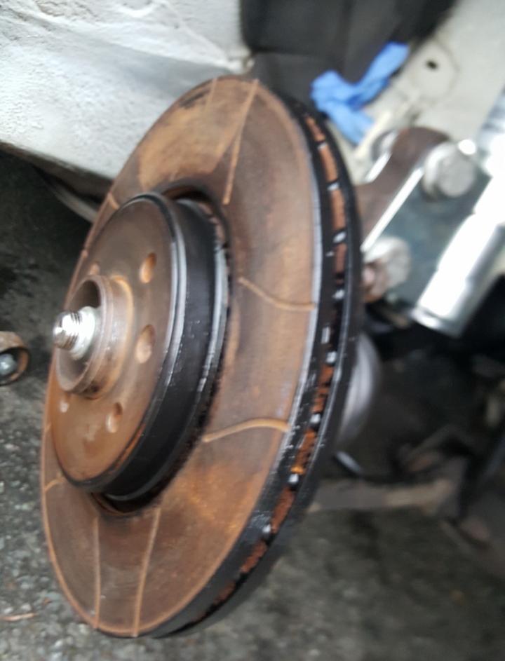

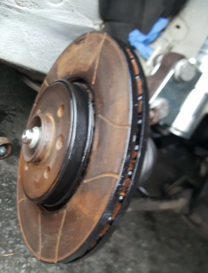

The bearing crapped itself upon removal, and the spacer was stuck on to the hub, which then bent on removal…
This is where I owe a huge thank you for @George@RTR_Parts for all his help in getting me sorted
Queries, part numbers, urgent posting and parts! Thanks again mate! :beers:
Again, ABS rings removed, then posted off to @ashtons99 . Glad they were of help pal :up:

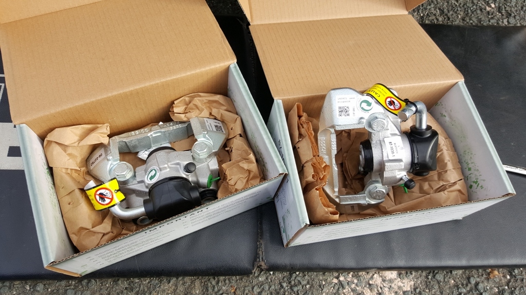

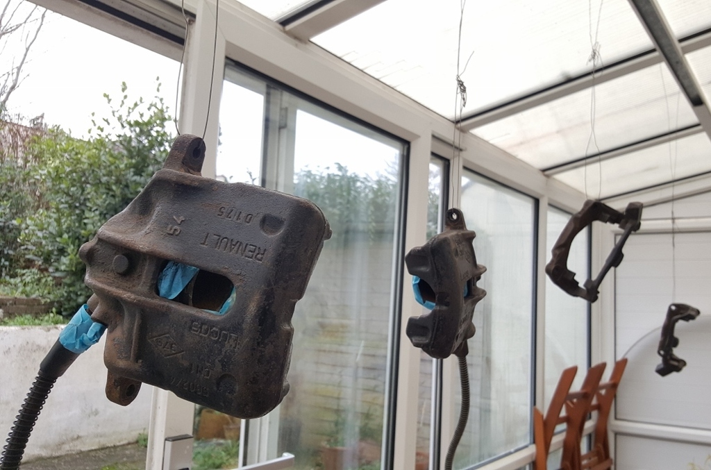

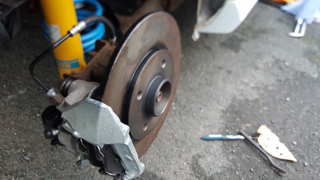

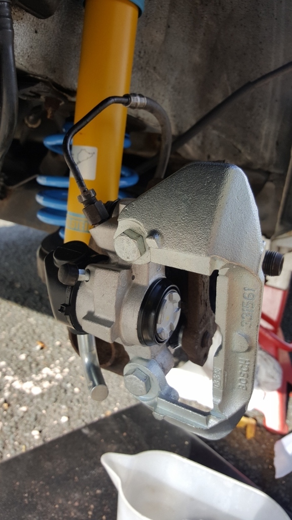

I could see that the caliper was sticking, causing more heat and what probably killed the disc. Inspected the calipers and they weren’t looking good.
As I had already unseized them earlier in the thread, and I couldn’t move the pistons at all, it was time to replace them.
Went for New Bosch refurb units:

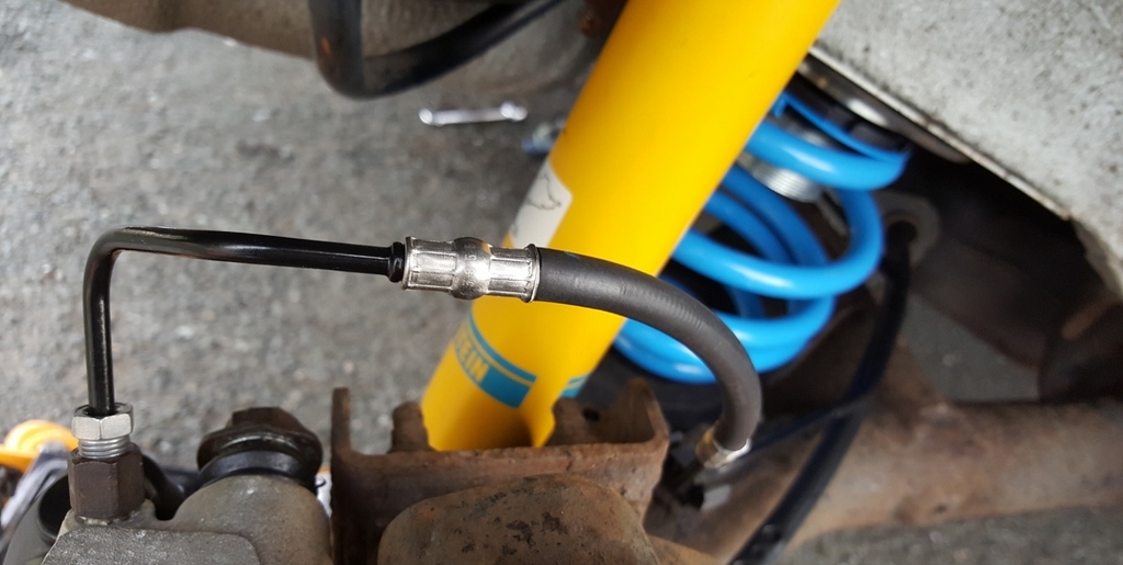

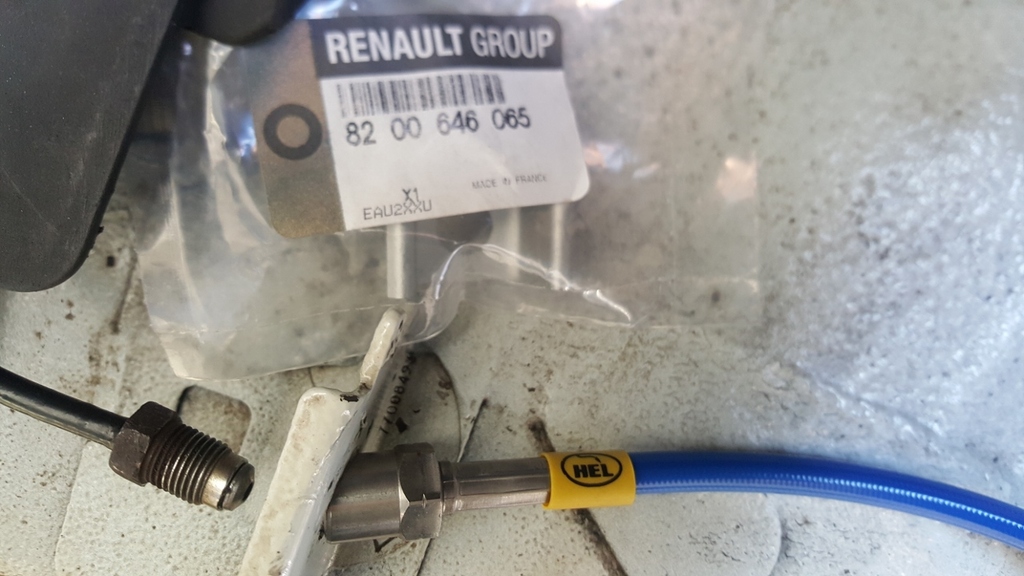

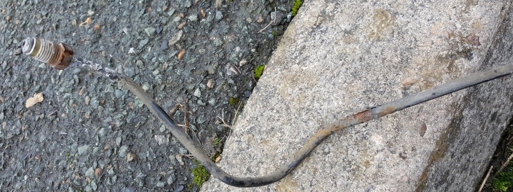

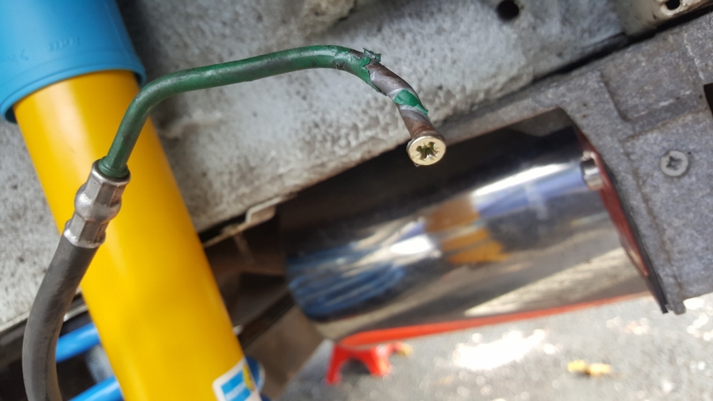

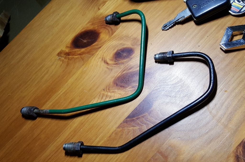

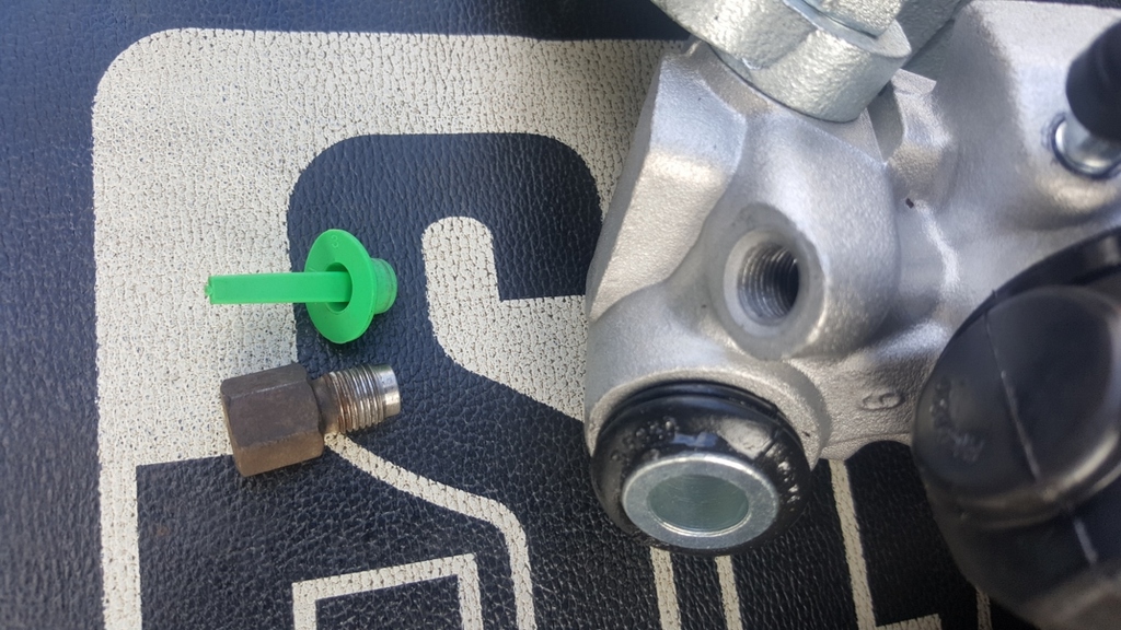

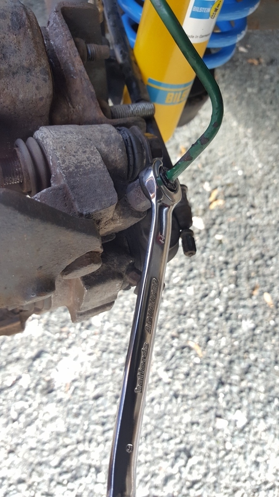

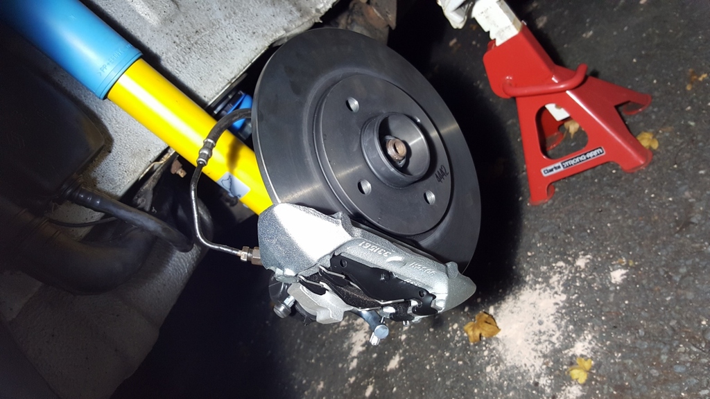

Started fitting the N/S but the brake union / pipe was seized and rusted together…
After lots of freeing up, ended up having to cut it off… :confused:
Continued to fit parts as they arrived

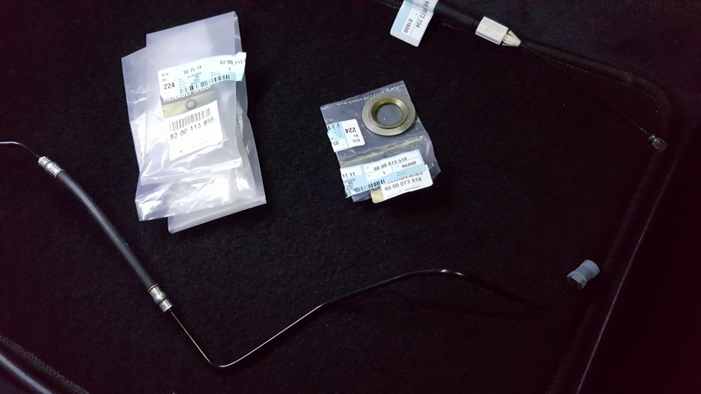

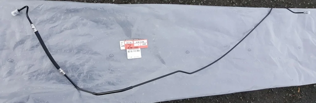

New brake pipe from George which thankfully was still available pre-made from Renault
Replaced the damaged Disc Spacer
New Genuine Handbrake Cables

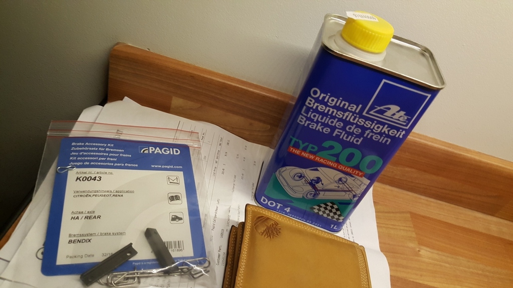

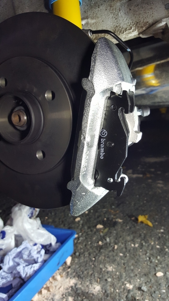

ATE Typ 200
Rear Pad Fitting Kit (Only because it was cheap to re-new again)
and a trusty Gunson Eezibleed

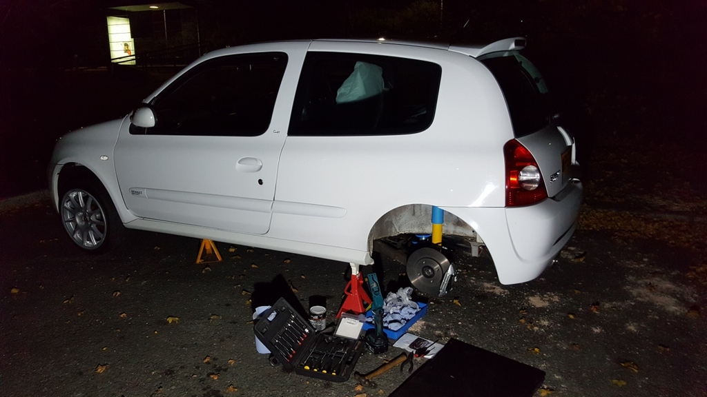

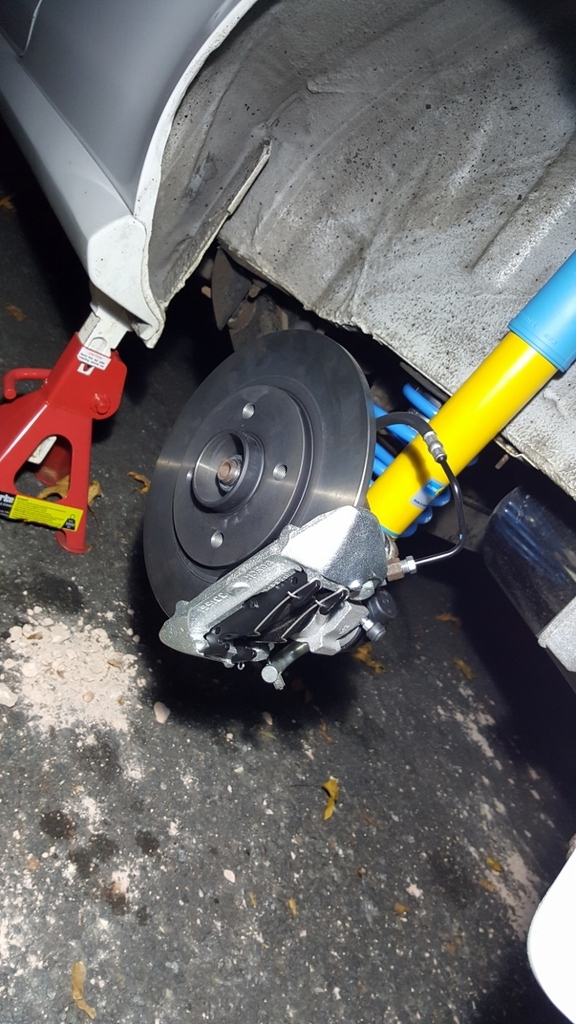

With the clocks changing (and trying to work with my phone torch in the dark) Invested in some half usable portage lighting…!
Test drive… and one caliper still generating more heat and slightly sticking…! :unamused:
Checked, checked, and checked, everything over again. All correctly torqued and assembled, so came on here for help which identified this causing the problem… :poo:

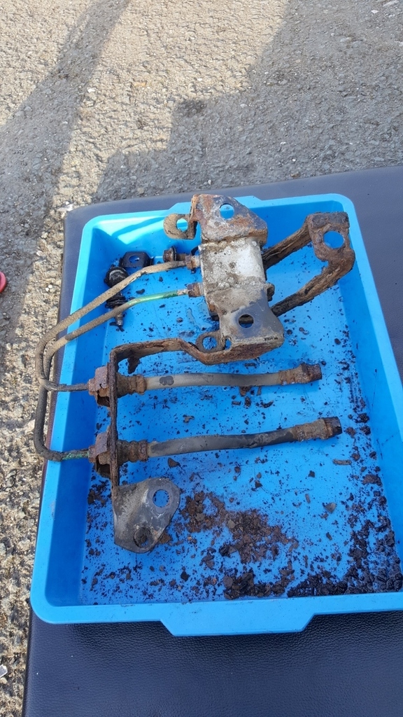

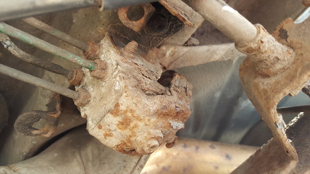

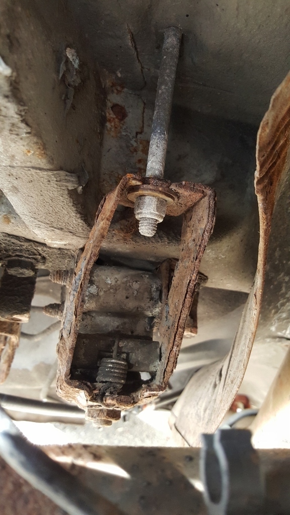

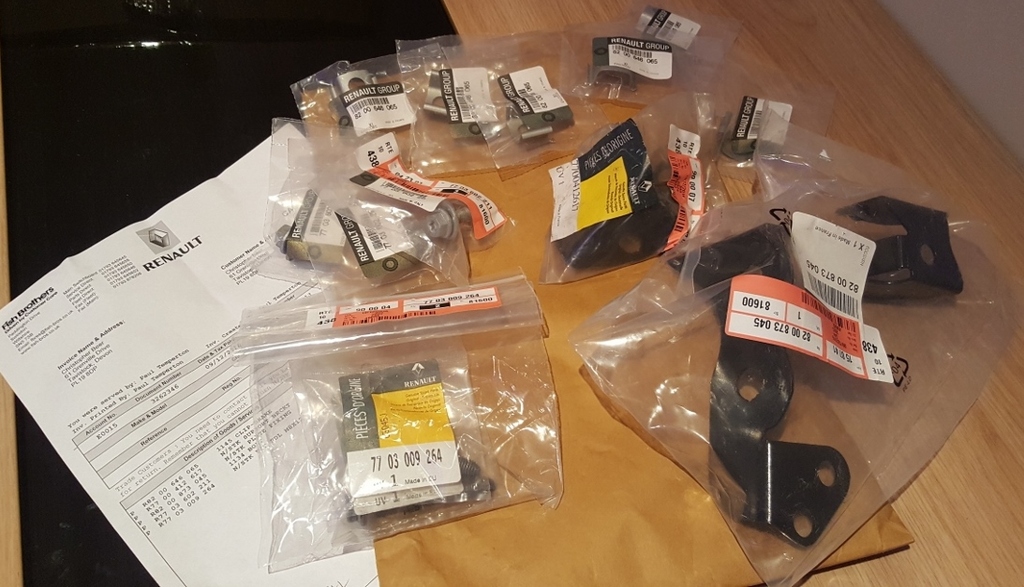

The car sat here until the parts arrived from France as Renault UK no longer stocked some of the brackets, and I wanted to replace the whole lot

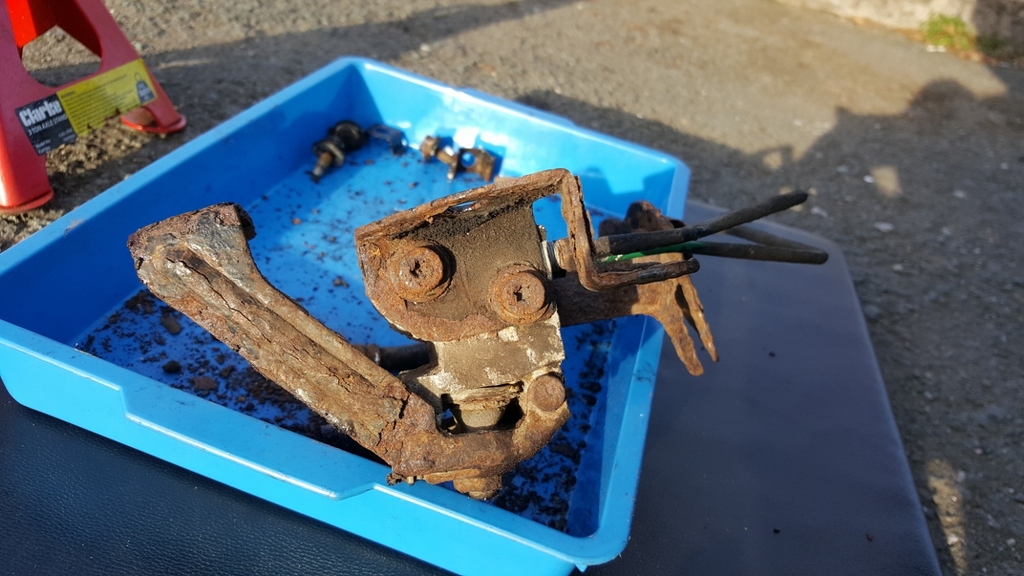

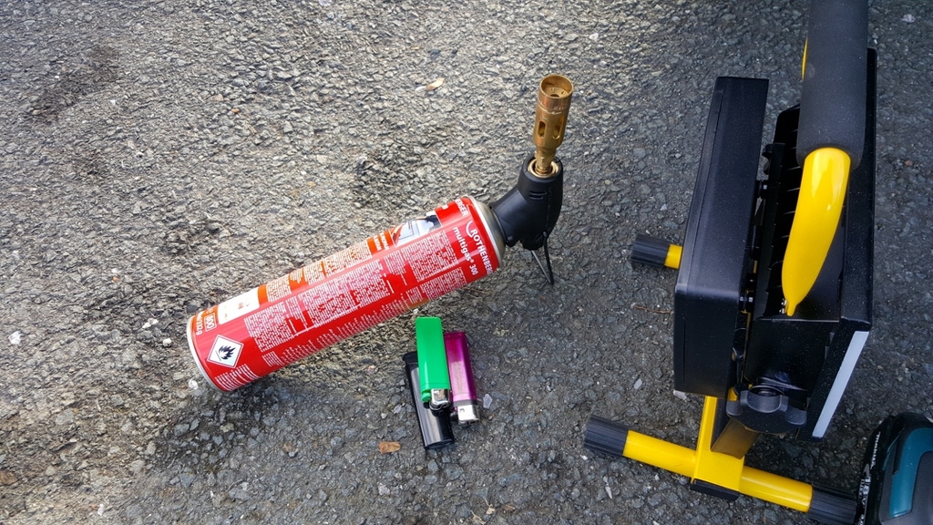

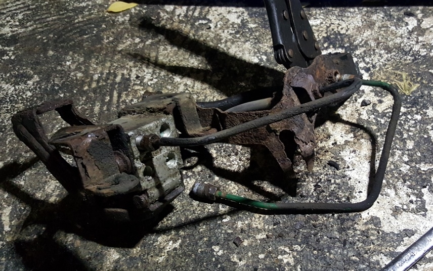

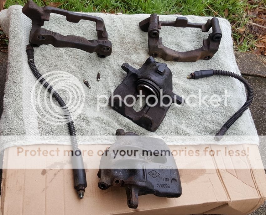

Heat, wire brushing and brake cleaner later, I eventually managed to remove the complete compensator and associated parts
What a total mess, all seized and unserviceable…

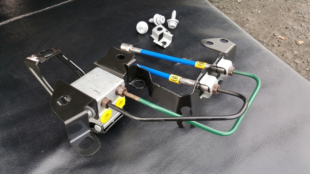

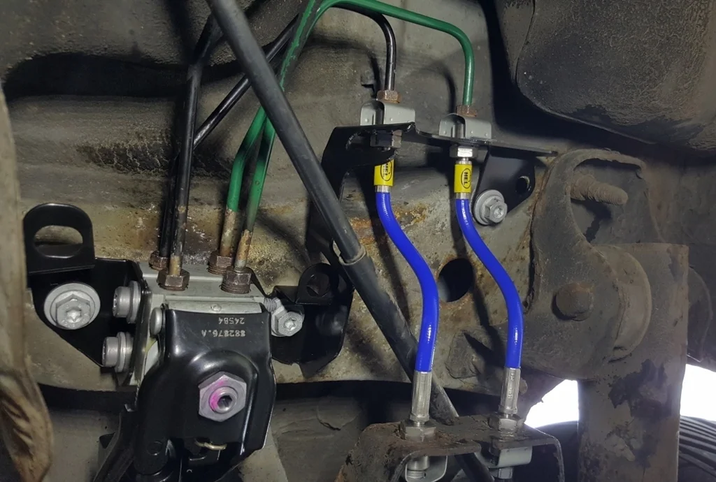

Thankfully managed to save the flexi to compensator lines as they weren’t available from Renault

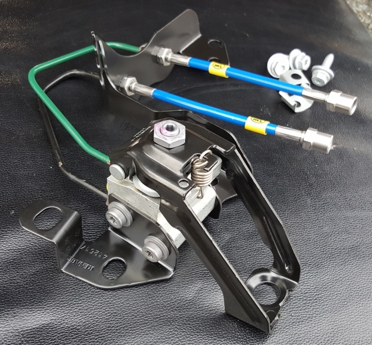

Parts arrived from France, thanks to Paul @renaultpartsdirect for his help obtaining these for me :cool:

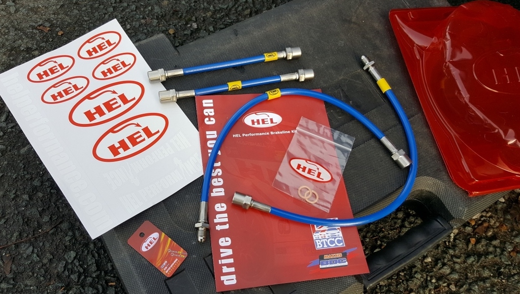

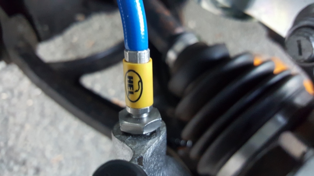

Went for HEL Braided Lines over replacement OE items, but in solid blue to match in with the Bilstein theme

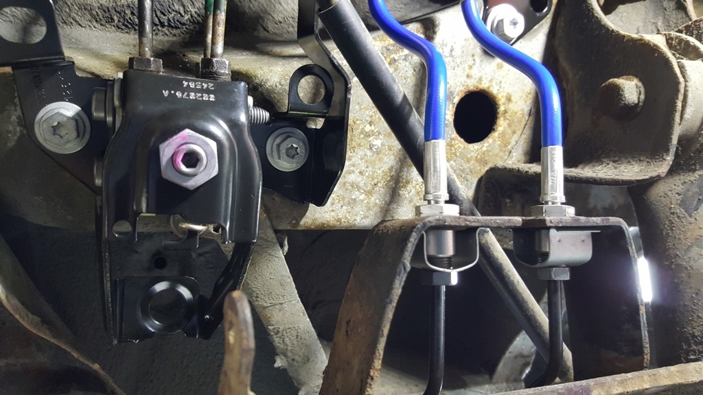

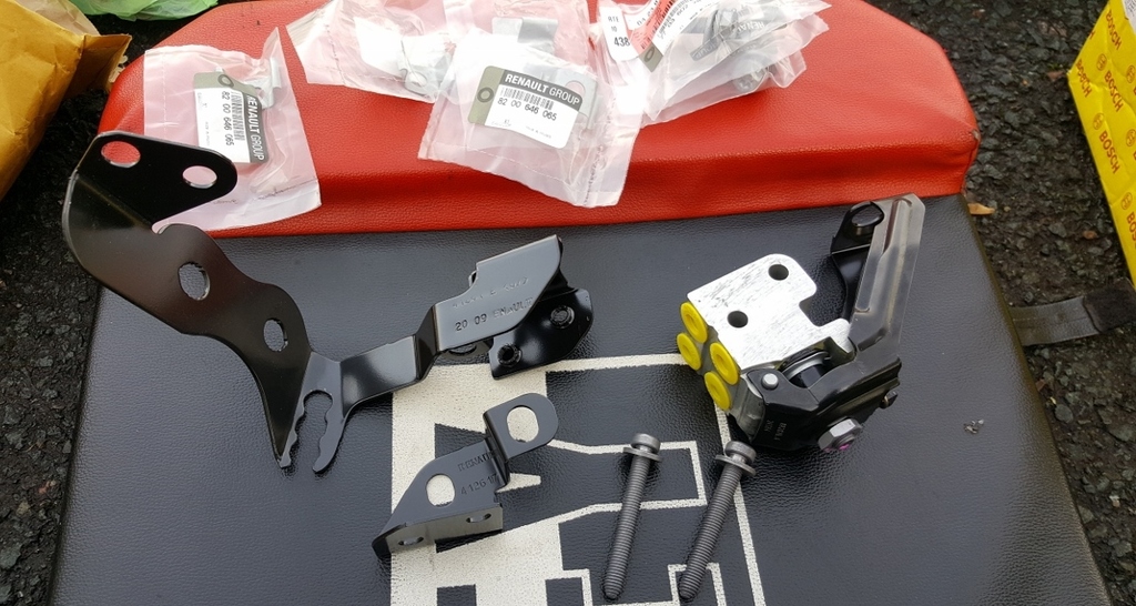

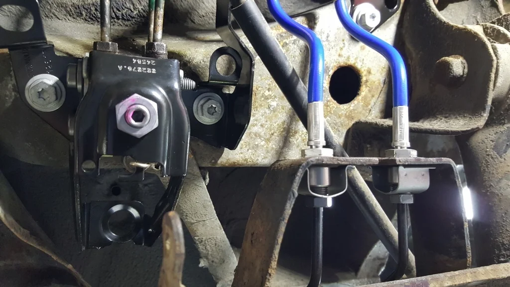

Assembled the compensator, lines and new brackets / fixings / clips and bolts etc
As I had already replaced the N/S brake line, and because it was available, I replaced the O/S line across the rear beam.
It got picked up as an advisory on last MOT anyway. Thanks to George for the better safe than sorry box lol
Fitted Compensator at last :up:

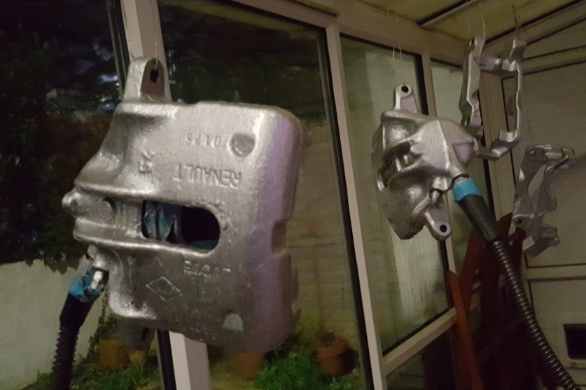

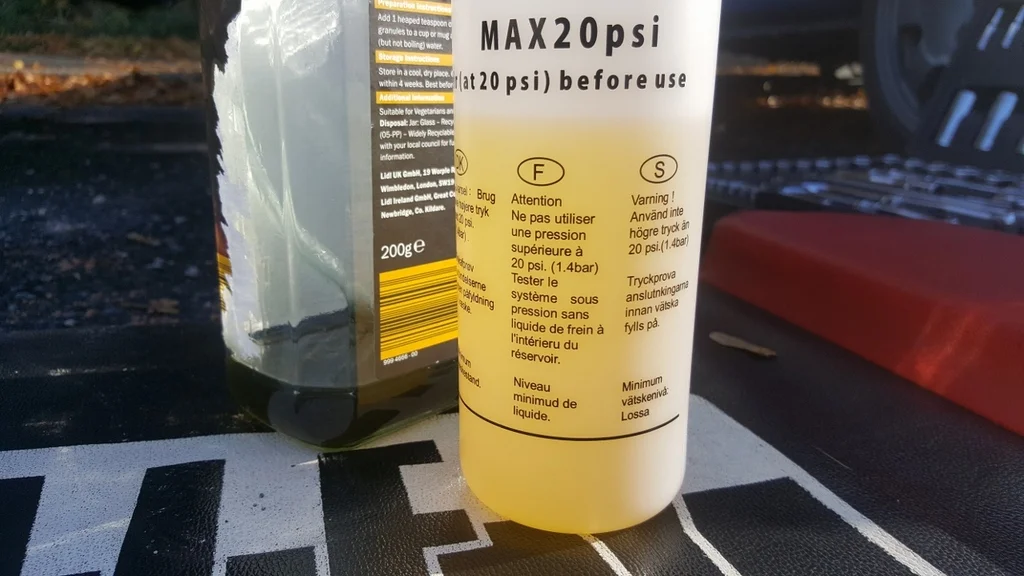

As the whole system needed a bleed and because I was swapping the lines anyway, this was a perfect time to pull off the front calipers to get them painted them for the new wheels in high temp bright silver :cool:

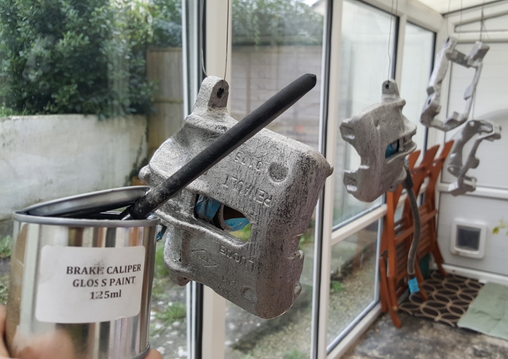

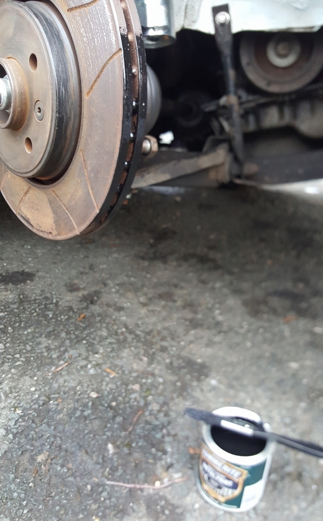

In-between coats used some satin black on the disc edges and prone rust spots
Makes a huge difference once the pads scrub the surface rust off, recommend people to do this! :up:

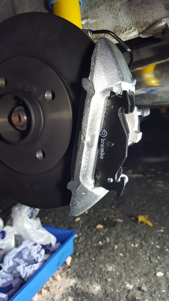

Calipers done, refitted and new front lines / OE clips fitted

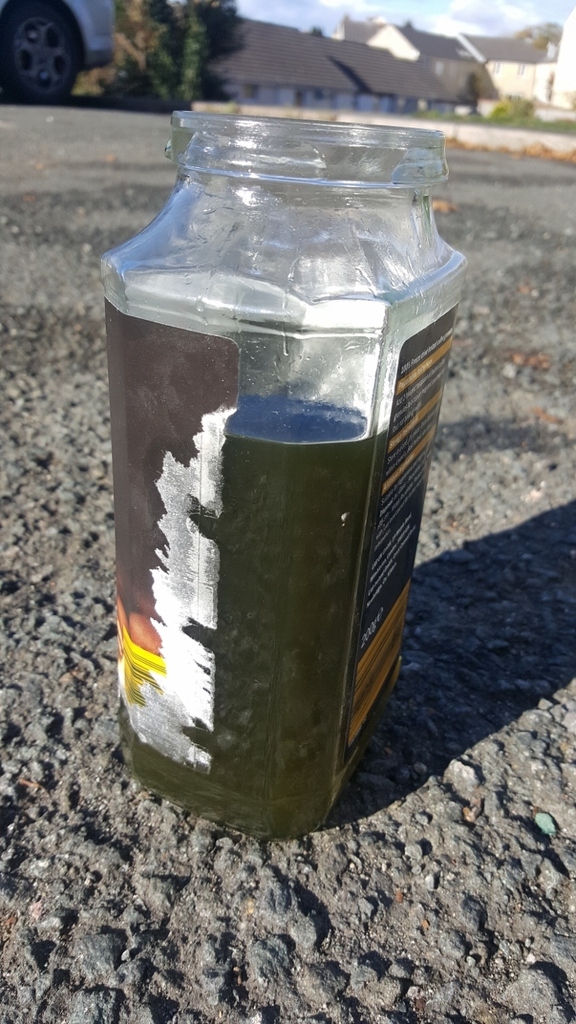

Time to get the brakes bled and get this finished. The old fluid was a mess, looked like it hadn’t been changed way before I got the car :down:

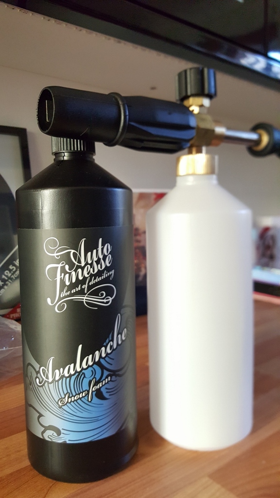

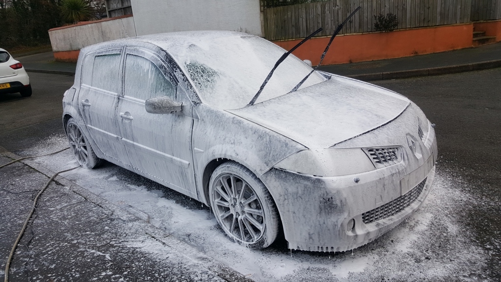

The wife got me some Auto Finesse bits and pieces for Christmas so had a little snow foam session
Then stole it off me afterwards :smile:

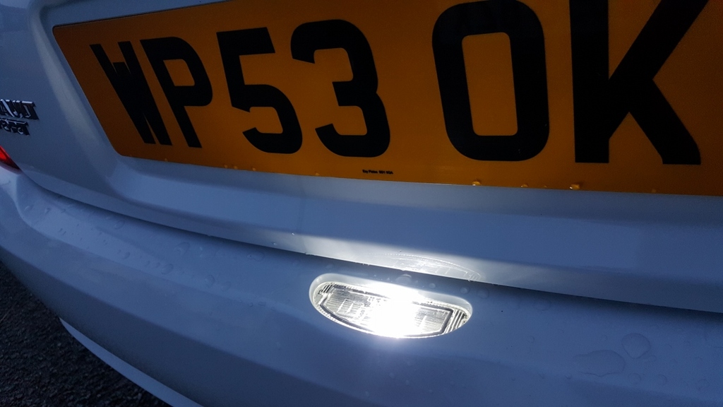

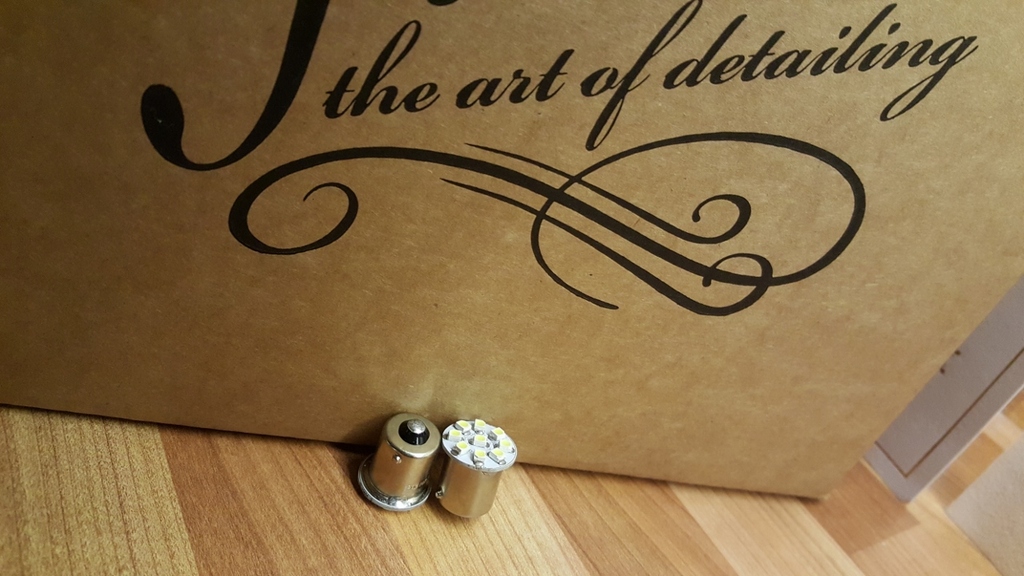

Noticed the number plate LED seemed dimmer
Checked the bulb and some of the board had blown, so fitted a replacement (came with a spare, result!)
Thankfully looks a whiter light than the last :cool:

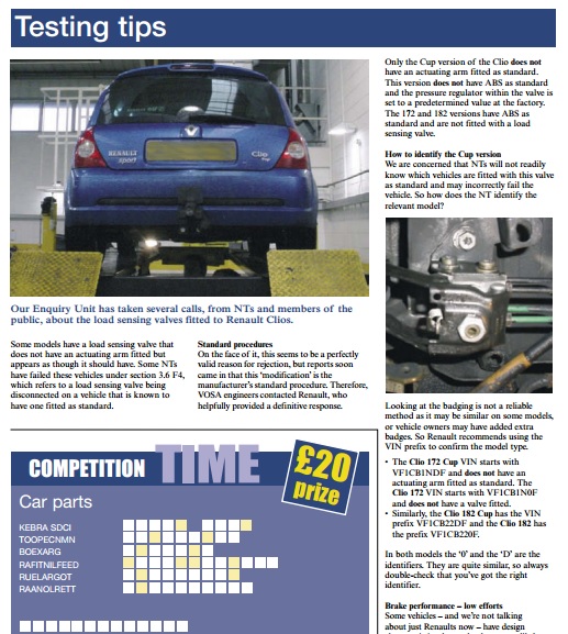

Next garage said:
"This has obviously had a recent overhaul, things are really good, and it's nice to see a car of this age so clean" :smile:

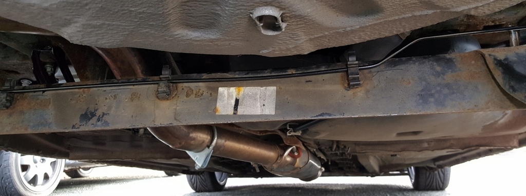

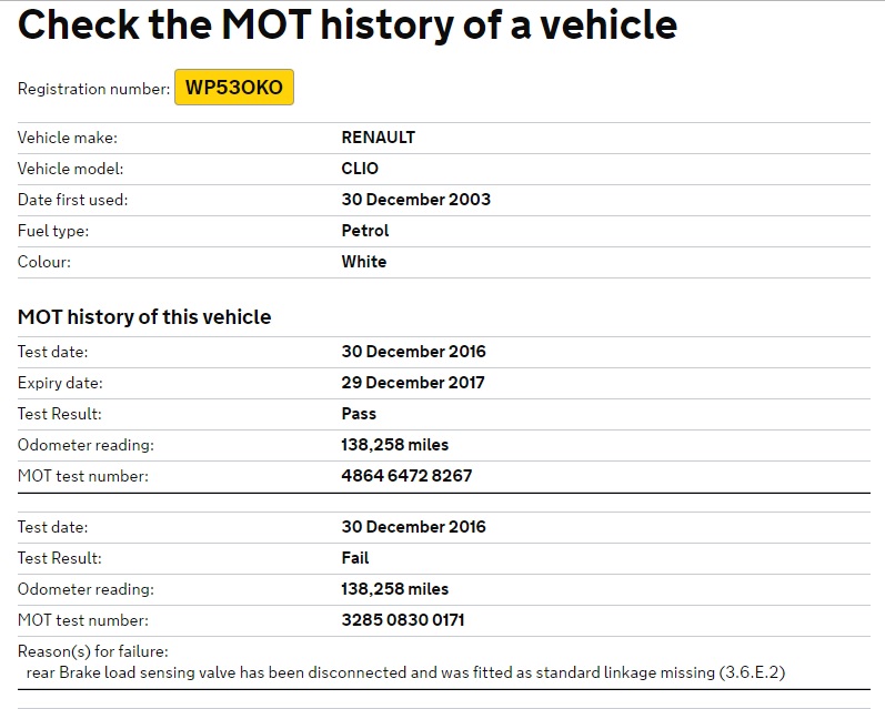

They called later.... It failed.... "There's a part missing from the rear brake compensator" *Sigh* :relieved:
I went back and showed the tester the VOSA Cup document… He checked the VIN number and apologised
Boom! 12 Months MOT again with no advisories this year! :up:

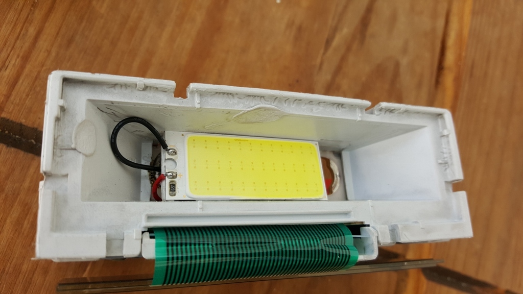

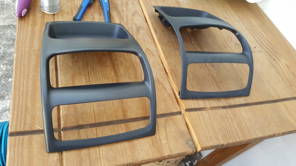

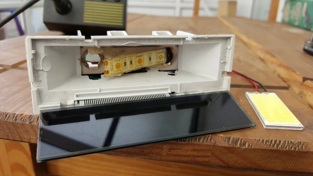

The MFD / Clock display became dim and shadowy, so took a look and found it had failed
Replaced with a COB unit, and also swapped the centre vent section for the Sport soft touch one from my old dashtop

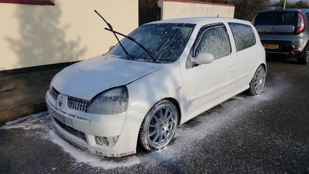

And because driving to the MOT got it sprayed with road salt (slight exaggeration)...
Power Washed
Auto Finesse Iron Out Wheels and Exhaust with Hog Hair Detailing Brush then Shampooed
Power Washed
Auto Finesse Avalanche Snow Foamed
Power Washed
Poorboys Super Slick Shampooed with Auto Finesse Lambs Wool Mitt
Power Washed

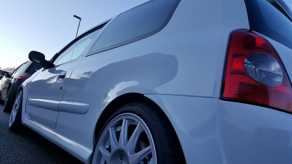

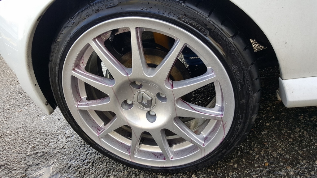

Drove up and down the street holding on the brakes to clear the rusty discs from Iron Out
Auto Finesse Aqua Deluxe Towel Dried
Auto Finesse Clay Bar'd with Auto Finesse Glide Lube
Microfibre Buffed
Poorboys White Diamond Polished
Microfirbe Buffed
Poorboys Natty's Paste Waxed - Every surface (windows etc)
Auto Finesse Revive'd all the plastic trims
Meguiars Hot Shine the tyres

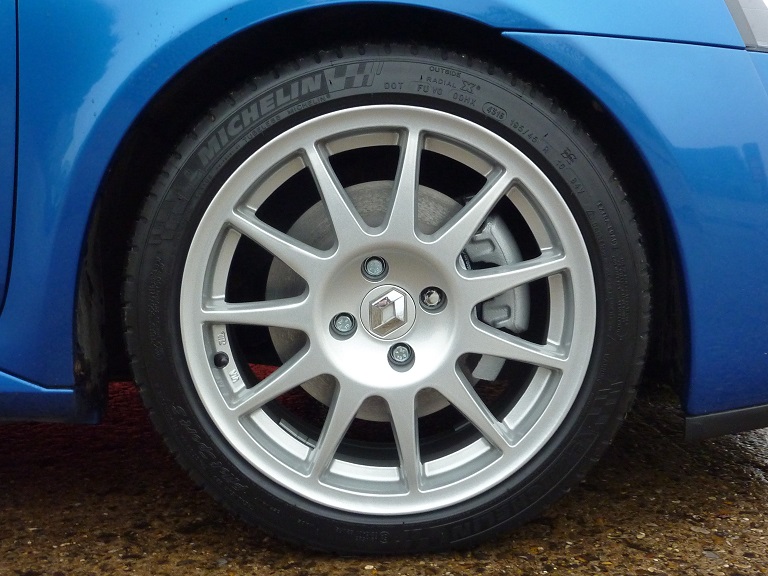

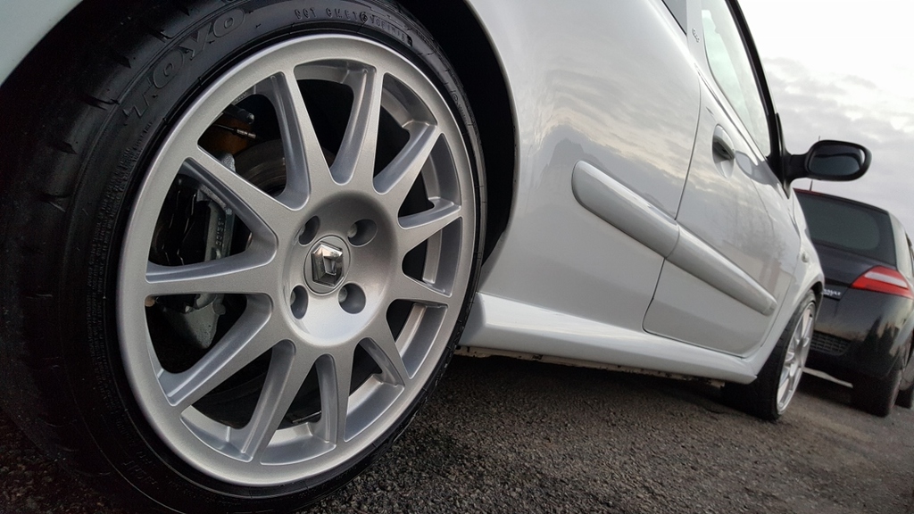

Silver calipers too :tongueclosed:

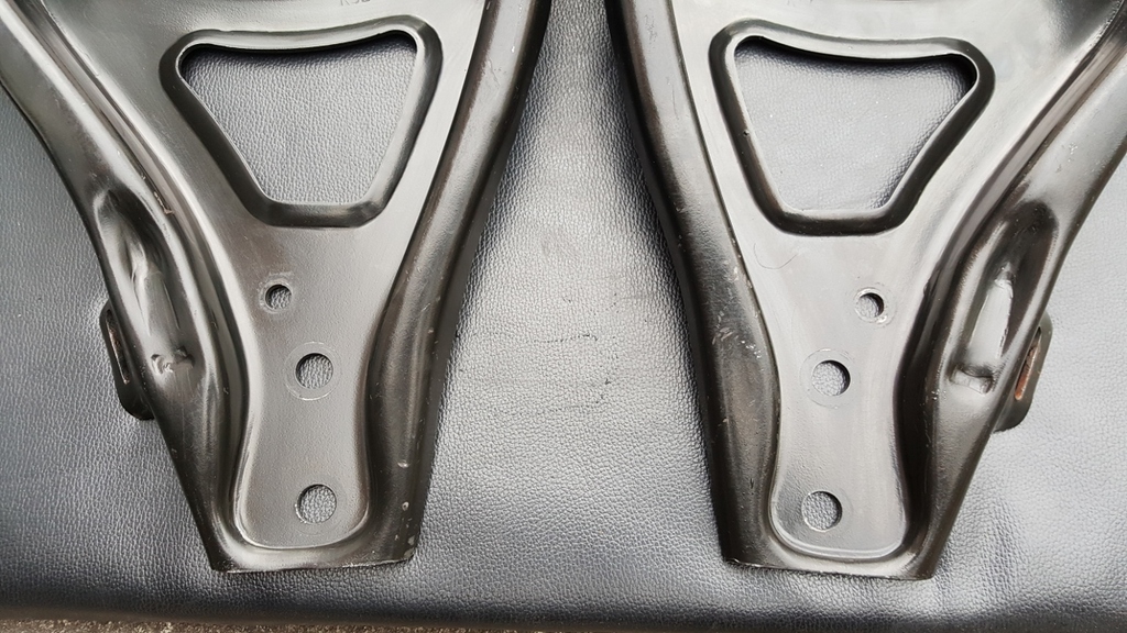

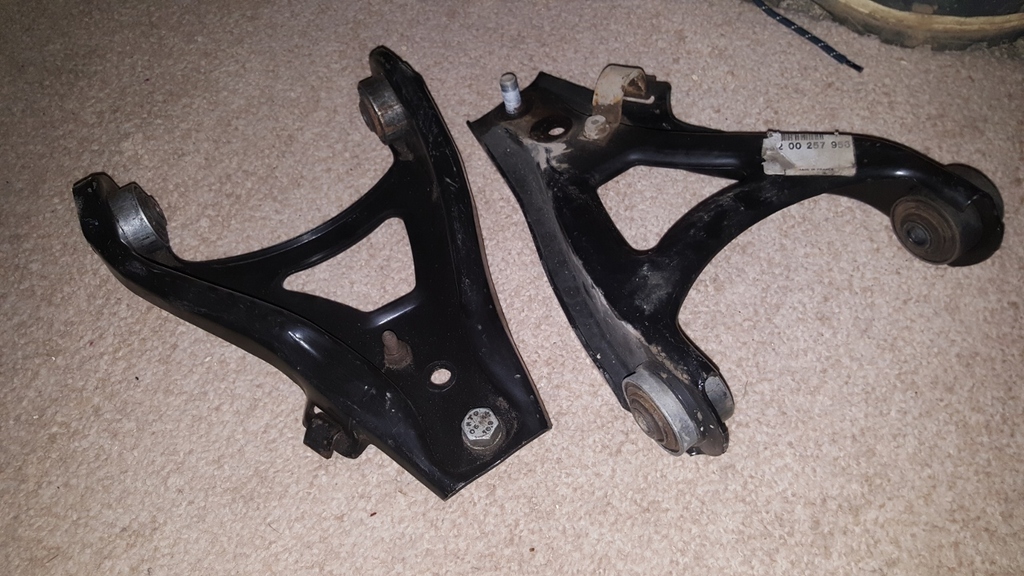

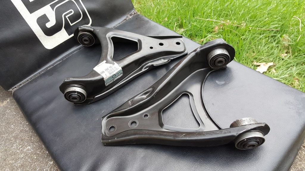

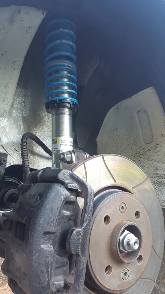

After all this @cs_dave sold me @ADS_V6 's Cup wishbones.
I've changed everything else so may as well do these too, cleaned up and they looked like new again
Nice Cup caster :)
Maybe a good time to do all the anti rollbar bushes?

Are you using 195's on the Turini's? Only thing I'd change is to 205's as I think they look better but it's all personal preference.
Lol a years worth of pics on my phone was painful trying to get some sort of order and choosing the ones to upload etc!
It's a Cup, so 195's for me ;)

P.S. silver Turini's and silver callipers has to be done! :smile: Mine's on 195's too...........
