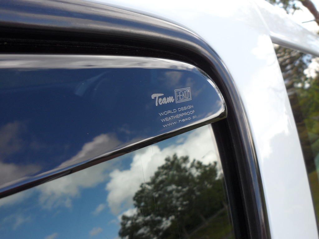

Team HEKO's to break out the wind
Another great product from AG

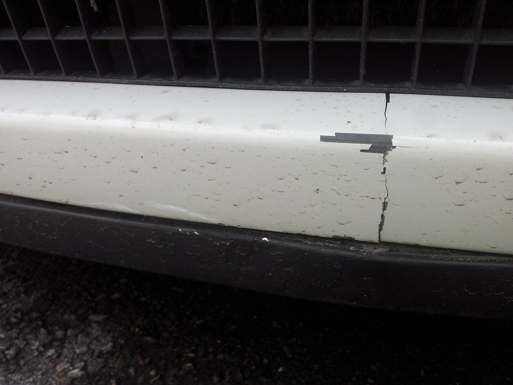

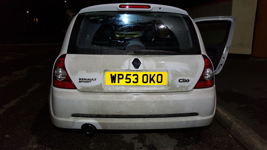

Shortly after I changed my job, became hugely busy, which resulted in a careless mistake 😧
Temporary botched effort touch up :down:

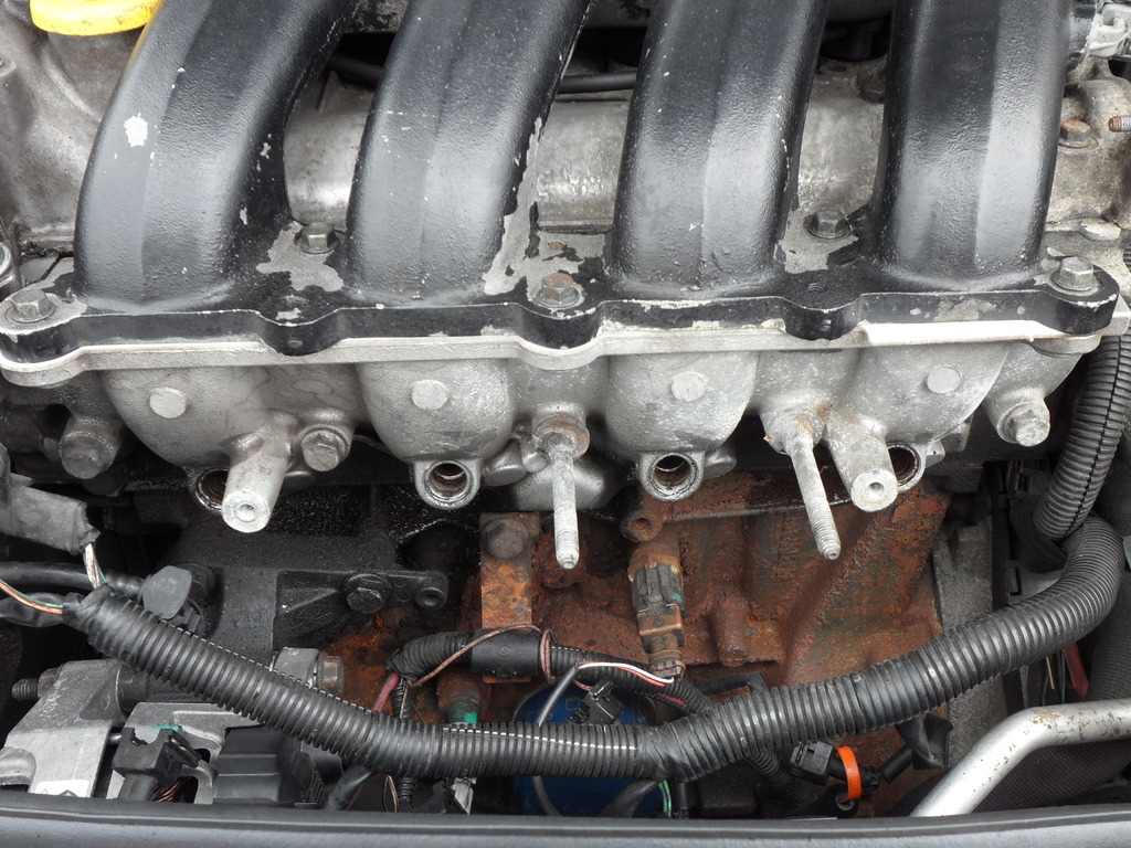

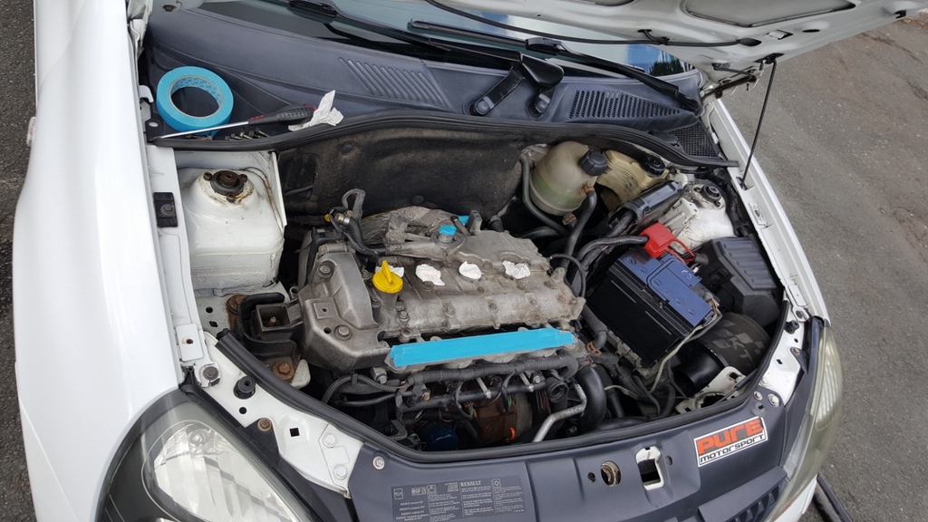

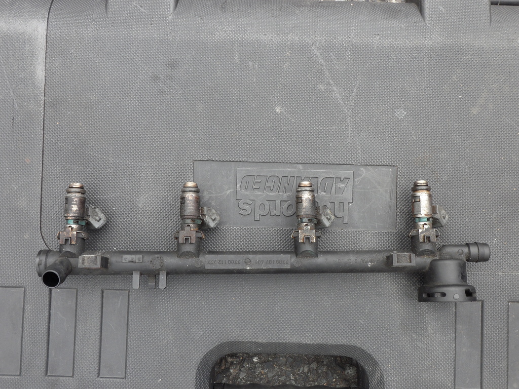

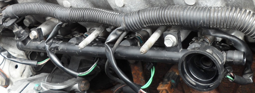

Then the car developed a misfire, not that I'm surprised
When at WOT below 3k RPM, or pulling away at low revs, it would bog down which became unbearable in traffic
Started with new injectors as the old ones had done a fair bit of mileage!
4 x New Genuine Magneti Marelli - IWP042's
Replaced a MAP Sensor which looked to be previously fitted by a cowboy builder 🔨

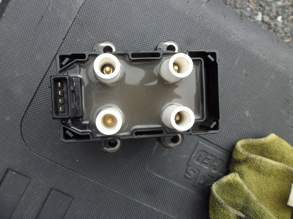

In the interest of new genuine parts, decided to also replace the Coil Pack

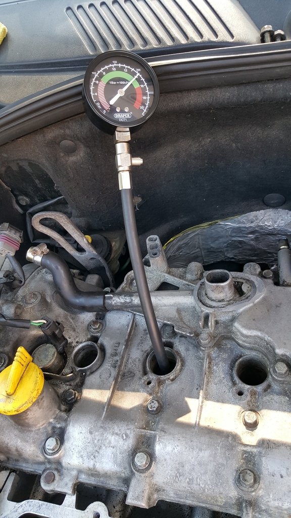

Quick compression test across the cylinders, which all came out well :grinning:
Very nearly new battery fitted, such a difference to the well being of the car
Ditched the labels and fitted a new positive red terminal box...

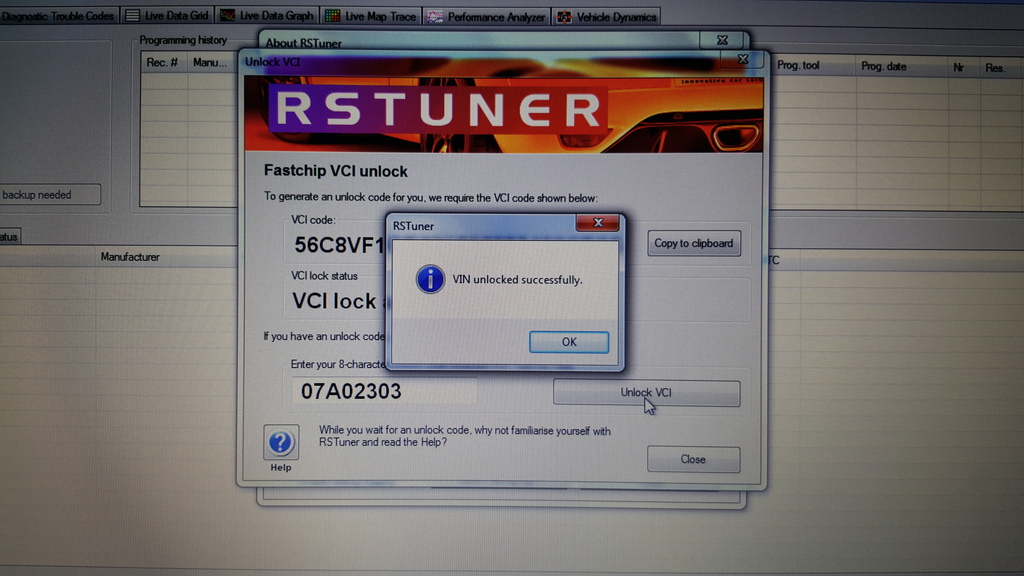

With all this done, what better way to bring it all together with an RSTuner :stig:
98 RON Performance MAP loaded on...
No more misfiring, running very smooth, and what a significant difference from that map ! :astonished:

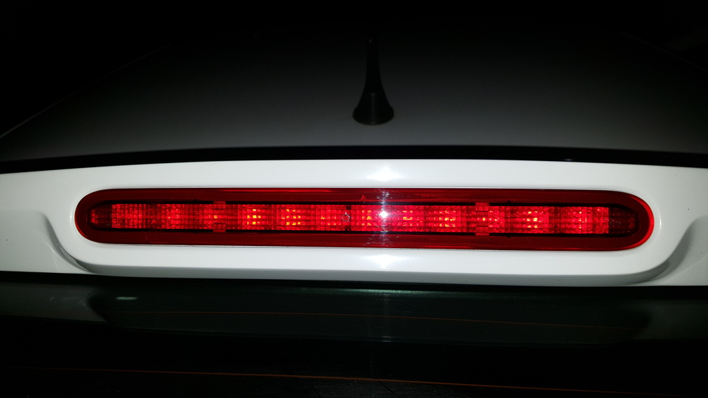

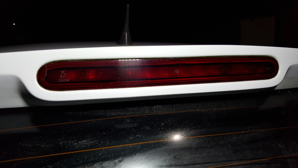

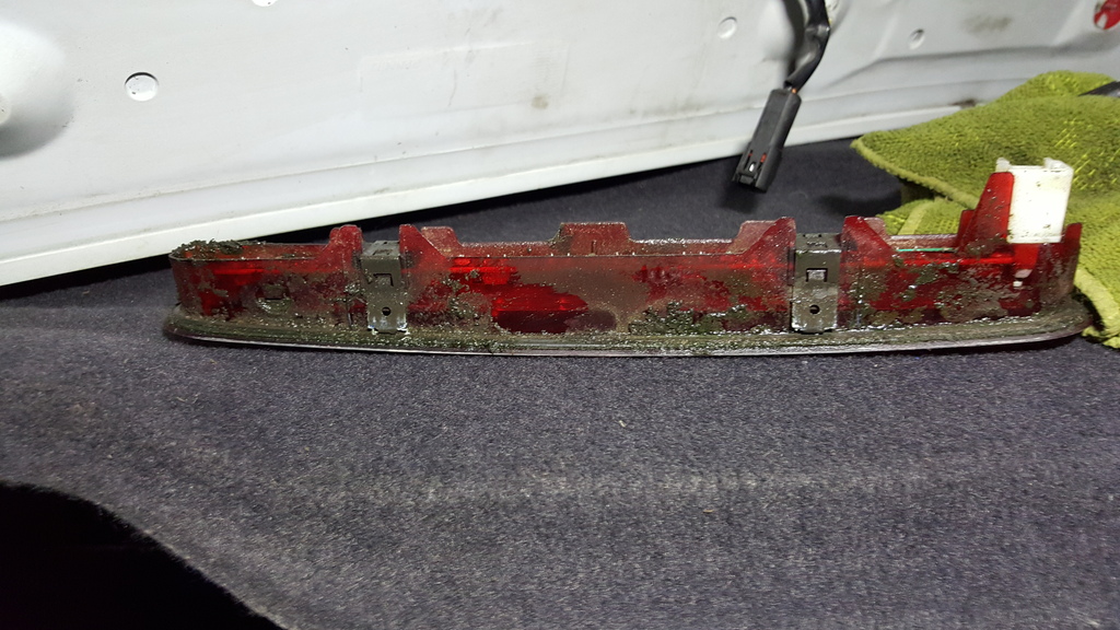

Moving to the outside, this cracked old brake light gave up completely...
Big improvement to such a filthy car

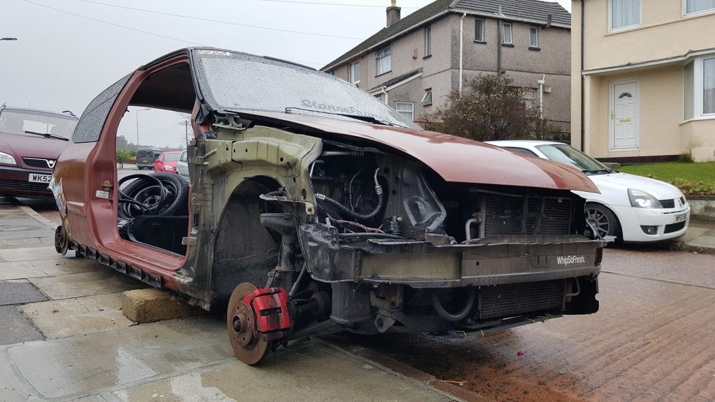

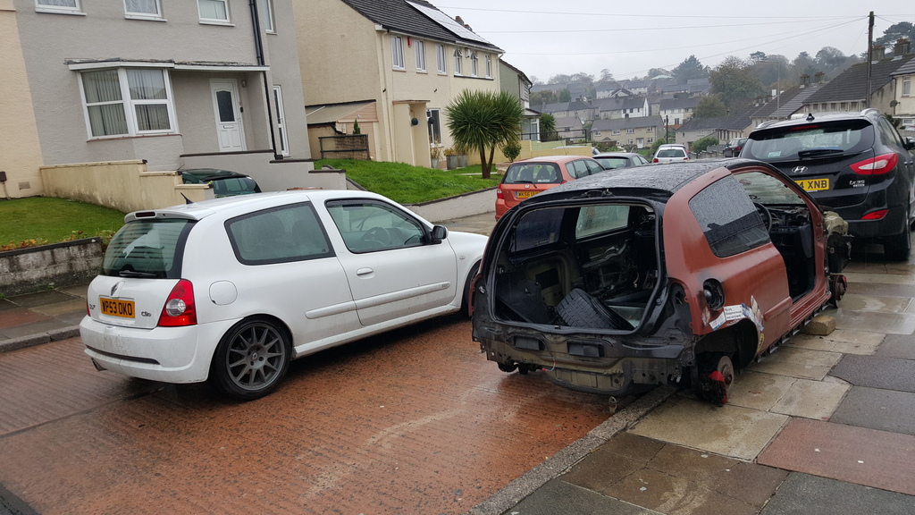

Raided this local car for parts before it got scrapped, some may recognise it ?!

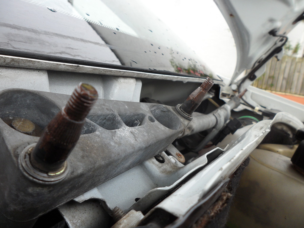

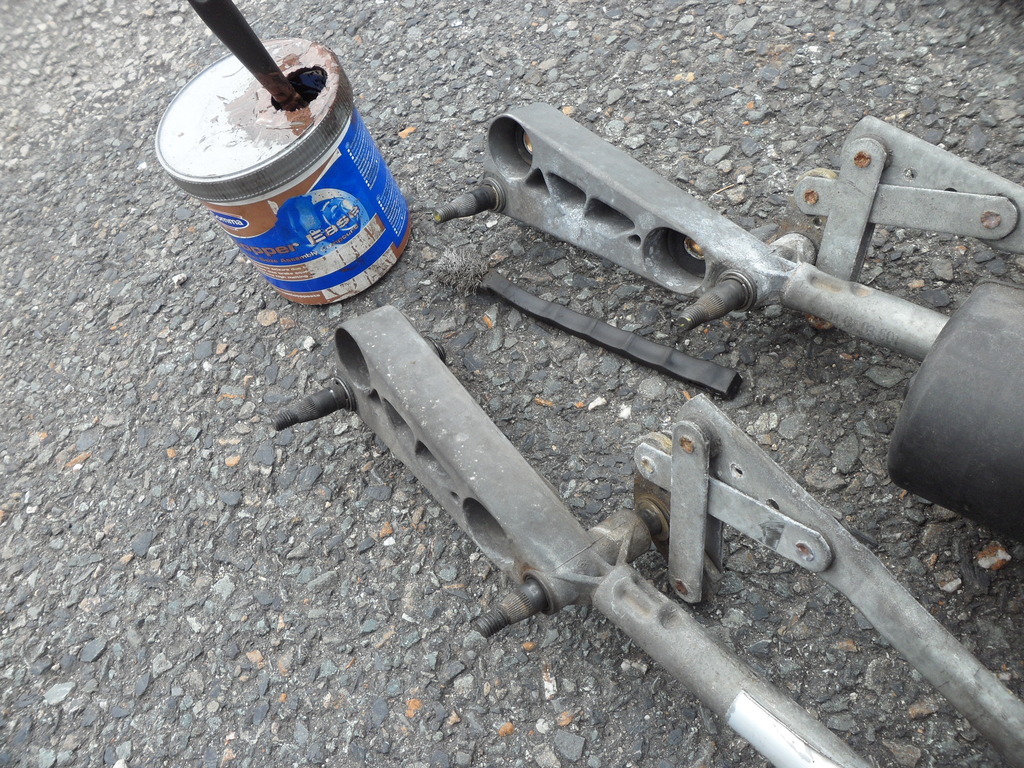

Collapsed wiper mechanism replaced due to worn circlips

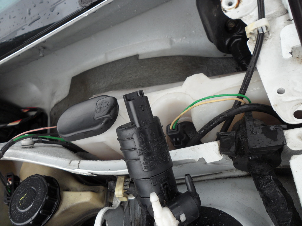

New washer pump, to fix the rear washer spraying the same time as the fronts, and vice versa (the common fault)

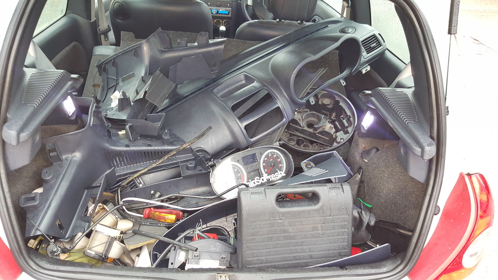

Gathered together lots of interior plastics to replace any damaged / scratched bits

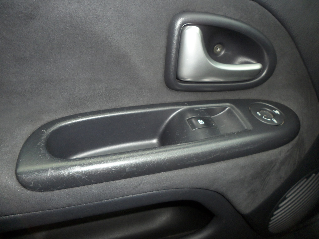

Door handles swapped for non soft touch items, highly recommended!

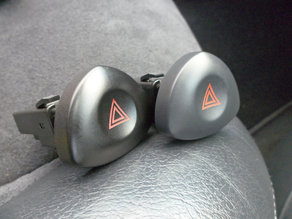

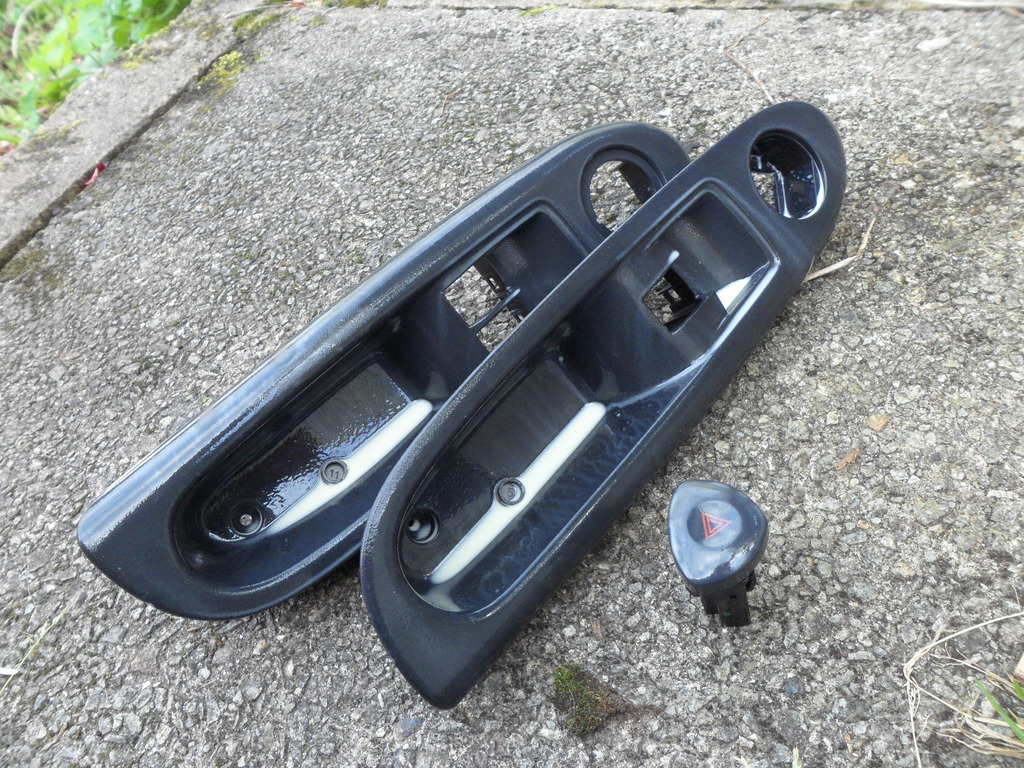

Hazard Panel replaced and a Genuine Hazard Switch

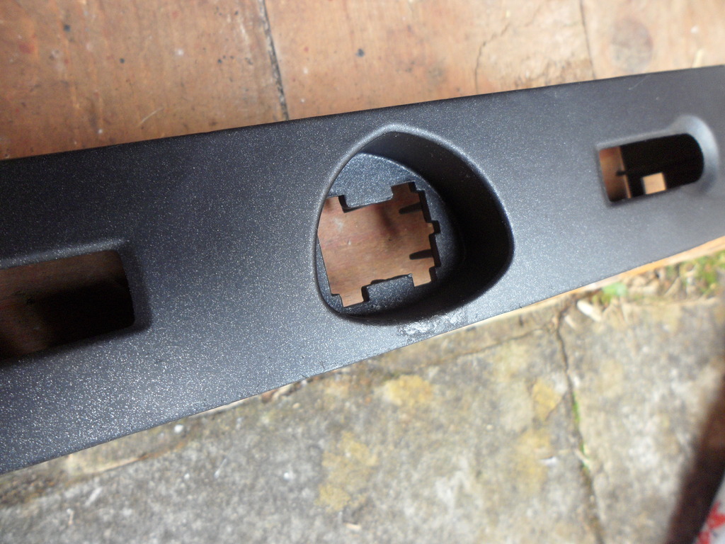

Dashtop finally swapped, this little nic has annoyed me since the original test drive 😊
Obviously sacked off the 'minion', but couldn't save the VIN sticker, so added a texture effect to match the dash

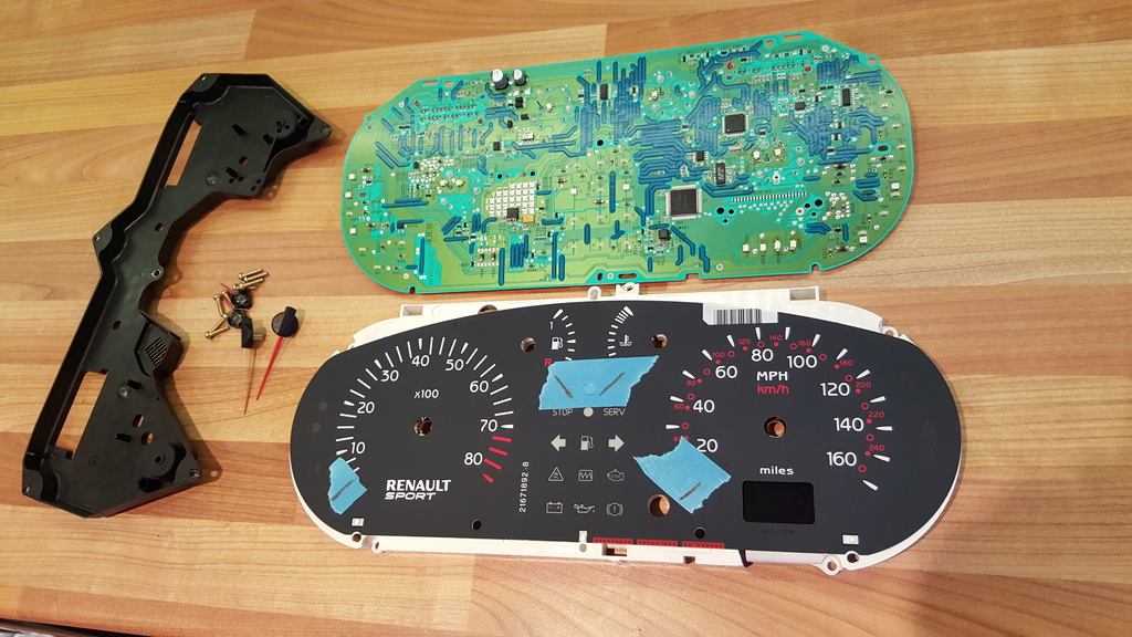

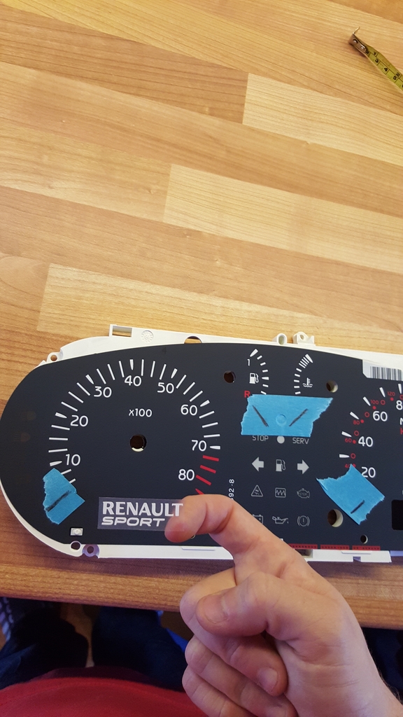

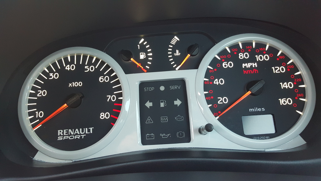

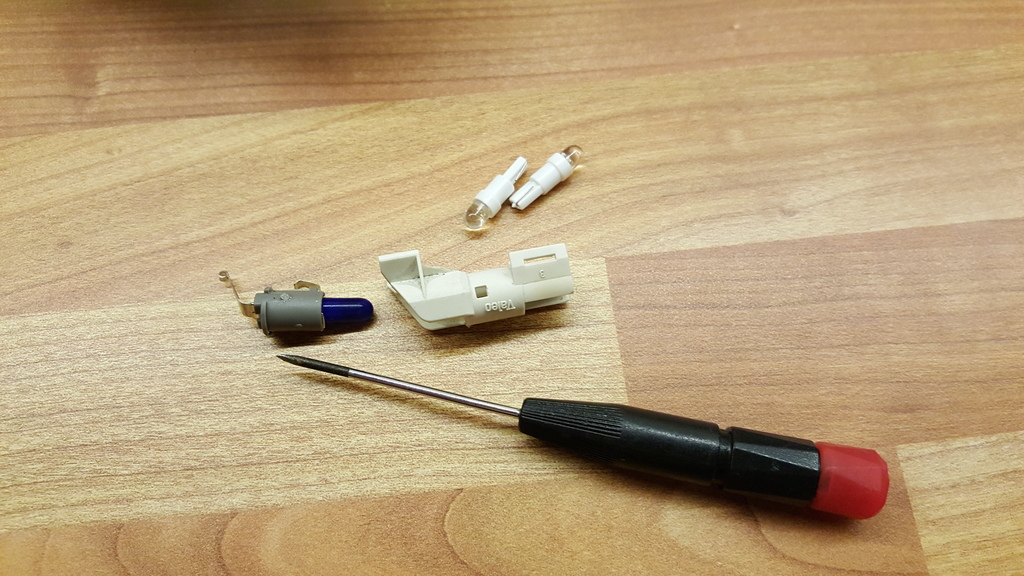

Did some final work on my clocks / dials
Made one mint set out of four, as wanted to retain the original mileage
Tidied up some soldering

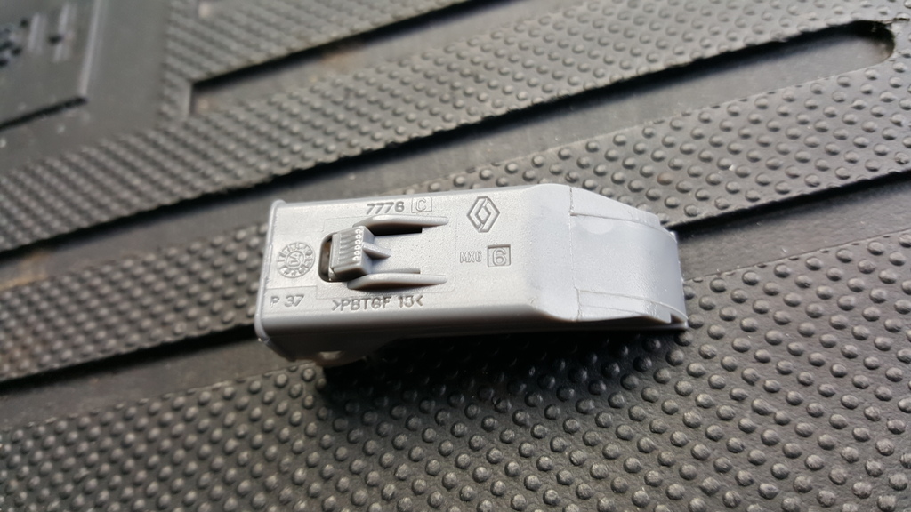

Mine was missing this clip housing, so the connection fits tight now

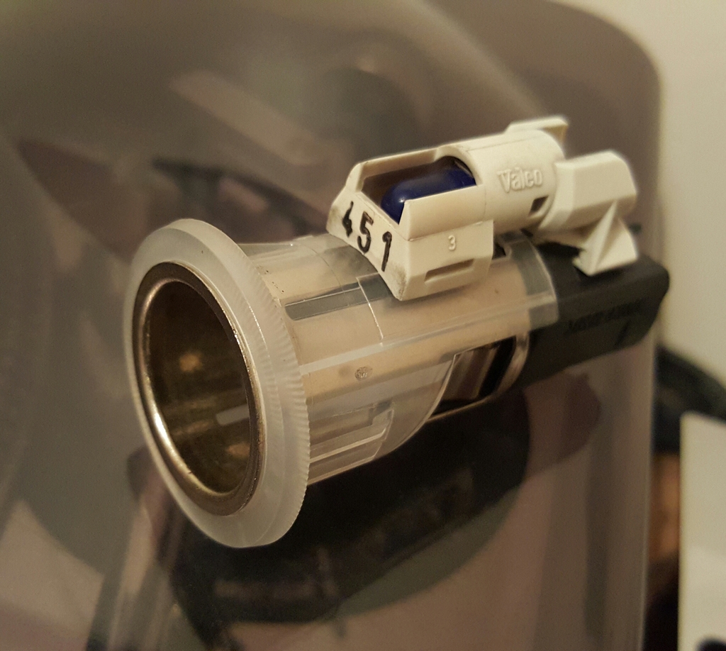

My OCD wasn't liking the orange one with the white illumination

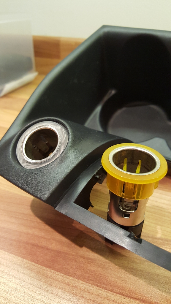

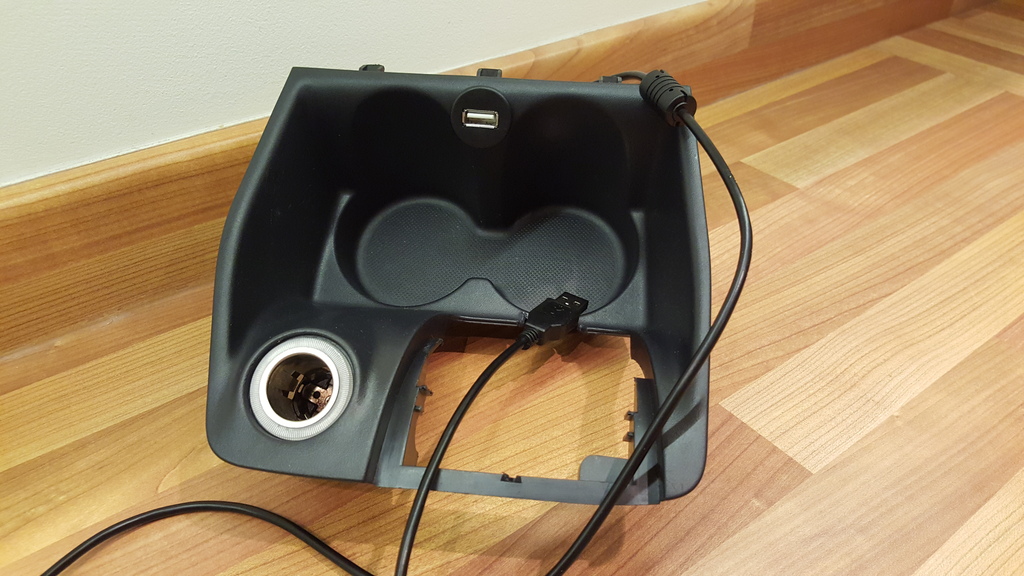

Added a subtle USB housing / Input for my headunit
Keeping in the white LED theme

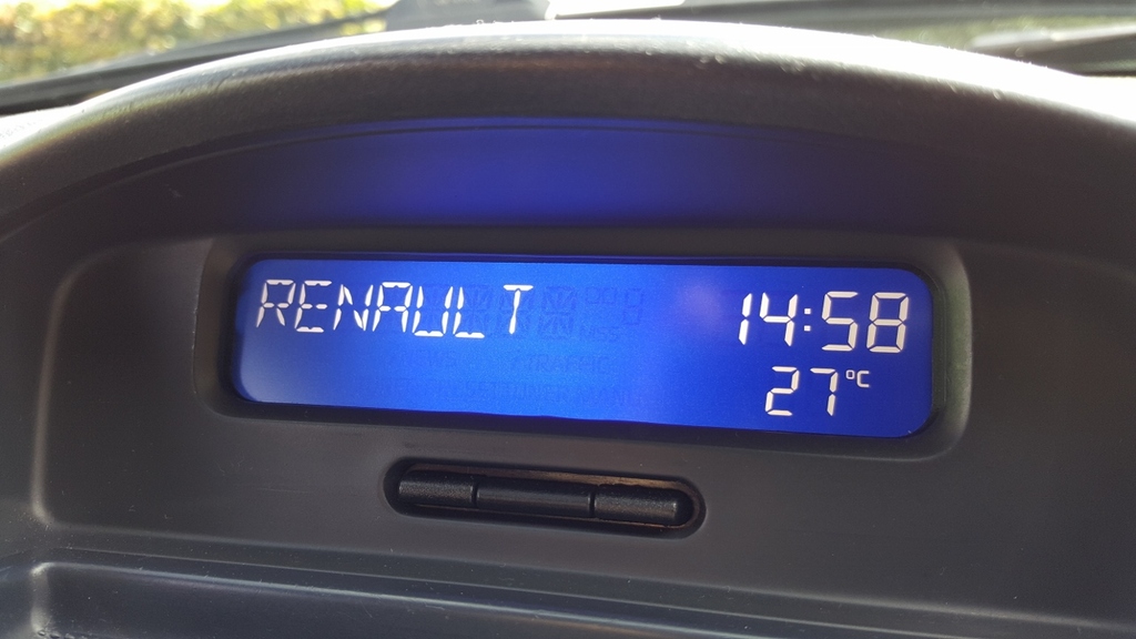

Steering wheel controls now functional (RENAULT pops on to the MFD)

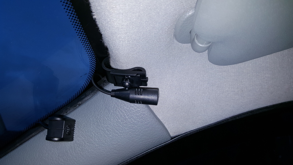

Bluetooth / Hands Free sorted

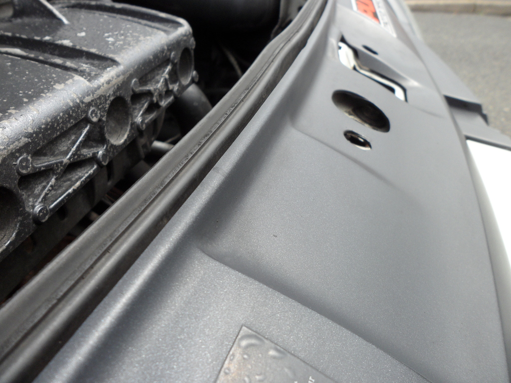

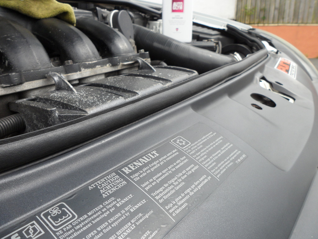

New Bonnet Seal

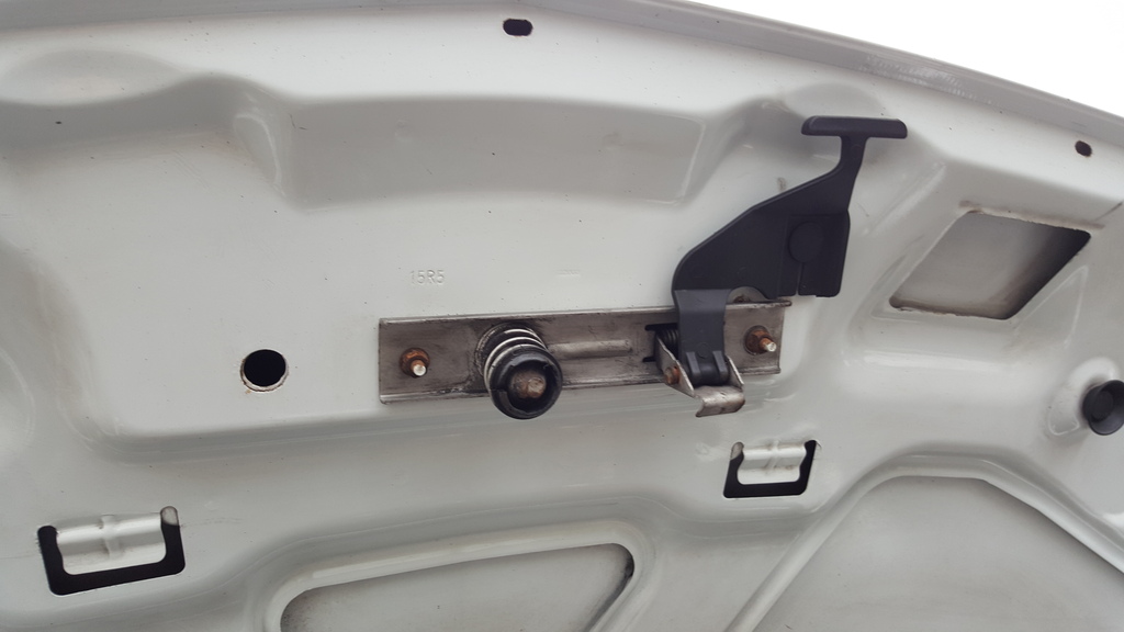

Swapped the bonnet catch for a cleaner one

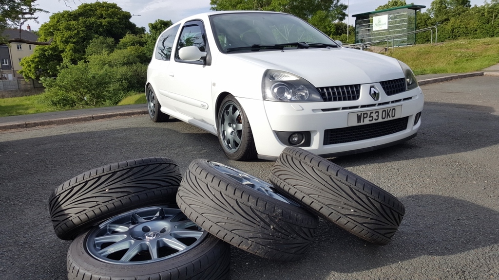

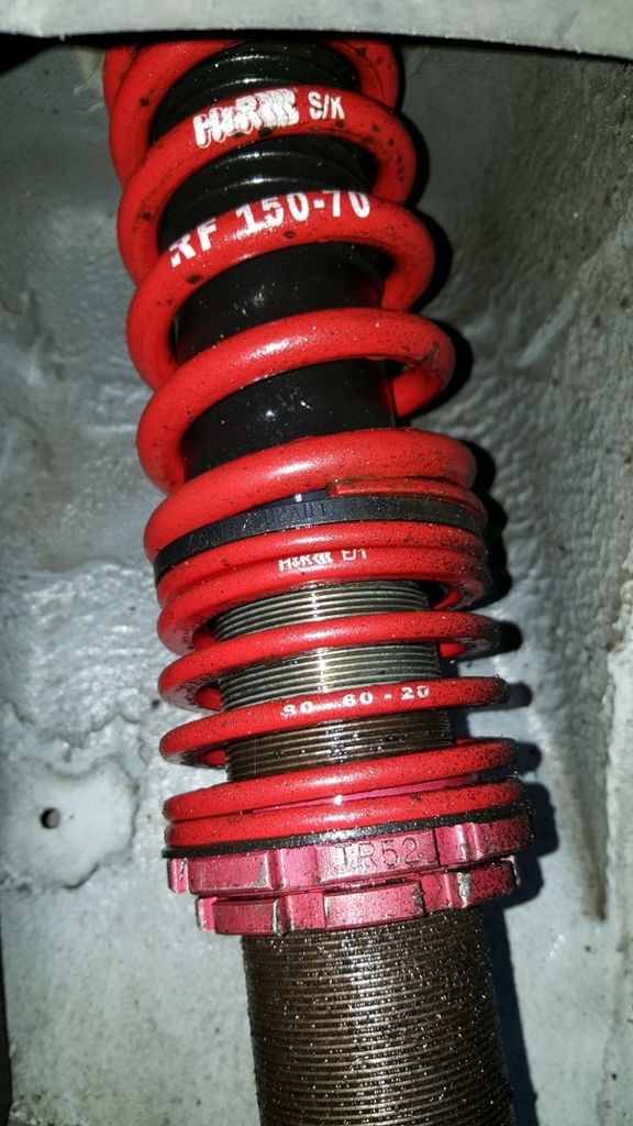

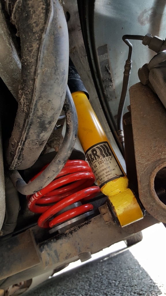

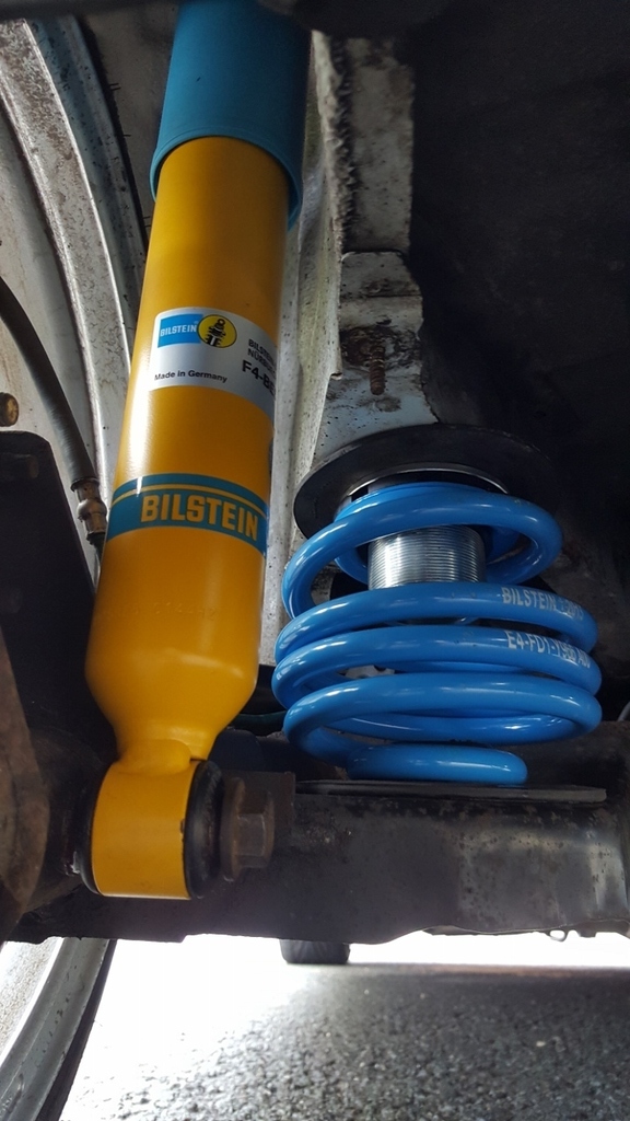

Refitted the KTR Rear Spring Adjusters (Sat a little too low)

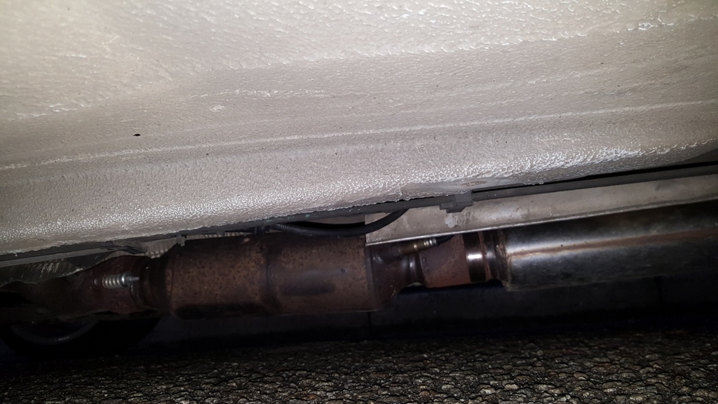

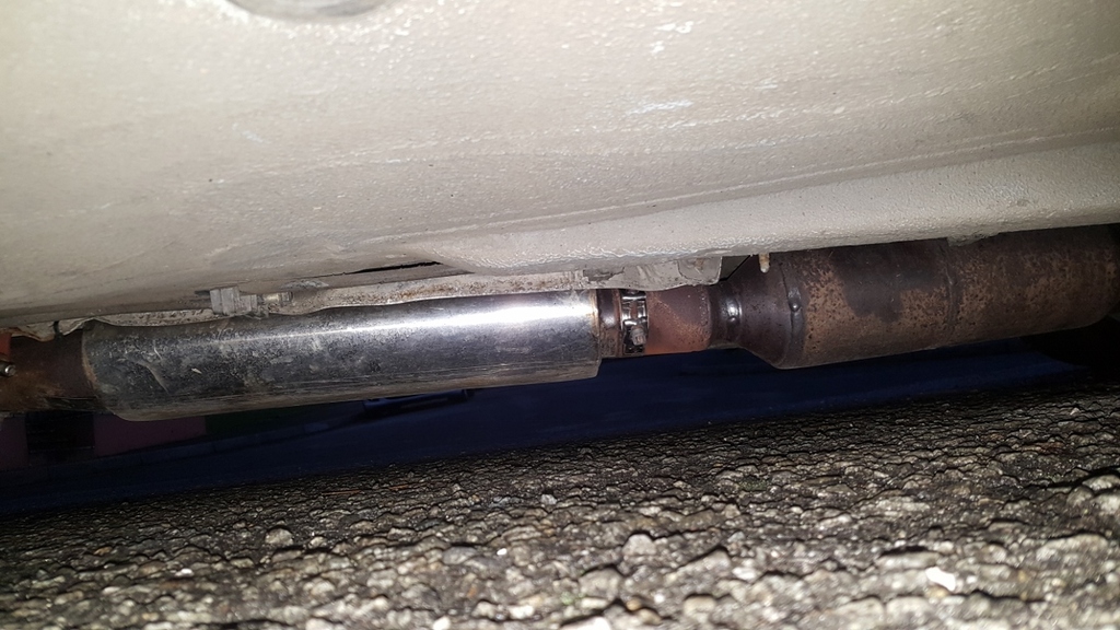

Adjusted the Exhaust

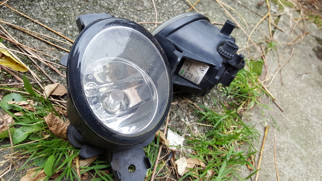

Replaced a damaged fog lamp

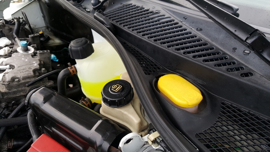

1/4L of Oil Top up

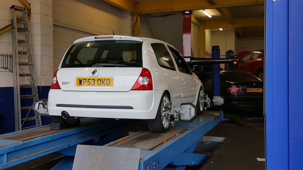

MOT spec time... (I hate that front number plate) !
I went back, "Almost finished, just re-checking the handbrake" they said... Typical Cup MOT
They ended up trying too hard, and snapped the cable, which failed it... ?

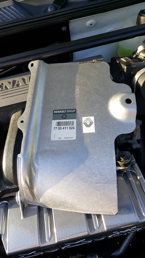

Nightmare heat shield fixings removed and replaced
An advisory was some corrosion on a brake pipe, so sanded it back and painted
Annoyingly they didn't check it on the retest ?

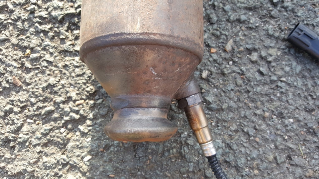

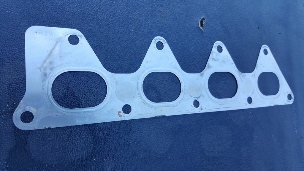

182 Manifold & Cat

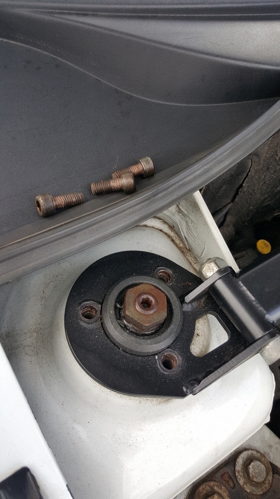

New 15MM Front Spacers and Bolts

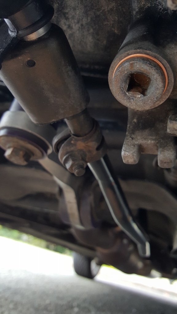

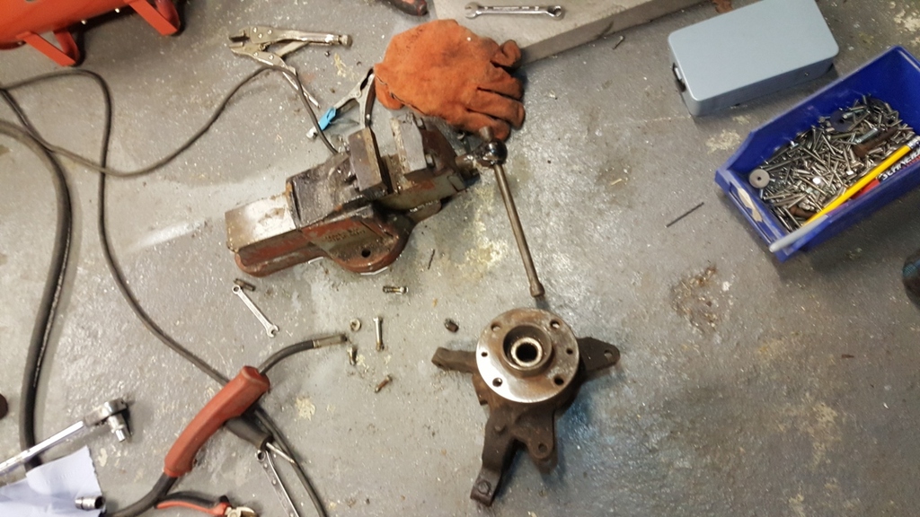

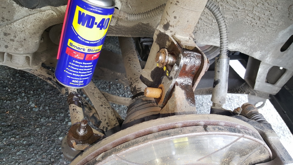

New 10MM Stub Axel Spacers - Thanks to @Josh_F - Has anyone got advice on removing those b*d torx bolts ?!

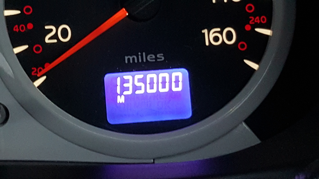

Munching up the mileage...

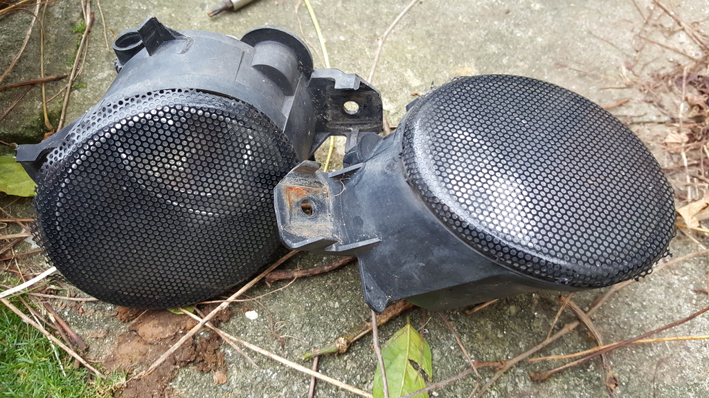

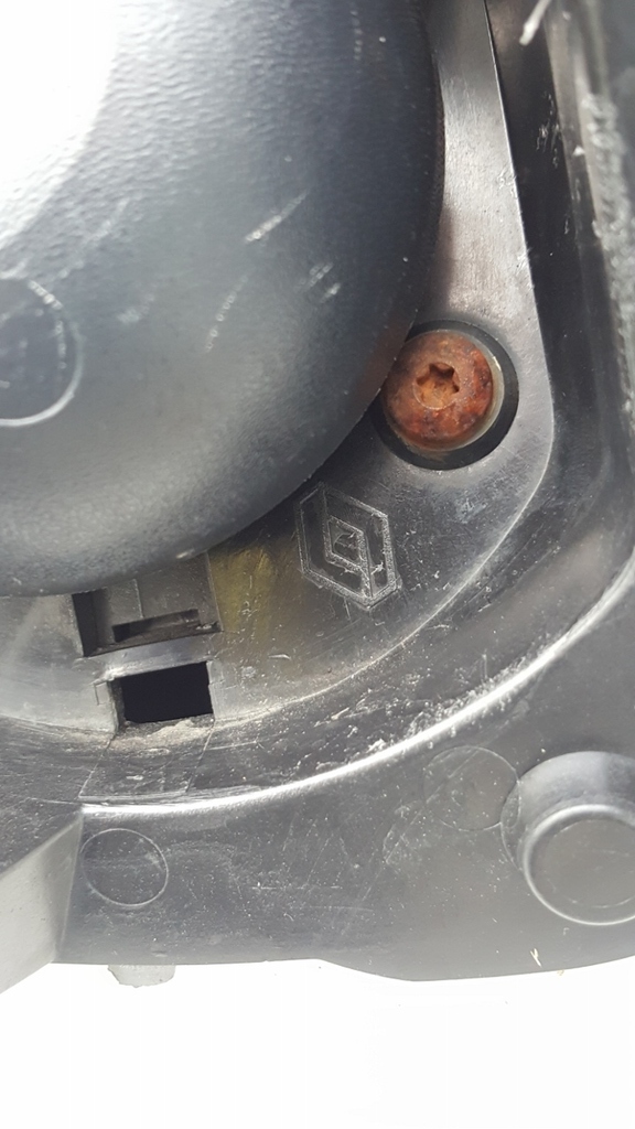

Removed the fog lamps off my spare bumper, as mine kept misting up from water getting in over the winter
Surprisingly I forgot to take a few photos, as I wanted to crack on with giving the car it's first proper clean of the year

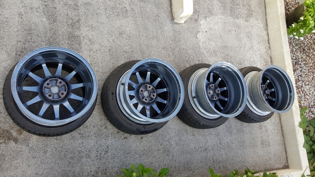

I decided to sell the 10mm stub axel spacers as I was having issues removing the bolts, so:
15mm Spacers originally for the front, used for the back
20mm Spacers bought for the front
16 x New Wheel Bolts to suit the extra width
Replacement fogs fitted

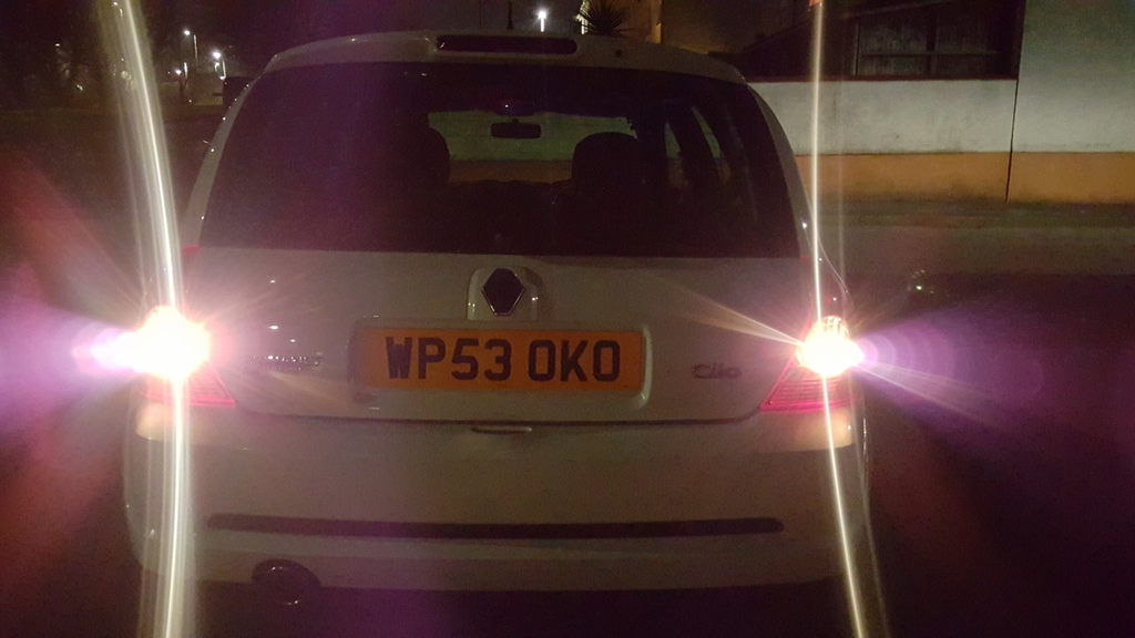

Continuing on from last time, the reverse lights completely stopped working

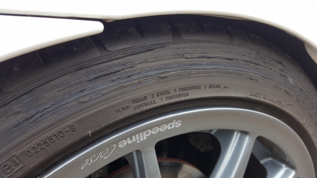

Since fitting the rear spacers, it was suffering with bad scrubbing whilst pushing it on bumpy corners, so rolled the arches in a bit tighter

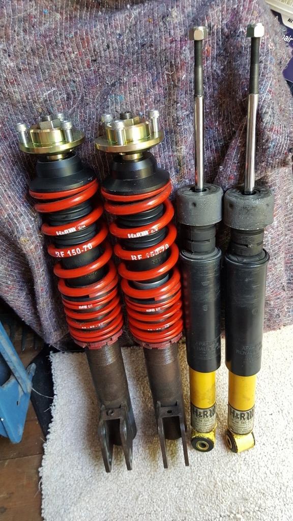

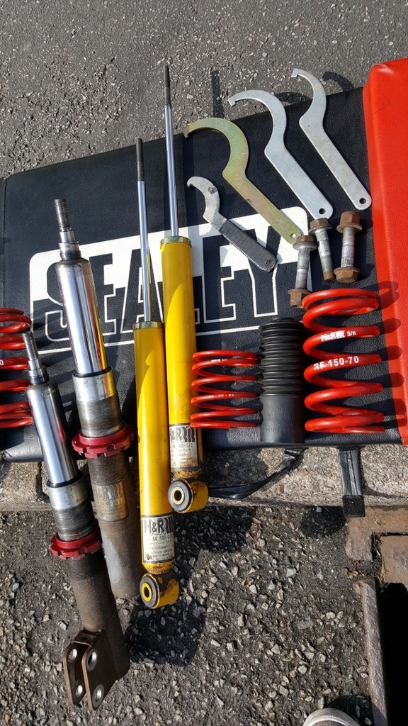

Then a set of H&R Coilovers popped up on here in the for sale section from @basket491 and had to snap these up.
They cleaned up pretty well for second hand units

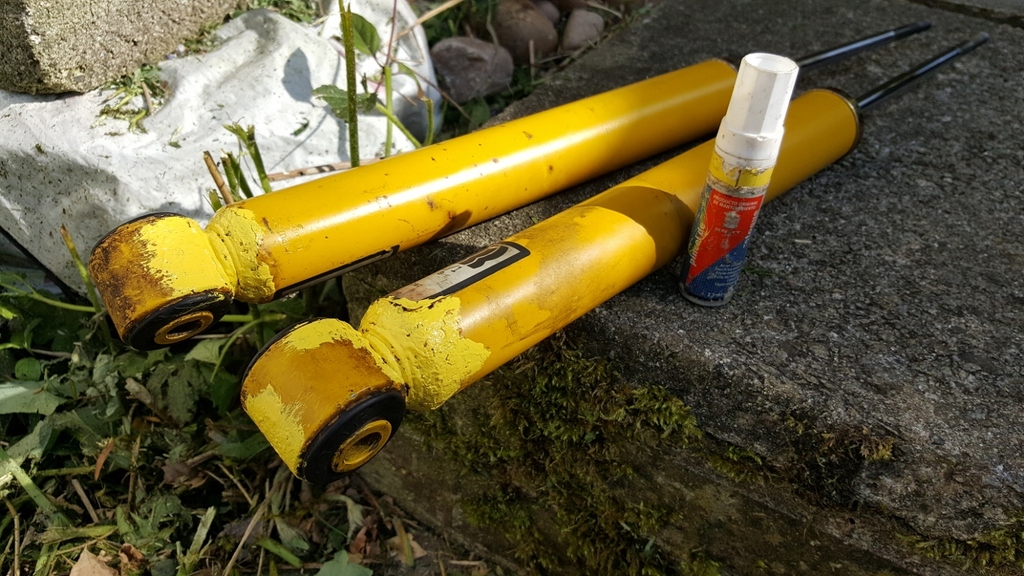

Found some old yellow touch up from the SEAT Ibiza, and although it didn’t match and wasn’t pretty, it saves any rust spots

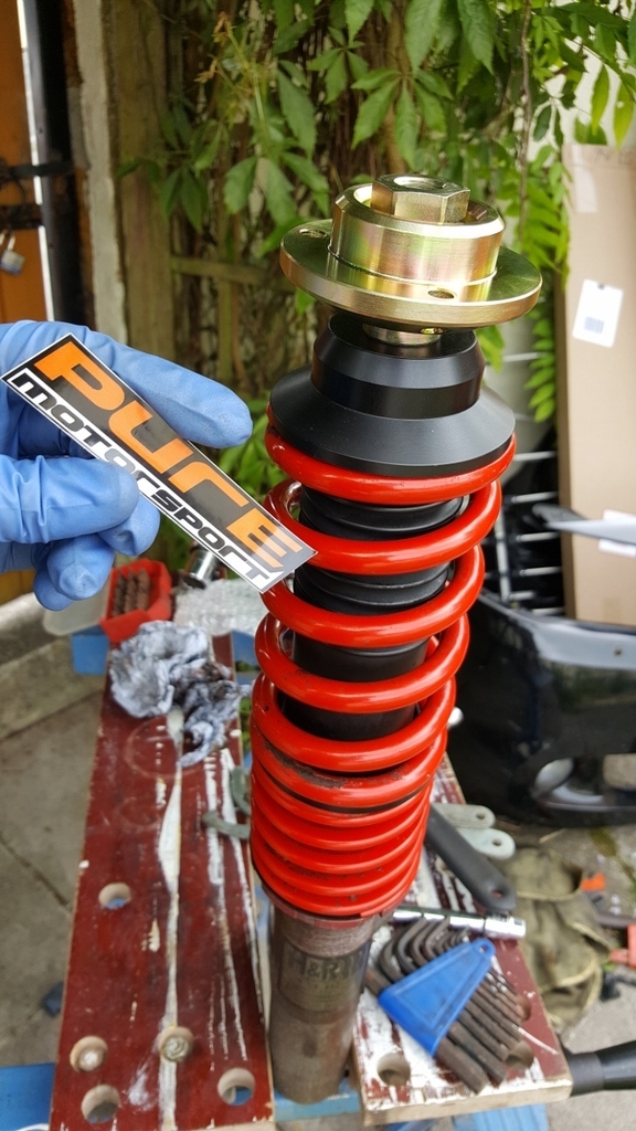

At the same time I decided to refresh the top mounts, although they didn’t really require it if I’m honest.
Top service from Nick @pure-motorsport :smile:
All cleaned, greased up, and spinning nicely for adjustment
Complete

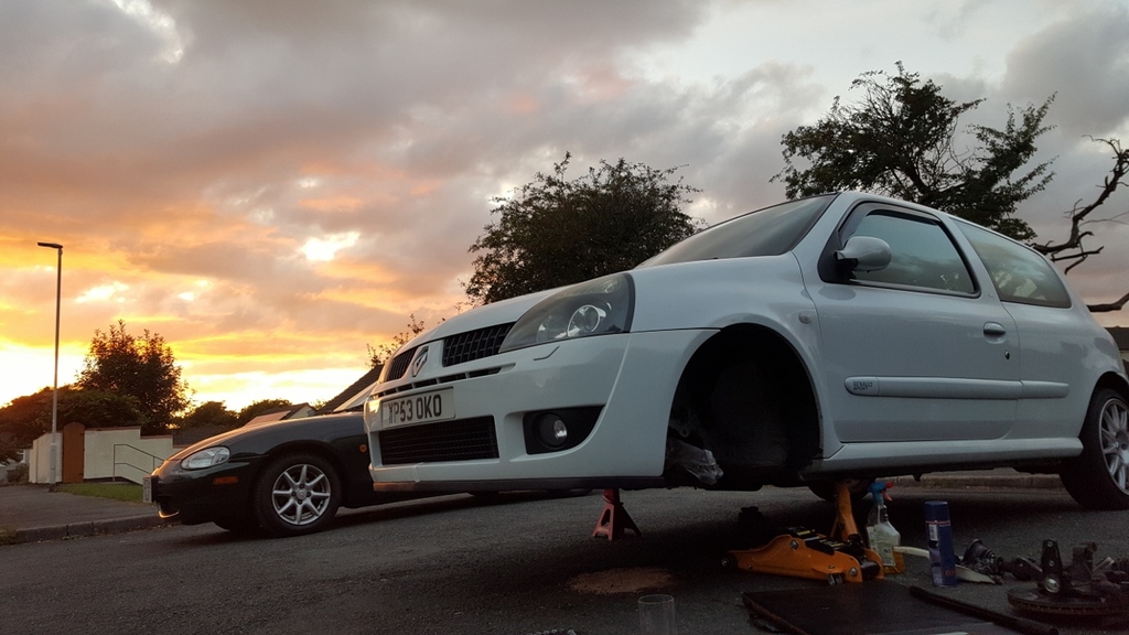

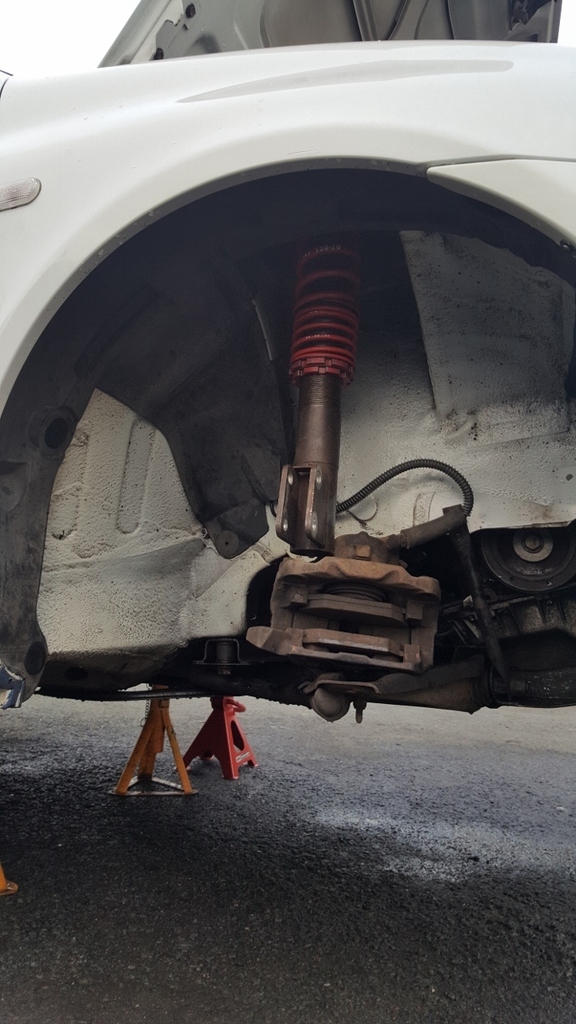

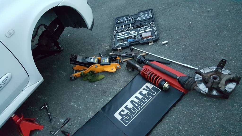

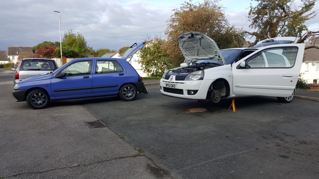

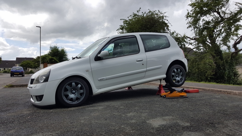

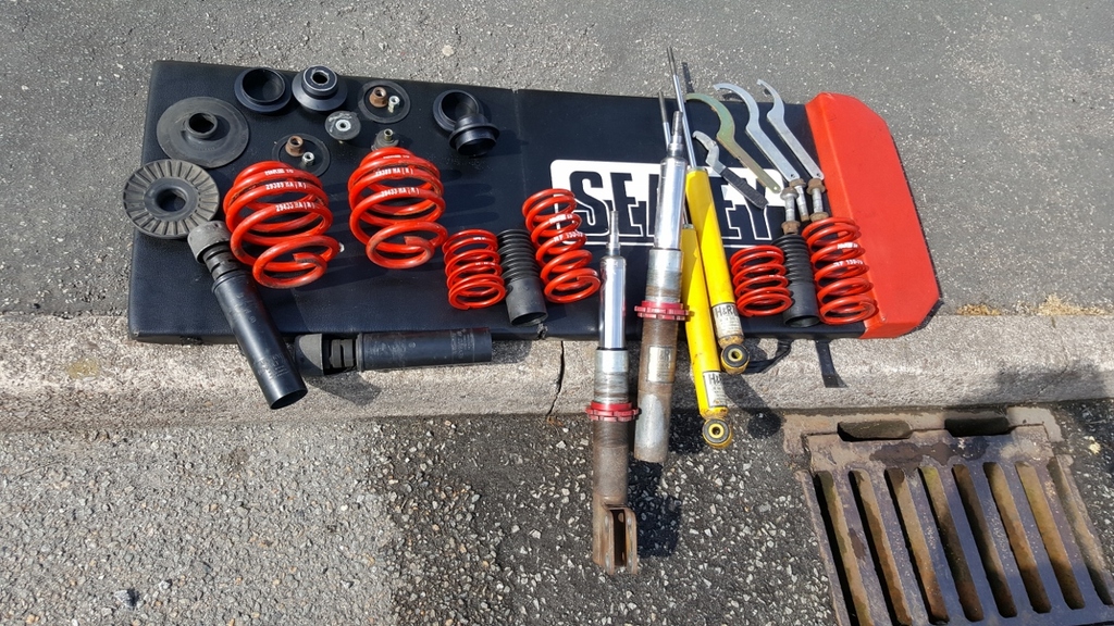

Now this is where things tend to go downhill… Starting removing the KTEC Coilovers...

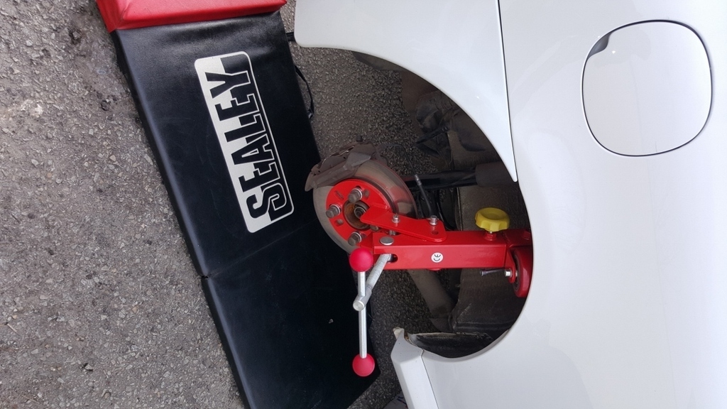

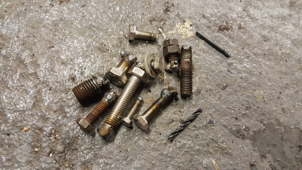

The bottom bolts had seized solid on one side. Lump hammering, impact gun, or the breaker bar wouldn’t turn or move them at all

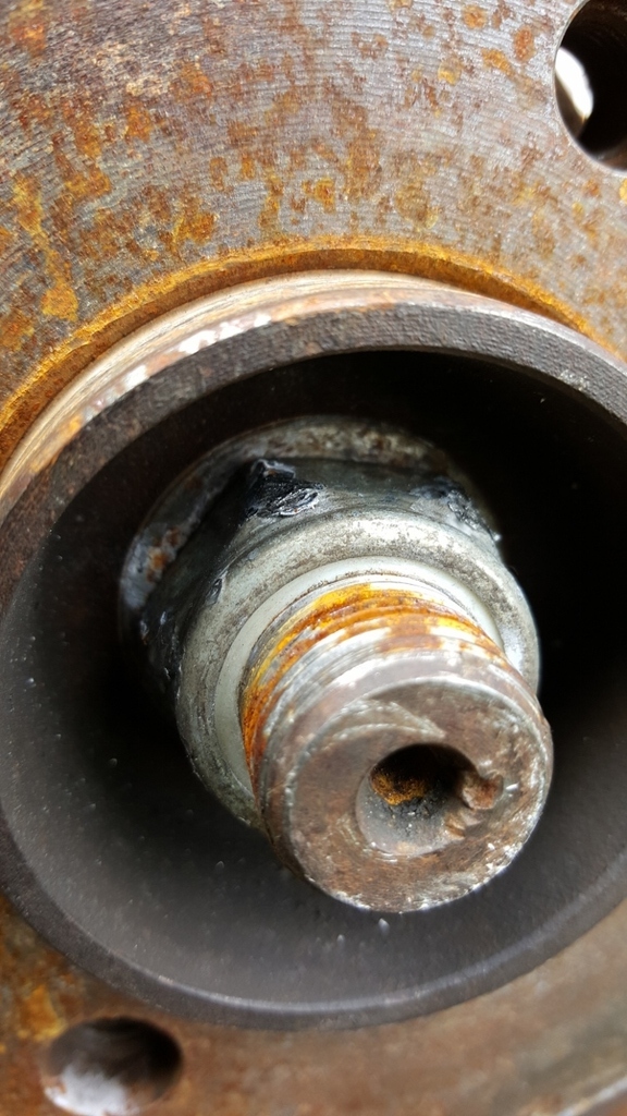

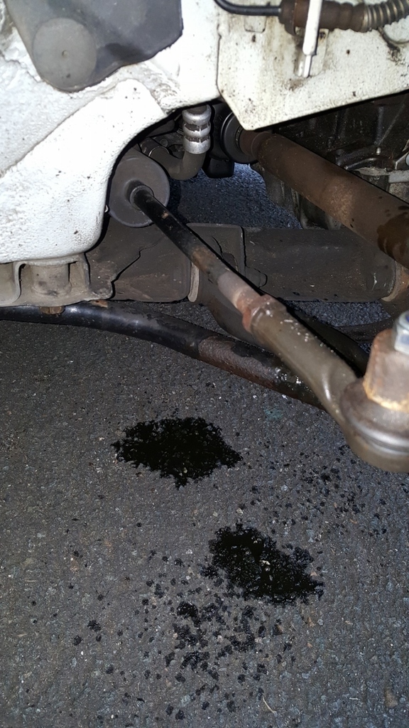

Undid the track rod to swing the hub out and face the bolts head on, and this happened undoing the thread. The end was also seized in?!
This was on a Sunday afternoon, and every parts place was closed and I had no steering or time to get it sorted..

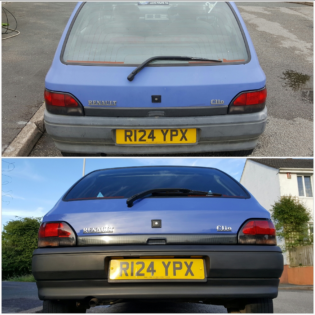

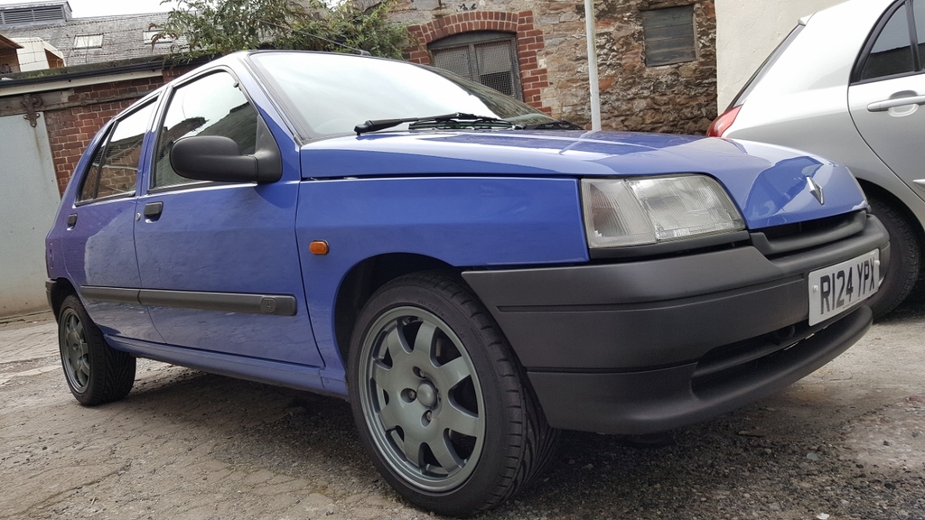

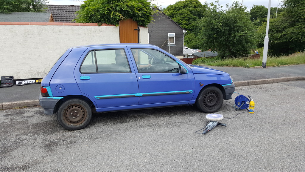

So that evening, I went and bought a faithful workhorse to runaround in that would double up for tip runs :stig:
Later on down the line gave it some machine cutting, new £3 wheel trims and fixed all the neglected bits and pieces to make it last a while

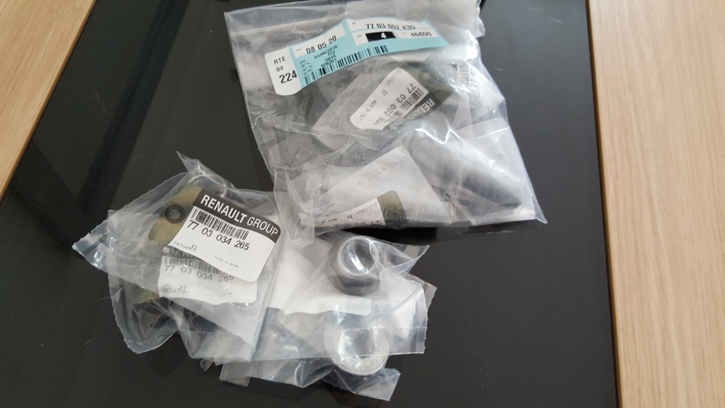

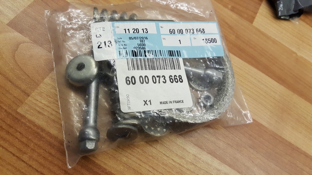

Ordered some new OE bolts to replace the scrappy seized camber ones

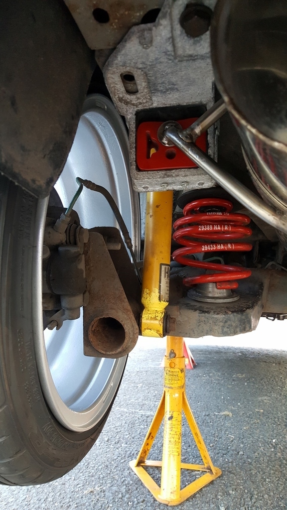

Fitted the rear H&R’s, nice and simple for a change!
Moving on to tidying the engine bay up a little

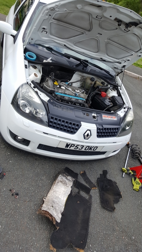

Removed the bulkhead sound deadening for a cleaner look, but does add a bit of noise!
New coolant bottle
New PS Cap and Washer Fluid Cap… still unsure on it’s look

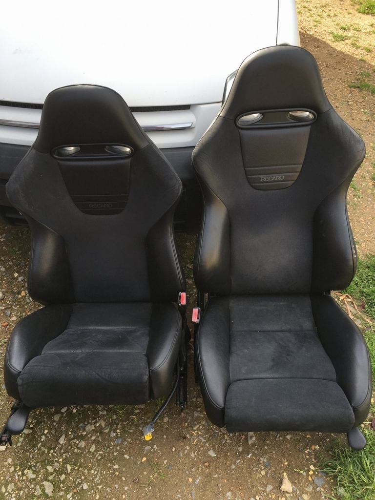

Went for a bit of “luxury” with a low mileage thicker pile 182 carpet to replace the cigarette burned and poverty spec Cup carpet. It cleaned up very well!
Repainted the black sections for seat mountings

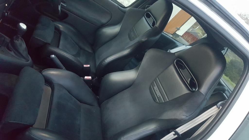

Trophy Trendlines came up “cheap” due to needing a small repair which I’ll look into later on
182 fronts sold to @ADS_V6 and Recaro frames hoovered and wiped down

Manifold gasket in good order, new OE gasket kit, and another new lambda as I only changed one last time

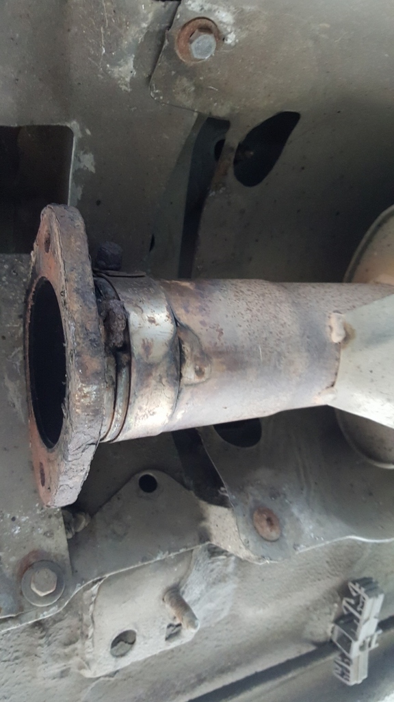

182 Cat and old mid-section join chopped off and the cat sleeved for the mid-section to allow fitment to the 172 system and not having an olive joint
Used Demon Tweeks for the Jetex pipe / sleeve

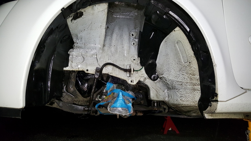

Subframe on it's way down

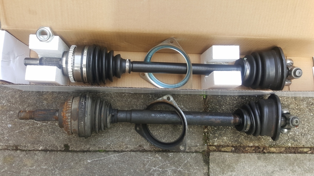

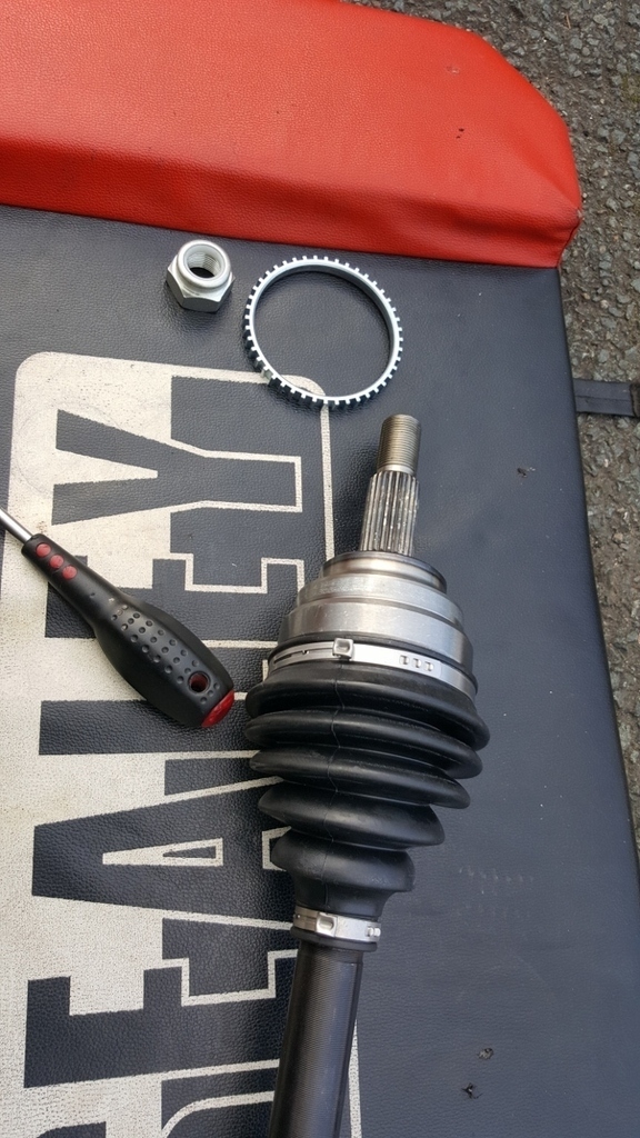

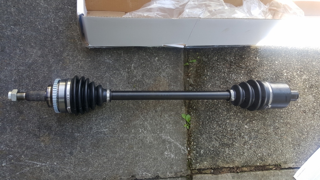

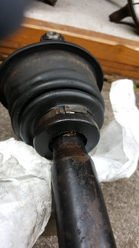

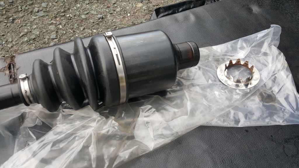

Replacement driveshaft as the bearing had started weeping gearbox oil
Hit a problem on the other side with the nut rounding.. So had to remove the whole lot
Also had to swap a wobbly circlip, and noticed the new shaft had a weight on when it shouldn't have...
Next was the problem of the replacement driveshaft not fitting the hub!
Tried a few things but ended up having to use my old snapped wheel bolt hub which mean’t removing the remaining wheel bolt threads…

182 Manifold / Centre Section matched up and sleeved to fit

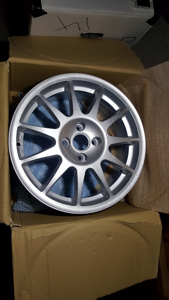

I asked a friend to do a photoshop for me of silver Turini’s, because it's a Cup afterall...
Before and after:
So instead of painting over mine, did a deal with @bangybear and swapped for these…
Cheerio to anthracite…

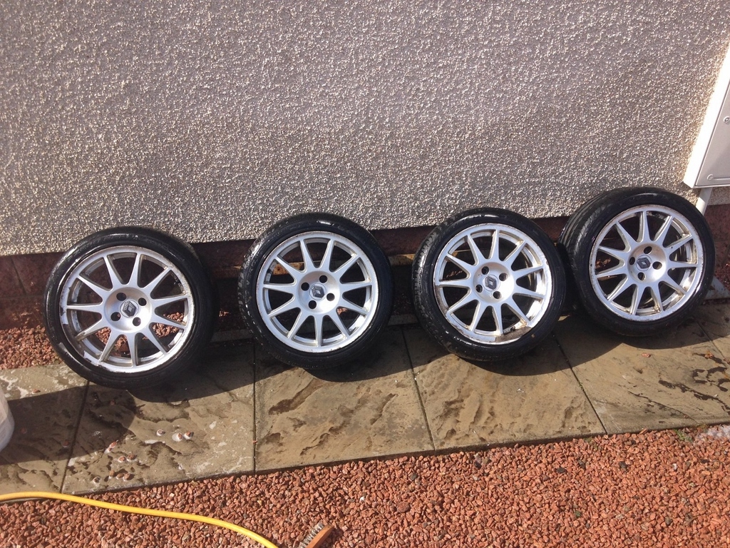

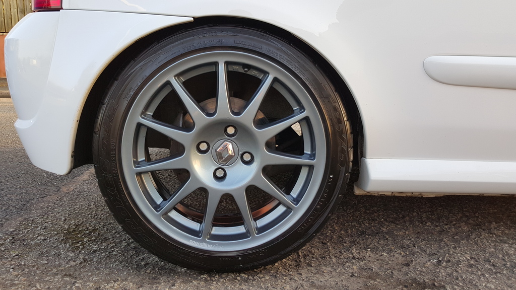

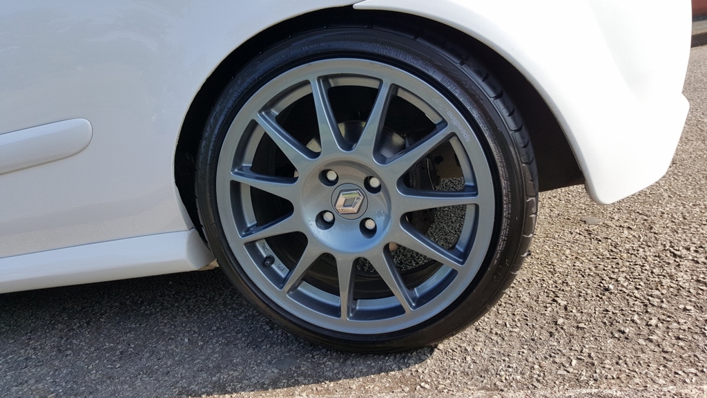

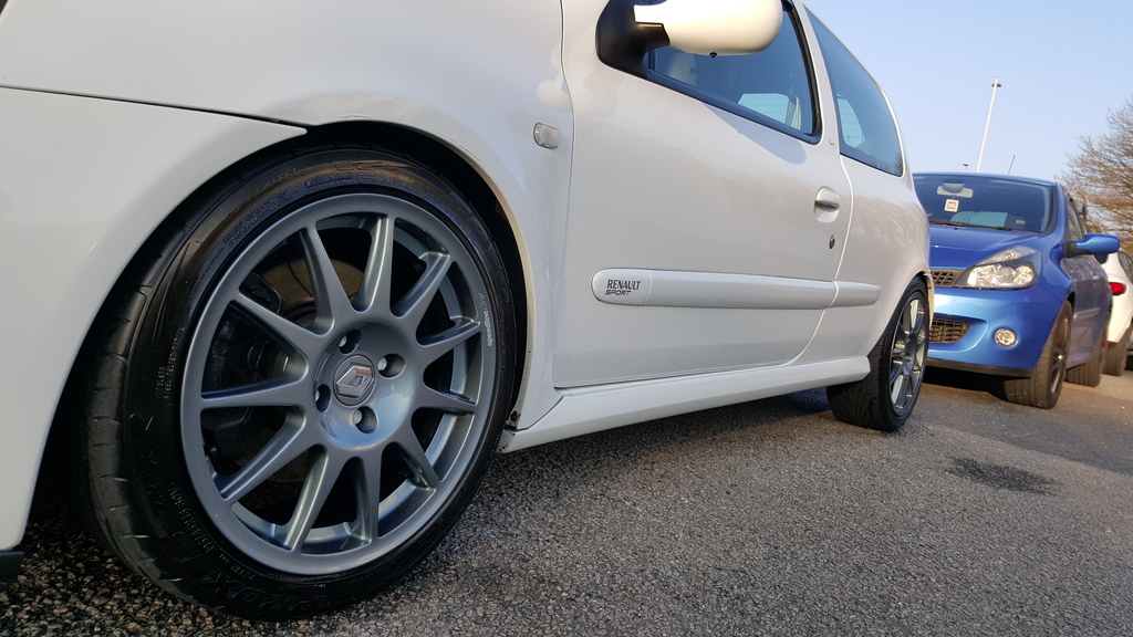

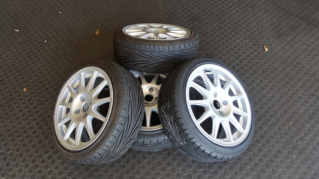

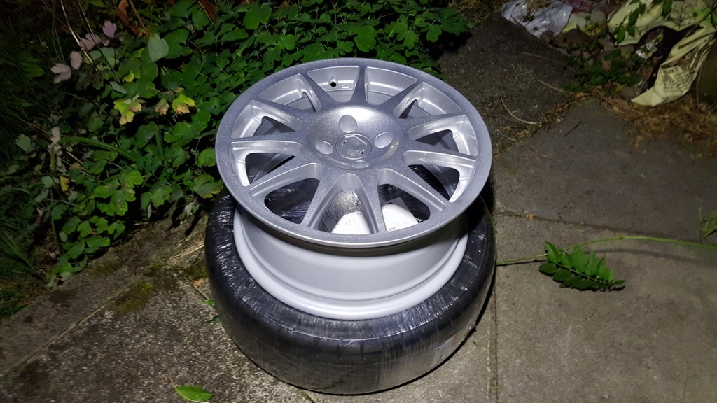

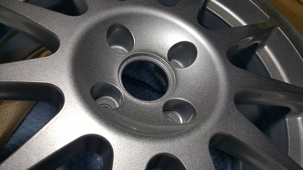

Turini’s back from the refinishers, powder coated bright / high sparkle silver! They look ridiculously bright and flecky with the flash on, but I’m liking them a lot as they look so fresh :cool:

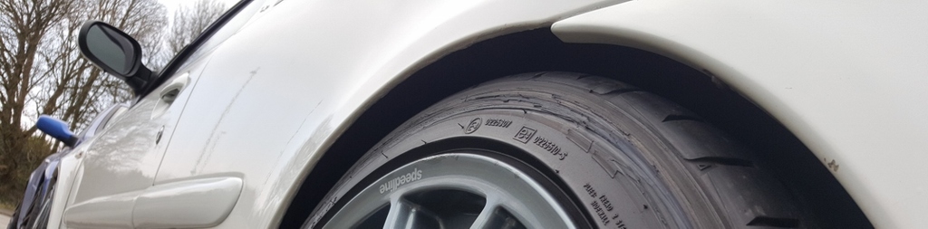

Went for some new 40 profile tyres (trialed two on the rear before the anthracite ones sold), and then a Hunter wheel alignment due to the new parts

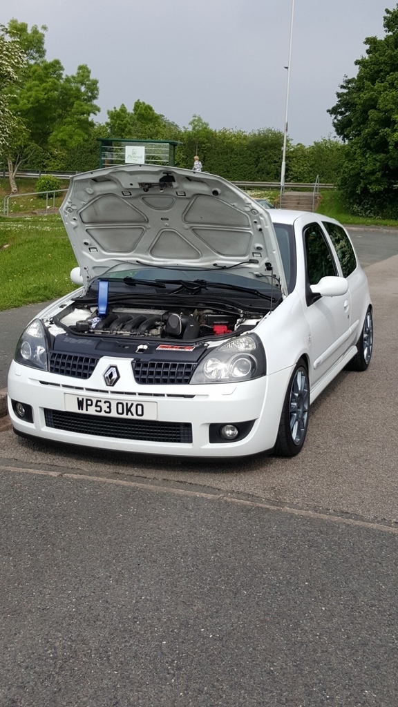

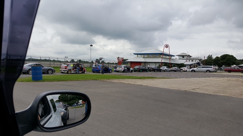

Then it was off to a Castle Combe track day… :hearteyes:
5AM Start!
Noise checked and ready for my first track session
Couple of other RS cars
Hot afternoon temperatures pushing the car made the tyres suffer a fair bit!
And a few track pics from the photographer guy John Gaisford :up:
It was a really really great day, the car didn’t use a drop of oil and performed surprisingly well against what I used to think were far superior and quicker cars!

A heat shield, genuine item off the lesser model Clio’s, New Coolant Cap and Powdercoated Fuel Rail Guard

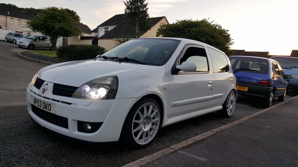

5000K Xenon Bulbs as I felt the 6000K were almost a bit too blue against the white paint

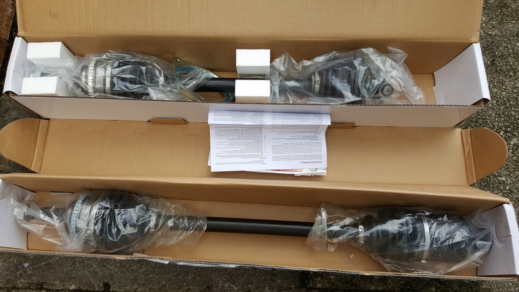

Checked the replacement driveshaft as it had already started knocking, which proved to be badly spitting grease on my new wheels! :triumph:
This time instead of wasting time on second hand “very good and checked” items I went for some J&R shafts
IMO are not to be sniffed at for the price, and work well on the Cup / non two piece drivers shaft set up.
@imprezaworks can verify he is still alive lol 😂

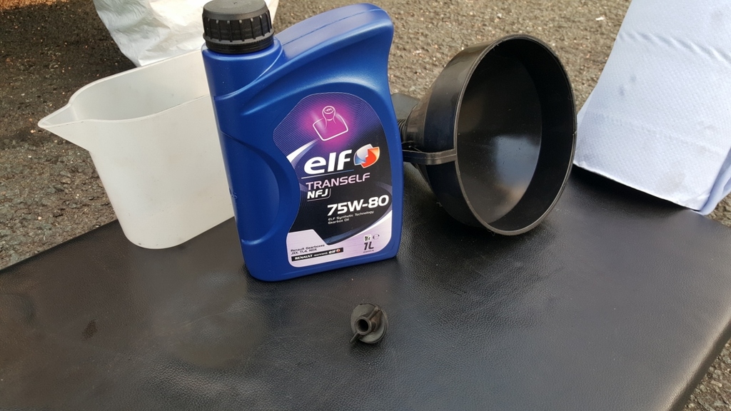

Gearbox oil replaced with yet another sealing washer
ABS rings sacked off and new shafts fitted
Another alignment check

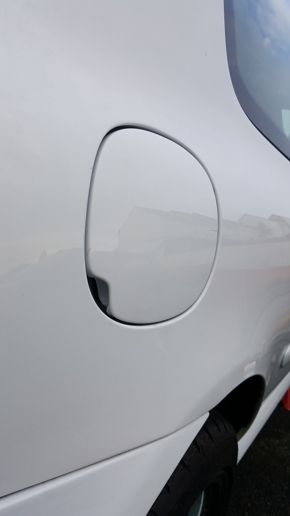

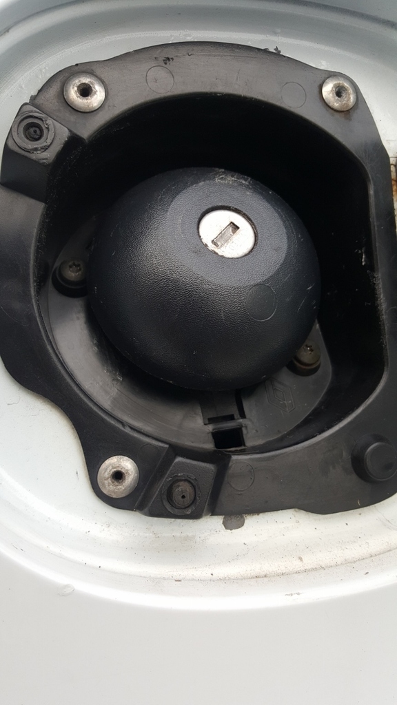

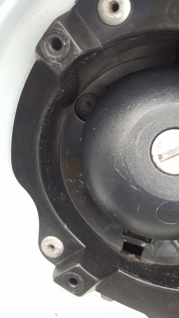

Replacement scuttle plastic clips, petrol cap rubber stoppers so it sits correctly again, and some non rusty screws

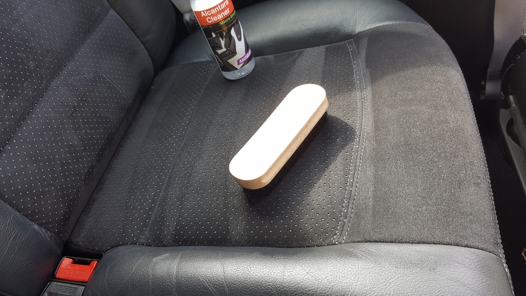

Tried out some Razeglaze Alcantara Cleaner on the filthy seats and some other polished bliss bits
Recommendation of @ADS_V6 fantastic products all round! :up:
Swapped a scratched boot plastic with a spare, so re-cut another second boot light hole again

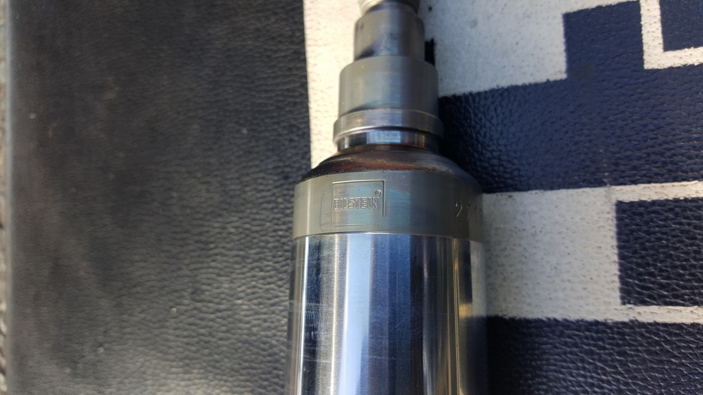

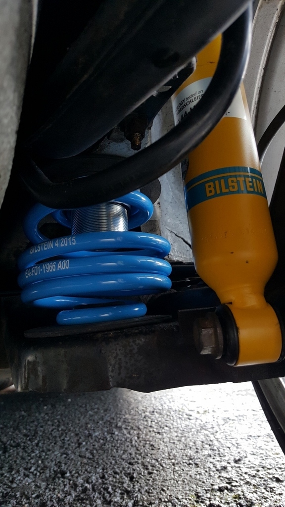

To make life easier I thought to raise the suspension up, only to find one of the front coilovers leaking all over the floor 😧
Off they came and sent off to Cornering Force for a rebuild
Almost two months later… the car was still like this
The shocks needed parts from Bilstein direct, which proved costly both in time and money

By this point, after what felt like countless failed second hand parts and weeks of wasted time and probably royally annoying the neighbours having to see the car on axle stands…
I opted to just bite the bullet and go for these… and I’m so glad I did :hearteyes: Thanks to @Bobby5
Spoke to Nick @pure-motorsport and he sent me out some washers to sort allow the fitment of the top mounts and got them assembled
