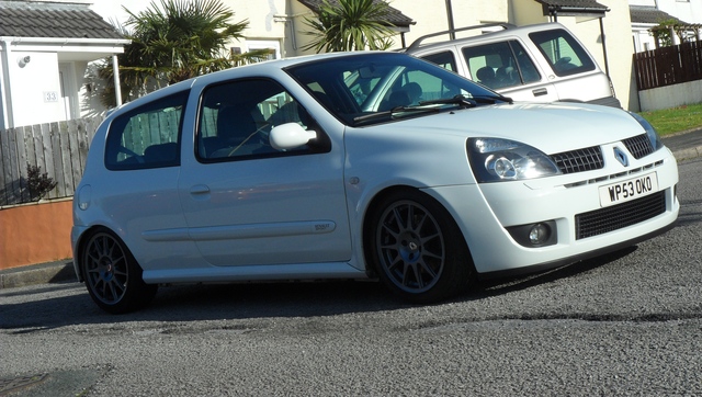

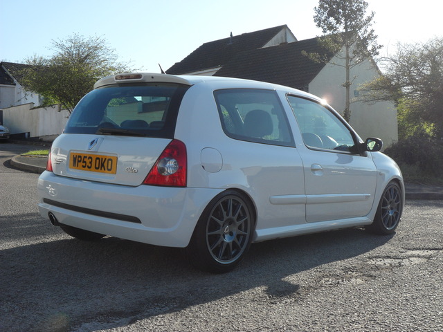

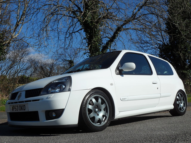

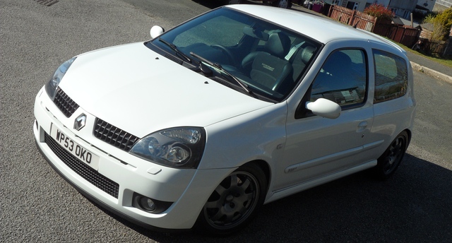

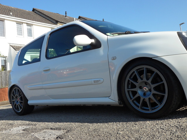

I love this car, it's perfect in white.
Anth Turinis for me personally!
Coming on leaps and bounds!

Just read the lot from the start, lovely Clio; never thought white would work but it does.... stunner.
White is still my favourite colour on these, then LY and RB, obviously a little biased ha
I think it was always going to be anthracite with the Turinis :smile: may have to pull my finger out and get them done before summer!

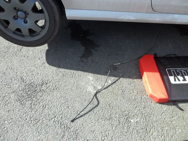

Awesome car mate! Just seen that camber gauge you have, that's badass How much are they? I need to set my fronts up but can't see me spending a lot for a one time application.
They aren't expensive pal, simple design, just a sprit level bubble so I used it to get it as good as I could before driving it and spent time double checking. When I got the alignments done I couldnt believe how accurate it was on a digital laser type computer machine that protyre had. Brilliant. Gunson was the make, loads on eBay.

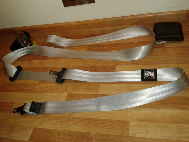

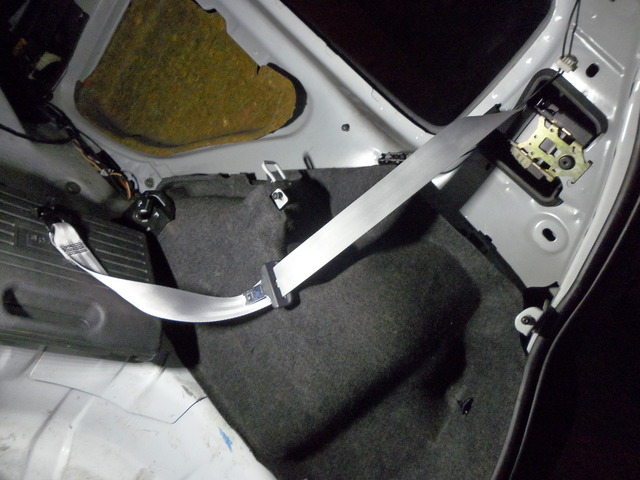

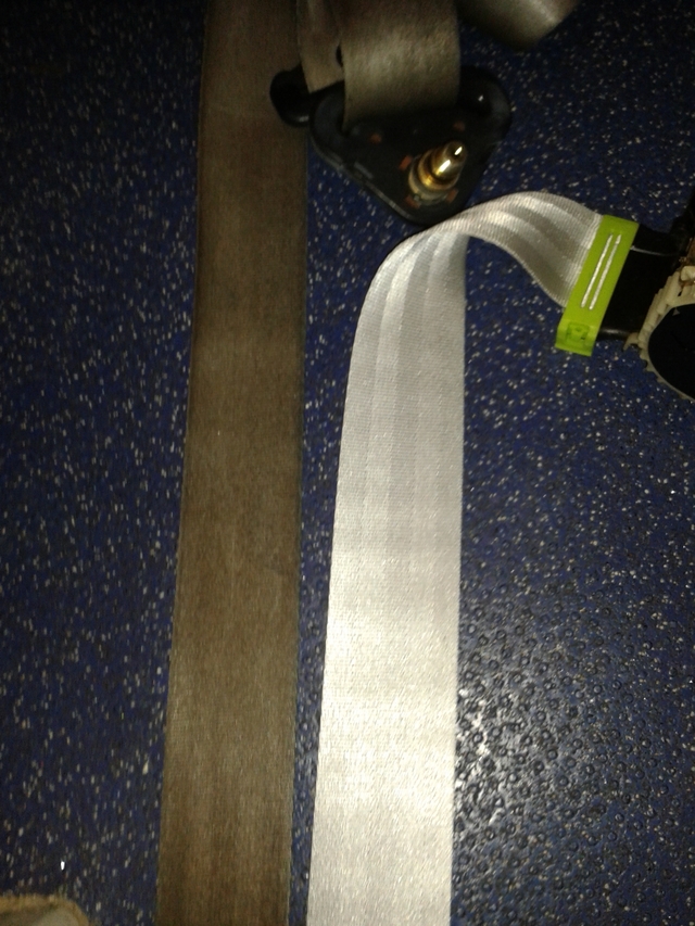

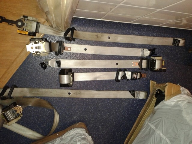

Silver 182 Belts..
The difference fully extended!

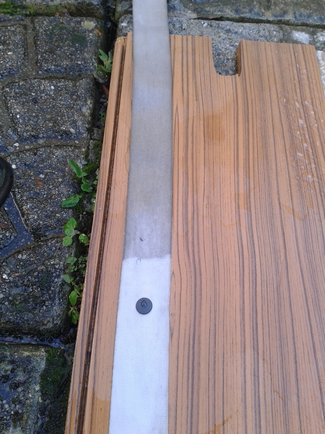

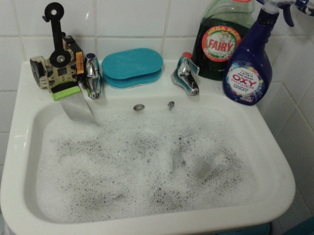

Hot water and soap etc didn't touch them.. so opted for the power washer which gave instant results! (See 50/50)
Dried.. Boom!

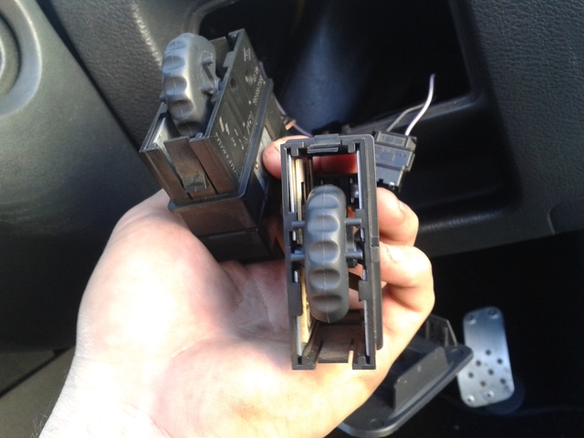

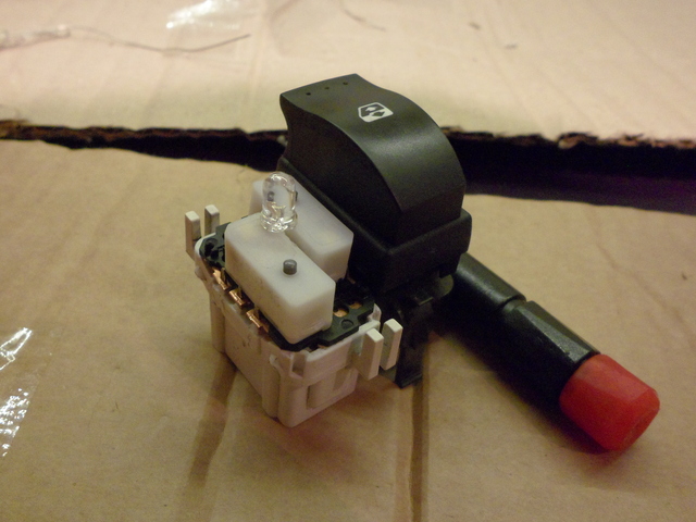

Working dimmer switch courtesy of @Dr Jekyll top bloke!

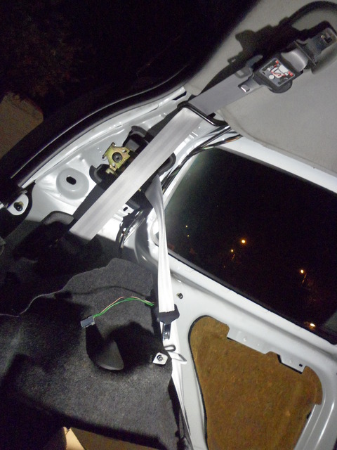

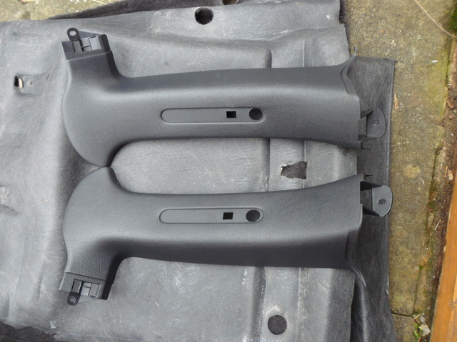

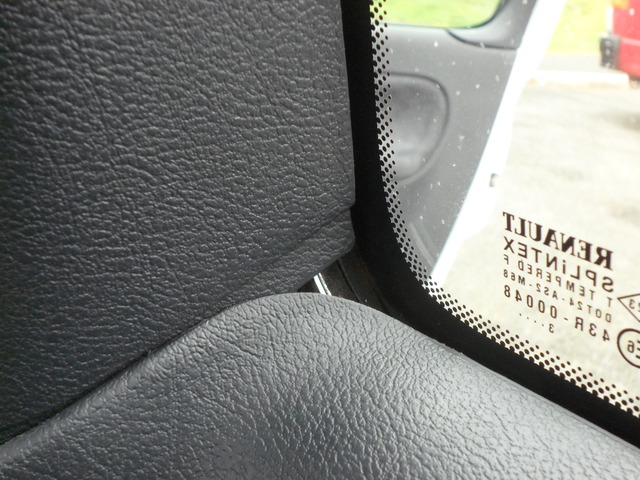

B Pillar Trims to match the new interior as 172/182 seem to vary?
Replaced the pretensioners with better condition ones (replacement top, original bottom)

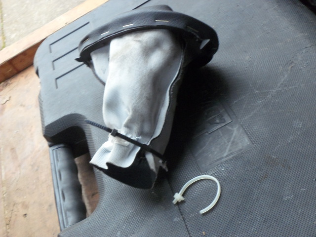

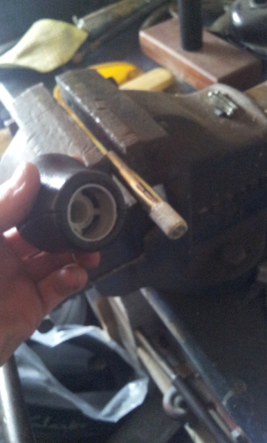

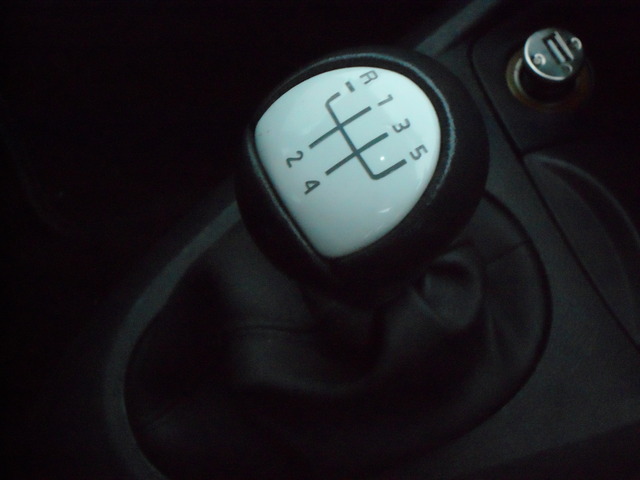

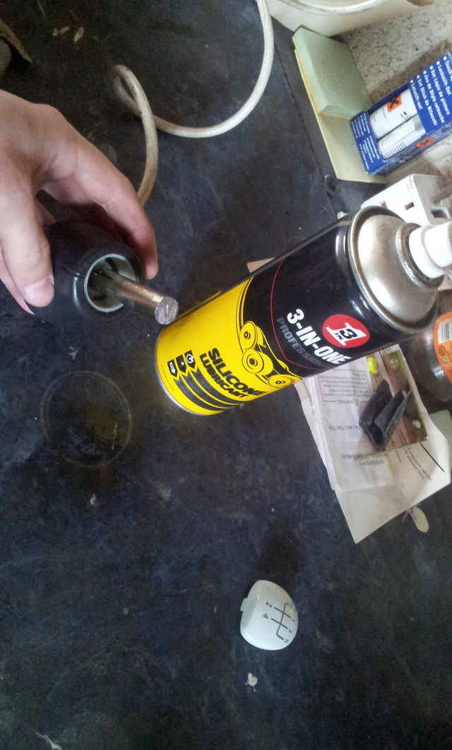

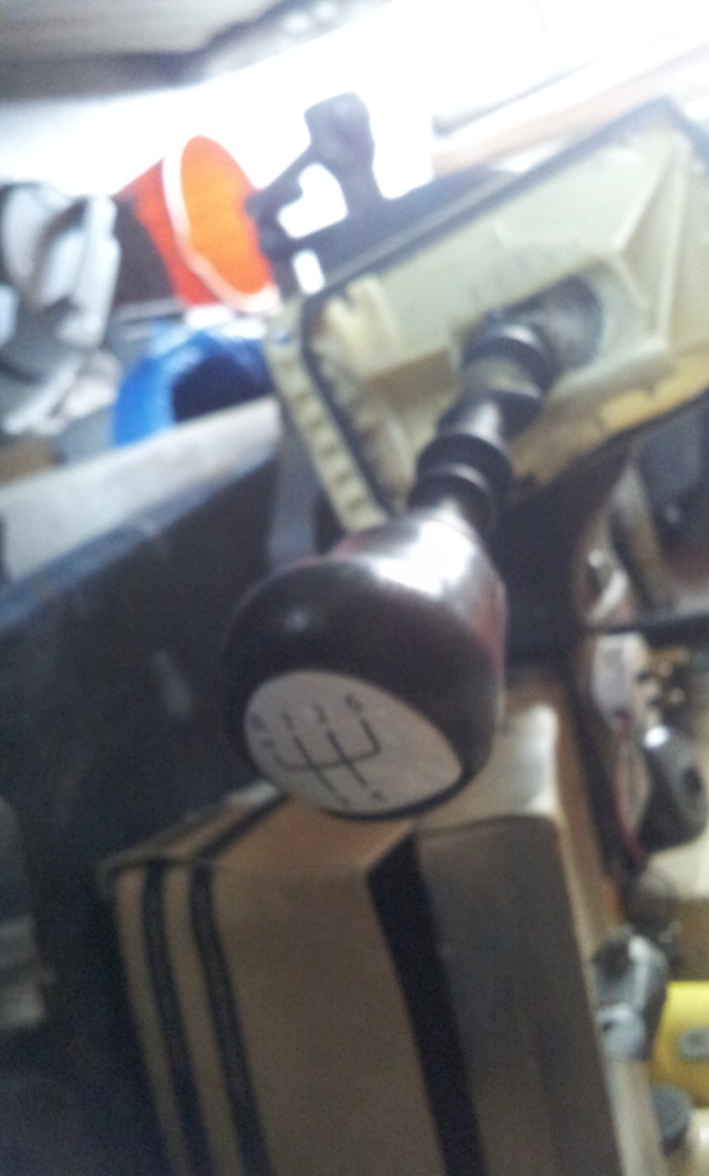

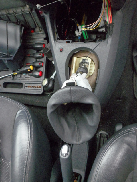

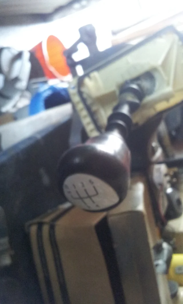

Immaculate 182 gearknob and gaiter, Renault really did know how to put them on, ended up sawing it off then mole grips to pull the bar out after lubing it!

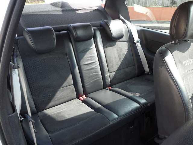

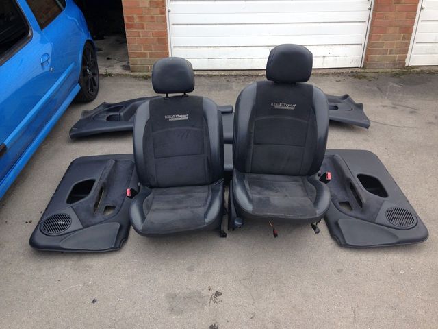

Next up.. assembling the interior again after selling my PH1 setup

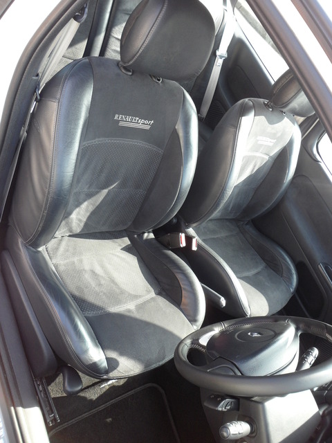

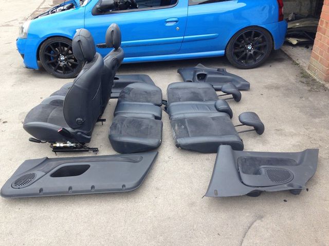

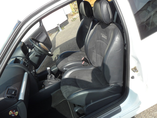

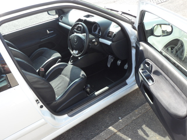

Drove to Wales for this bargain, immaculate, 182 interior after being a bit sceptical from the photos :)

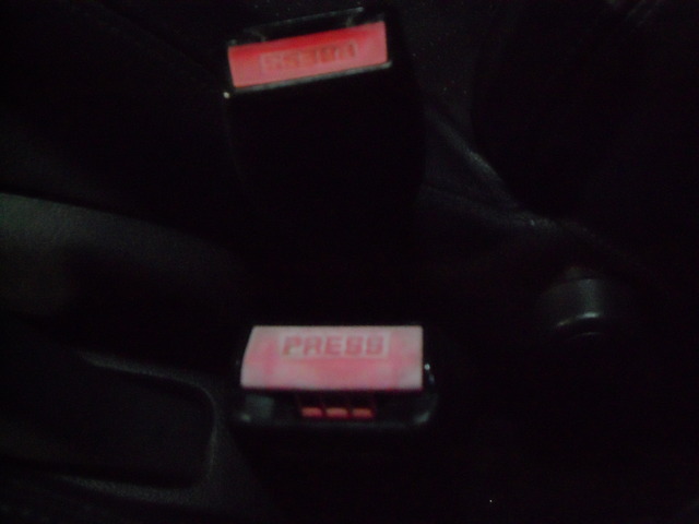

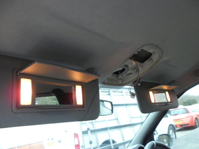

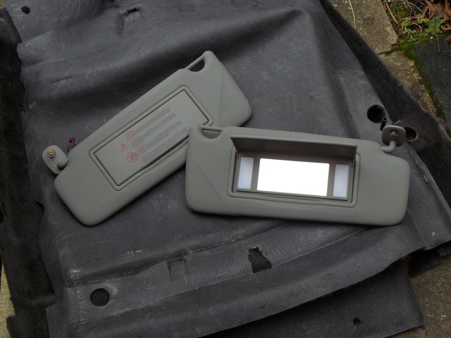

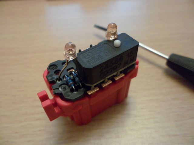

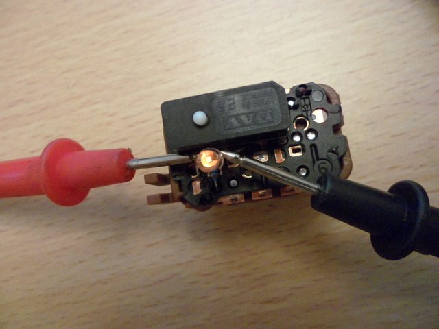

Nice little touch, illuminated sunvisors, wired them off an ignition live

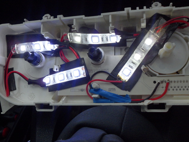

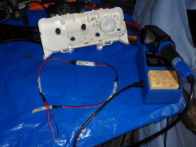

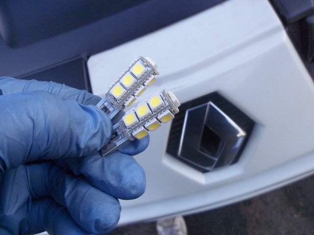

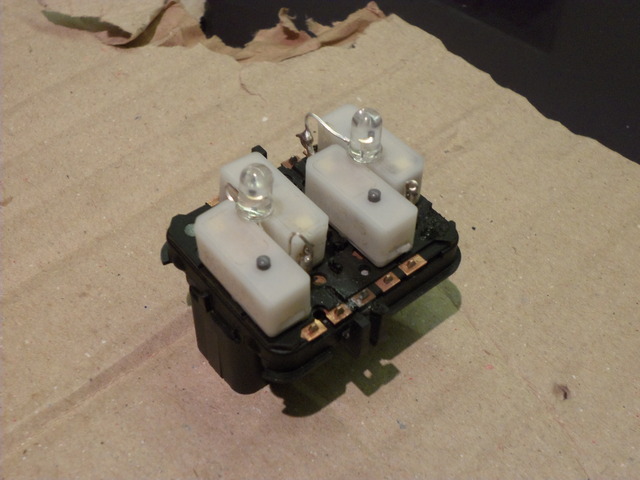

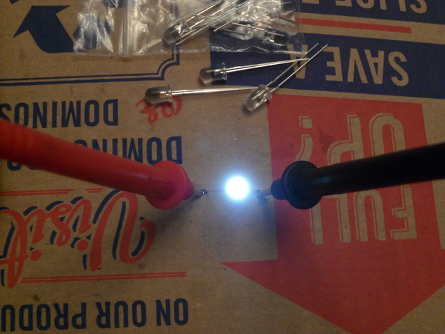

Ordered up a load of LED's to finish the interior conversion

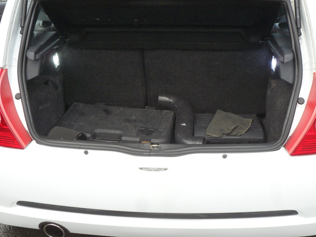

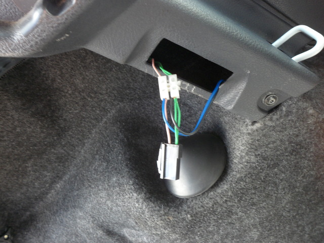

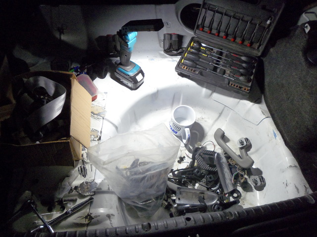

Moving to the rear, twin boot light..

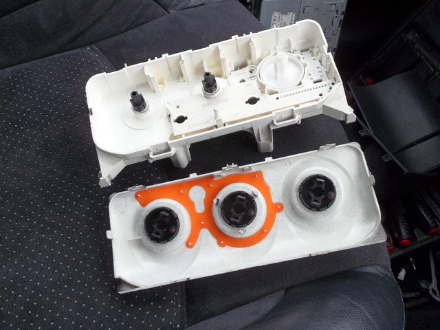

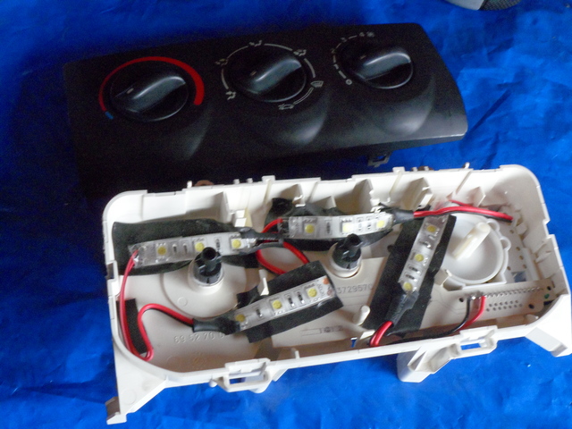

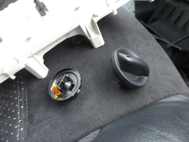

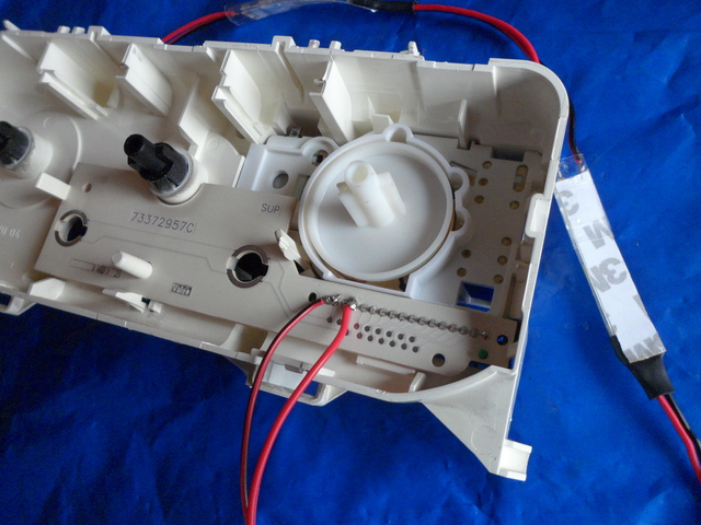

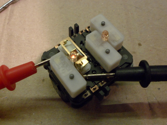

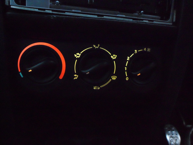

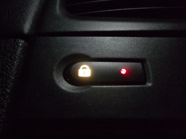

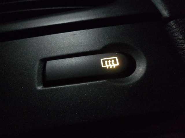

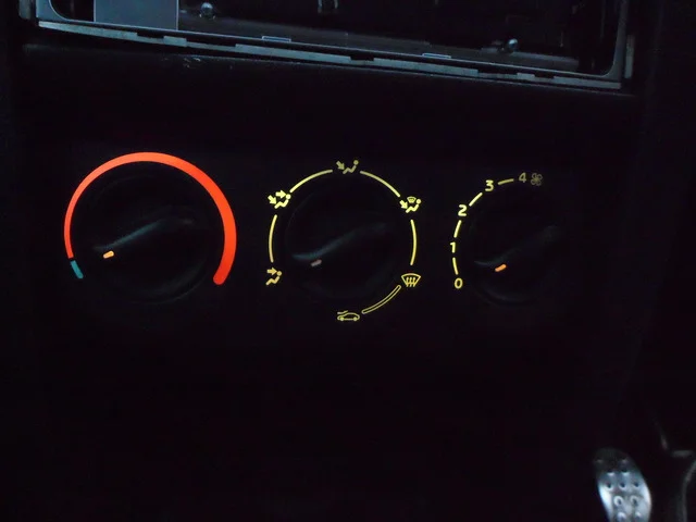

Heater controls... have been putting this off... removed the orange bits where possible

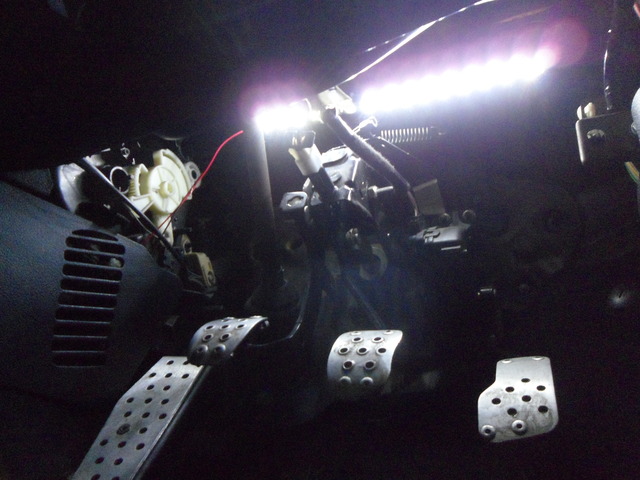

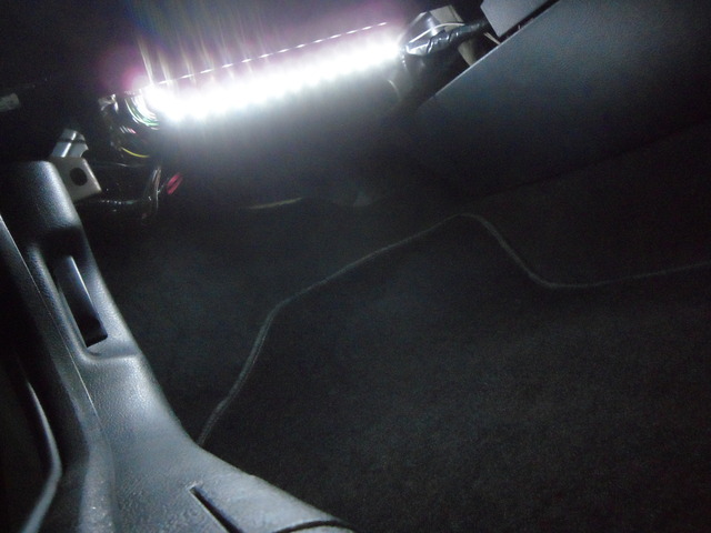

Footwell lighting, wired off the interior light so they fade out once the cars started

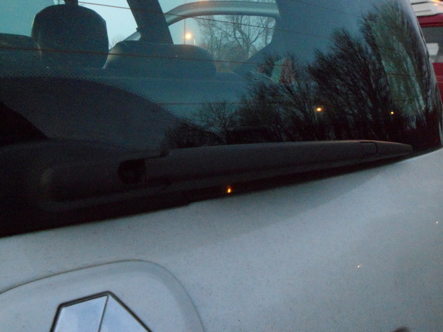

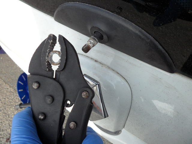

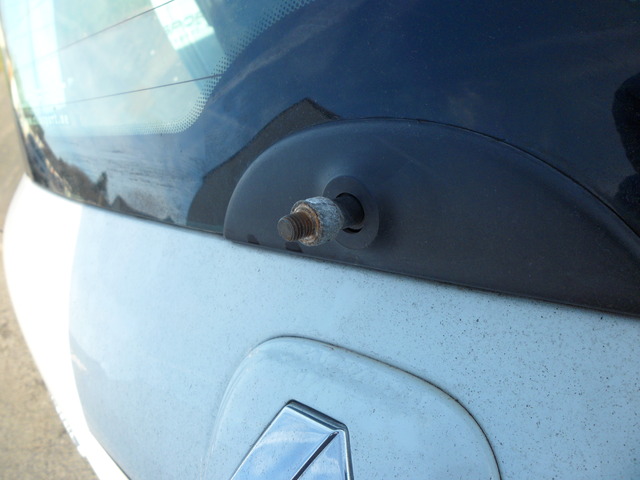

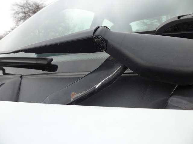

Replaced the rear wiper arm as it seized after washing and broke off

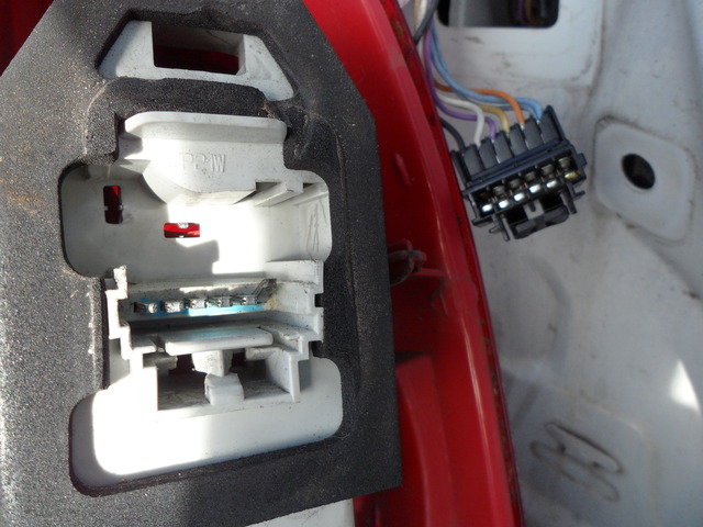

Found a permanent fix for the rear fog light illuminating when you brake, tried new bulb holders, cleaned up the connections, but bending the earth pin worked a treat... ignore the old dial colour photo... It's been doing it for a while!

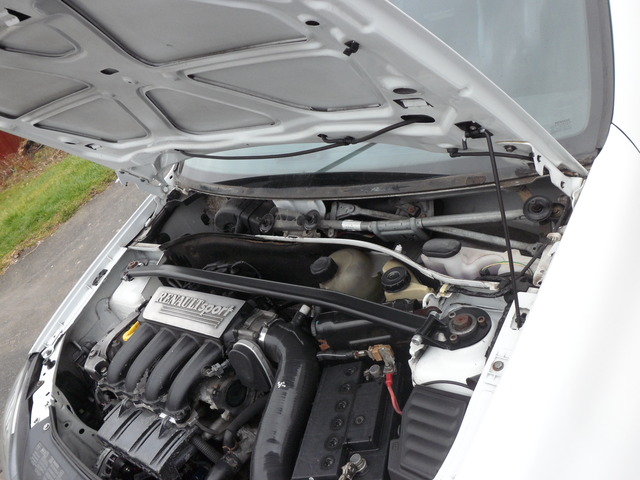

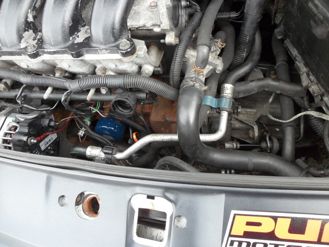

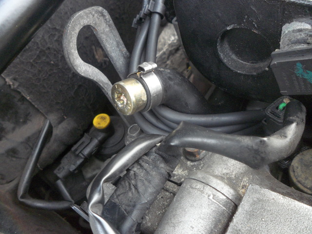

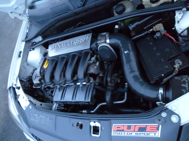

Deleted the charcoal box pipes

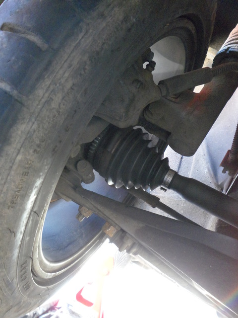

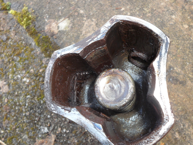

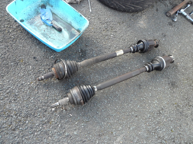

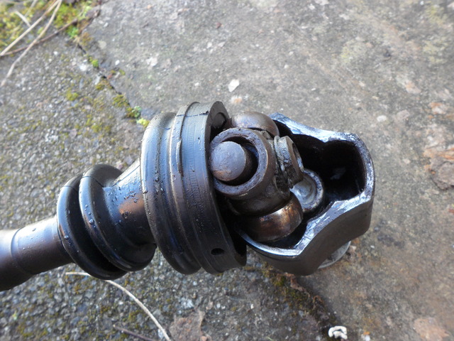

After all this, my driveshaft made me feel like the world was about to end...
Thanks to ALS Performance Parts for a decent replacement (Bottom)

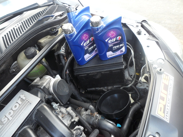

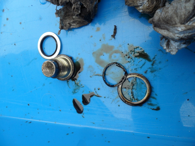

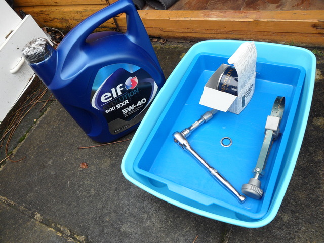

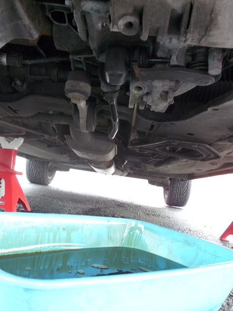

Good excuse for a major service, right?

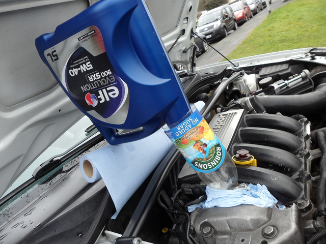

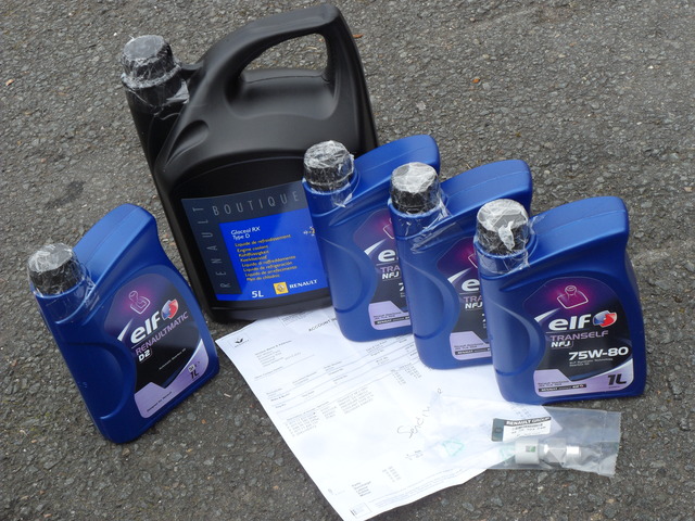

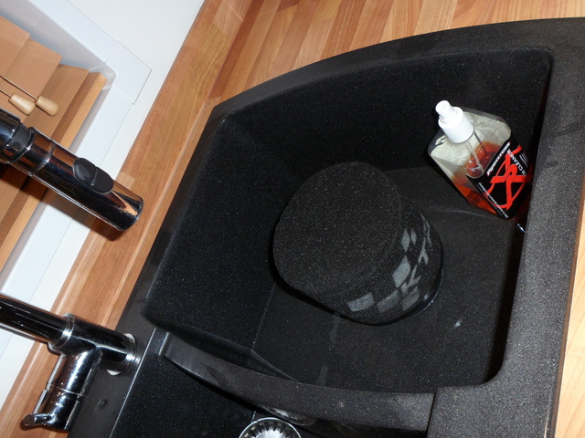

Renault ELF SXR, Washer, Filter, Ghetto Funnel

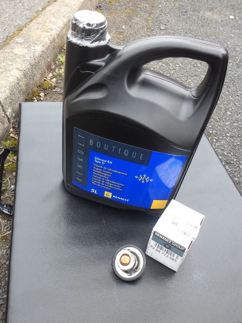

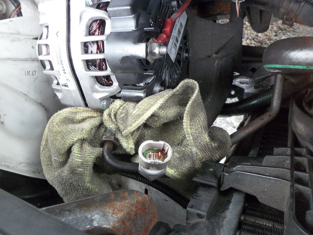

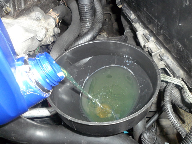

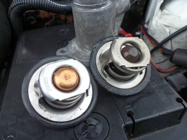

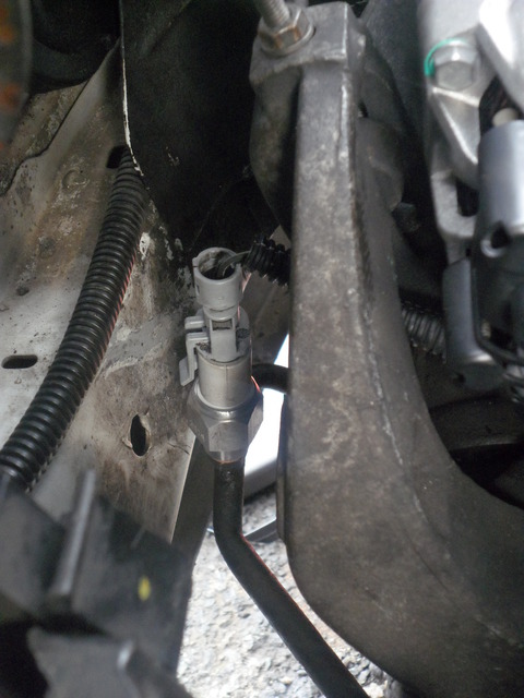

Renault Type D Coolant and Thermostat as its been dropping temps on open roads
Thanks again to @Renault Wolverhampton for all his hard work getting everything to me

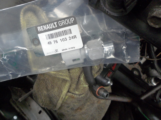

Renault Elf Box Oil, PS Fluid, Sensor and more Type D as it takes more than 5l

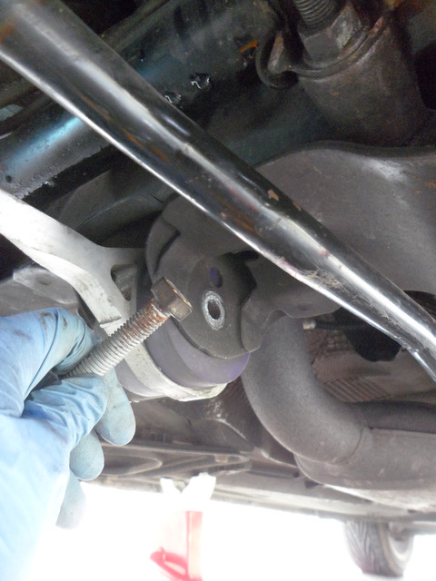

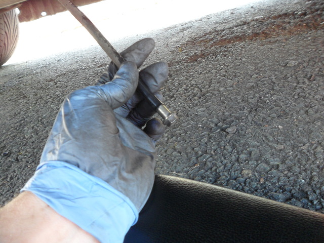

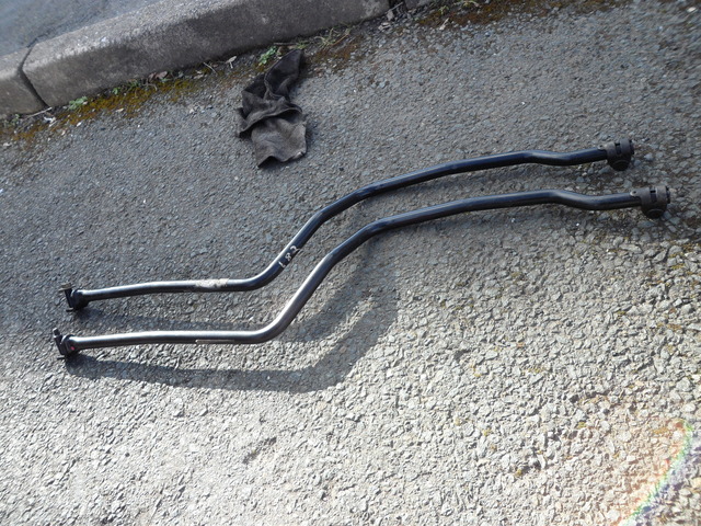

Replaced the linkage bar as mine got dinked, and reversed the dogbone bolt as it knocked in neutral

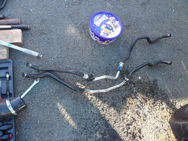

Replaced the low pressure PS pipe for a non perished one with brackets, replaced the high pressure Renault PS sensor as mine started leaking, cleaned the filter and some Renault PS fluid

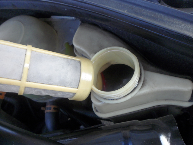

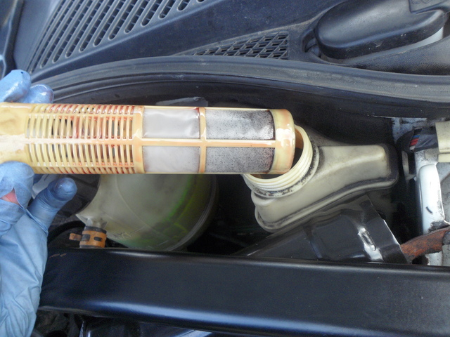

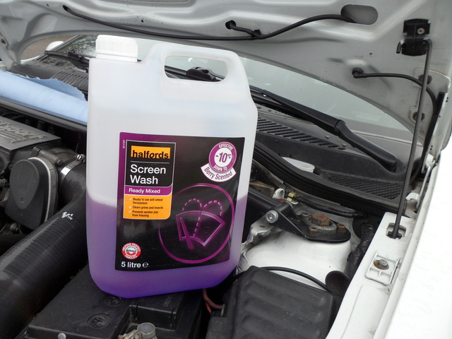

Also a good excuse to clean the KTR Filter again and more berry screen wash :D
Done! Thanks to @MrTom for the Fuel Rail Guard.. to be repainted with inlet in due course

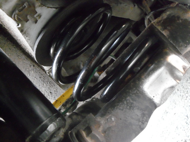

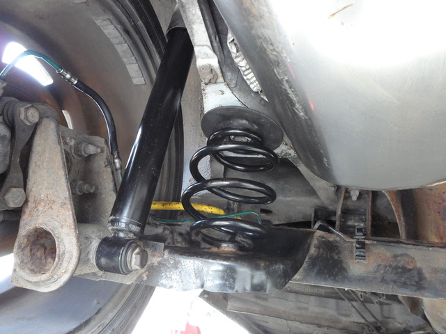

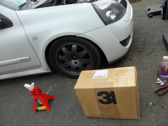

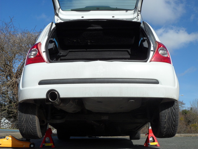

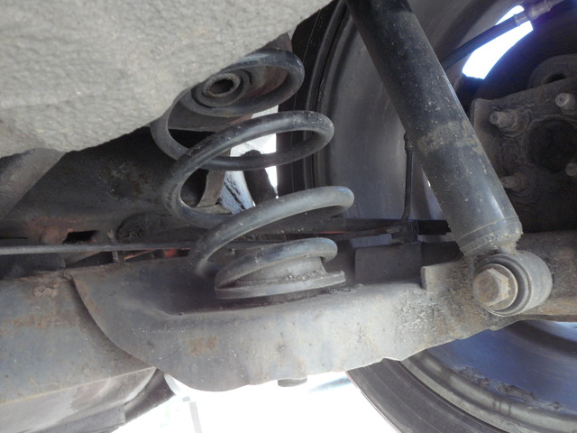

Moving to the rear of the car next, removed the adjusters as the rear sat too high IMO and cleaned things up

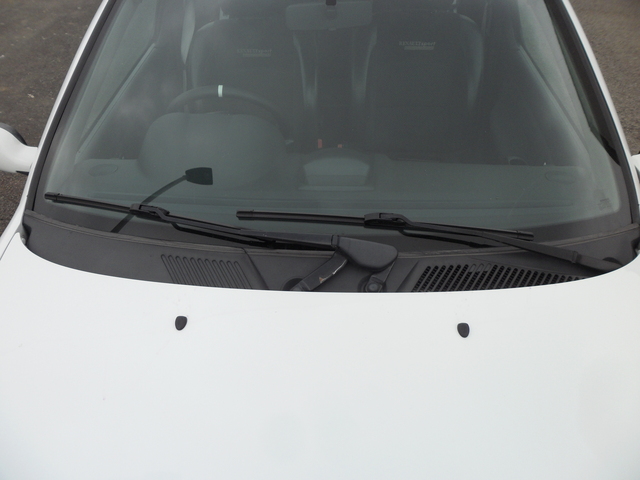

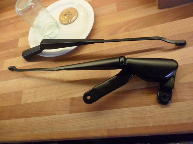

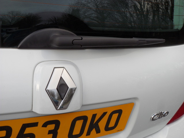

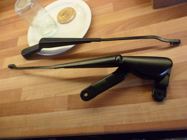

Thanks to @KitsonRis for these refurbished wiper arms, really make a noticeable difference paired with some Auto Finesse Revive on the scuttle!

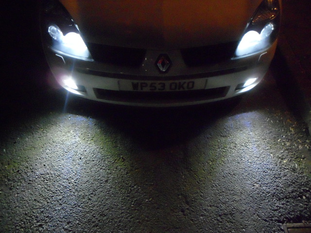

The best sidelights I could find

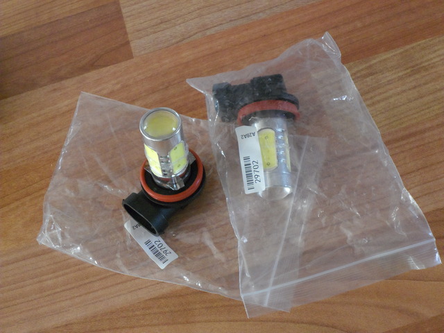

Paired with some ridiculous foglight bulbs :D

Haven't seen this before Chris. Looks brilliant. Careful when deleting the carbon canister as if the tank doesn't have a way of breathing it pressurises in the warmer weather.
:up: ta Graham!
The canister delete has been done for a long while, but the pipework has only been done properly for a few months now with no noticeable issues? I removed it all as the pipe had a nick in it by the wheel arch and the sensor gave up also, throwing up a constant fault code. I assume on hotter days it may give a petrol cap hiss potentially? Never seen anyone have an issue unless its not blanked in the event of a crash fuel may make its way out?

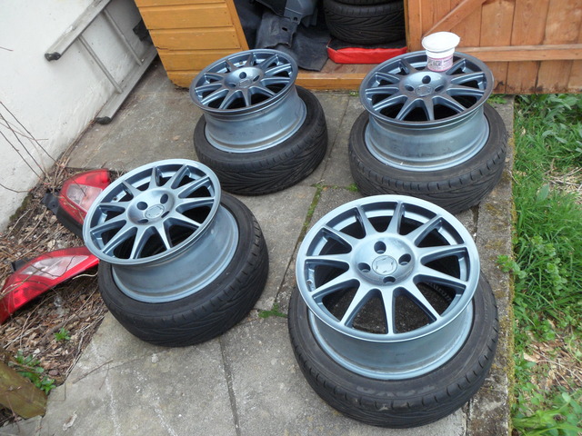

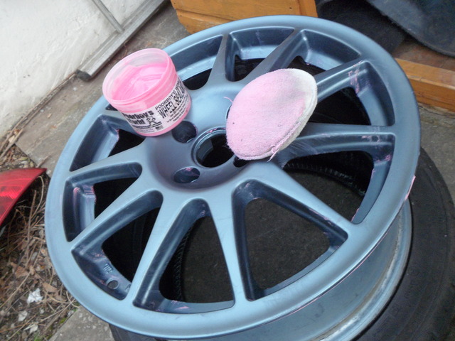

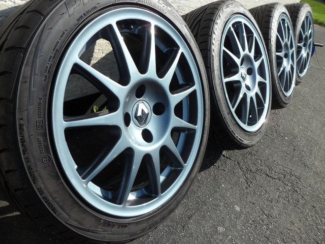

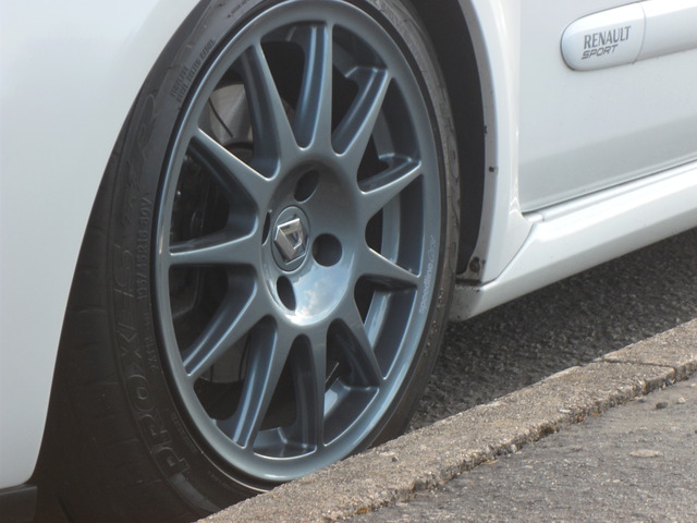

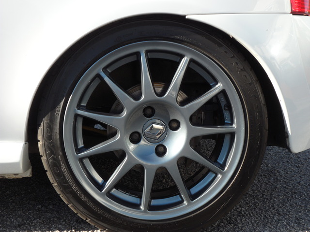

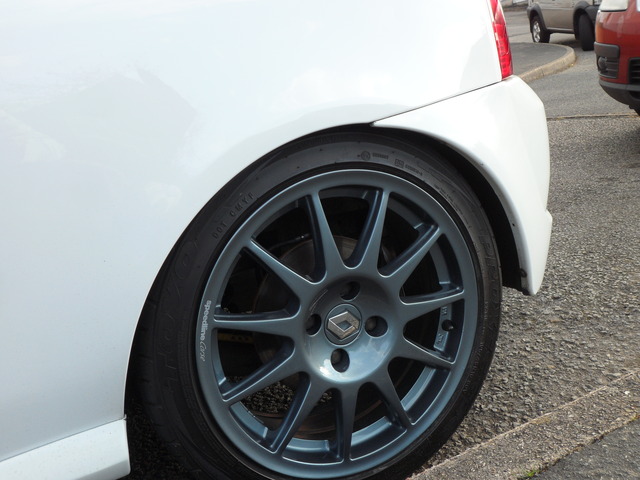

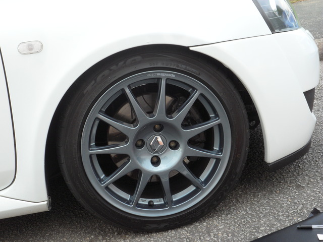

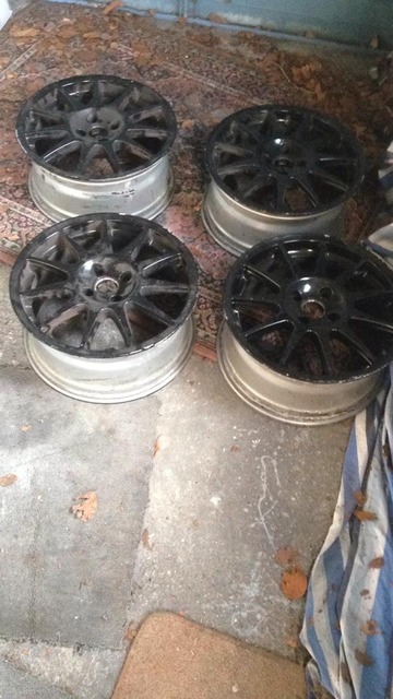

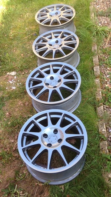

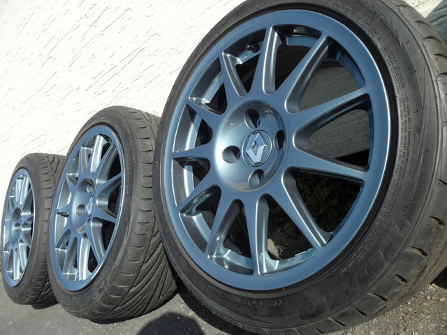

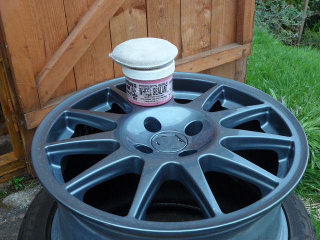

Dropped off the Turini's for a refresh.. They were looking tired and in black made them look a bit lost on this car
Painted in the same colour as the Williams alloys, HNR Stone Grey, and the insides blown over...
Prepped and sealed with some Poorboys, smelt like I could eat them !
195/45/16 Toyo Proxes T1R's slapped on!
Fitted...

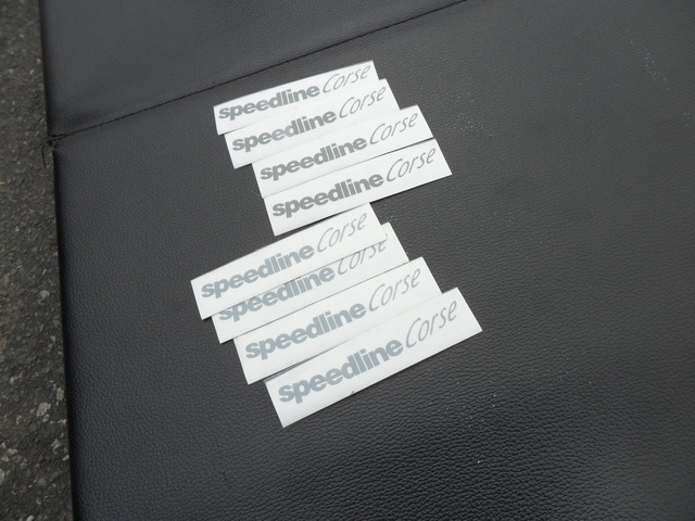

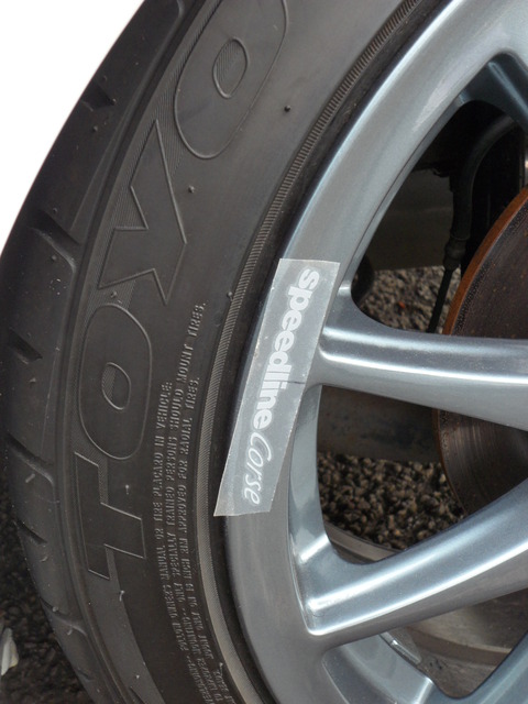

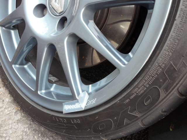

I umm'd and arr'd about the 'Speedline Corse' decals to achieve a more Trophy look... Silver vs Anthracite
Trialled the silver ones first... just to check they didn't look like flashing valve caps spinning around...
But the Silver won hands down...

they look very smart Chris...look so much better with turini's...and top work
Thanks mate, I love the colour combo of them

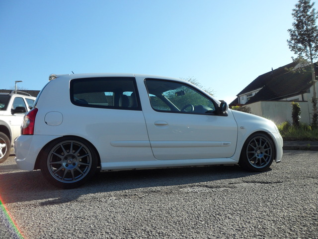

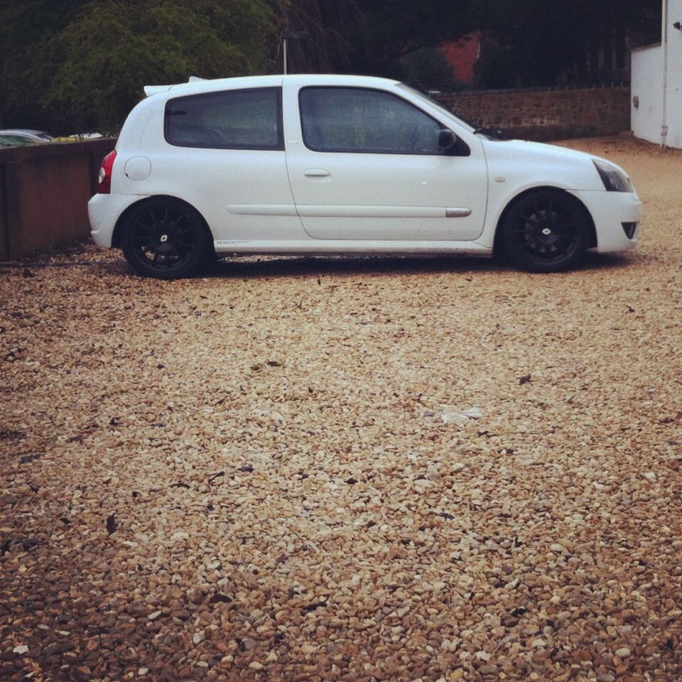

Looks a tadge too low imo though
:cool: nice one
I know what you mean, I haven't touched the front height but the rear I always found too high before, see the photos back a page when it was on Turini's in black, but unsure if it needs to come up a little bit again...
I love low cars though so dont see this stupidly low myself lol
