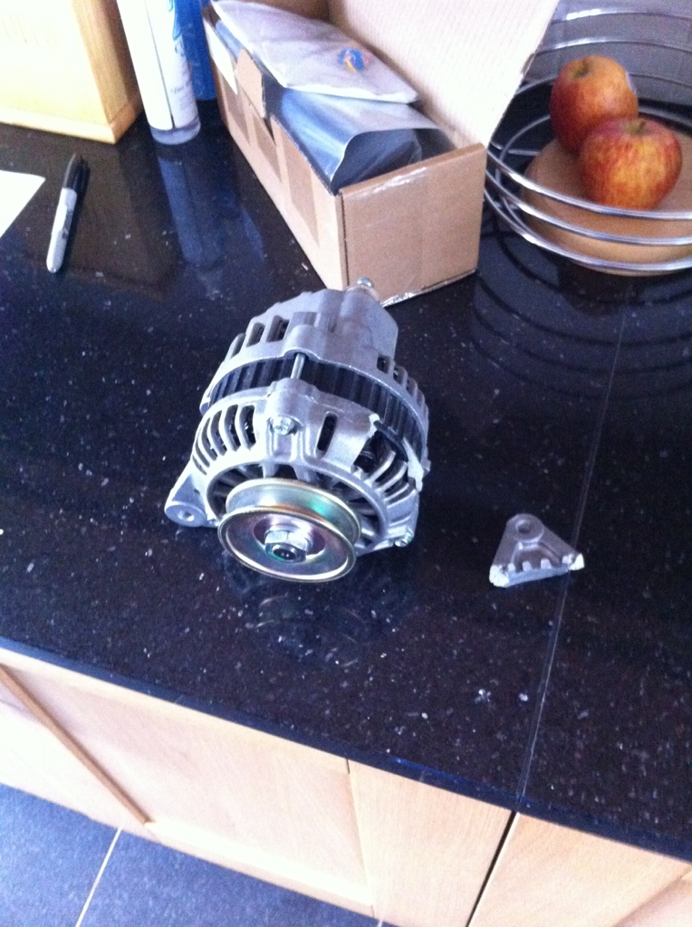

Probably a blessing in disguise, because I don't think there's anything up with the current alternator. Bloke I got it from on eBay was sound enough so a refund is due my way.
I do like this car - I had a nosey on pistonheads a while ago and most of them are too pimped for me.
Dude as I said on Fduk that alt don't even look like a fd alt... That pulley is defo wrong! How much u pay for it?
The pulley is wrong I know, but that's interchangeable. The mounting points were correct, but backwards, but it was listed as an FD one. £160, getting my money back and just chancing that my existing one isn't the problem when my belt comes.
It's probably the air pump, it makes an horrendous sound when the clutch engages/disengages.
160!!!!!!! Holy s**t!
I have rebuilt fd alternators for 20 quid lol!!! Also only paid 40 quid for a refurbed one lol
U got someone building it back up for u? Or u doing it? If you are on the rear housing where the brushes are... Slide them in then from the rear of the housing slide a pin through there to hold the brushes back... Then you can slide it back together easy.

I've not fixed it yet. Just waiting on some air pump blanks and I'm good to go. I've got new bearings in the alternator, some Dragon performance underdrive pulleys and a 5pk780 belt ready to eliminate the air pump though.

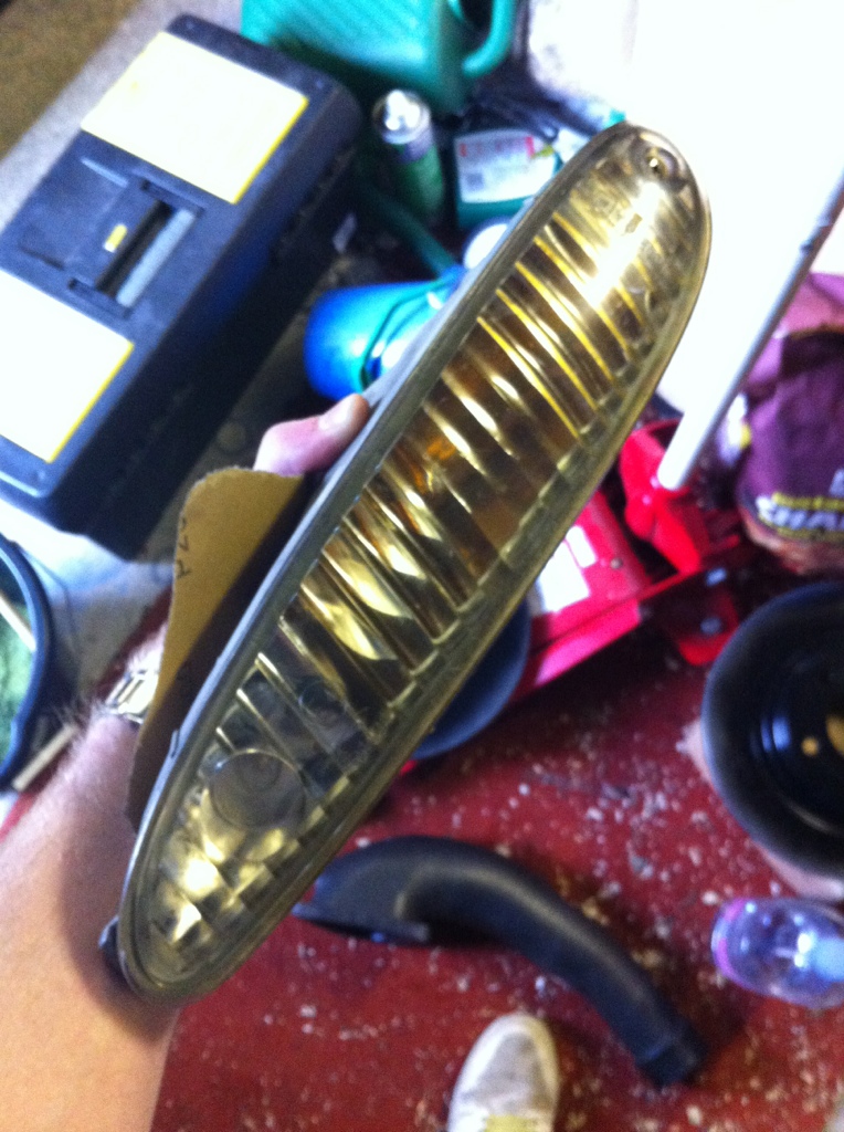

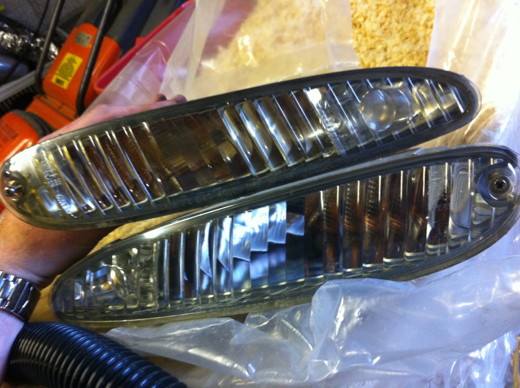

Whilst I'm waiting, I'd bought a few bits to tidy it up. Unfortunately, couriers love to break my s**t, but these sidelight/indicator units survived.
They were a bit yellow and cracked when they arrived (although eBay images didn't show that), but nowhere near as bad as mine so I cracked on polishing them up.

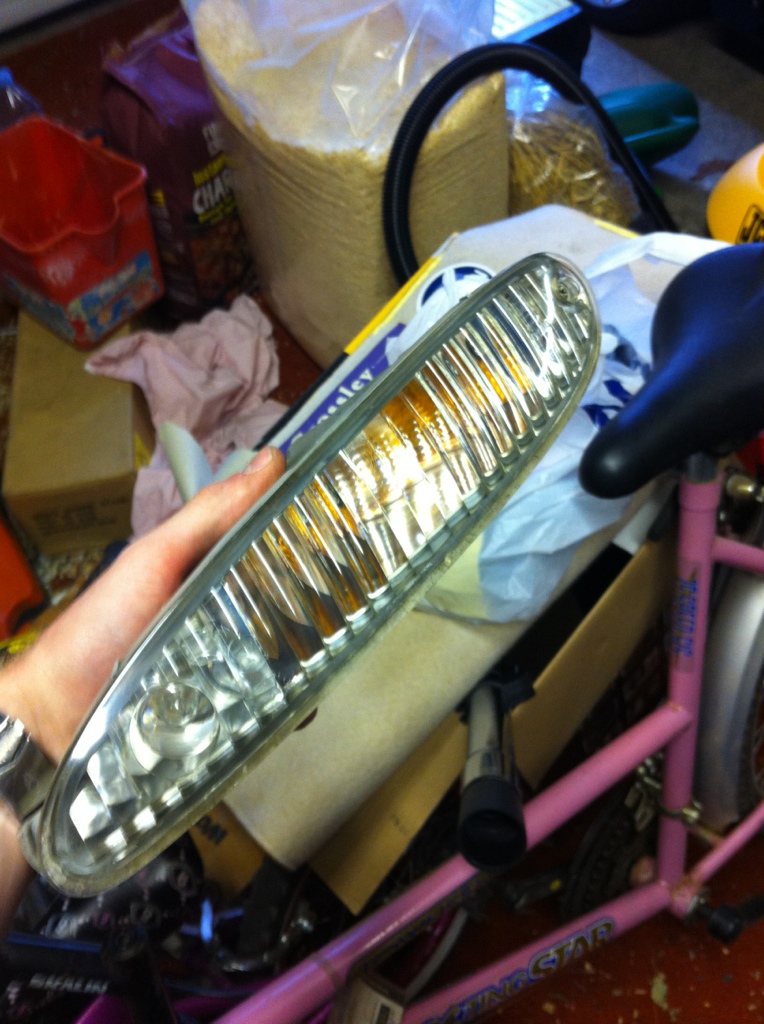

I took one yellowy light...

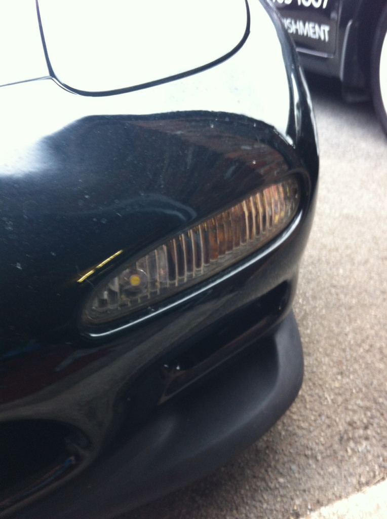

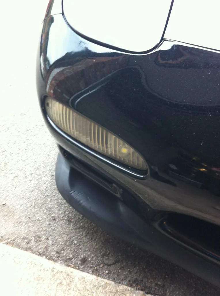

Then wet sanded it with 1200 then 2000 grit, then polished it up with Sonus polishes on my DA polisher...

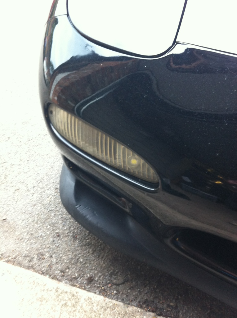

Side by side, before & after (images don't truly show it.)...
And on the car, before & after with a coat of Zaino Clear Seal applied to protect them from the UV...

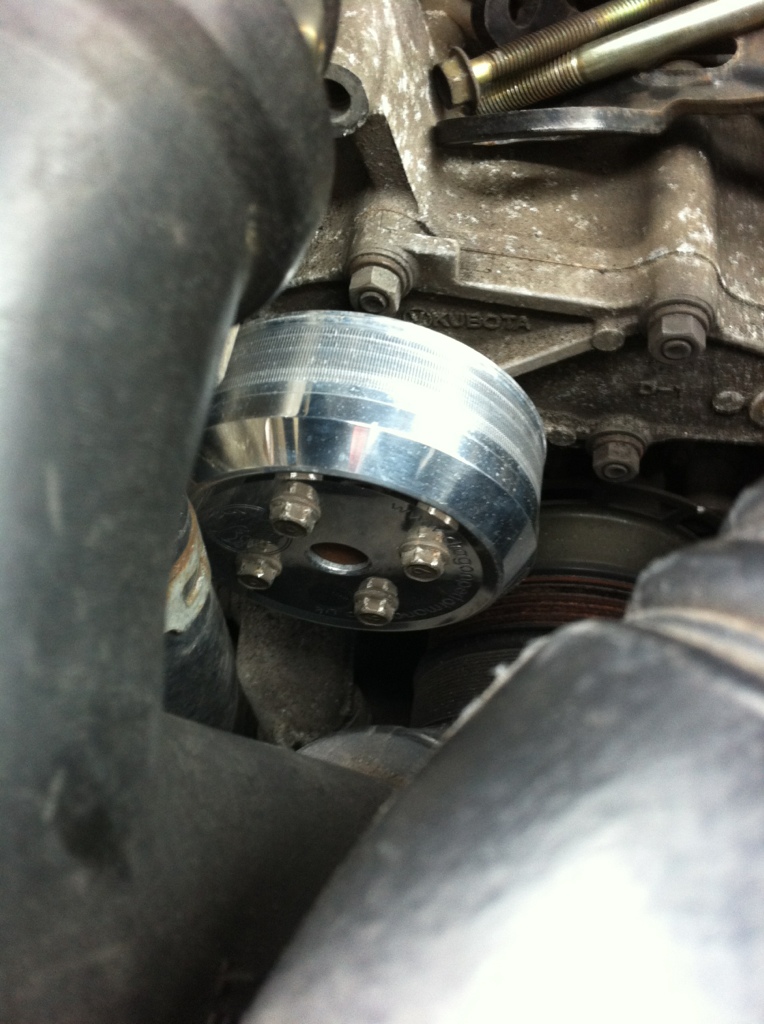

I've rebuilt it this morning. Underdrive pulleys are on, and it now runs.
Water Pump pulley on...
Built back up...

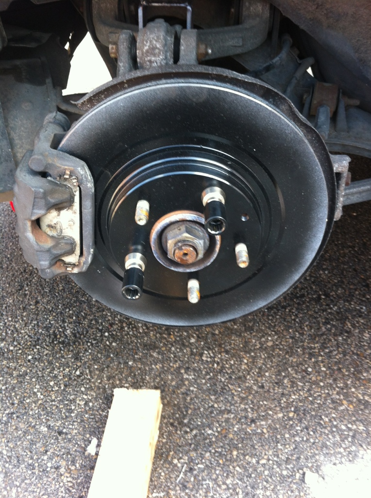

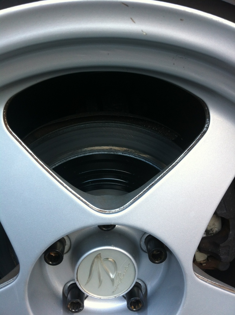

Yesterday, I fitted the rear brakes. Well that's not entirely true, I fitted the discs only. Reason being, I couldn't bodge a tool to wind the calipers in. Luckily the old pads were still full of meat (about 7-8mm), had worn evenly and were Lockheed Delphi, so hardly some pissball brand nobody had heard of.
About a mile later, I'd made the black paint perfectly circular!

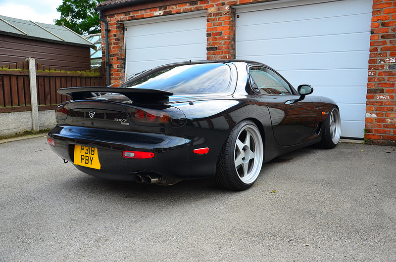

This afternoon I also managed to get it aligned. I'd put up the printout but frankly once I got home I just wanted to drink, and now I can't be bothered to scan it. It drives far better than it ever did (I was running daft camber all round ranging from -3 to -4.5!). I'll put the printout up in the near future. To make up for this, have a pre alignment image I took with my new camera midweek...
RX7 by gaz_roberts01, on Flickr
I might get some more bits sorted this weekend, weather and beer providing.
