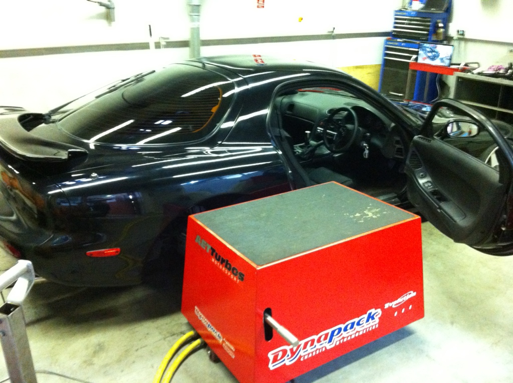

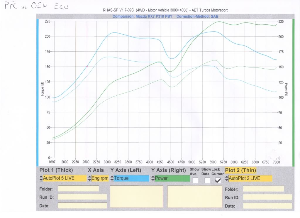

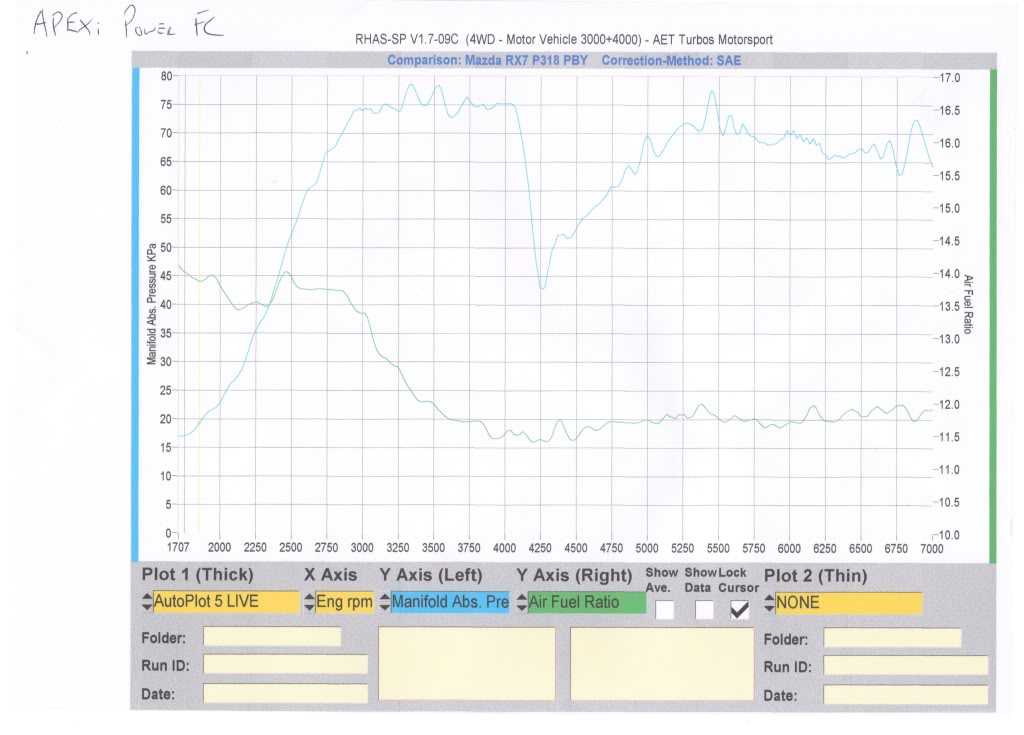

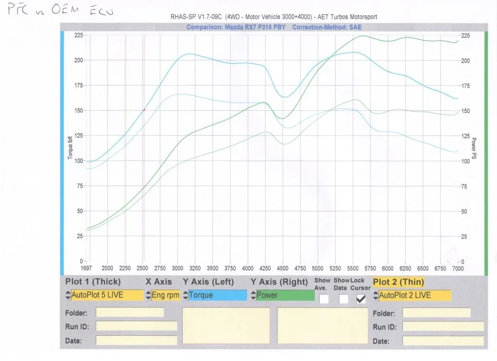

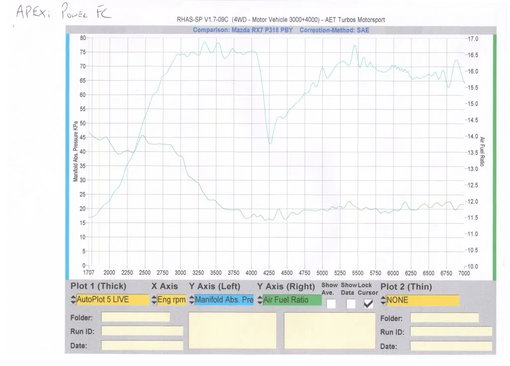

Yesterday was the day I found out if I had truly fixed the misfire on AETMotorsport's dyno. I was there at 2PM, on possibly the hottest day we've had this year, so power was never going to be an amazing figure.
All I can say is, I fixed it :D However, the standard ECU was dog s**t, it wouldn't hold boost after 6000rpm, power was down and the AFRs were in the high 14s/low 15s.
I'd taken my Apexi Power FC along, as last time I was there he said we'll try that once it's fixed. I had to fit the ECU from the driver's side and through the passenger window as the hub dyno was preventing the passenger door from being opened, which was an interesting method!
Anyway, we did a run on it, and everything was much better. The graph below shows the PFC power curves in bold, the OEM in faint. Massive difference.
The AFRs are also a lot better (although could be improved, but my blowing exhaust won't help those readings), as is the boost level.
I don't think 222bhp at the hubs is bad considering how warm a day it was, and the fact that is just a Base map that comes on the ECU. I really enjoyed twatting it down the motorway on the way home, the way the second turbo kicks in is AWESOME. Pissed off a few rep BMWs and an Astra VXR too lol.

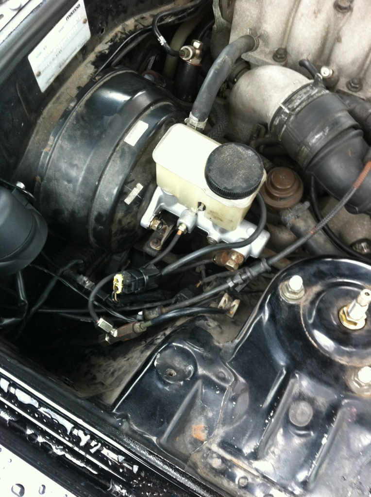

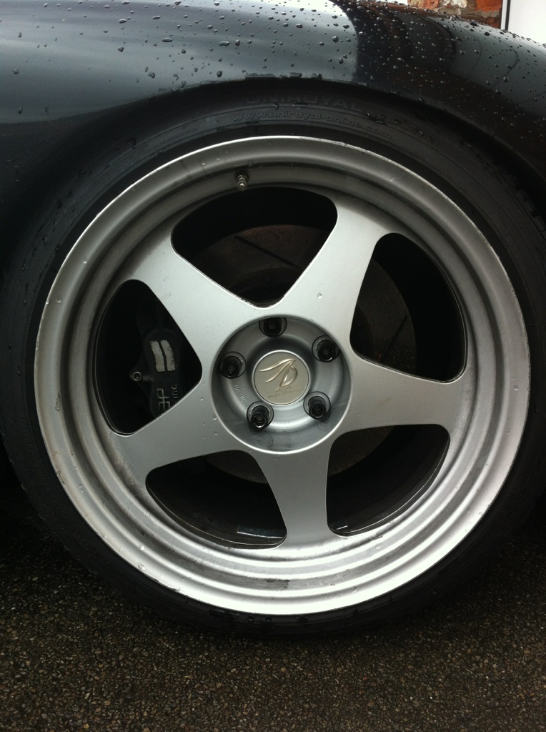

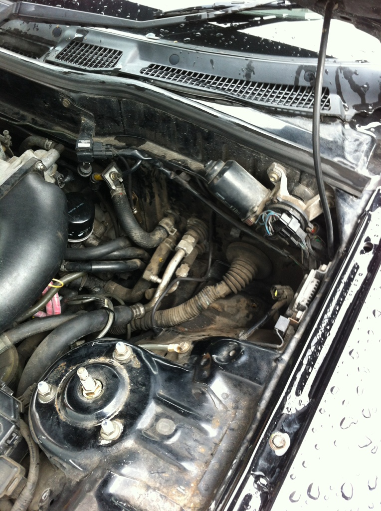

So whilst it's been there he's done a few things I couldn't be bothered to do;

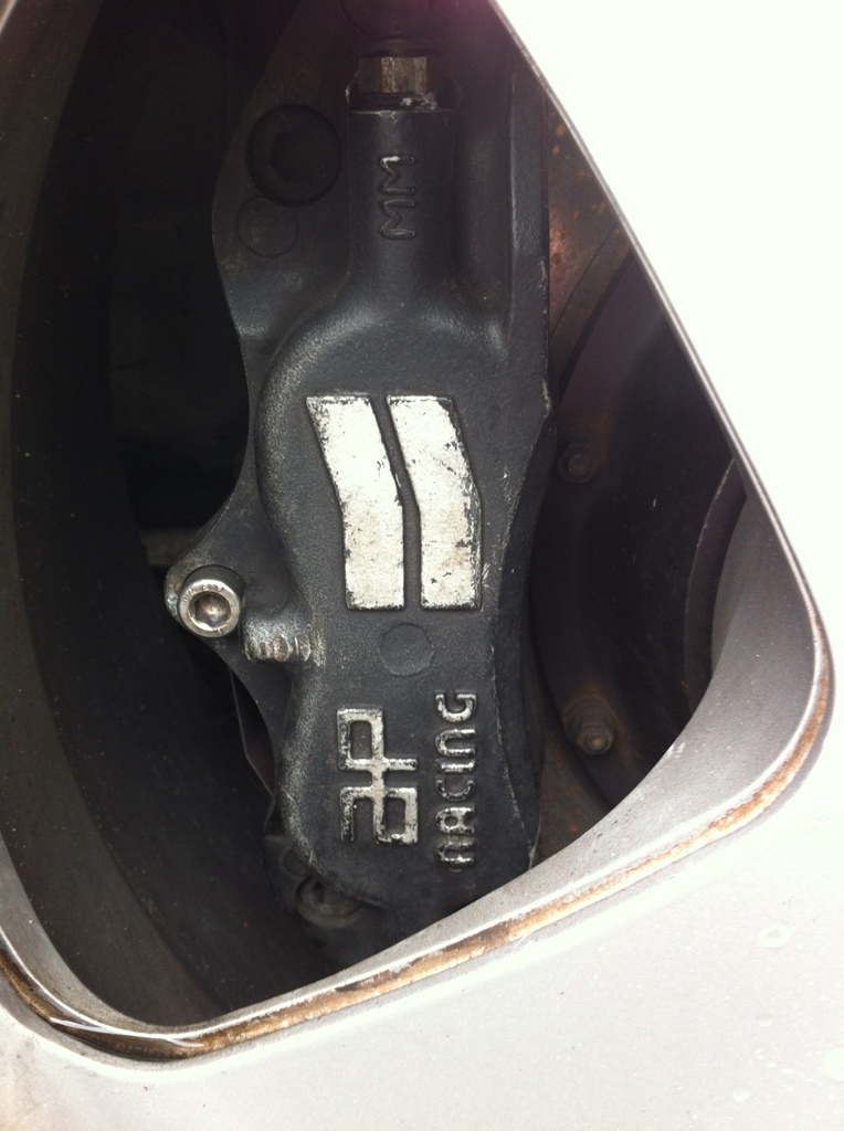

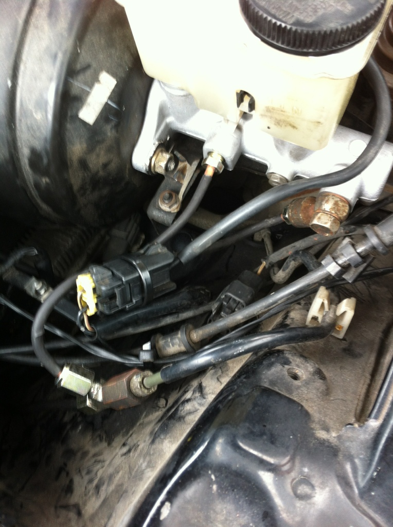

  • Mazda 929 Master Cylinder Swap
  • AP Racing 330mm Brake Conversion up front (EBC Redstuff pads, which will be binned soon as I dislike EBC's products)
  • Braided Brake Lines
  • ABS Delete
  • Swapped a front hub
  • Set the tracking
  • Noticed the exhaust leak so fixed that too.
He was also going to fit me a braided clutch line but it already had one, and he couldn't find any play in the steering system so nothing to repair there.
Front Brakes...
Big old void left by the ABS pump, will make accessing the spark plugs even easier...
Master Cylinder/ABS removal...
So much nicer being able to brake without loosing my teeth, those brakes were shot. I need to fit some OEM rears when I get round to it, and desperately need an alignment doing as the car feels so damn twitchy on the motorway that you feel like it would swap ends given half a chance!

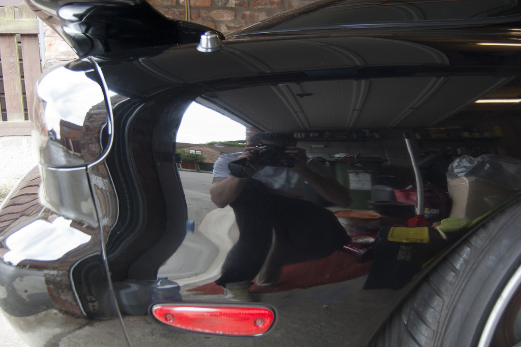

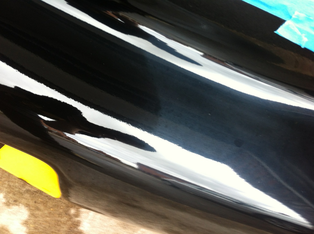

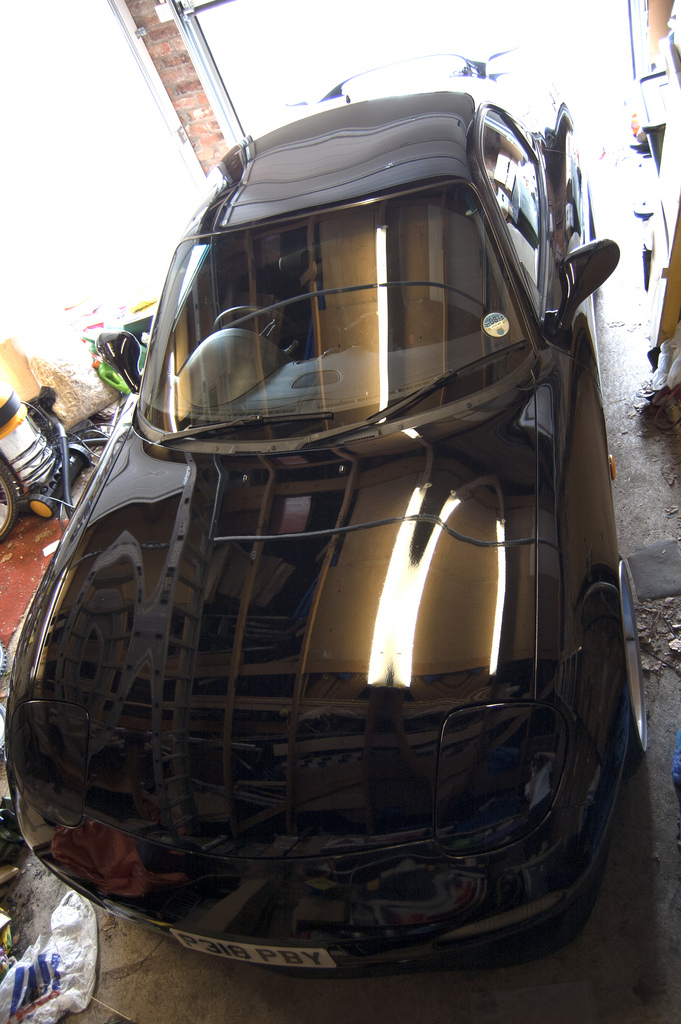

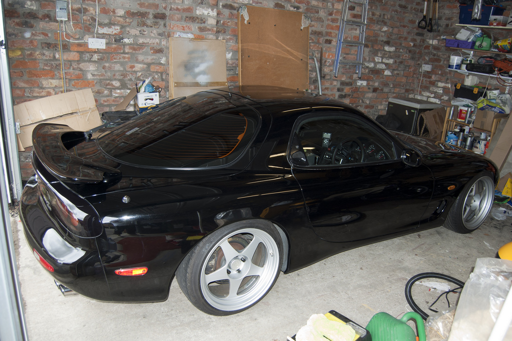

Spent 10 hours of my life machine polishing the car, topped it with a coat of Poorboys Blackhole and a coat of Poorboys Natty paste wax to give it some protection...
DSC_0090 by gaz_roberts01, on Flickr
DSC_0093 by gaz_roberts01, on Flickr
DSC_0087 by gaz_roberts01, on Flickr
It's nowhere near perfect, but it's a lot better. I'll never be truly happy with the paint unless I get it sprayed, but I doubt that'll be happening so I've no choice now but to accept it. This image shows how badly it had faded...
I'll get better pictures probably tomorrow, some planks have been replacing concrete fence posts and I've had to hose the drive down of concrete & cement dust and also mud.

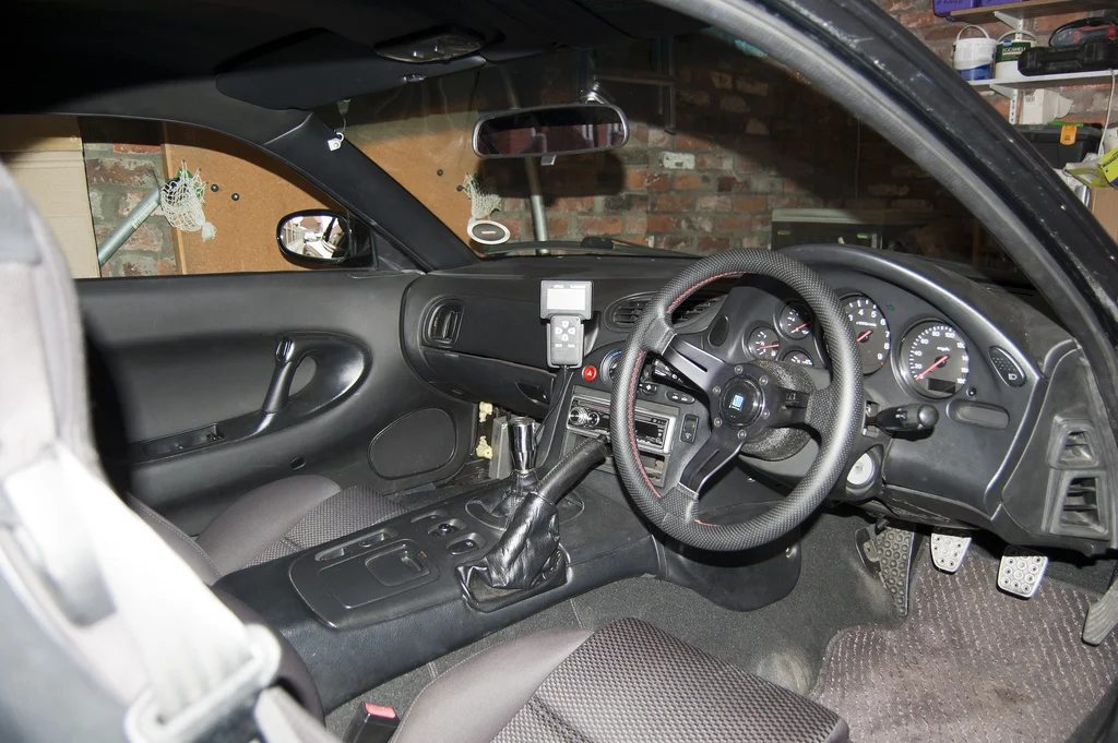

I decided to repair the R-Magic holder that was broken in transit from Japan, rather than risk the same happening again. Fitted it, and I now feel compelled to look at the hand commander a lot :o
