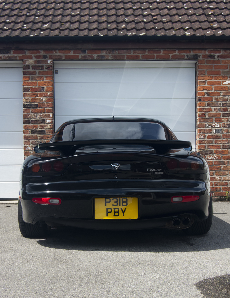

At least it's shiny, so I've improved it's driveway ornament status...
RX7 Rear by gaz_roberts01, on Flickr
Man my D40 sucks, need a newer camera.
