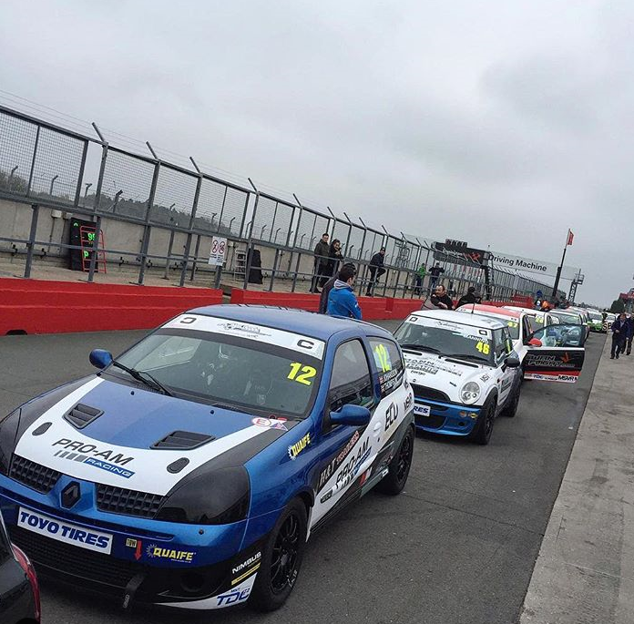

Nice to see you and the car, it’s trully stunning up close. Was a very testing day of testing for us, think this is the only time we’ll be in front of you this year......... [emoji23]
We haven’t seen any of the official photos of our car from Monday. Mind you it wasn’t looking it’s best at the time of the photos [emoji85]
Thanks mate.. it’s good to see so many clios racing, yours was looking great too, love the pic!.. haha, who knows you could be flying past us on the track if your better drivers, hopefully have some good battles...
Was such a shame to see you had that incident with that mini who obviously needed to get down to the opticians..

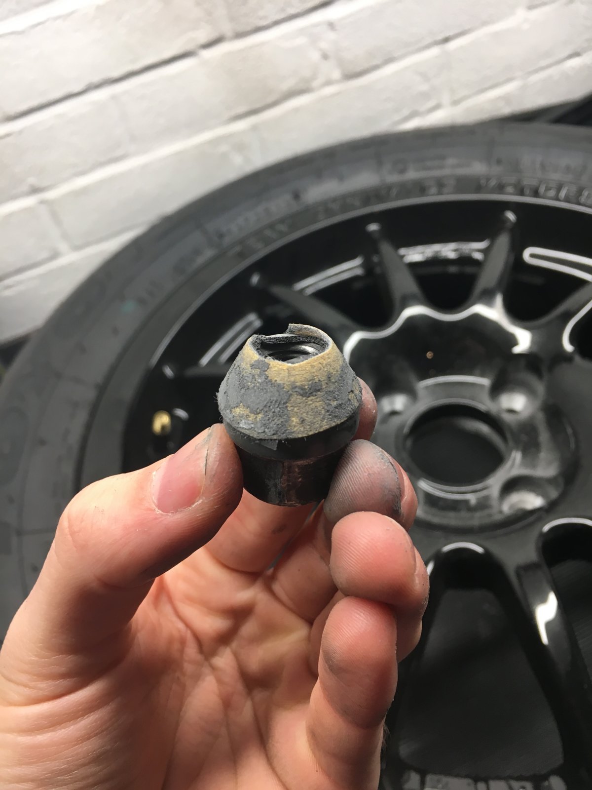

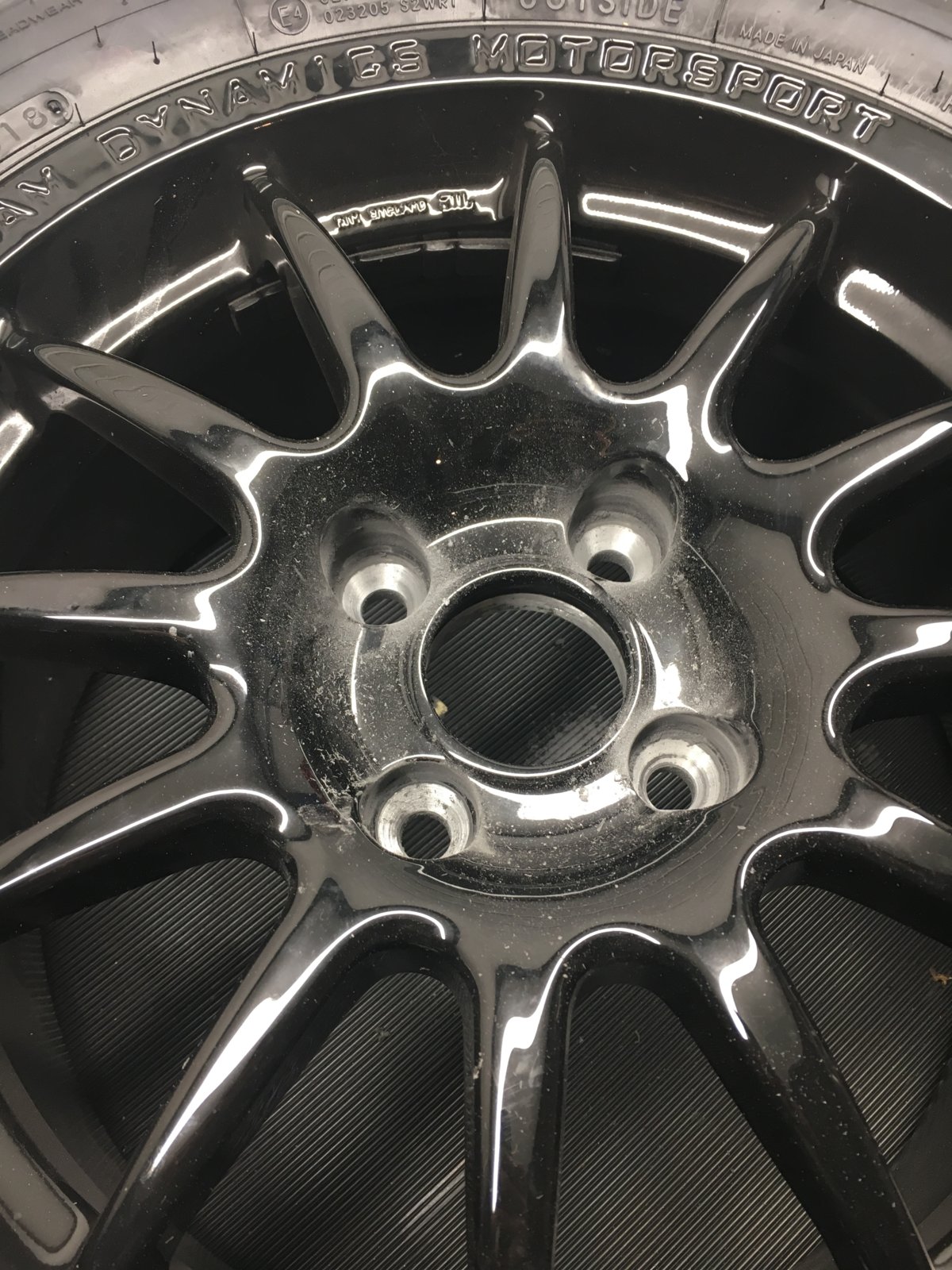

Top tip, I use sand paper glued to wheel nuts to remove all the paint that is left on the wheel nut face in the wheel. We had a wheel come loose at Blyton when we first ran the car because of this. Not sure why they don't supply the rims with this removed from the factory.

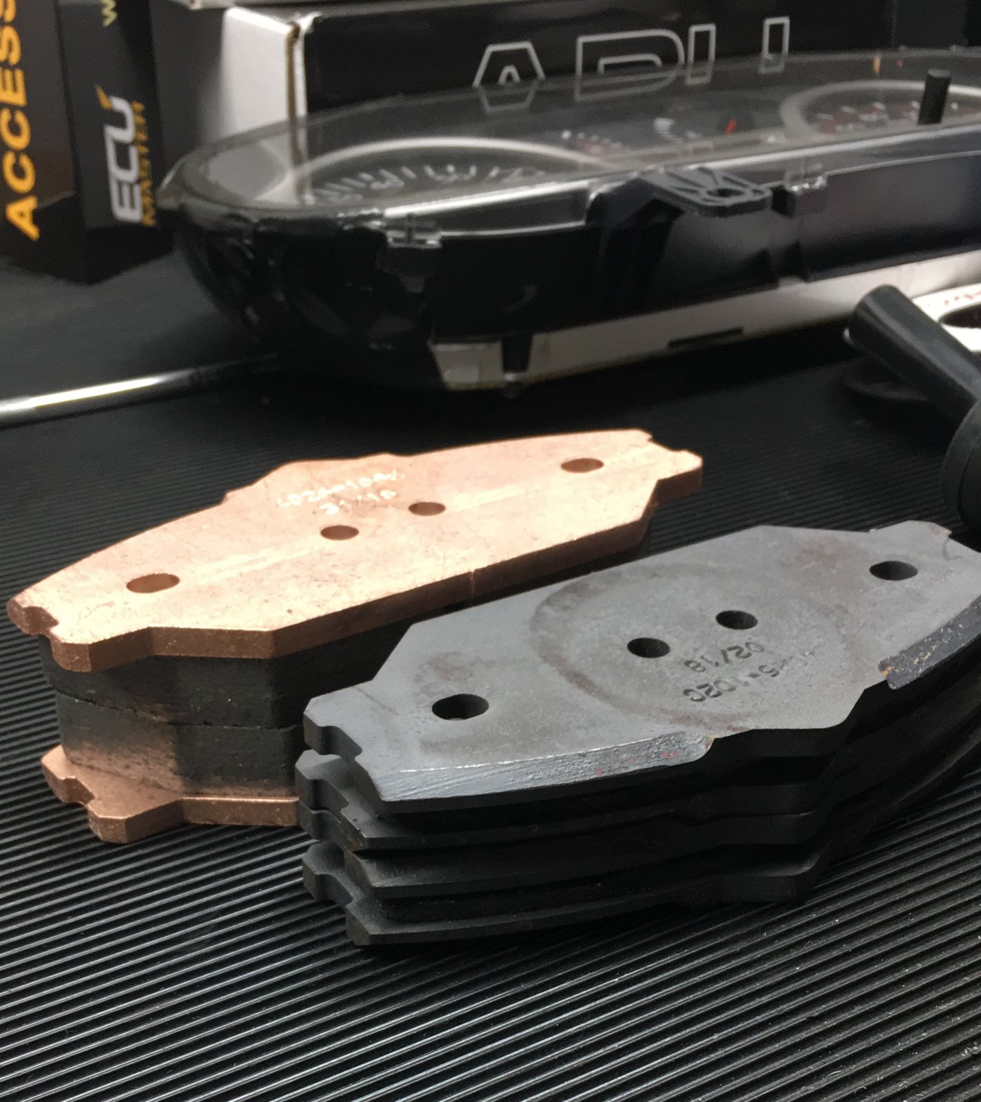

Front/rear discs and pads were cleaned up and measured, always good to keep track of how much they wear from each race to ensure they will last when worn down more. Front pads changed to a new set of CL RC8s .. think we may have taken them to the limit at the test!

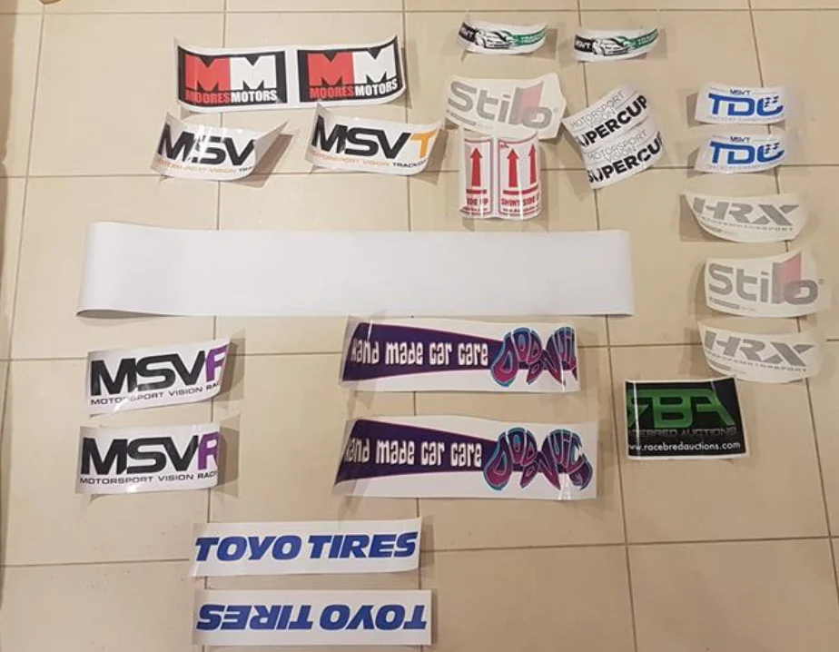

MSA stickers for extinguisher button and external electrical kill switch were ordered and fitted. I also had time to get our latest sponsor H&T Trailers on the car in prime position. Hugh and the team have always helped us out and were really keen to get involved. They are supplying us with free trailer hire throughout the season, and i'll be doing some coverage of the trailers that they supply for purchase and hire. They now have a parts store, so if you have any servicing required on your trailers or need any straps etc they can sort you out.

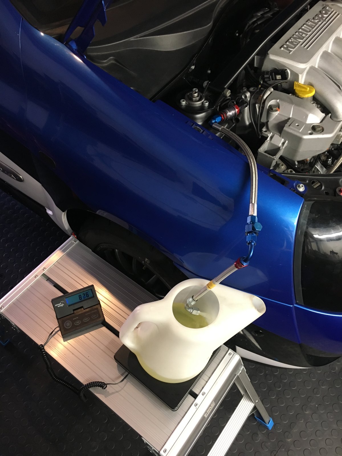

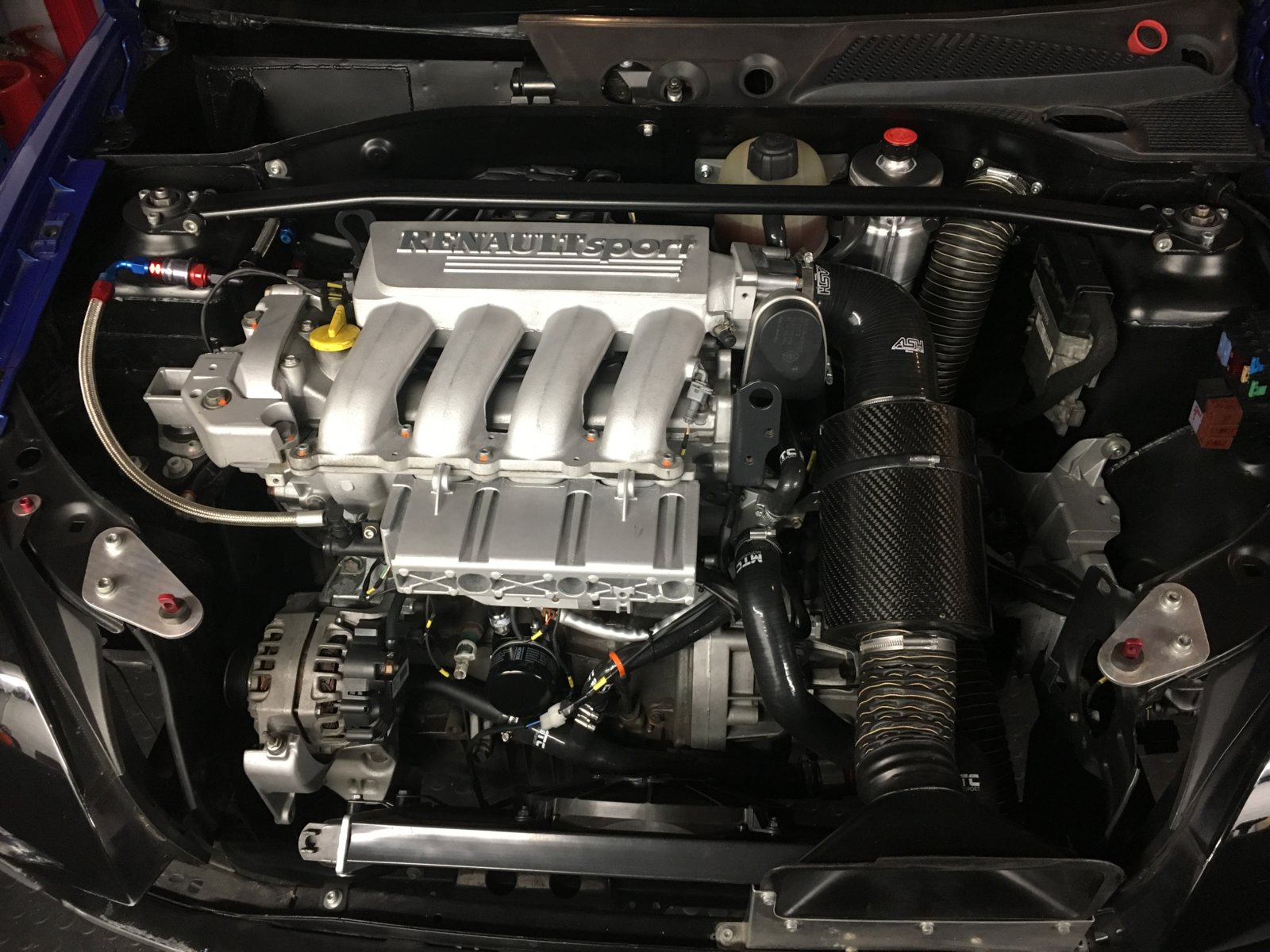

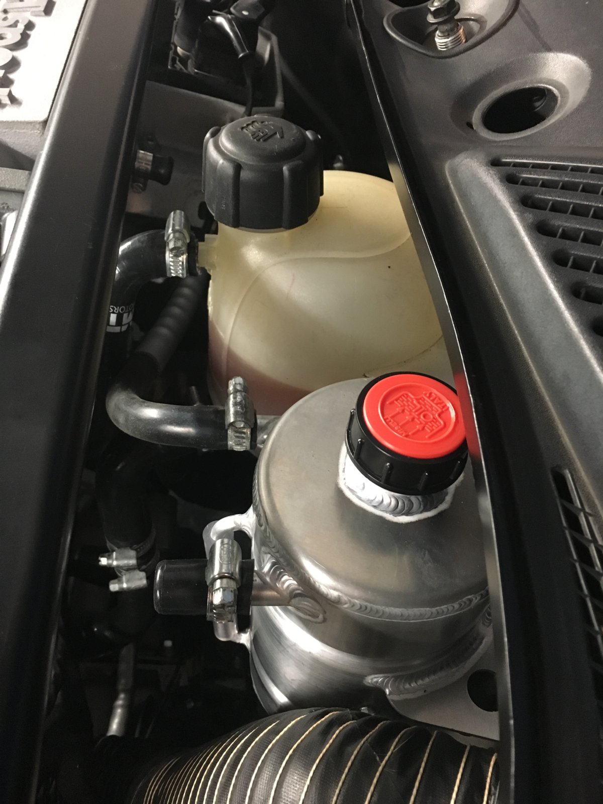

Next up was fitting the oil catch tank. I had previously just been running a filter straight out the head (I knew this had to change but was putting it off). The MSA rule book states you need one, so in it went. Lots of head scratching later on where to put it I decided on moving the header tank over slightly and slotting the catch tank in between the header and cockpit cooling. Fits well i think.
1413844
1413845

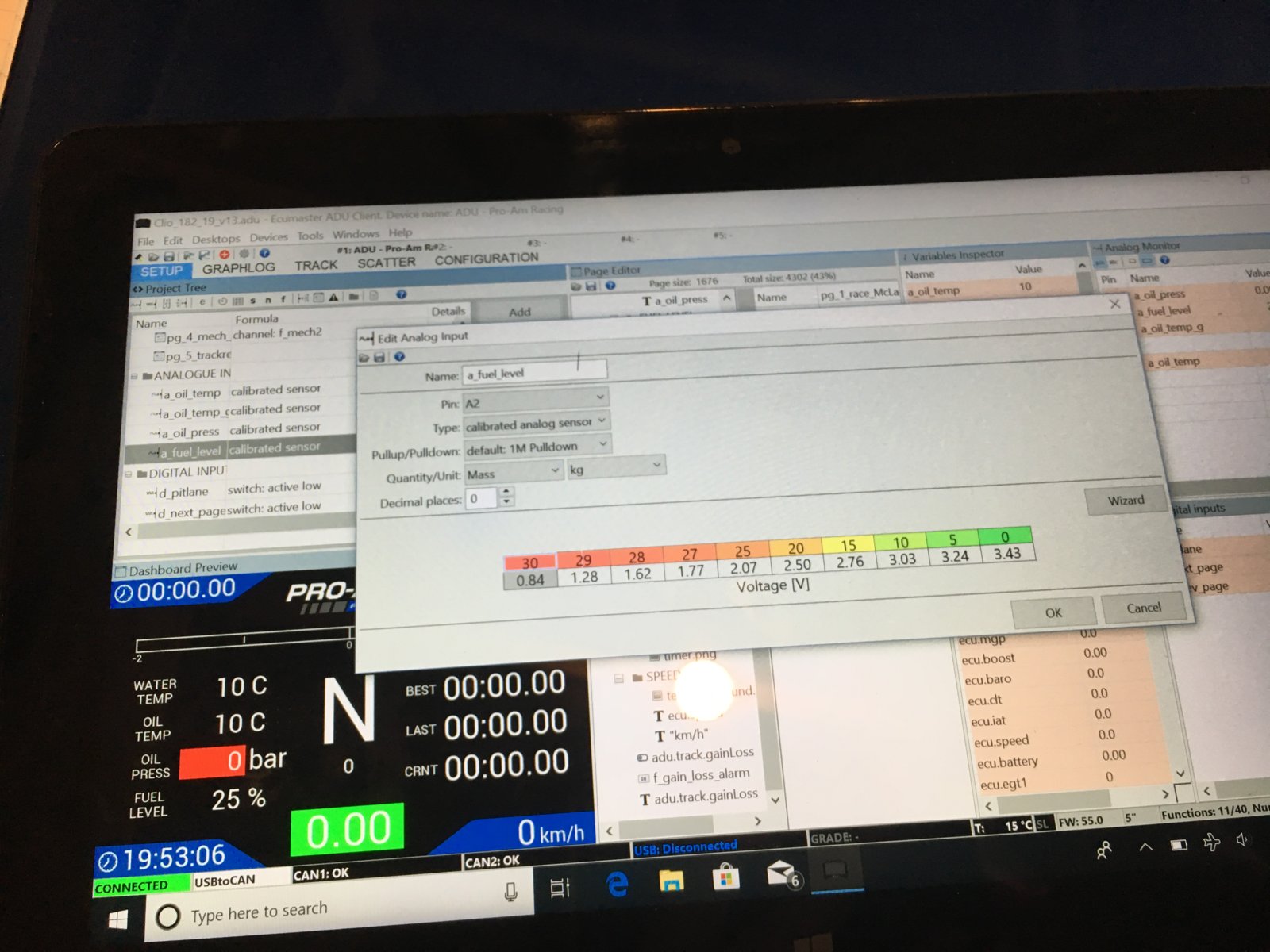

Next up was calibrating all the sensors I had fitted for the dash.
Engine Oil Temp / pressure, Gearbox Oil Temp
This was easy as the sensors come with a calibration sheet you have to input into the dash software.
I then set about wiring in the fuel level sendor wiring. The fuel sender unit is 0/300ohm so I used a 150ohm pull up resistor and filled the tank in 5 kg increments and recorded the sensor voltages. I recorded it in kg as we are in a power to weight category so its good to know how much weight is in the car rather than volume.

While all the preparations were taking place MSVR had sent through all the championship mandatory stickers and the team/vehicle passes
(pic taken from a fellow competitor, who like us was amazed at how many mandatory stickers there are!!)

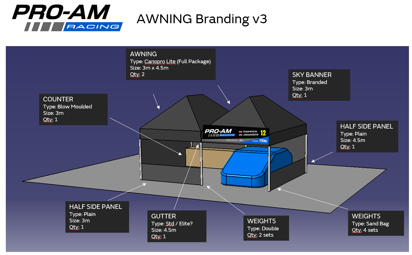

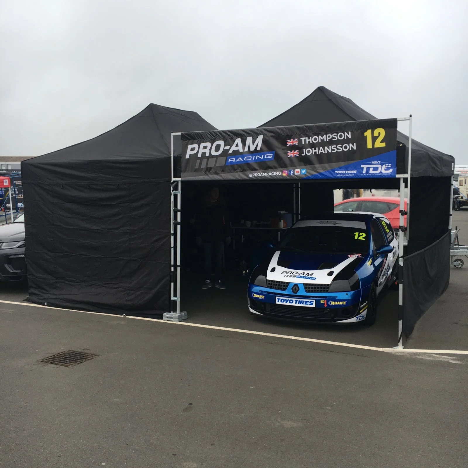

With the car finished I was just waiting on all the awning and kit to be delivered.
I had been working with Surf & Turf on putting together a package for race weekends.
The final design I came up with was as below:
1413856
I wanted to have a space for the team too as well as the car, so settled on two 3x4.5m awnings. We went for a simple sky banner for the branding as then this can be changed easily season on season. It also meant we could keep the awnings plain , and thus the resale value high.
We also wanted a table as one of the biggest things from the trackdays was not having something to put our stuff on.
The half height walls we wanted to make the setup more inviting to other people at the circuit, whilst showing the car off at the same time.

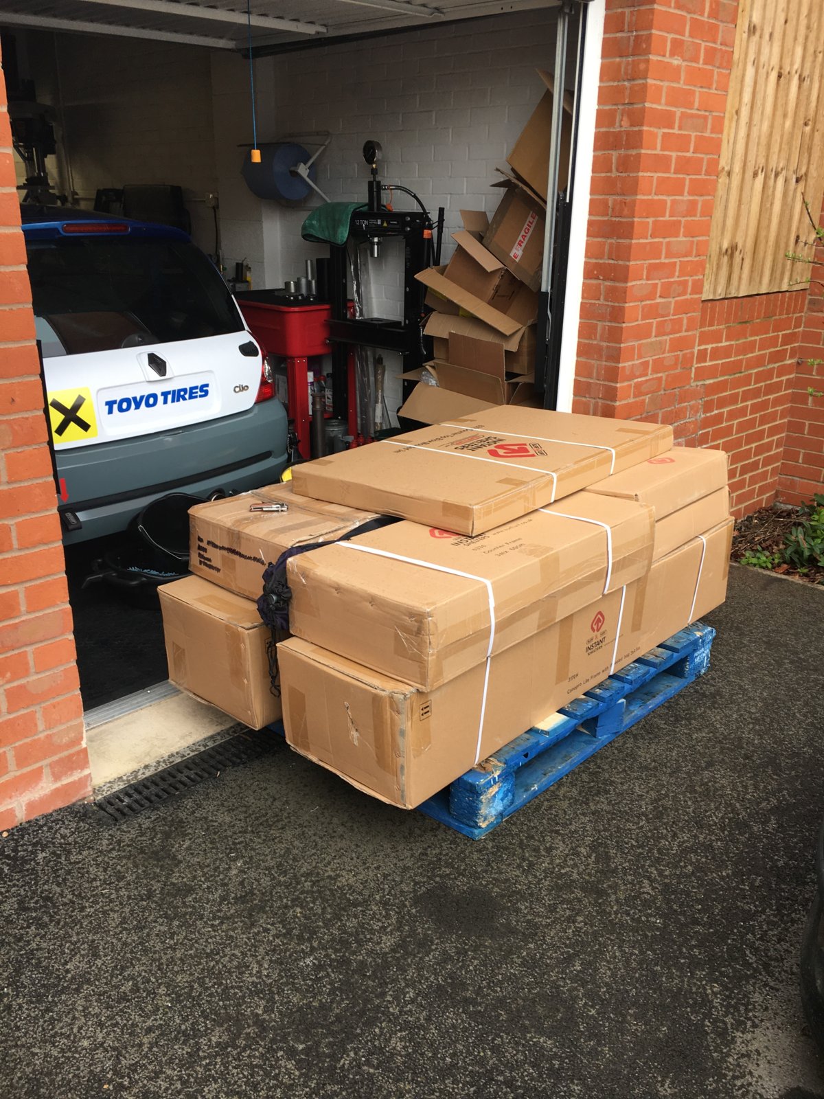

Once it arrived my initial thoughts went to " how the hell am I going to get this all to the circuit" haha!..
1413857
Final bit of kit was our driver kit stand.. absolute bargain from Argos. Should keep everything nice and organised. Can't beat a bit more branding either!! haha
1413858

With the fuel sensor did the 150 ohm work ok , i need to do my dash 2 set up and was advised to use a 300 ohm pull up.

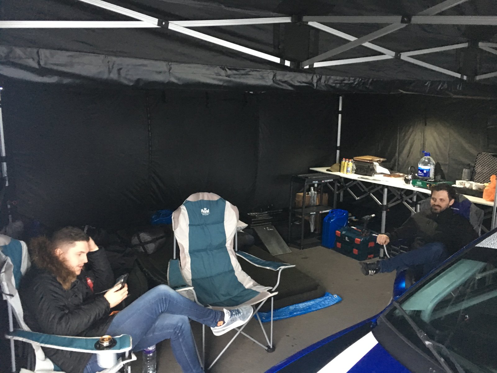

So we headed up to Donington mid day on the Saturday as we were booked in with Total Track Dyno Power at 2pm.

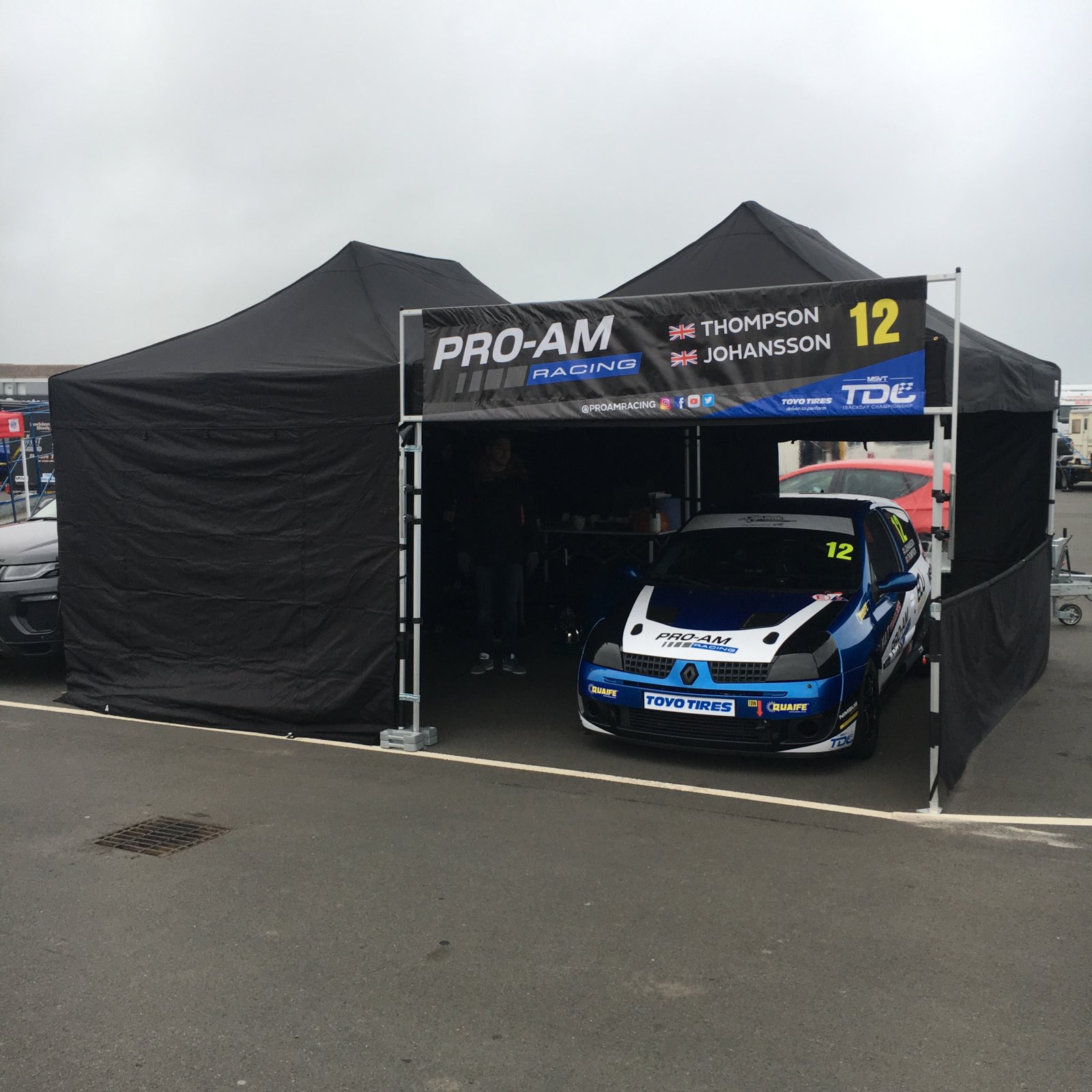

@chrispy.clio and I got there first and started to unpack all the awning boxes (luckily the Clio has a large empty boot, so most of the parts went in there, and the main awning bags were strapped on the trailer in front the car)
I'm glad we arrived on the Saturday to setup as setting the awnings up for the first time and understanding how the joining kit etc worked took a while!.. An hour or so later and we were all finished. Should be up within minutes next time though, the Surf and Turf products are brilliant bits of kit. Its amazing how such a large awning and table can compress into such small bags/boxes.
The setup and sky banner looked better than I previously hoped it would. Will be a good base for the rest of the season!
I particularly like the modularity of the walls, having full height and half height really opens up the awning whilst protecting from the wind. Plus at night we can fully enclose the awning.

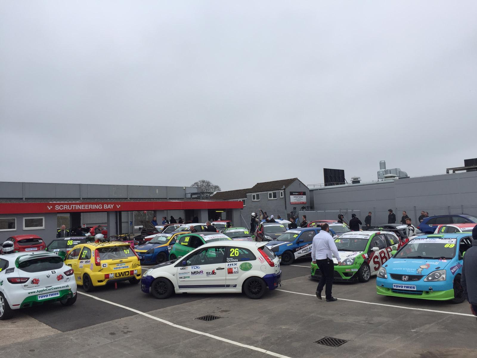

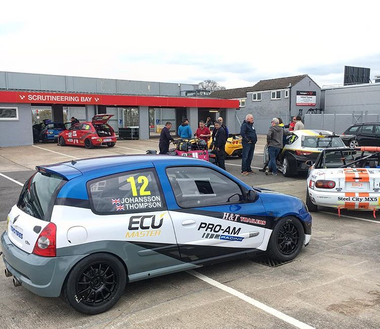

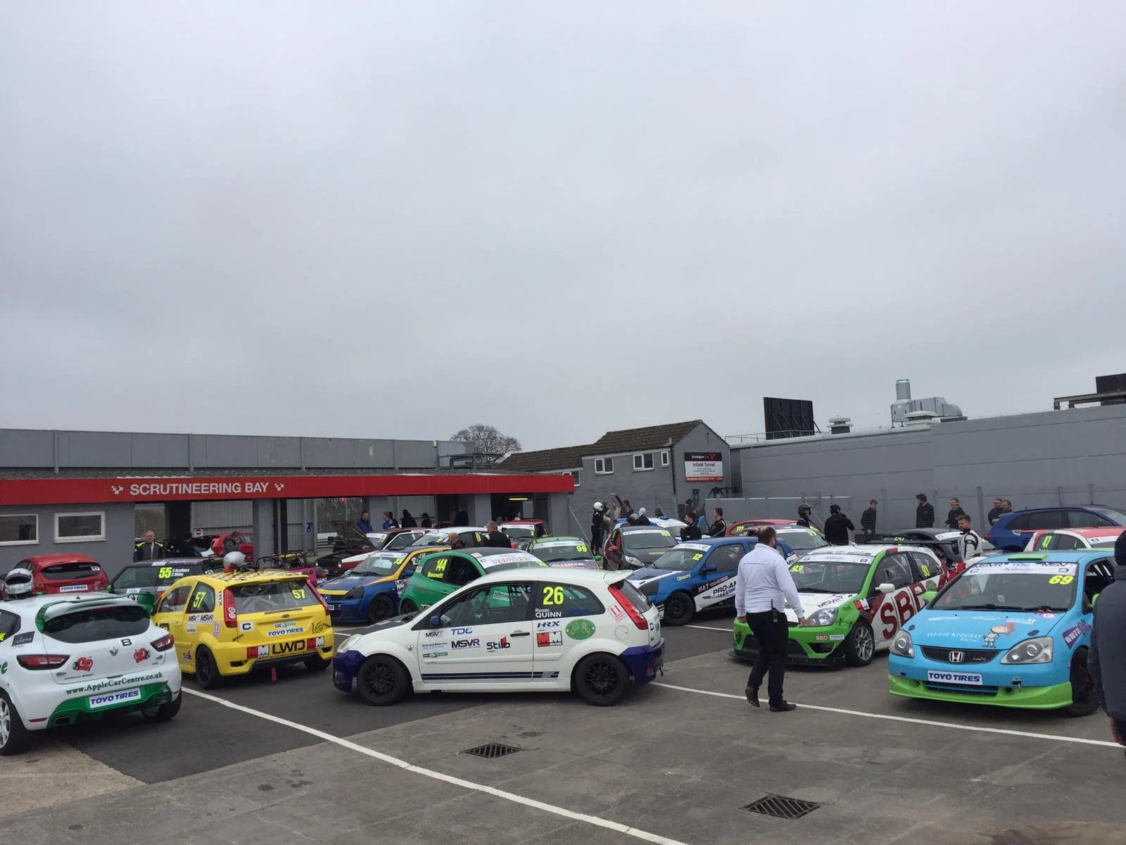

We then jumped straight into the queue for scrutineering. Something I really wanted to do on the Saturday, as it would give us plenty of time to resolve any issues that we/scrutineers may find with the car.
1414487
It was also great to see a new addition to the livery with H&T Trailer Hire & Sales coming on board as a main sponsor to the team. Hugh and the team have always been so helpful and supportive of us; from the first time they got us out of a tough situation last year, and all the way through our test days. If you are after any advice on trailers, plan to buy one or are wanting to hire one they are the guys/girls for the job!
So we managed to pass through scrutineering pretty swiftly!.. We were praised on our build quality which was great to hear. The only item which we needed to modify was the addition of a yellow band on the main earth cable from the battery to the body. This was easily added and our 'pass' sticker also added to the car!.
All those endless nights going over the rule book and blue book paid off!

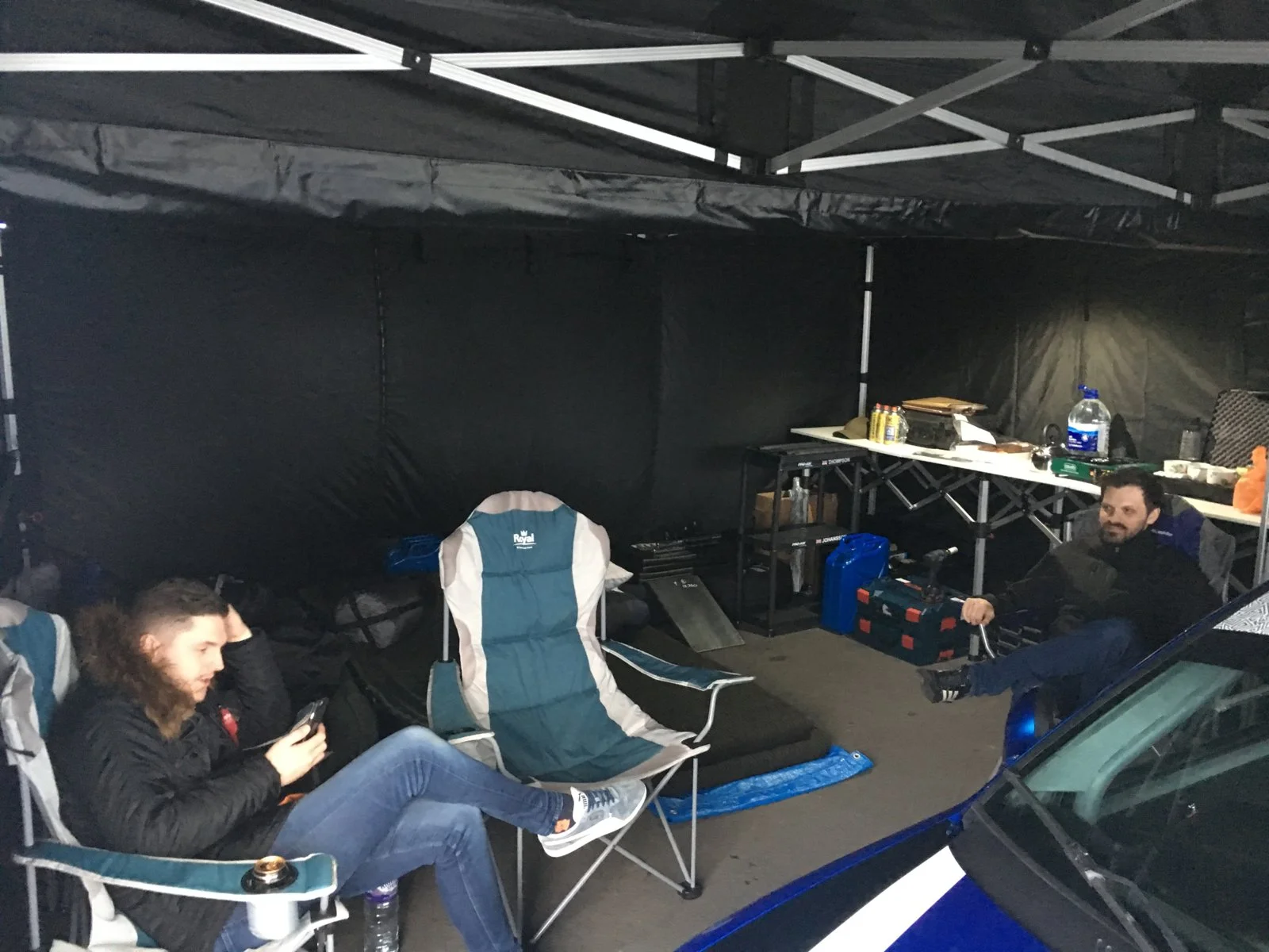

We took the car back to the awning and waited for @Jenbo to arrive. We then set about adjusting the ballast and working out the fuel levels for qualifying in the morning. The last task was to fit all the championship stickers and position our personal sponsors. Then setting up the camp beds and getting the Dominoes in!!!
1414488
The awning was surprisingly warm through the night!. but jeeeez we missed the memo on needing ear plugs!, the planes coming into land at east mids every 15mins made for an interesting sleep.

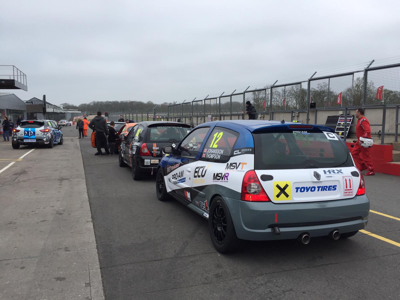

We were the first group out for qualifying at 9:05 so it was good to have everything ready.
With last minute checks and cameras installed Ben headed off to the assembly area while I carried a spare wheel, trolley jack, torque wrench and wheel gun to the pitlane, just incase we got a puncture. (reminder to get a trolley for next time as that was all pretty heavy!!)

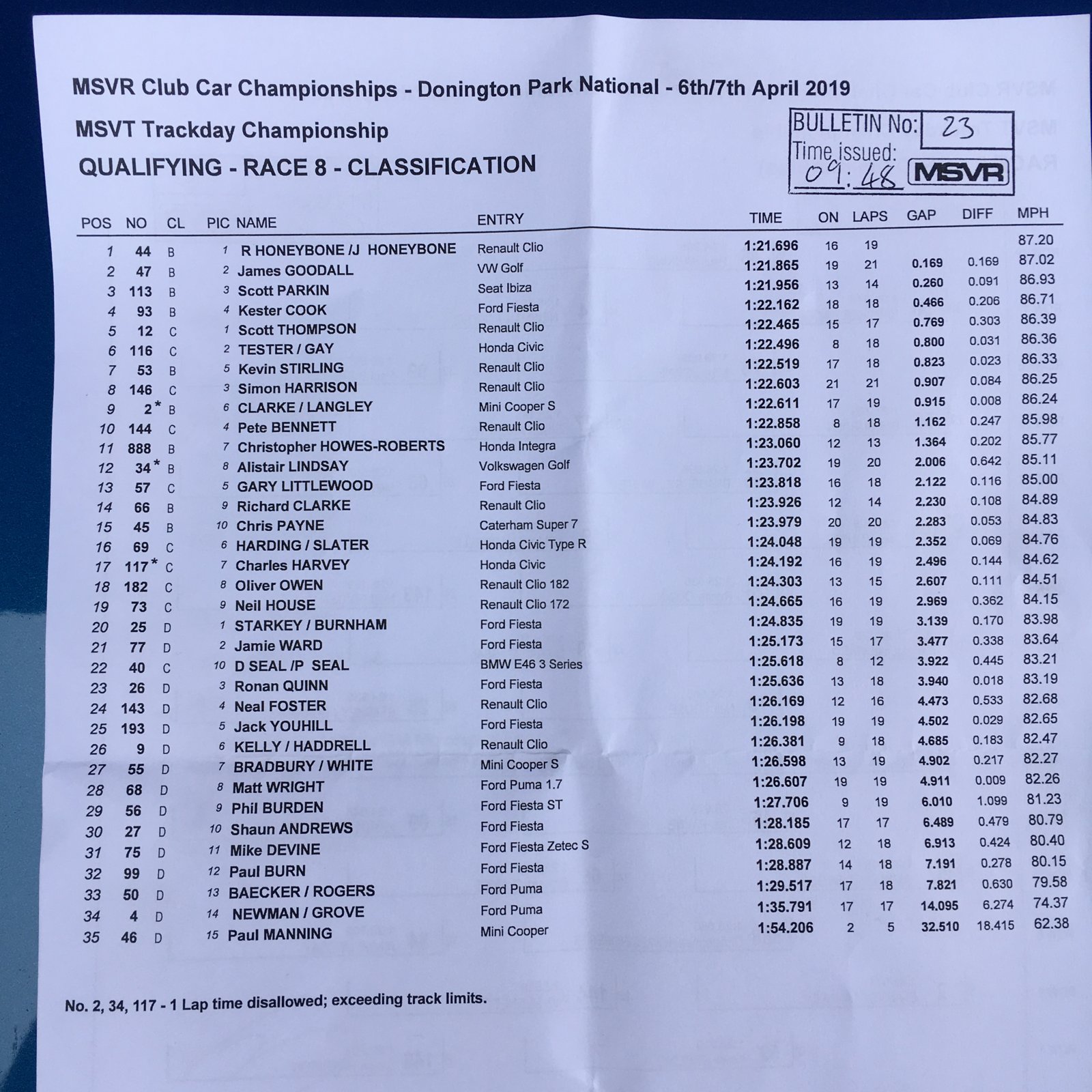

With the green lights back on the track went live!.. The plan was for Ben to go out and warm the car up and do his 3 mandatory laps (each driver has to do a minimum of 3 to qualify for the race) then put In some banker laps before he handed over to me. We have always been within a few tenths of each other in testing which is great for race pace. Ben is very consistent, and me more sporadic, but I have always managed a faster single lap (I think Ben is a little more worried of damaging the car as I am the one who does the work haha).
The first few laps we were down in 22nd out of 33 cars and I was pretty pleased with that as It was about P8 in class and for our first event I didn't have a clue where we would be compared to the competition. Little did I know Ben was just trying to find some space out on the busy circuit. Once he got into a rhythm, the car and Bens pace began to show, jumping up to P9 overall and 3rd in Class!.. Now I was starting to get excited, we were in with a chance of a good quali result here!..
Being the first group out on track the track evolution was starting to become apparent. Every lap people were going quicker and quicker!.
Before I knew it I was being told to get my helmet on as Ben would be coming in!.. Then I was out on the circuit for my first qualifying session, this is what the previous 4 years had been building too!
Knowing Ben had warmed the car and tyres nicely, and spending all year testing I was at one with the car immediately. I was able to take the craner curves flat even from straight out the pits!. The confidence the car brings is brilliant. The setup edging towards understeer, but very stable. It was a joy to drive.
I quickly found a gap in the traffic and began to work on my lines, trying to be as smooth as possible. I was trying to take turn one too fast and struggling with entry to mid corner understeer, but everywhere else on the lap felt good.
It was great having @chrispy.clio on the pit wall keeping me informed of lap times and position via the intercom. Saves looking out for pit boards.
We crept up to P2 in class behind a Honda Civic FN2 (great bit of kit).. I then found myself catching the civic on track, I made one last push on my last flying lap of the session, getting a little tow maybe ;) and went 2 tenths quicker putting us into P5 overall and P1 in Class!! with a 1:22.465 pipping the 2nd place Civic by 0.031s (that was close, good job we got the transponder fitted)
The chequered flag came out on the next lap and that was it, first session ever and we had grabbed pole in class!!!.. what a feeling!
Hi mate, thanks, it has escalated recently with all the latest mods.
Yeah the 150 ohm works fine, gives a voltage range between 0-3.5v .. a 300ohm will give you less resolution (0-2.5v) but will probably still be ok.
All depends on how many sensors you have hooked up to the 5v supply, it can only take so much current, the more sensors the less resolution u can run on each. if you aren’t running many you could use a 150ohm on the fuel sendor.

Thanks ive got 4 sensors from the 5v , oil temp, oil press, fuel level and gear position but can put the gear pot onto a 12v feed if i need to.
what pull up resistors are you running on the other sensors?.. about 300ohms?.. if so I'd say you could run a 150ohm on the fuel level sensor without any issues as you aren't running many sensors.
