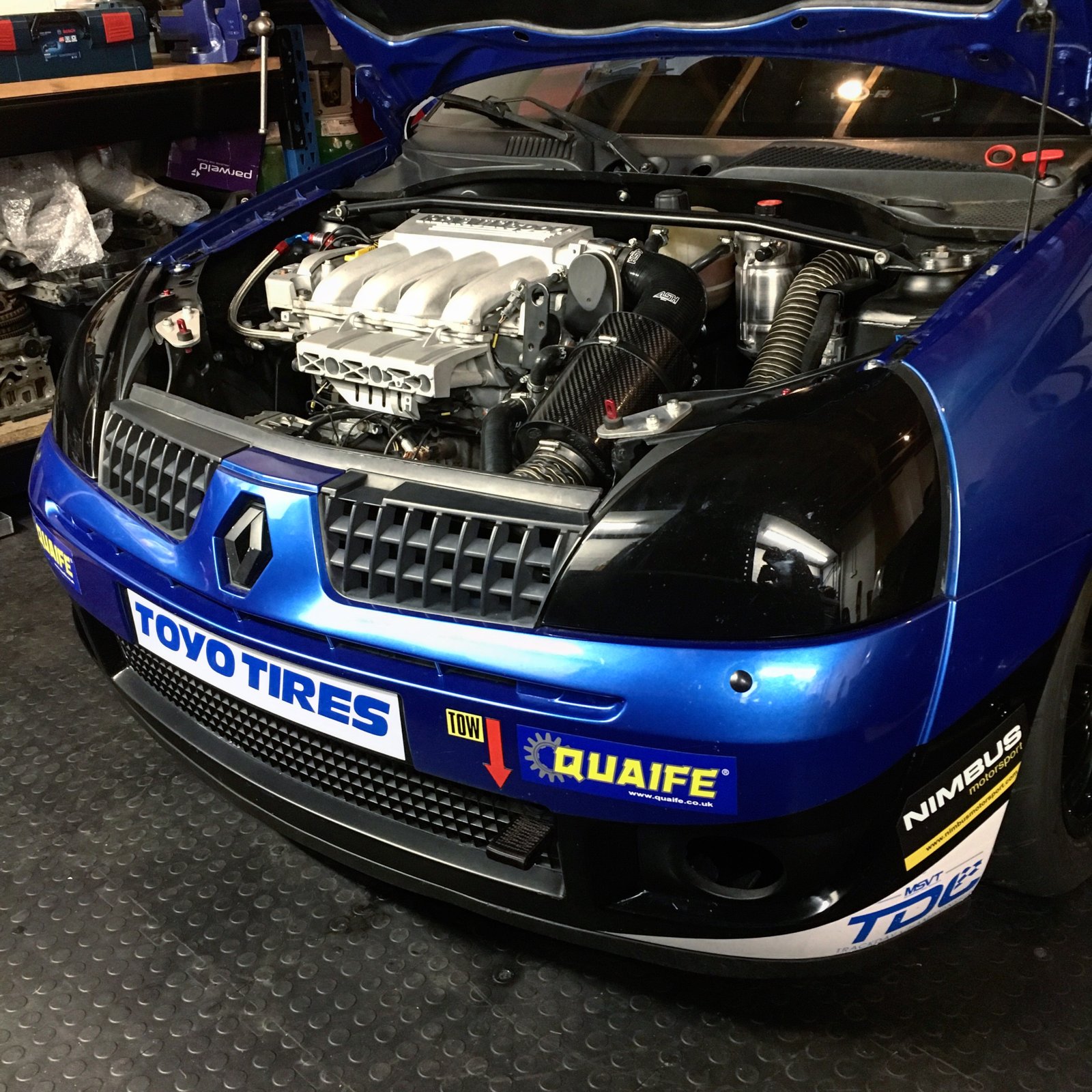

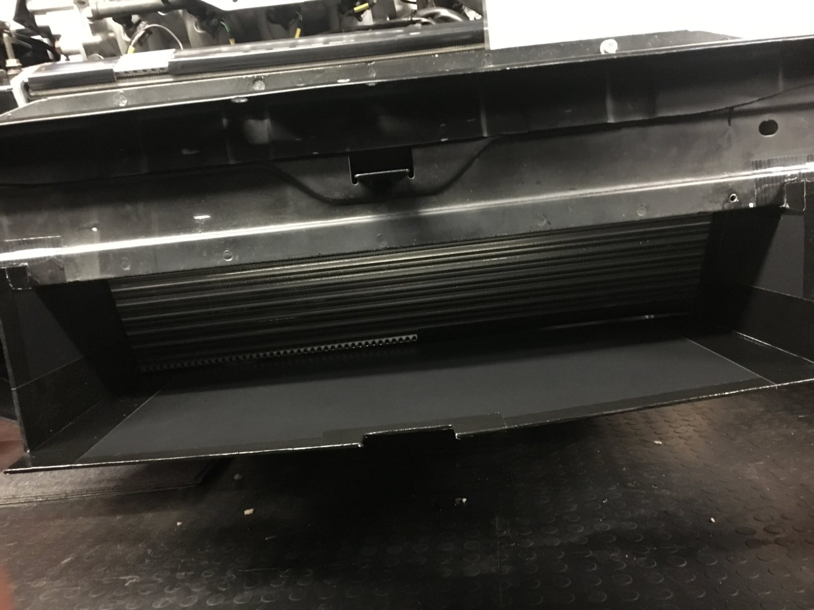

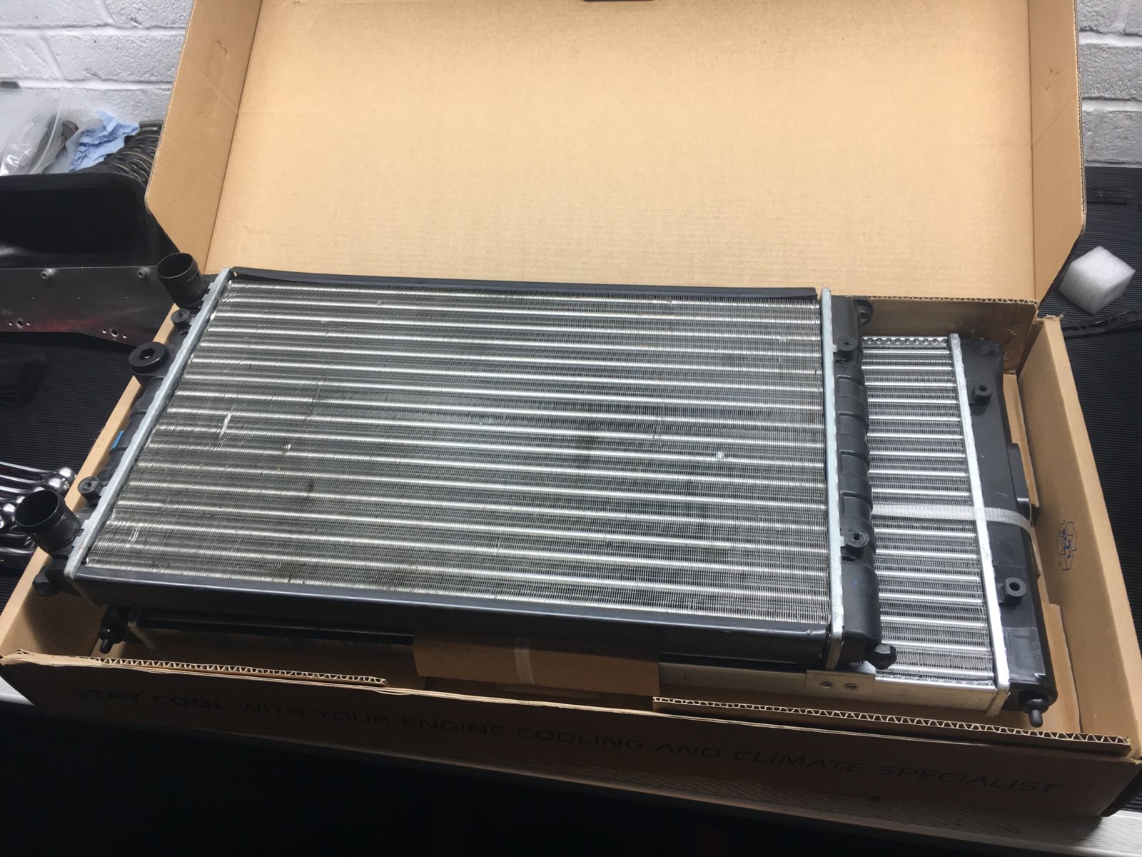

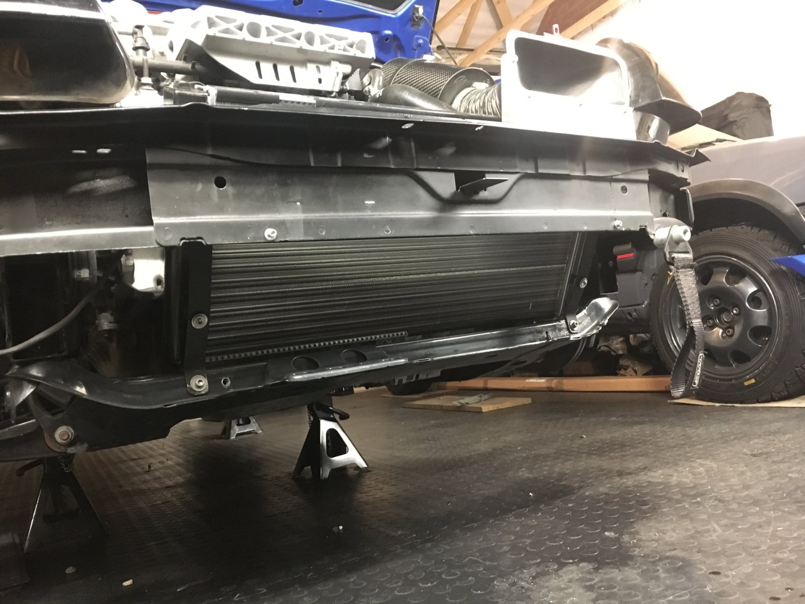

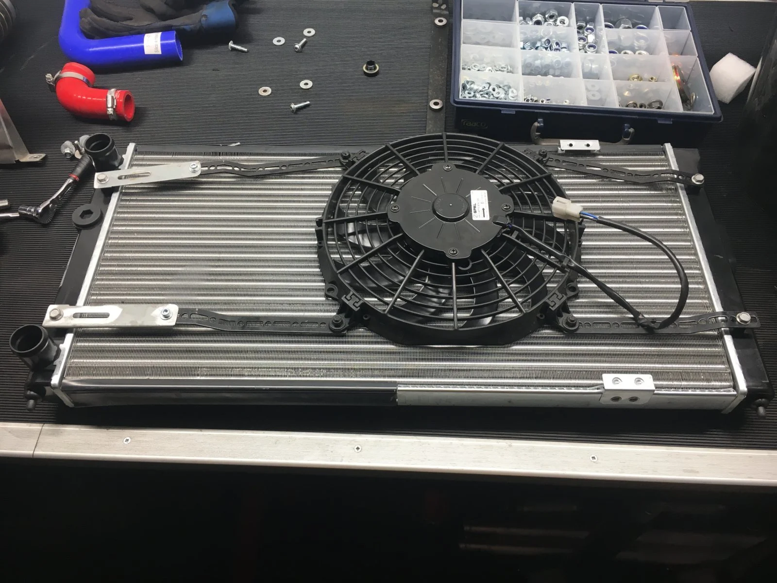

So after Donington we analysed all the data, watched all the videos and planned to make all the necessary changes ready to come back stronger at Snetterton.
One of the main issues we saw at Donington, now that we have data logging on the car, was that the car was running around ~106deg water temps and ~145deg engine oil temp. The air temps were at about 12deg too so it wasn't particularly hot. We do run Evans waterless coolant which has a higher boiling point so doesn't cause any hot spots or increased pressure in the water system, but will cause the water temps to run slightly hotter with no issue to the engine (they say about 3-10deg hotter) so the temps at 106 weren't a huge concern, however going to races on hotter days we'd be a little more concerned, more so for the engine performance, with the residual heat heating the inlet and air, and any effects on the ignition driven by the ecu.
With this in mind and knowing its only going to get hotter in the summer, and we will be running closer to other cars while racing we decided to improve the vehicles cooling system.
The plan was to fit a slightly longer radiator and make a bigger duct for the front bumper to suit.
Again I sourced a new radiator from Advanced Radiators, this time a SE320 which is the same height as the current one, so it will fit under the inlet duct, and is 100mm wider. This gave us an area of 1.884m2 which is an 16% increase over the rad fitted, and -0.6% less than the std rad area.
Comparison of old vs new

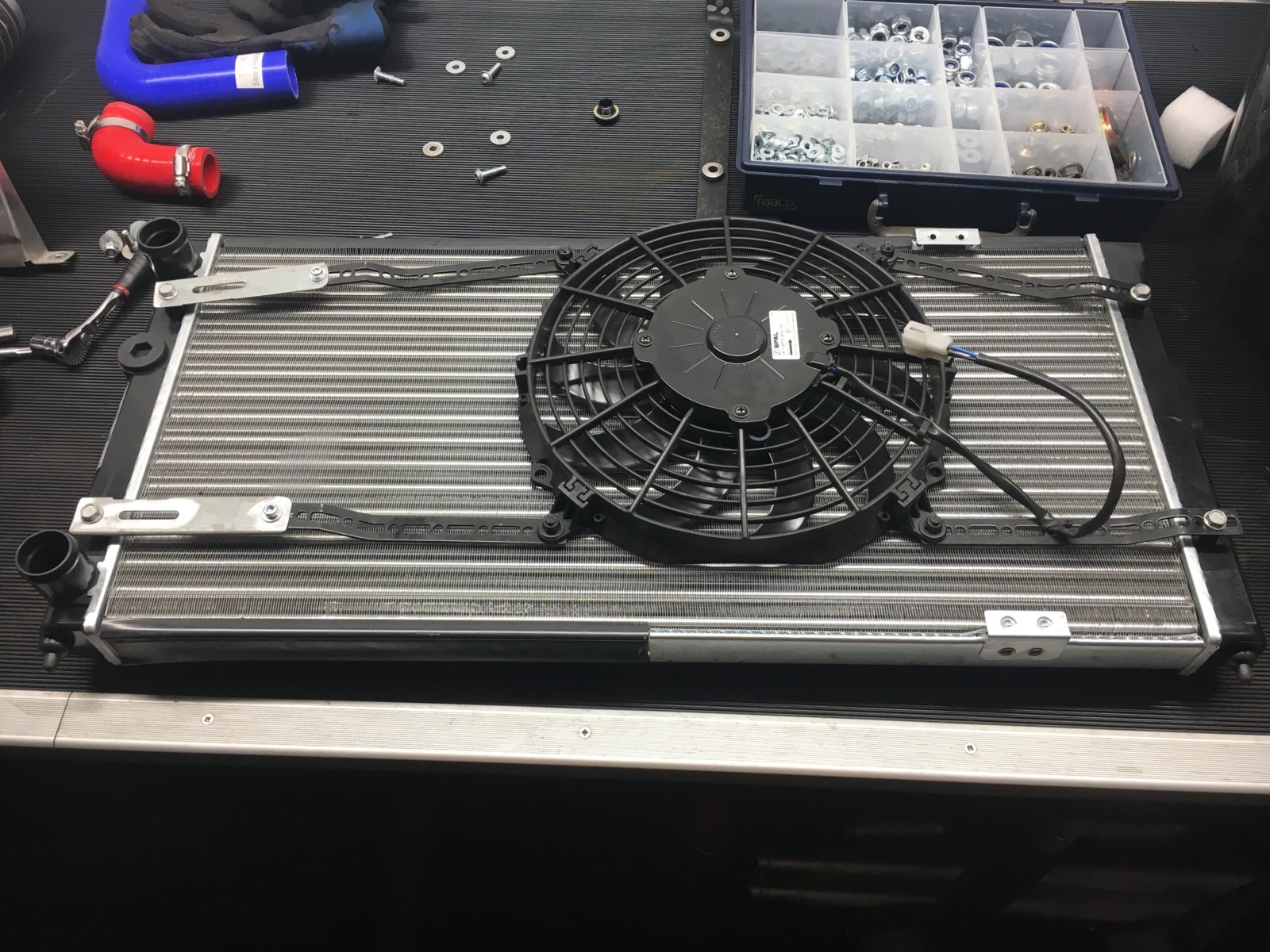

1418576
I fabricated some little extensions pieces for the fan mounting and re drilled the subframe and bumper beam to move apart the rad mount plates to the new width
1418577
1418578
I then made a brand new duct to ensure all the air flows through the radiator and doesn't pass under the subframe
1418580
This should lower the temps sufficiently to run in all weather conditions. Figures crossed its enough for Snetterton. Only the logging will tell!

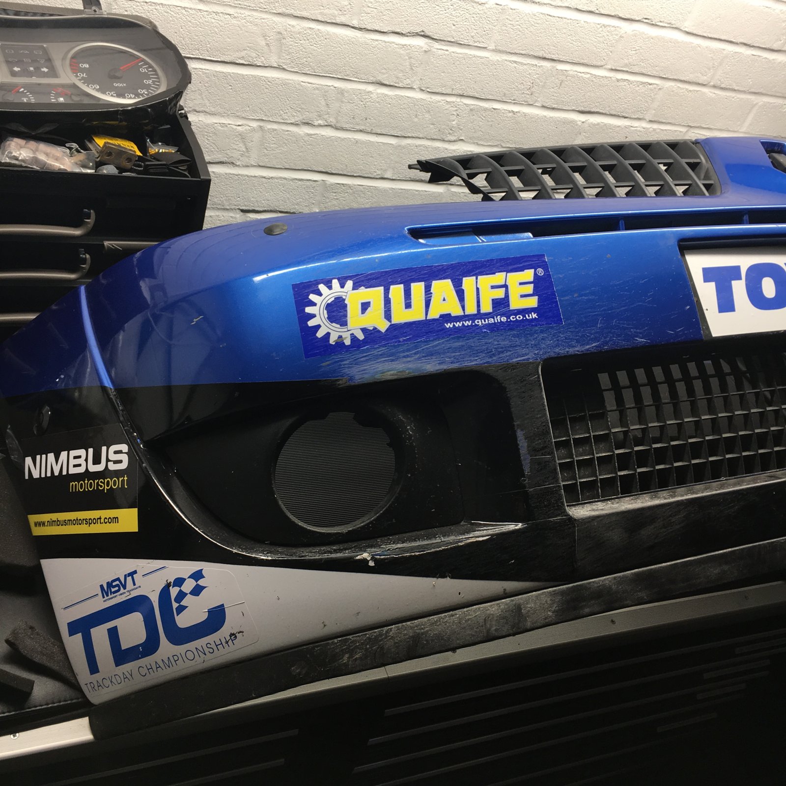

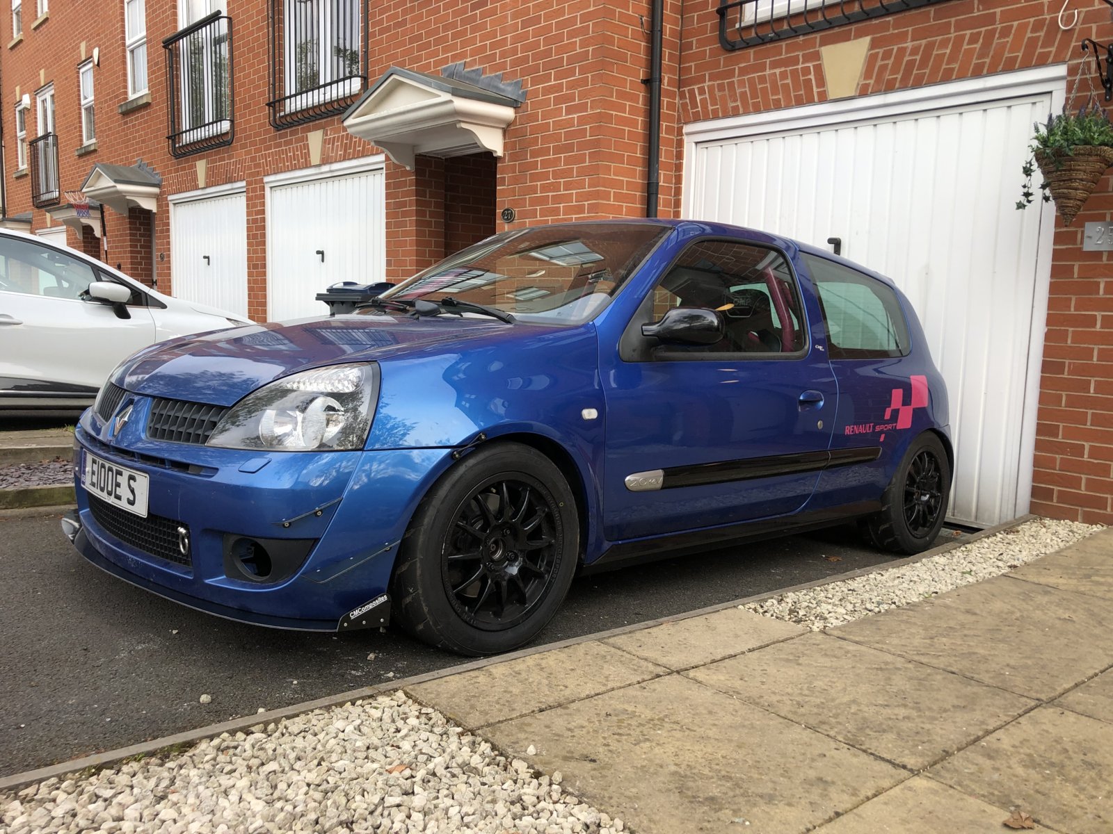

I also had to clean up the front bumper. After my unexpected trip into the gravel at Donington the bumper popped off when they towed me backwards and the marshal decided rather than pick it up he would drag it across the gravel trap paint side down haha. Can't complain if this was the only damage from the weekend!
1418581
All cleaned up and ready to go for the next round!!

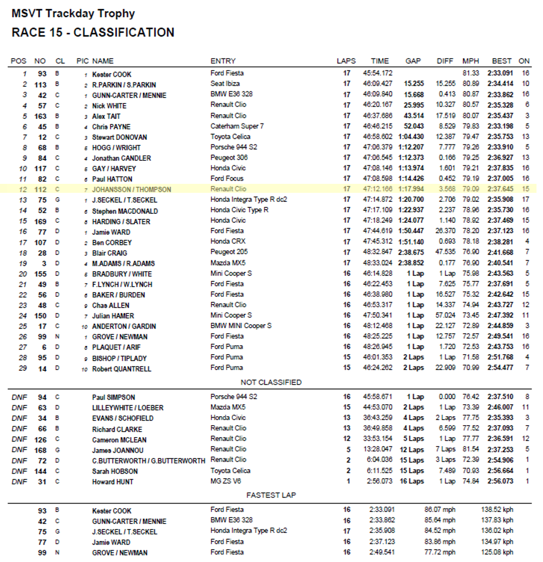

I crossed the line and still went a little quicker, getting a 2:17.701 placing us P13.. P5 in class.. C class pole went to Pete Bennet in his Clio X85 Cup car with a 2:16.265 no pole for us at this circuit!! Booooo haha
1422189
We have found the higher speed circuits suit our car better, where we can keep the momentum up, and utilise the advantage of our lighter car. Snetterton has a lot more slow and medium speed corners where we have found the higher powered heavier cars seems to gap us slightly. The grid compared to Donington was massively different, so these differences were noticed in all classes, not just ours.

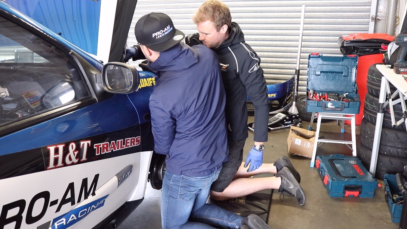

We felt that the most important thing to sort was the braking, it was very easy to lock the brakes as we were running high levels of front camber. As the car wasn't rolling much in the wet we could back the front camber off to regain the braking efficiency.
So we set about reducing the front camber and rectifying the front toe to suit. We also softened off the dampers. Ideally we would have modified rear camber and toe, and disconnected the front ARB.. but this isn't something we could do in the hour we had.
It was a bit of a mad panic as we got called for the Race and we were still mid front toe alignment.. Luckily myself and the team managed to get all the front up tightened up with a few minutes to spare.

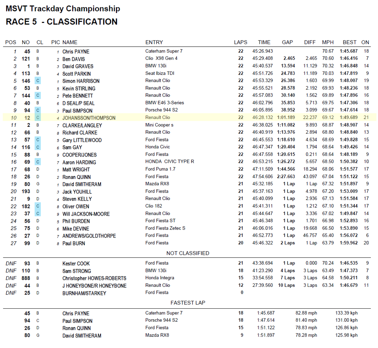

Next up was a trip to Silverstone to sample the GP circuit. This time though it was a round of the Trackday Trophy, which is also ran by MSVT. These races are held to the same regs as the Trackday Championship, but just one off events with Trophies, and no points are awarded. You are also allowed to use any tyres on the MSA list and not confined to the Toyo R888Rs, so there was a mix of different cars on different rubber.
RACE REPORT- RND#5 TDT Silverstone GP
Being my local circuit, less than 30mins, it was a nice change to be able to setup on the Friday and go home back to my own bed for a good nights sleep.
In contrast to the previous race weekend we had a kind schedule:
Qualifying 11:30
Race 17:20
With the car all ready the night before and the weather looking good for the afternoon we stayed with our dry setup this time. So it was just a matter of waiting for Qualifying.
The call came and over Ben and Chris went to the assembly area, while myself and the rest of the team headed to the pitlane as I would be doing the 2nd half of Quali. Unfortunately Quali got delayed due to one of the GT cars in the GT Cup dropping oil all down the old start finish straight and all round Copse. So they called an early lunch for track clean up, leaving all the cars stuck in assembly (as they didn't want to call everyone again and delay the days running)
So and impromptu photo shoot commenced haha
Finally we were let out and a steep learning curve commenced.. With the GP circuit being about a 2:40 lap time and having 20 corners there was a lot to learn and a lot of areas to gain and lose time!.. With Silverstone being a relatively flat track and recently re surfaced it quickly became apparent we were really struggling with Under steer!.. Running wide multiple times through Copse.

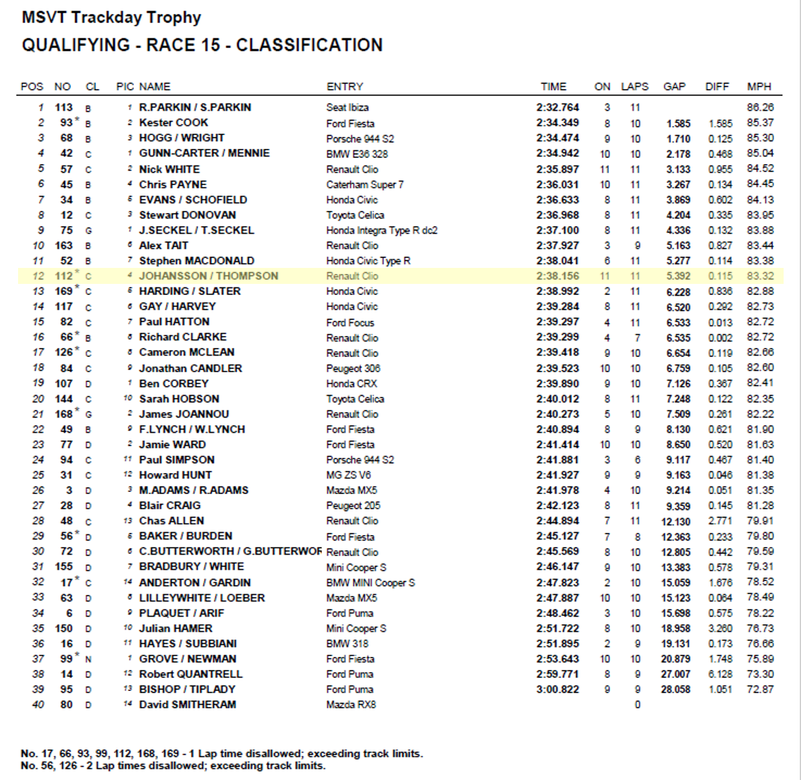

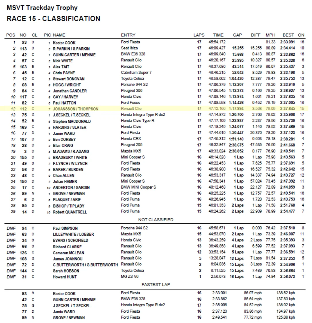

The flag dropped on quali and the results were in. P4 in class with a 2:38.156 (first of the class C's on Toyo tyres and TDC regulars)
Frustratingly, over 3s off pole though! Definitely a power circuit, which we lack as we have gone for low weight over high power.
Speaking to the Parkin brothers of Darkside Developments who grabbed pole (regulars in the trackday championship), they said they had done a test the day before and compared the Dunlop Dirrezas and the Toyo R888Rs and said there was well over a 3s difference, with the Toyos being slower. So if we ever did a TDT race again we'd look to switch to the faster tyres.
With the terrible US we had we set about making some changes. We put some more toe out at the back and upped the rear tyre pressures.. Also managed a front pad change and cleaned up all the grease and siliconed up another J&R OS front driveshaft boot which split! 2nd one this season. Hoping that it had time to set before the race! (a little trick we learnt from Cameron McLean Racing, who has had similar issues)
We decided as this round wasn't a championship round that Ben would have his first race start with me doing the 2nd stint. This way it took the pressure off a little, and made him feel a lot more comfortable.. Ben made a good start and kept out of trouble, losing a place to the #117 Civic which got a great start.
Ben then headed a 4 car battle for 5th position for the next 5/6 laps keeping the chasing pack behind with some great driving, even closing up on the civic for 4th.
On the in lap Ben ran wide on the last corner and a couple of the cars managed to get in front, but Ben dived into the pits anyway, as they went onto to do another lap. I was patiently waiting at the end of the pitlane to jump in for my stint... A swift change and a quick update on the circuit conditions and I was driving out the pits... I left a couple of 2nds on the table as I pulled away a little to late, so we managed a 2:02 stop time. As i came out the pits I was right behind the 4th place #117 civic, which I started to eye up.
At this point the other cars in the battle for 4th/5th had pitted, and as the Civic and I came round the first corner we saw 2 of the cars coming out the pits infront. So it would be a close battle to the flag. However I started to struggle on my downshifts to hit 3rd from 4th.. and on my upshifts to 3rd.. which saw me lose a place to the fiesta and miss some opportunities to overtake. (We found the bearing on the shifter system had started to tighten, so wasn't self centering properly, quick fix after the race annoyingly)
So we ended the day in P12/39 and P7 in class which wasn't too bad considering. (top 3 had great pace all day so wasn't going to be a podium)
We also managed to lap faster, due to the setup changes made and managed a 2:37.645 (0.5s faster than Quali)

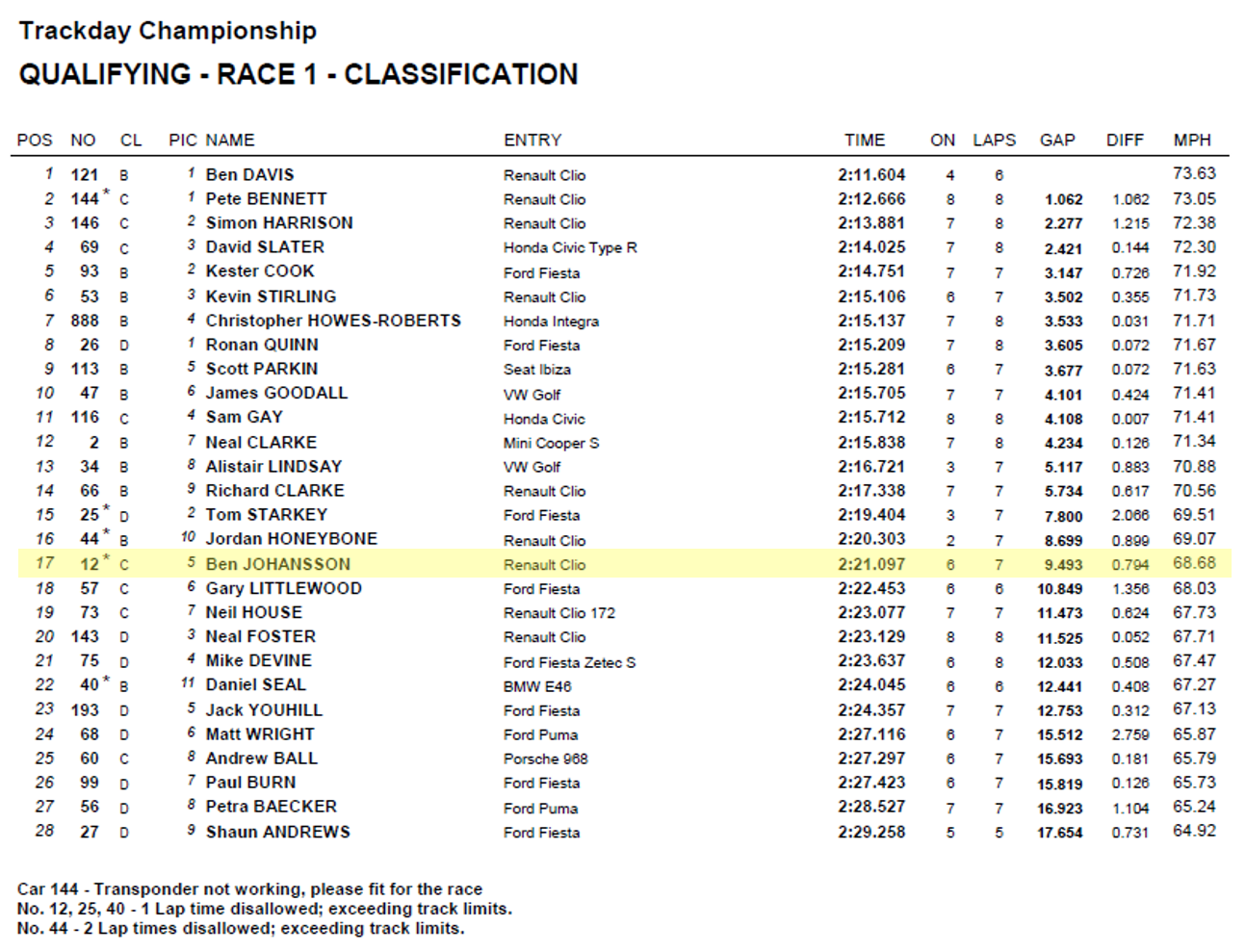

Qualifying went ok and we managed P18 overall and P6 in class. The first 3 were 1 second up the road and then it was close for 4th, with 0.042 of a second separating us. (2 seconds quicker than the other C class 182 so that was a positive)

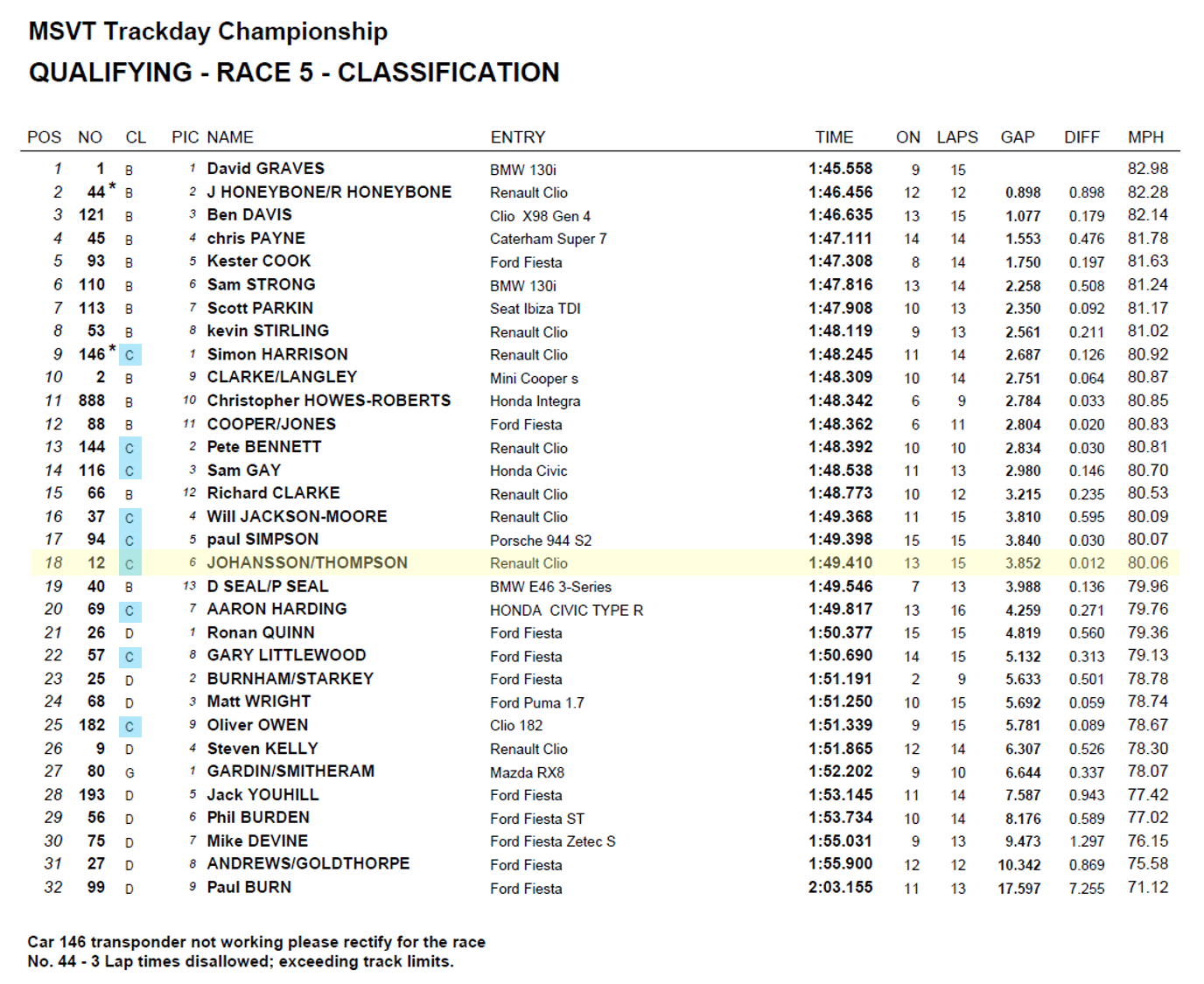

The car felt good tbh.. But we were loosing time on the drive up and out of Surtees... The gearing just isnt right in the Clio, bogging down in 3rd but just about on the limiter in 2nd.. Nothing we could do about that so we just prepped the car for the race and waited.

I got a good getaway from the grid and held my position through the first few corners.. On the run through Surtees I got a heavy tap from behind from the BMW of Red Seal Racing, which pushed me out wide allowing the White Knight Racing Civic to dive past under both of us... Little do we know but one of the D class cars behind had had a big off into the barrier on the way up to Druids causing the safety car to come out.. So as we passed the 4th corner the flags and boards came out so everyone backed off.. We then spent the next 2-3 laps behind the safety car, as it took quite a while to remove the car and clean up the fluids on the track.
Unfortunately the file with the footage of the first lap corrupted when i copied, so the youtube video starts at the safety car restart. (didnt miss much anyway)
After the restart (which i should have been closer to car in front for, lessons learnt) I managed to get past the civic on the next lap with a dive up the inside into Paddock Hill Bend. I then preceded to battle with the BMW in the class above. He had the grunt, but I had the corner speed.. Grunt prevailed though, and he got ahead.
I started to reel in the guys in front, but it was time to pit and hand over to Ben.

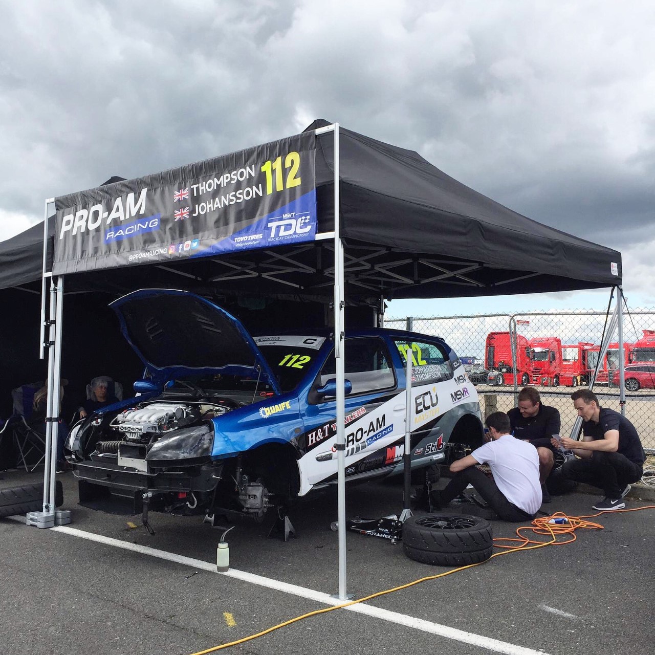

We managed the 2nd fastest pitstop of the gird, with a 2:01.180 .. with most our rivals 10s slower which allowed us to jump up to P9 overall and P3 in class after the stops settled.
Ben couldn't hold off the Porsche behind who was lapping at least 1 second faster than our pace, so it was inevitable really. A little tap from behind at Druids to let Ben know he was there and then the Superior drive out of Surtees saw the Porsche drive past. Ben then sat in a pocket behind the Porsche and 10s ahead of the guys behind.
So we finished in P10 overall and P4 in class.. our 2nd best finish this season. So a good day really. Again the car performed excellently and we both enjoyed the circuit and carried on learning!.
Up 8 places from our starting position so happy with that too
*IF YOUR NOT WINNING, YOUR LEARNING* as they say.

adir
  clio 172
what is the power/weight regulation on your class ,can you go a bit higher, or you already on the limit ?
looks like you have the upper hand in the corners, but not enough on the Straight ...
Tomotek
The regulation for Class C is up to 150WHP/TON and be sit at 148.5 allowing a buffer for dyno variability. (We run ~35kg of ballast to get down to that value.)
Its all relative to the circuit, for example we were on Pole at Donington, which suits our car quite well with the high speed flowing corners where we can keep up our momentum, and the gearing is perfect. But other circuits where there are more 'stop/start' corners and some corners in between gears we come off worse.
Donington and Snetterton are also tracks we've driven a lot so track experience is also something to add to the mix. Some of these boys have done quite a lot of seasons racing. As a lot of people say, bum in seat time is worth a lot of lap time.

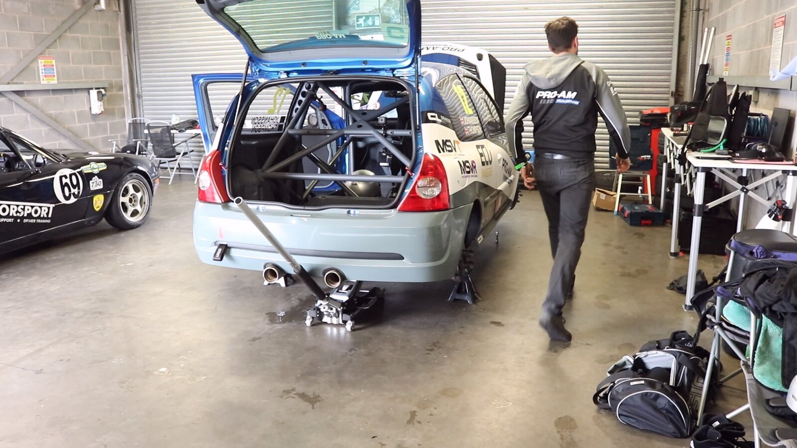

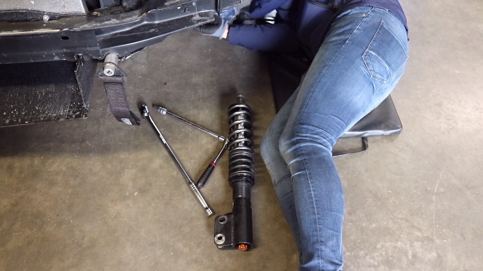

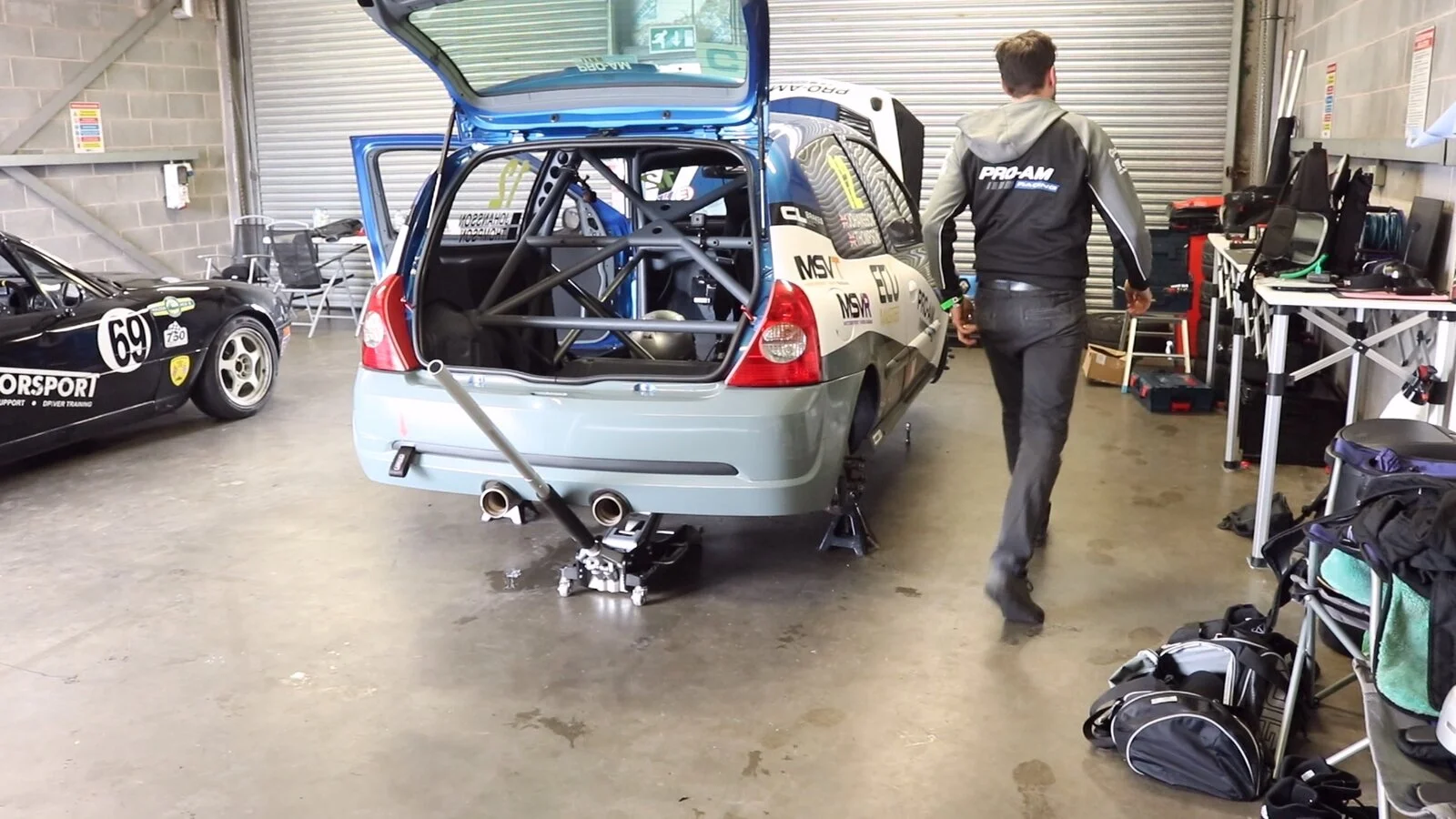

We started the day with a bit of track familiarisation.. Both Ben and I doing a couple of 10 minute stints with our baseline setup. It wasn't long before we lapping at a similar lap time to last time out, so we then did what we came to do and bedded in some new tyres and brake pads etc.

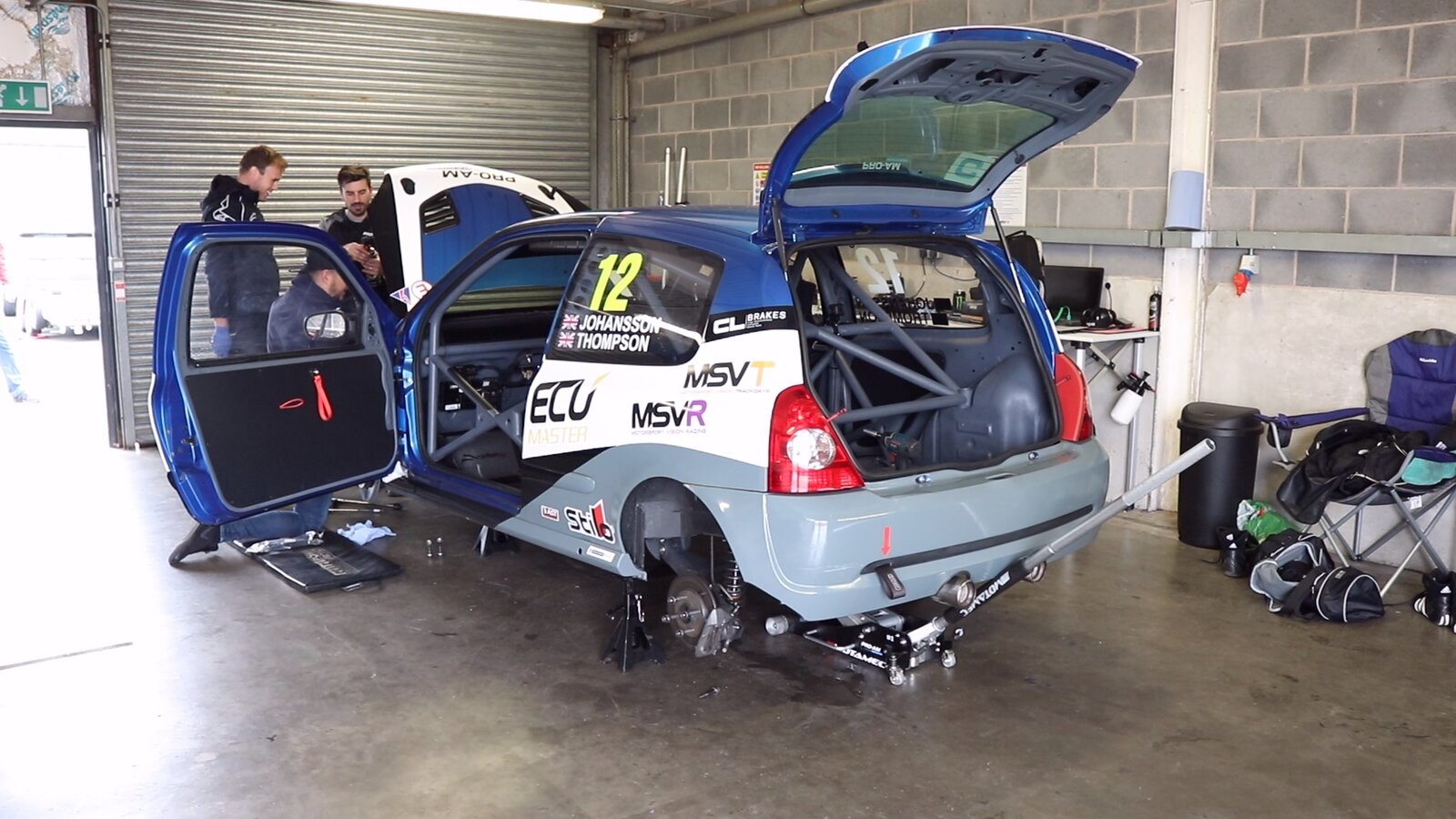

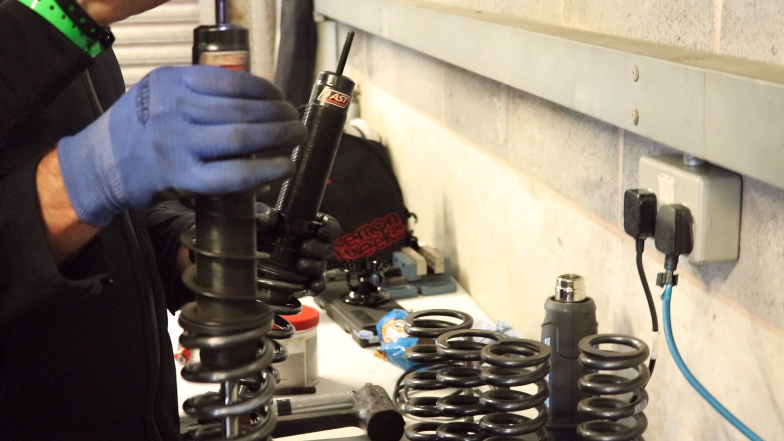

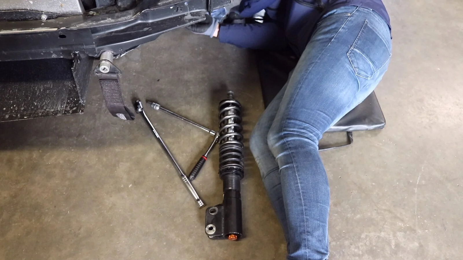

During the lunch break we got the car up on axle stands and started to change out parts of the suspension. We had finally got our own, in house designed, Prototype Geometry Correction Kit (plug and play with OEM Renault Hubs) machined and built up, so this was fitted. Roll Center and Bump Steer Correction.
We also softened off the overall spring rates front and back to match the changes we were making with the geometry. AST uk sorting us out with a quick supply of springs, just in time!

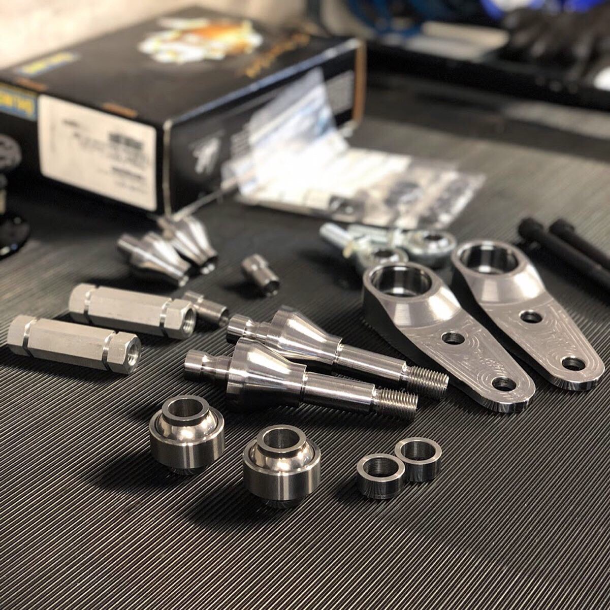

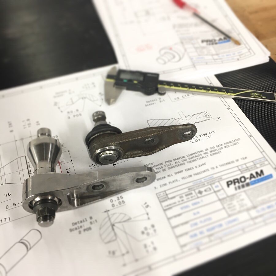

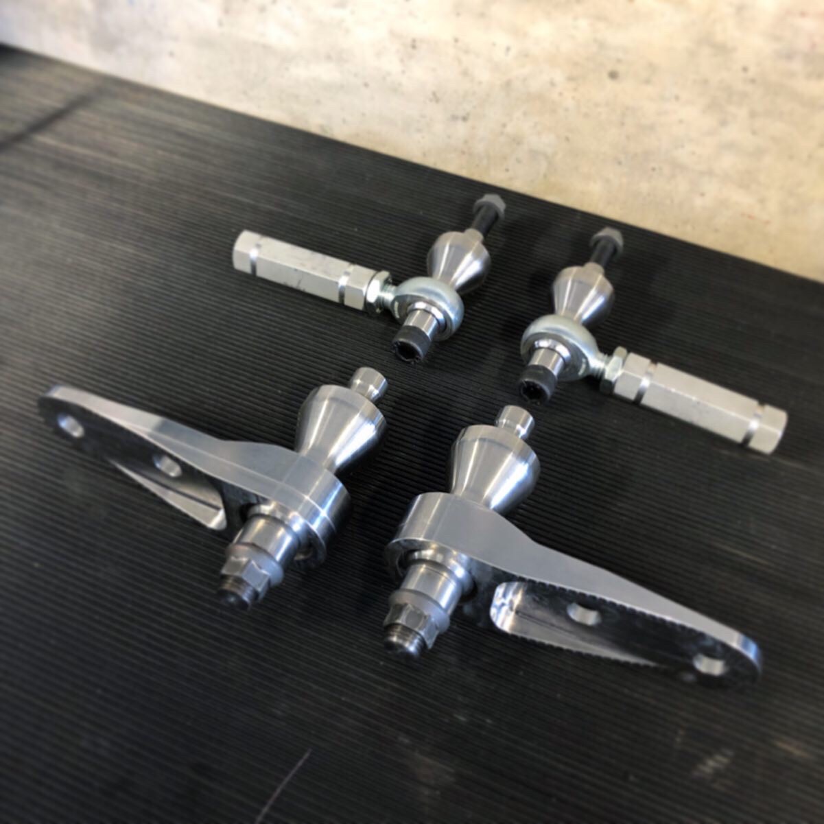

As most people will know a few versions of these have been floating around.
The kit is used to adjust both the front Roll Centre height and reduce Bump Steer.. With the excessive lowering of race car and track car Ride Heights (to bring that critical Centre of Gravity down) front suspension geometry is drastically altered.. This alteration causes High levels of Front Roll which has to be combatted with Higher than optimal front Spring Rates to support the car through high speed corners, thus reducing the cars low / medium speed mechanical grip and turn in response.. Higher levels of Camber are also required due to the large front roll, which can be difficult to achieve, and which also reduces available tyre contact patch (essential for optimal traction when accelerating and braking!)
With our kit we are able to raise the Roll Centre height by lowering the outboard ball joint Centre, thus reducing front roll and correcting all the above issues!.. In parallel the bump steer correction kit is installed to reduce the sensitivity of the car and the steering to any single wheel bumps in the track, providing a more stable and smooth ride around even the bumpiest of circuits.
The team worked hard to get all this fitted within the hour
One of the unique features about our kit is that it has been designed with adjustment on the RC height. With the integral spacer you can tune the RC height to 2 stages, depending on the level of ride height drop you have on your car... Or it can be used to tune the balance by increasing the roll at the front, for wet weather running, where the softer front end is beneficial to grip, and providing a safer 'more understeery' response. As we all know these Clio's can get a little tail end happy in the wet.
We then went out and with the kit set on stage 1 (the least adjustment). It was instantly noticeable how much the understeer was reduced, and turn in improved... It took a few laps to re calibrate as we were turning in to soon (as we pre-empt the understeer normally). It was also noticeable on the long back straight, which is rather bumpy, how little inputs were being felt at the steering wheel from the road. Normally you have to fight with the steering wheel to keep the car in a straight line some times.
We were impressed so far, so we came in and quickly adjusted the system to stage 2 (the most aggressive raising of the RC height)
Again another step change in performance was noted. More than anything the increased confidence that the car would go where you pointed it was amazing.
We then set about doing a couple of race simulations in the afternoon, to get some mileage on the parts. managing over 250km in the afternoon, so a decent amount of running.
So we ended the day very happy indeed, and confident going into the race the following weekend.

Nice write up, I'm sure you are aware of a certain RC setup that fails on track.
You definitely know your stuff regarding engineering so I'm sure your kit will perform perfectly and reliably.
I also know what you mean regarding the turn in! I have Mr Northloopcup's setup and at Croft in August I couldn't believe the transformation, paired with the gripper diff it was unbeatable
Tomotek
Hi Michael, yes i'm aware of the issues that the other RC setup has had 😓 .. I've seen a few posts people have put up.
Appreciate your vote of confidence! (y) .. Our design is fundamentally different and doesn't feature stress raisers in critical areas, and we have been very vigilant with our material selection.. We are also proving out our designs on track before we machine the first batch of parts to sell. We have around 500km on the parts now, with another 150km going on at the weekend at Brands Hatch! As you've seen, I pride myself on quality so wouldn't want to offer something without testing it thoroughly first.
Haha, love the vid!.. seeeee yaaaaa!.. nothing in the same category comes close as you say
1985michael182
We all know the quality of your work and your engineering background and attention for detail. These will fly off the shelves once you've finished testing and can put your seal of approval on them.
Next you need to create a decent 4pot brake package that fits under 15s with out have it bastardise anything.
Tomotek
Thanks, I hope they will.. I'm always open to looking into other parts to develop if the demand is there!. so if you can think of anything let me know.
I love it when people develop their own stuff, and I'm also interested in these parts.
But doesn't the bumpsteer need to be altered again, between the two stages of the Roll Centre kit?
Hi mate, yes your correct, the bump steer needs to be altered too. There is a matching adjustable spacer on the track rod end attachment too.. Its under the head of the bolt and goes into the rose joint, seen in the pictures above. This is simply flipped over.
