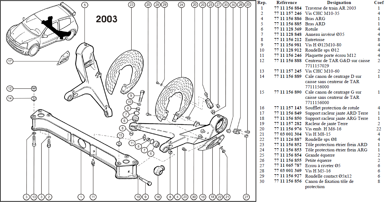

What about some castor adjustable, camber adjustable, bottom arms to compliment the RC kits ?
I'm thinking about some castor/camber adjustable top mounts. We want to be able to quickly change the setup as we have highlighted that as an area we are weak at. So having the adjustment at the top means we can leave the car on its wheels and do all the adjustment with the bonnet open. I also want to be able to change spring rates quickly so we can change between wet/dry.
So I might also make it possible to replace the front springs without having to take the dampers off the car!
We are looking into lower bottom arms too. We want to replace the powerflex bushes with some proper spherical bearings.
That means taking them out from the top right? (y) :)
Yeah exactly.. I want to be able to remove the top mounts quickly and slide the springs up and out the top.

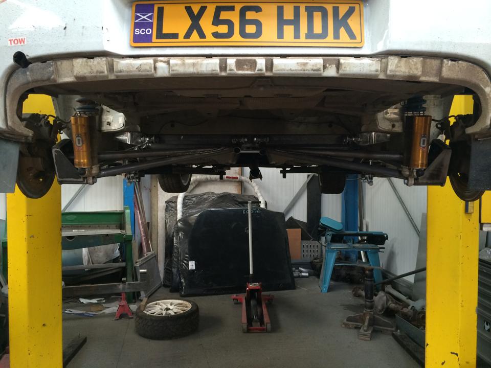

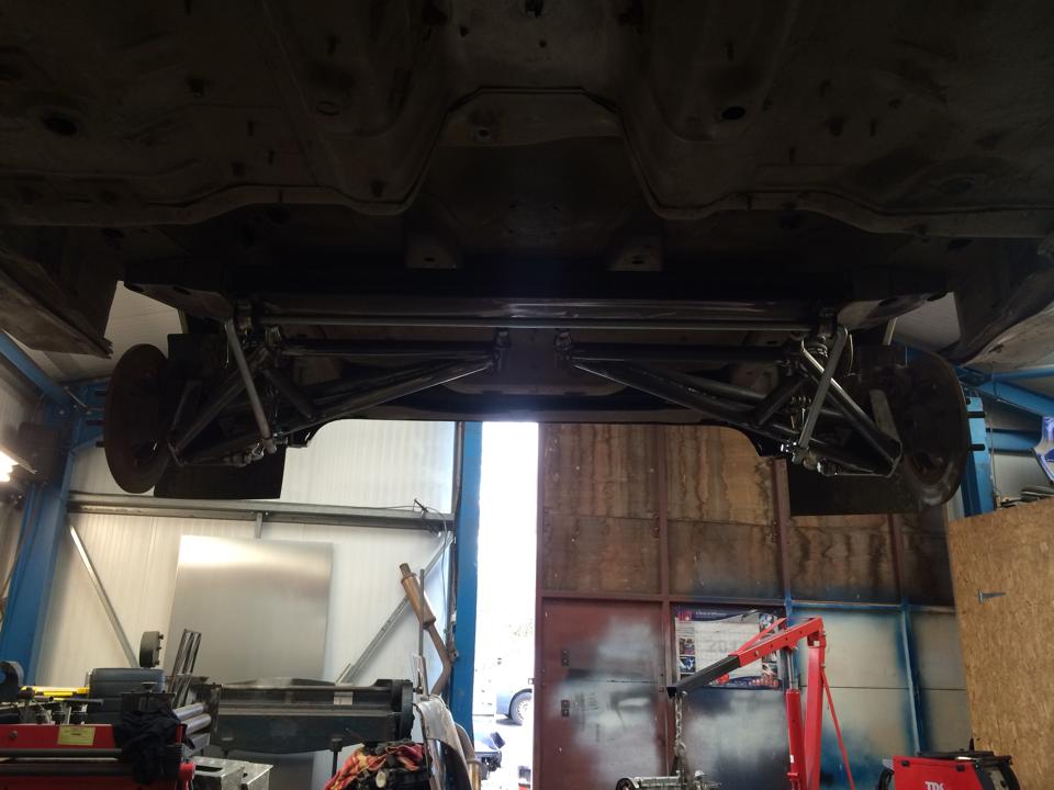

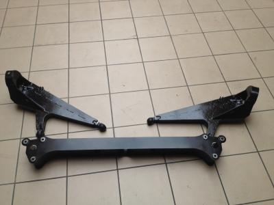

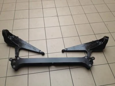

I have seen this before!.. It is a good idea, would need a decent ARB to go with it.
Made sense on the rally cars because of the wheel travels they needed, and the extreme bumpy roads to have independent suspension. Not 100% sure how much time you would gain on a track focused Clio. Only one way to find out though ;) how many shall i design and get made haha?

There are definitely gains to be had by ditching the twist beam on rally cars. All the teams did it back in the F2 days. As you say, there are good gains in travel for one thing, but twist beams are also a pain in that your toe change is non-linear, which isn't helpful, especially on rough surfaces where you want the car to be predictable. On a track car, where the travel is much reduced, you wouldn't suffer the effects so much, so the benefits are more limited. As @Tomotek says, you'd need a decent ARB along with it, because you lose the roll resistance of the twist beam once you go independent. Easy enough to fit an ARB to the back though of course, it would just need to be thicker than the usual PMS/Whiteline type deals. The ones on my F2 car are mahoosive, front and rear.
You may have to move the fuel tank into the car too, which adds to the cost.

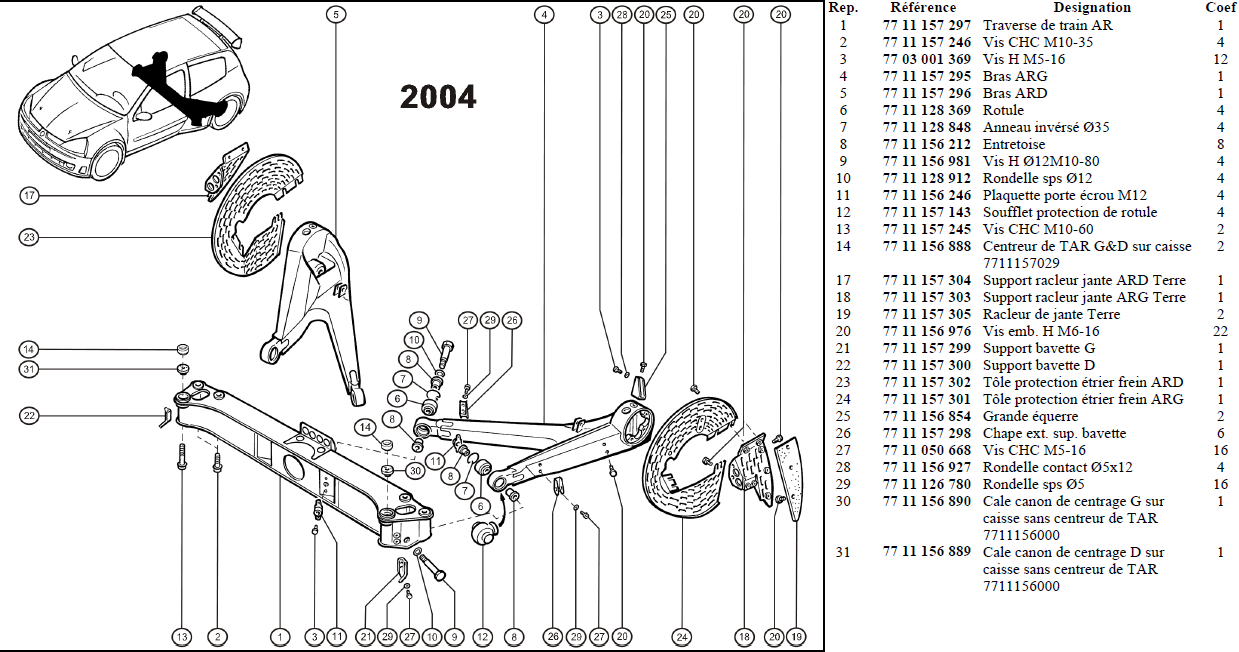

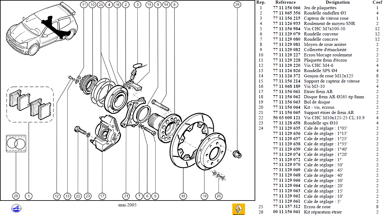

From all I have heard from people racing clio’s (and other fwd cars) is that they set up the car to basically drag the rear around, and this is the best way to set them up. Do you think the outlay to develop/manufacture these on a one off or group buy basis would be worth it for the benefit?
The benefit would be that with independent rears it allows you to run a softer spring rate and a separate rear arb. But you’d then need either a custom rear arb, or better still, a blade rear arb to allow adjustability. But, then you’re into research and development just for the arb. No such thing as a one size fits all.
Outlay vs benefit is a difficult one really, but, I was told that the standard hubs wouldn’t stand up to the roll centre correction, and there wouldn’t be any noticeable difference....I was also told a carbon r3 maxi evo wouldn’t fit in the engine bay of a mk2....
I guess I’d say it’s worth it just to see if there are any benefits!
I think as Mark said it gives the ability to fine tune the setup and have a more stable rear end, but with the ARB still have a stiff enough rear end to get the car rotating.
Mark I think you have it spot on.. It all depends on how much effort you want to put in, and with that you can get anything to fit/work.

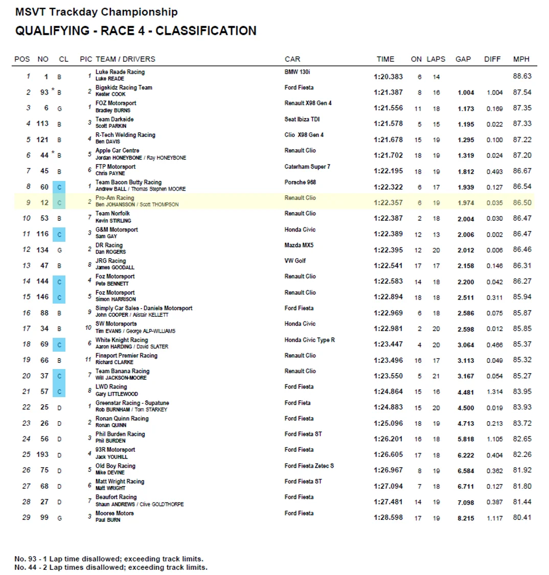

We were as usual the first group of cars on circuit for qualifying, so the track was cold. Ben went out first and put in some great laps, commenting on how good the car felt, especially now through the medium/slow speed corners. His time put us on provisional pole position in class at the half way point before the driver changes.
Ben Rnd #1 Best Quali Time: 1:23.501
Ben Rnd #5 Best Quali Time: 1:22.357
On comparing his lap times from earlier in the year (very similar track conditions), he managed over 1 second improvement!
Normally, we see the faster times coming in the 2nd half of qauli as the cars and tyres warm up and the track evolves. So we were expecting to drop the times in my stint.
I started well, getting into the low 1:23s straight out the box. before getting down to 1:22.454, but I was really struggling with snap oversteer coming into the medium speed corners. It felt like the rear tyres were starting to overheat as the track got hotter. So I pitted to have the pressures checked, Indeed the rear tyre pressures had shot up over 0.4bar higher than we normally run. So an adjustment and out I went. Unfortunately I wasn't able to make it back round in time to beat the chequered flag for one more lap.
Scott Rnd #1 Best Quali Time: 1:22.465
Scott Rnd #5 Best Quali Time: 1:22.454
Unfortunately the new entry for this round of a Porsche 968 managed to beat Bens time. getting a 1:22.322, so 0.035s faster!.. close!
