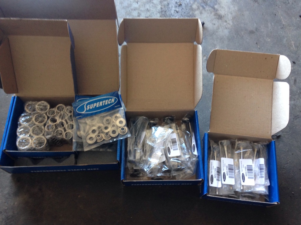

Large port head with super tech valves,springs and retainers

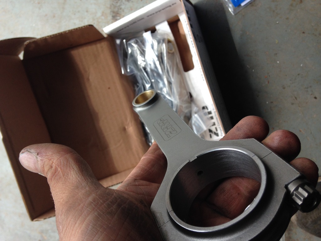

ZRP Rifle drilled forged con rods

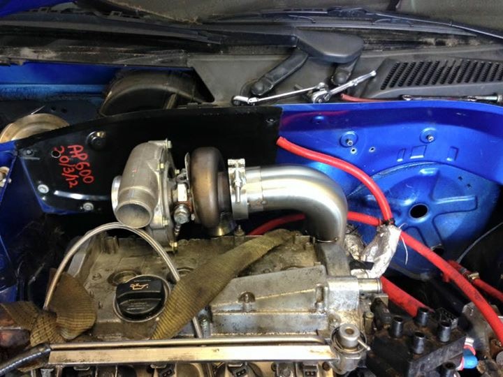

GTX3071 (may even go GT35)

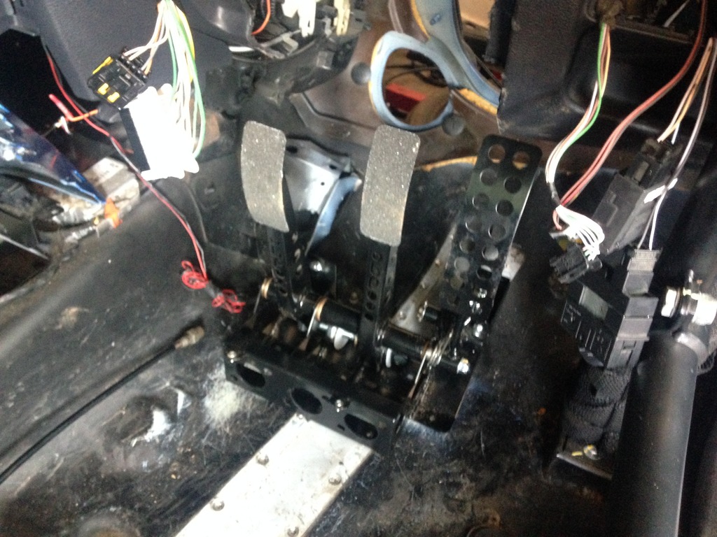

Will have a Dash2, and remote pedal box to get rid of my clutch issues (master cyl over heating due to turbo/manifold)

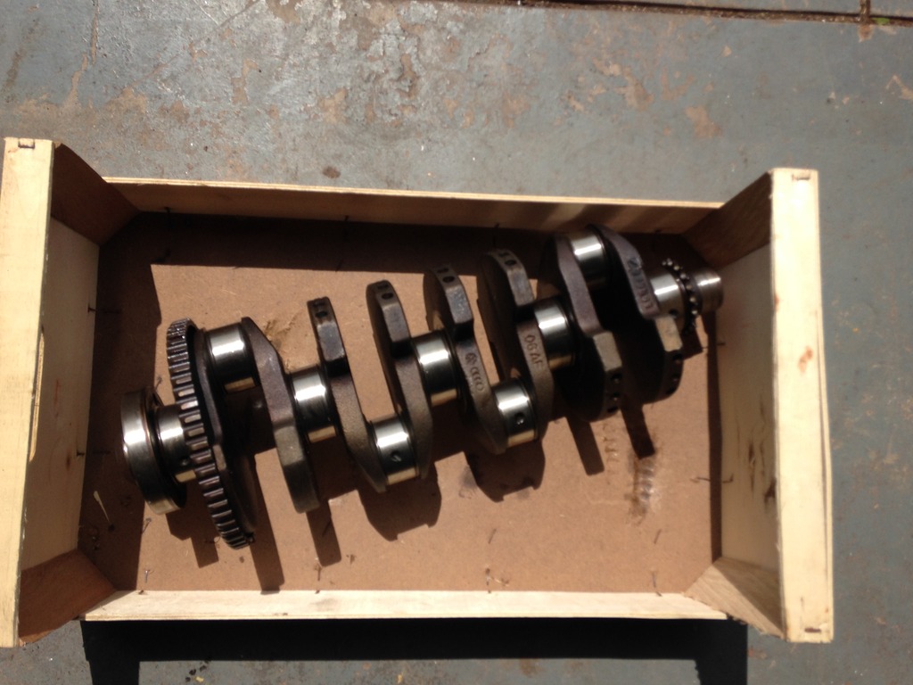

2.0 crankshaft
ZRP Rods

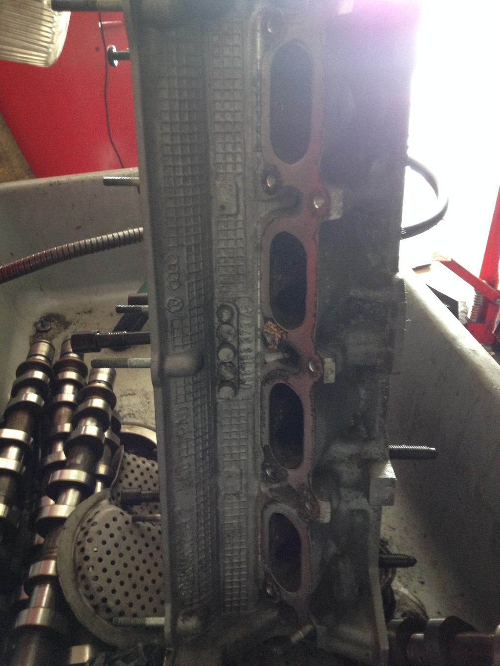

Large port head

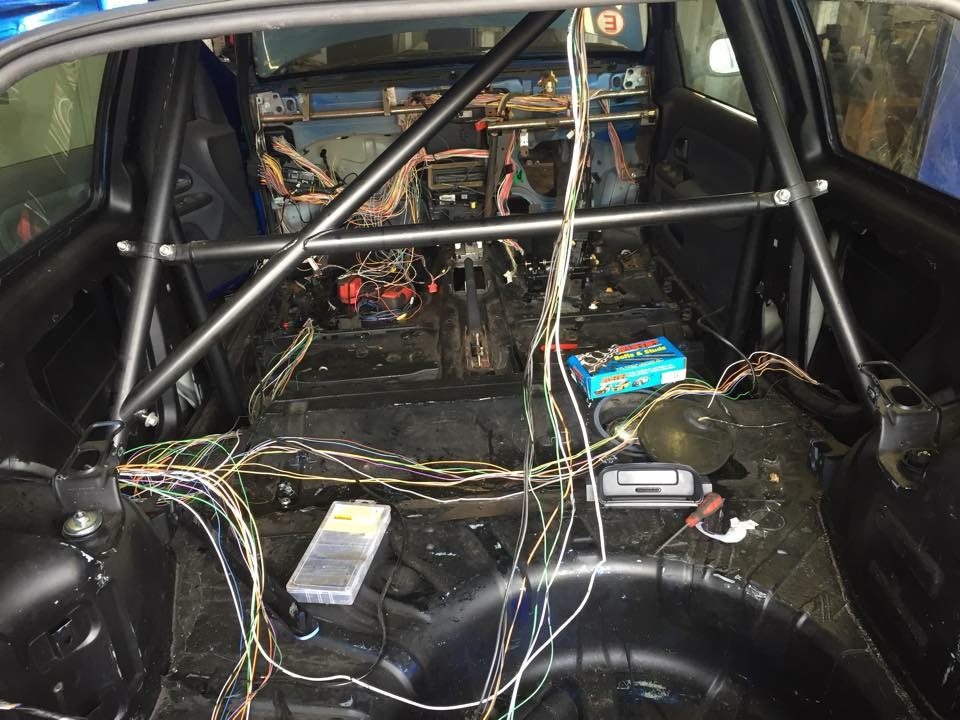

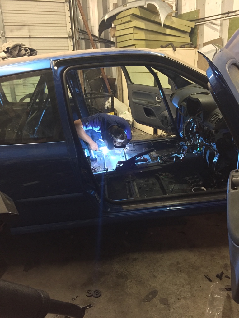

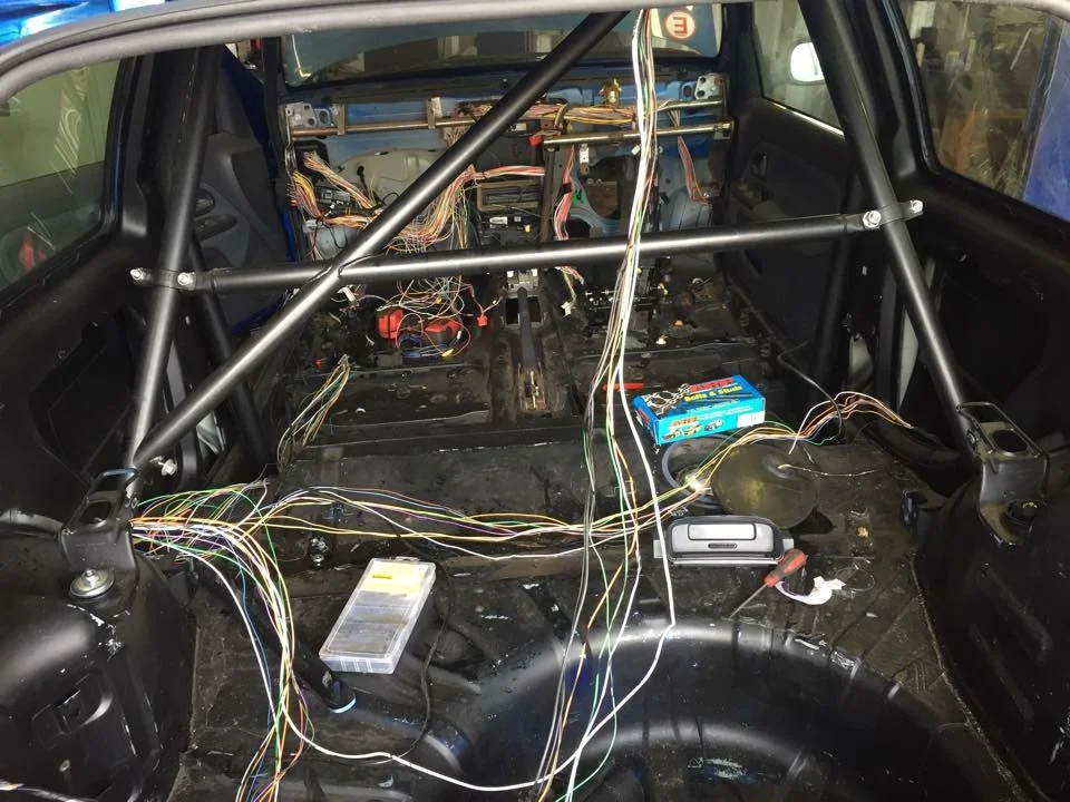

Loom is all back together, @Stopherson has popped up a few times and we've had the seat rails welded in, sadly no pics of that.

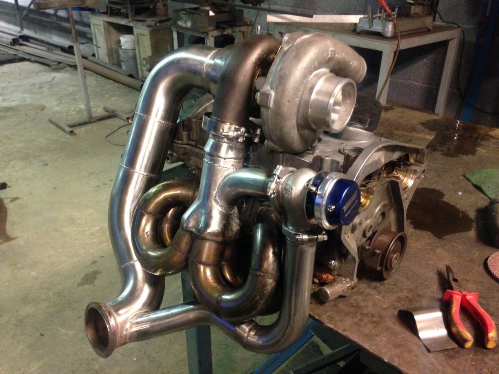

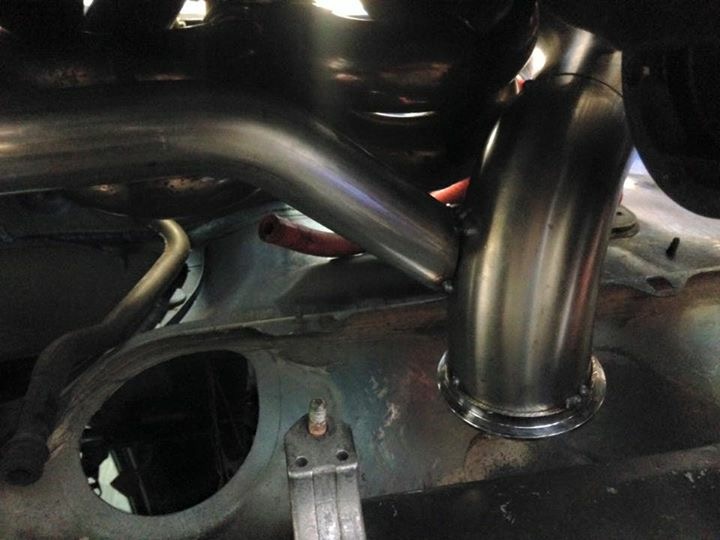

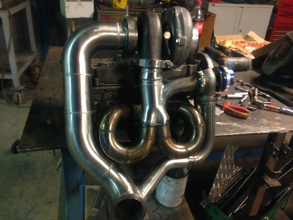

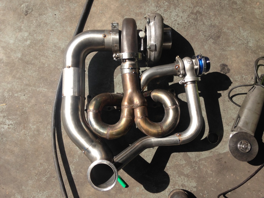

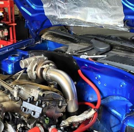

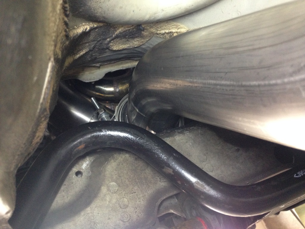

Downpipe parts:

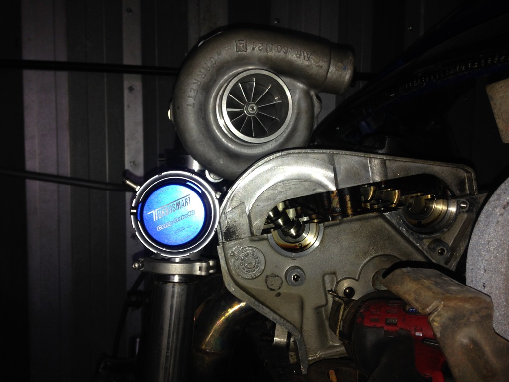

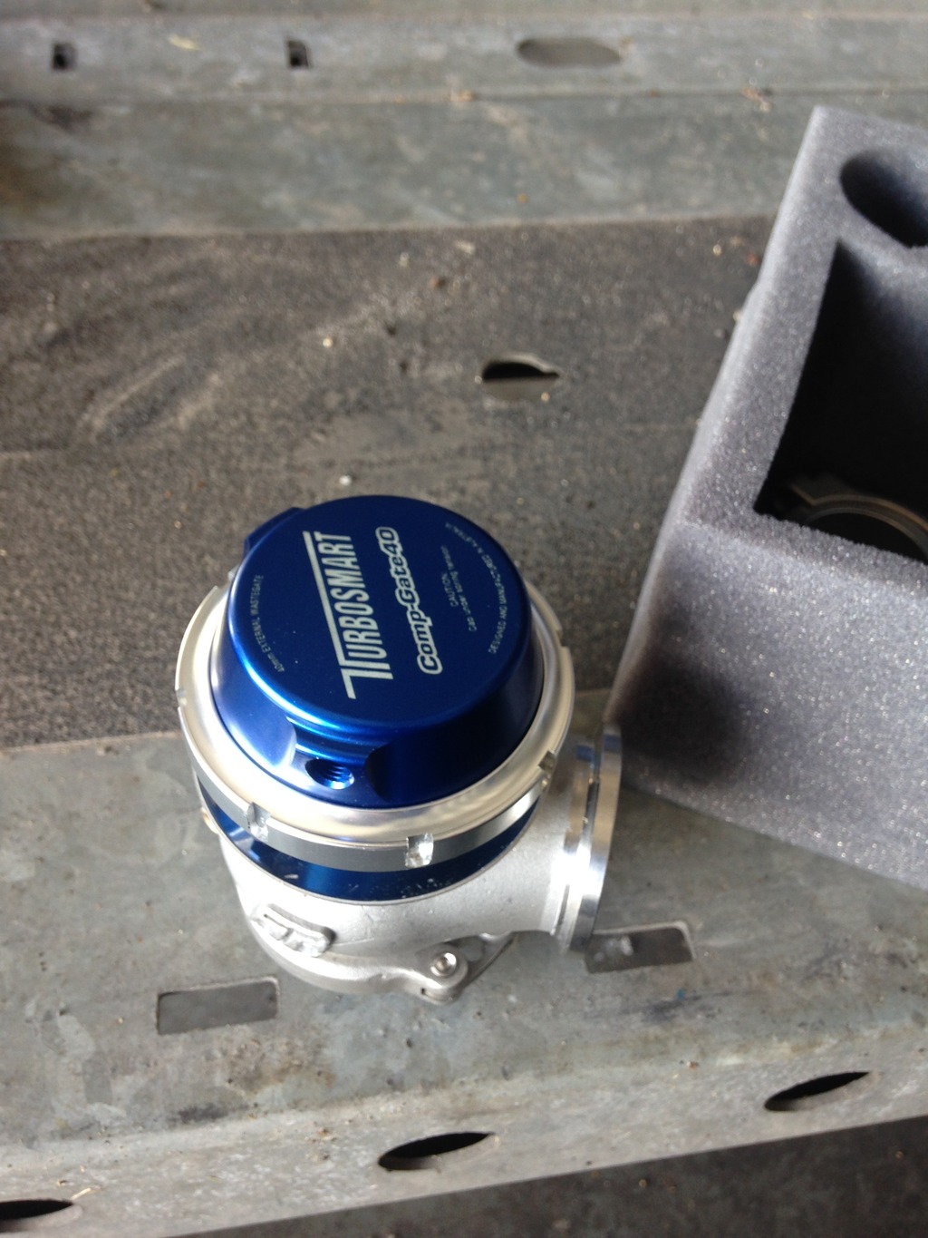

Turbosmart compgate external waste gate

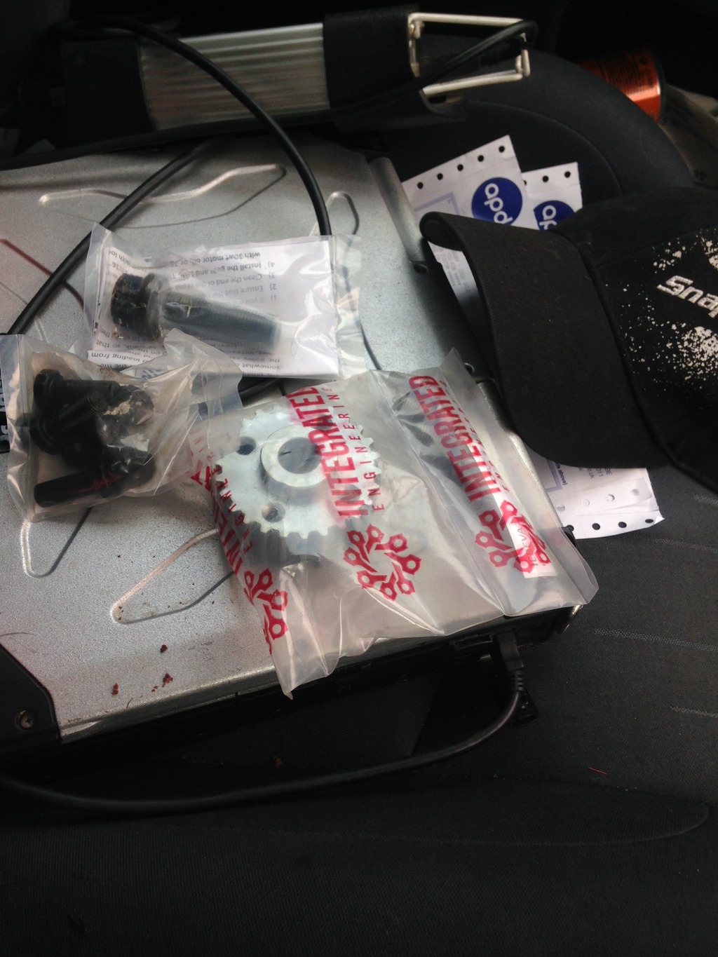

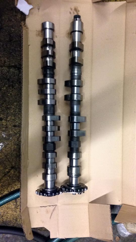

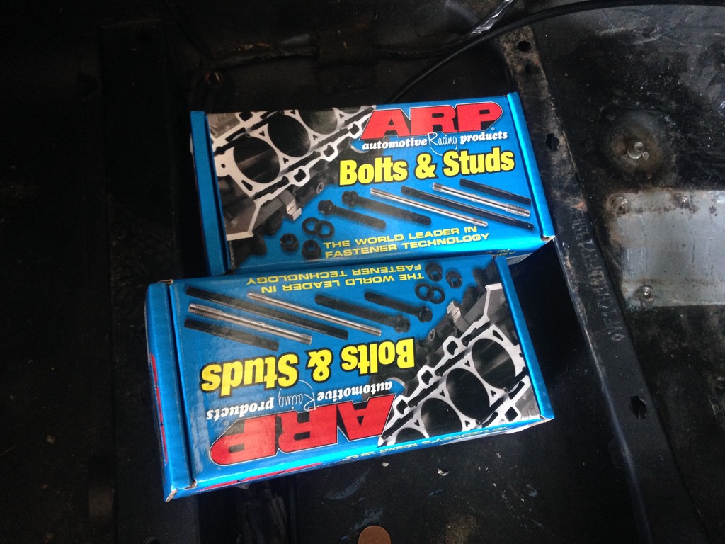

Then popped up to badger5 today as I was on trackday support for a few guys, and ordered my cams, but also came away with a billet interference fit crankshaft sprocket, ARP Crank bolt, ARP Flywheel bolts.
Engine is coming out the grey one this weekend to raid the clutch and flywheel to get the whole bottom end assembly off for dynamic balancing.
