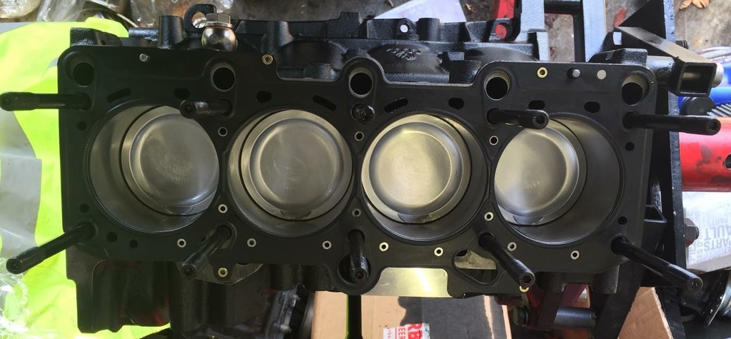

Dan@SJM's 1720v cup.

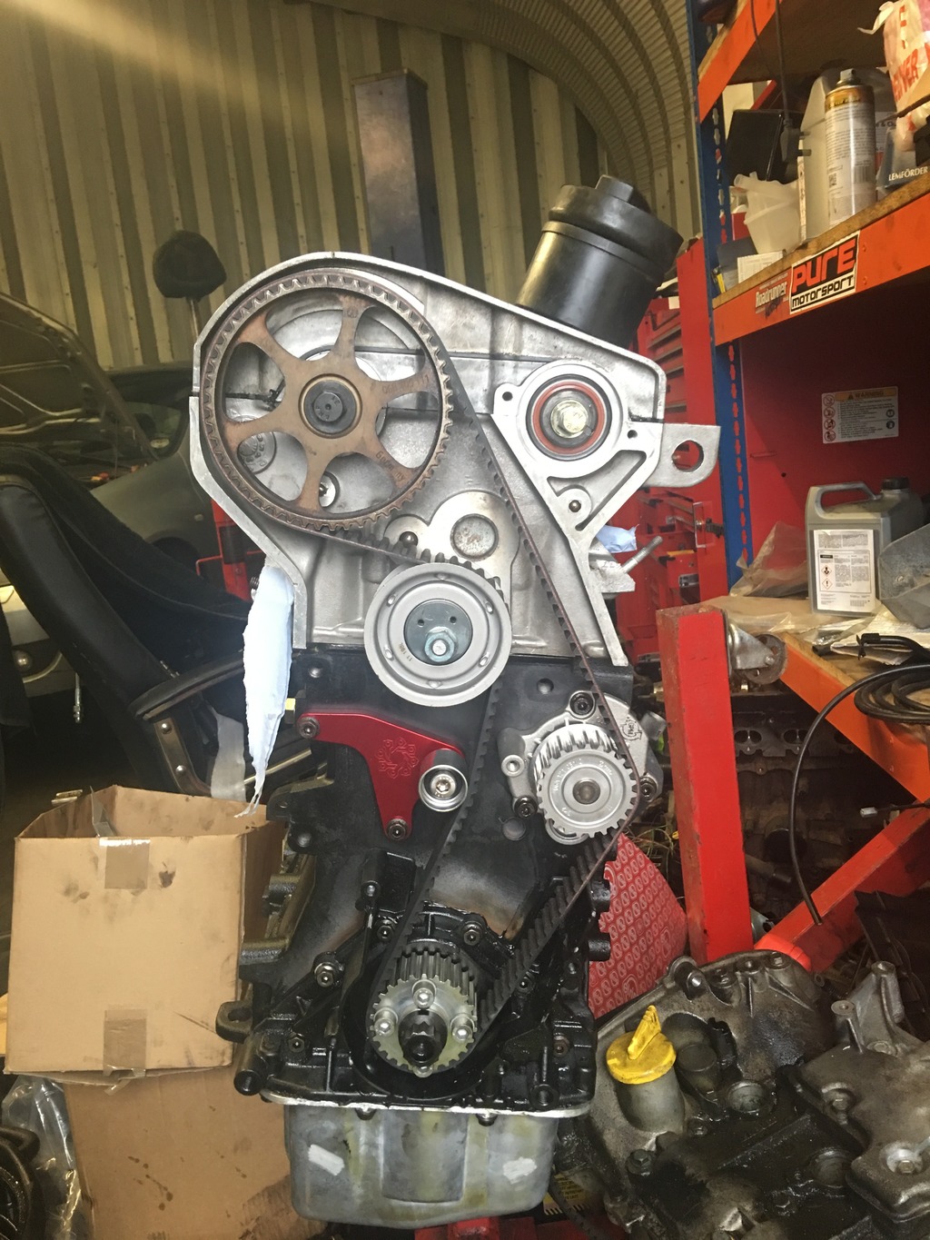

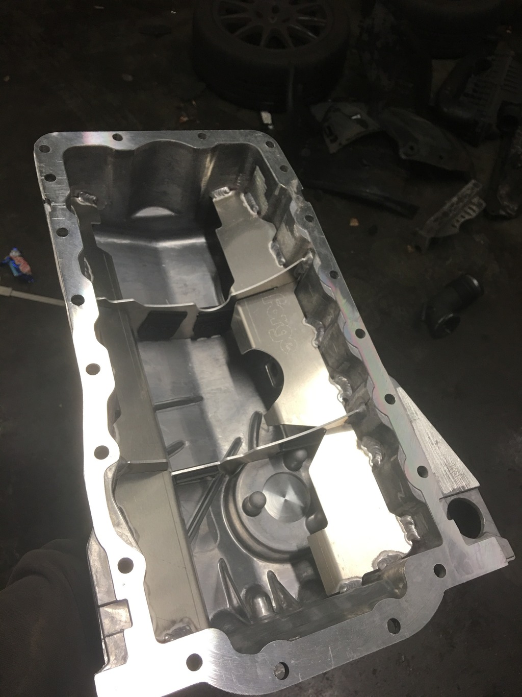

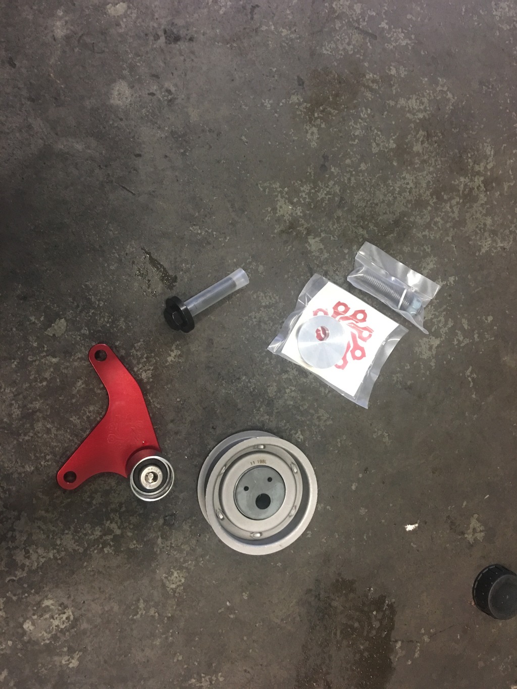

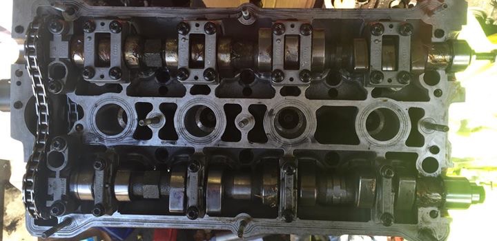

Should update this really, bottom end built, head back from having the Lash adjusters machined. Sump arrived from forge. Just waiting on the manual tensioner and ARP camshaft bolt from Integrated engineering, and a new cam chain tensioner.

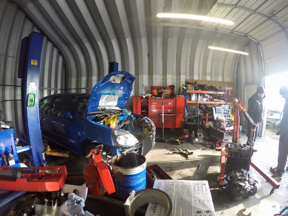

Well @Stopherson came up a few weeks back to Give me a hand and to get his MOT done. So we cracked on with the cup.

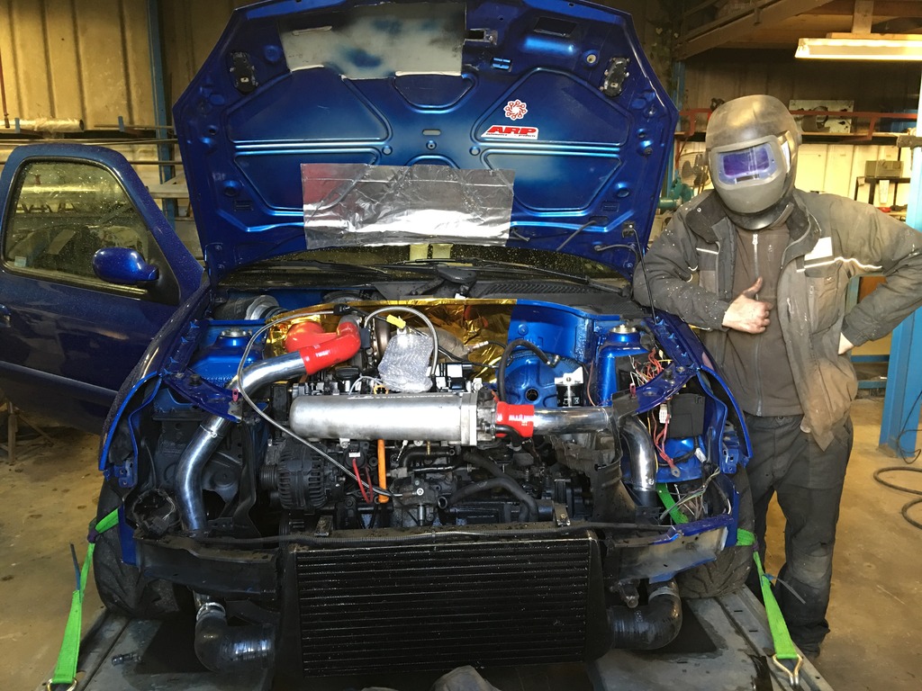

No pictures taken, but the subframe got welded up a bit more substantially this time, so no cracking! Then we set about getting the new engine in. And these are the only 2 pics for the day lol.
I've bought a pipe bender and some pipe to attempt hard piping the intercooler, but it just seems to want to kink no matter what I do :( tried the usually compacting with sand but it didn't work.

Should be a pretty interesting motor once done, is the slam panel cut (looks like the intercooler interrupts it)

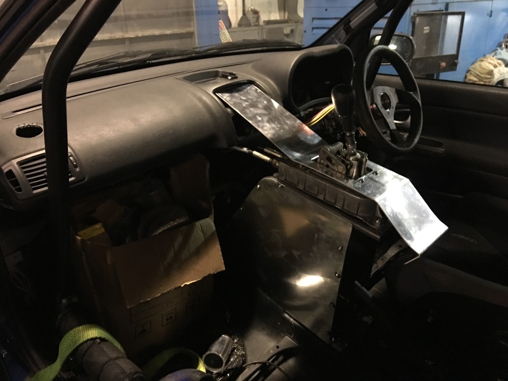

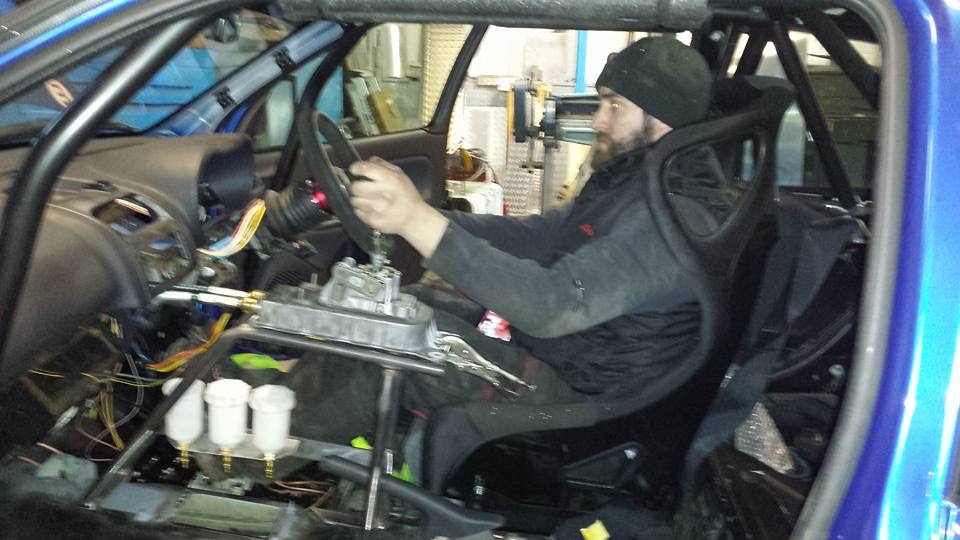

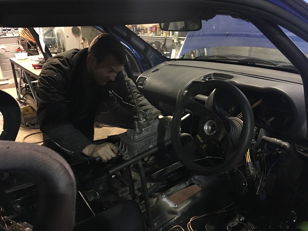

Centre console, in pictures it does look very high, but I can't seem to get an angle that actually portrays where it is. It's a bit higher than I planned, but sadly handbrake functionality denoted it was this high. It's inlu actually about an inch higher than the centre of the wheel.

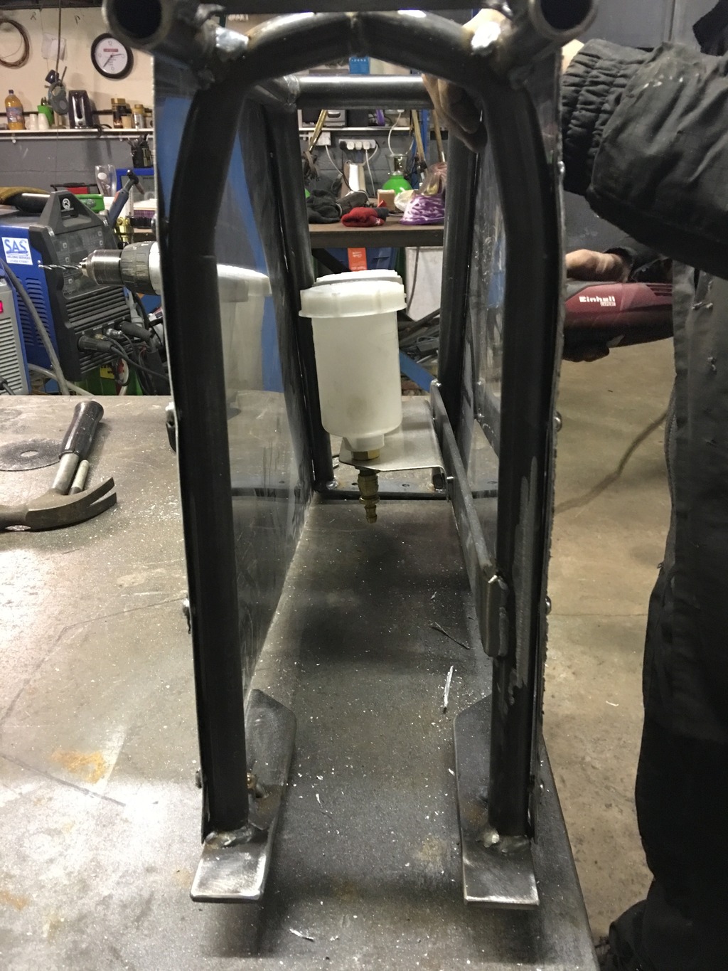

Brake and clutch reservoirs fit nicely inside.

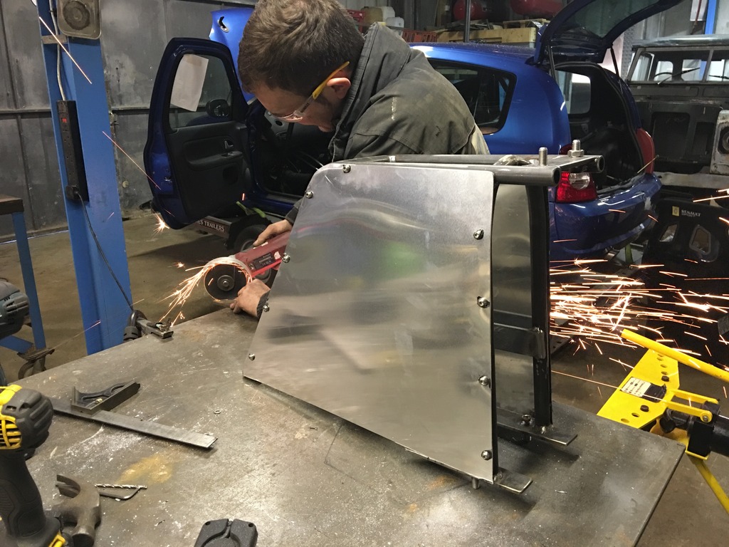

Switch panel (not finished, needs the sides welding on but we ran out of time today)
I've also sorted a panel for the swirl pot and fuel pump, and a checker plate floor pan to cover the master cylinders.
Is that not going to hurt like fcuk if you have a whack on track??

How high is the gear lever when your hand is on it to select gear mate?
Maybe a side on shot with your hand on the steering wheel and one on your gear lever would give you a good pic. You'll obviously need an assistant to take the pic though!

I will add that the gearstick position is actually alright - you think it is really high, but when you're sat in the seat it actually feels nice - a little different but not bad in any way.
Maybe for tall arses like you.

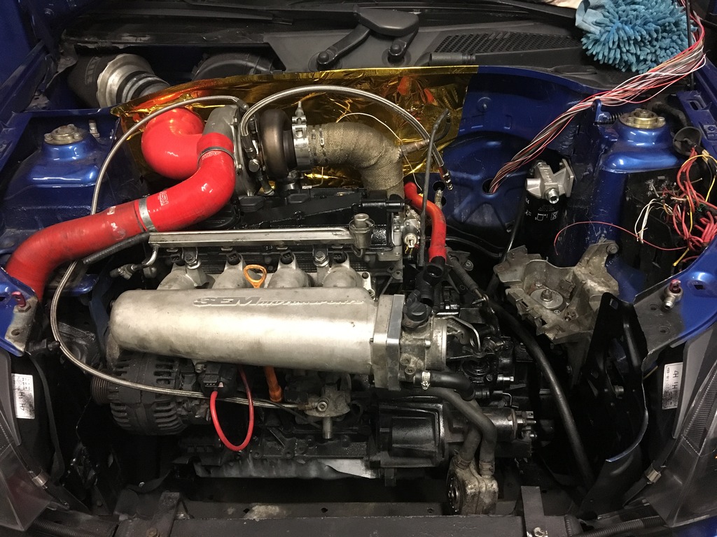

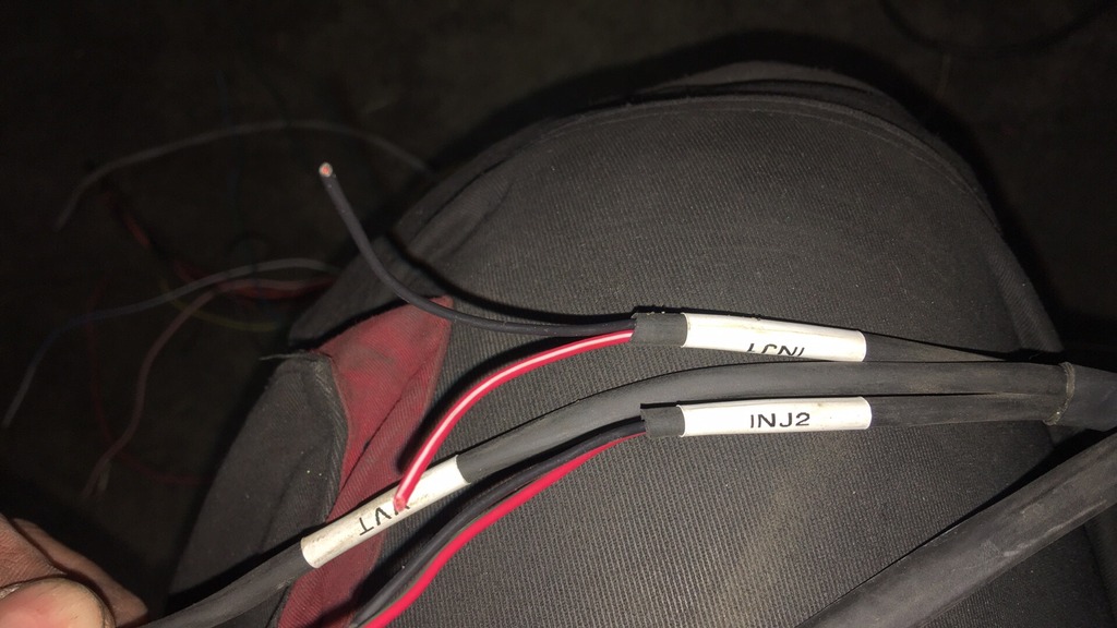

Engine was in, then I set about wiring:
Then did the interior loom (no pics) but did set it up so I can have mains only (just as a 'I'm coming' setting on track after having a few near misses with people underestimating my approach speed.

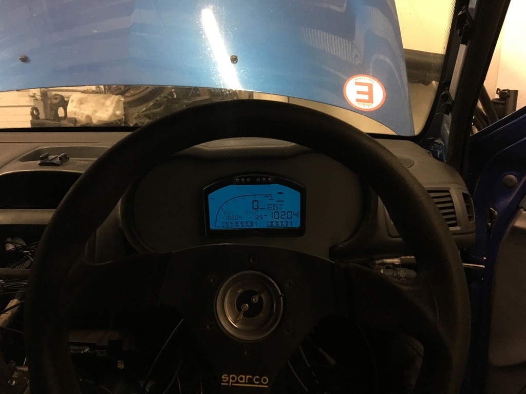

DASH2 wired up and functional.

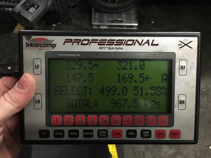

Total weight.

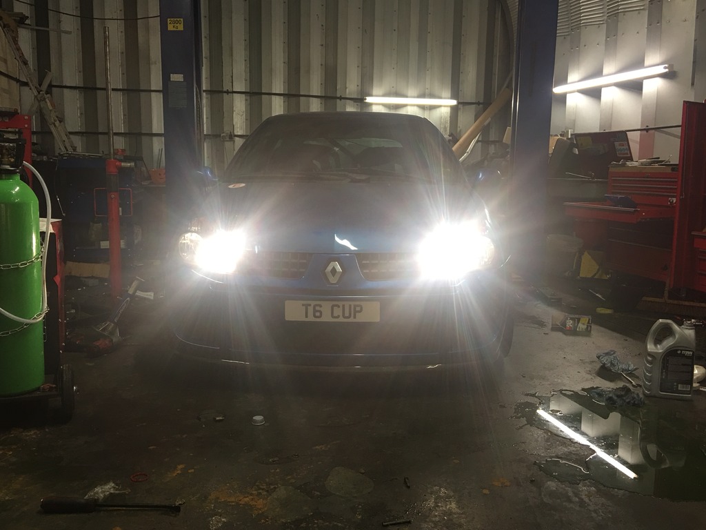

Then it was onto running in and mapping. Unfortunately this didn't go to plan.
After running in and an oil change I started doing the low end mapping. This all went well. Decided to try a couple of gate pressure runs. First pull with a footballer map (rich and retarded) did 249 at 0.6bar peak. Tweaked the fuel table and started another in which I noticed a rattle on the way up so immediately killed the ignition and got out to investigate.

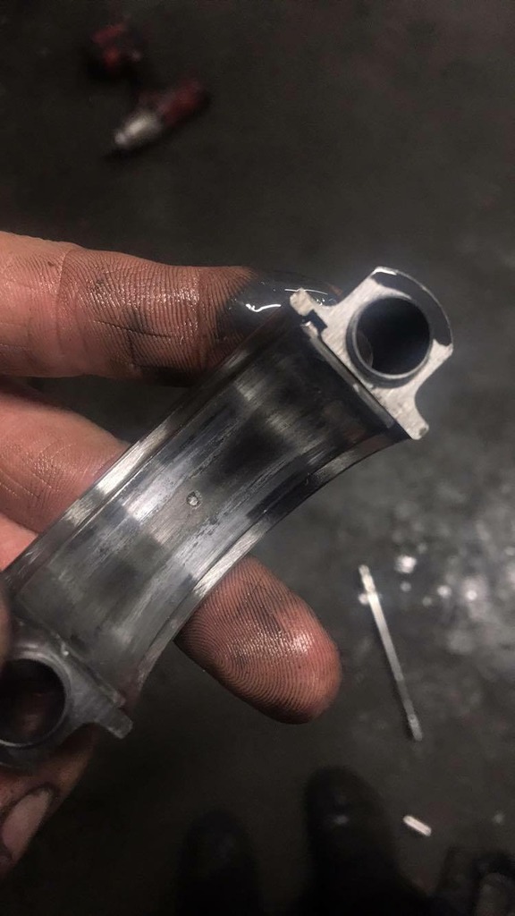

With the Fuchs Titan race pro being red, the dyno cell looked like a murder scene. Nice spray mark right up the wall. And about 3L on the floor. ****. Set about investigation as to what had failed. Then noticed the oil filter had pulled off on 1 side. (This would explain the lack of oil pressure lights!) as it was still pumping but not enough pressure to sustain clearance from 3krpm. But why had this happened? Well, turns out the local Audi specialists parts lady had given me the wrong part. It was too small to notice the thread was different (M18 against 3/4unf.) - about 1mm difference, which would explain why I didn't notice it. So in urgency I popped over to the local factors and found the cheapest m18 oil filter I could. Just so I could start it and see if the motor had survived. It had thank god. But I called it a day to pull the sump off and inspect, rather safe than sorry! Upon inspection all the shells were scrap. However the crank was unharmed.

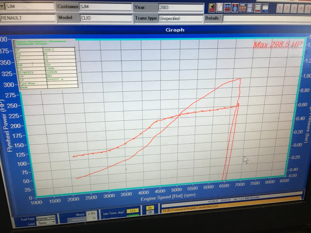

Then managed to get a set of mains and big ends of King racing bearings from TSR. Fitted them and have done about 50 road miles with it. All seemed well so booked the dyno again. Took it up to the dyno and started doing the mapping again. Did a base run that came out at 246, then added 3 degrees of timing, 269, then another 3 and got 304. Cleared the screen and went to get another run. This time 298. But noticed a rattle. Argh!!! This time it was box related. Pulled the end cap off the box to be greeted by a snapped circlip. Well atleast it was an easy fix. Hopefully!! Circlip a due tomorrow AM.
Here's a pic of the power graph. Happy with that at 0.6bar!
