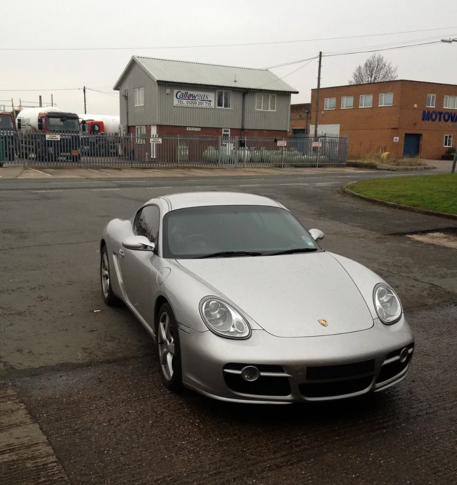

Pics
Goes to the dippers tomorrow :)

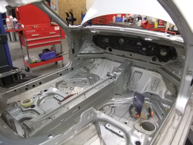

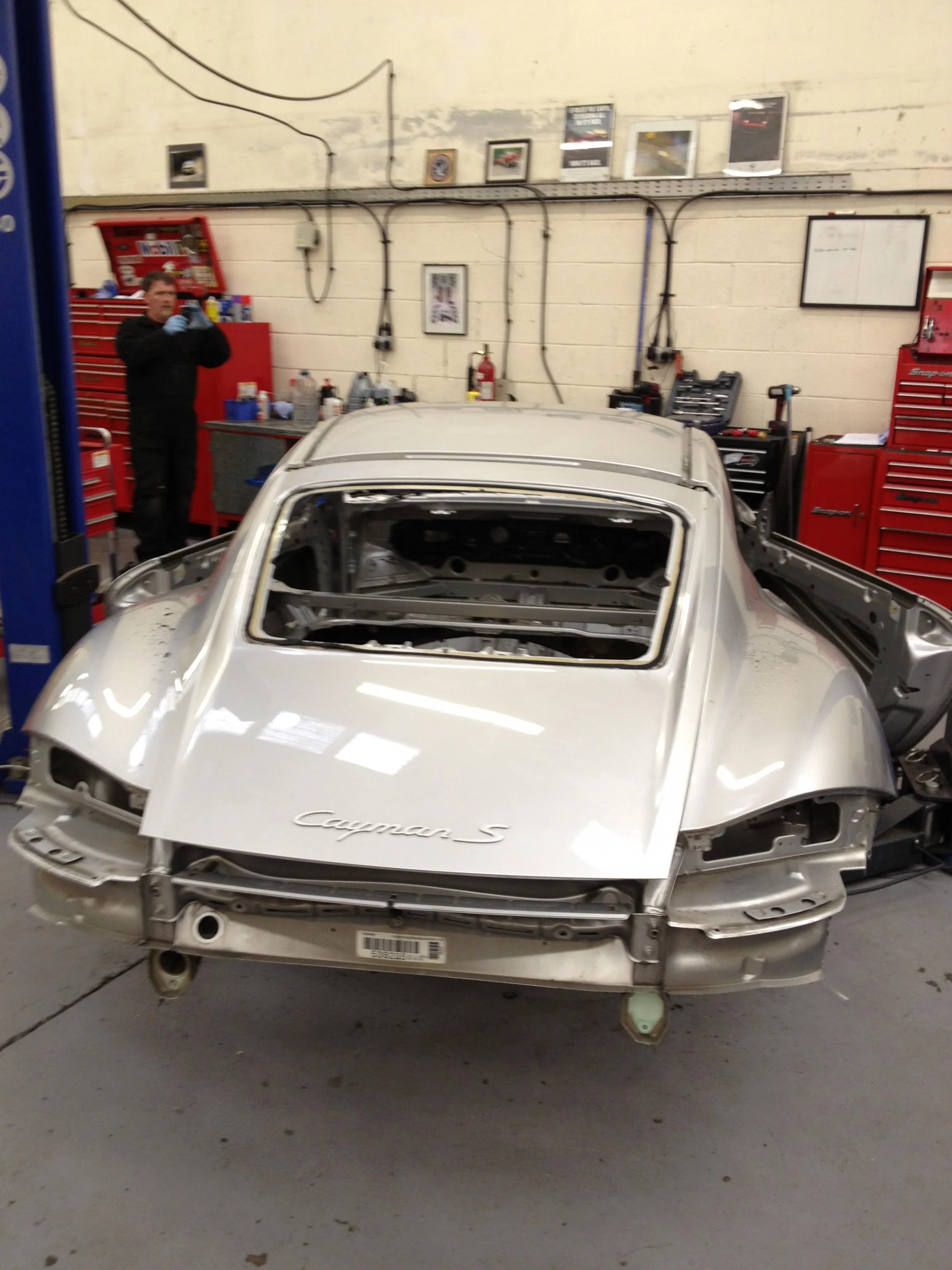

Popped in to see the car today.
Cage is going in but custom cages made some of the bars 20mm too short and that has set us back a week :mad: Its booked in for paint next Monday then a full dry build can commence, the lads were cutting the panels for the aero catches when I was there today.
note ally bonnet.
The engine came back from its health check with no issues just waiting for the shorter belt and lightened pullys. The diff has been dispatched so the box will be off for the rebuild soon.
GT3 arms have arrived and the KWs are currently getting screwed together, chewing over ECUs and looms atm.

how does dipping save that much weight?
Because it removes everything from the shell. All the glue, bonding agents, sound proofing the lot. All the under seal is removed from areas inside the sills and box sections.
A few tacks are needed in the doors as you can feel the skin moving on the frame because all the bonding has gone.
