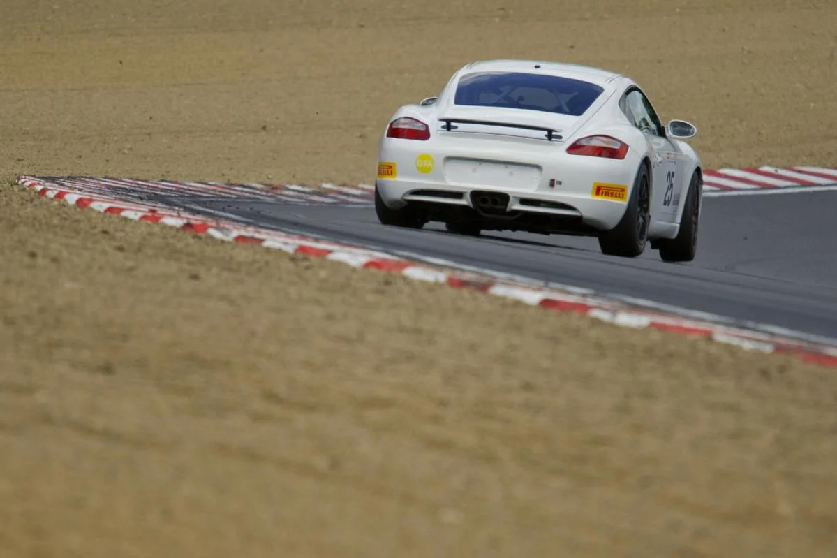

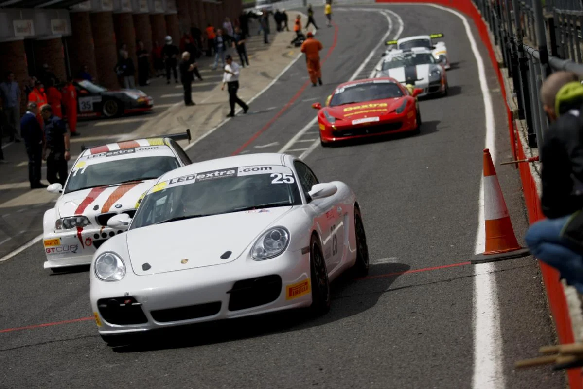

The 40 minute race went well, we had a few issues in qualifying and we didn't expect much however I managed to get the car within a second of a 996 Carrera Cup car (sequential box, rose joint, 100bhp more aero etc) and within 1.5 seconds of the class leaders. Not bad for its first outing and in a very very basic spec still fighting ABS and set up issues. We were last in class and last overall however after 40 minutes of racing we finished 3rd in class and 8th overall! We were made up and originally just hoping to finish let alone on the podium. Epic. MSVR-1687.jpgMSVR-9809.jpgMSVR-9691.jpgMSVR-1438.jpg

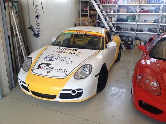

We have also acquired a Cayman Cup car from Italy, it has a massive amount of fully developed Cayman parts on.
We've got fair amount of bits to swap over to ours as well as making up a proper peddle box and a few aero tweaks. :) Roll on Oulton Park.
