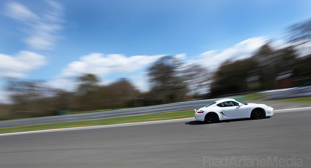

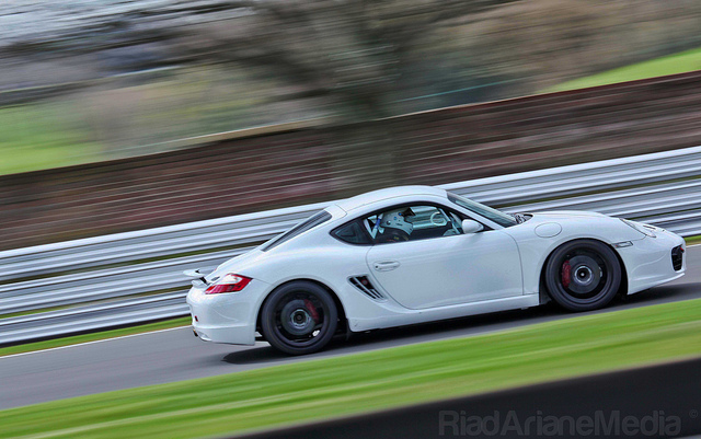

The pictures are a bit crap as I didn't want to get in the way, the geo and ride height are yet to done too hense the rally car esque arch gap. The car goes for its final flatting down on Tuesday then Oulton Wednesday then onto Brands Friday-Saturday.
This thing is mental. First lap out, first test, NO setup and sams chasing a GT3 Vantage round, actually scary how much it goes. Helps that the mowles ain't slow either. Cage is FIT too.
