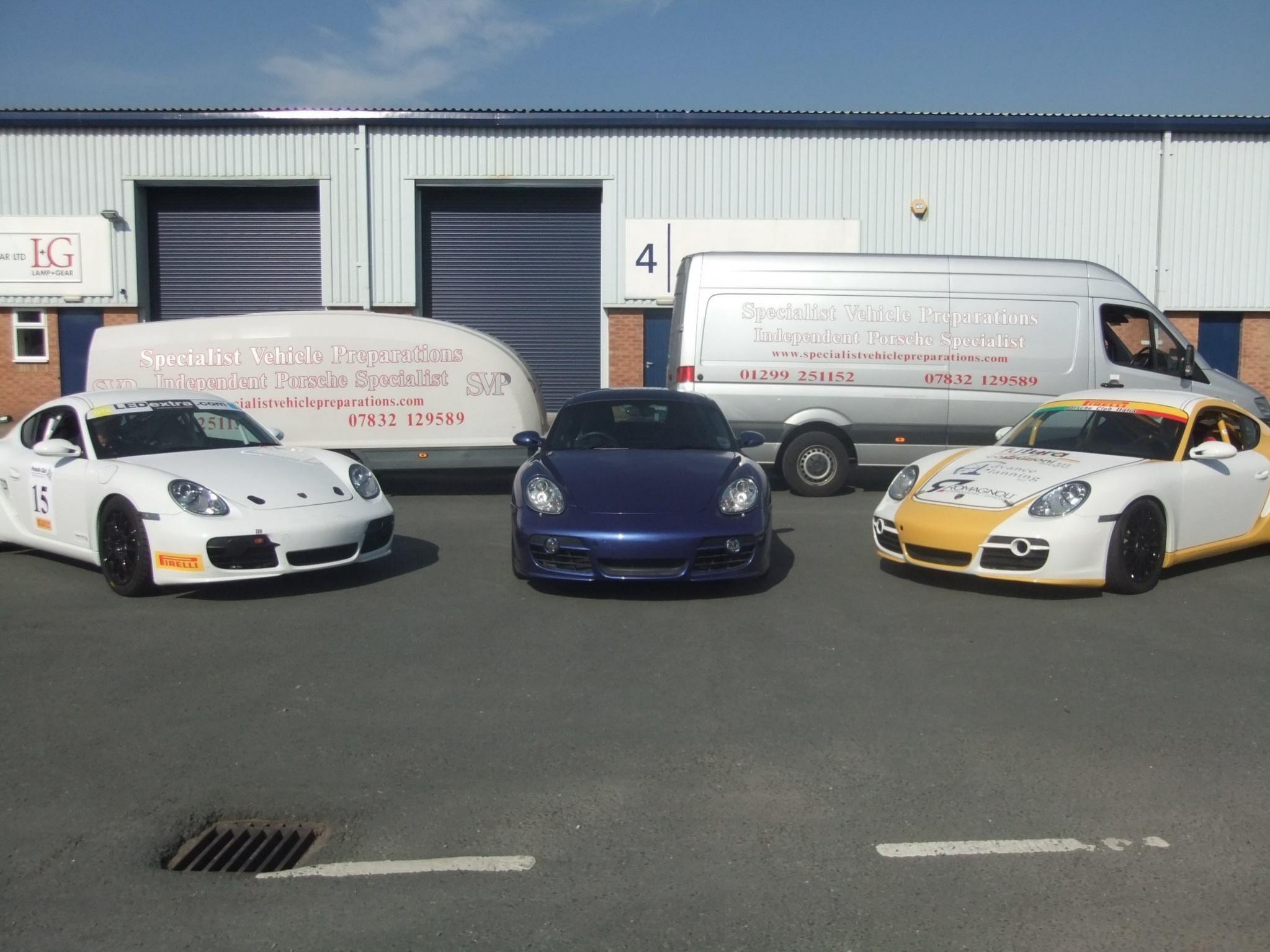

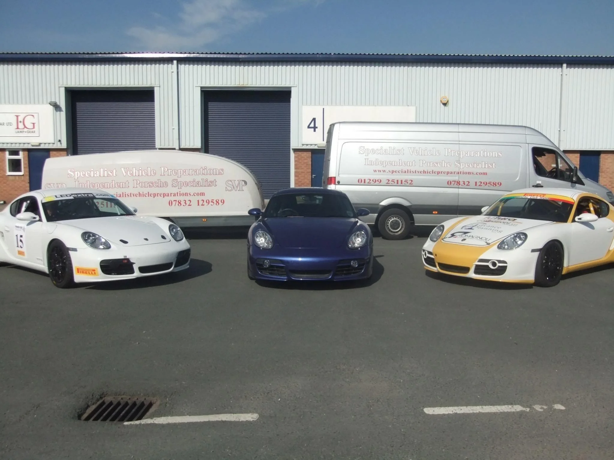

Due to complicated development reasons we ended up getting another Cayman race car this one build by Porsche Italy. It was bit of a dog but had 997 Carrera Cup car front suspension, uprights, top mount, and brakes etc. It also had a GT3 crown wheel and 320bhp steel engine.
We did a race with both cars at Silverstone which was hugely entertaining as my farther and I finally got to go toe to toe and race each other directly :smiley:
He got a better start off the line but two laps later I was in the lead lapping much faster in the slower car. Settled the argument once and for all on who’s faster. No vid sadly, not sure why but I can’t find the memory card anywhere. Grrrr.
Took the white car to Le Mans which was fun, saw good few peeps from CS who said some very kind things about it so Cheers!

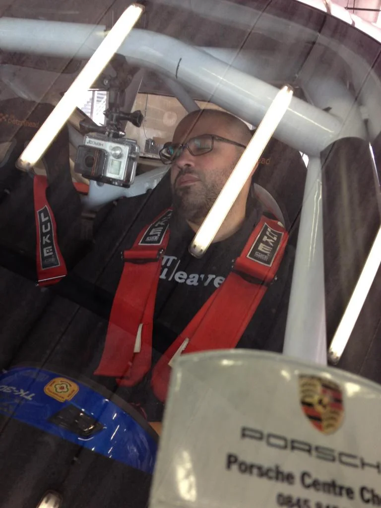

Nap time for Warren, he soon woke up especially when we had a entire turn off opposite lock applied. Opps :smile:

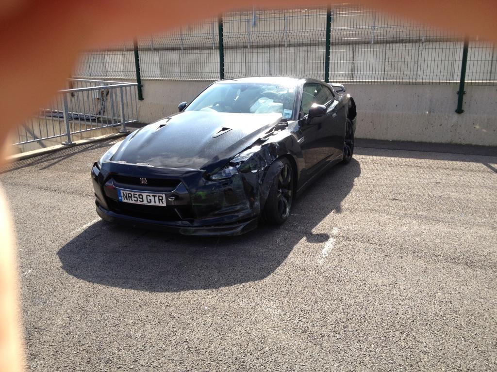

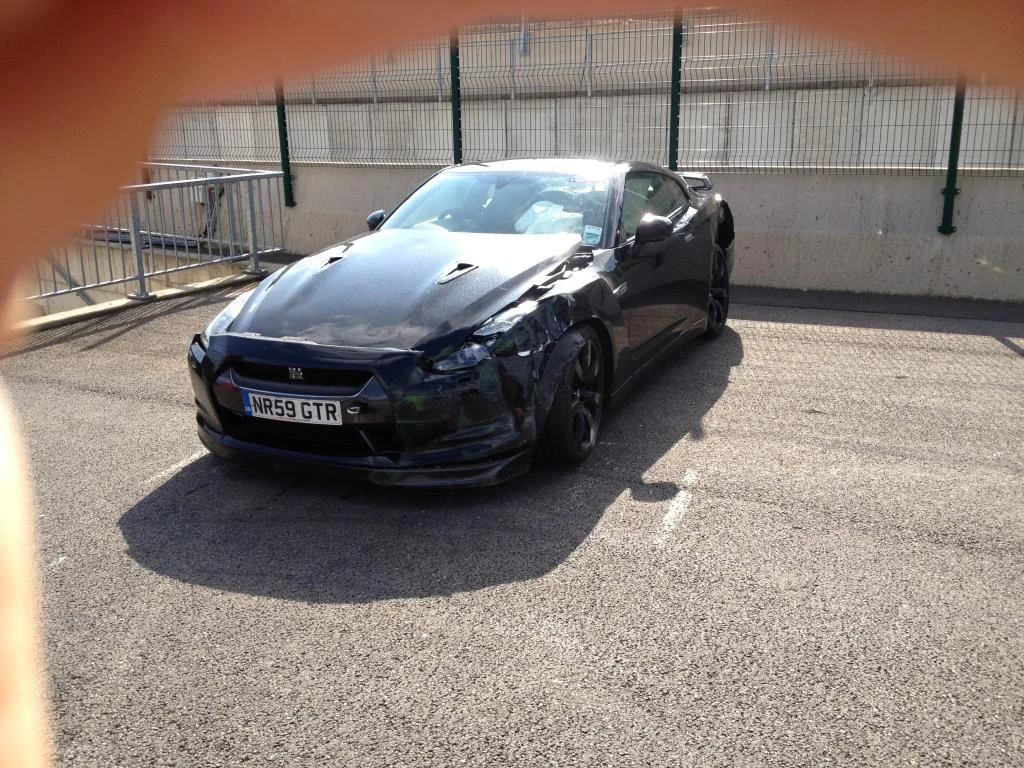

Poor GTR

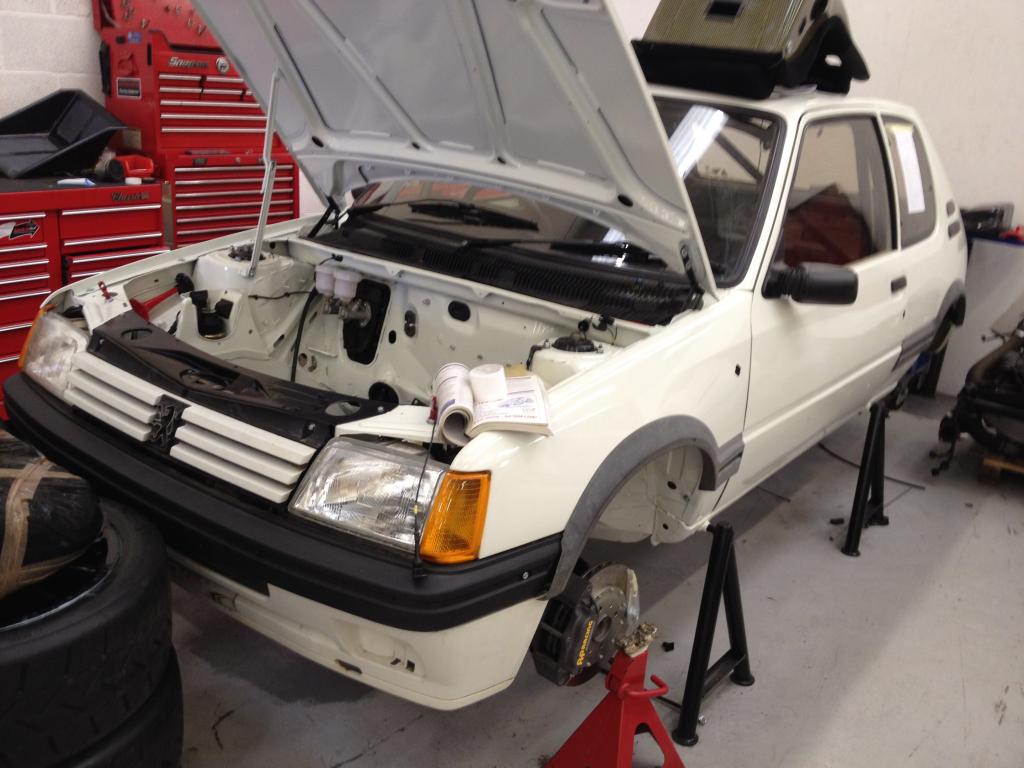

A few pics from the SVP workshop for the rally fans
Rebuilt Pug 205 GTI Rally car.
Recently dipped shell, its so straight for a car with such history.

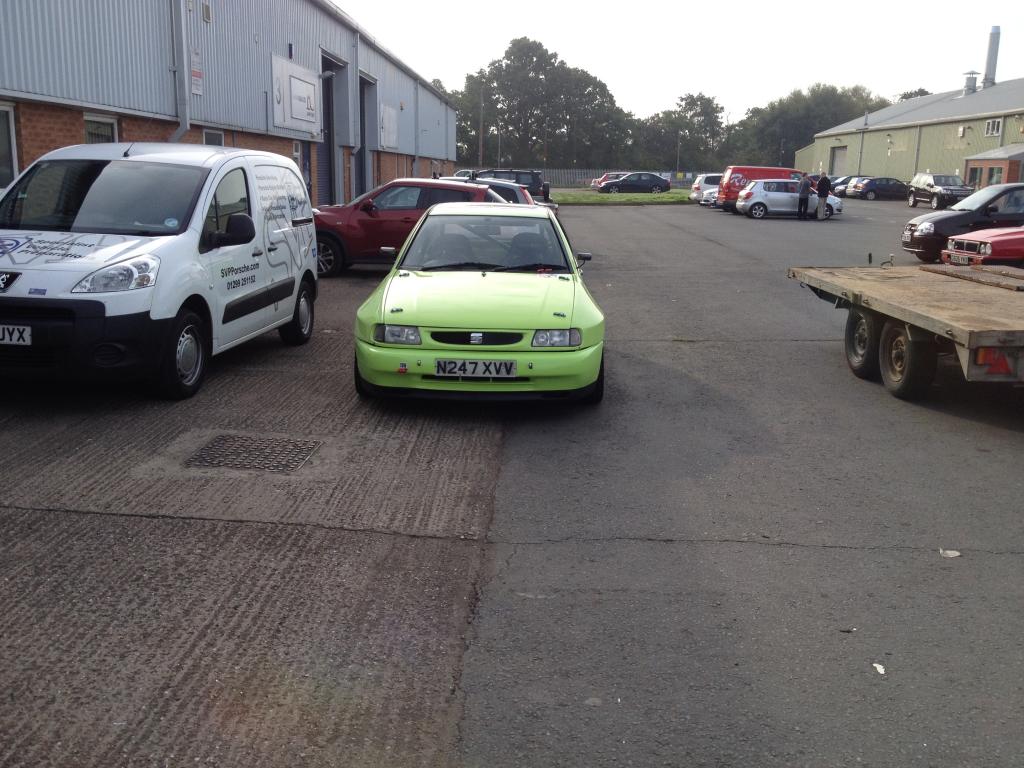

Random Seat thing, lovely car with laughable front track and sequential box. Originally built by Seat rebuilt by SVP.
Sorry for the awful pictures I am by no means a photographer.

Was that seat on ebay recently? Sold for very little iirc
The Ibiza used to be used by a guy known as RobT and he was more secretive over the car than some F1 teams. The car then ended up in SVP's hands and from what I understand they made it into a car useable for rallying.

Ingenious use of the strip LEDs as interior lights! I've got some of those for under cabinet lighting in my kitchen, and it never once occurred to me I could use the left over length for interior lights on my track car! Brilliant! I shall shamelessly steal the idea. Lol!

Glad you like it and let me know how you get on. We have some more to go on the cage for night time identification.
