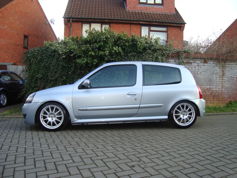

i cant believe that renault never did a glacier white 172/182.

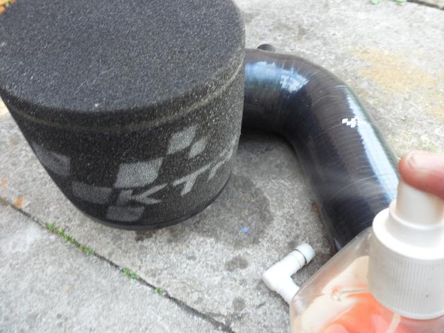

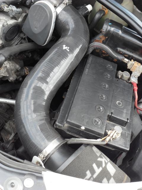

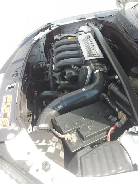

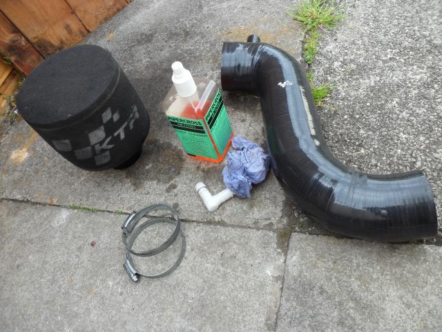

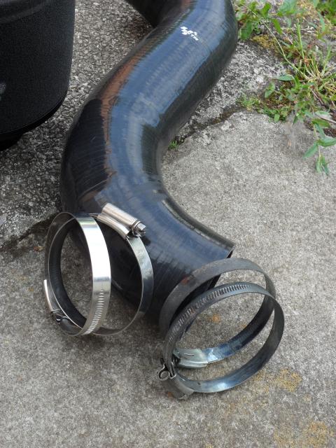

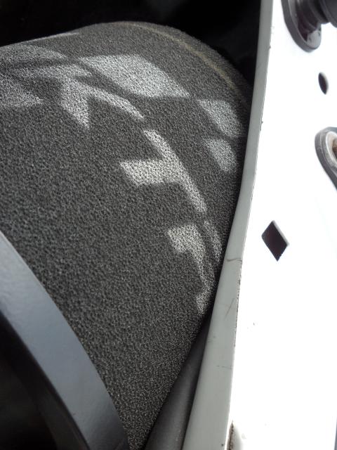

Wasn't happy with the blue induction / reducer adaptor set up, thought I wouldn't be happy with anything other than the BMC CDA, until I tried this out..
KTR's induction kit, in black, which fitted the bill perfectly :)
Gave the filter a good clean with some spare pipercross foam cleaning fluid, and replaced the worn looking jubilee clips
A tight fit, battery did need to come out
Really does sound the nuts though..
Has a slightly less deep note than the BMC but an almost TB type note to it, and really opens up on 5K !

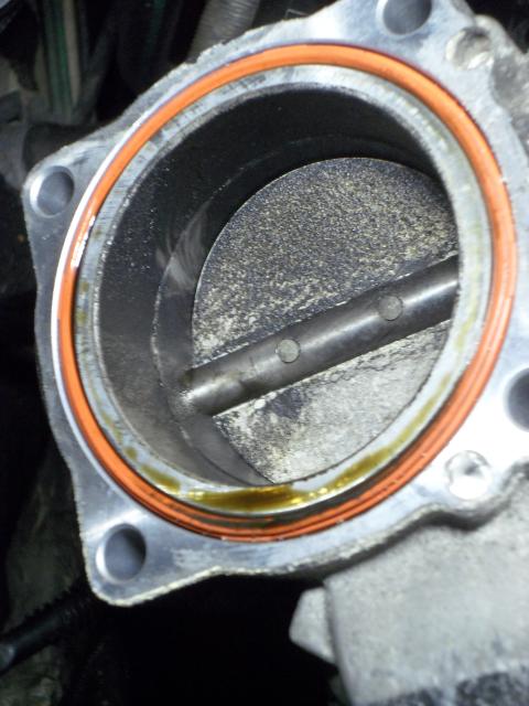

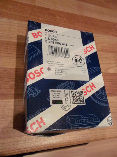

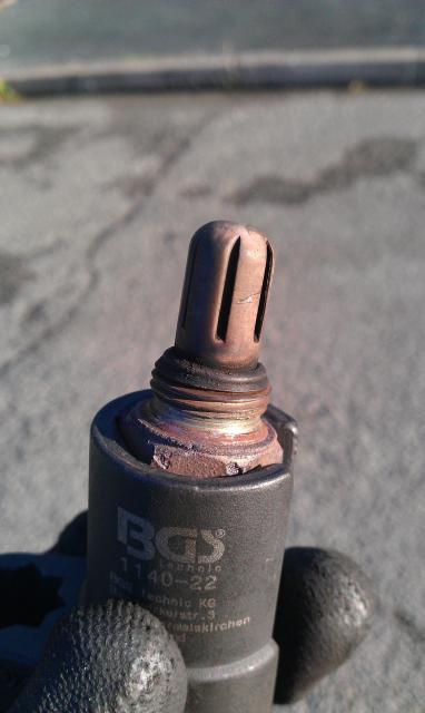

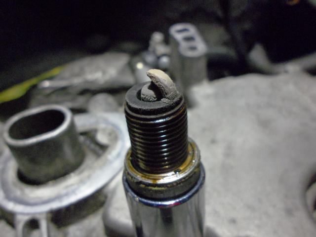

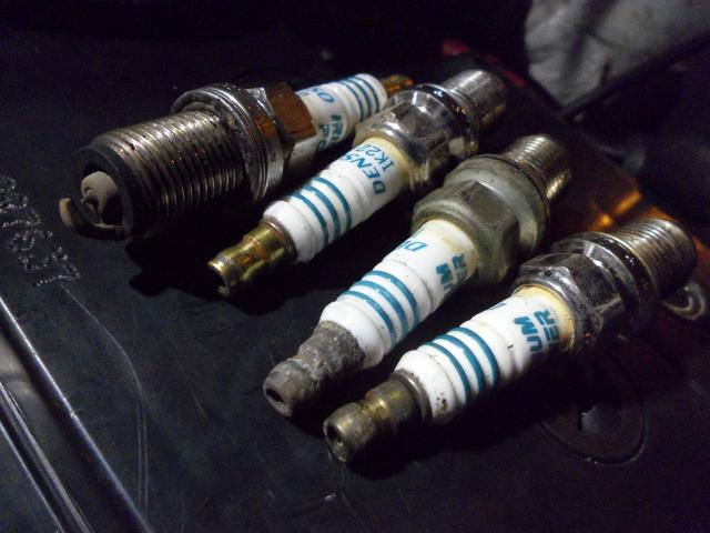

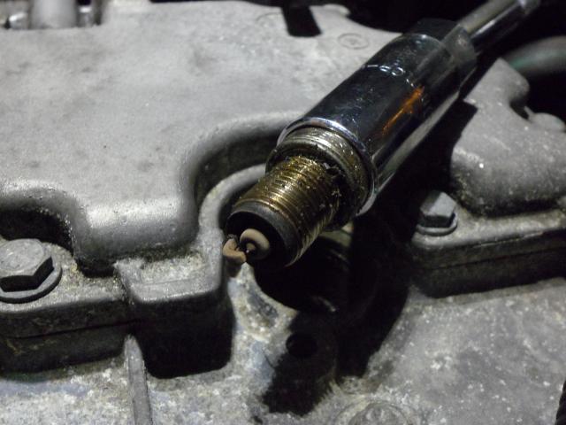

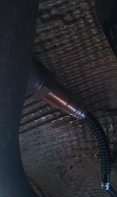

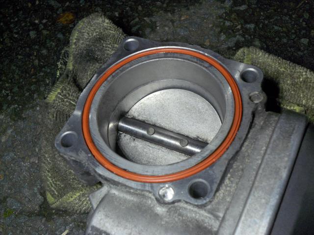

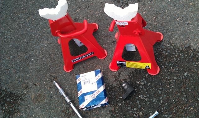

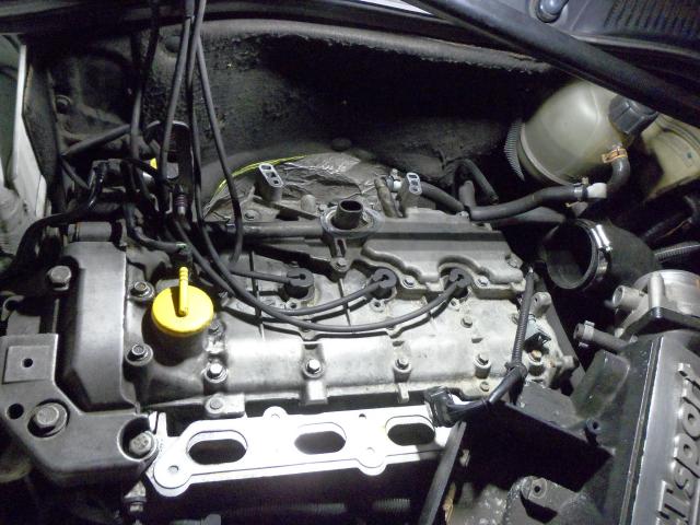

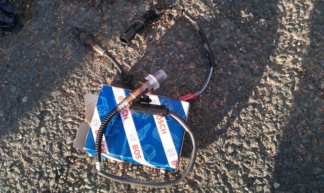

The engine was becoming a little unhappy in the mornings, engine code of pre-cat lambda sensor.
Went for a direct to OE plug Bosch fitment one, came with the plastic fitting clip and pre-greased
This old one was unbranded, had been cut and wire joined (obviously cheap universal one)
Rattled like mad once it was removed!

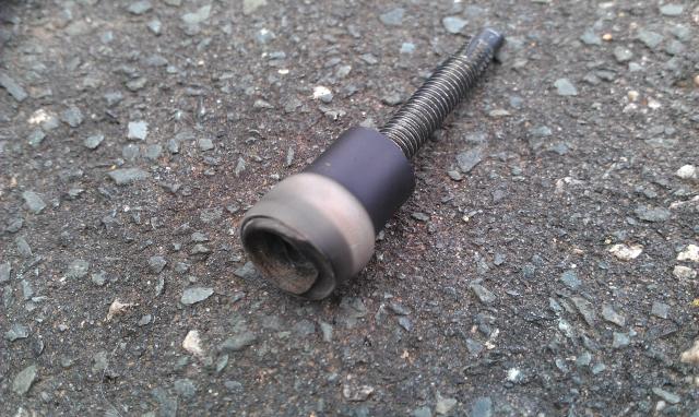

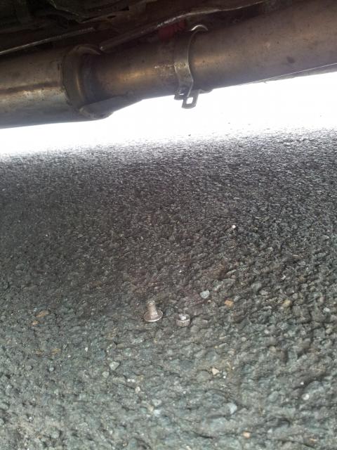

Whilst I was there, replaced an exhaust mount bolt as the other one turned to cheese..

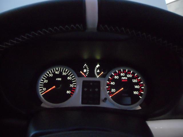

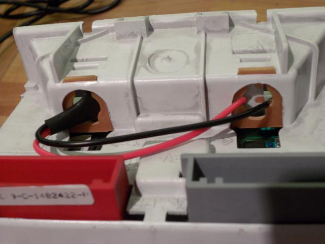

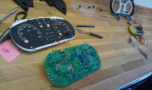

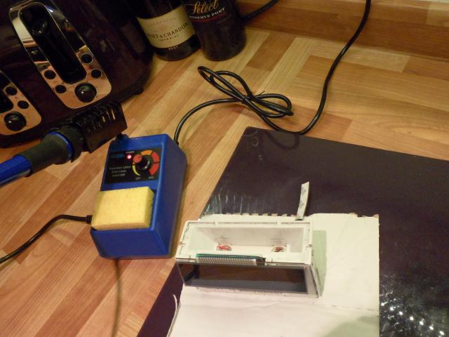

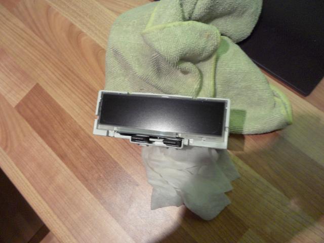

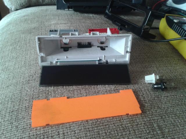

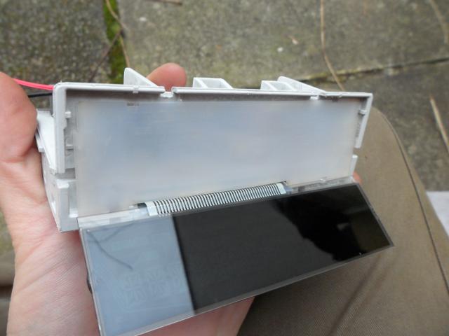

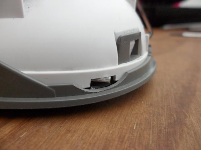

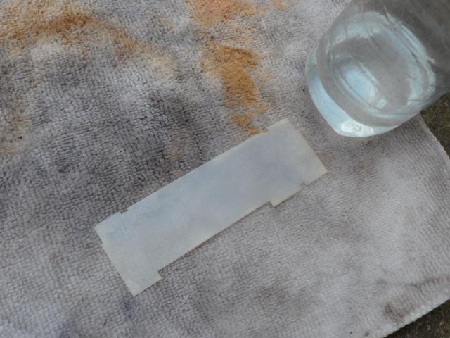

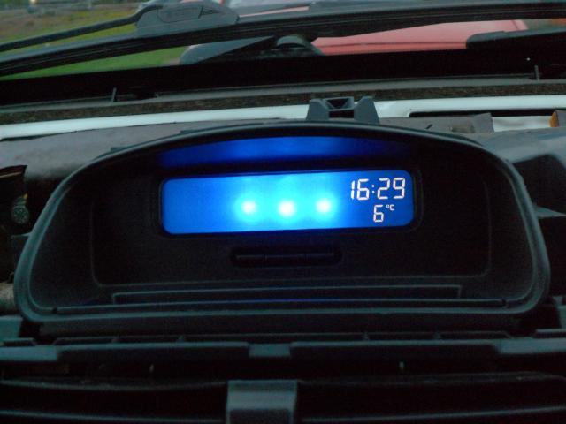

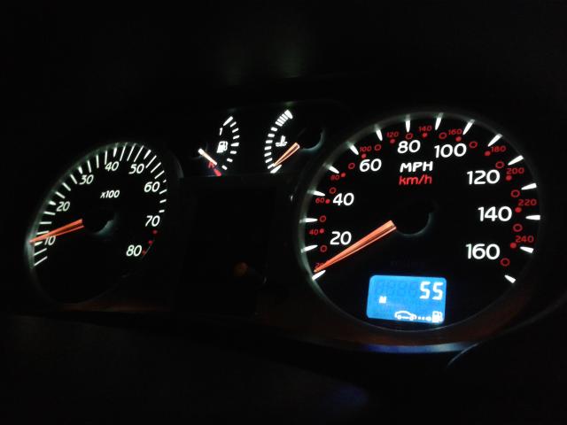

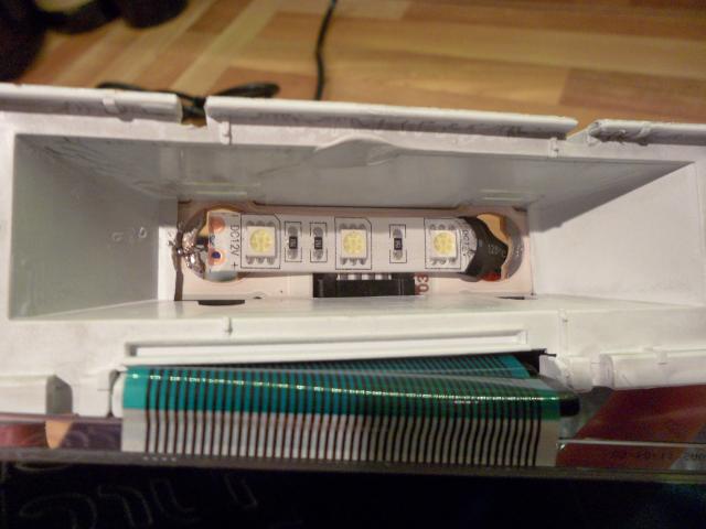

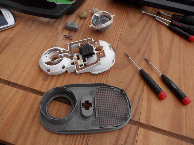

Had an intermittent problem with the left indicator bulb. After time with a multi metre, some forum help from CS.net with pin outs, was down to a pin in the plug dislodged from the slightly

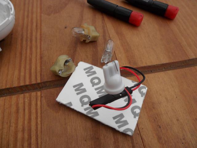

Bit of experience with stripping the clocks, will come in handy for an White LED conversion one day... !

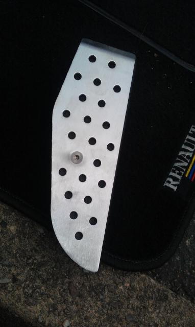

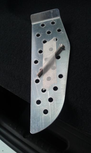

Ally footrest from Dan@MAD
Old one broke on removal lol

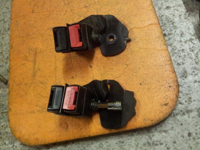

Replaced a rear seat belt buckle that gave up

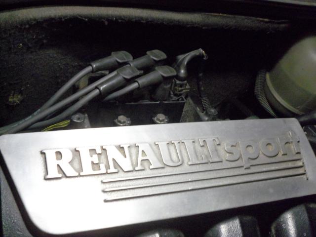

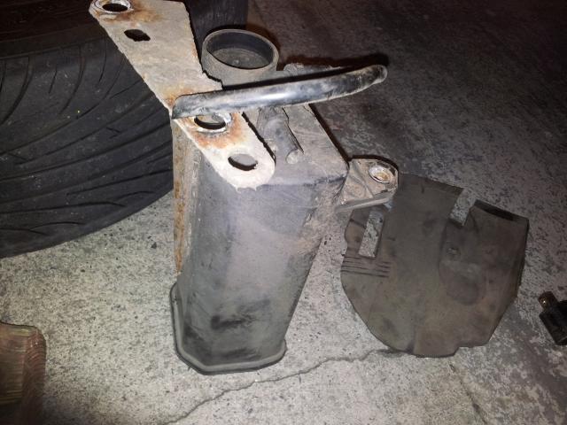

Deleted the charcoal box/carbon canister thing and did the pipe work

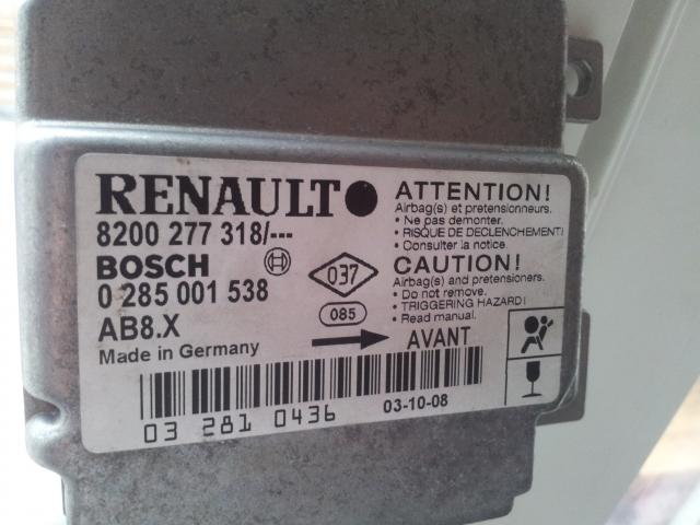

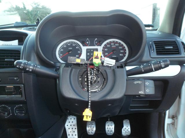

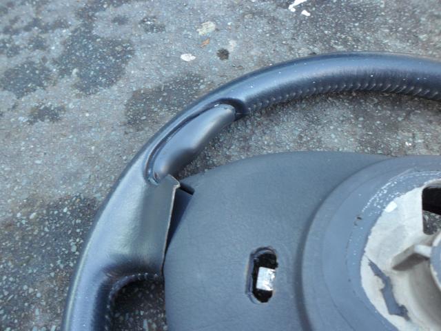

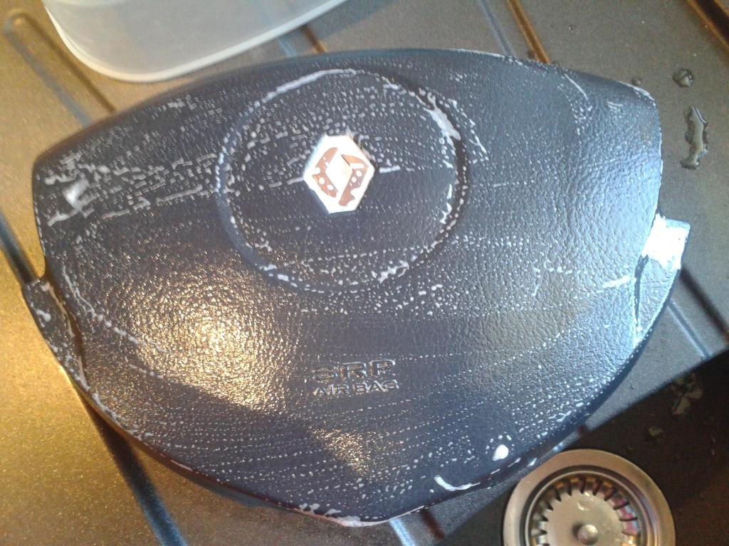

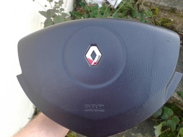

Got another Cup airbag module after having an airbag light since having the car due to a defective module
Thanks to Dan@SJM for sorting the configuration out!

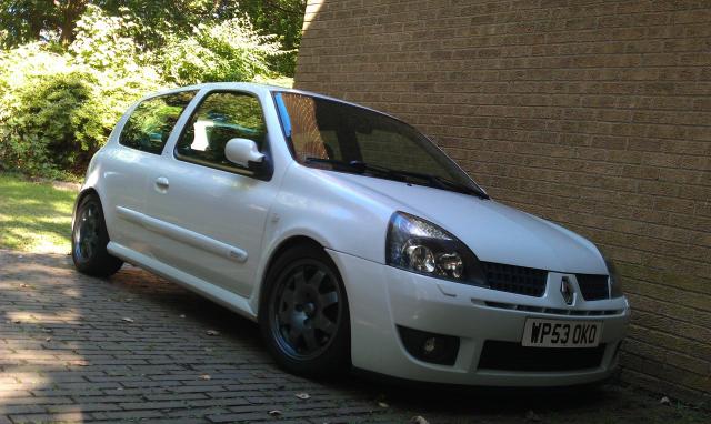

The last tax disc for the car... Better do it neatly!
Standard size BSAU plates in prep for MOT

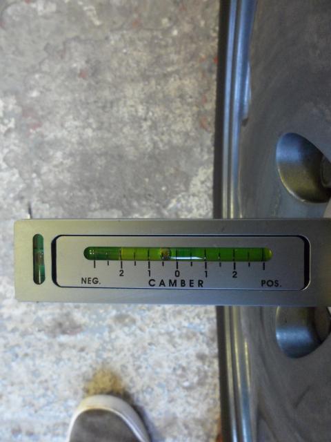

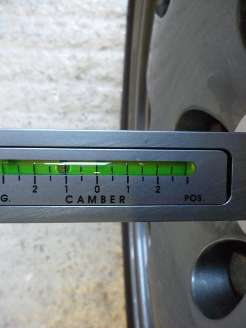

Reduced the camber due to the other Nankangs scrubbing out rather quickly
Down to 0.5 degrees now and towed to match, less silly slow wheel spin pulling out of uphill junctions

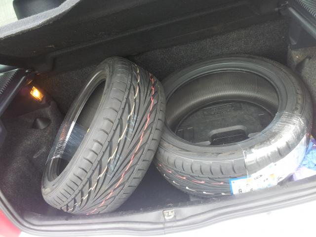

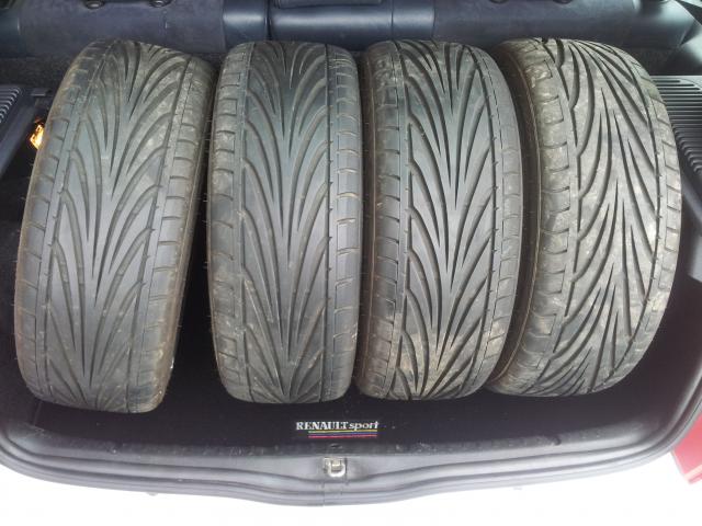

New set of T1R's to match the rears again

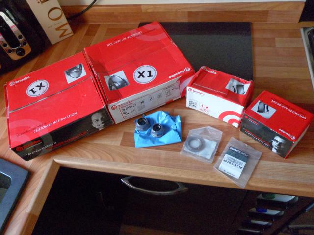

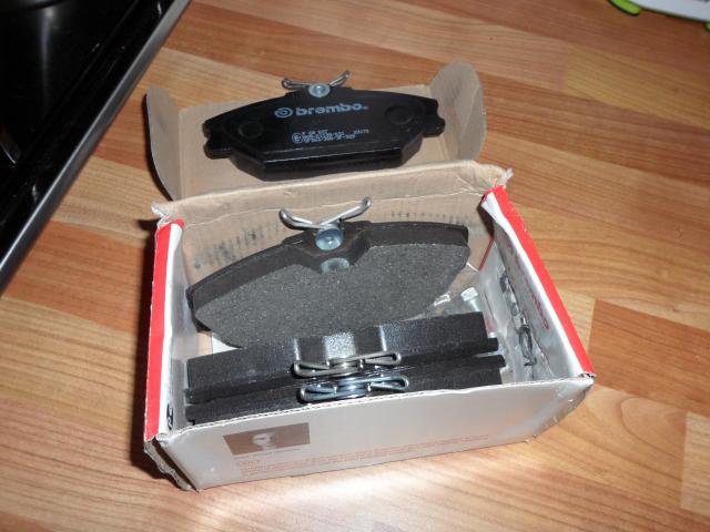

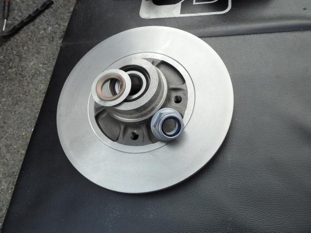

Thanks to G_172 from CS.net for getting these brakes to me within a couple of days:
Brembo Front Pads
Brembo Rear Pads
Brembo Rear Discs
Renault Rear Disc Spacers
Replacement Rear Hub Nuts

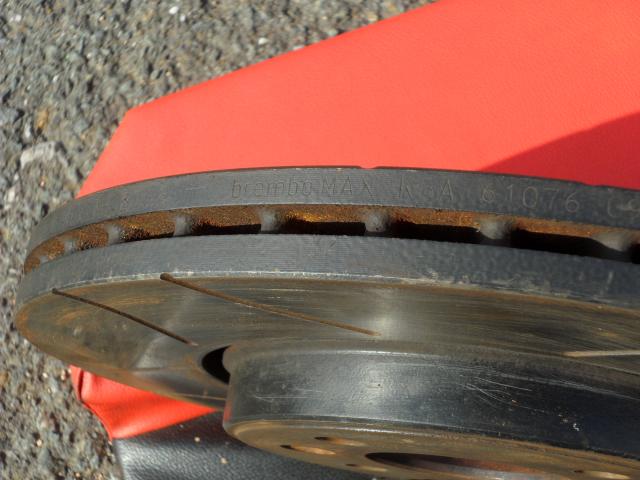

I also have had an as new set of Brembo Max Front Discs sat around for a while collecting surface rust so dug these out while I was there

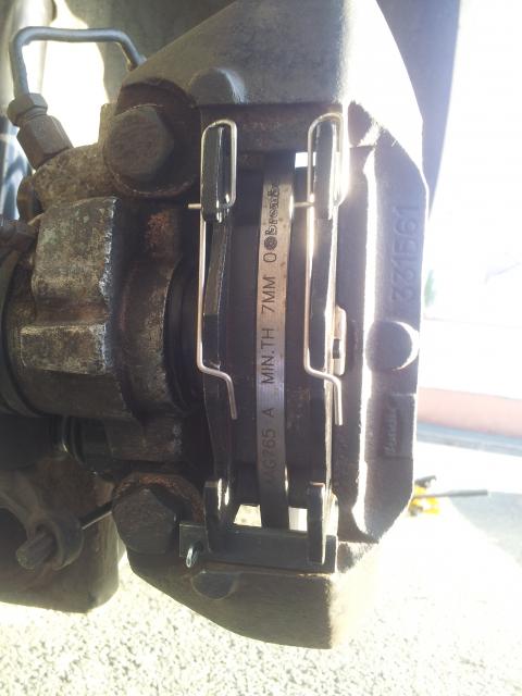

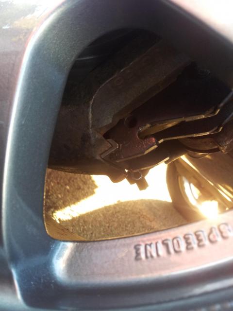

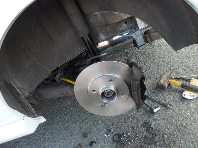

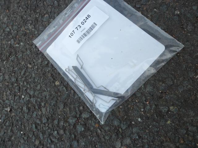

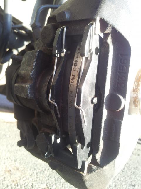

Decided to also get hold of a rear pad fitting kit.. A good thing to as mine unbelieveably had NO SPRING RETAINING CLIPS FITTED!
I have no idea how the pads have stayed in, made me feel a little sick..

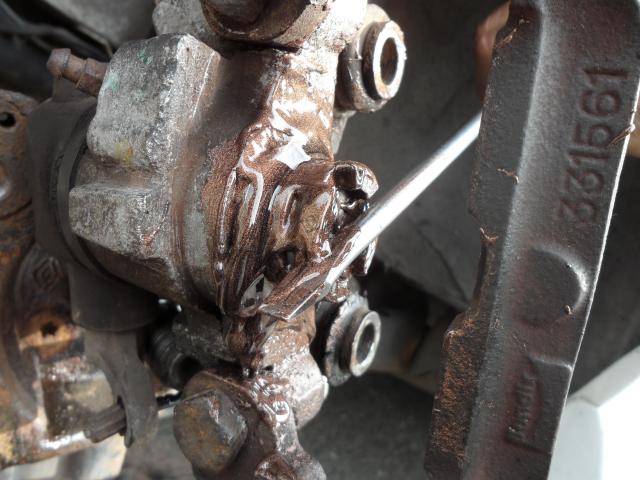

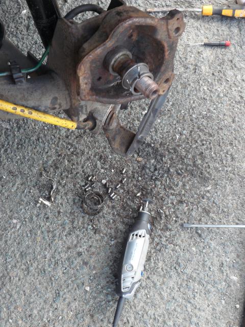

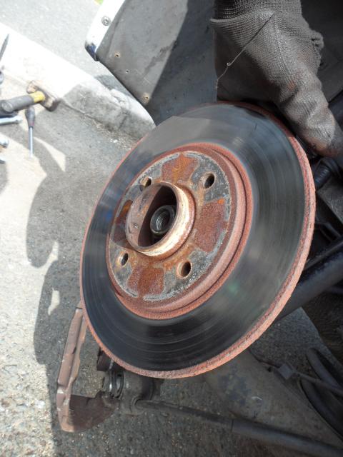

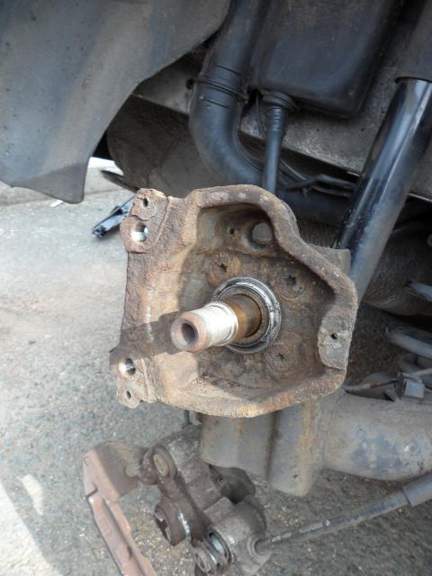

So... old, worn, bumpy feeling, scoured, and warped feeling brakes

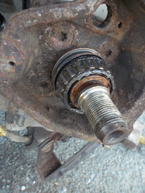

Passenger side I had to use a lump hammer to remove for 25 minutes, hard, didn't feel great, then the bearing let go of itself
Spent some time cutting the remainder of the bearing off.
The reason for this side being such a pain was probably because the disc spacer was missing!
New bits

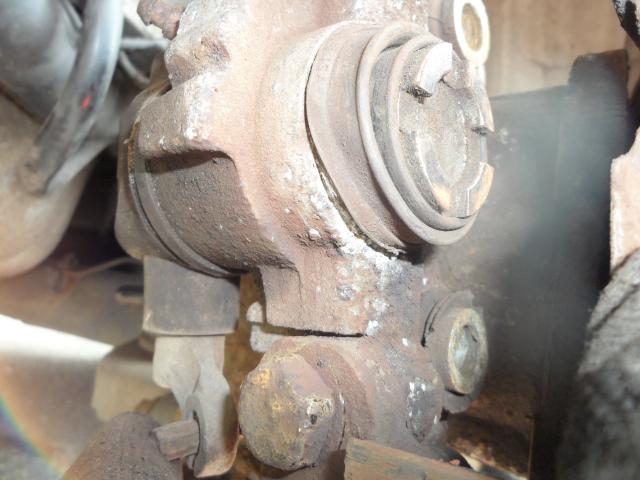

The drivers side almost fell loose as soon as the nut was off
Reason... this side had a spacer fitted

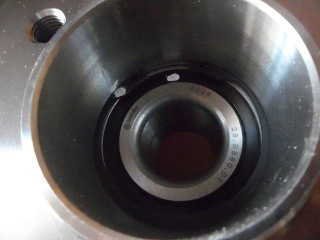

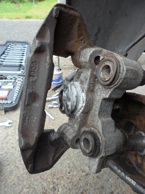

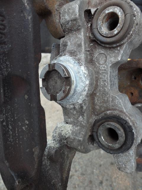

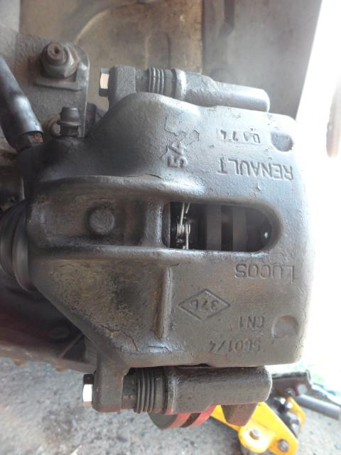

However.. note the rubber seal bulging out.. seized rear caliper
Spent some good time cleaning this up while it was extended out fully with small wire brushes and good glass paper and smoothing then whacked in a seal of copper grease to get it going again

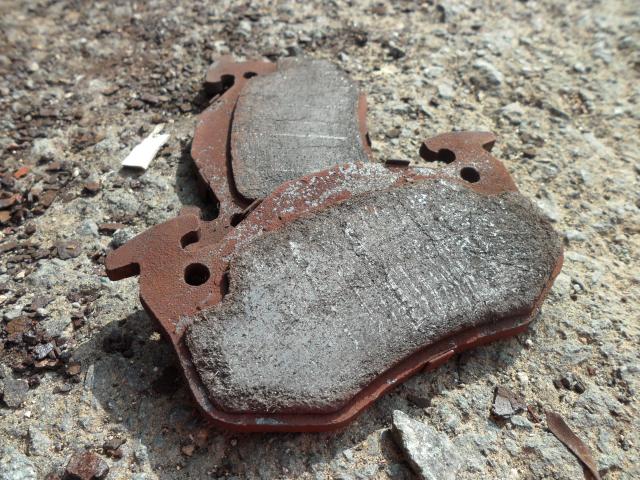

Old pads were very brittle and worn from the heat of the caliper no doubt
Caliper sliding like a dream now and working the best it has been since I've had the car, brakes in a straight line!

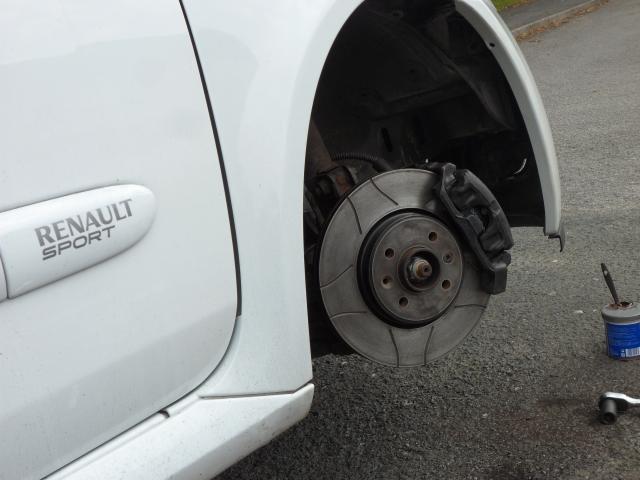

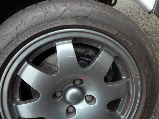

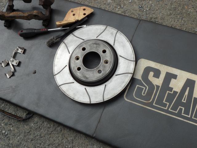

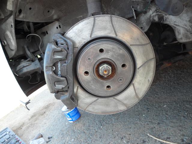

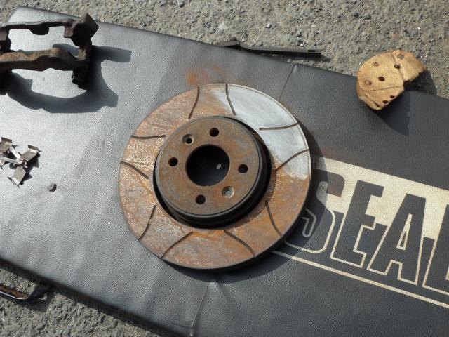

With the rears finally in good working order, moved on to cleaning up the front discs
New pads and caliper to carrier bolts
Dirty wheels, although don't look it, back on and Toyo's on also

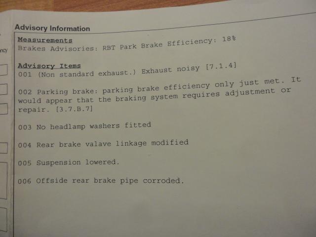

The big ... MOT TIME
Passed first time
However was asked a couple of things before they did the advisories on the computer:
1: Exhaust system isn't a standard item - ORLY?
2: Handbrake only just efficient - Put this down to the new brakes, he agreed they had not even worn in yet
3: Xenons - Asked if I fitted them and because I had did, these were 'retro fitted' so no washers came from factory, so would pass?
4: Modified rear brake compensator - Cup rear brake set up lol
5: Suspension is lowered - Oh?
6: Brake pipe corroded - The only real advisory ?!
So with all that out the way, back on with the narrow plate and a wash before tucking it in for the evening

They weren't happy with it being lowered to be fair.. splitter was ever so slightly bending, good thing it wasn't a Cup/Carbon one!
Took it to another place before this MOT but they called me 1/2 hr after drop off to tell me the sliding jack wouldn't go under it on the ramp so couldn't MOT it unless I raised it up..
Horn - Mine was the earth connection
Broken Spring - Cheap as chips for another set
Brakes - G172 !
Get it sorted dude, Renault's get expensive if you don't sort things out, otherwise you end up with a huge to do list, tackle it as it comes ;)

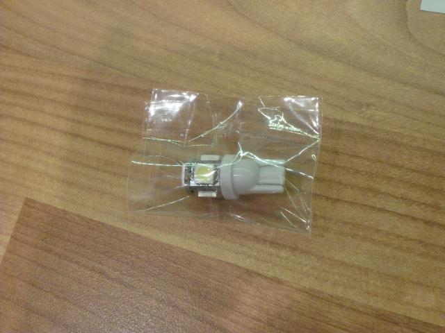

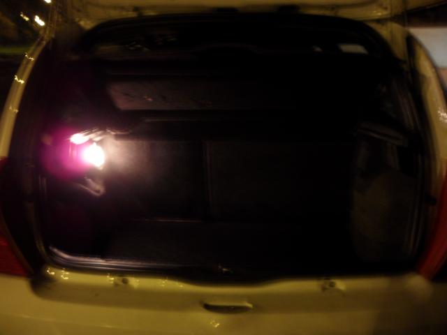

Still have the hose, adaptor, and BMC though, but unsure if you wanted it as the size was wrong for a Clio, you could always chuck it on with the adaptor and see if you are happy with it but the adaptor spoils it a little TBH

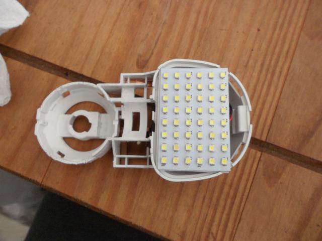

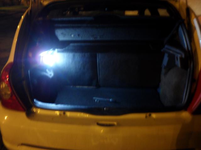

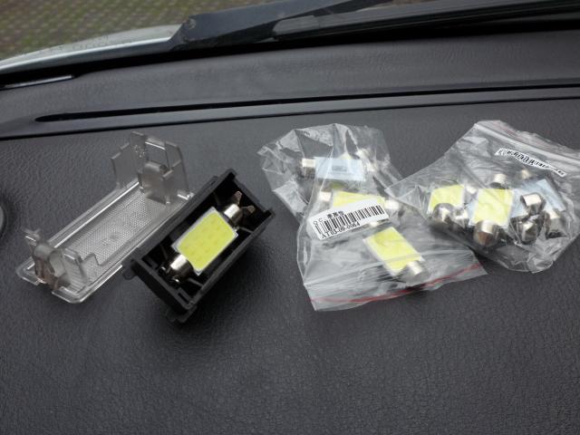

If not, then could do a deal with the LED conversion or something? Be cheaper than me buying a decent iron, materials and bits and pieces. I was planning the full conversion though (dash, switches, heaters, clocks, interior lights etc)
McGherkin
Macca fan boiiiii

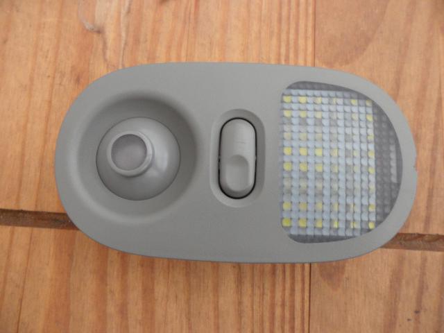

Well I've got 50 LEDs so I'd imagine there's enough, although I haven't taken apart the door switches etc so don't know how bad they'll be. Drop me a message about that deal and we'll sort something out :)

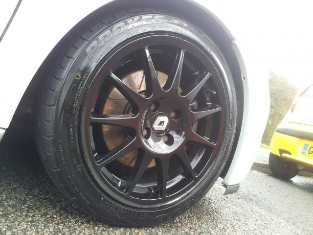

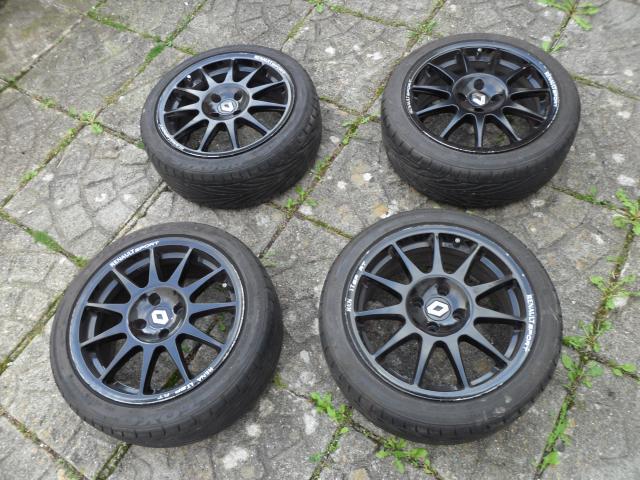

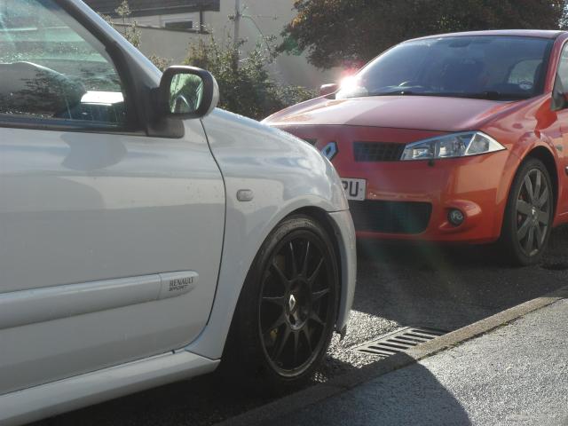

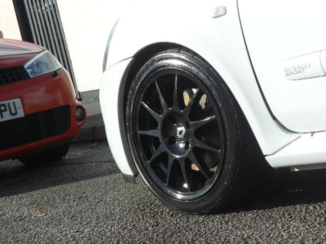

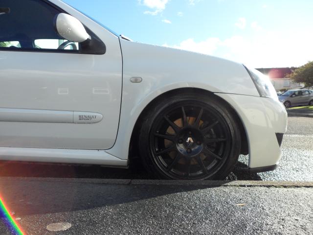

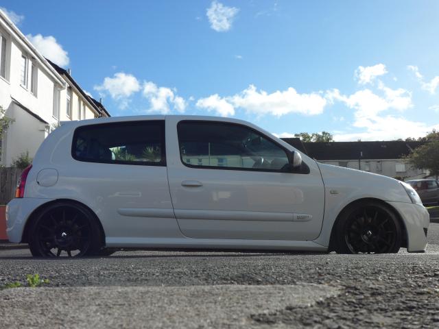

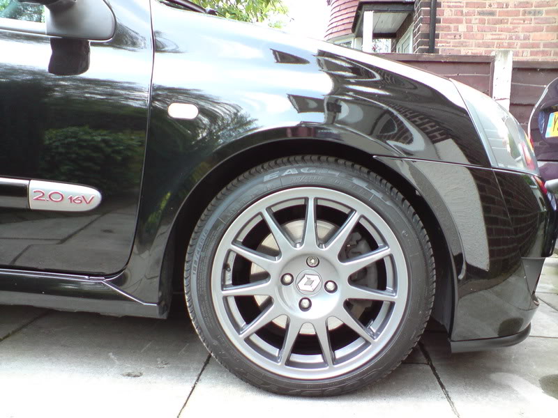

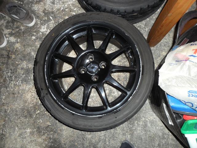

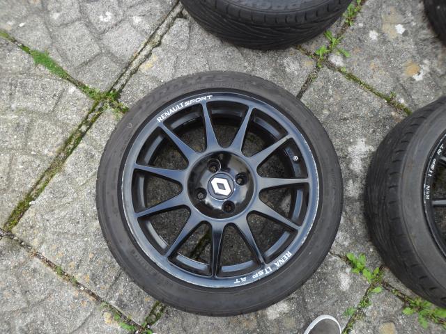

Moving on, finally a wheel change!

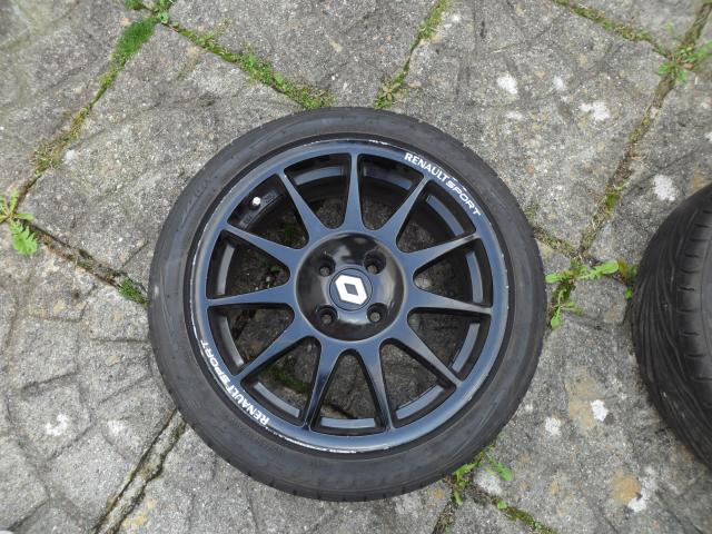

A friend snapped these Turini's up and planned to refurbish them with track tyres. Initially I wanted the T1R's for my wheels but ended up doing a swap deal :smile:
(Facebook photos)
Got them home..
195/45/16 T1R's
Not really thought much of black wheels, but here they are before..
A considerable amount of time cleaning them up..

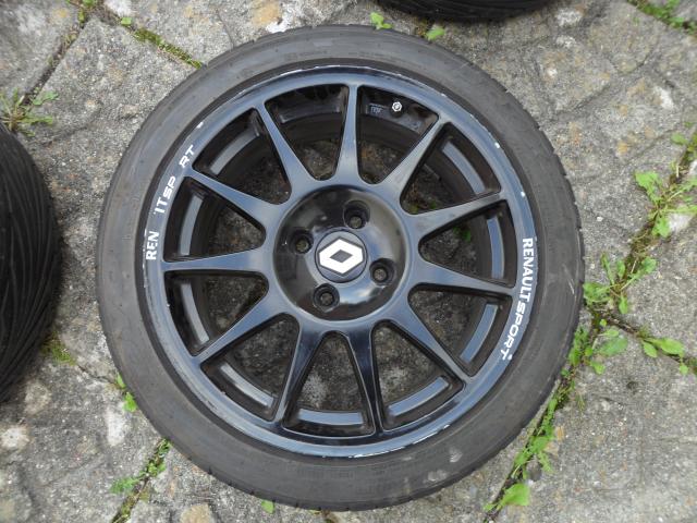

Removed the Renault Sport (or R nau t S ort) stickers which were peeling anyway, the paint scars stood out a mile..
45 Minutes with a touch up stick, and some tyre slick, we had this..
Now at this stage I need to remind everyone again, and myself, that these are only temporarily on until they get re-painted
So a couple of snaps of them on the car..
The Williams Speedlines back where they belong :wink:

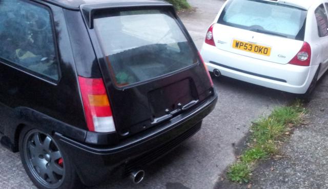

Whats the deal with the 5? Needs a thread!
Has a thread on another site, however not been touched for some years now! Couple of clips on YouTube of the build but again these are out of date by a mile!

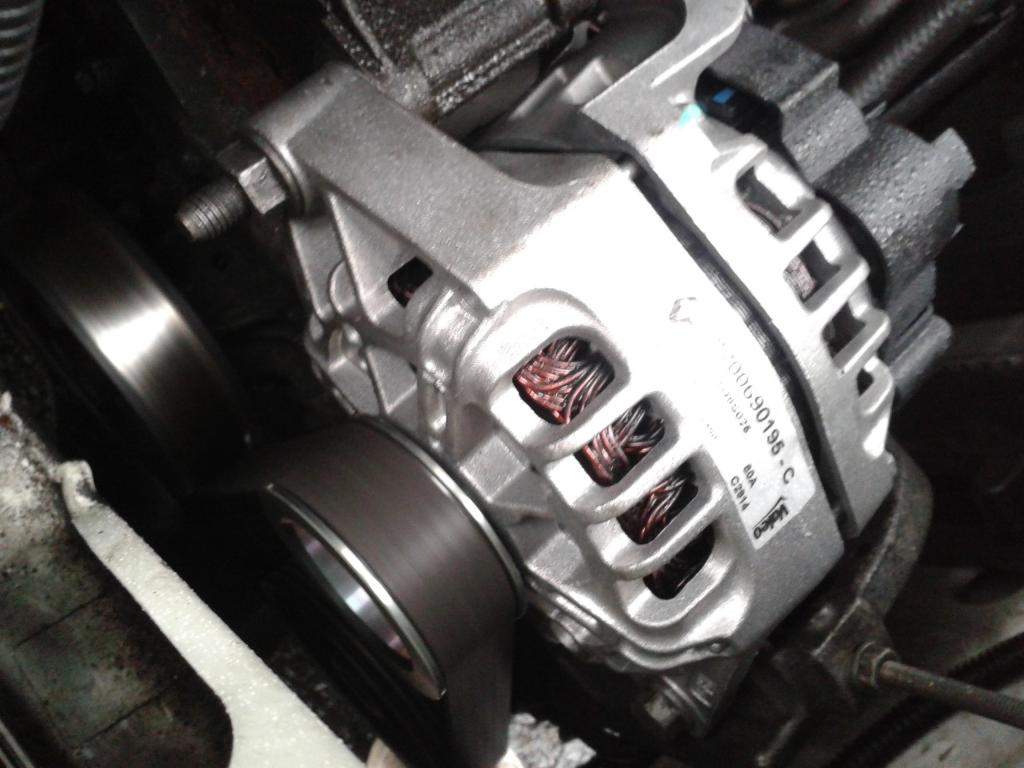

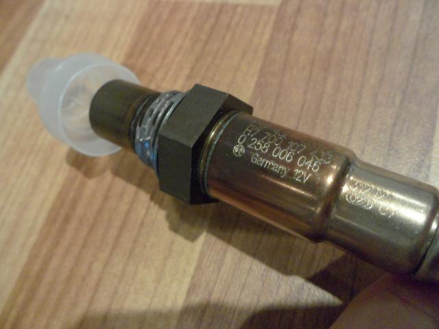

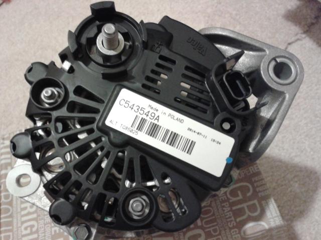

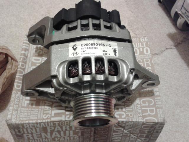

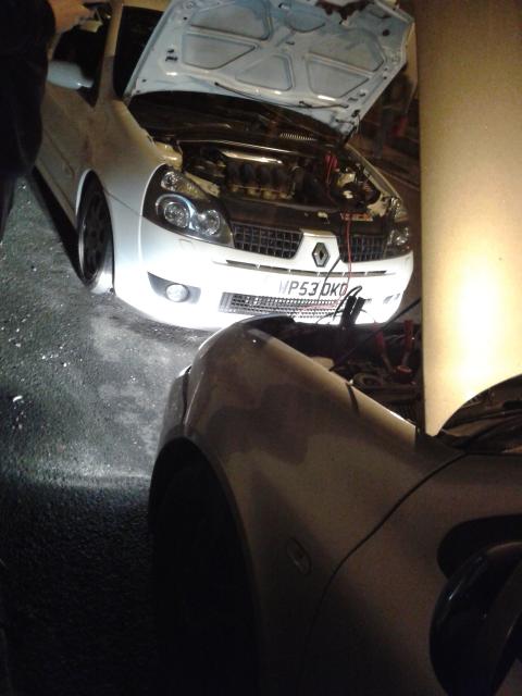

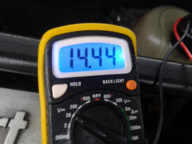

I'll start with saying a special thanks to @McGherkin for providing me with some ClioSport electricity :(

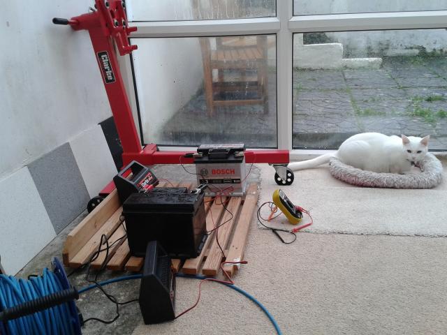

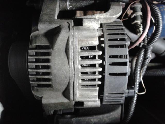

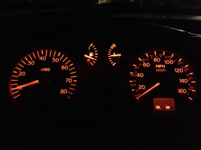

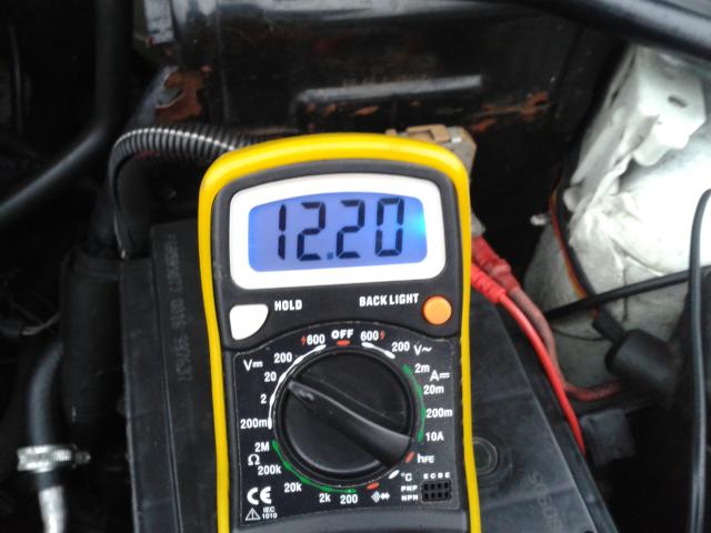

Got the car back home and chucked on the multi meter which gave me this (Car running and voltage slowing dropping off)
Out with the battery as it ran completely flat, and gave it a good day and overnight charge.. Meow
Thanks to @Renault Wolverhampton for sorting this out..
Out with the old...
In with the new !

Whilst we are on that track, @Renault Wolverhampton then sorted some of these bits out, ECP are the other bits..
ELF Evolution SXR 5L
Renault Oil Filter and Sump Plug Washer
Gearbox Oil Washer
Renault Type D Coolant 5L
Renault Thermostat
Renault NGK R Plugs

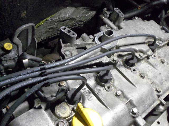

'Prospark Leads' Pretty pleased with these for the price
Bremi Coilpack - Thanks to @JW-172 for the patience with this

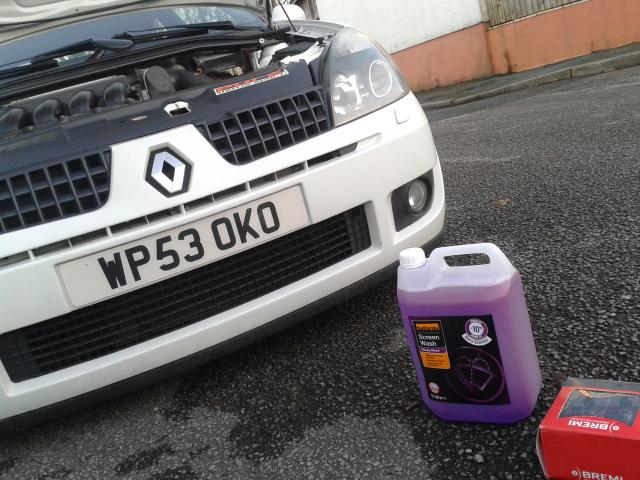

Oh.. and thanks to Halfords for the special offer on Screen Wash!

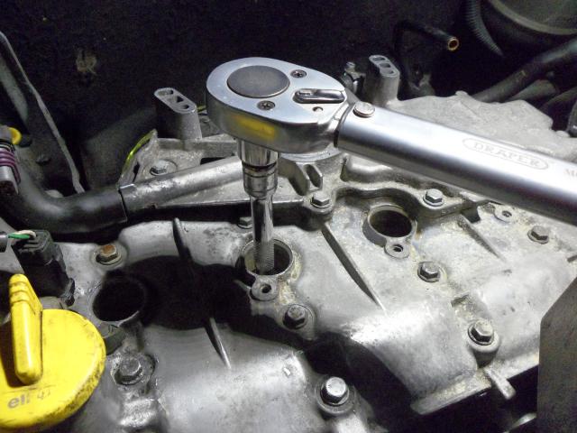

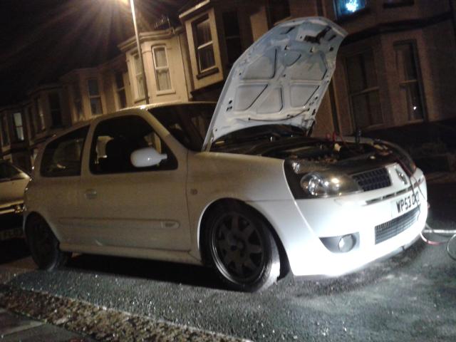

Got to work with the ignition side of things due to a lead popping off and melting on the manifold.. resulting in a misfire..
Plugs were terrible..
All torqued up and new leads
Gave the inside of the TB a good wipe down whilst I was there..
Done...
Fluids and Brake and Gearbox fluid change soon, but will do this all together.

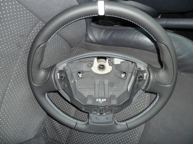

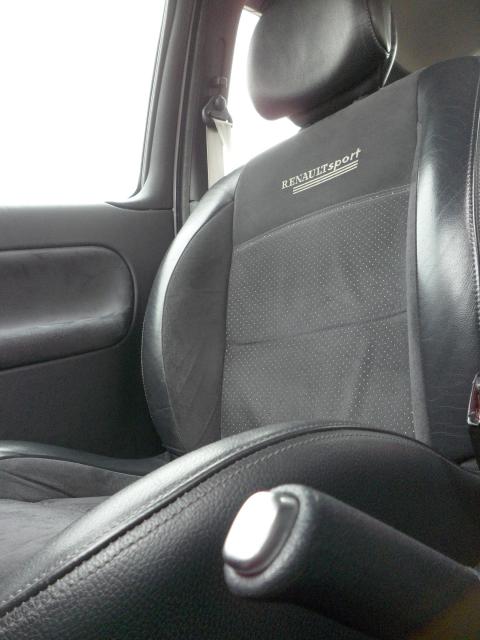

Next... I cleaned my airbag...
Because my steering wheel got naked :eek:penmouth:
Merry Christmas from my misses whom is now my 'fiancee / wife to be be!' :hearteyes:

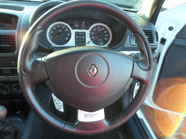

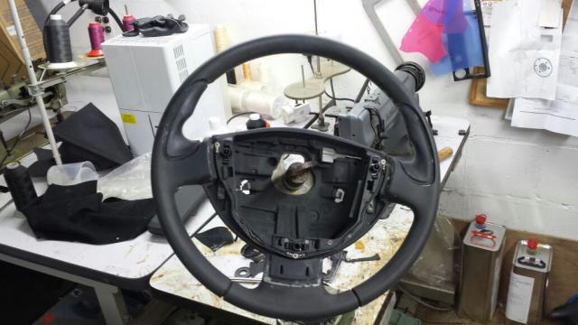

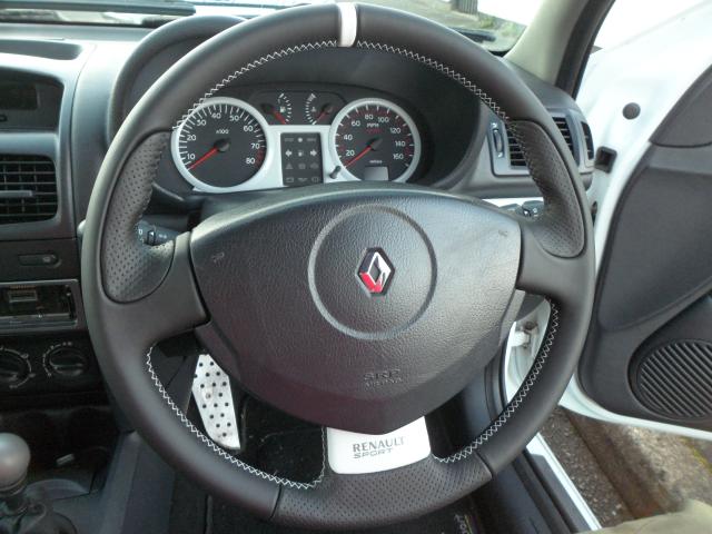

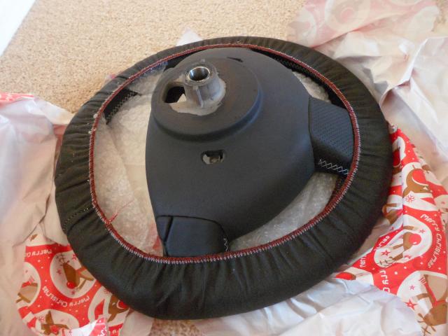

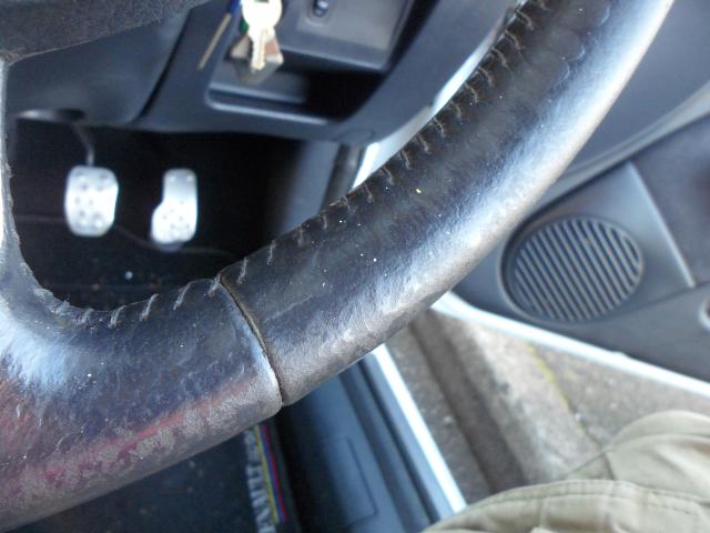

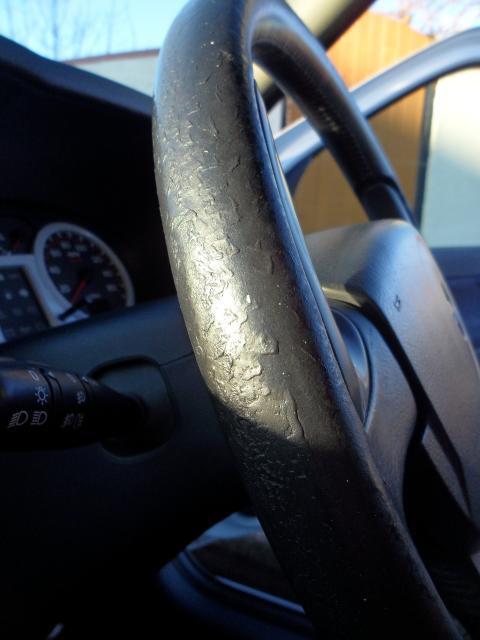

To replace this monstrosity which has grated on me since day one...
Thanks to @snappy for the TOP WORK, what people say was true, these are excellent:
Retrimmed Wheel
White 12 O'clock
White Stitching
Perforated Thumb Grips and Bottom Section

Thanks again to @McGherkin for his patience with sorting these Dial SMD's.. nothing is plain sailing!
Glovebox
Boot

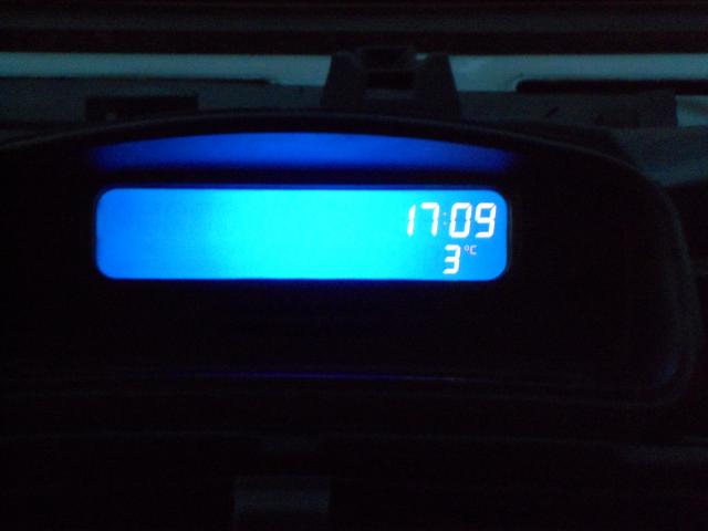

Got dismantling the MFD / Clock / Radio display
Before (Both bulbs blown and only sunlight providing this)
With the power of Acetone.. Bleached the orange away
Got myself a new soldiering iron to replace my old 'hot broken spoon' I had before
Ended up with this.. Not the look I was after :dizzy:
Ordered some translucent filter sheeting and made up a replacement filter..
Done, camera makes it look a little odd here?!

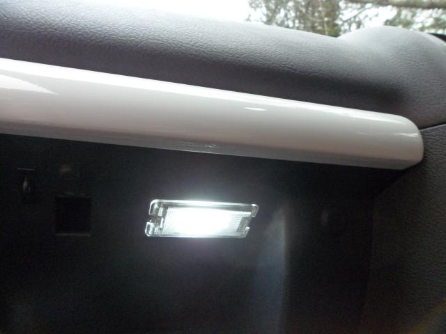

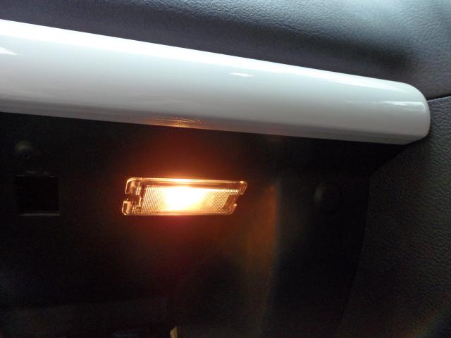

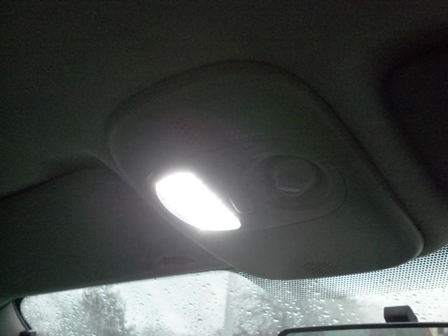

With that done, interior light time... inspired by the guide on here... !

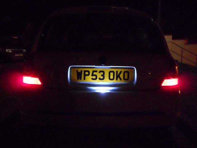

Number Plate Lamp
And lastly.. A sneak peak of the new 182 interior if anyone hasn't spied this yet ;)
More on this later.. that's enough for now !
McGherkin
Macca fan boiiiii
Coming on leaps and bounds!
Happy to help mate, looking good and nice to see the inspiration you've taken, and good work on finishing the centre clock, next on my list so we might need to hook up again :)
Interesting that you had to notch the interior light out though to fit the SMDs, the panels I had (all used now!) fitted perfectly, looks like finding more is going to be a pain!
