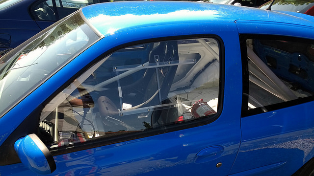

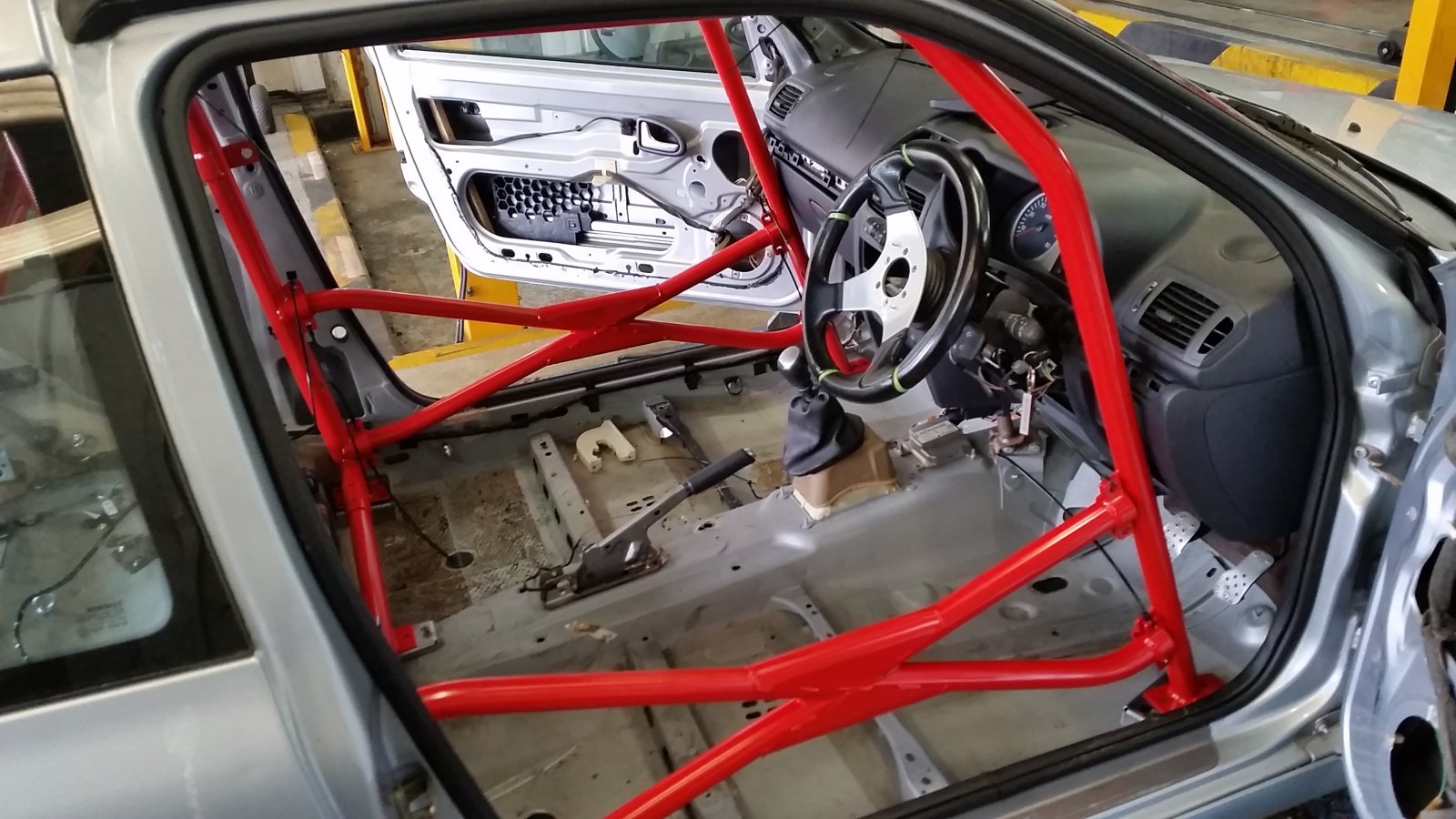

I went for a safety devices cage from Mark Fish, took advantage of one of the group buys, option 4 with the extra mount points on b pillars and tunnel, can always send some photos if you like
Ads
  Clio 172 Merc ML55

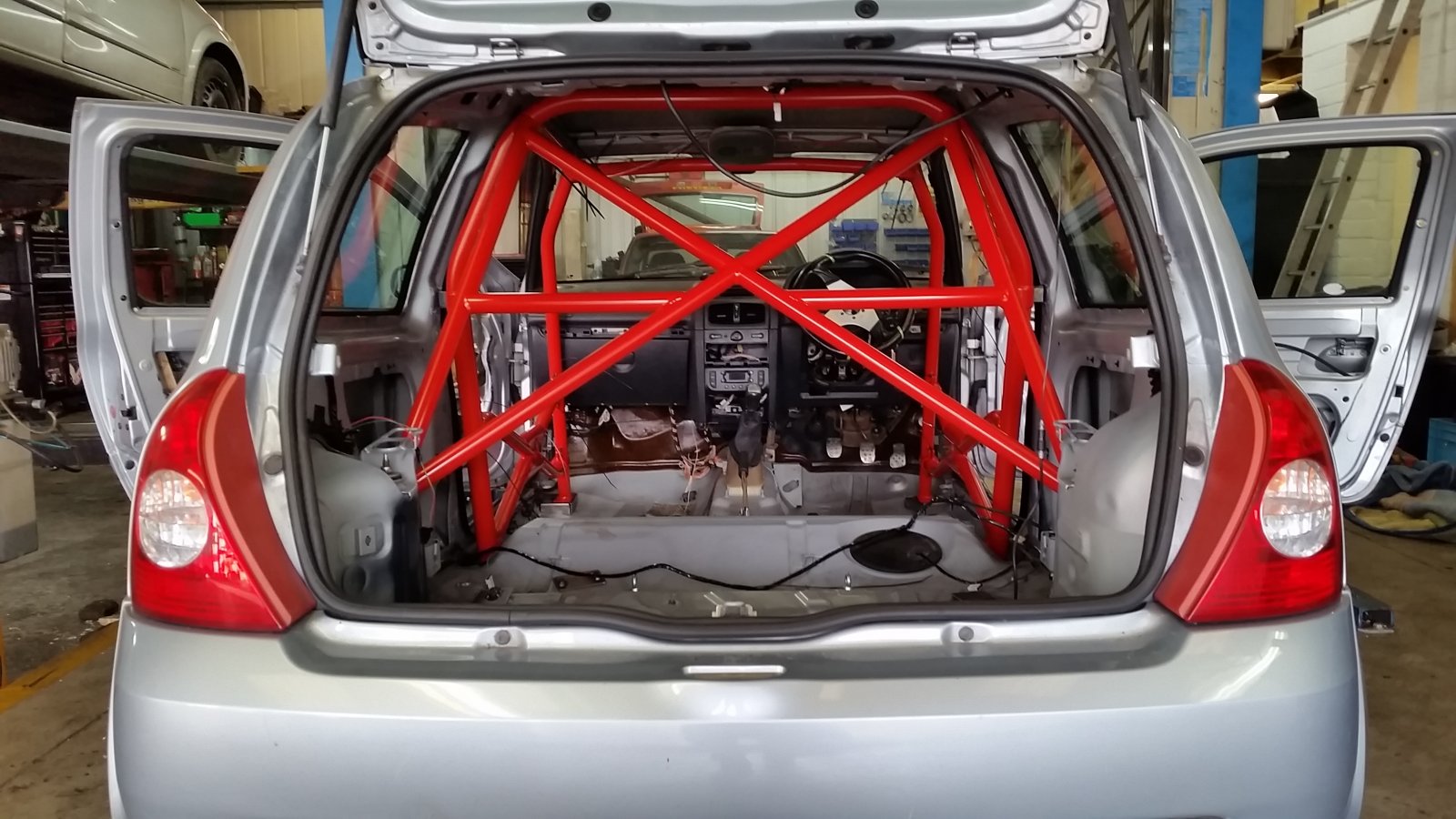

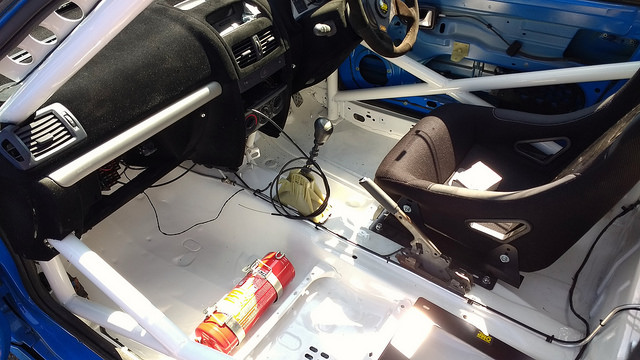

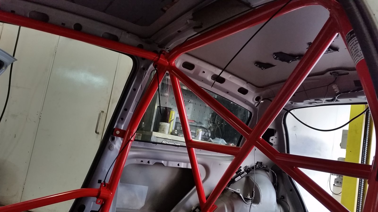

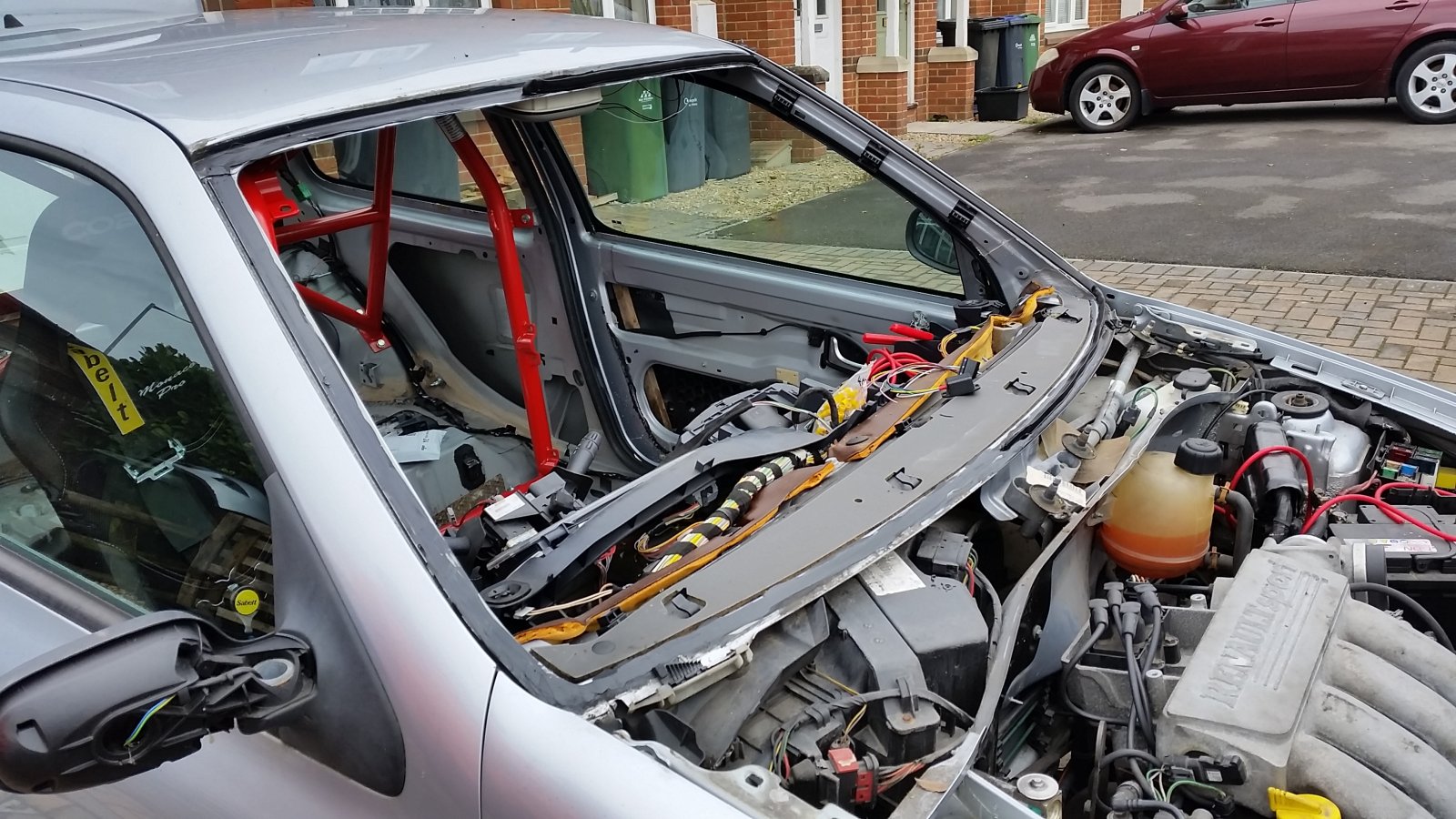

Ok so most of these are from when we installed the cage, hence cable ties holding various pieces in place
If you look closely you can see the centre pick up point on the tunnel in what was the rear footwell
Again extra pick ups on b pillars
And finally door x bars too
As mentioned earlier this started off as a 6 point bolt in Safety Devices R017 (I think) roll cage, and has had extra b pillar brackets and a tunnel brace fitted, so now is 9 point.
These extra brackets are designed and fitted from factory and are an optional extra.
I ordered it through one of Mark Fish's group buys and I couldn't be more impressed with the service and quality of the cage, yes there cheaper cages out there but personally I rate safety devices highly so opted for this
Hopefully it's of some help

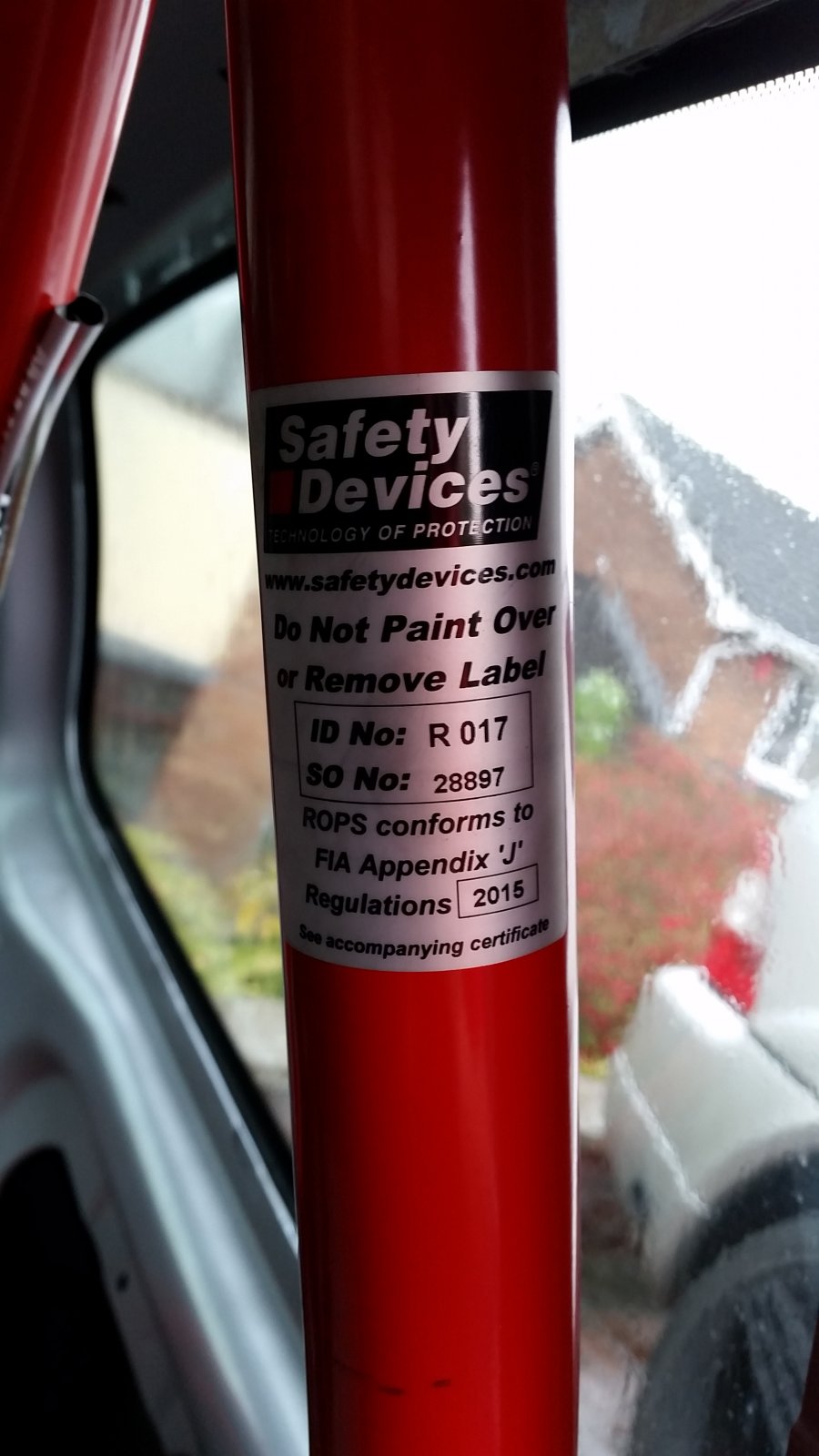

It's definetely MSA spec, I've got a feeling it's FIA too, I'll have a look when I get home and grab a photo of the I.D. plate on the cage

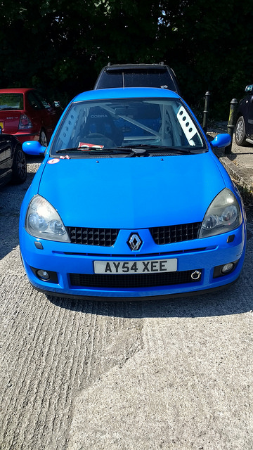

Saw this advertised locally on Gumtree a few weeks back, also happened to see you coming down the A30 the other evening. You decided to keep it?

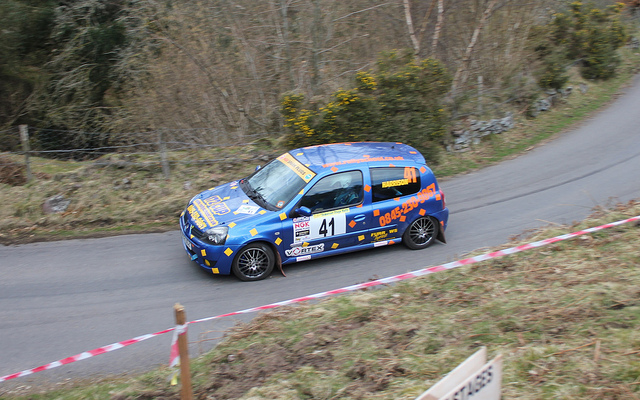

Just found this image I took at the Somerset Stages a couple of years ago! Dont see that many Clio's out rallying so seeing so many on here either done or about to be done is great.
Dont know anything about the day does anyone?

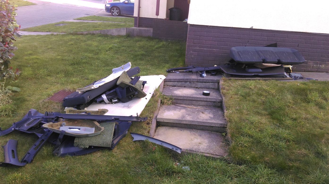

This is the pile of crap you get when stripping the interior
This is the start of the project properly

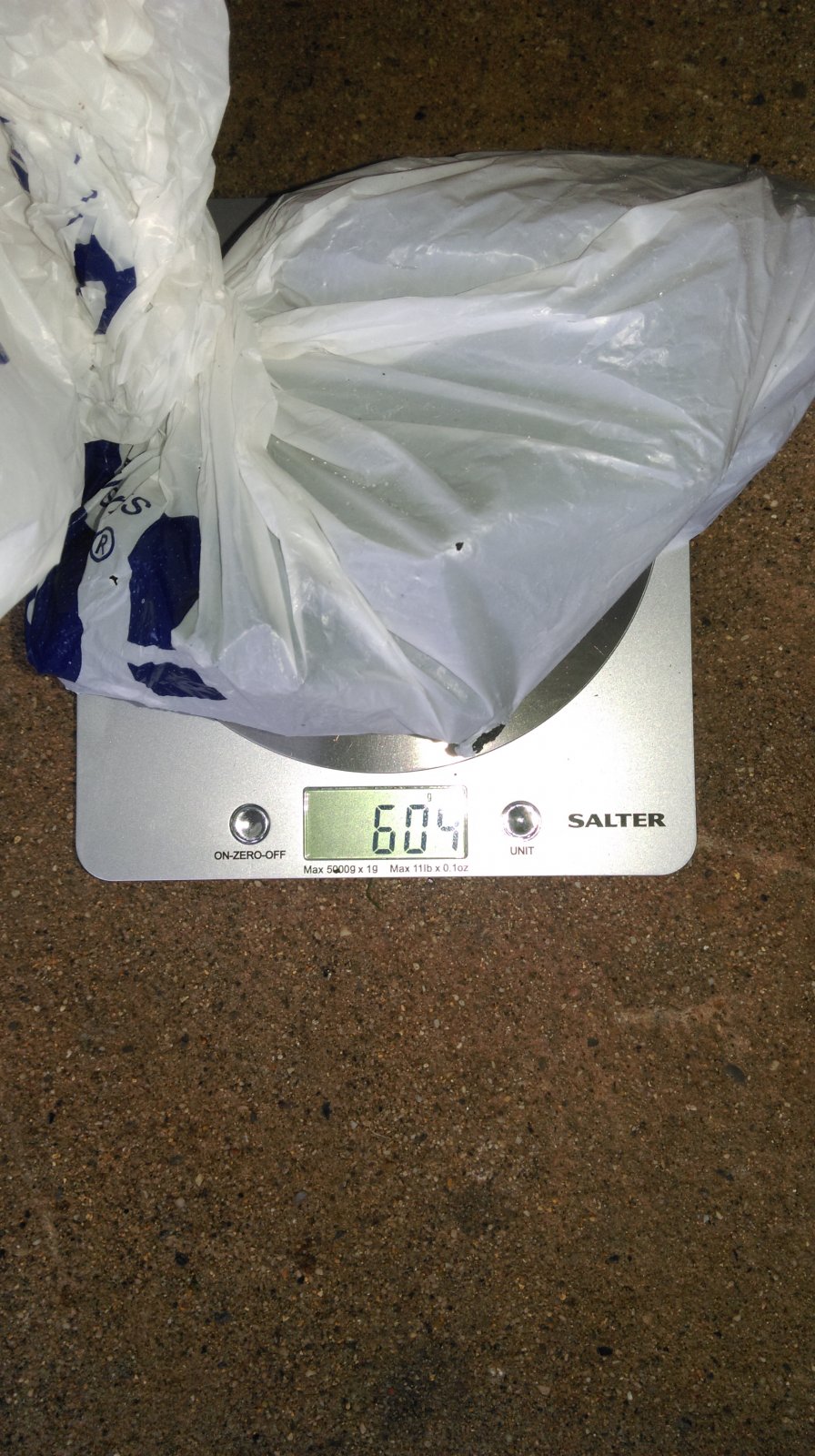

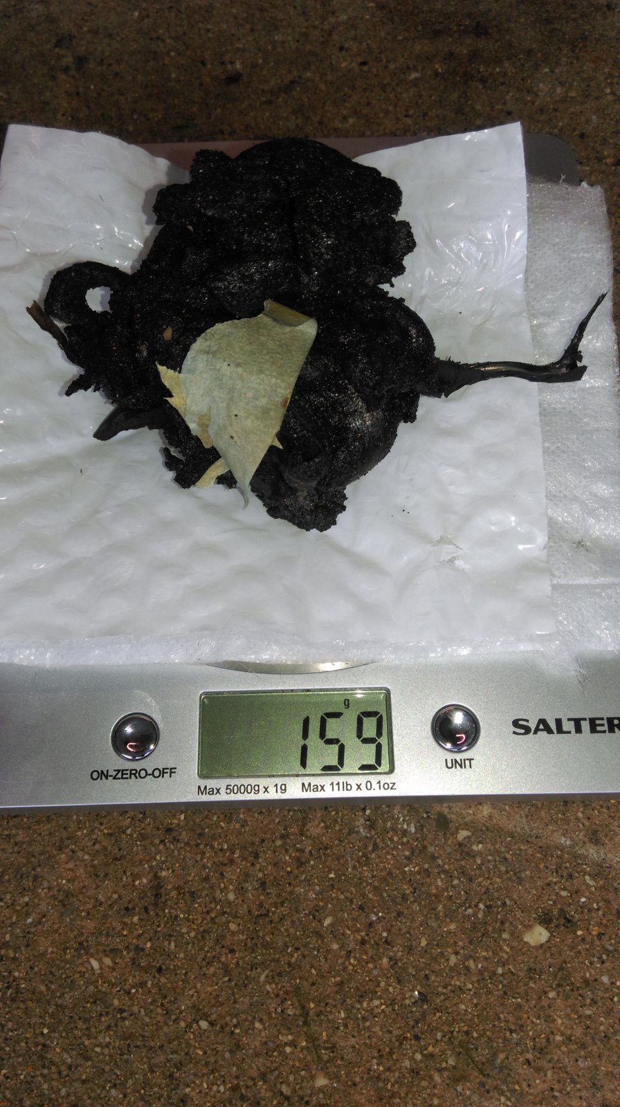

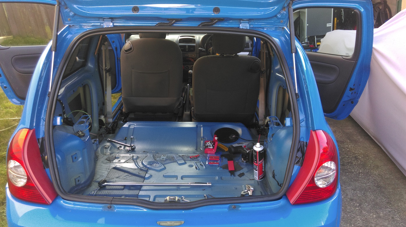

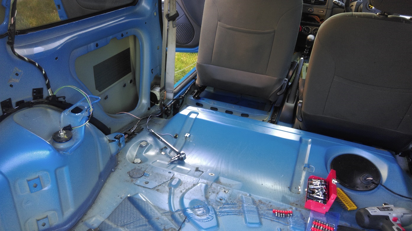

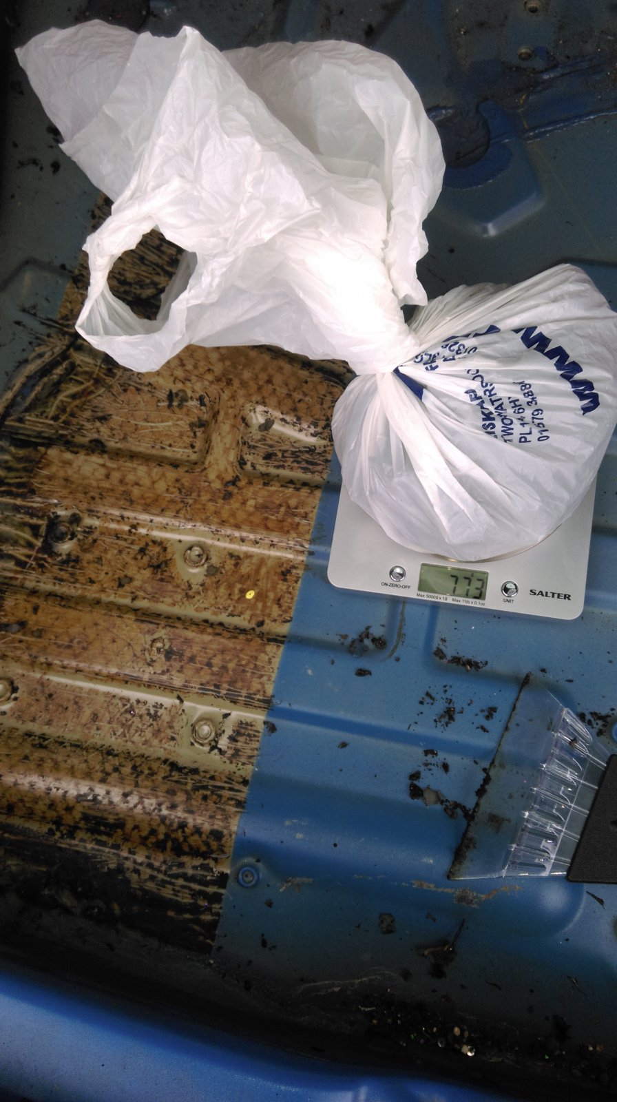

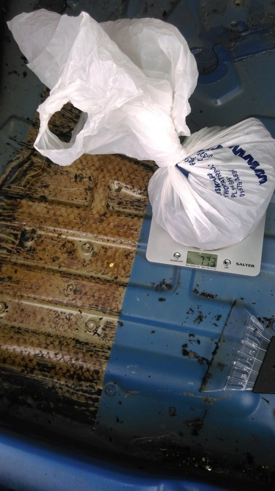

Started stripping out the sound deadening what a S**T job but glad I'm doing it. I decided to document each area.
First patch is the bit in the boot 773g
Second bit
Behind each seat 604g so 1.208kg
The bits in each rear side section 318g for both sides
I also started the roof and that is a crap job will update with the weights as and when!

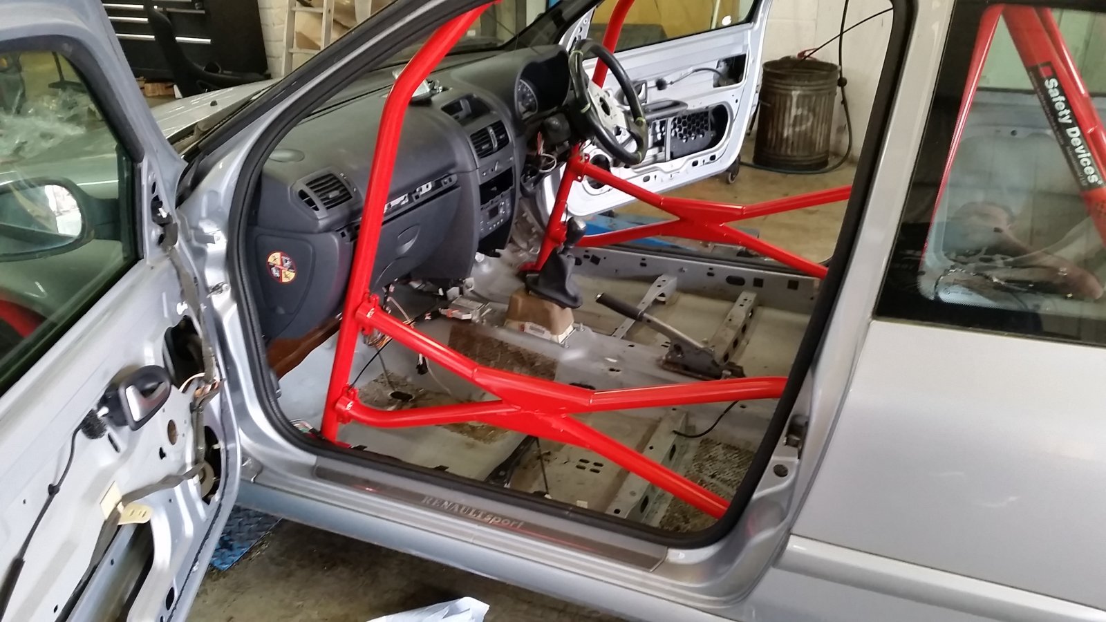

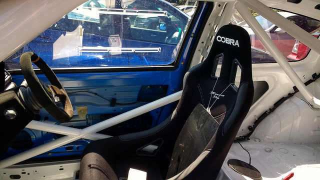

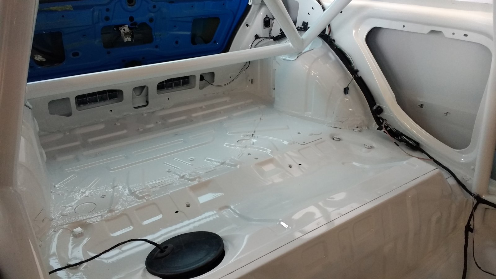

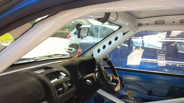

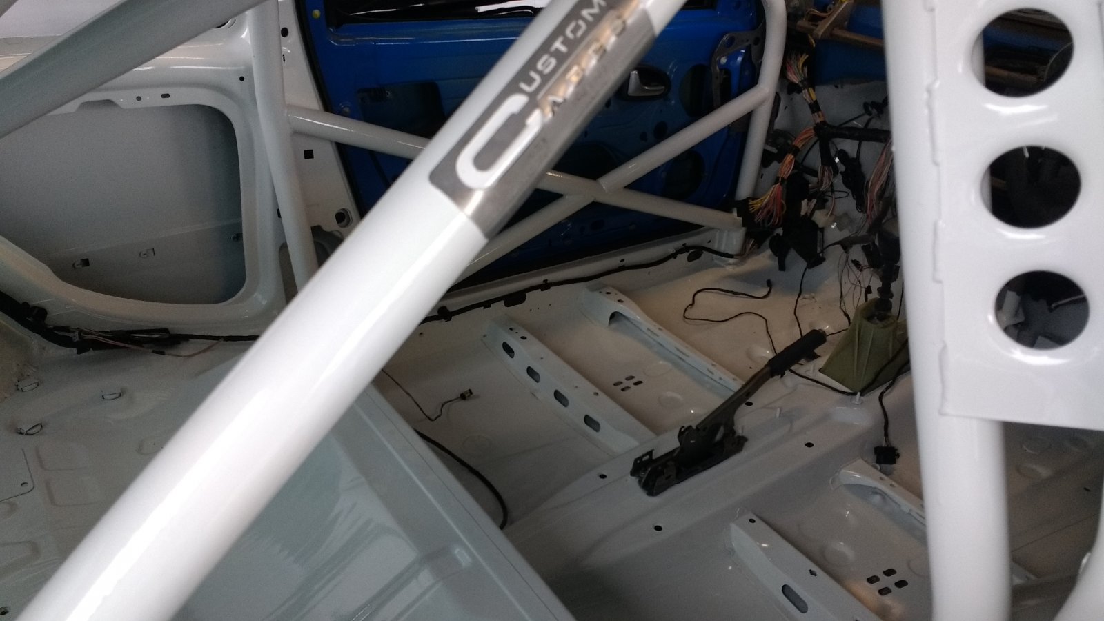

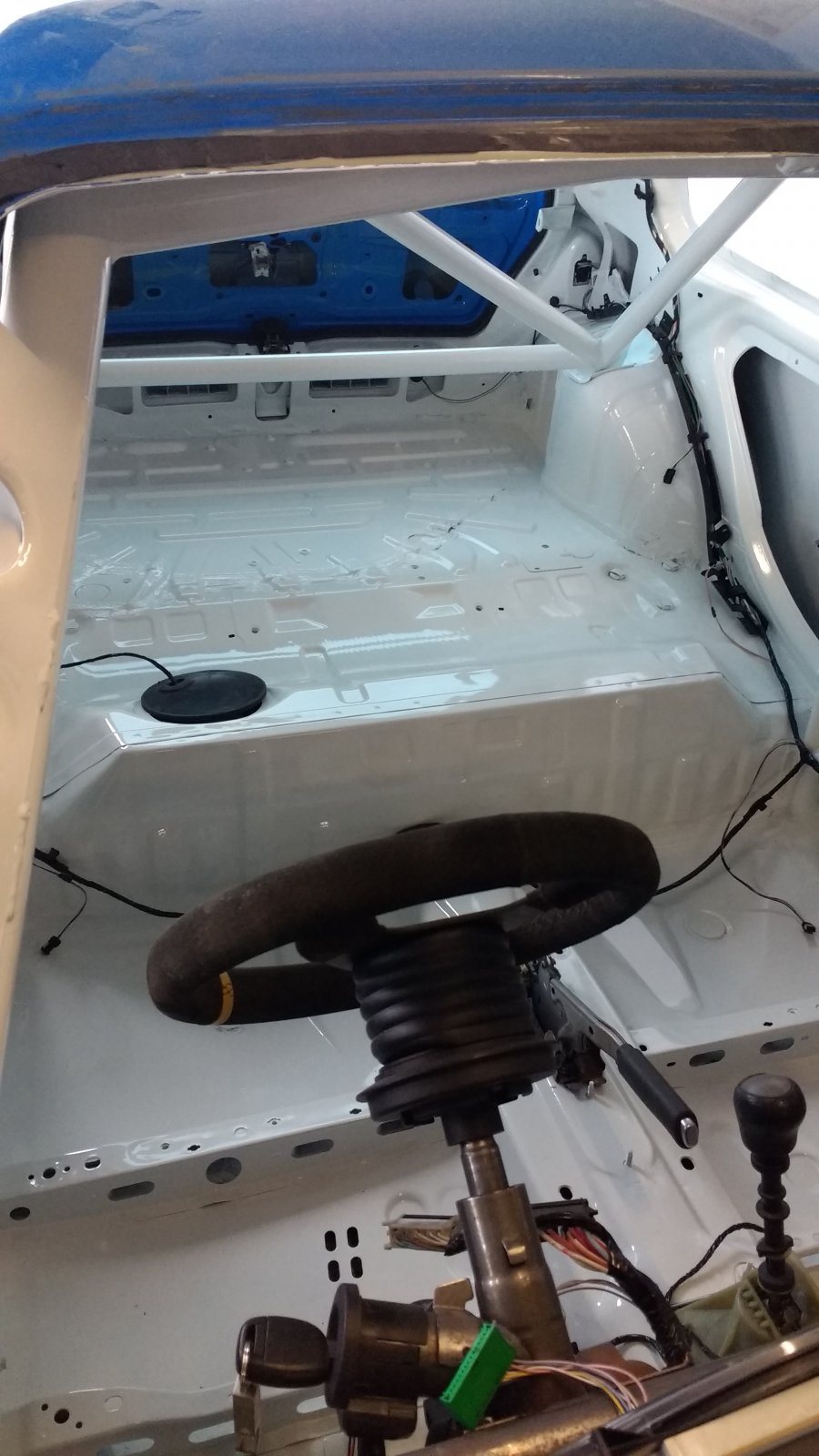

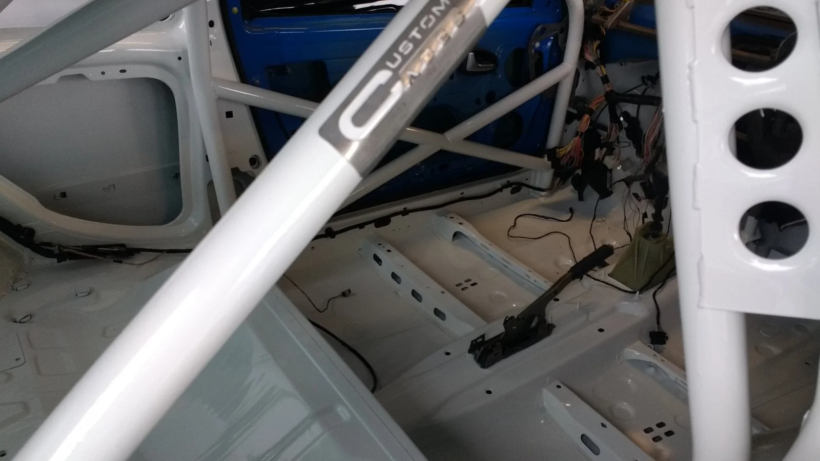

A small update. The custom cages cage has gone in along with some extra gussets and the car is now without flex!
Couldn't get to open doors to get better pics this time as a gearbox on a pallet was in the way. Flocked dash going back in this week then the plexi glass and the foamex door cards front and rear. Then Seats/Harness and extinguishers etc.

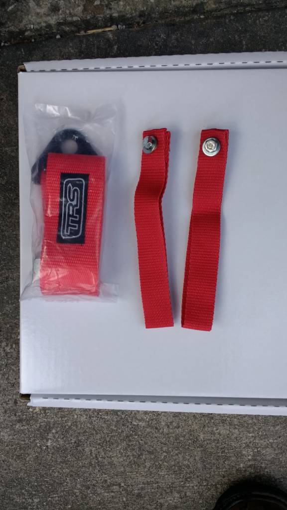

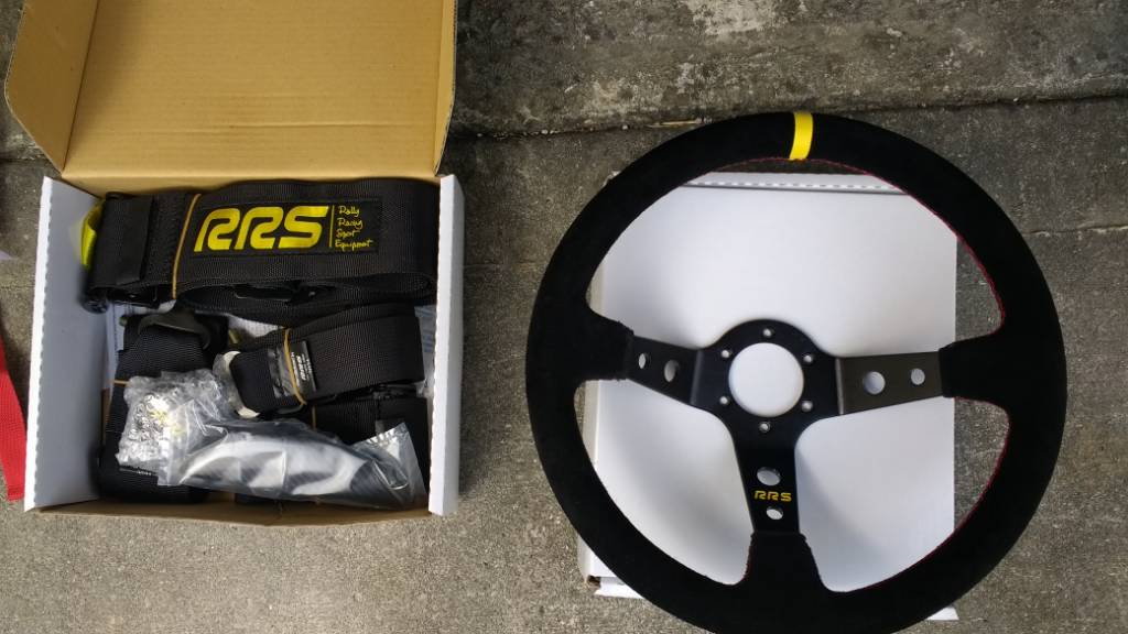

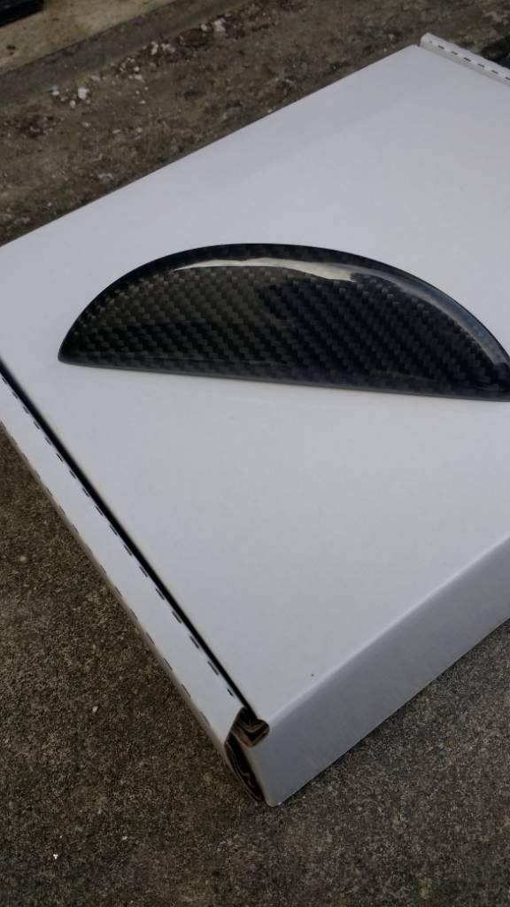

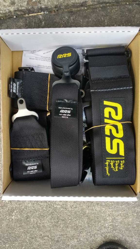

Some more bits aquired and going in the car soon. RRS 3" 6 point harnesses and RRS dished steering wheel. Carbon rear wiper blanking plate and some tow and door straps as the door cards will be fitted and require a method of grabbing.

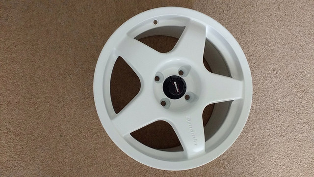

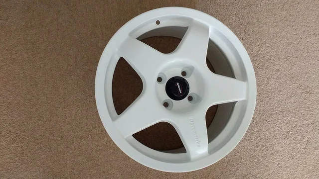

And to wheels I have these Team Dynamics but still not sure on tyres ??? need to last 100miles for TSH rally but also be soft enough for a sprint/hillclimb so may need 2 sets + wets but a spare set (ouch gets expensive).....
