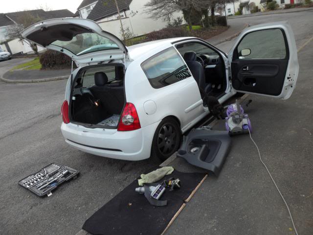

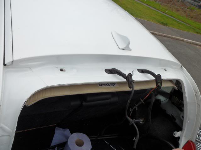

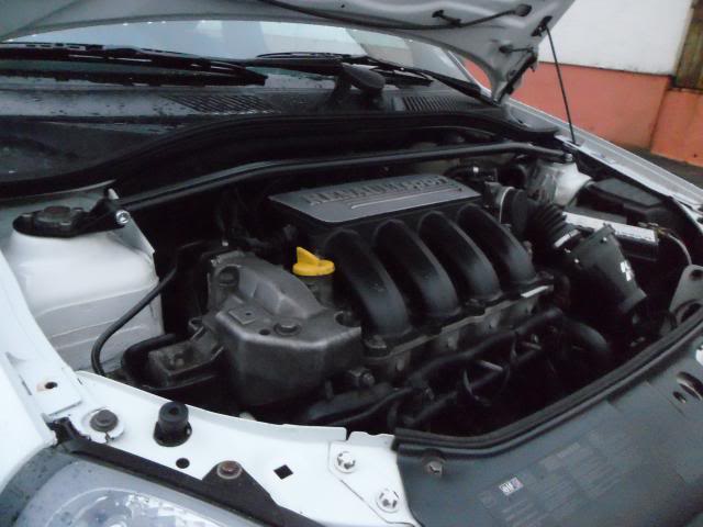

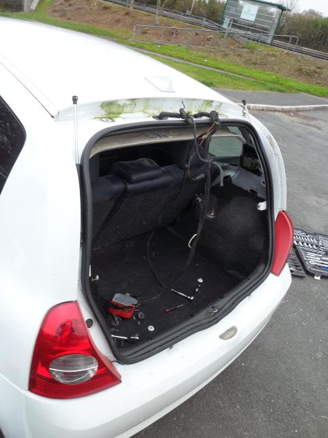

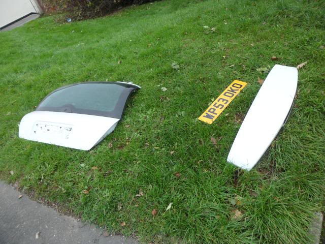

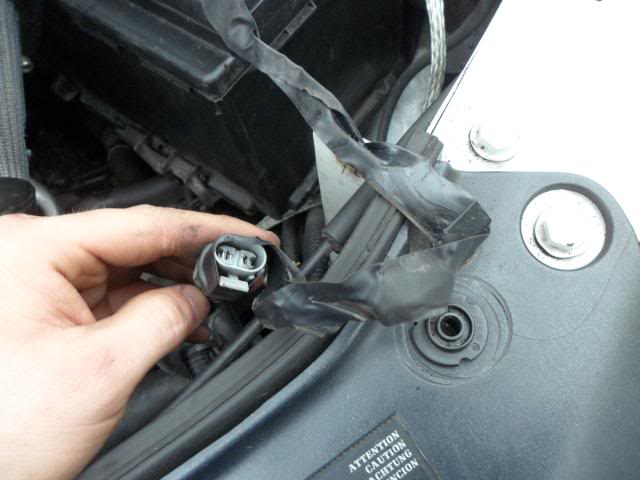

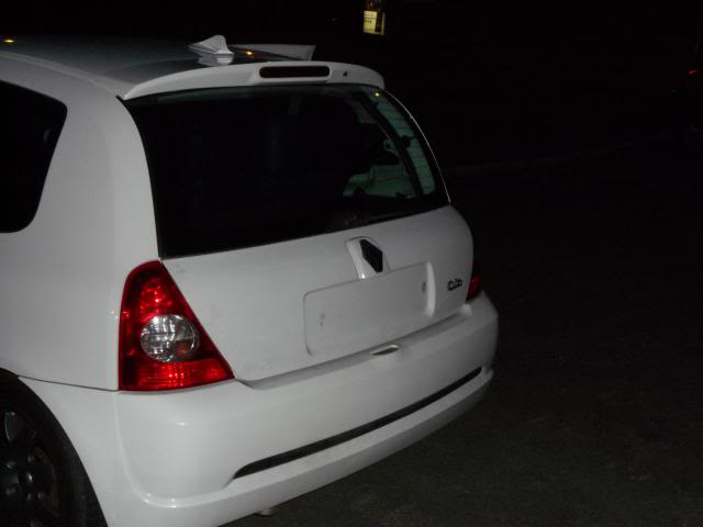

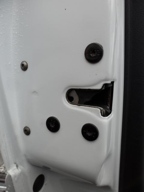

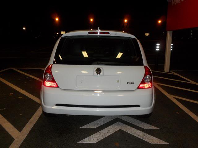

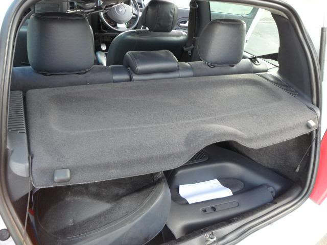

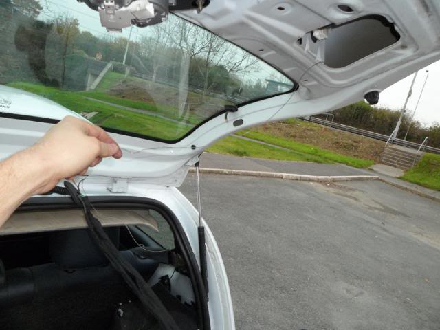

Changed the bootlid at last
Cleaned areas and routed wiring etc

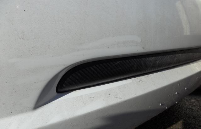

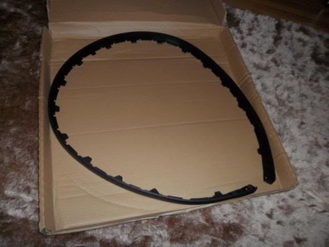

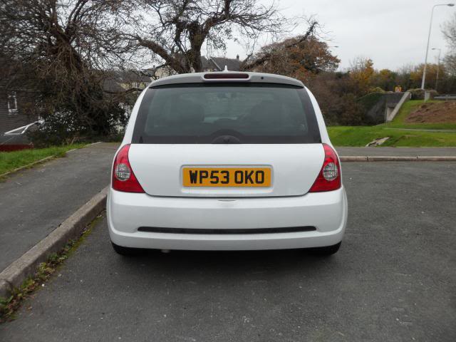

Old number plate snapped from an over kill of tape

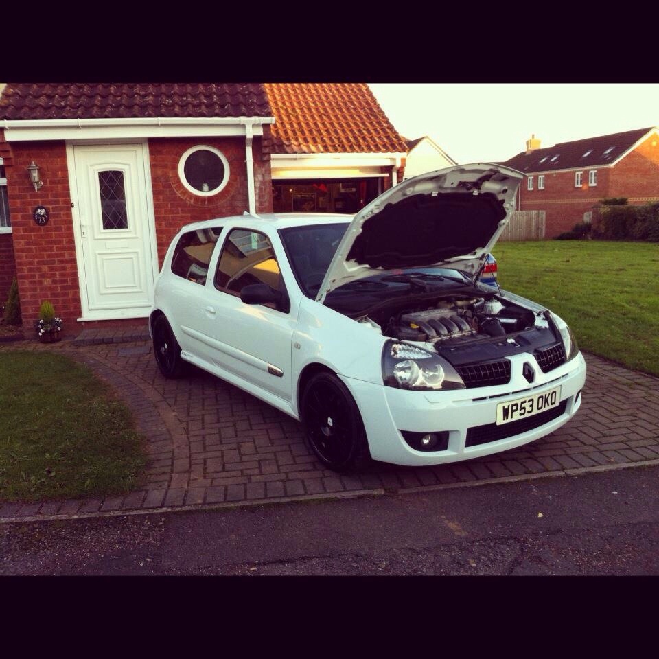

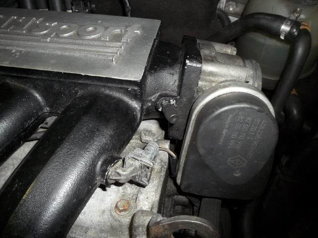

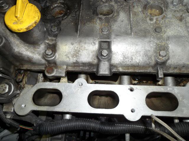

Ordered a new one, but here it is before I cleaned and polished it up
Next..

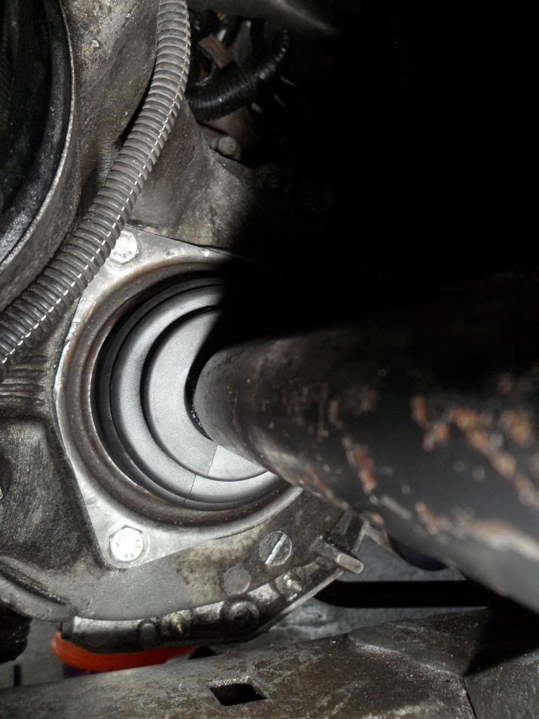

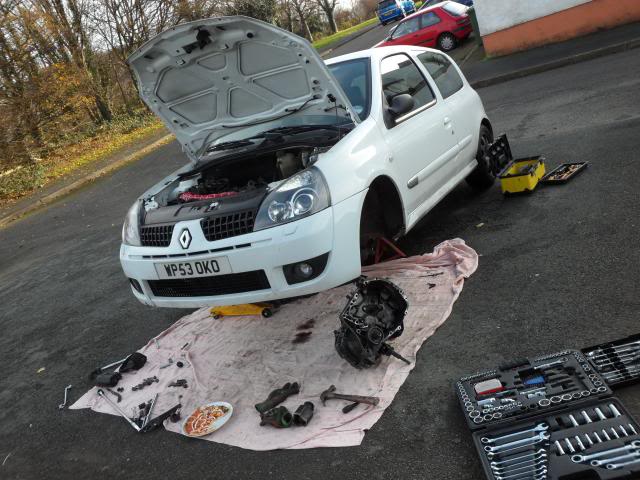

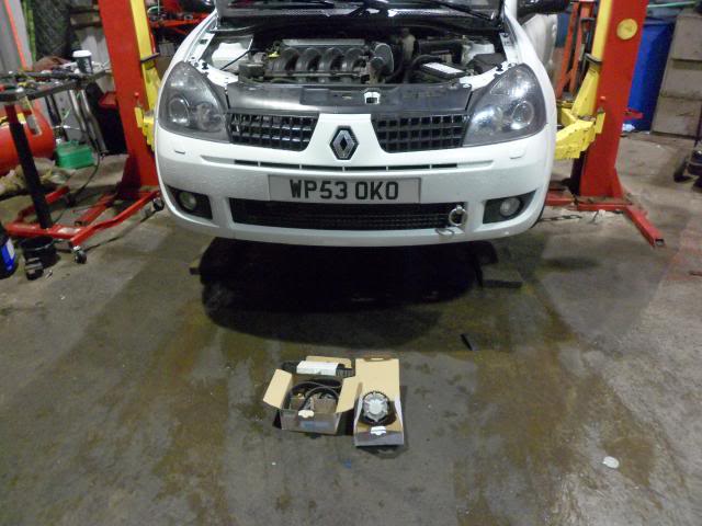

The Cup decided to ask santa for a clutch...

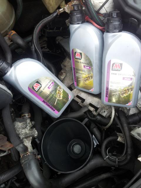

Mean't I could fit my speedo drive box, Millers Fully Synth and an OE non-slipping clutch!

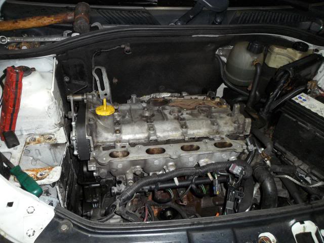

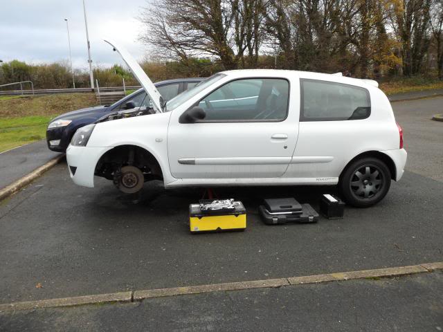

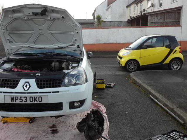

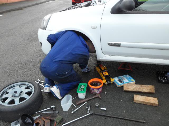

Tool's at the ready here goes..

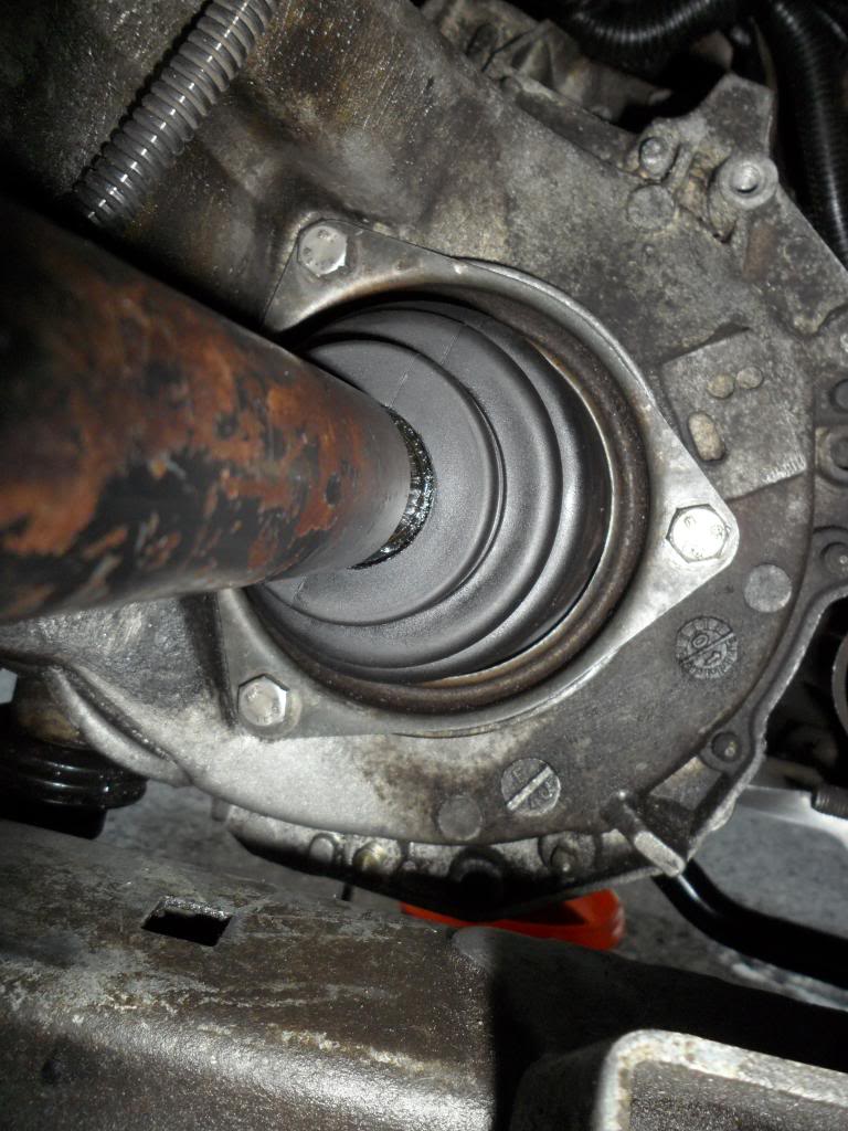

This job was a complete nightmare working on the floor, barely above freezing temps, on axel stands, and on your own bench pressing it all!
Note the transport in the interim ...

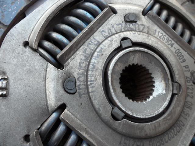

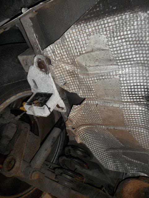

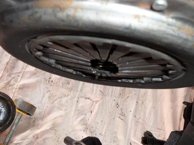

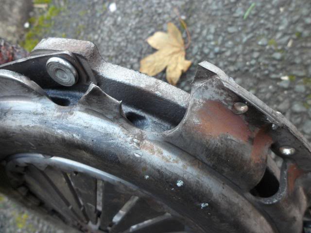

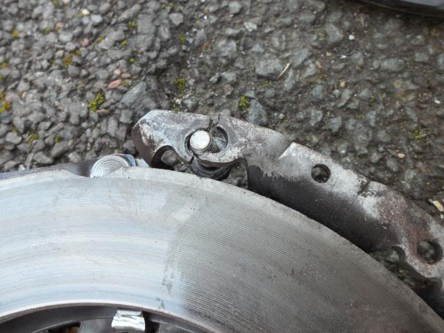

What I found :dead:
Pressure plate.. bolt stuck in place and cracked casing

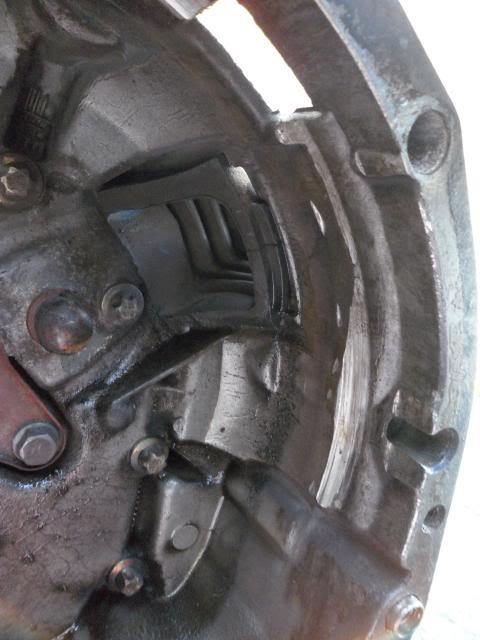

Other side completely broken off (piece was still bolted in the flywheel)

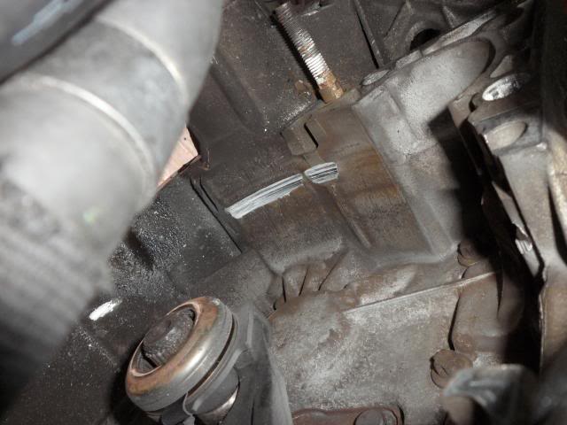

Gearbox casing scored but luckily not damaged at all

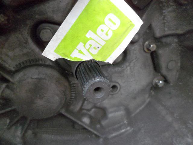

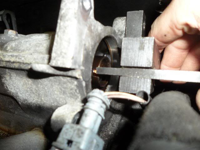

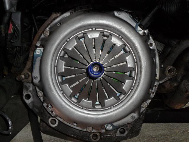

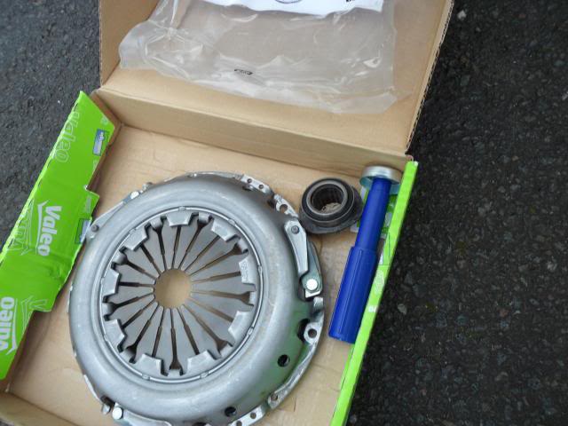

New Valeo Clutch, bearing, pressure plate, grease and alignment tool and plate

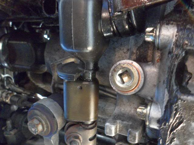

Boom! Aligned a beaut, box slide on first time on my own

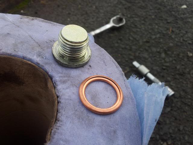

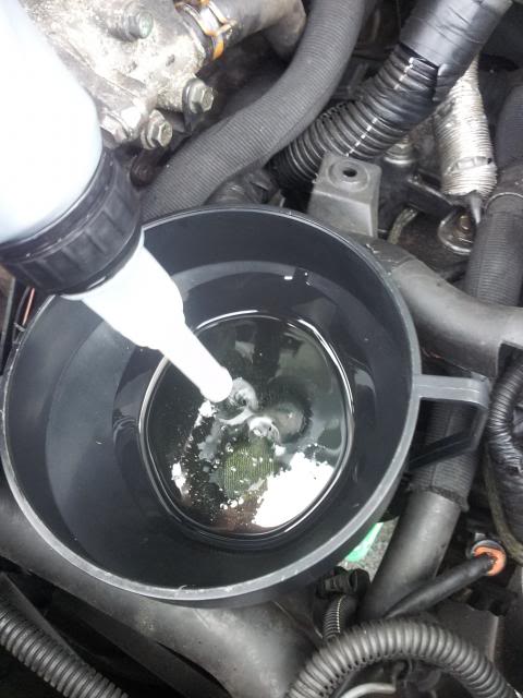

Sump plug washer replaced and silky new oil going in
A huge amount more happened in this clutch / gearbox process, but very happy to know it's done correctly.

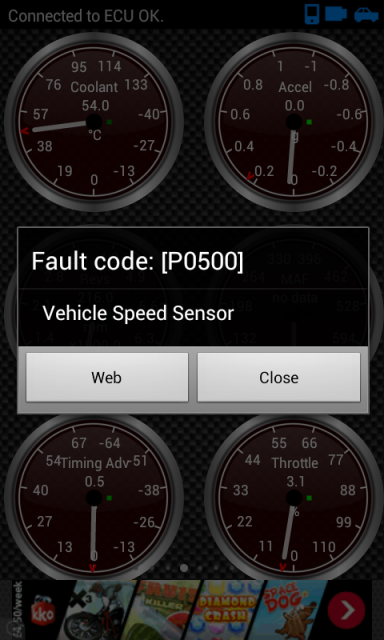

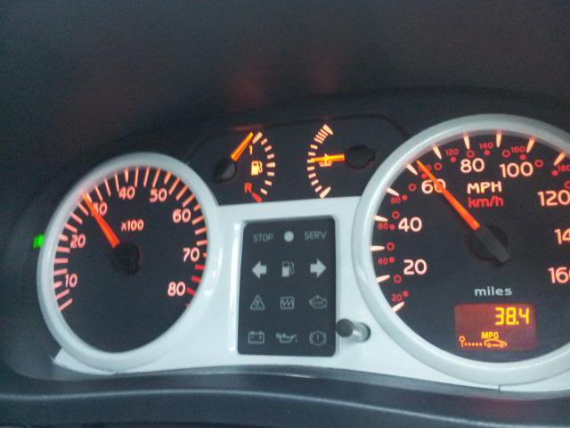

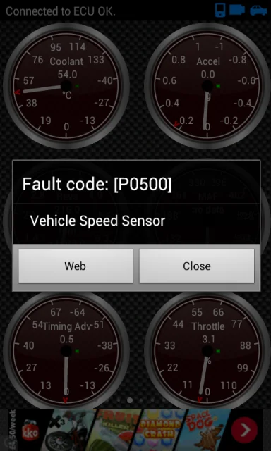

Anyway finally mean't I could clear this code! :cool:
The car was pretty lagged with all the work so a Karcher / Meguiars clean down

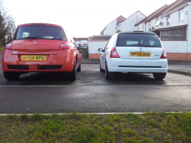

Gave the misses 225 a once over, however I only dried the Clio
Took it to the end of the street and back, speedo working, auto lock kicked in, and things were feeling good apart from the camber was miles out.

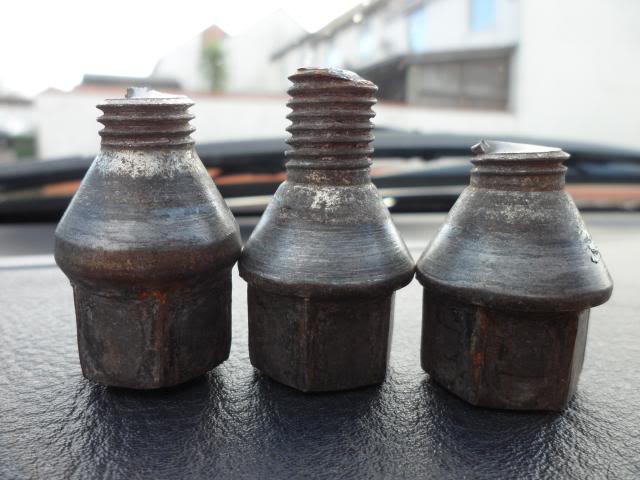

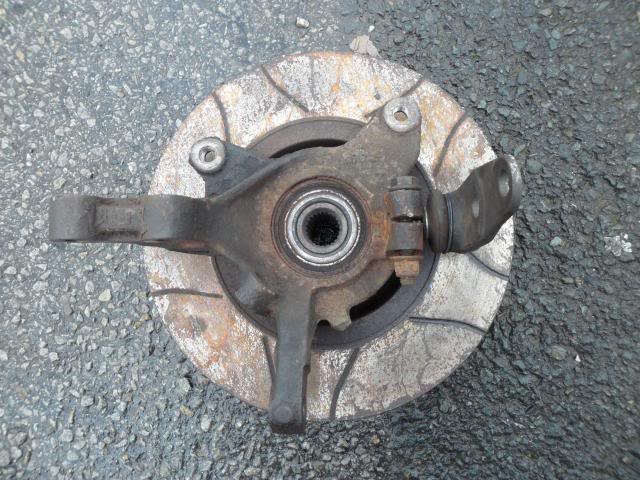

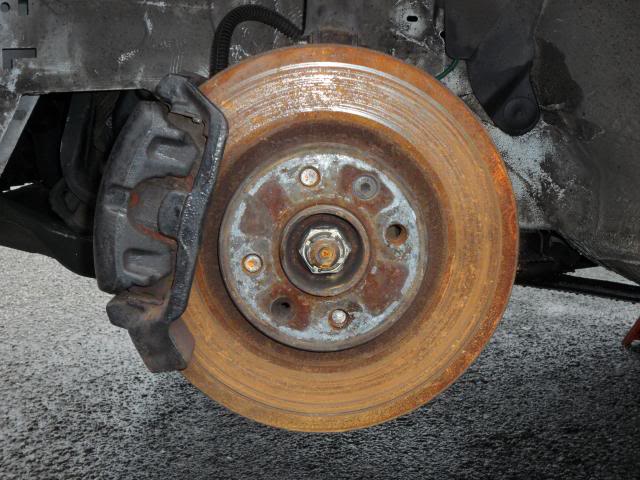

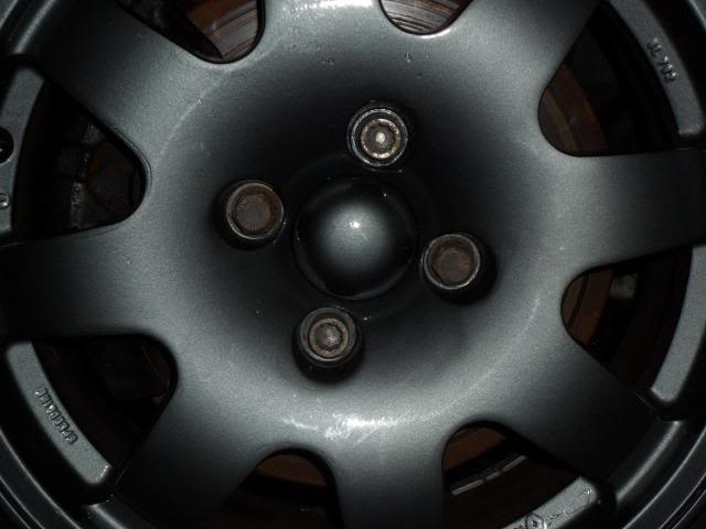

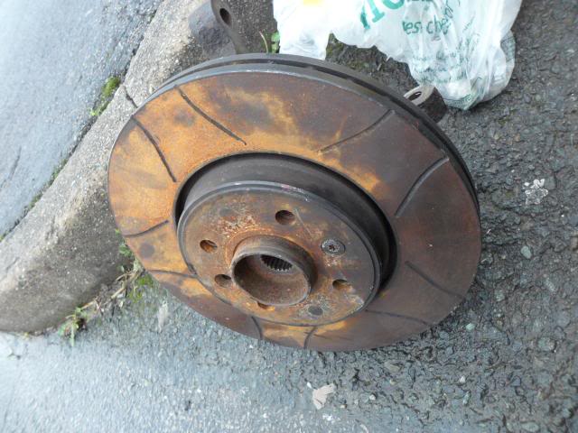

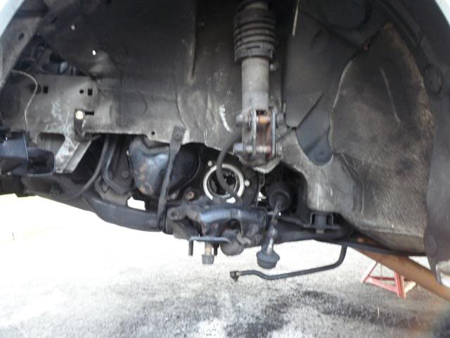

So went to pull the wheels off but the passenger side bolts decided to ... :mad::mad::mad::mad:
Fix one, gain another I guess!
Will be sat around until the replacement hub arrives to save me faffing around with removing the studs
Sigh ! :D
Ha thanks John
Always been real aware of wheel bolts since a garage years ago used an air gun damaging the bolt threads, the alloy it self, and chewing the lockers !
I had only just tightened these up, rolled down the street and back, and they un-done like toffee :( All on the passenger side hub
Glad they didn't pop off on a corner so replacing any suspect ones now but not a good end to the job at all, the clutch surprised me more, can only put it down to the heat from it slipping causing it as I have been nursing it since I've had it ?!
EDIT: I've just noticed one of the snapped wheel bolts are different !

Studs snapped on my beamer while I was driving it. . They will loosen with wheel off mate I got mine out no problem...
Yeah I need a stud extraction kit or something ideally as don't want to sit there drilling them, and can't get anything on them at the moment.
So will replace the hub itself and just sell the other one once repaired or keep as a spare.
Snapping bolts while driving.. no time for dat!

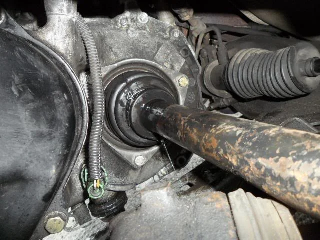

Hitting a couple of problems on the way (CV Boot wasn't seated and leaked around a litre of oil onto the floor etc..)

Was going to say that one of the bolts is different but just read you've seen it.
Do you think that could have been the cause?
I have no idea really, but my money suggests it didn't help, although they felt fine when I swapped the wheels over when I got it, and when I put them back on after the clutch change. I could understand if I used a breaker bar and jumped on it but I spun them on with a socket then used a wheel brace and just quarter turn nipped them like I've done for many years on car, never cream them up.
Never mind it's minor in the scheme of whats gone on so far mate :)
Hmm very strange. It could have been a lot worse though!
It's a good job you weren't flying down the motorway or anything.

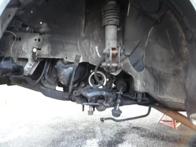

Here we go again... Continuing from the last set back...
cs_dave kindly sorted me a complete hub
Plan: New wheel bolts all round!
Job done

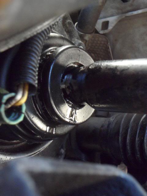

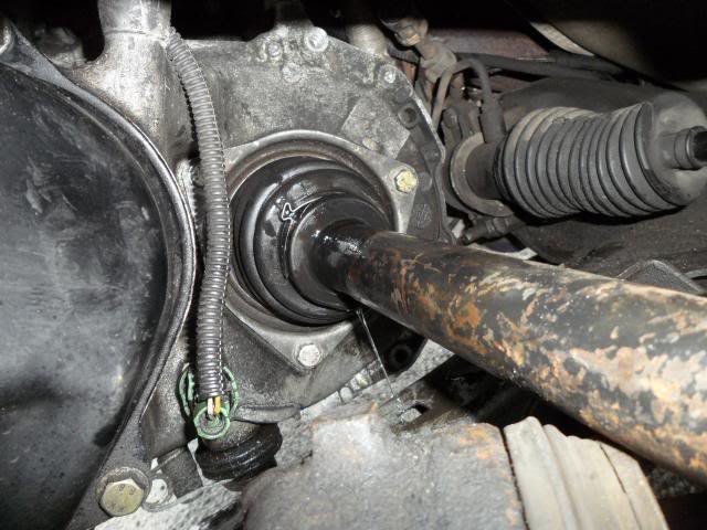

Or so I thought.. :dead:

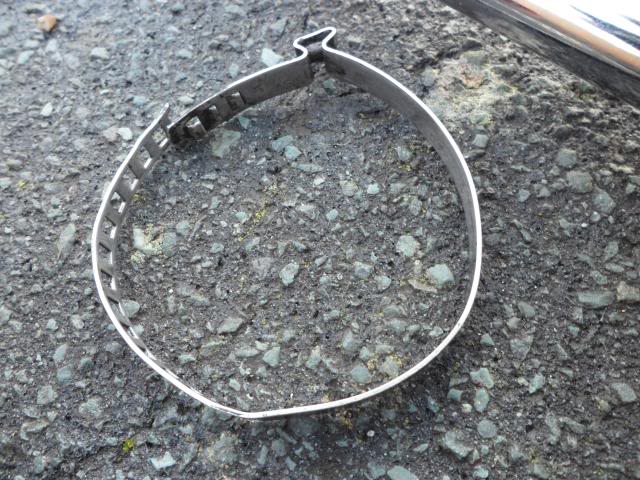

Boot popped off the bearing
Re-seated but still leaking
Another gear oil drain !

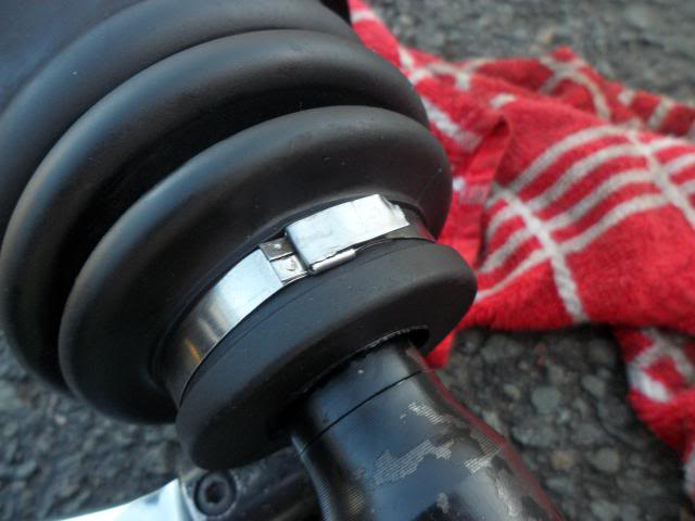

Turned out the boot clip was my issue, no wonder I couldn't solve the leak, should of spotted this after doing the box :eek:
Degreased inside and out, now with permanent clip, pressed on with tool
Given the oil had been drained through three times, and I had lost half a litre... Another Opie's visit
Sorted :cool:

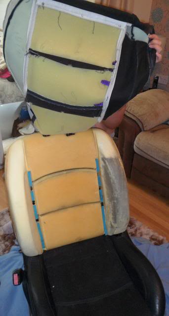

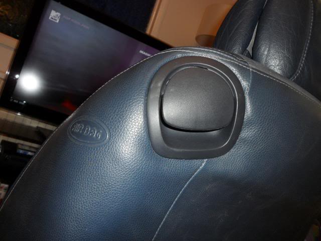

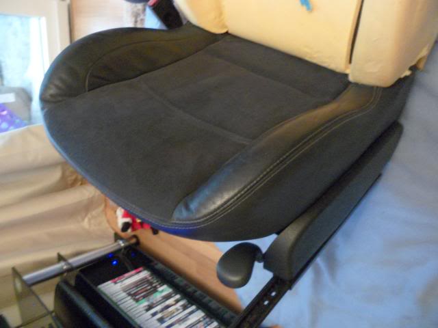

Moving off the mechanical side of things for a minute

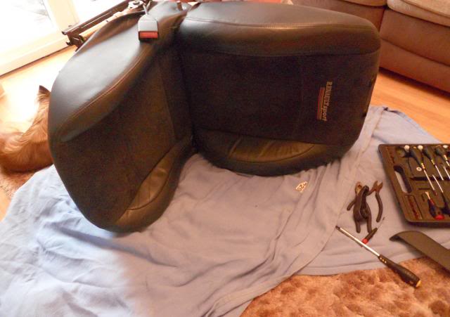

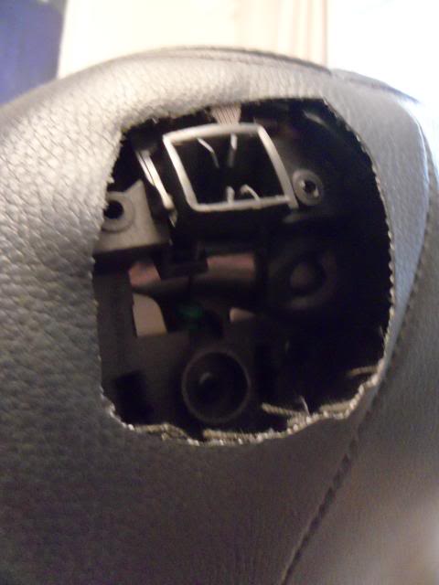

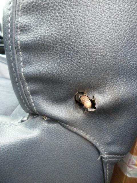

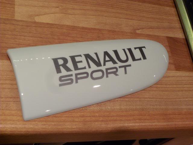

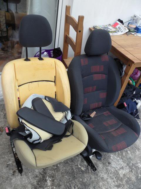

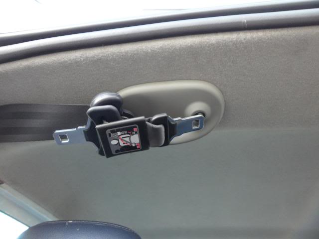

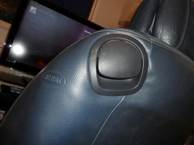

The passenger seat wasn't able to used for getting into the back, because of this

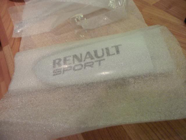

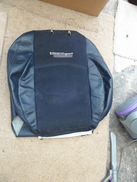

Still had the old seats lying around, and personally prefer the phase two handles, so they got used as donors for a phase 1/2 swap

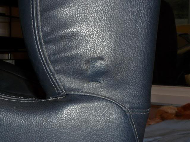

The hole from the old handle, used some black tape behind, then super glue to pull it all in
Then used a small patch from cutting out the new handle earlier
Without the flash on this isn't hardly noticeable now its in the car :) Will do the drivers seat in time

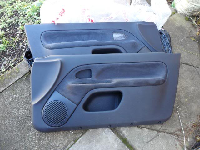

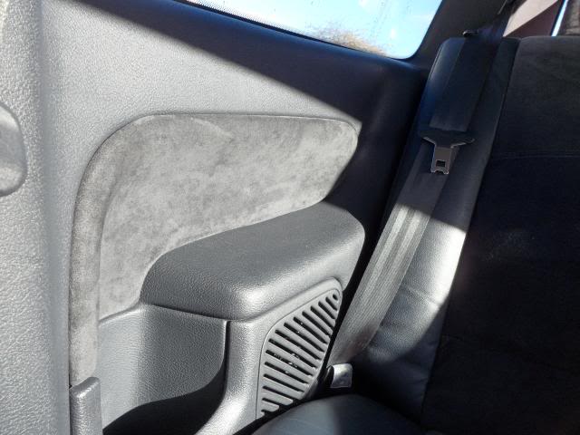

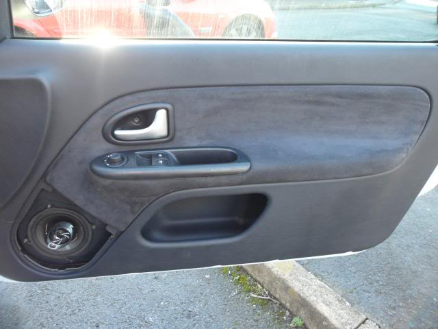

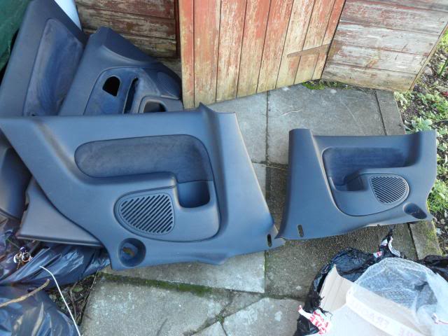

Alcantara door cards

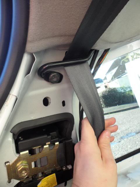

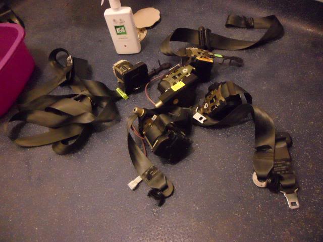

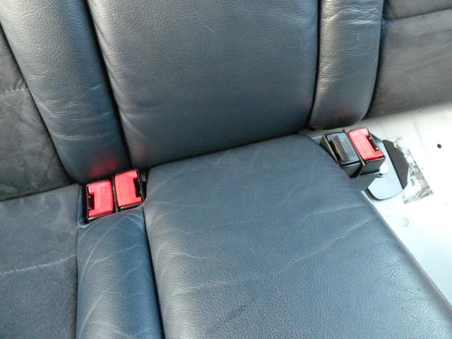

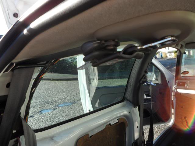

Cleaned these up along with a new set of matching black seat belts
Fitting time, replacement plastics, trims, new clips, parcel shelf etc

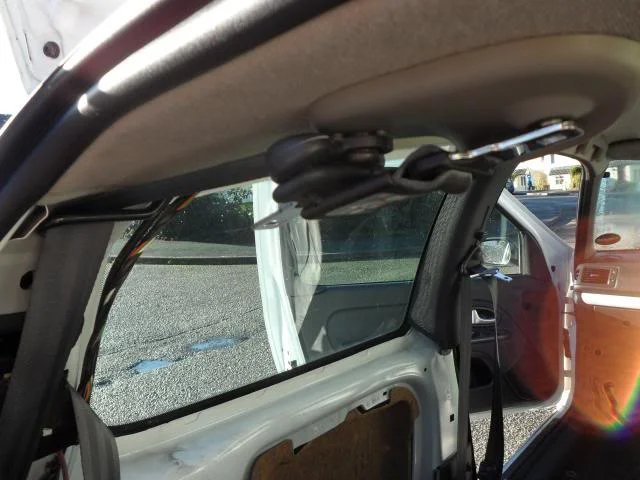

3rd rear belt swap

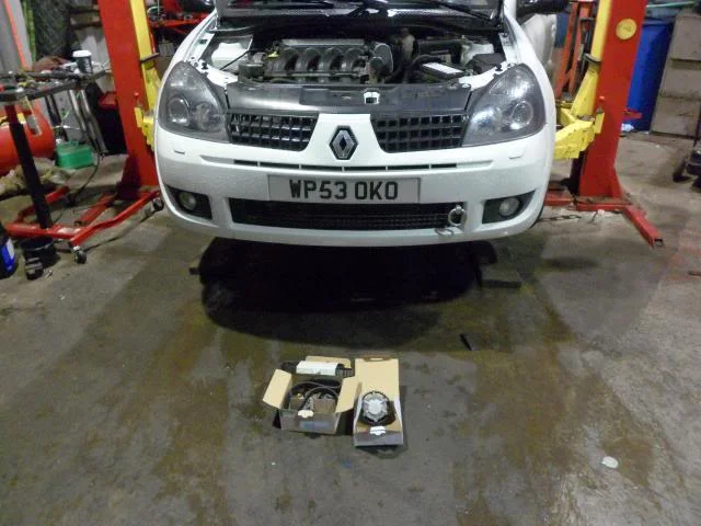

Today was time for a road trip...
To Dan at SJM Automotive - Thanks for getting these photos for me :cool:

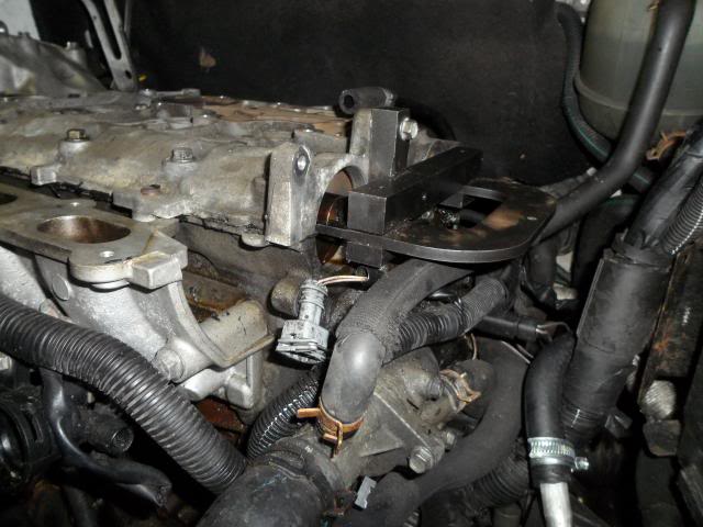

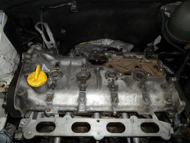

Cam belt kit
Dephaser
Aux Belt
Cam shaft seals
Oil and Filter

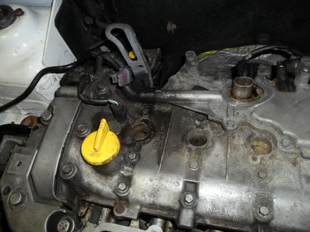

Rocker cover resealed
Sump removed and resealed
and a couple of other issues put right he found (like the aux belt fitted the wrong way round and a tensioner :S)
Note the oil collected from the leak..

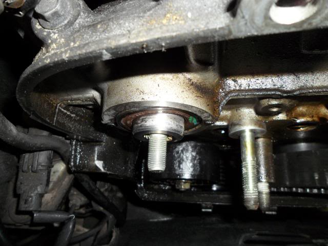

Re-coiled inlet plenum threads and replaced the bolts as they were all wrong and threaded!

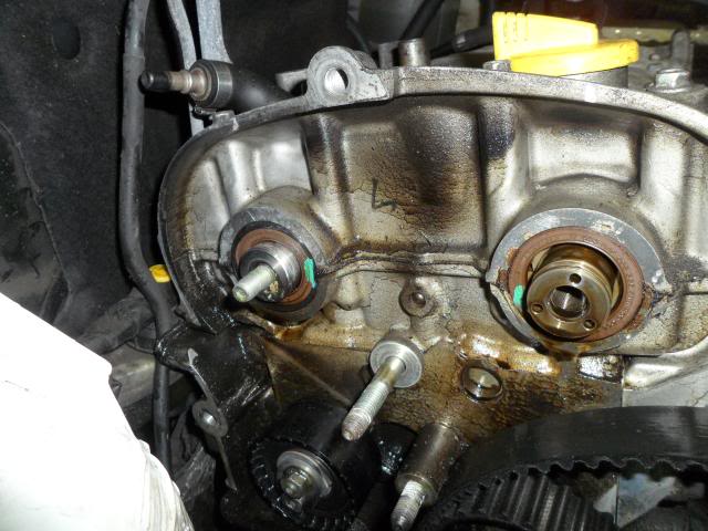

Timing before
Leaky cam seal!
Not seated correctly from the last belt change
Timing
A bit of cleaning and degreasing etc..

Cambelt tensioner ;)

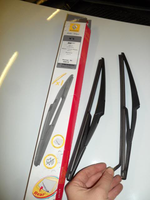

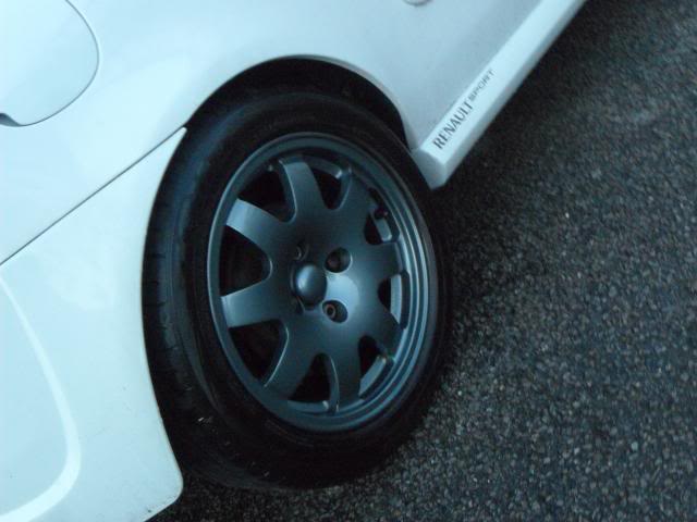

Now the weathers improving after the South West storms we've had lately, the rear screen was finally warm and dry enough to fit my CS interior sticker
Cleaned up the wheels

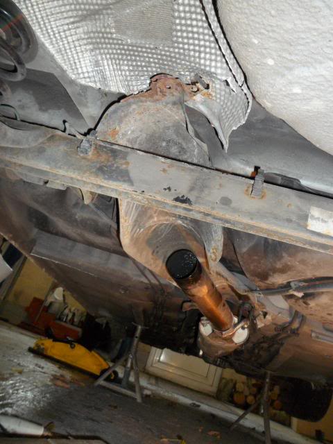

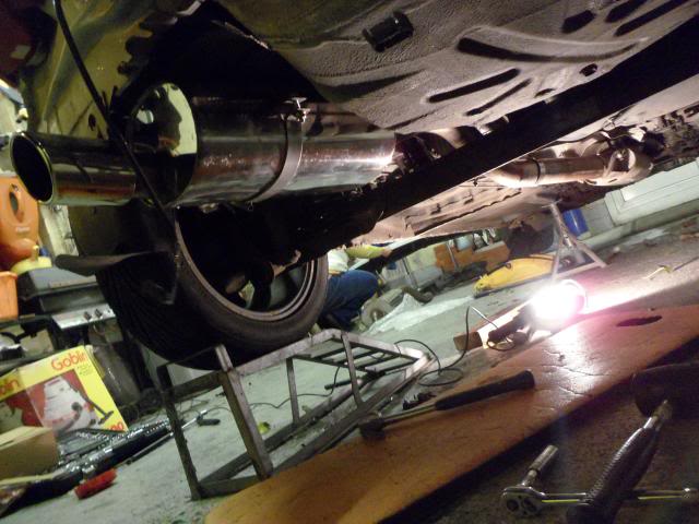

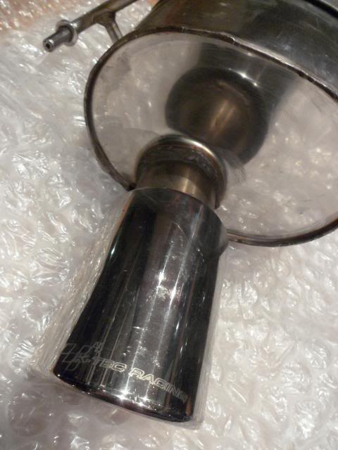

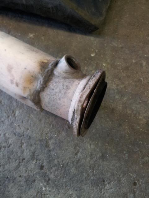

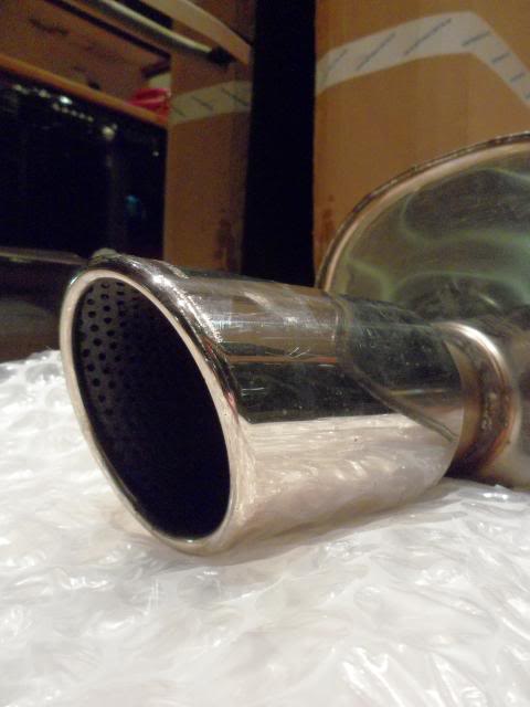

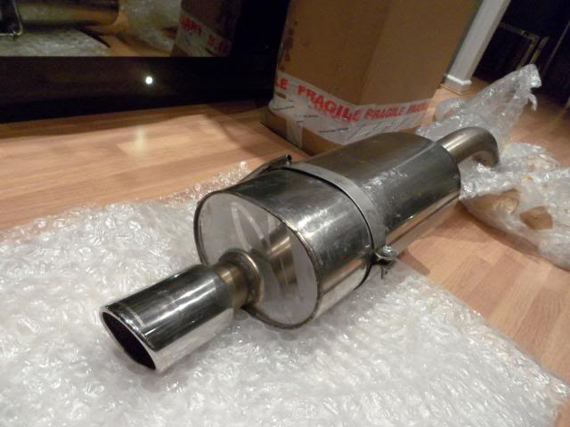

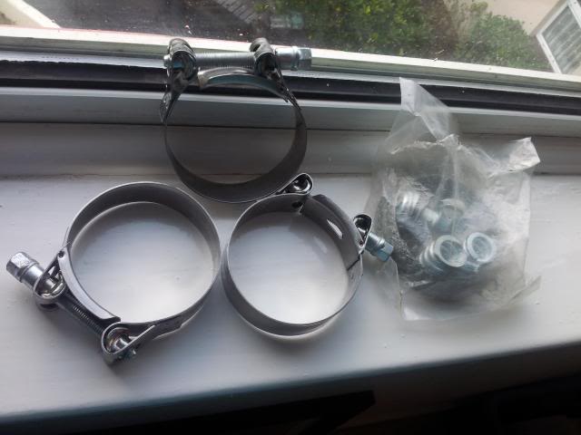

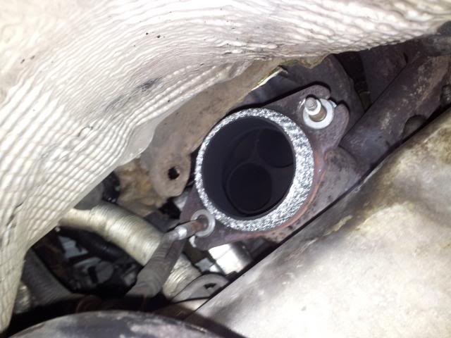

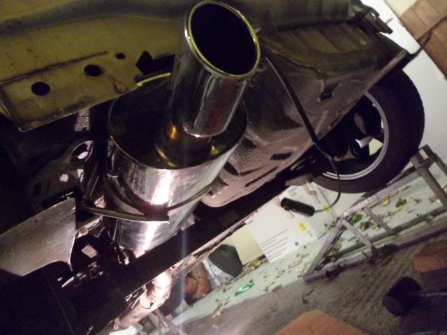

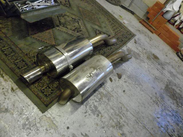

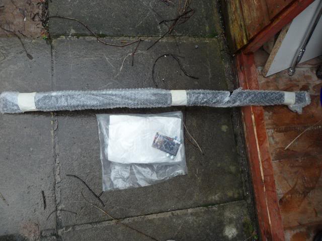

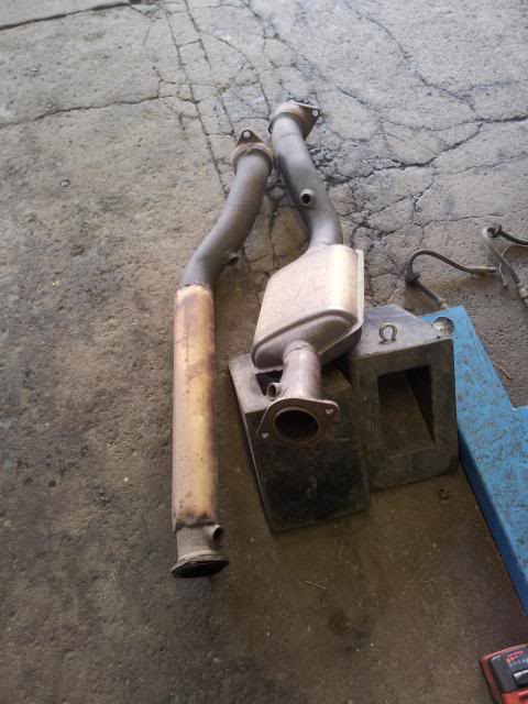

Deciding I wanted to change the exhaust, and opted for a K-Tec recessed exhaust system..

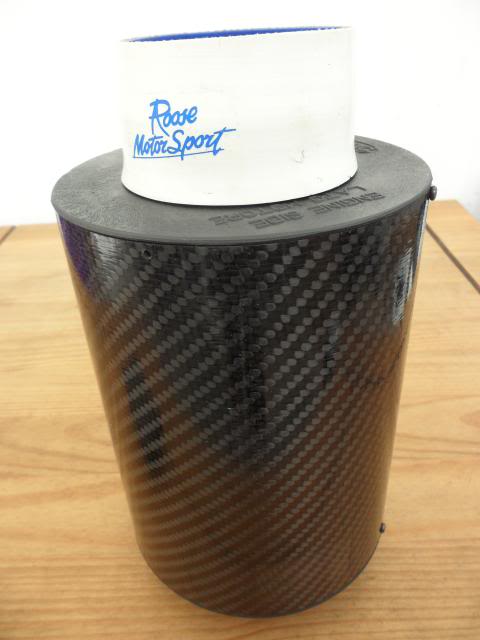

Hit pot luck when Prestigechris showed interest in my stealth system, as he wanted rid of his recessed one, so an exchange later...

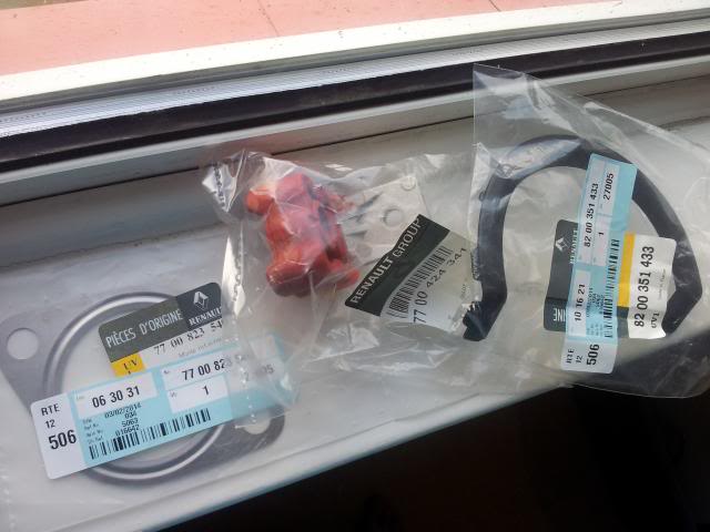

Picked up some other goodies for the job:
Renault Red Centre Mount (got through 2 non genuine ones already!)
Renault Manifold to Cat Gasket Kit
Renault Cat to Centre Gasket
Genuine 182 Surround
Mikalor clamps

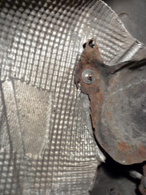

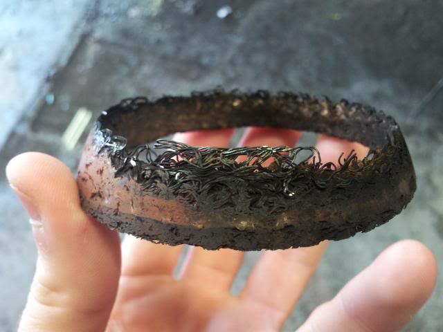

Off with the stealth.. where I found my exhaust rattle/knocking, heat shield collapsed and sat on top of the backbox / rear beam section
Washer and nut.. Sorted

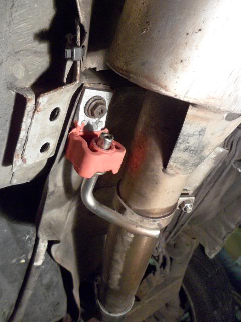

Wasn't going to do the downpipe/cat on axel stands so dropped down to a mates garage
Nasty DIY decat and cheap / bent / glued gaskets
Rain and storms ripped the last one
The car is sounding 110% better with mostly all induction noise...
No howly, raspy, tinny, loud decat..
Almost silent now, but still gives a nicer and deeper note when it's red hot after giving it some
Thanks to mattcreed for his group buy, and supplying what looks like the whole of ClioSport with Fabia splitters :D
Next, another thanks to Kelv for organising the Pure Motorsport group buy

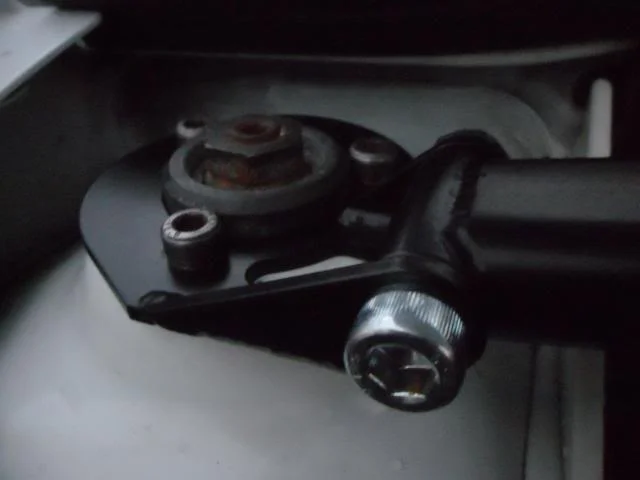

I went for the strut brace only to match the top mounts

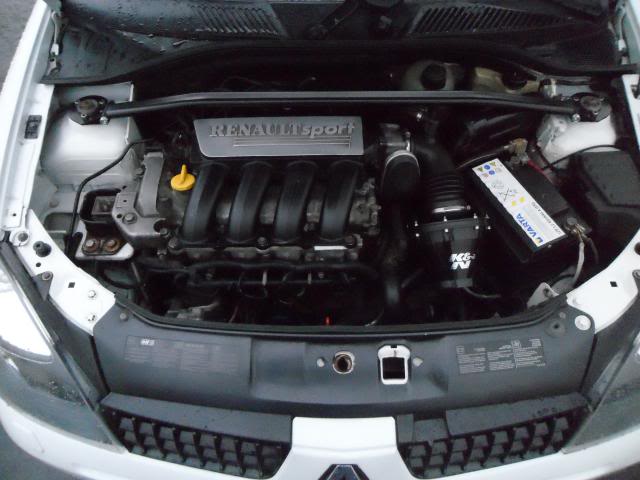

Gave the bay a wipe down, refitted the K&N Apollo plastic cover, and removed a couple of bits to tidy it up

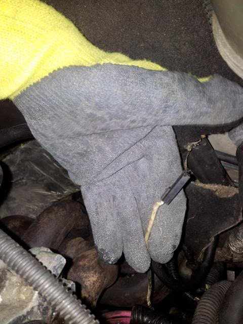

Things were going well.. until I had no starting motor one morning.. knew exactly why and found this predictably blowing in the wind..
Renewed the connection with a spare bootlid wiring loom I had (the heated rear screen connection is identical, even has the same colour wire and plastic plug), took the opportunity to extend it a little while I was there

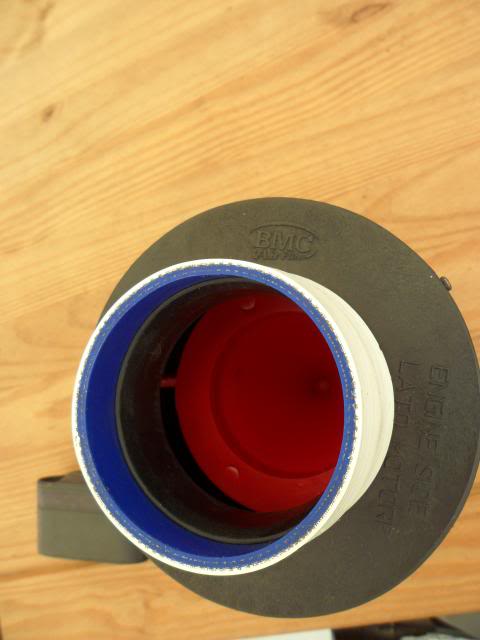

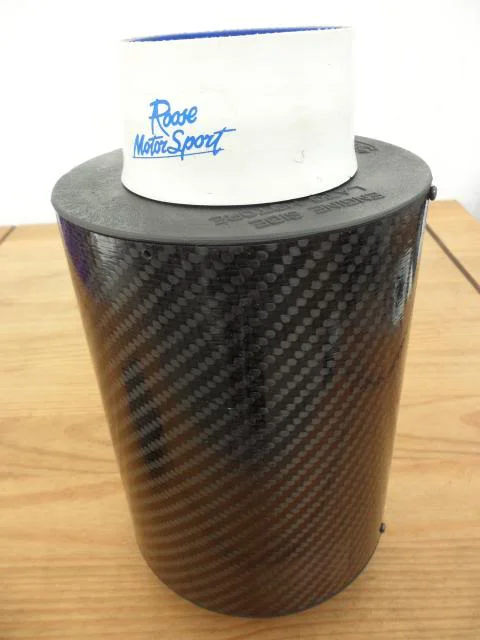

Didn't rate the K&N since the exhaust change, so going to a BMC CDA, a big one..

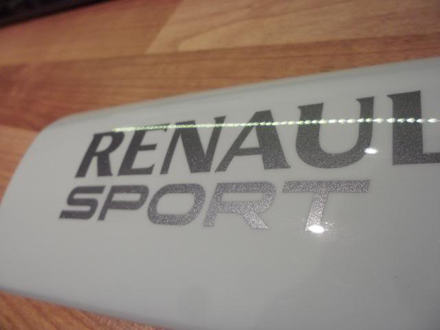

Glacier White with 205-110 RS Writing

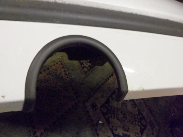

  Mondial 172Cup (A/C)
This is looking nice again!
Not generally a fan of cutouts on rear bumpers but you've done it perfectly! Nice black/white contrast too...
