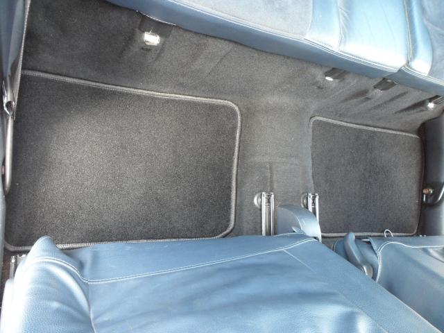

Where did you get the floor and boot mats? are they readily available anywhere?

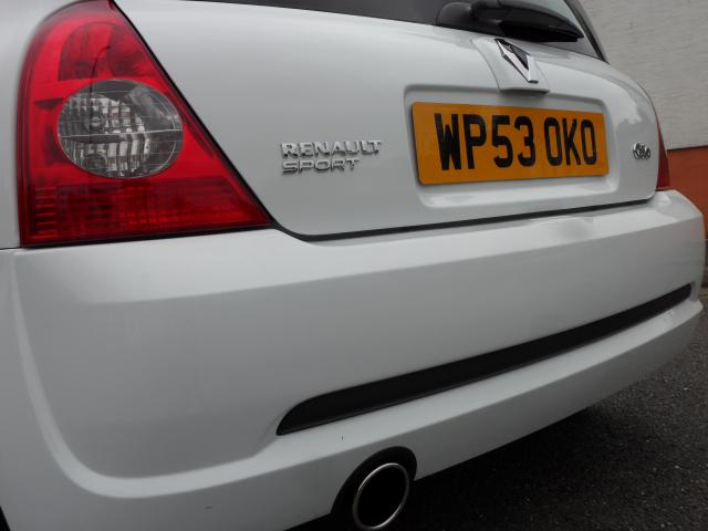

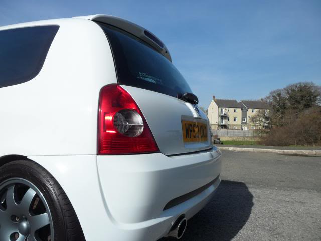

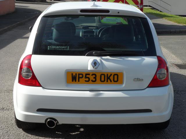

Not generally a fan of cutouts on rear bumpers but you've done it perfectly! Nice black/white contrast too...
Want to see this in the flesh soon!
Thanks dude,

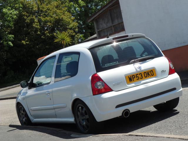

I was in two minds myself but felt the back end needed an exhaust tip on show, without the 182 surround, I wouldn't of done it though!

I think white is my favorite colour for these cars!

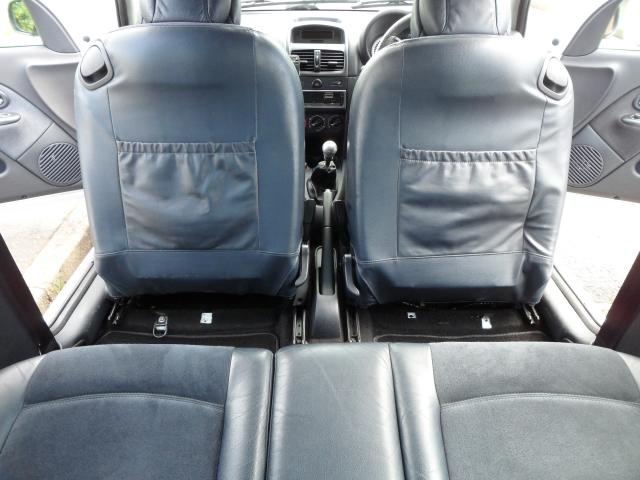

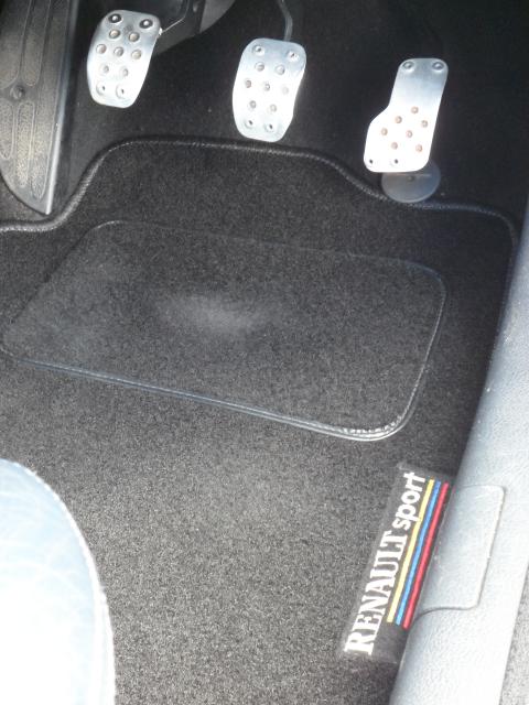

The mats I found on eBay, I got in touch with a seller who sells tailored 'Cup 172' mats and sent him this logo and how I wanted them
http://asklogo.com/images/R/renault sport logo.jpg
I was tempted to go for the new style logo, but went for these to match the seats, a bit different to the normal RS mats as well
Guess I should fit them soon ... :o

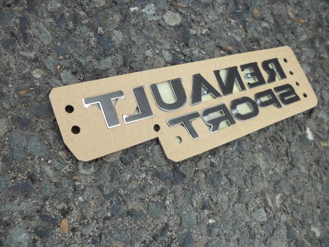

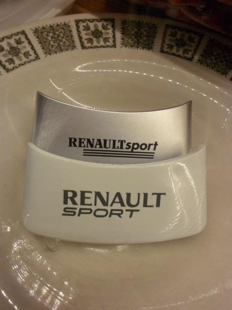

The Renault Sport bullet

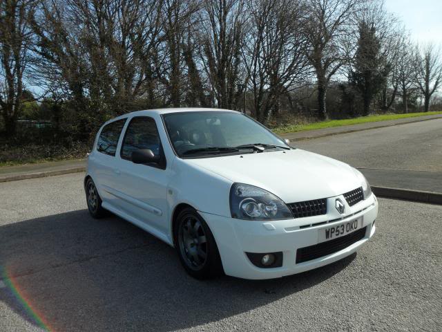

Spent the rest of my morning doing the following:

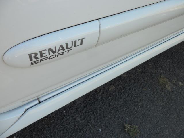

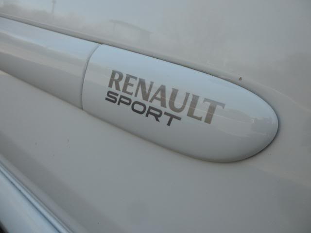

Removed side skirt decals
Checked all the levels/fluids etc
Jet Washed
Meguiars Shampooed
Rinsed
Apple Screen Wash
Water Magnet Dried
AG Tar Removed
AG Custom Wheel Cleaned
AG SRP'd
Meguiars Window Cleaned
Meguiars Metal Polished Exhaust Tip
AG Vinyl & Rubber Shined
Meguiars Hot Shine Tyre Shined

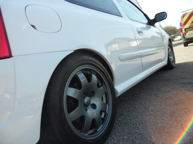

Some reflection shots
Bullets
:race:

Bullets are a nice touch mate :)
Oh and the williams wheels look quality too.

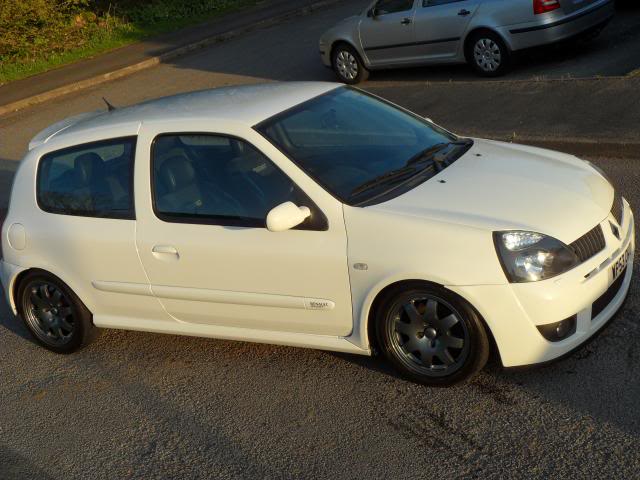

The Williams as mentioned were only mean't to be a temp measure but my Turini's all need tyres and a good load of prep and painting first.

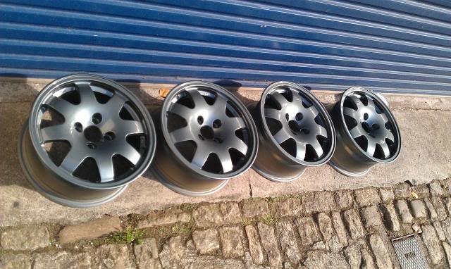

love the badges. . Sell the Williams and get tyres and refurb with proceeds. .
Wheels aren't going anywhere, need to be back on my 5... (prepainted)

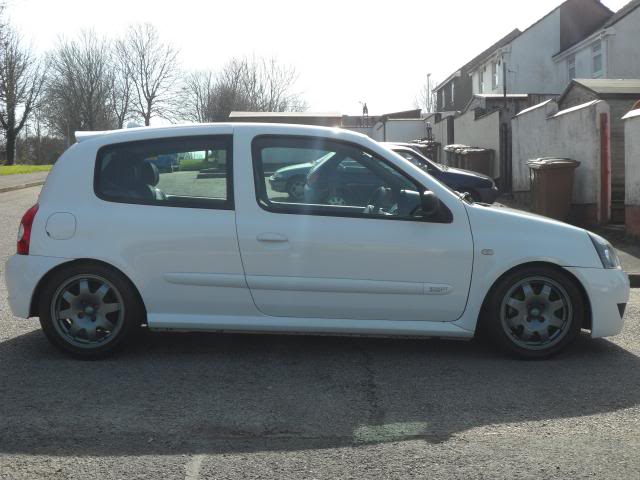

looks superb i really like it on the willy wheels.
:cheers:

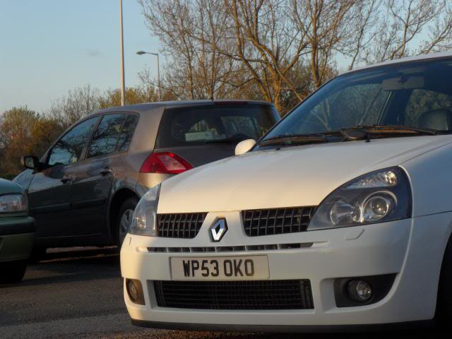

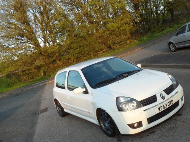

Actually very surprised at how nice it looks, seen a few look so tacky but this is a peach!
Keep the willy wheels on it. looks perfect.
:D Ha, I know what you mean, usually I see white ones with black painted trims/wheels/roofs etc and stickers, I like to keep things OE+

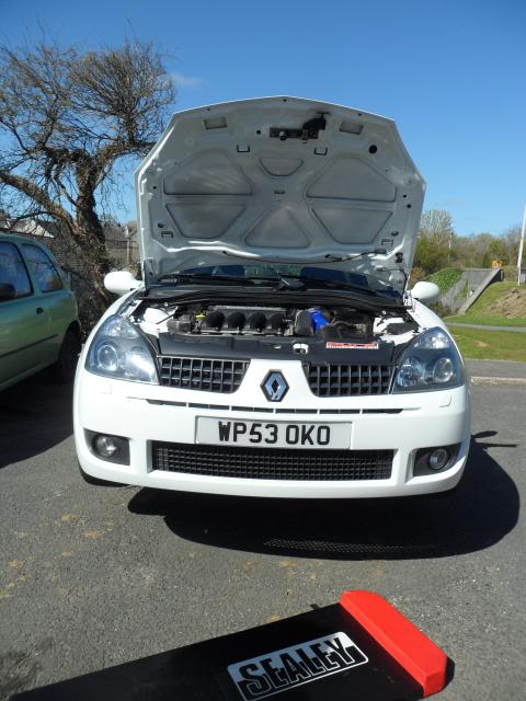

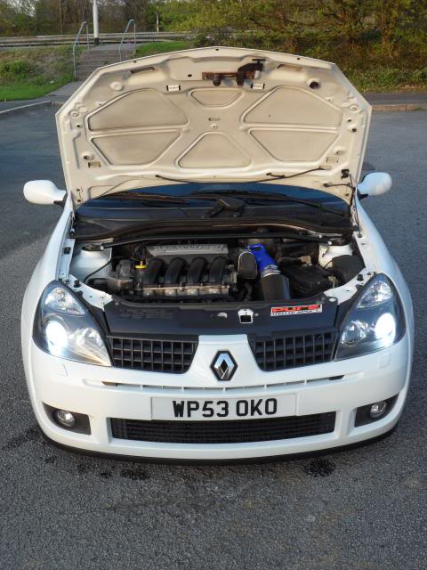

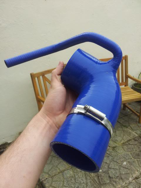

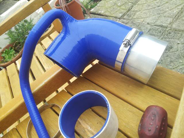

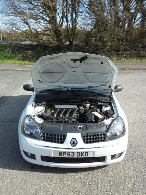

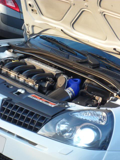

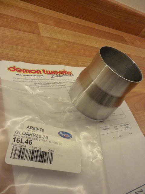

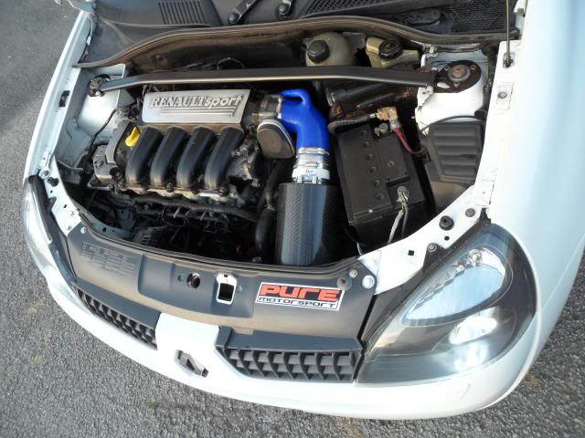

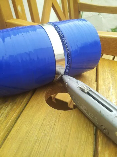

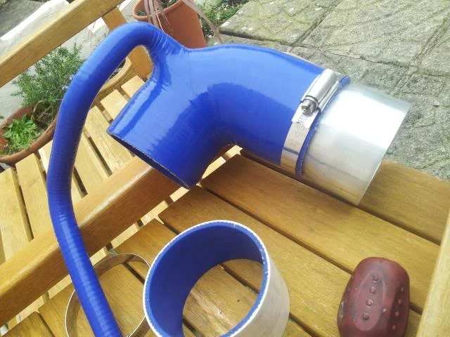

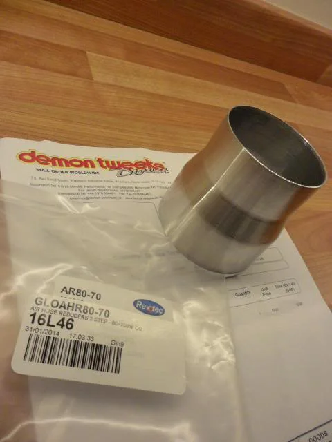

Joiner for the larger BMC CDA

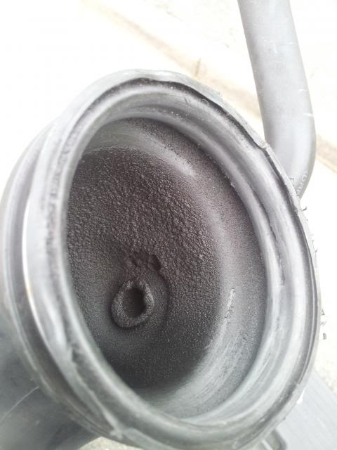

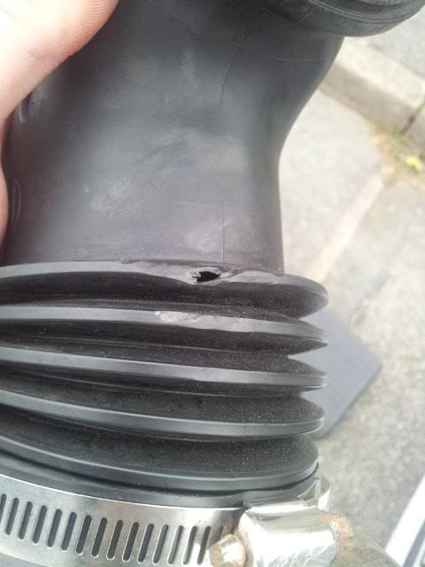

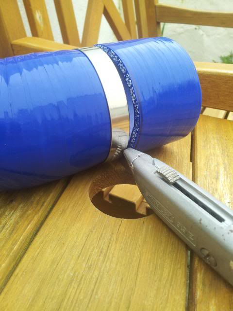

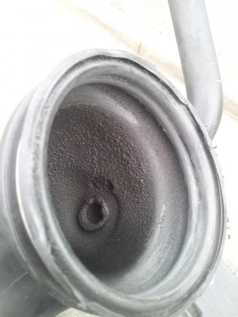

Silicone hose and oil feed. Cut to suit, not my choice of colour but meh
Old hose was horrendous..

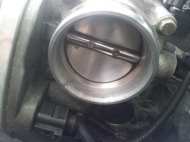

TB cleaned up with carb cleaner, behind the butterfly also

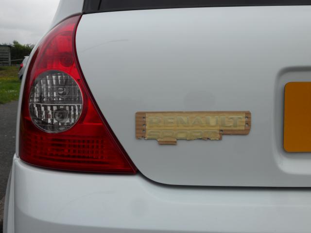

Nasty peely sticker binned off (replacement further down the page)

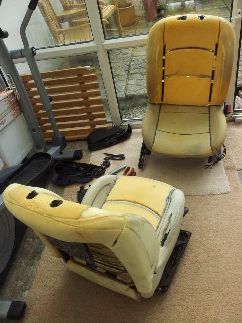

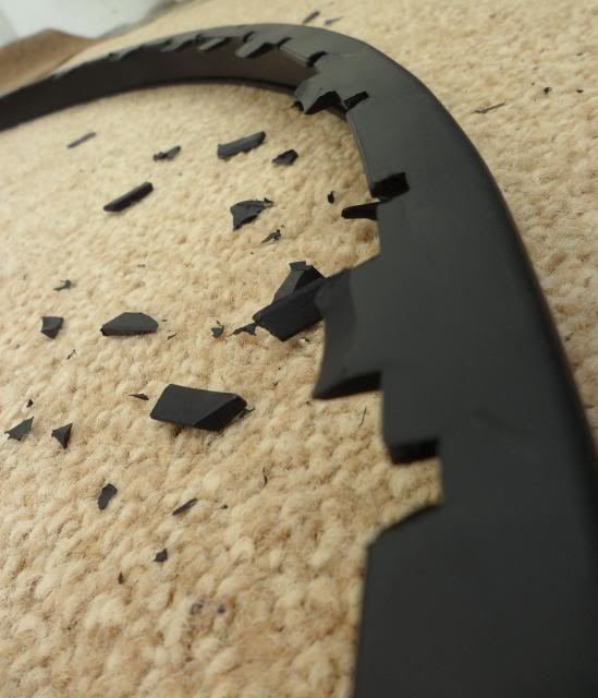

Converted the drivers seat to phase two spec
Phase one seat sliding handles were always popping off
Note the old seat bolster

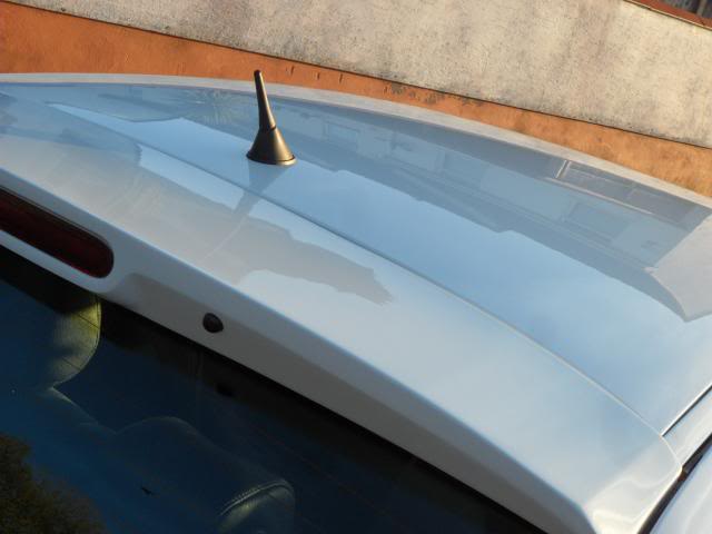

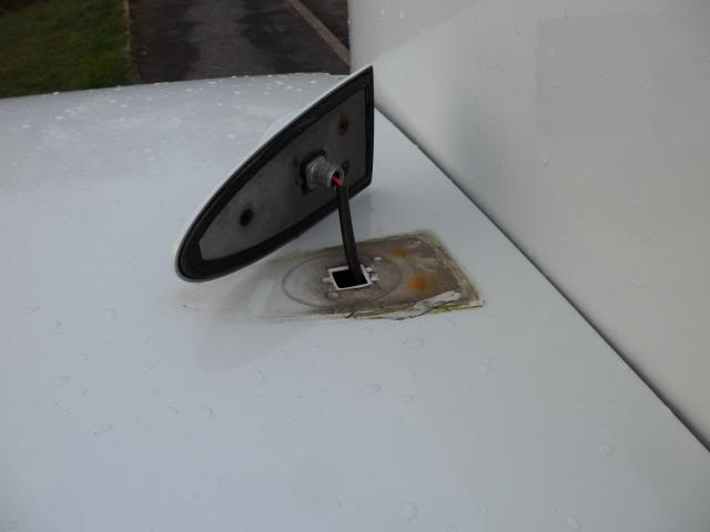

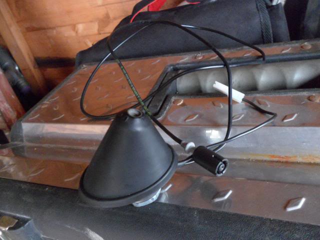

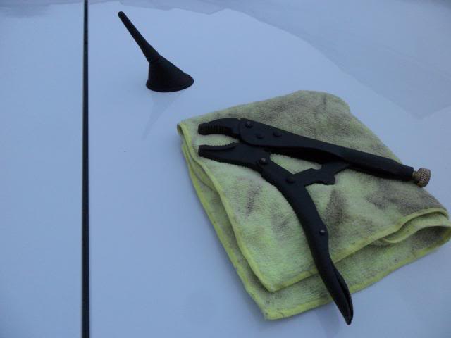

Mint aerial base
Thought I'd have an issue when removing 'The Fin' ..
Nice and tight

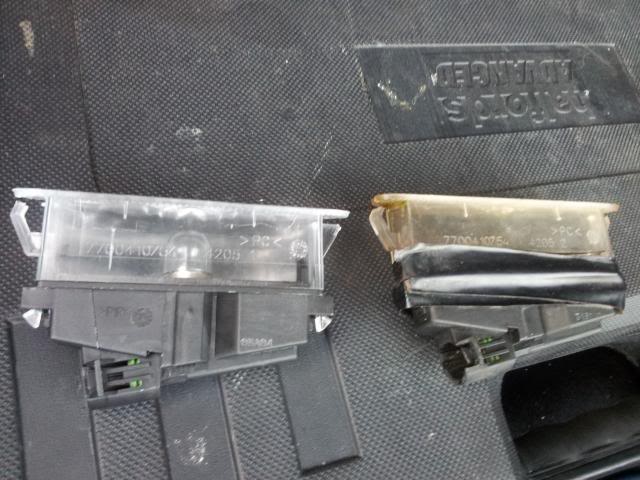

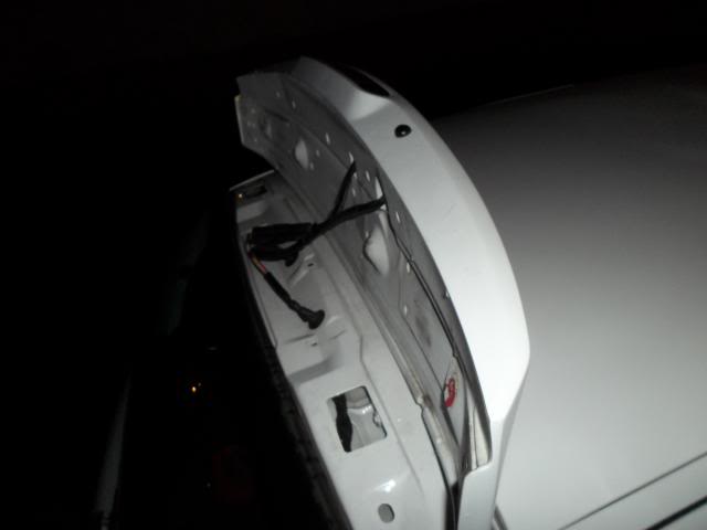

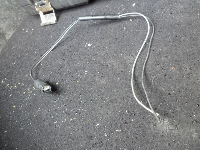

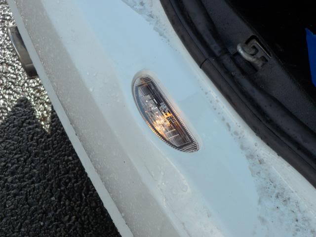

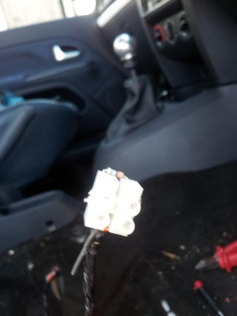

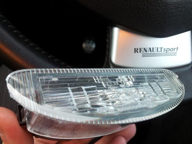

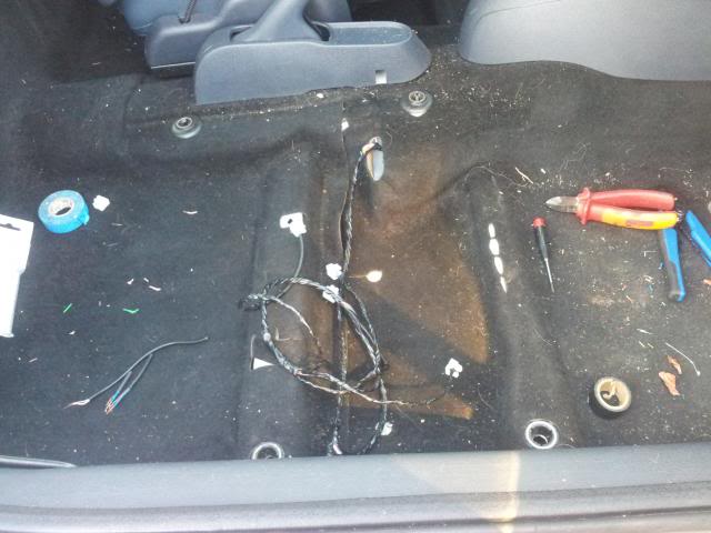

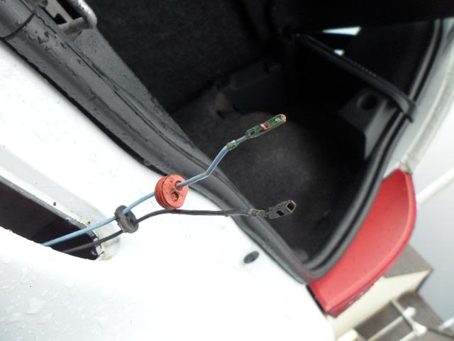

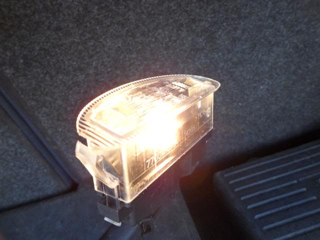

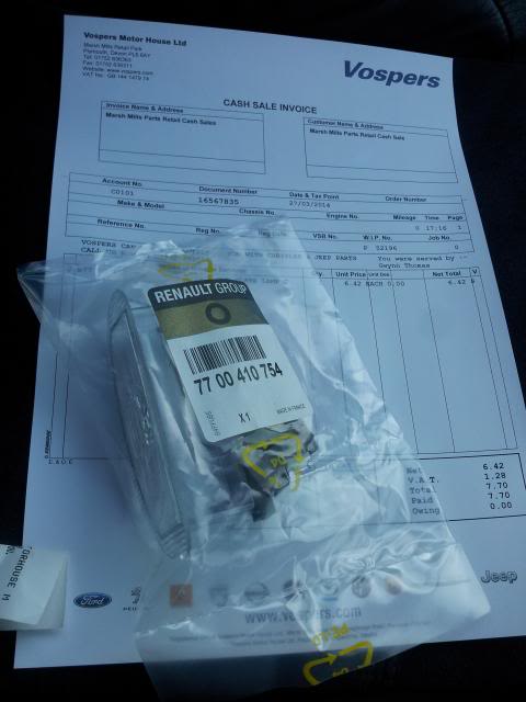

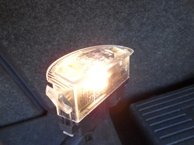

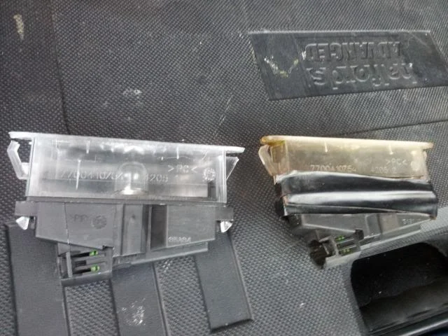

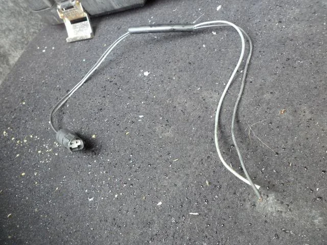

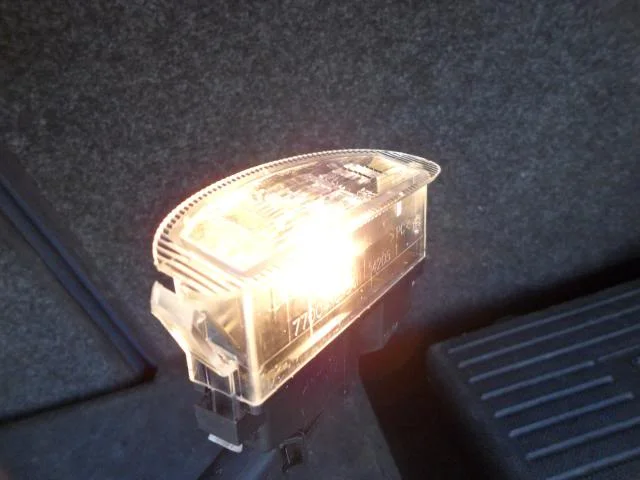

Noticed my plate light becoming intermittent, stripped the plug down and found this..
Renewed the plug with the spare boot lid loom and got myself down to Renault to replace the unit

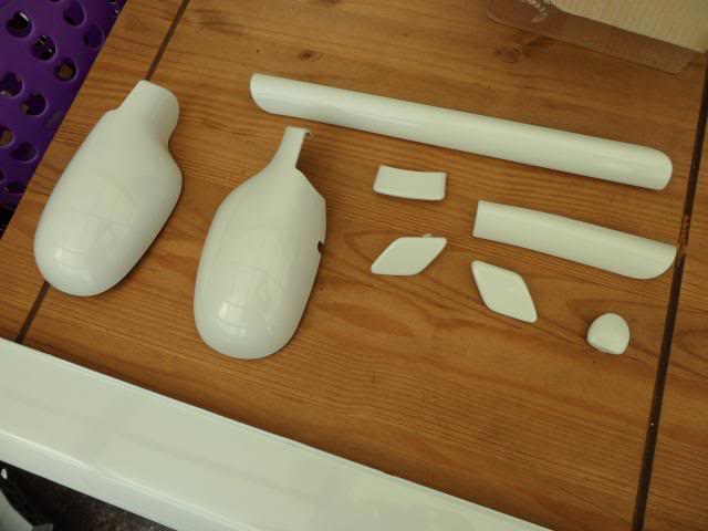

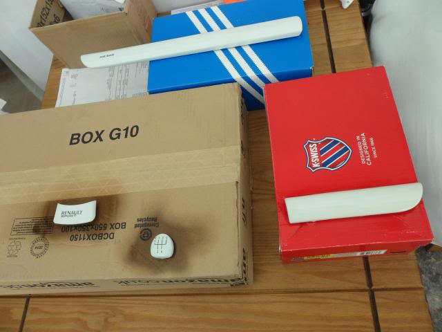

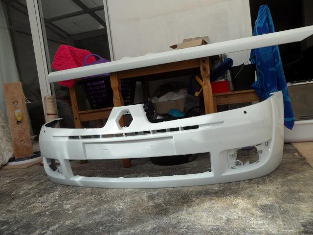

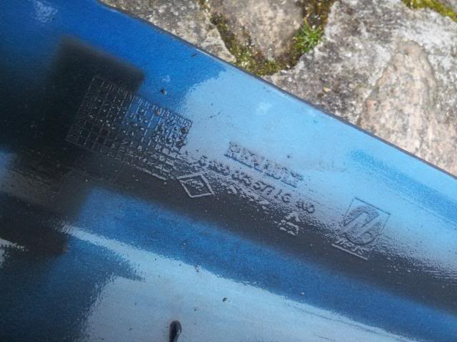

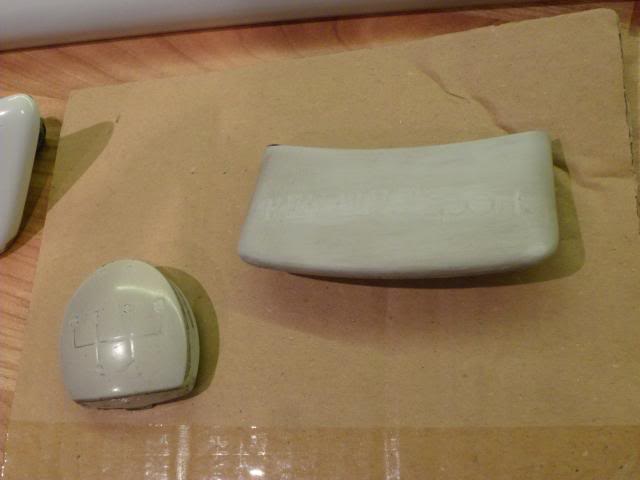

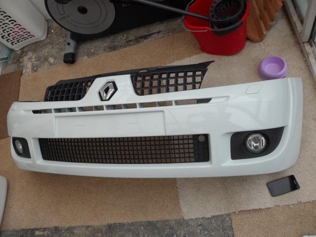

Some fresh Glacier White 369 from my local paint shop to have to following sorted:
Front Bumper

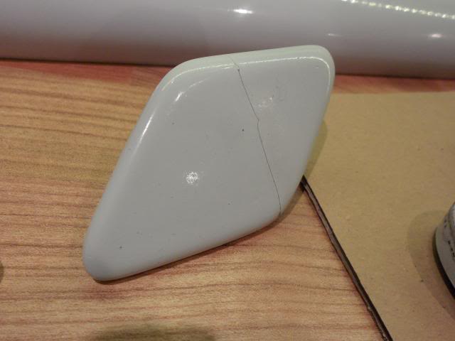

Washer Caps
N/S Side Skirt

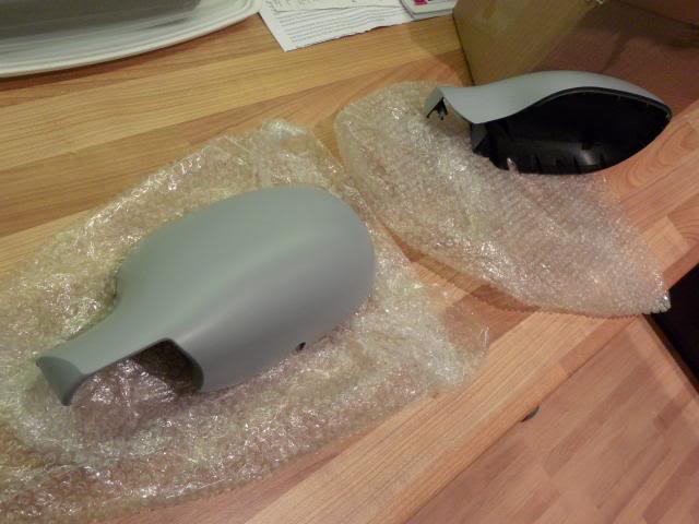

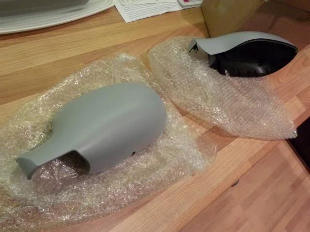

Mirror Caps
Dash Strips
Gear Knob Insert
Steering Wheel Insert
Dials/Clocks Surround
Before photos:

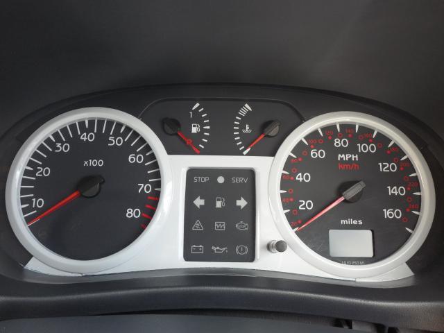

Back from the painters, dial surround still not back the mo:
Thanks to N2Grafix for the bumper decals

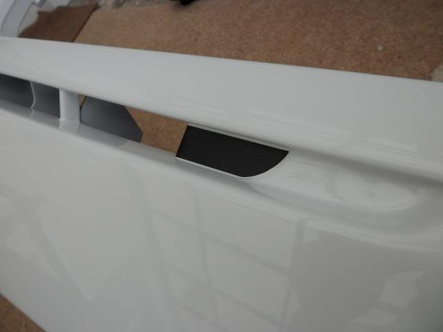

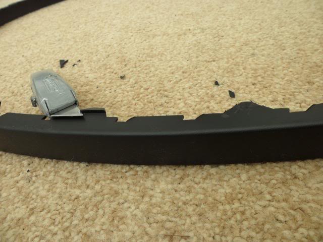

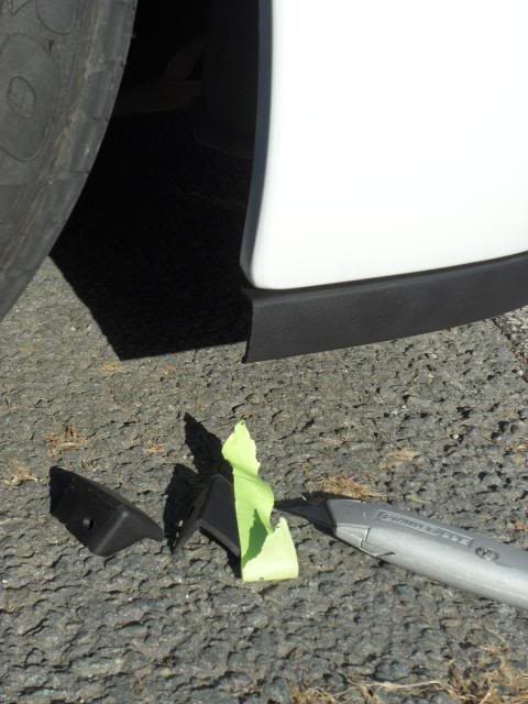

Fabia Splitter tabs flat levelled

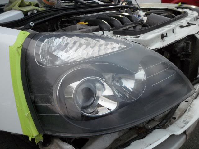

Went over the xenons with the 3M kit as I did them off the car last time around
Was able to give them some good pressure this time (left first stage, right finished)
Done

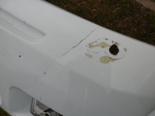

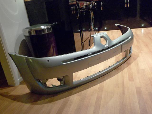

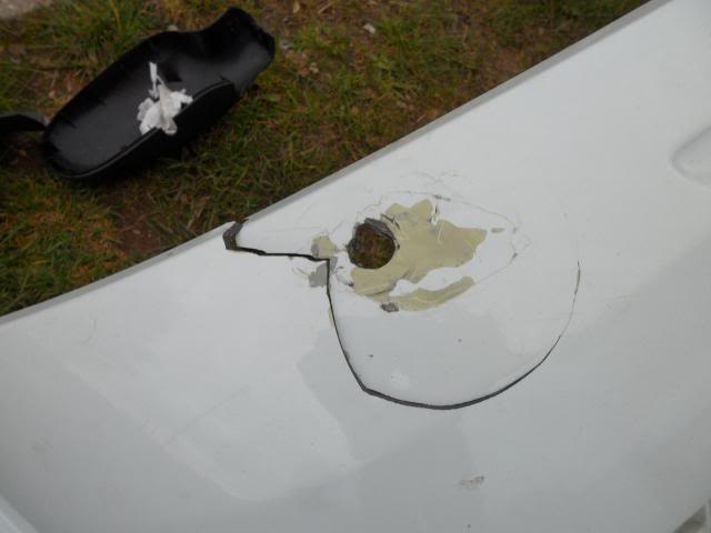

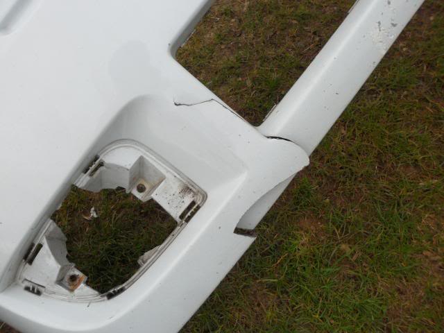

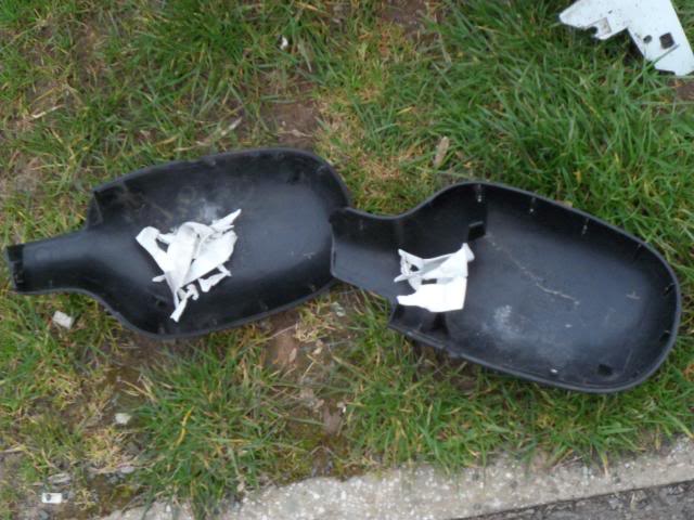

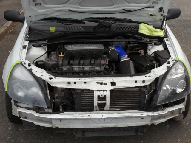

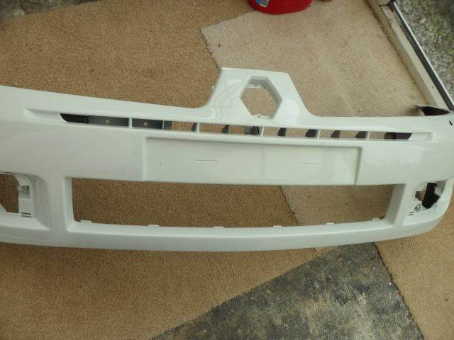

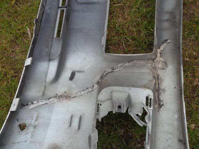

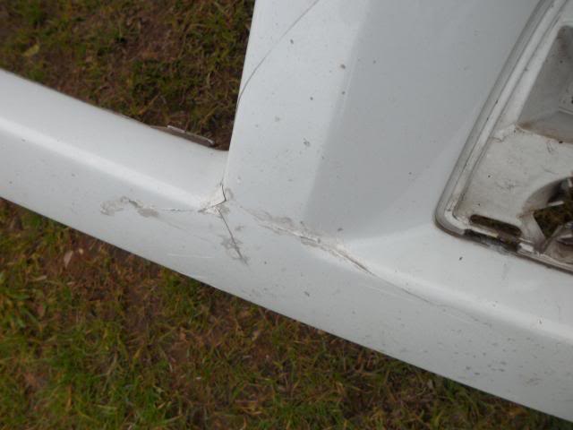

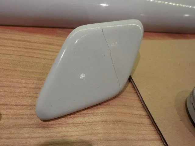

Old mirror caps (foam tapped on..) and some honest photos of what I was hiding regards the front bumper !!
Fell to pieces from poor repair work

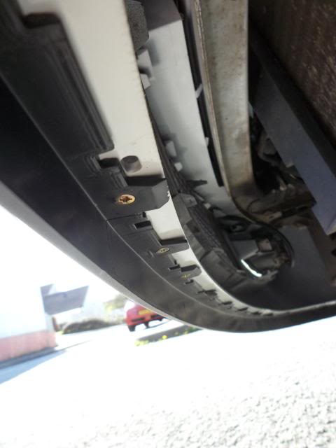

Spent the rest of the evening removing the old bumper speed clips and bolts, the bumper was obviously pulled off without undoing the bolts at some point.. nightmare..
New bumper (now actually bolted on to the car :D)
Splitter perfectly straight, short short screws and clean cut ends

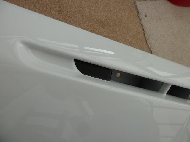

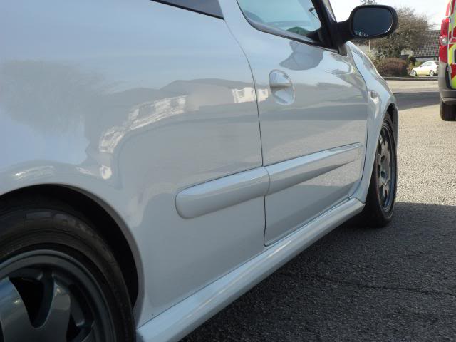

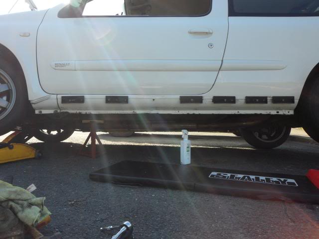

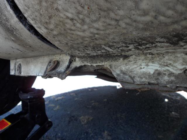

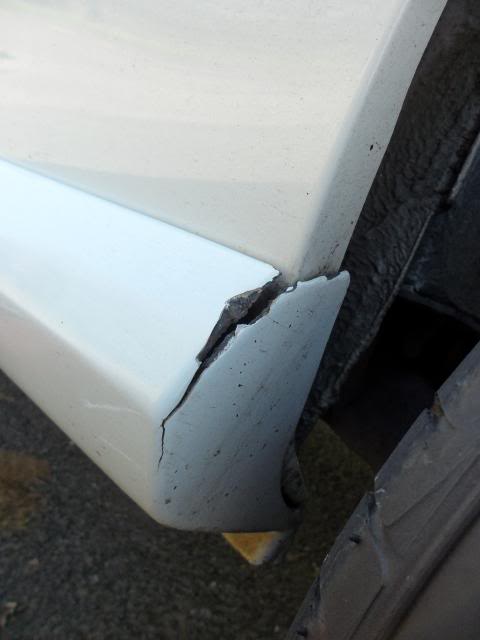

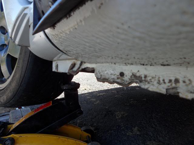

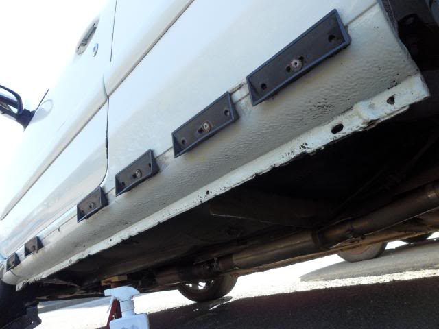

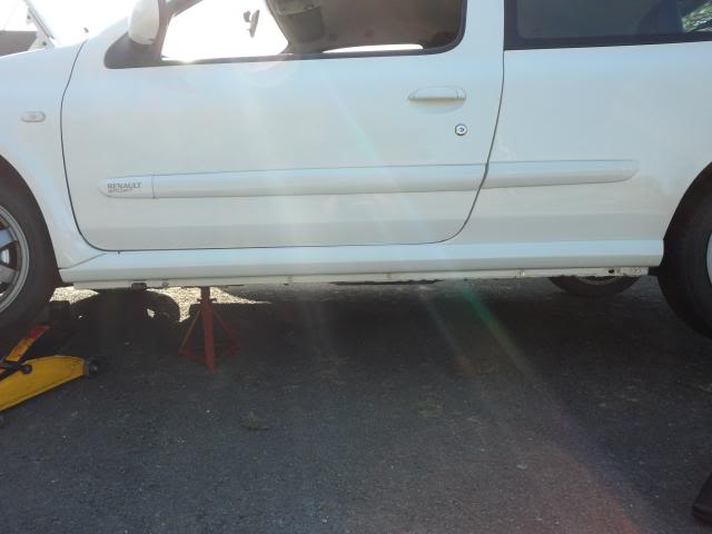

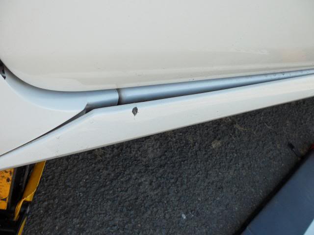

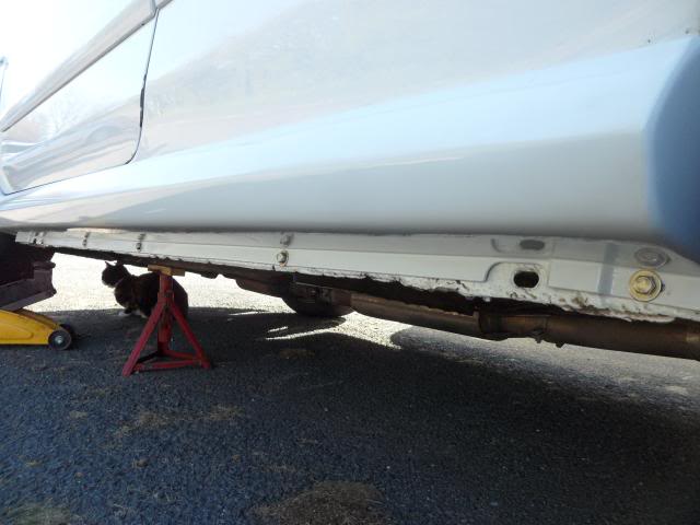

The sideskirt had been forced off/on at some point, used to annoy me seeing this every day..

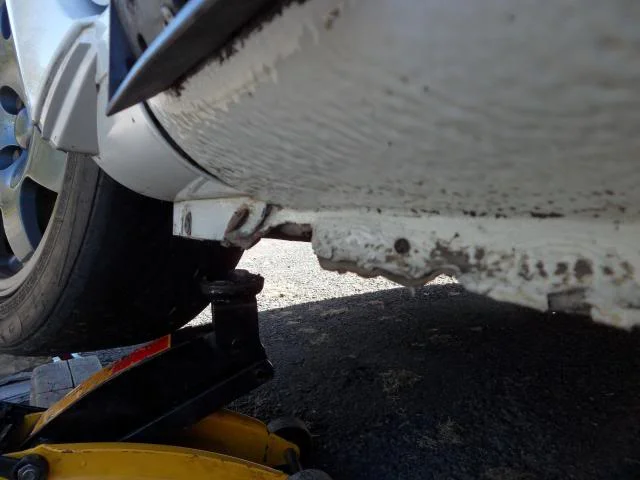

Here's why... typical Clio jacking point error... probably the same time the wheels where taken off to be painted orange .. !
Got cleaning, mole grips, long nose pillars, hammers etc
New bolts, lock nuts and washers, fresh!

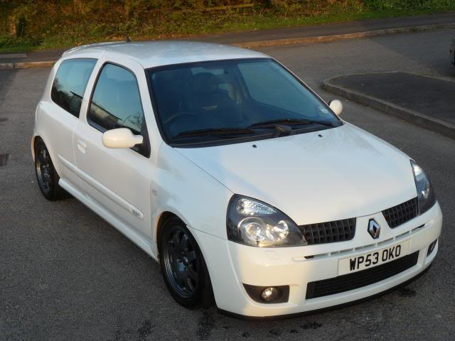

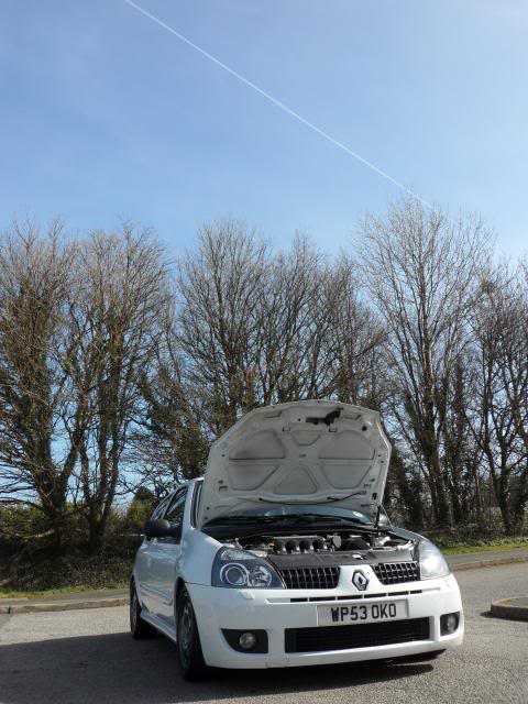

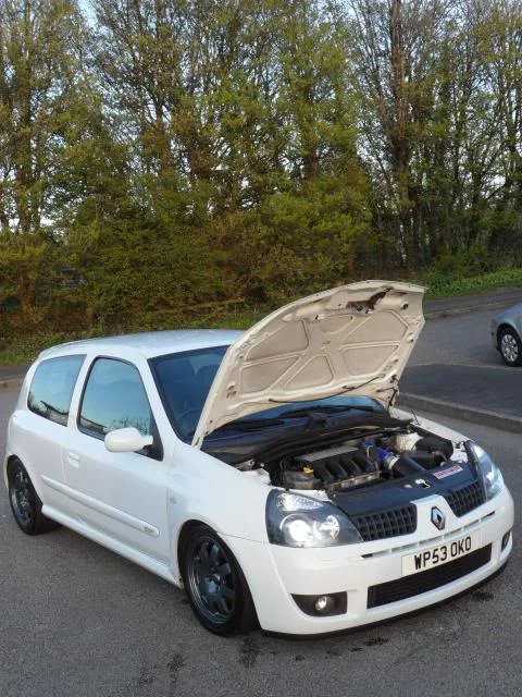

Overview of changes..
(Induction, Aerial, Grill Replacement Decal, Painted Bits, Splitter, Drivers Seat etc)
Oh and a wash, standard !

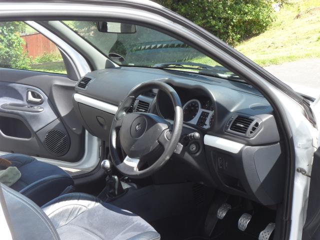

Interior plastics stickered up and four coats of lacquer..
Interior cleaned up and mats in

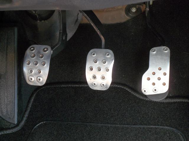

Pedals metal polished

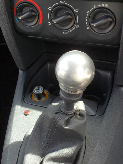

PH1 style spare gear knob (Need to get the heatsheilds and exhaust off to fit my mint 182 one) .. Also a cig lighter torch

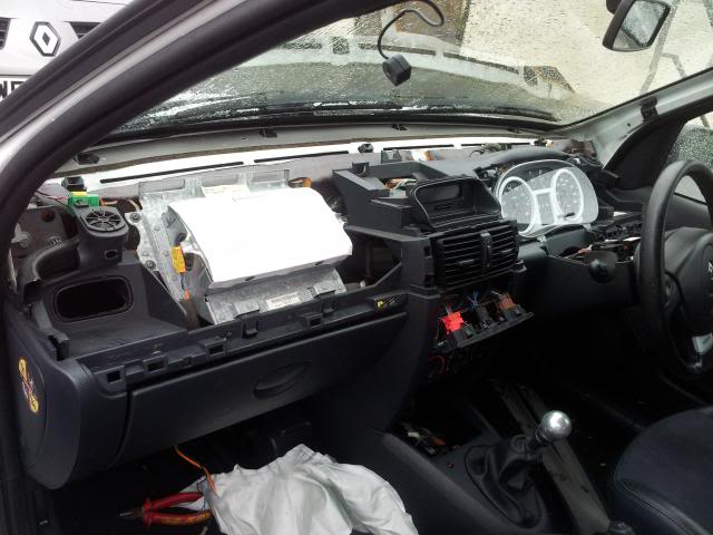

Dash top off for assembling the clocks

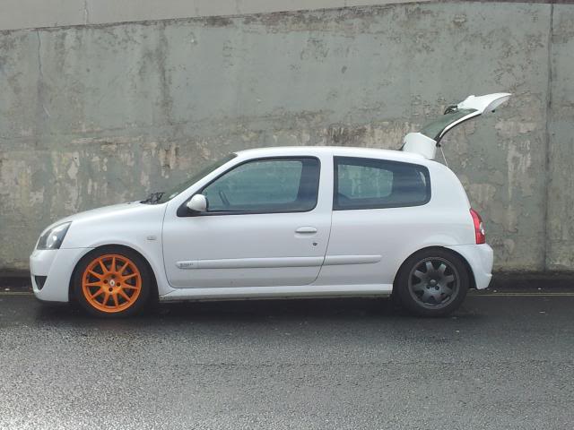

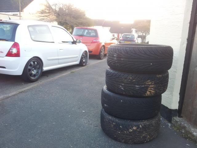

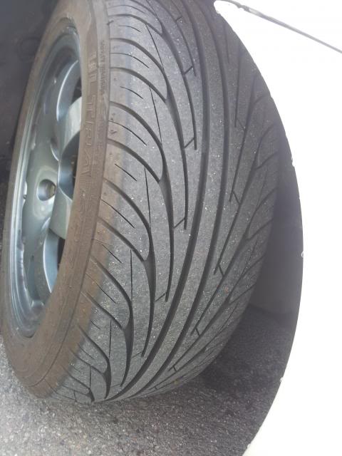

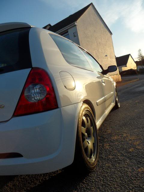

Front tyres were getting low so picked up a good second hand set.. Nankang beasts! :quiet:

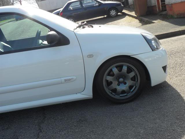

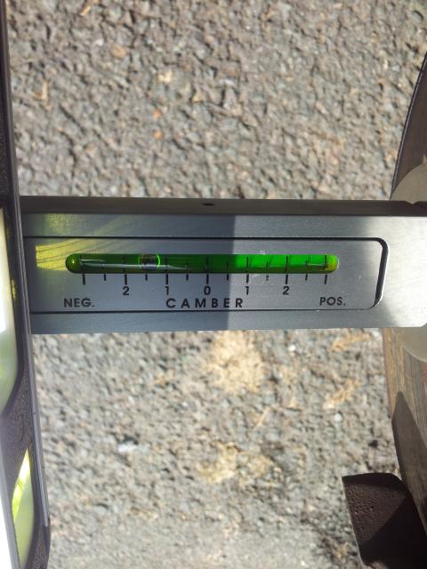

Here's why the Toyos scrubbed out

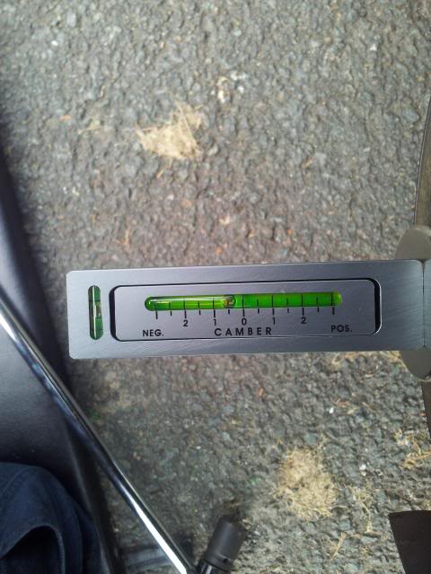

Corrected to 0.5 degrees, also matches the look of the back
Trip to the tyre shop again (Don't like other people jacking the car up, look what happened to the sideskirt previously!)..
Remember these wheels? :eek:

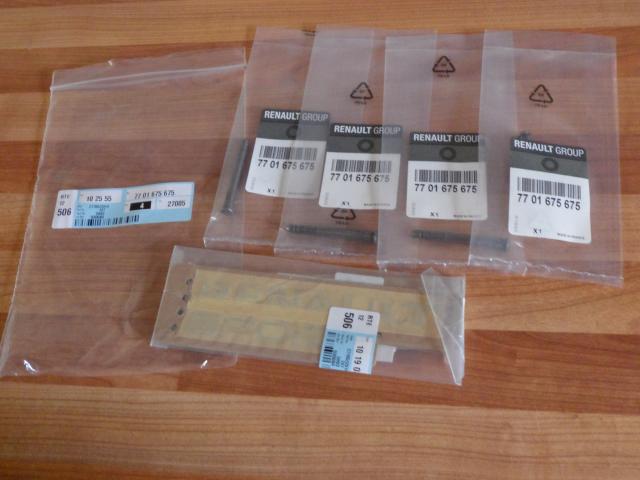

Few Renault bits (more on this later)

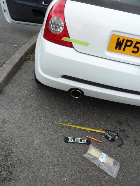

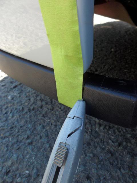

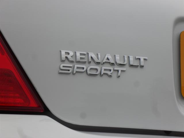

Measured up, levelled, and mirrored the position of the Clio badge

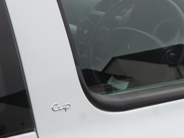

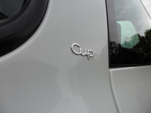

Opted for some 182 Cup one piece door pillar badges
The original ones with the yellow 172 never looked right on the white paint, plus they always tend to be wonky
Again, measured and levelled etc

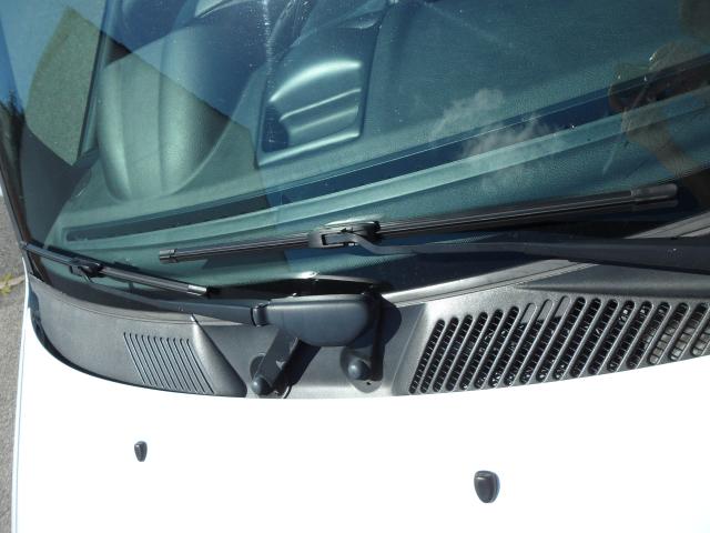

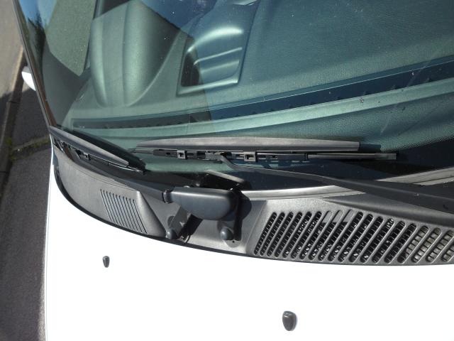

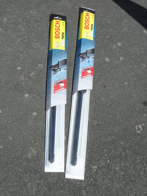

Spoilered streaky wipers binned
Looking miles better and these perform a treat!
