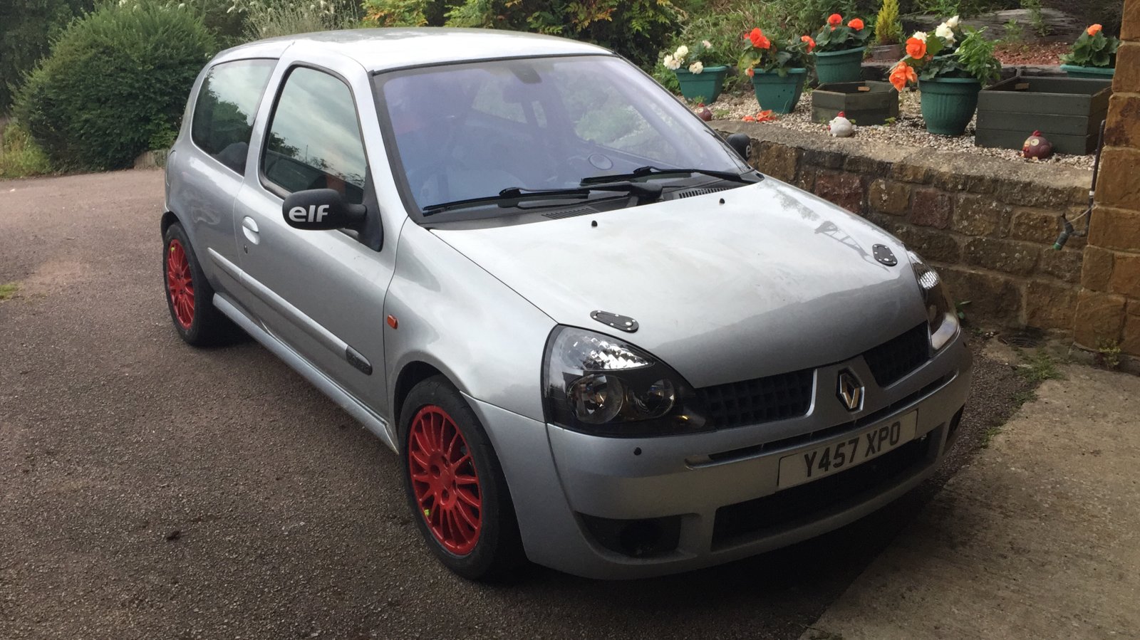

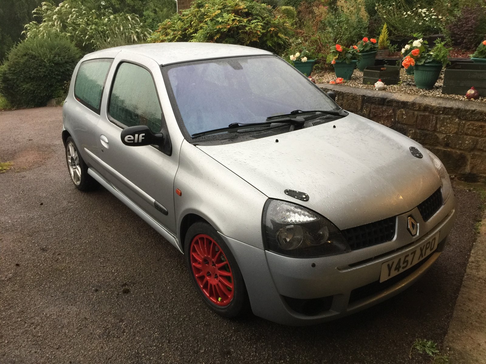

So time for another quick update on the car...
@Daz... came by Wednesday so I could check out his steering wheel, and put a face to a name. Was nice to meet you buddy!

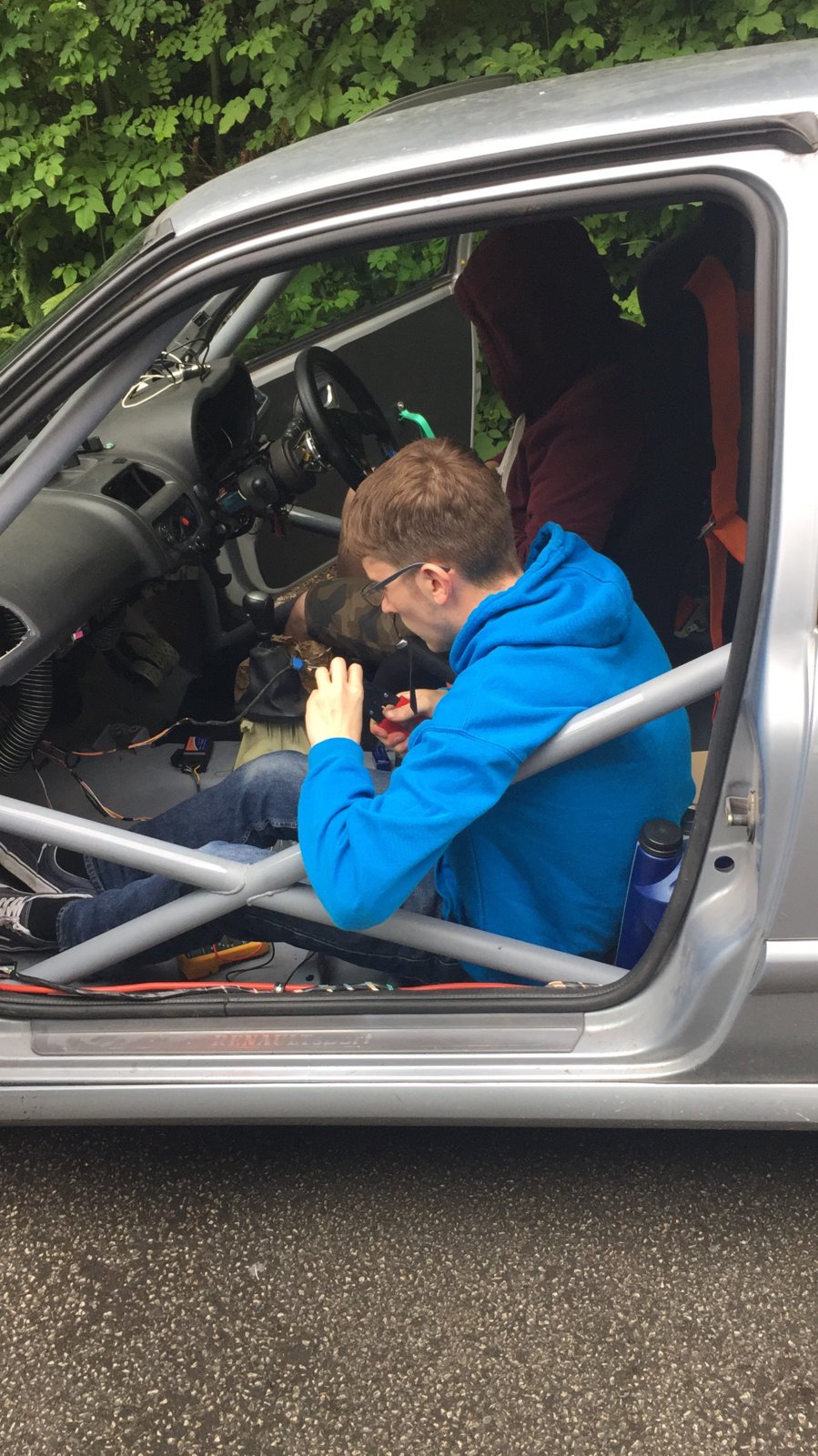

Shortly after, @Steven103 came over to relinquish his boredom and continue to try and figure out my electrical issues.
He set to work on the car, and whilst he was playing, I was talking to daz about his ph1 stalk and the horn.
Daz pointed out about the stalk being plug and play, and you just needed to connect 2 wires. Oh, like those ones there......
MASSIVE f**king D'OH
It only turned out to be the horn wires dangling loose. Sometimes it's good to have another pair of eyes (and a brain) looking at things! So yeah, the horn now works!
A bit more testing on the high beam situation (as they weren't working either - don't worry, no loose wires for those), and it was found that they worked when the spare UCH was used.

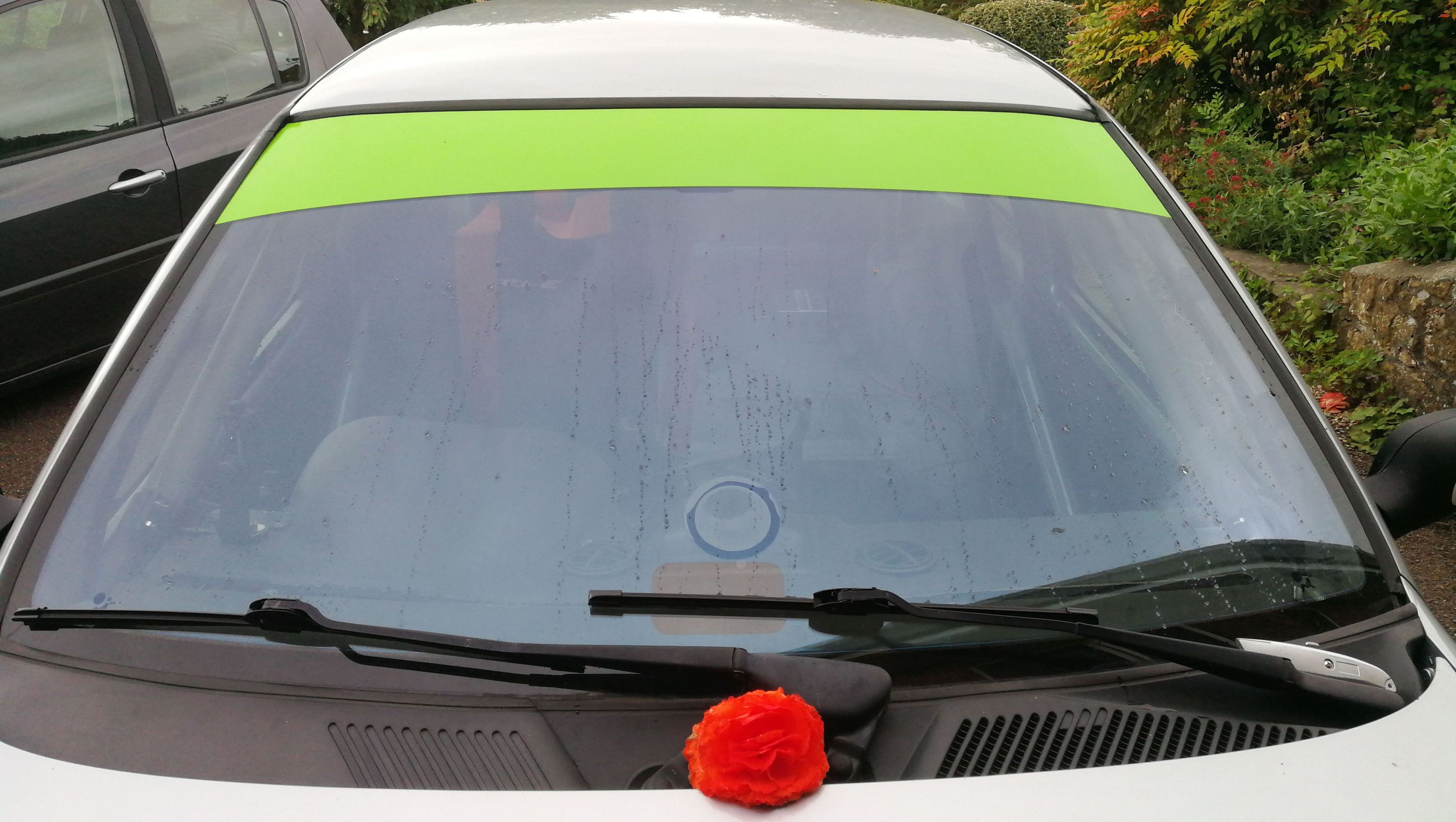

I also set about a few other jobs.

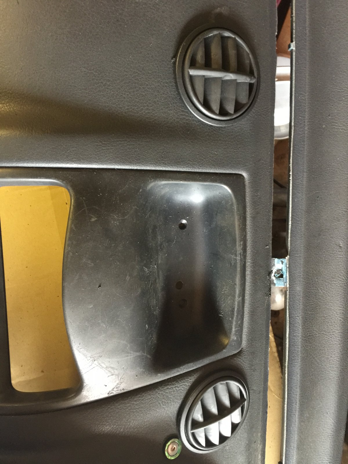

New vents installed. The demister T7 unit pipes will run to these, and should do a good job of clearing the screen.

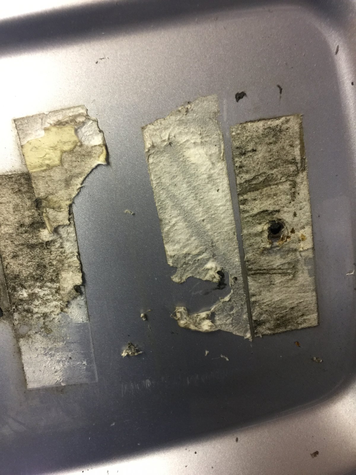

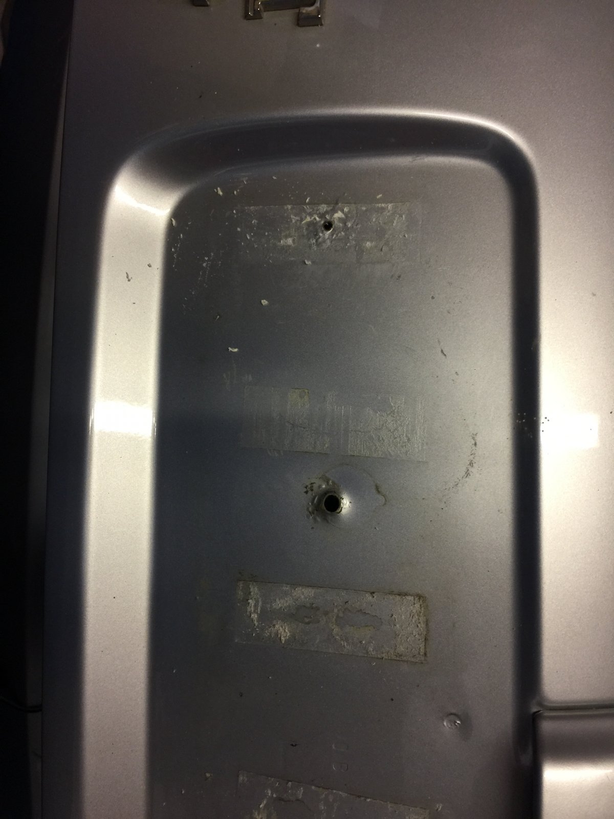

Also got some HG Sticker Remover. Awesome stuff, and smells lovely! Definitely use in a well ventilated area though...
Quick cut out for the front tow strap...

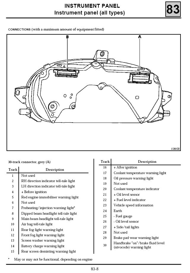

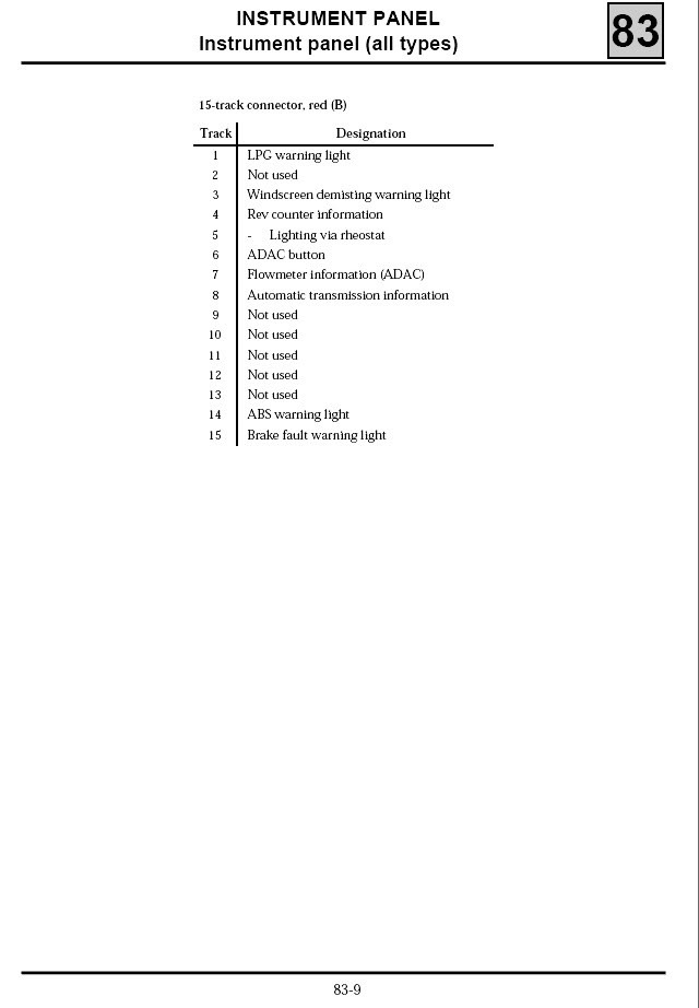

@fairm010 also found a wiring diagram for the clocks. Tomorrow's plan will be test to the voltage to pins 4 and 16 and see what it's getting at the plug. See if we can track down this ridiculous issue with the instrument cluster!!

After more electrical testing today, I'm still no wiser as to the clock issue.
However, all the warning lamps work. So the plan now is to use a gps speedo (as a working speedo is not actually needed for the MOT), and get the car thru and passed - I hope!
Steering whee is being changed for a flat OMP wheel when it arrives, and a ph1 stalk with horn button is also on order (now we've got the horn working).
This means at least the car is on the road and useable, and along with an OBD reader I can run an app to show revs, fuel level, temperature, and speed.
Then an auto sparky can take a look at the electrics and try and figure out my non moving needles.

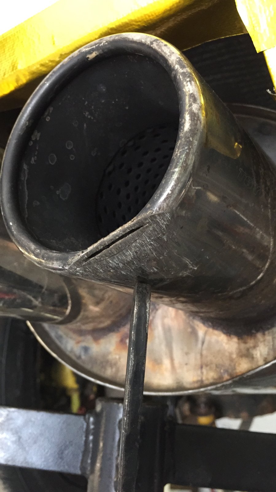

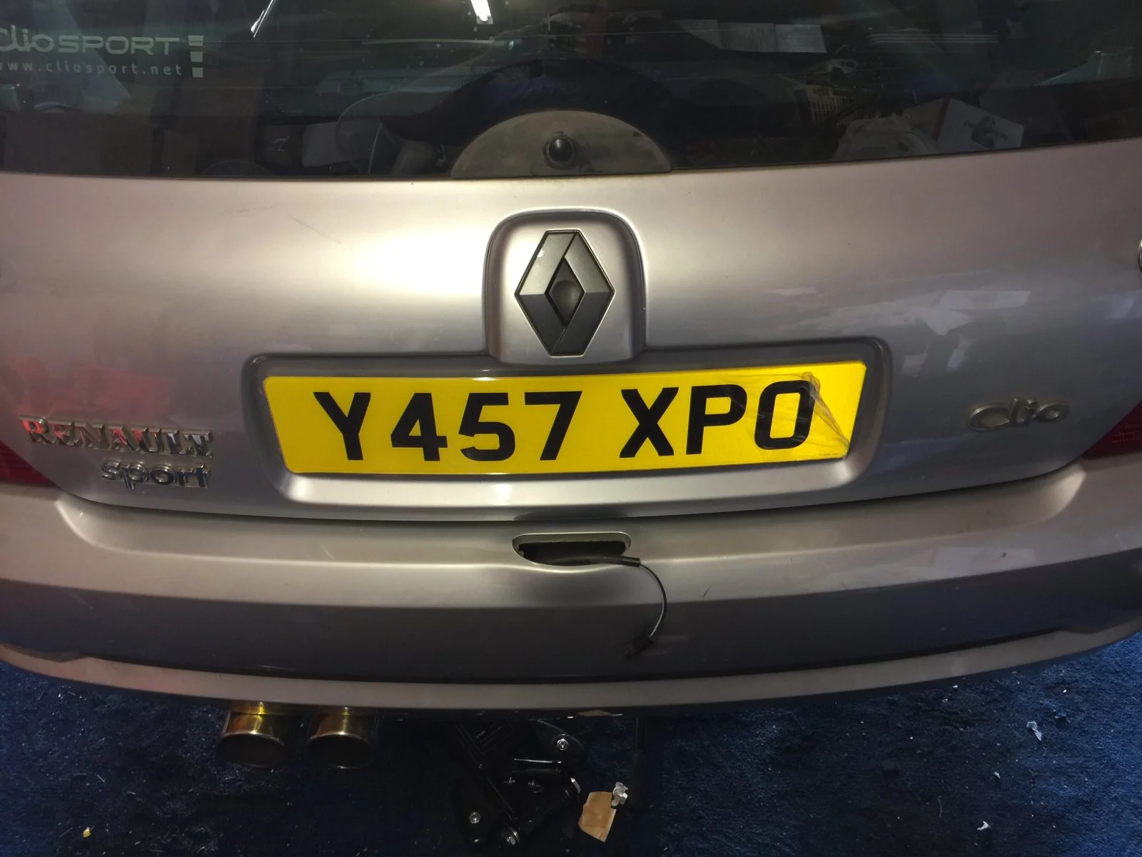

It also appears that the backbox is far too heavy. We noticed that there appears to be a snapped hanger on the other side of the exhaust too. So maybe it's no for a 172?
Might have to purchase a new backbox!

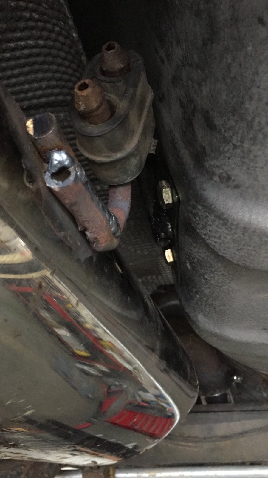

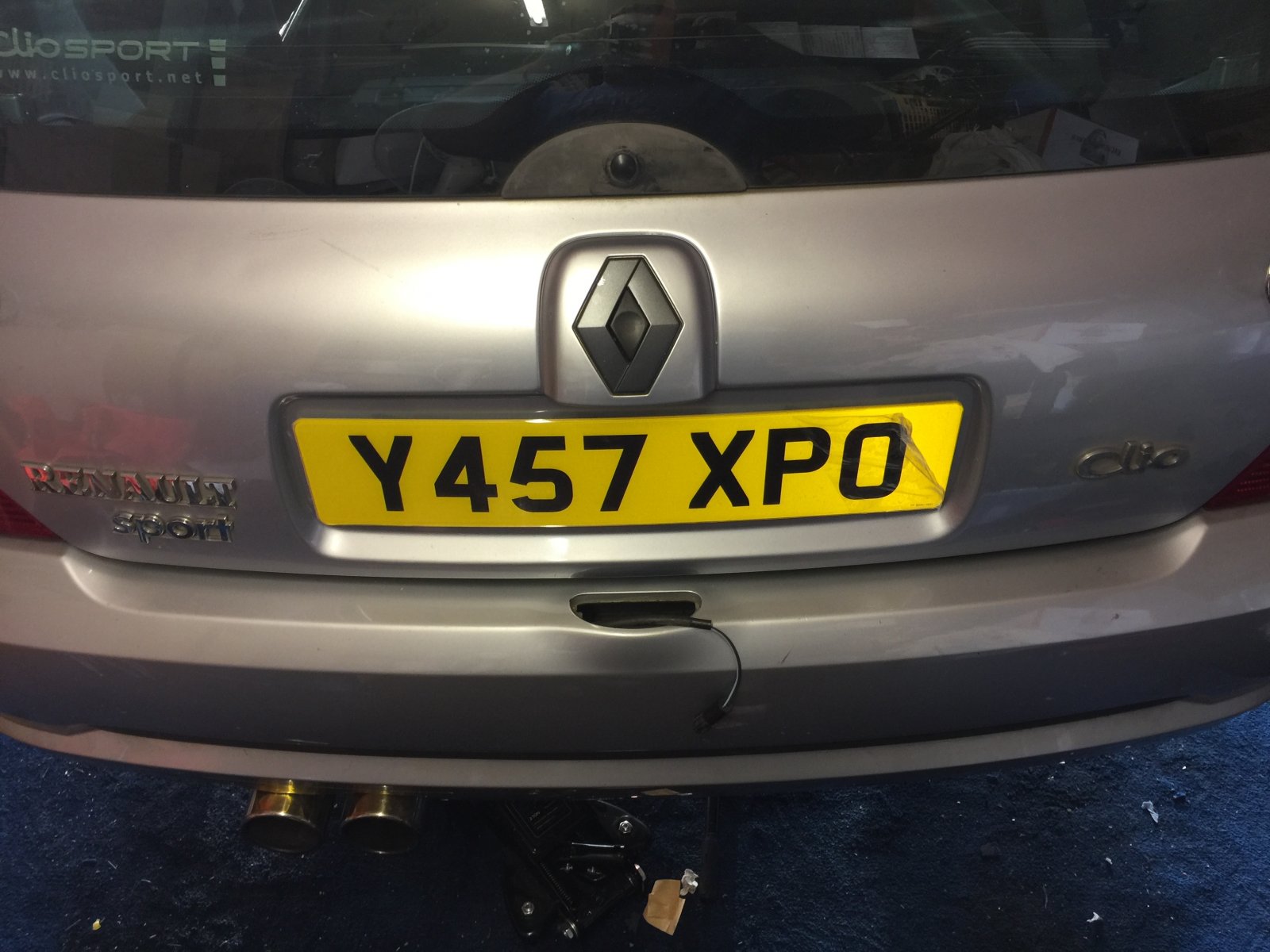

Took Friday off work to get the exhaust sorted on the car, and to head up to @dann2707's for the weekend for a hoon around the peaks.

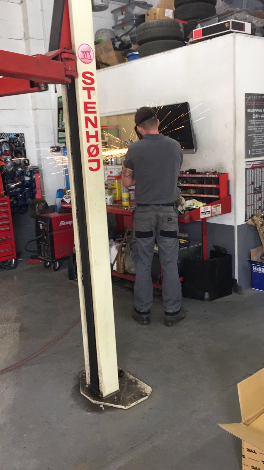

Took the car down to Automax, and Max set about working on a secondary mount for the exhaust.
It was clear that the backbox wasn't made for a Clio, but with time and money of the essence, we decided to make it fit.
The damage done from the backbox falling off it's mount on the way to the MOT. Slashcut tips anyone?
It was tided up a bit after this, but this gives you an idea of what we went for. It's not pretty, but it works. So that is more than good enough for me.

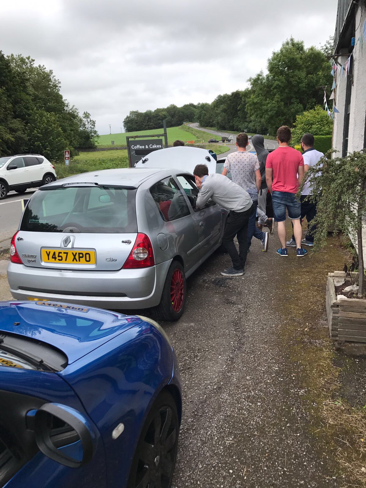

The car performed well, right up until a point that required some braking for a junction.
As we came down the hill, I braked, only to find my foot go all the way to the floor!?!
Some quick thinking meant using the handbrake to help bring me to a halt, whilst thankfully some braking did remain from the calipers.
We got out to check what it was, but couldn't see anything. We decided to head on back to Dan's place, as he was suffering from a knocking noise. 100 miles all in and we made it back in 1 piece.
After returning to Dan's, we had a quick check over of the car.
Turns out, a rear pad had made it's escape!
Thinking back, I'm sure a fitting kit was put on, but I'm starting to doubt it now.
New fitting kit and disc and pads are needed to make a full set back up, and a lesson learnt.

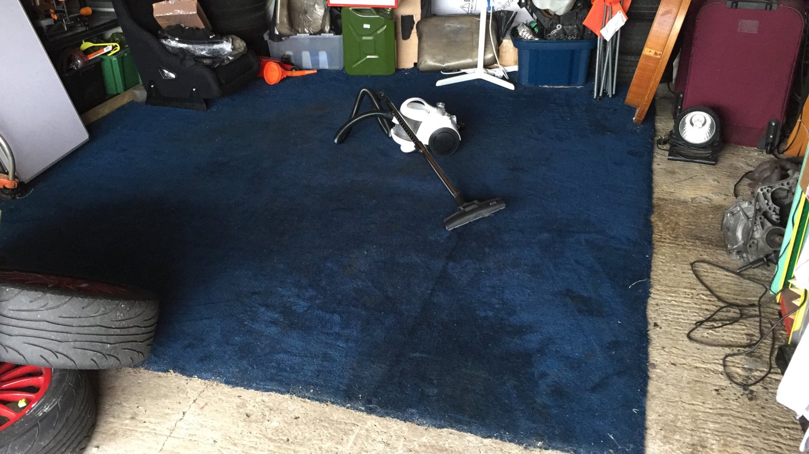

Jesus what is wrong with me. I even gave it a wash and hoovered the garage!?!

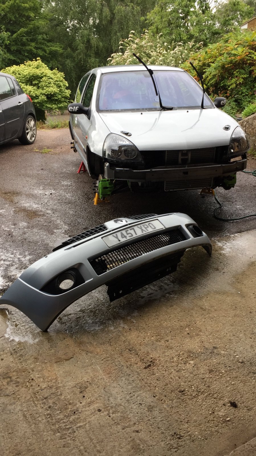

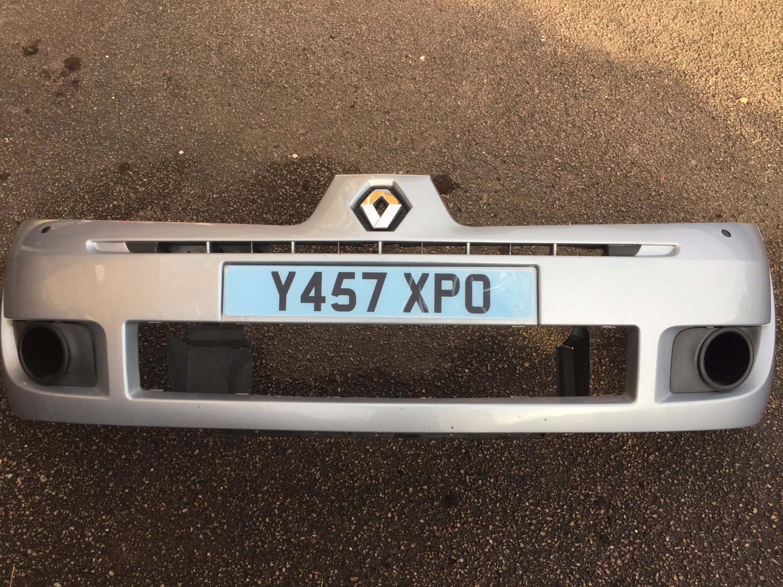

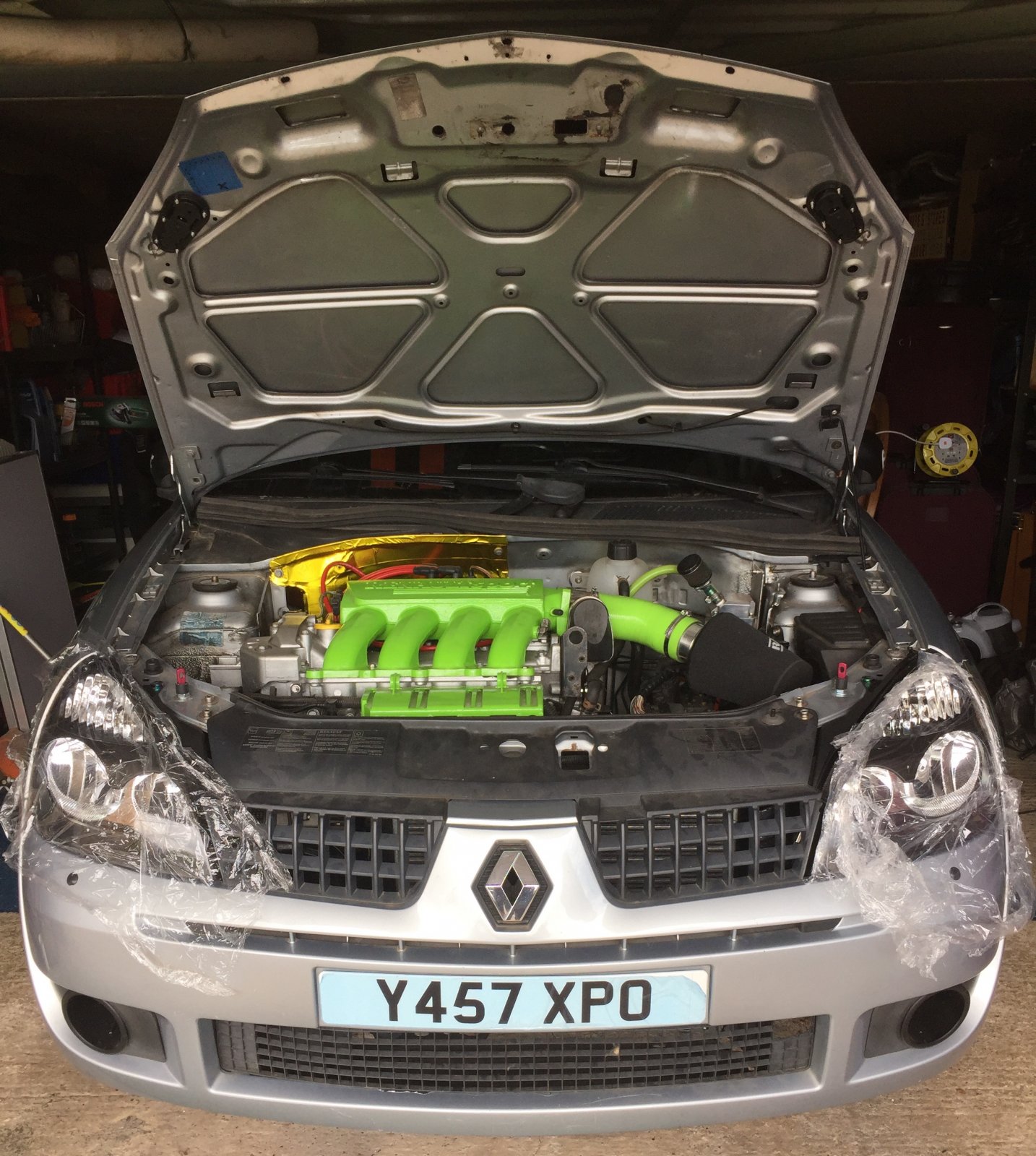

Wheels and bumper are off.
Wheels for a clean(!?!), and bumper so I can sort the adjusters on the headlights.

Did get my headlight adjusters fitted, and have adjusted the drop links on the white line ARB.

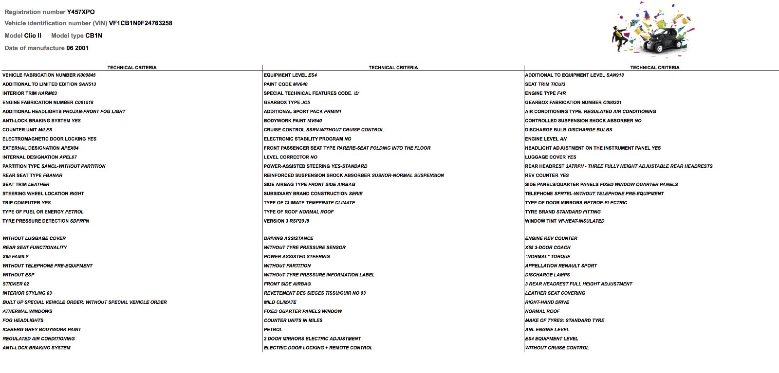

So speaking to @jaswalker24 the other day, and Joe has kindly found some spec info for the car when it was originally built.
From the electrical issues, we've found that the car was one of a group only made for 7 months in 2001, and also appears to be a bit of an odd job.
It doesn't have ESP, but has ABS.
  Many.
Is nothing special.
It's only 2003 cars that had ESP/bolted diff, then late '03 had cruise too.
Yeah yours is early in the fact they changed some things but not groundbreaking.

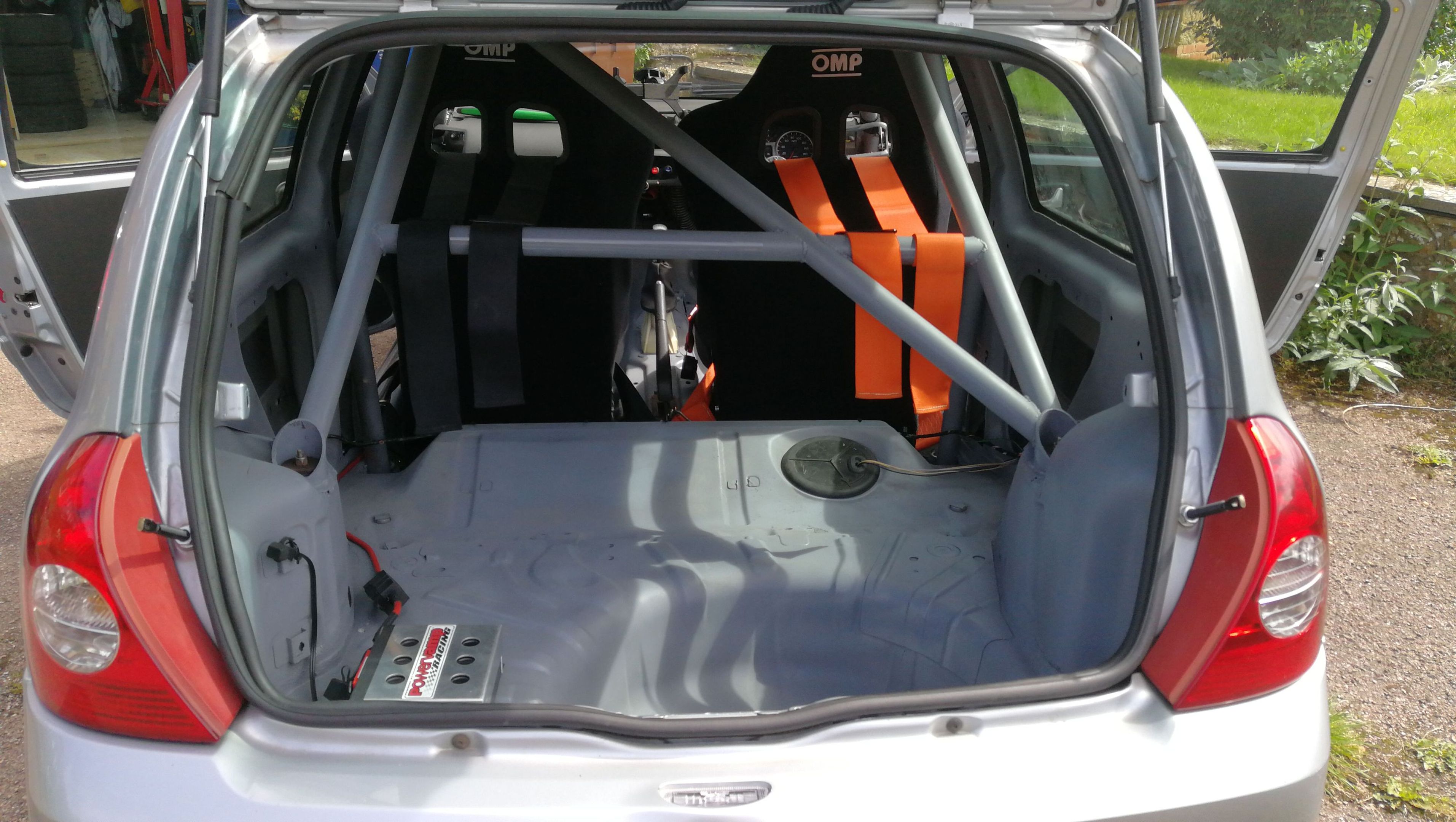

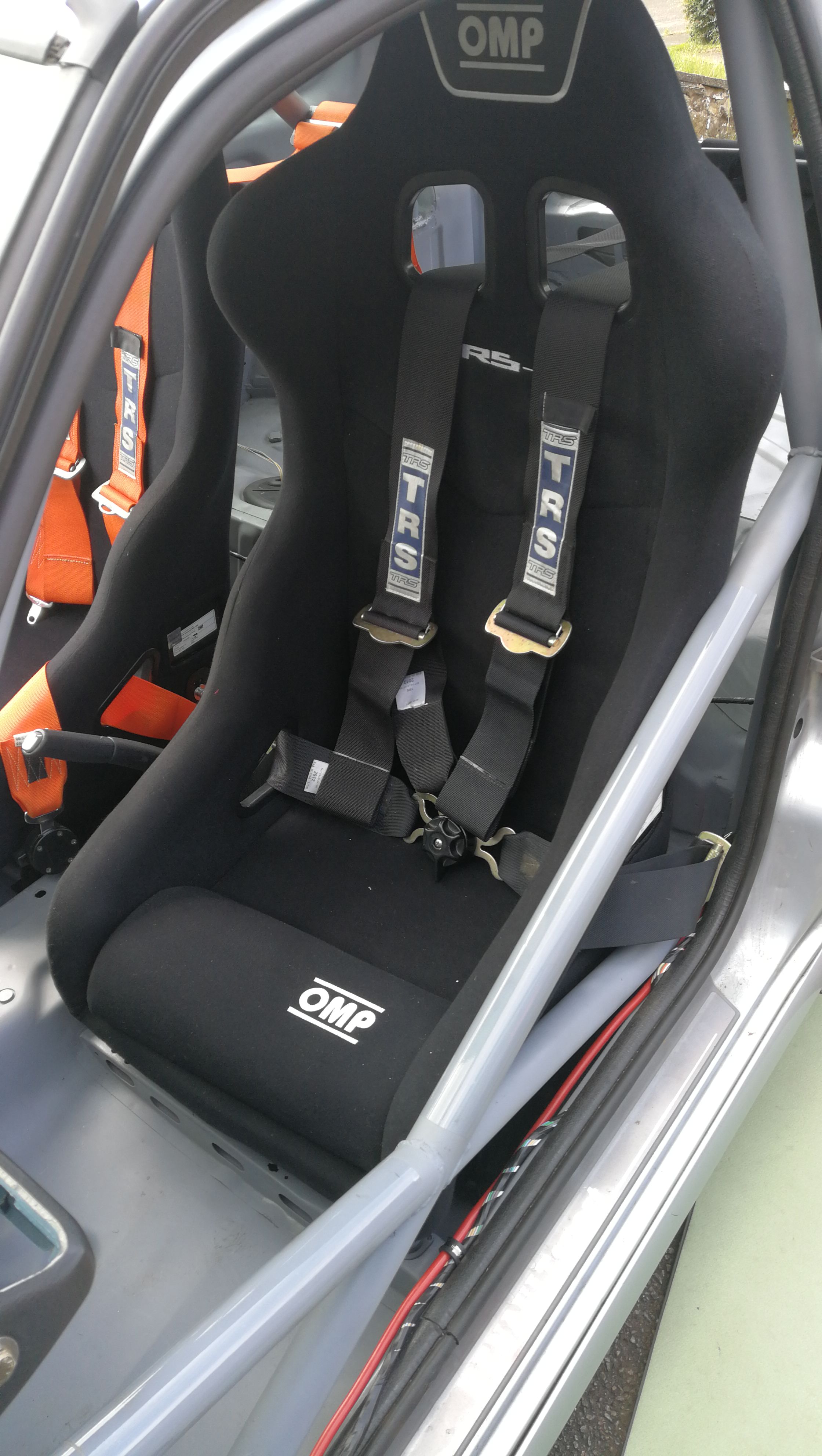

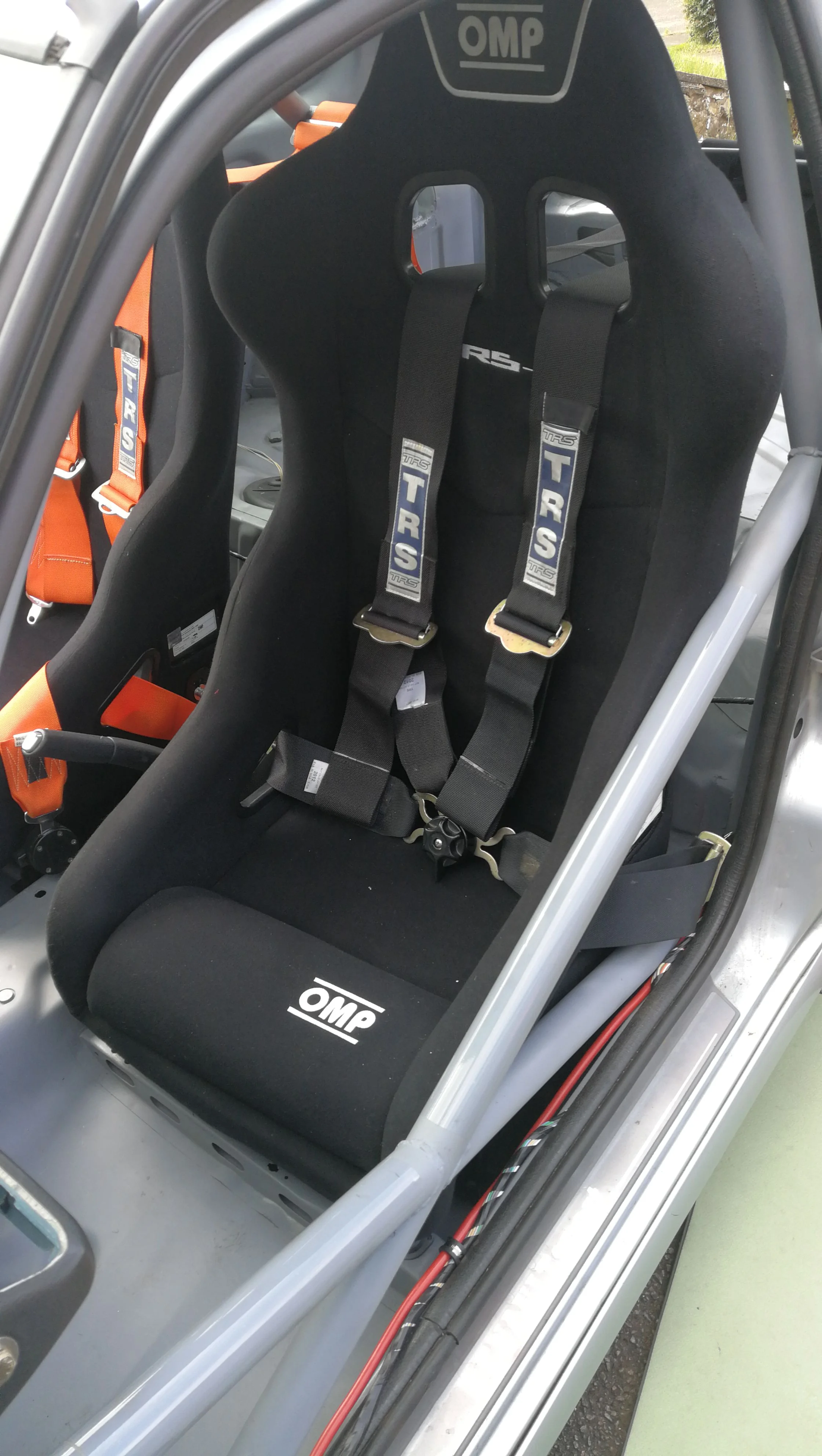

Had a free morning so set about finally getting the passenger seat in, along with harness, whilst also adjusting mine.
I hate fitting seats. Have it a thorough cleaning inside too. Well, my level of thorough...
Mum was chuffed that she could get in and out quite easily. Then again, she is fairly small so it's not quite the same tussel to get in and out that I go through.

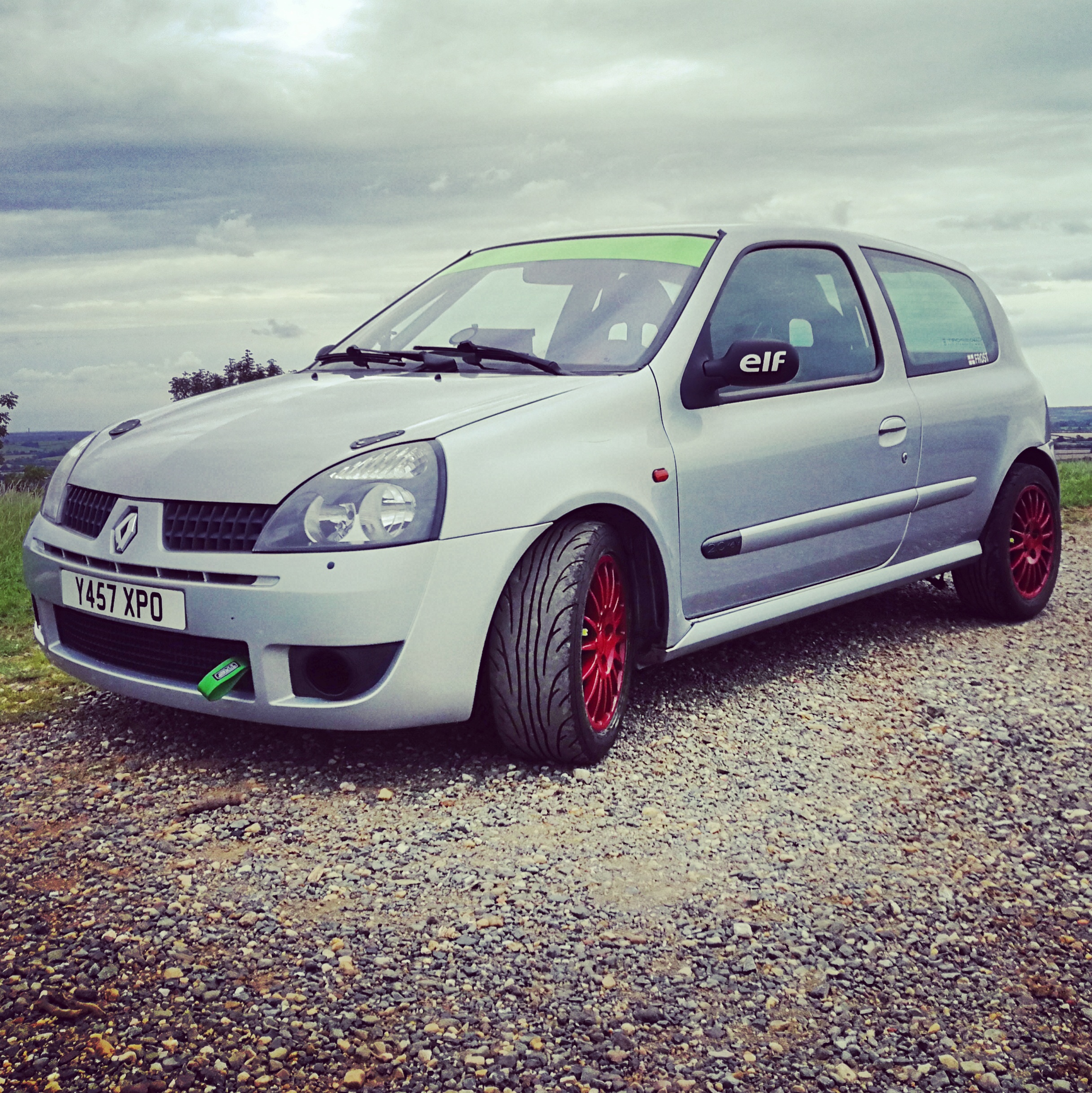

With those out the way, I came back to the paddock, and adjusted my tyre pressures, and took a brave pill, and headed onto track.
It was....
AWESOME!!!!
The car handles really well, the DS2500's were more than enough for someone driving their first 1*2 on track, and more importantly, nothing broke.
