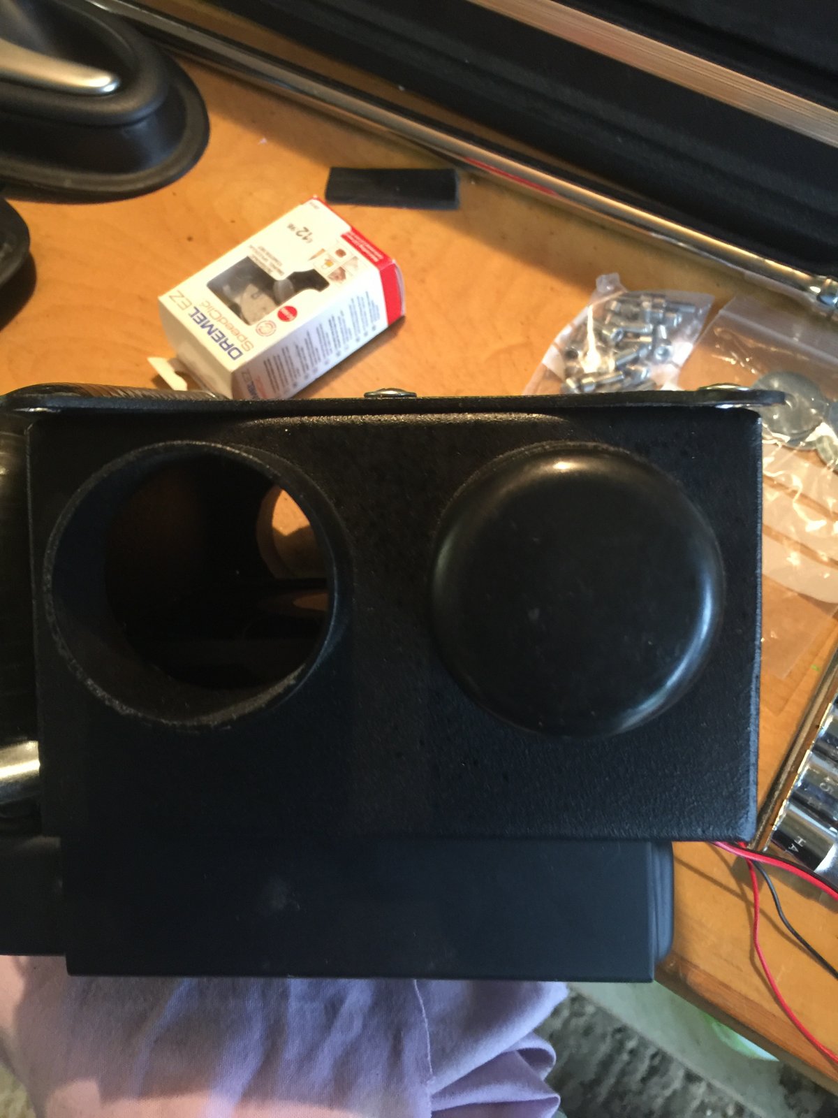

Waiting on some bits to turn up. Bolts, etc.
Got some caps to blank off 2 of the heater ports.
51mm if anyone needs to know.
Also trimmed up the fog light surrounds to fit the brake ducts. Secured with the good old cable ties.

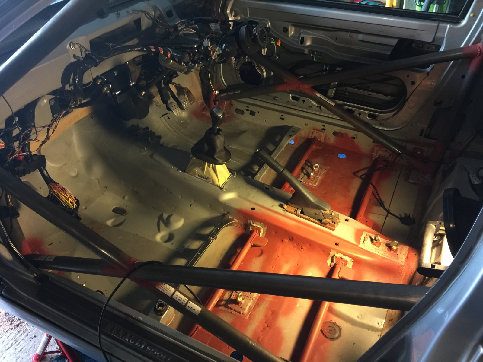

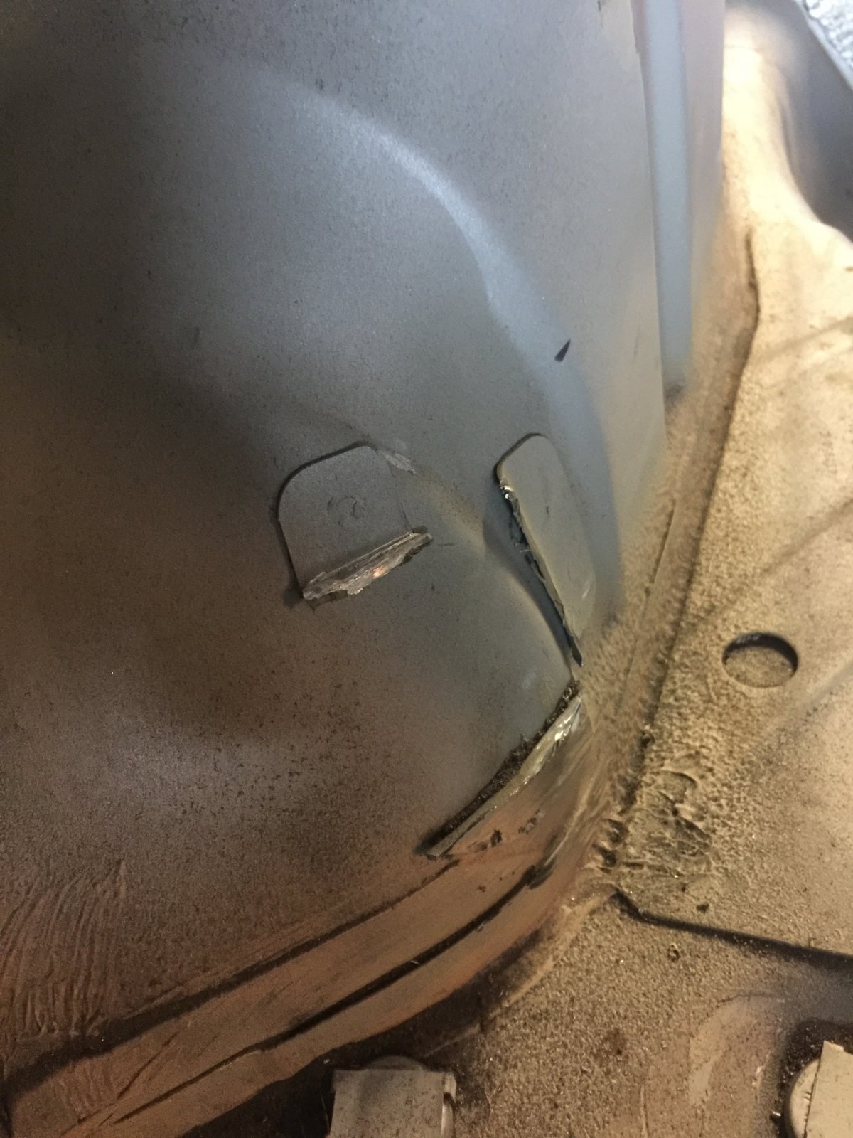

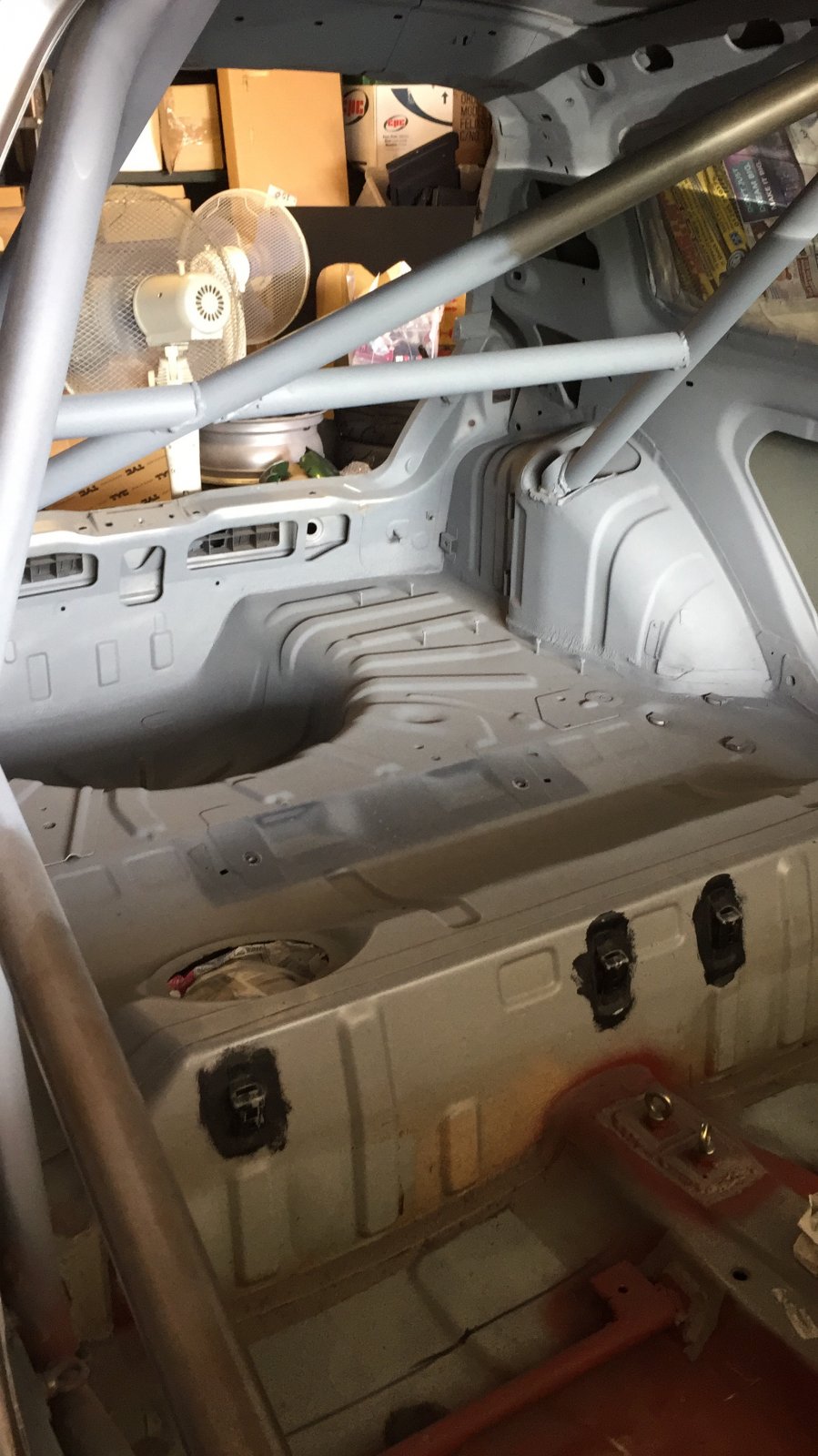

Got a few more jobs done this afternoon.

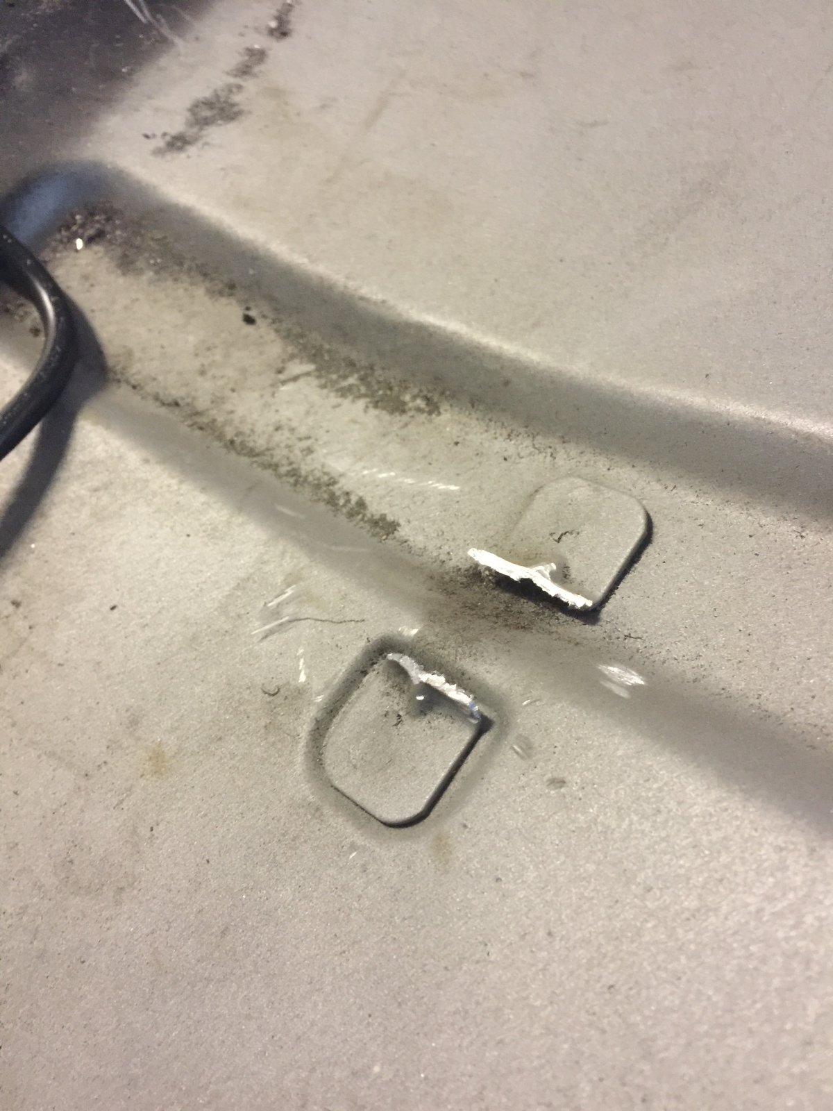

Refitted the spoiler and boot latch, and made a start on grinding off the unwanted brackets before the grinder packed up. Not bad for 10 years I suppose.
Will grab another one this week and crack on grinding them down now they've been cut off.

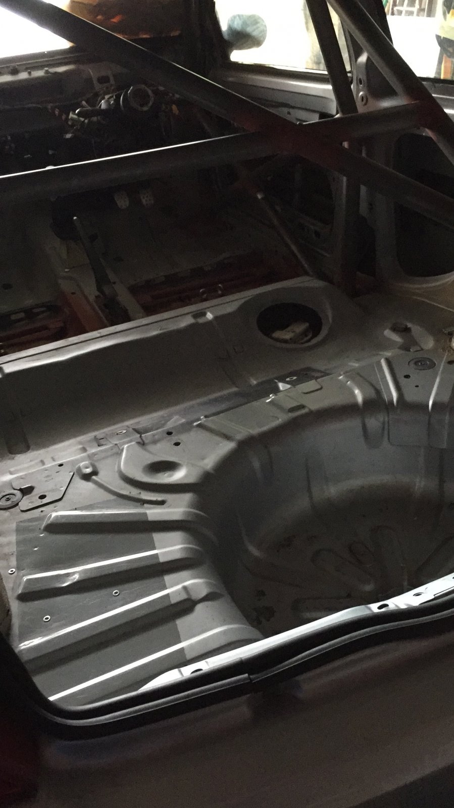

Popped to Argos this morning to pick up an über cheap hoover too. Something to clean the track car and the DCI with.
Inside was full of metal shavings and dust. Came up sparkly clean.

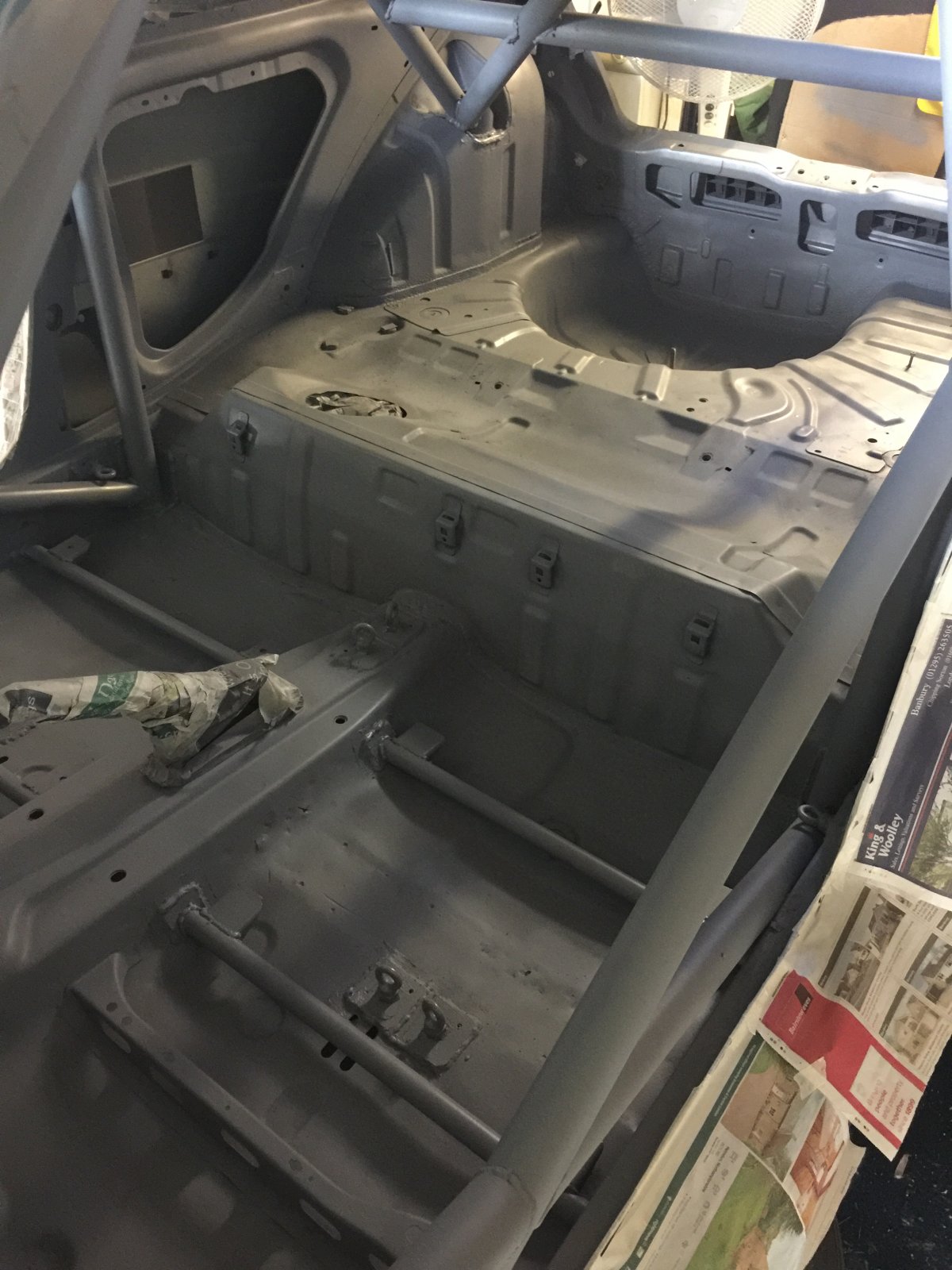

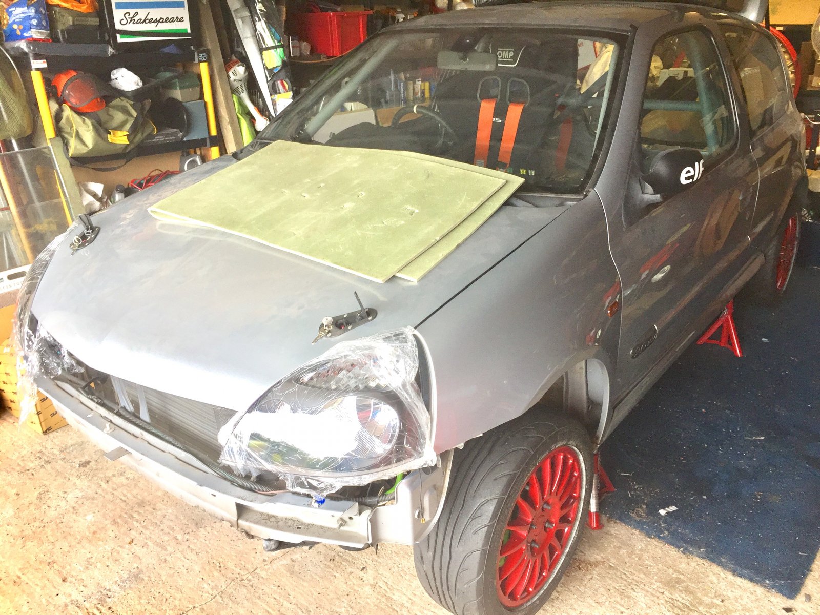

So @Steven103 popped over today, and I had wanted to get the exhaust on and the remaining drop link for the RARB.
However, I found that I didn't have the gasket for the cat to centre, so that will need ordering.

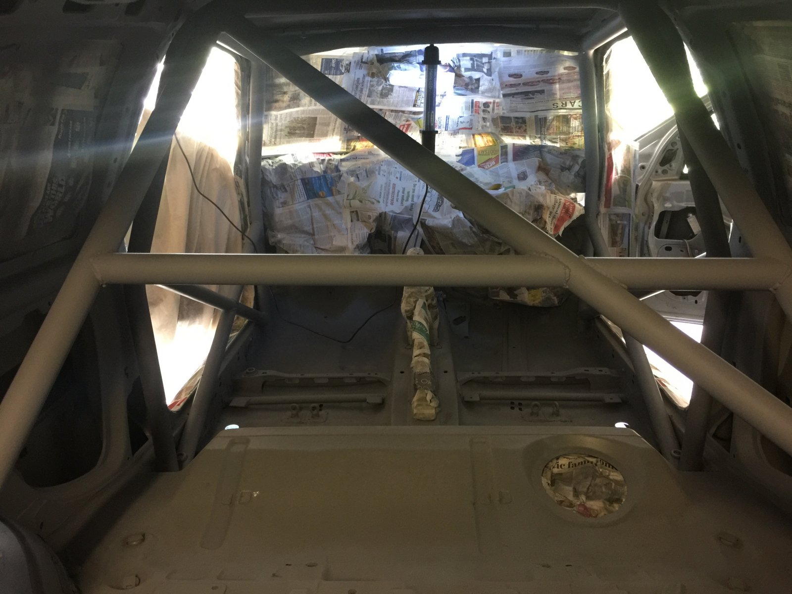

We than thought, lets crack on with some painting!
So a spot of hoovering, cleaning, sanding, more cleaning, more sanding, and more cleaning, and then some masking.
Trip to Halfords for the tape and primer, and we set to work. Back half of the car done, bar the bench bit (as we were sitting on it).

More primer done and the lacquer is on. Will run it like this as at present I quite like it.
However if I don't, I can always redo it later.

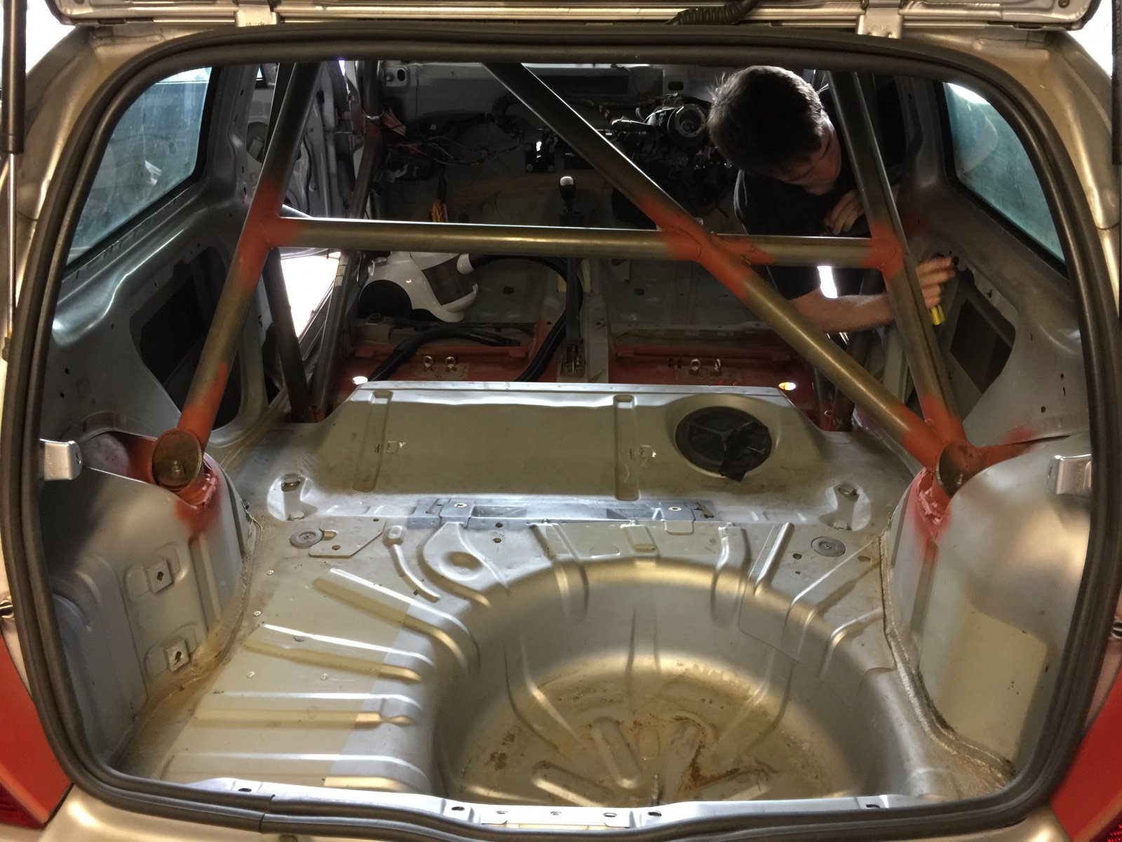

Also Alex and Sash popped by yesterday so that Alex could finish the remaining electrical jobs. We got it fired up too which was awesome!

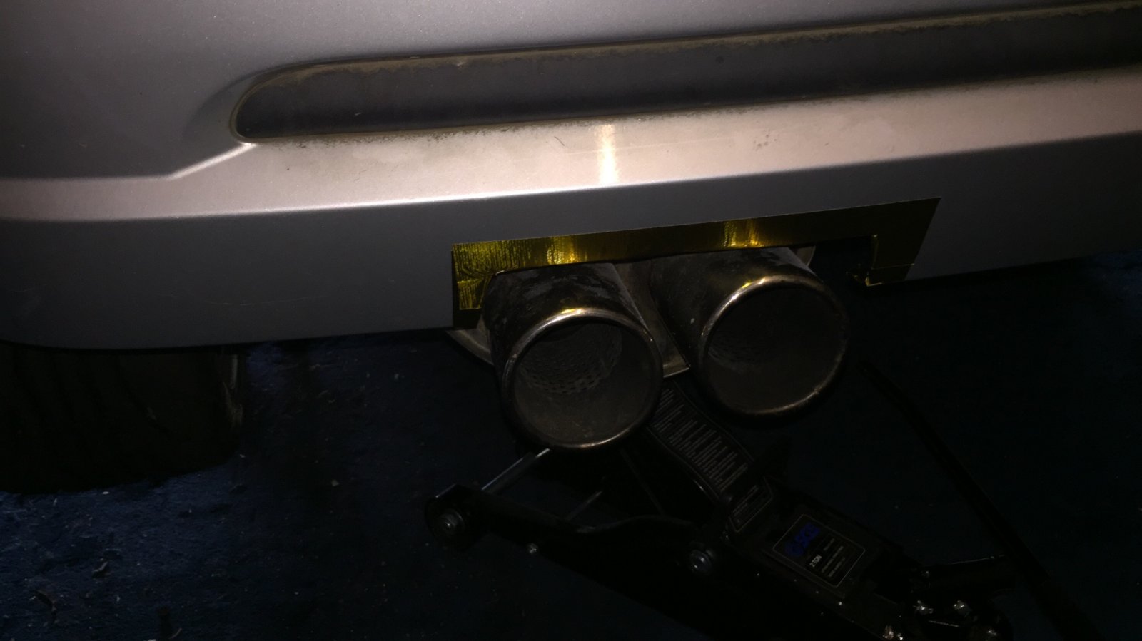

I fitted the backbox after Steven came round the other weekend and helped with the paint prep and fitting the centre section.
Just need to cut out some of the rear bumper so it can go in its place and get the mount fitted.
I've got the week off now, so really am aiming to get it mot'd, taxed and insured!!

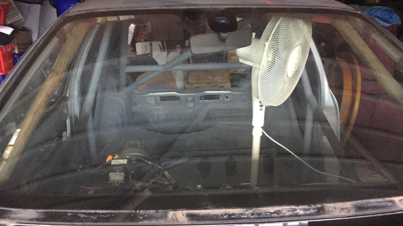

Wiper motor, arms and scuttle panel is all back together.

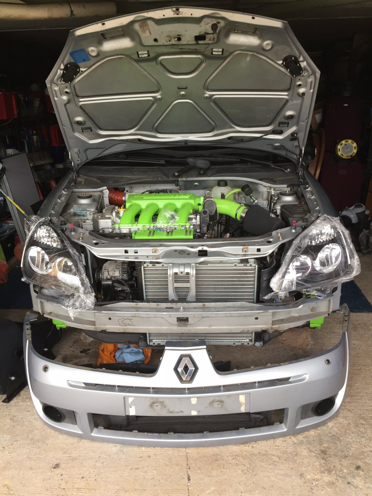

Unfortunately I've now discovered a problem with my brand new TYC headlights.
All brand new bulbs, but the sidelight won't work on my passenger headlight, and the drivers side headlight doesn't work at all (low, high beams, sidelights or indicator).
JP83
South Central-Oxfordshire
Thankfully managed to find the issue with the drivers headlight.
The connector in the headlight wasn't pushed forward enough to make contact with the plug. Now that's sorted, the headlight now fully works. Woohoo!
However, the sidelight on the passenger side still doesn't work. I'm guessing it's the connection.
Any suggestions on how to investigate (remembering my experience with a multi meter is zero)?

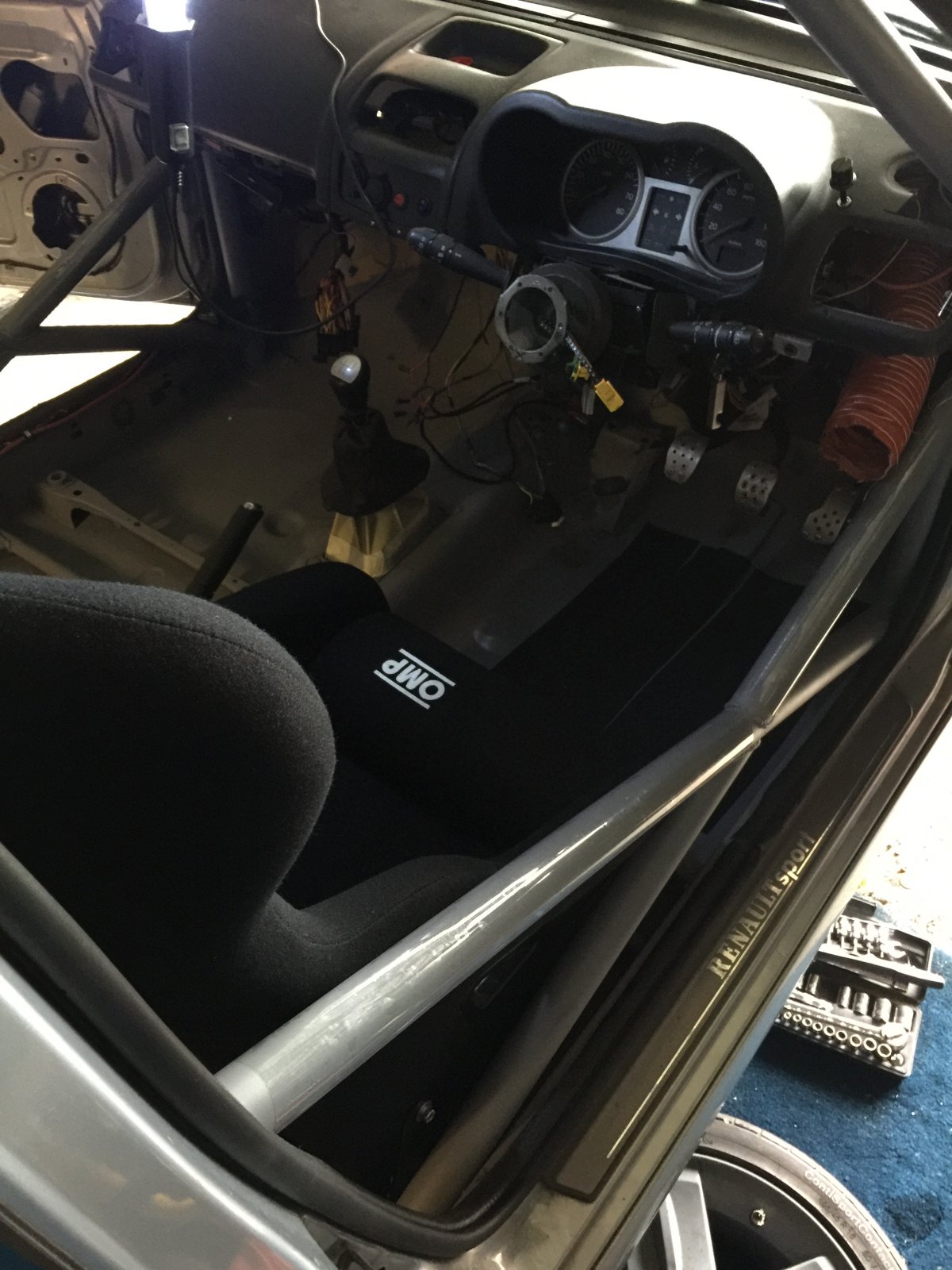

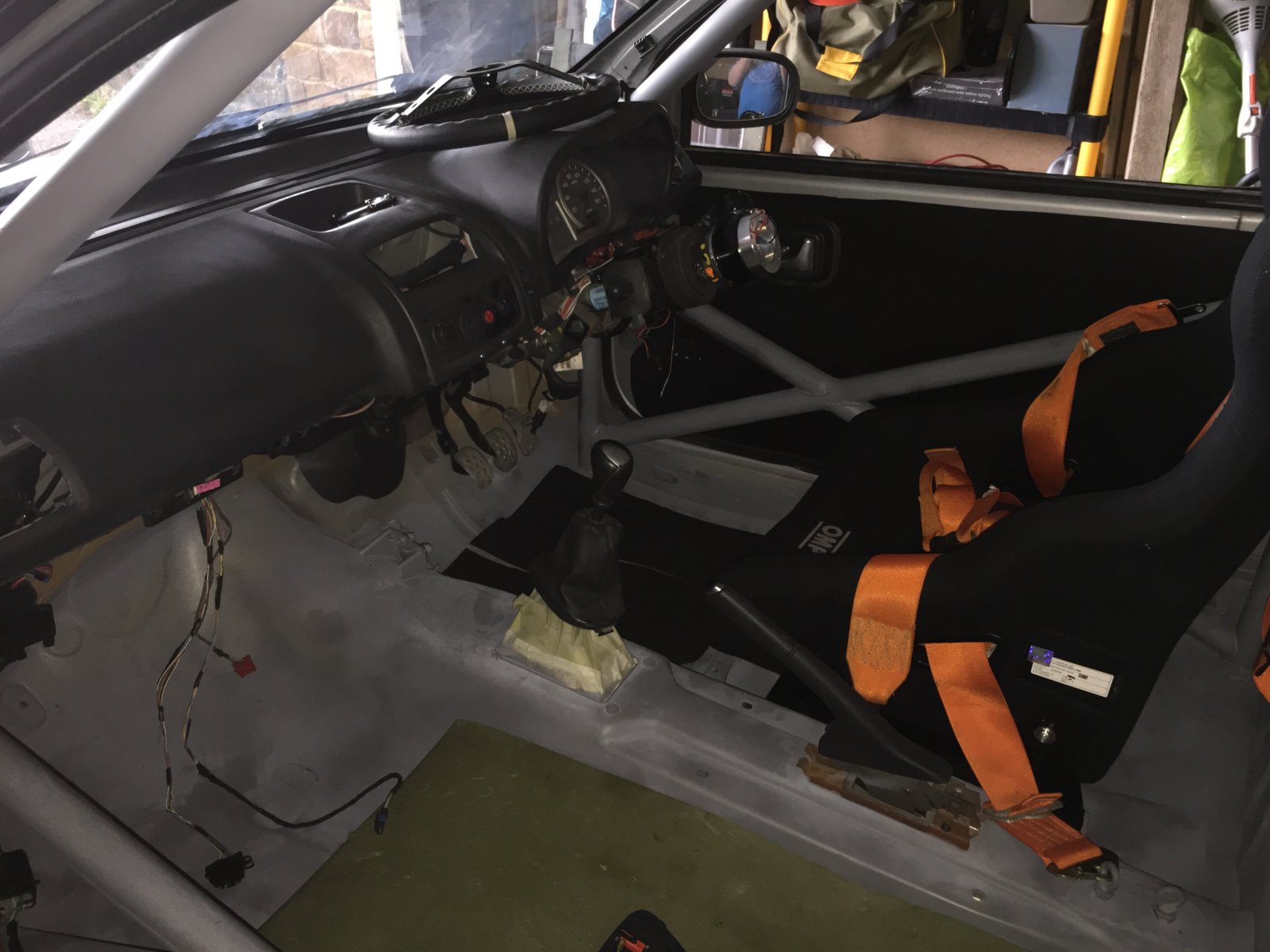

Made good progress with more jobs on the car:
Protective wrap on the rollcage applied, dash mounts added.
EPAS switch put in position on dash.
Exhaust mount fitted.
Grip tape applied to drivers footwell
Seat is in place too!

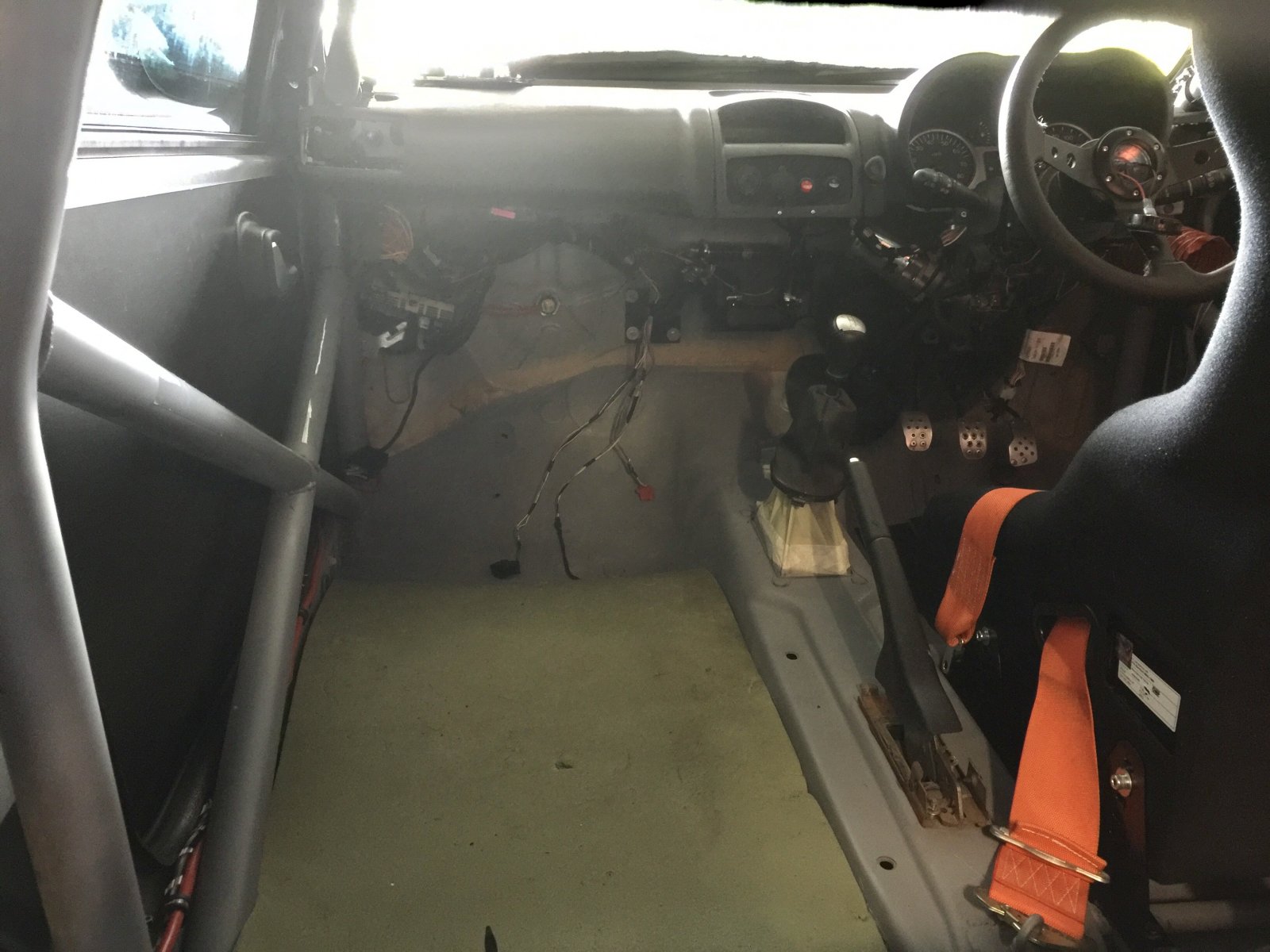

So still scratching my head over the electrical gremlins.
Down to no high beam, no brake lights and no front wipers (don't have a rear one), and no horn.
I managed to get on with some other jobs in the meantime.
The inside actually looks like a car now.

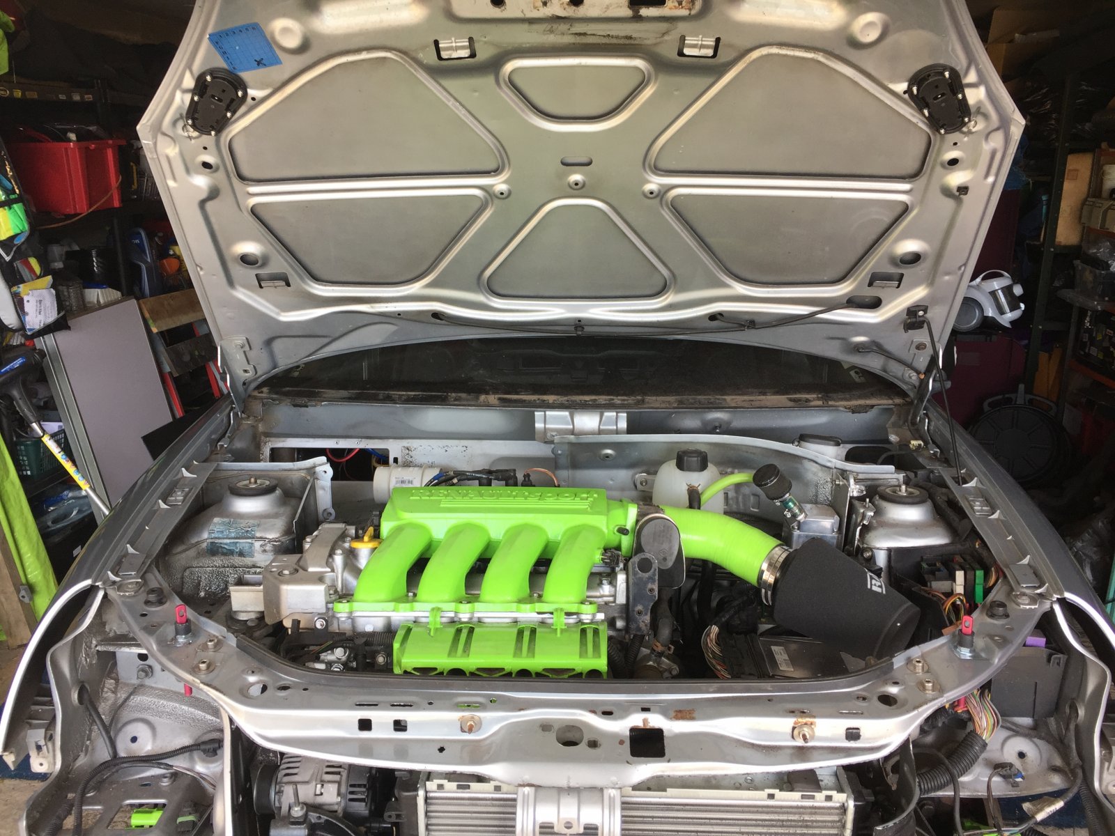

Engine bay is just about done.
The pikey bumper cut. It's comically horrific.

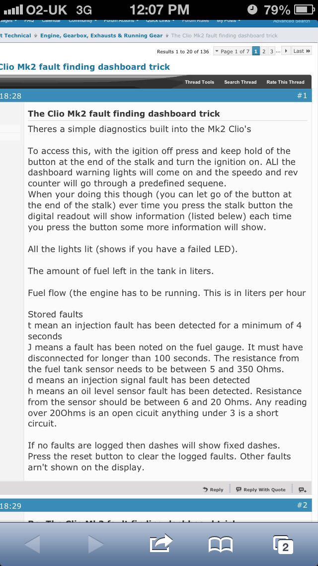

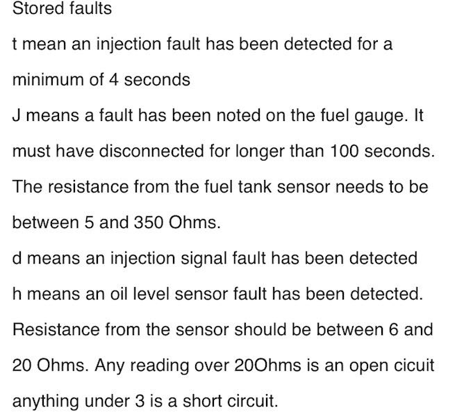

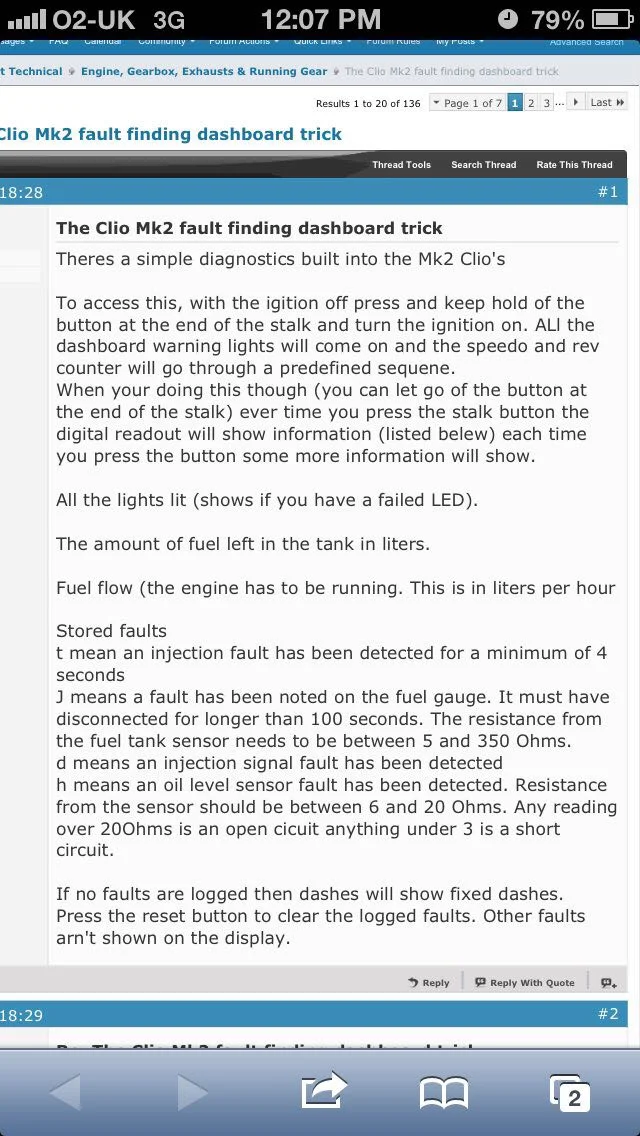

Done a dash test (pressing end of stalk and turning on ignition. Lights ondash come on, and all needles move during test.
I've pulled all the fuses in the engine bay and interior fuse boxes. No broken fuses.
I've reseated all the relays in the uch (the ones at the back).
Earths have been checked in boot (need to check under dash, but nothing has changed since the other night when the lights all worked).
Also during the dash test I've got a couple of codes: t - - h

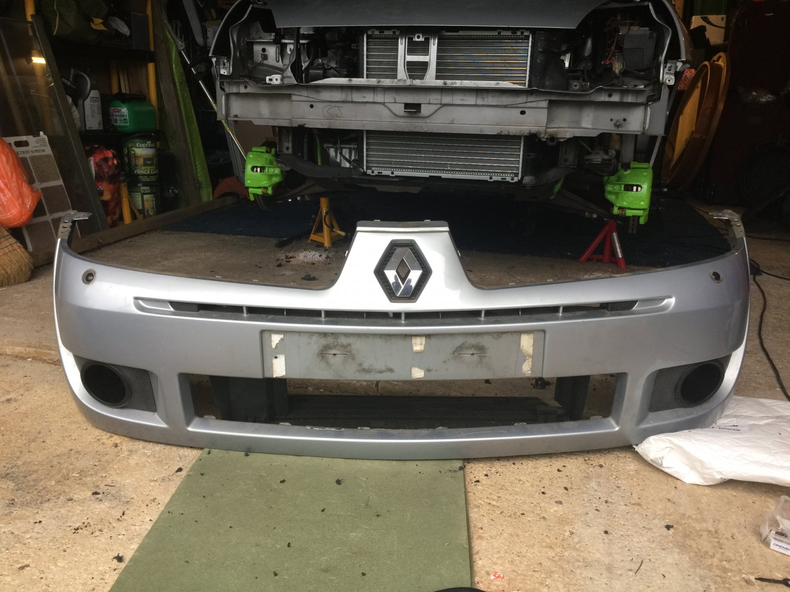

So more playing today. Wheels are on, and some minor adjustment to get the tracking good enough to get to the mot garage (when it's done).
Cat as it stands...
Still have an issue with no main beam and horn.
Bleed coolant, get bumper on, fit door pulls, harness and some silicone on the bung in the aerial hole.
That'll be enough to get it ready for the MOT.

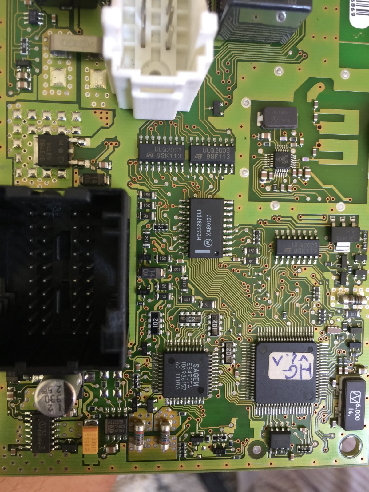

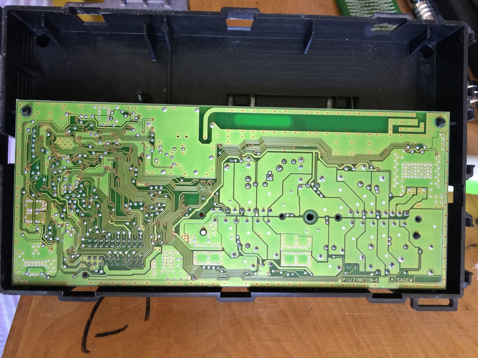

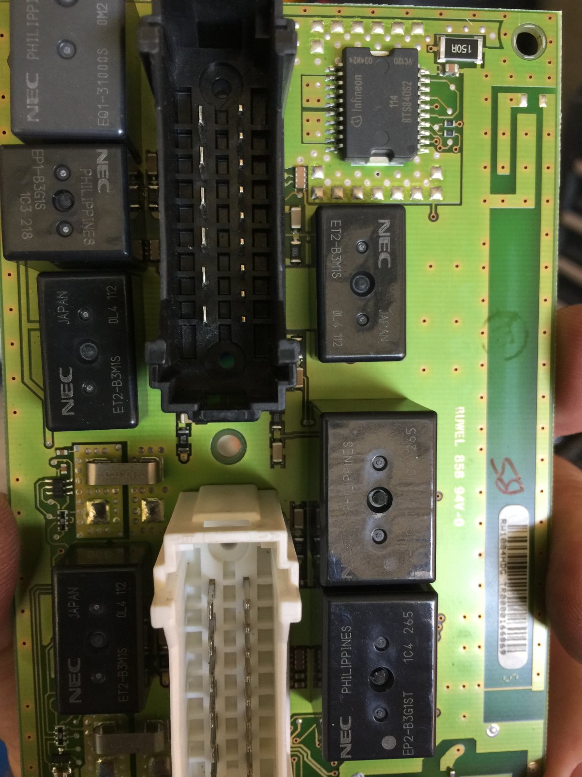

Pop the UCH off , see if there's any circuit board fried. I did this on my old Dci... accidentally hit The alternator poll doing a filter change , dash wouldn't work, lights intermintant and horn dead.
JP83
Will take a butchers.
Bit strange that the dash test works ok, but when the ignition is on, none of the clocks work?

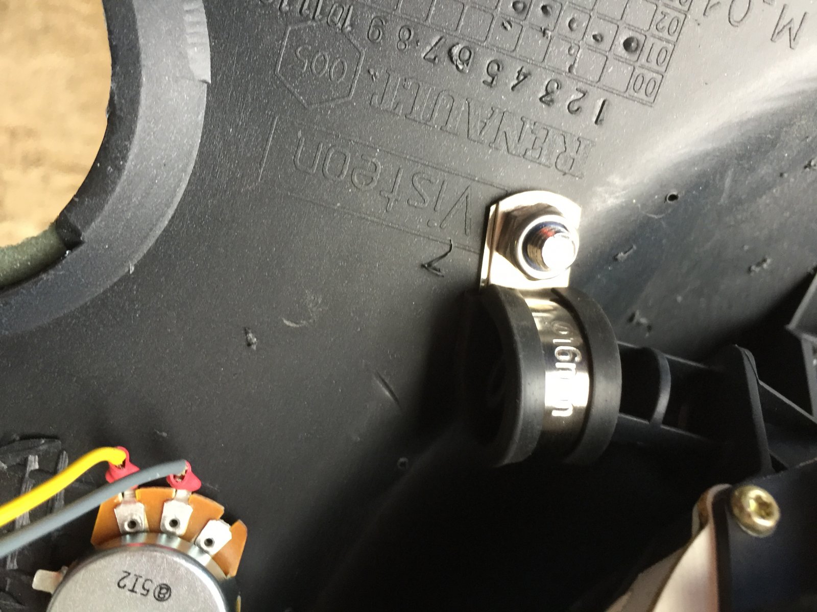

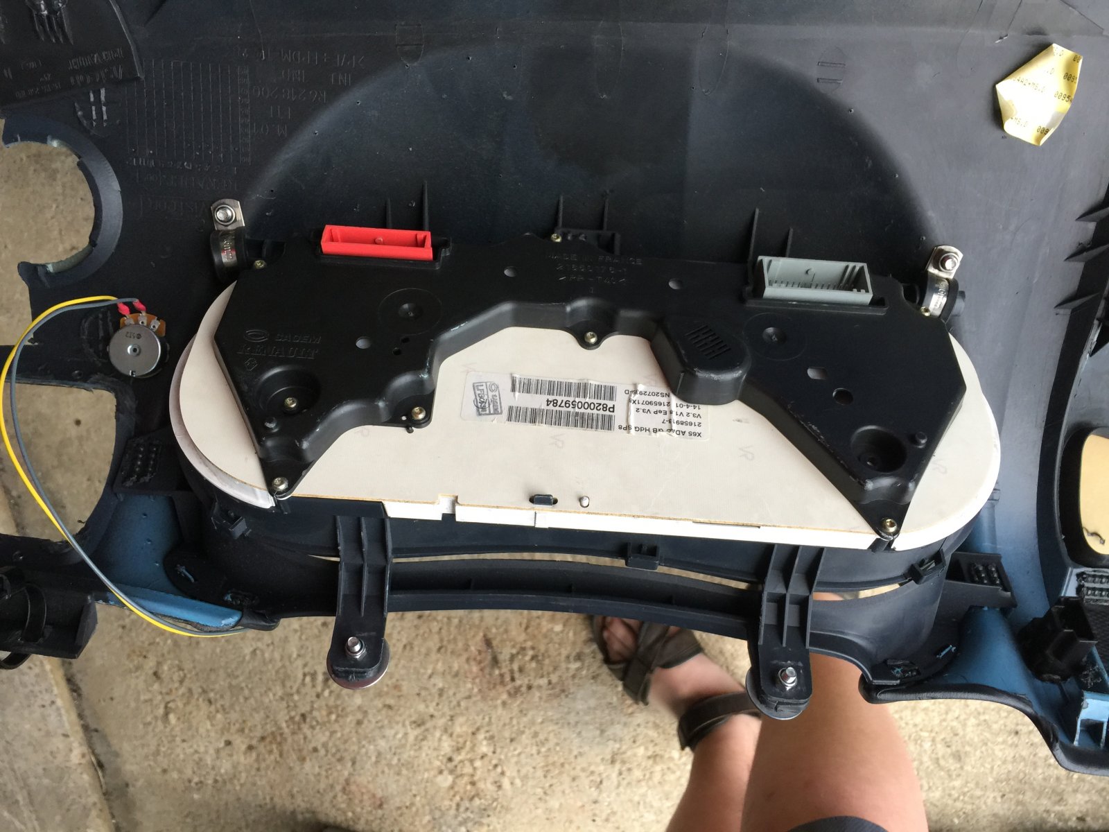

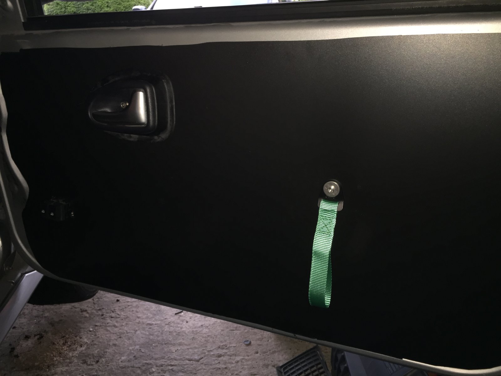

Couple more jobs this evening. I was trying to think of a way of securing the clocks to the top dash without making them difficult to remove (and not using cable ties).
I purchased some fancy bolts and washers from CSF last year, so have used some for the headlights, and 2 for the clock mounting.
(DEM SANDALS)
I also got the door pulls fitted. Rivnut in the door, hole in the doorcard and job done.
