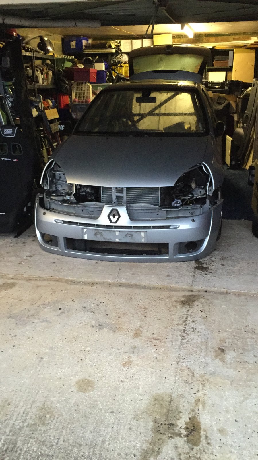

Right, back on topic.
It would appear that when the car was delivered back to me, the bonnet was shut - makes sense.
However, in my eagerness to strip the car, the bonnet release handle & cable was removed..... And now I can't open the bonnet.... D'oh!
Any pointers?
Edit: Front bumper is off, so there's access to the mechanism.

I would open the bonnet.
How did you remove the cable?
I take it that the bonnet was open when removing then closed... now you're trying to get back in?
If so with the bumper off, you should be able to get it open by putting a flat head into the mechanism. i could be completely wrong though 😂😂
Yeah, bonnet was open initially. It was removed prior to being taken away to have the cage welded in (and the handle inside the car is in the way of the front upright, so needed to come out).
I'll try the screwdriver trick. Otherwise, it might be a good excuse for a fibreglass bonnet....

Good news! The cable for the bonnet release was actually still there, so gave it a good tug (Ooo errr), and was able to open the bonnet!
Unfortunately, it was late and dark, and my enthusiasm to stay outside for any longer was very shortlived.

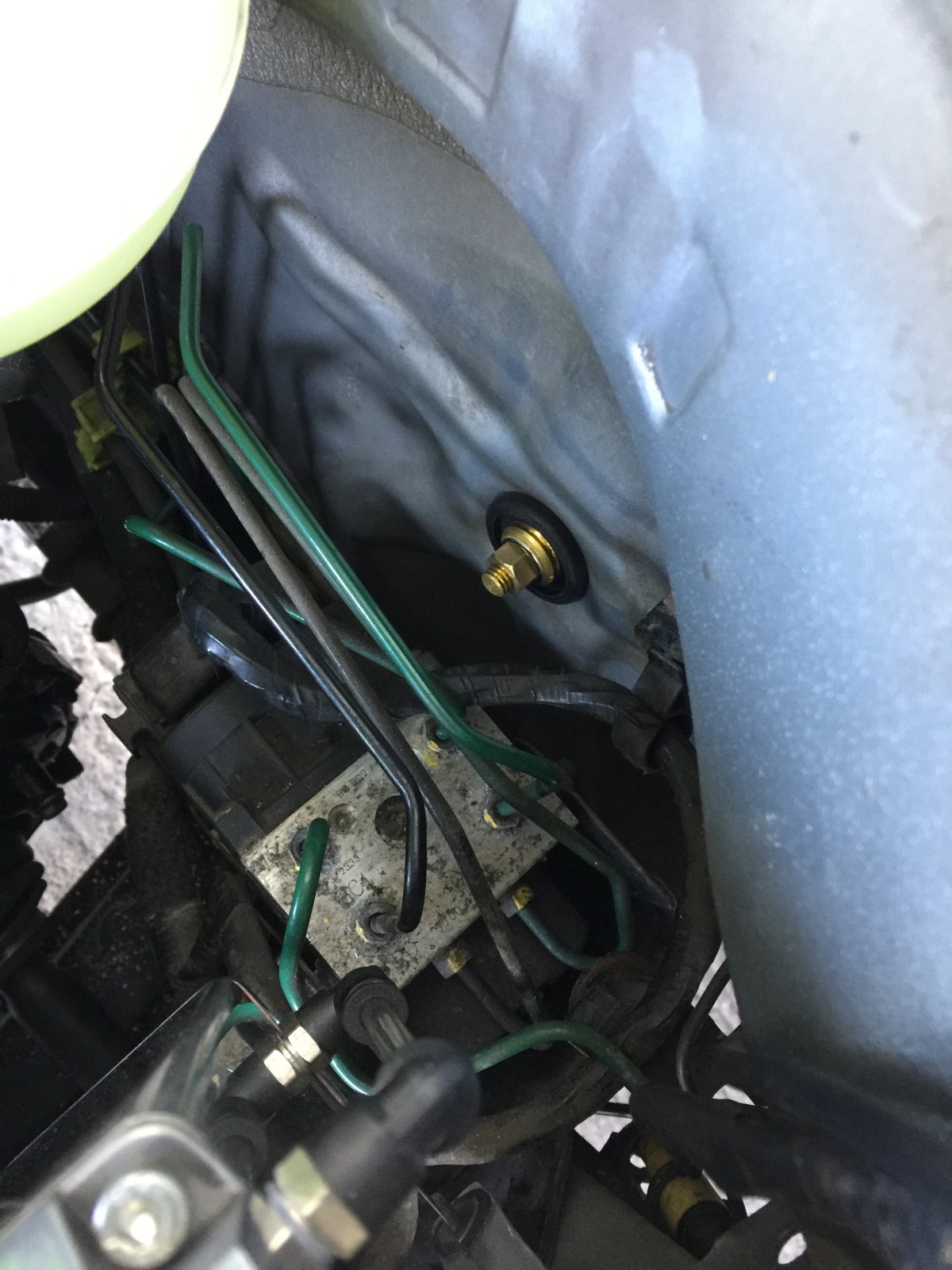

Not had much chance to get in the garage recently, but managed to get a few hours in there today, and Steven came over.
He was determined to get the front brakes sorted!
So with the new brake pipe flaring tool, and "special grease" in hand, Steven set to work. New fittings have been put on, and there are no leaks - happy days.

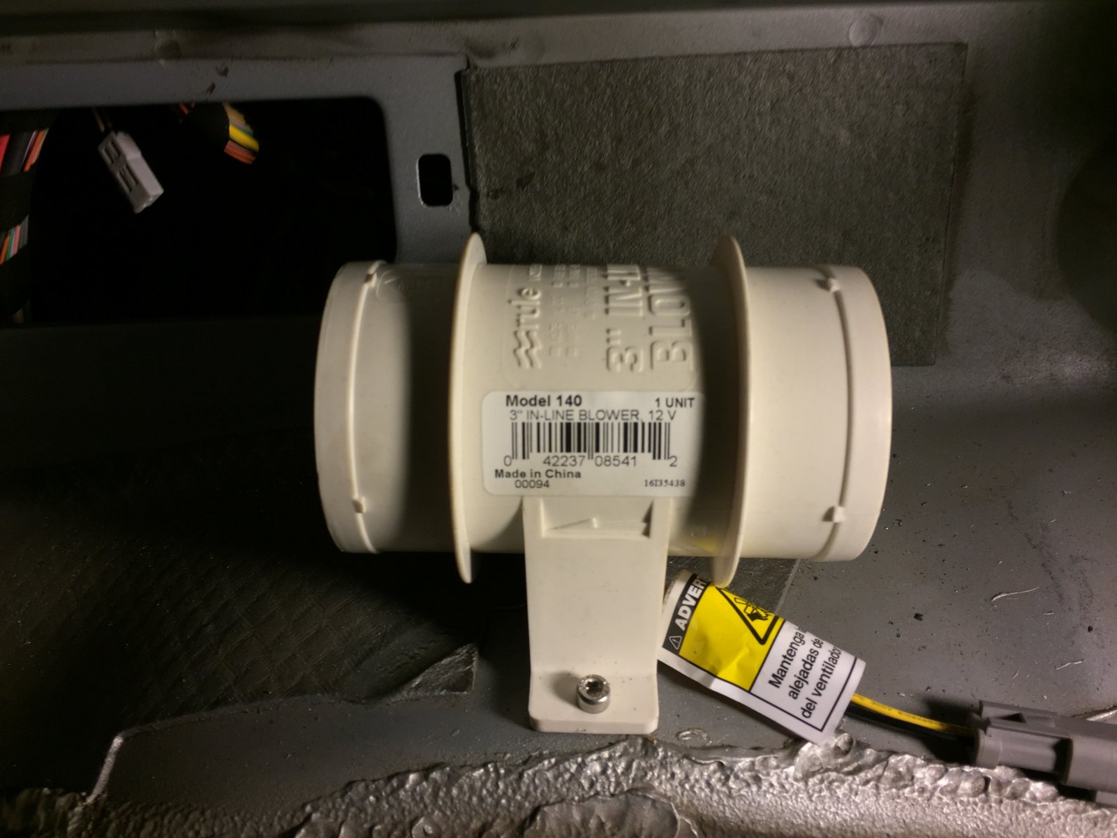

I also managed to get the blower unit out, and have put the blower in place. Unfortunately numbnuts here forgot to charge the drill, so no actual fitting took place. D'oh!
It looks tiny in there, bless it.

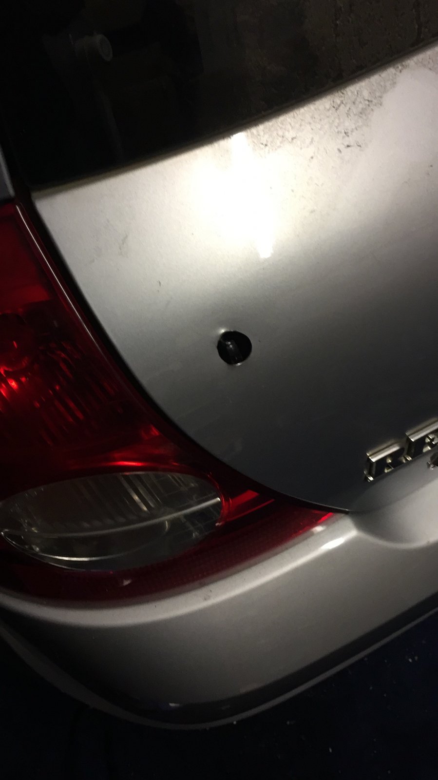

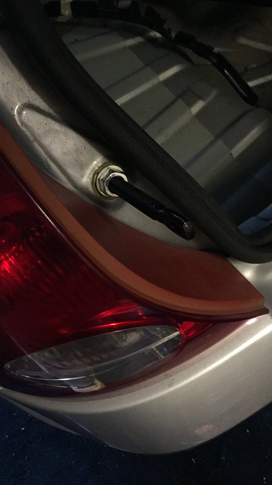

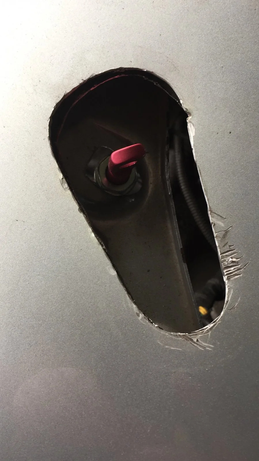

Boot pins. Taking some inspiration from @M.C.. I got to work.
My foolproof way of finding out where to drill...
Got 2 rivets on, but the shape of the catch won't allow me to get the rivet tool flush to it. Will have to think of something else to replace the self tapper.

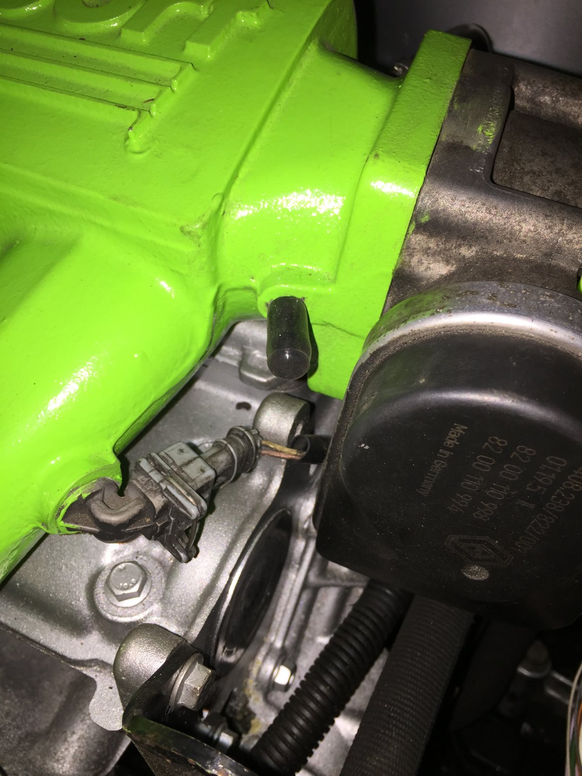

Found some 5mm silicone caps on eBay. Does well to seal the breather after removing the acoustic valve.

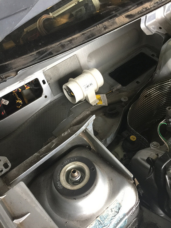

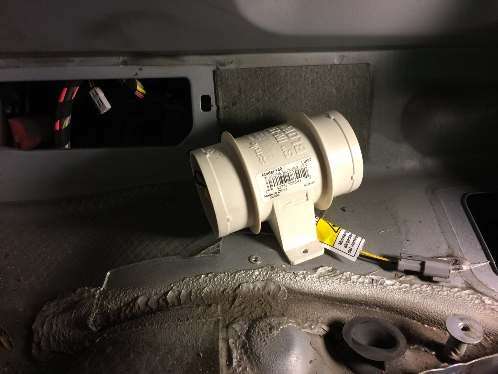

Got my rivnut tool (which is awesome!) and started on mounting the cold air blower for me in the cabin.
Got a dremel the other night as well to tidy up some bits and the boot pin fitting.
And yes @dann2707 the tar will be removed. :tongueclosed:

@JP83 Similar way I marked mine where to drill but I was not as brutal 😂
Just use some M3 or M4 (can't remember what size I used) stainless button head bolts and nyloc nuts instead of the self tapper, they are a bit fiddly to get the nuts on though.

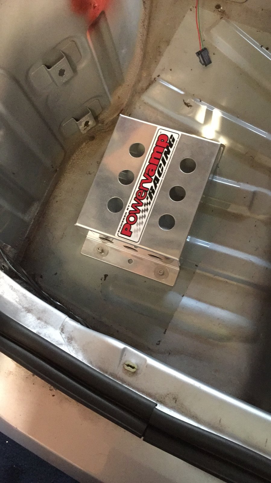

Got the battery cage position sorted.

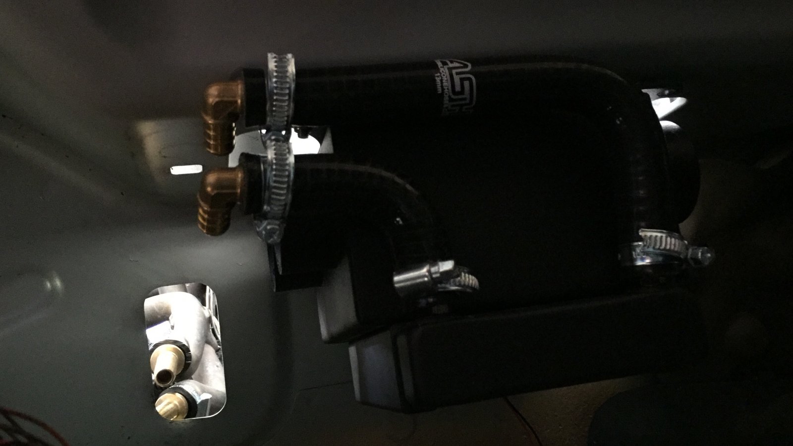

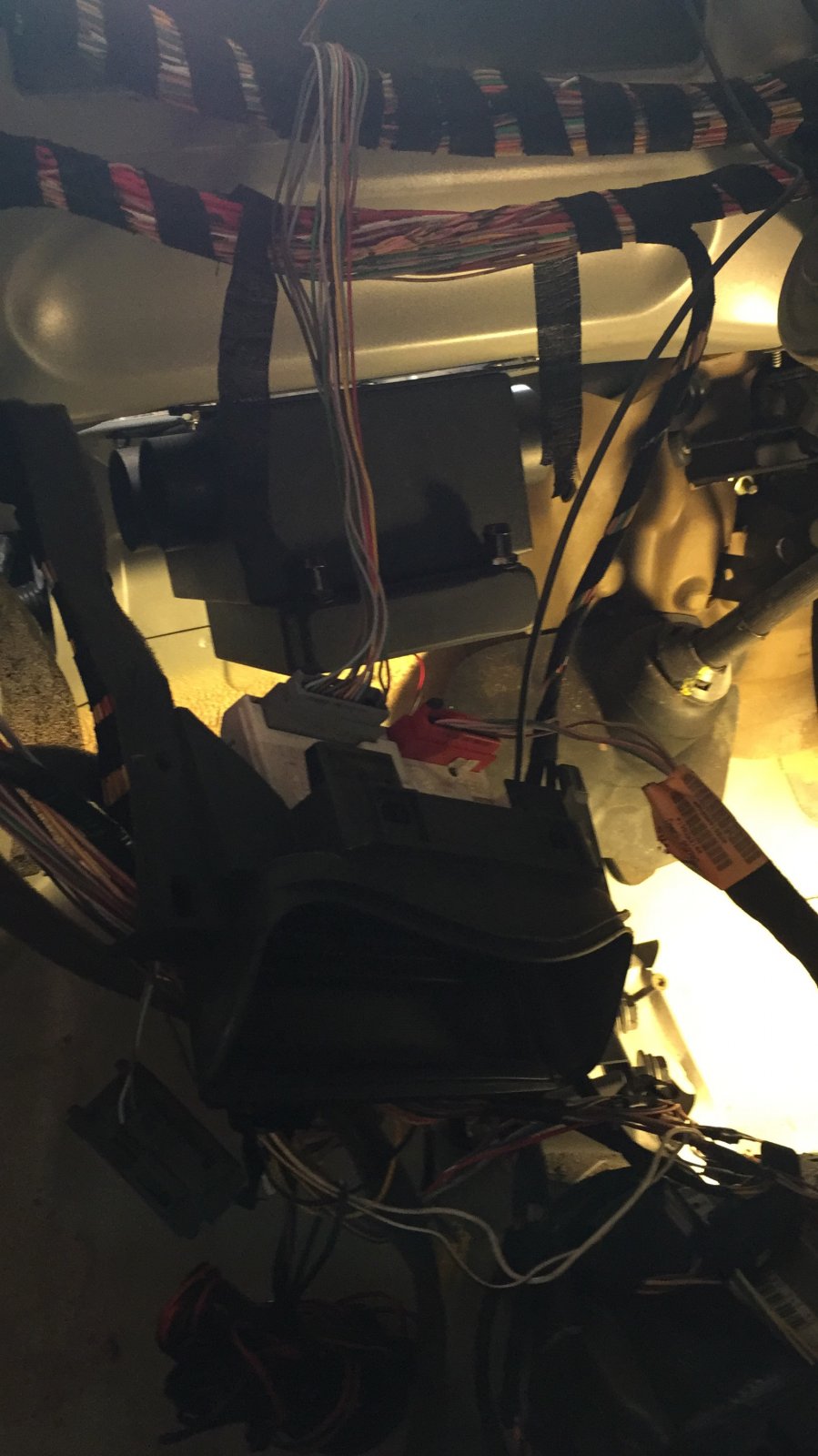

Also got the T7 heater; which will be my screen demister, mounted on the underside of the bulkhead.

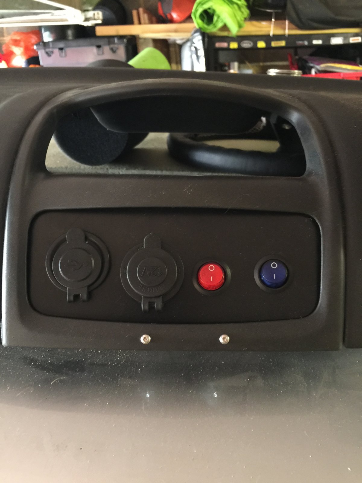

Also got my switches positioned on the top dash. Keeping it simple, so blue = blower, red = demister.

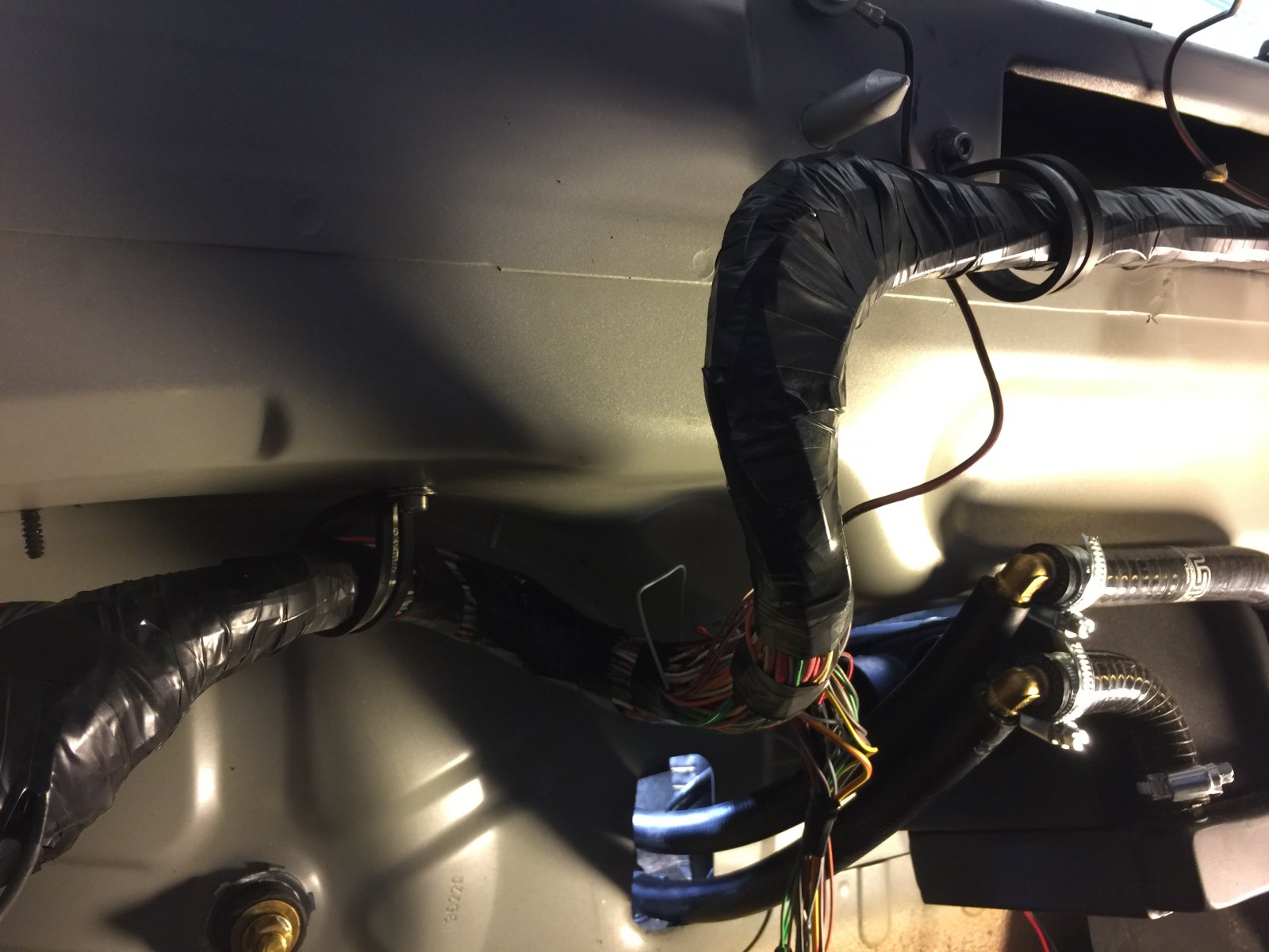

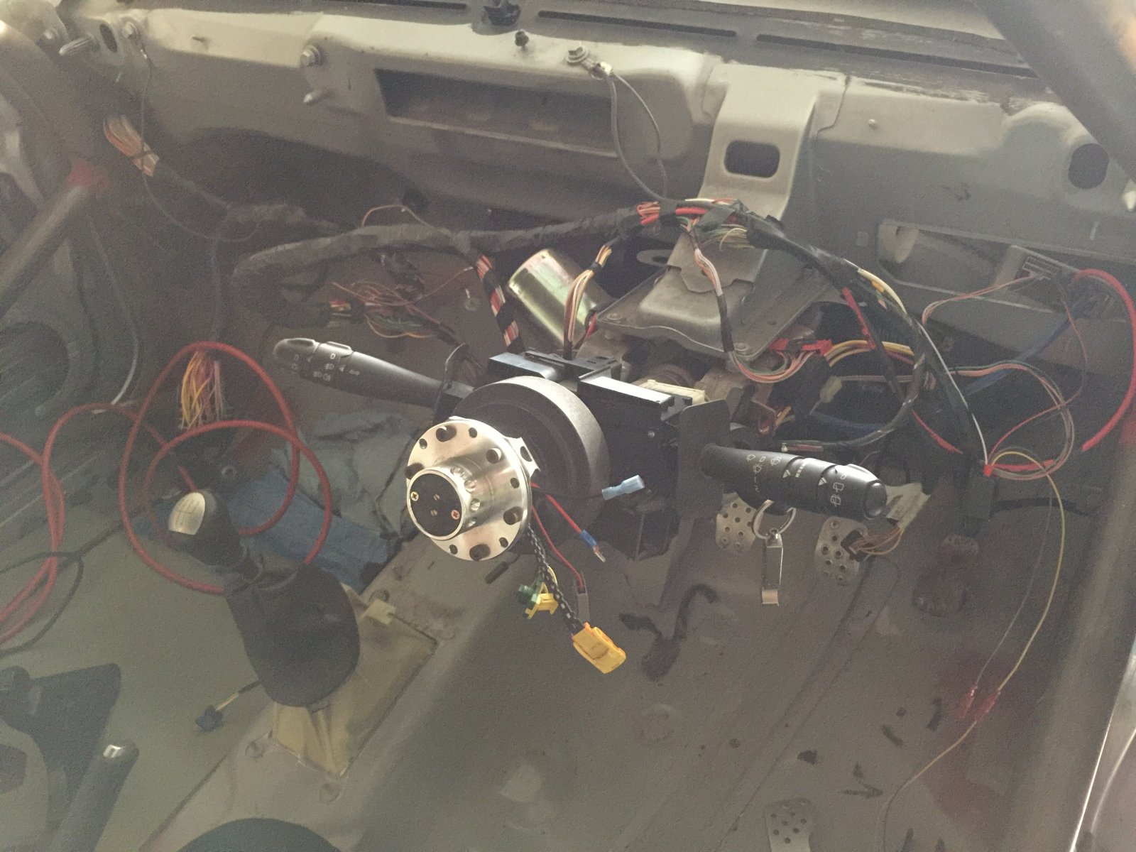

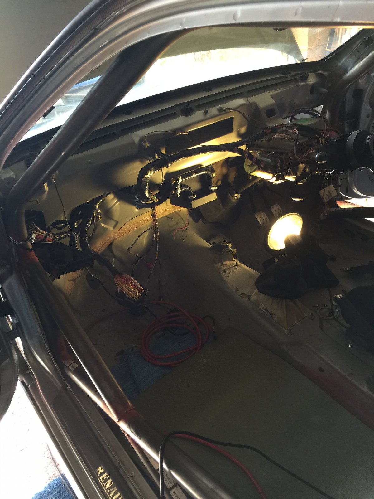

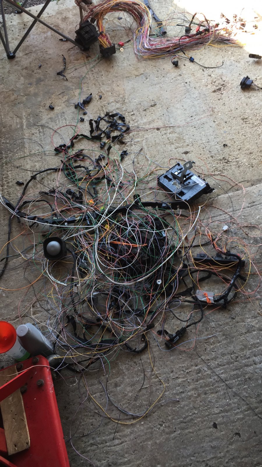

And then today, was a day I'd been eagerly anticipated. Mr @AlexW dropped by to make a start on my wiring loom for me.
After a few hours, he'd trimmed the unwanted stuff out. Rear wiper/ washer, airbag and alarm crap, speaker wiring, climate, etc, etc.
Weighed it all, and it came to 8kg!
Unfortunately we got a few snags.

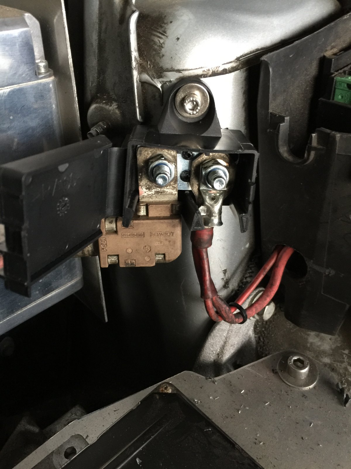

I'd only got 6 & 8mm battery terminal connectors, but the longacre bulkhead adapter is 10mm. Doh!!
Also my crimp tool for said terminal connectors was s**t.
Still, huge progress made on the wiring today, and I was very pleased with the progress.

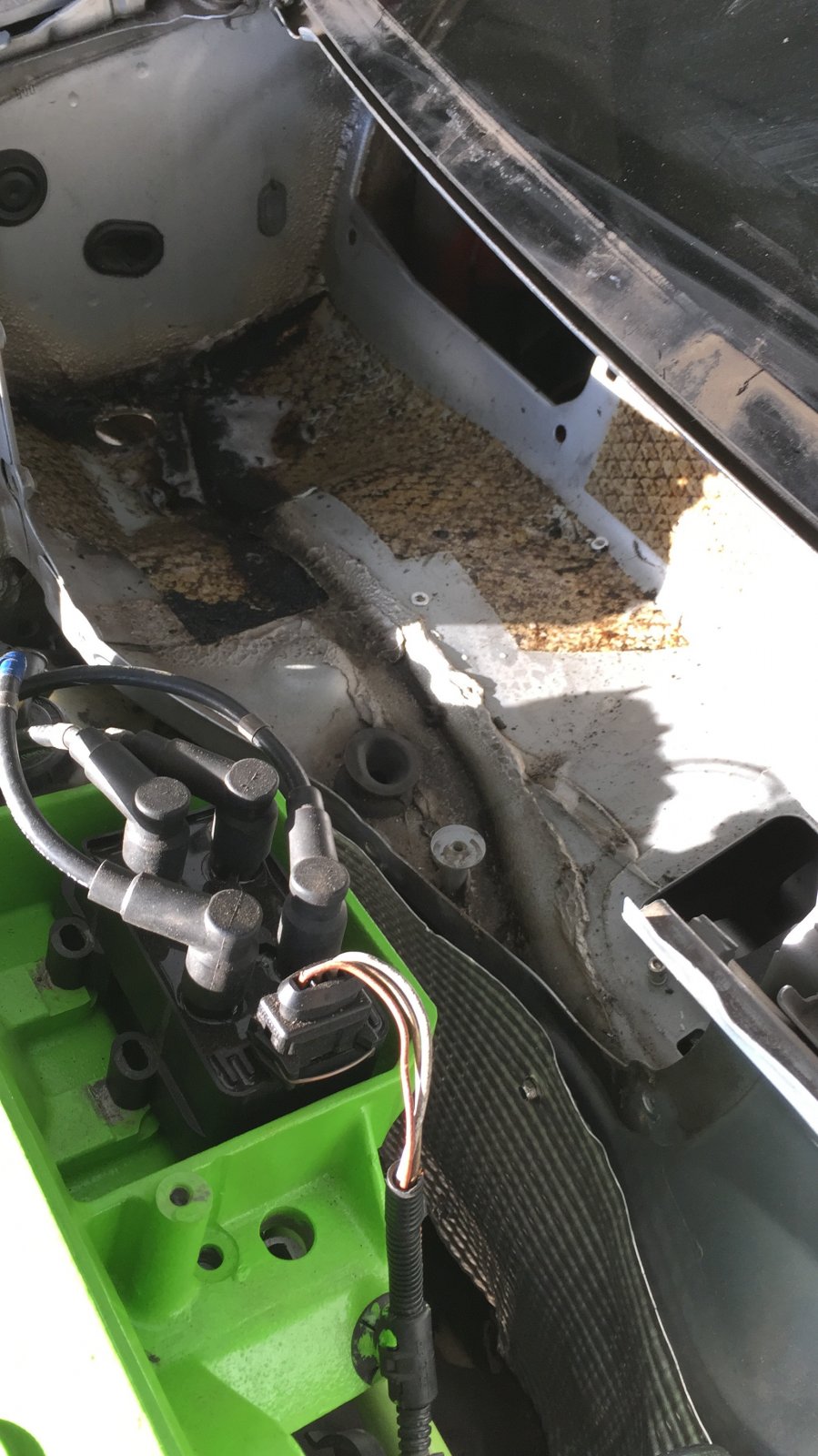

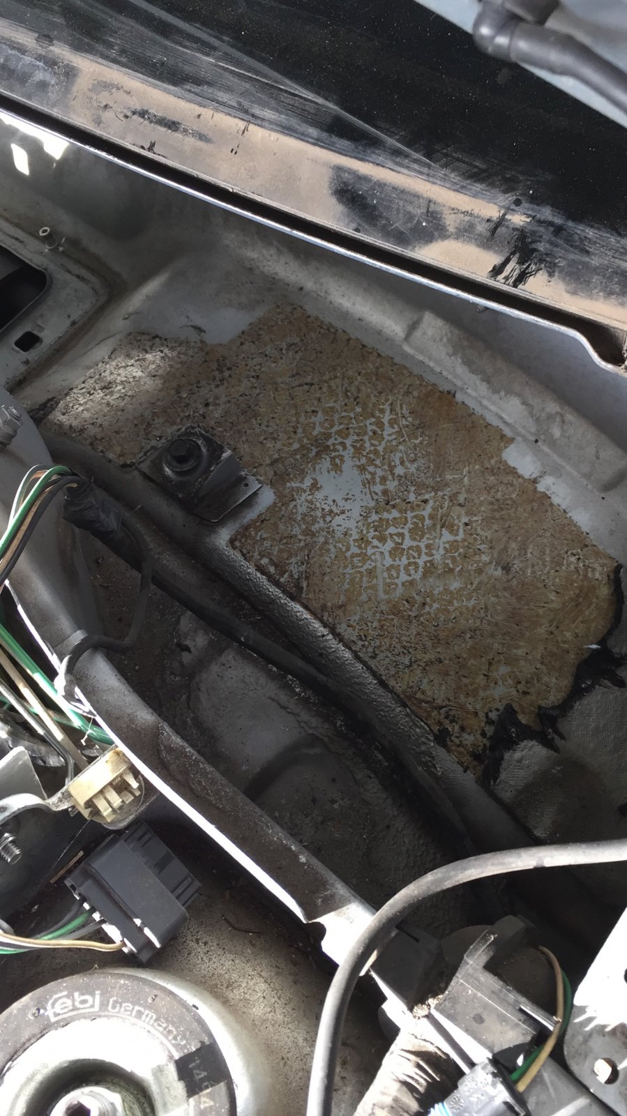

Started to remove the tar patches from the scuttle panel.

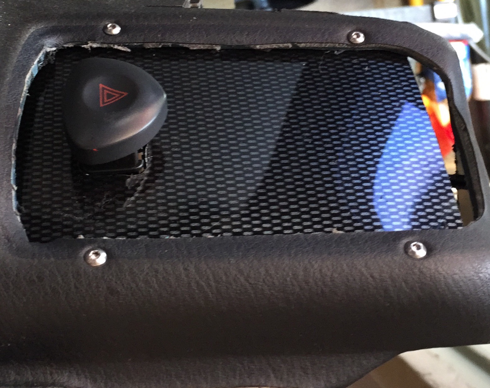

After mounting the switches in the centre of the dash, I decided to locate my Hazard switch on the right-hand side. The EPAS adjuster will also be located here too.

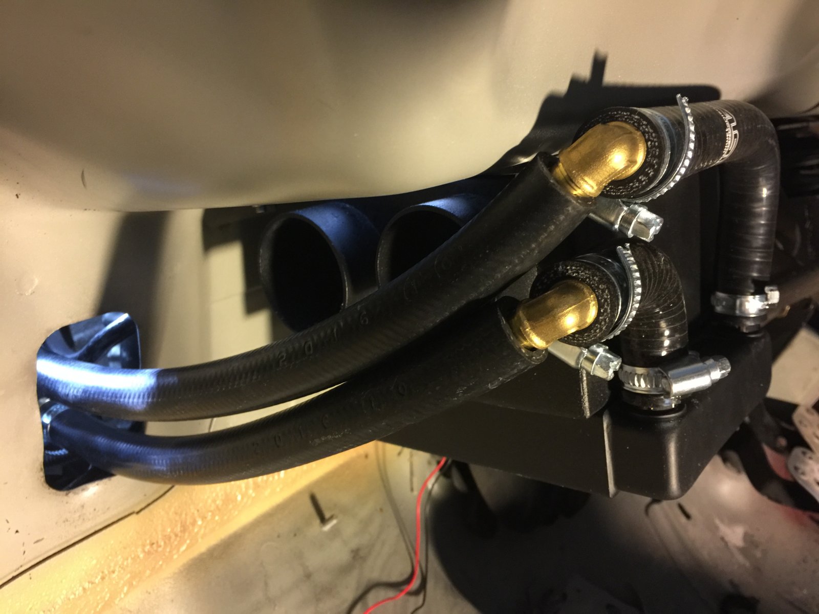

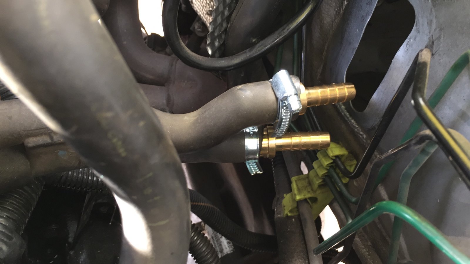

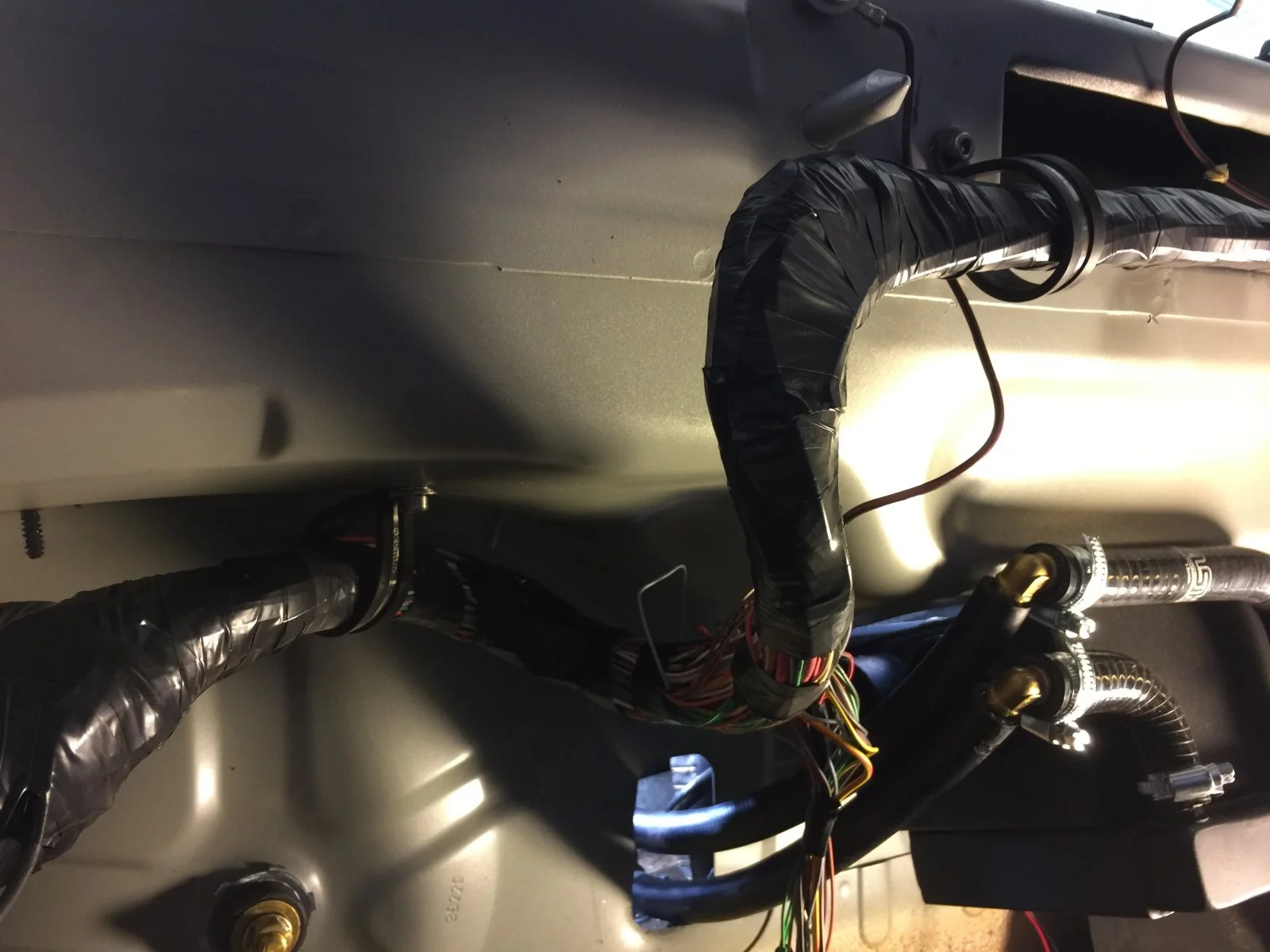

Also got my Brass reducer connectors for the coolant pipework for the T7 heater unit. Just need to grab some 13mm hose now and it'll be done.

Remove tar patches on roof, rear quarters and in scuttle

Today I popped to Halfords to get some heater hose. Last bit I needed to finish off the coolant hoses. Need to get some edging to go round the hole the hoses pass thru, to stop them rubbing and splitting.
(Yes, there's a couple of jubilee clips to go on too)

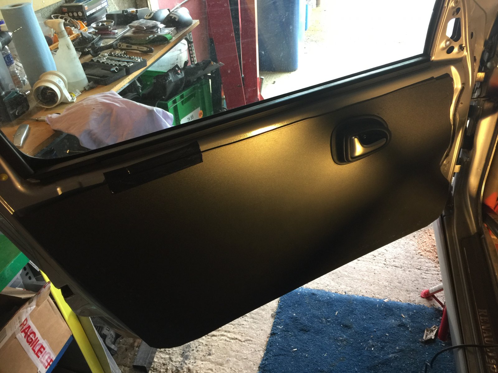

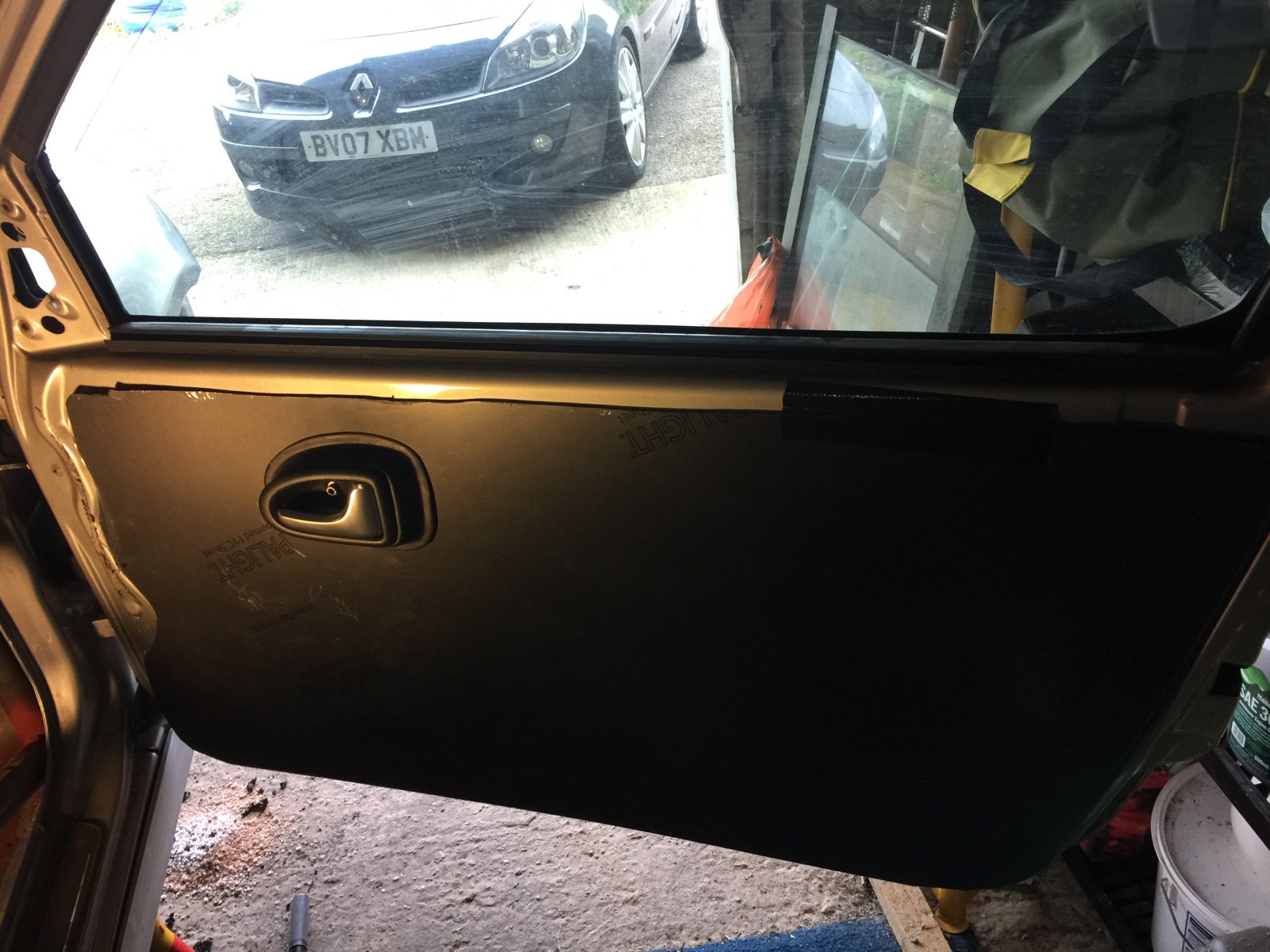

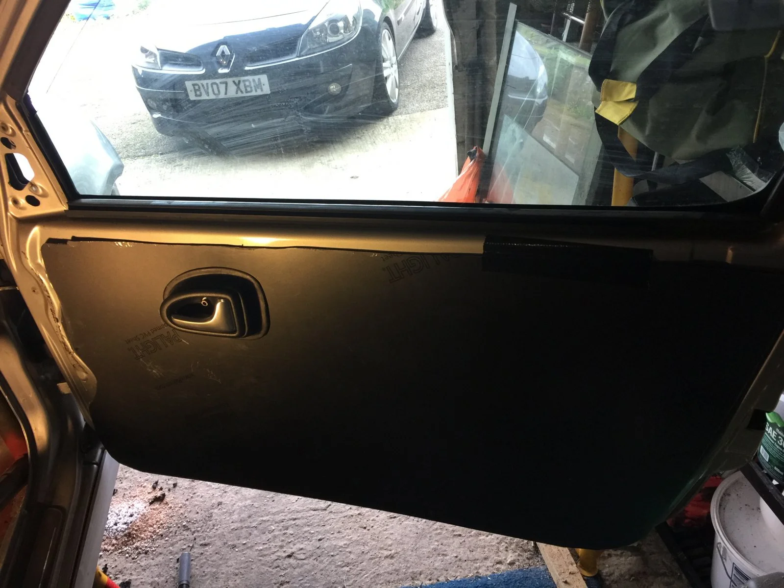

Also cracked on with the doorcards. Not perfect by any means, but they'll do.
Think I'll use some strong double sided Velcro to hold them in place.

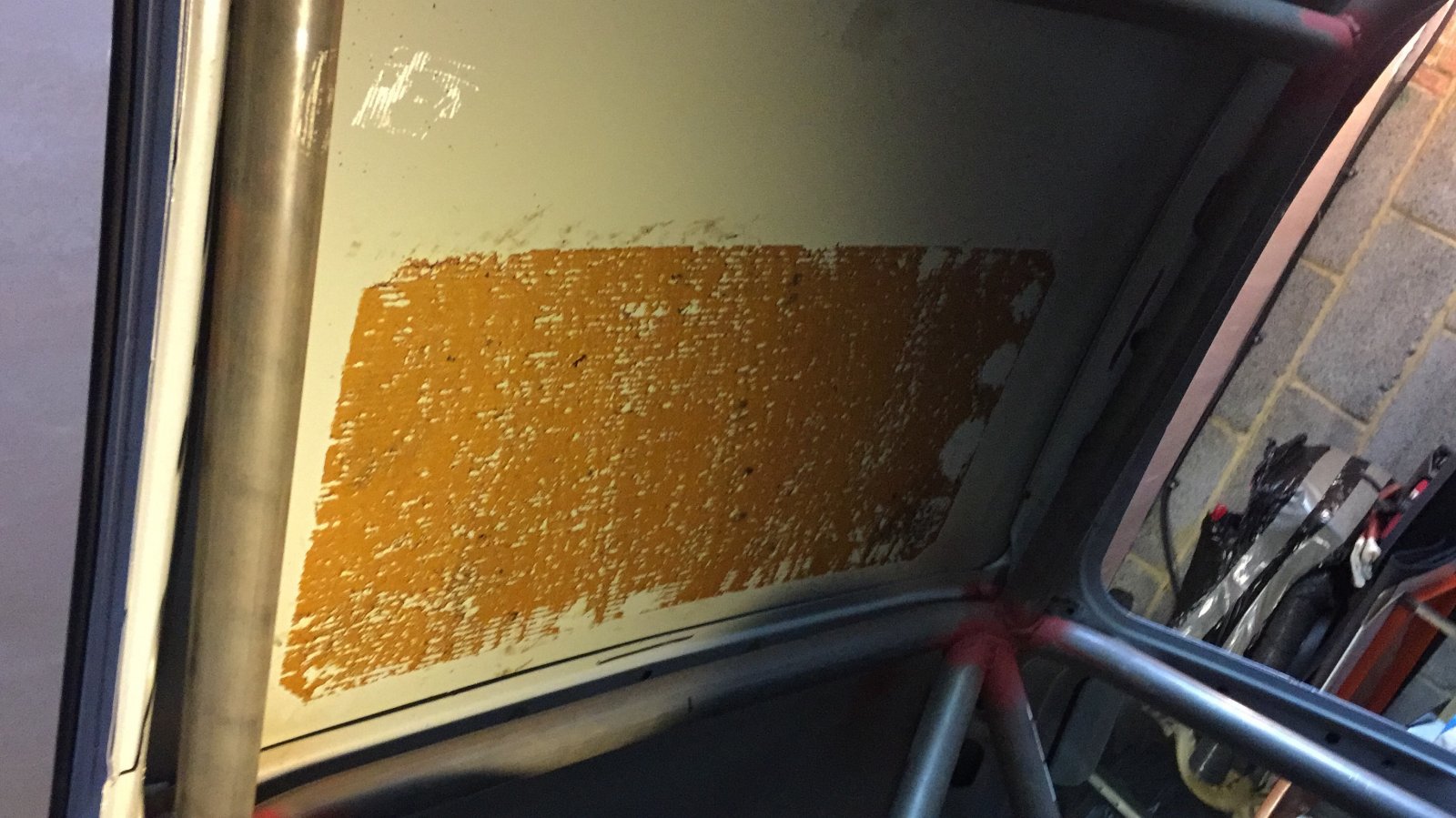

JP83
South Central-Oxfordshire

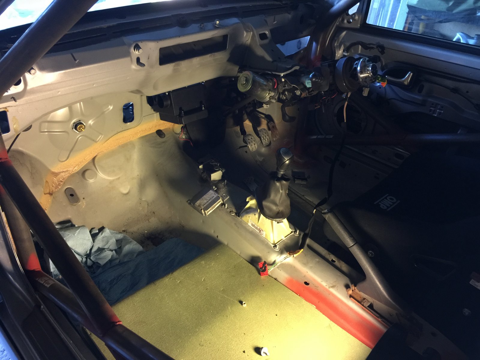

Sister and the kids went home a couple of days ago so inbetween other jobs I found some time for the car.
First of all, started on the horrendous job of removing the roof tar. What a b*****d...

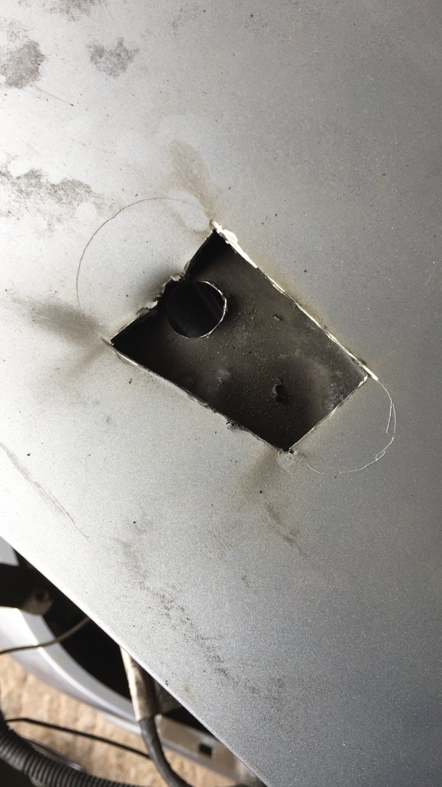

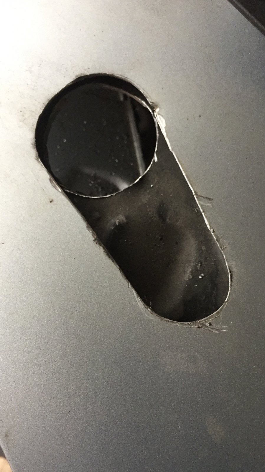

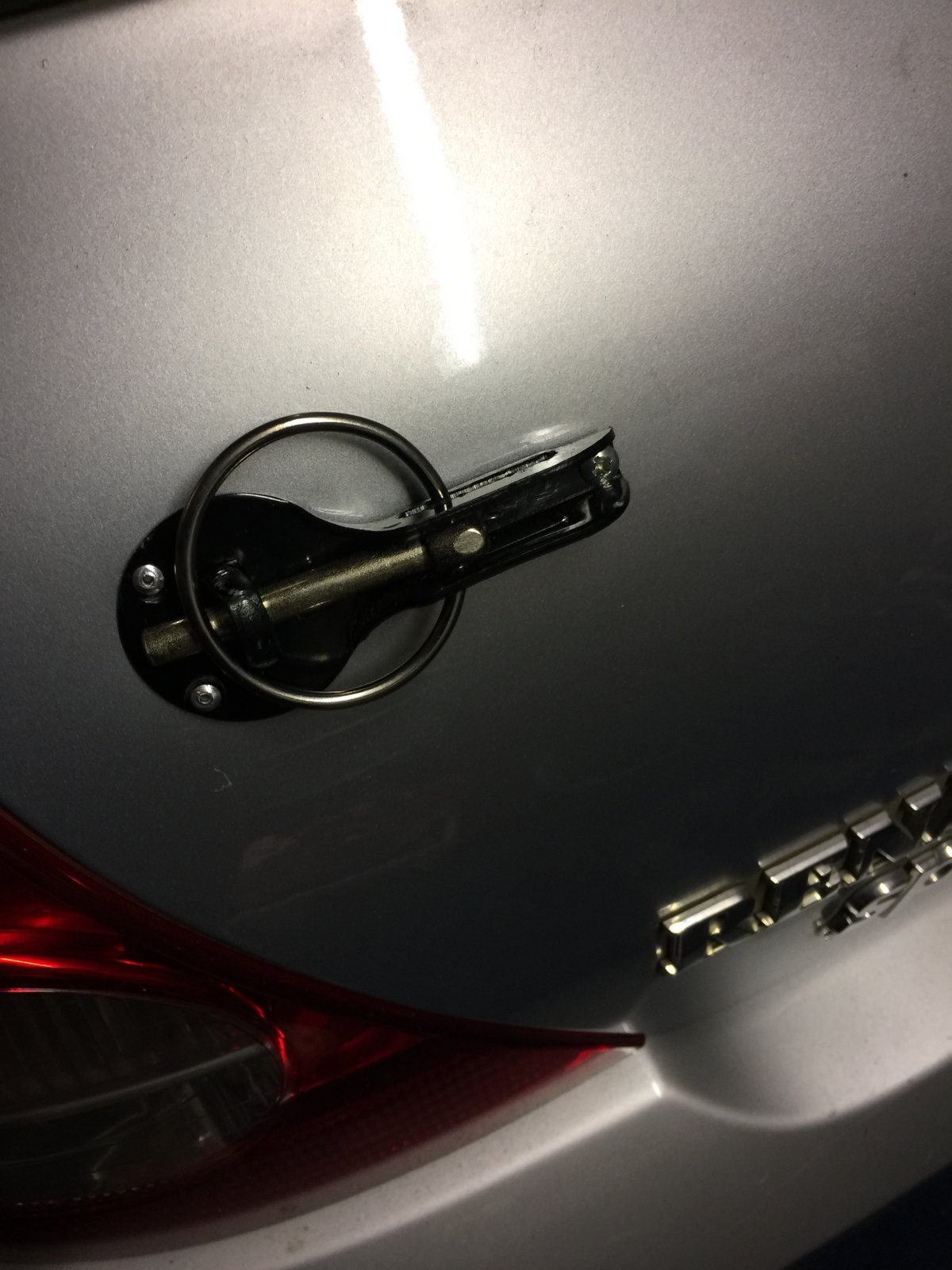

Then that was followed by the frightening job of putting the aerocatches in the bonnet.
Waiting on some longer bolts as I've decided to keep the inner skin on the bonnet too.

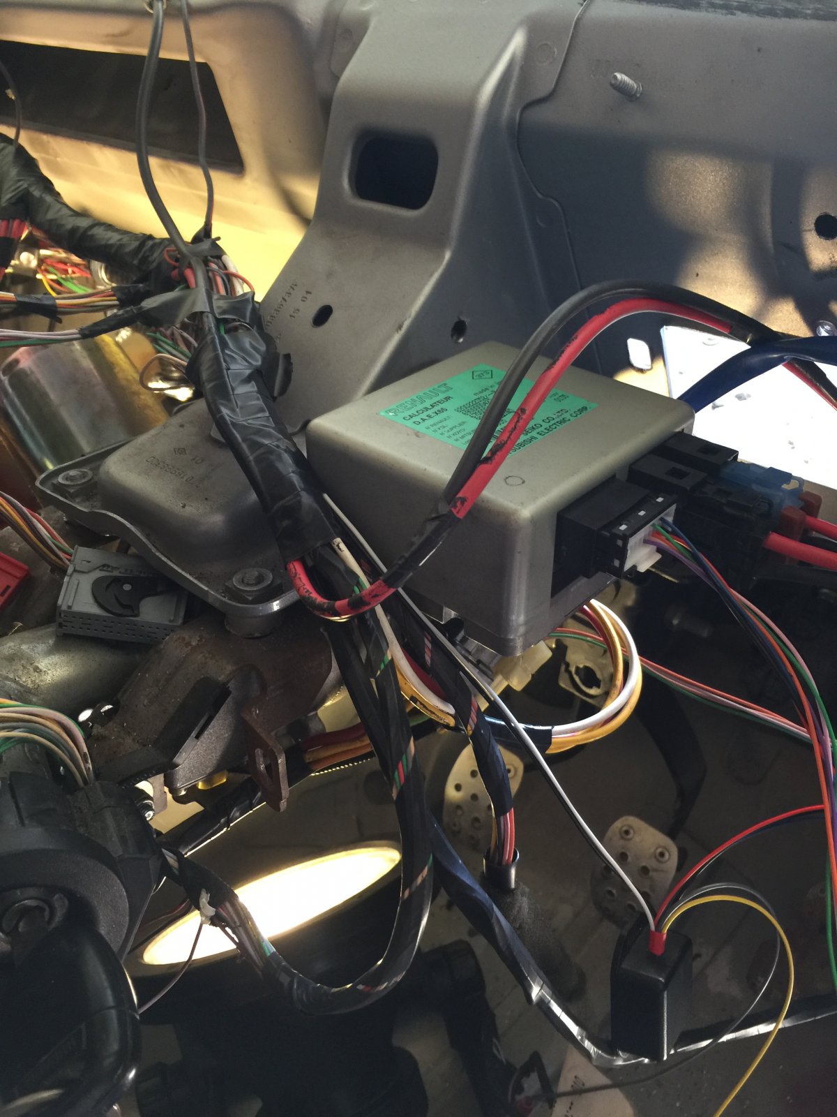

Got the EPAS unit mounted.
Also got some P-clips to keep the loom tucked up under the dash.
It's getting a bit neater in there now.
Waiting on some goodies to arrive over the coming days to really finish off some bits!

@JP83 you don't need longer bolts for the aerocatches mate, you just need to make the hole in the lower skin big enough for you to get a socket on. Aerocatches secured on one skin only is fine, and mine were tested up to 156mph at the Nurburgring. :wink:
JP83
Yeah, I realised that after speaking to @dann2707 about his, but I kinda like how snuggly it fitted. Plus the bolts were £1.50 for a pack of 25.
