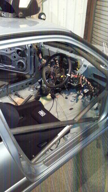

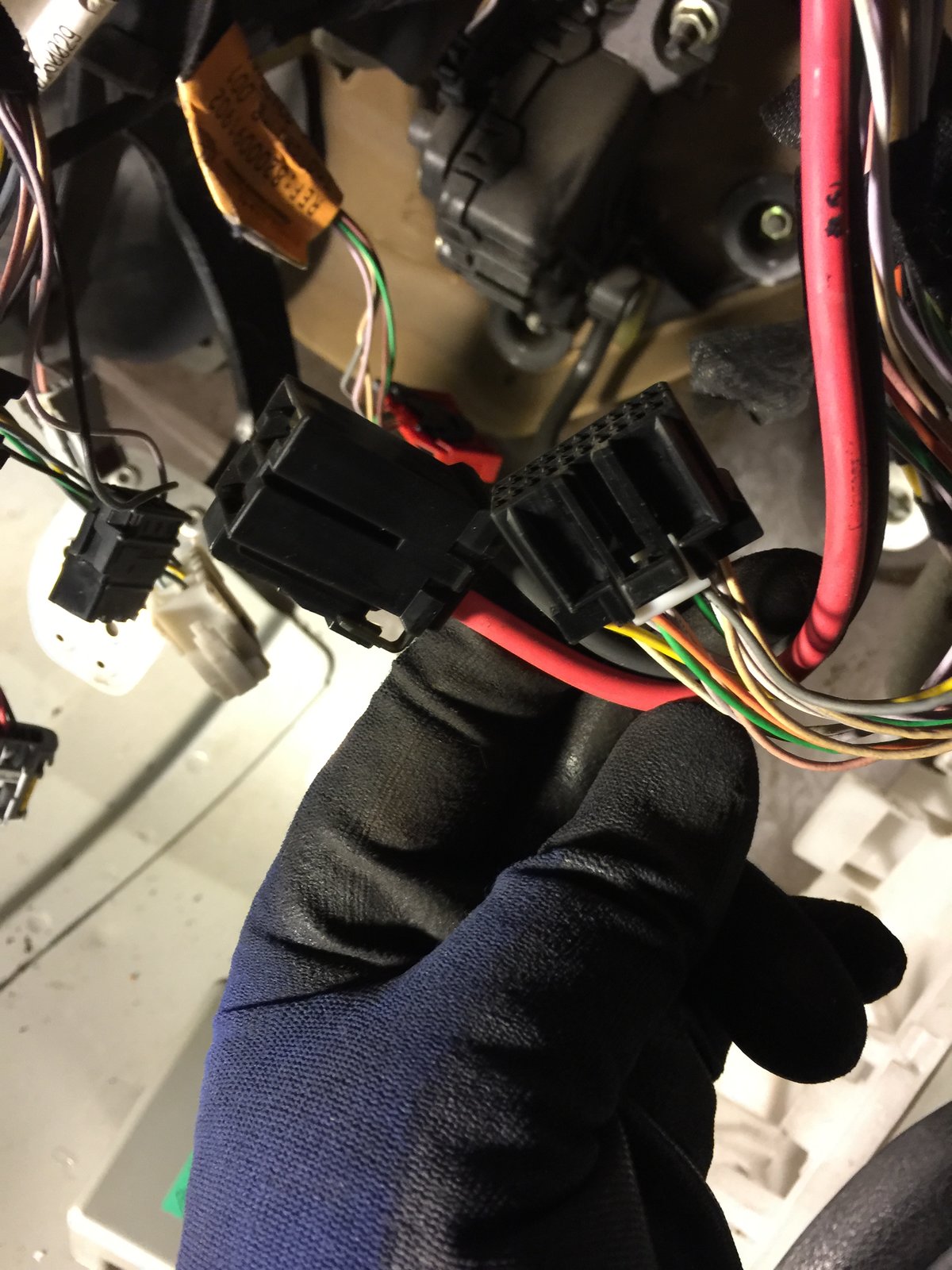

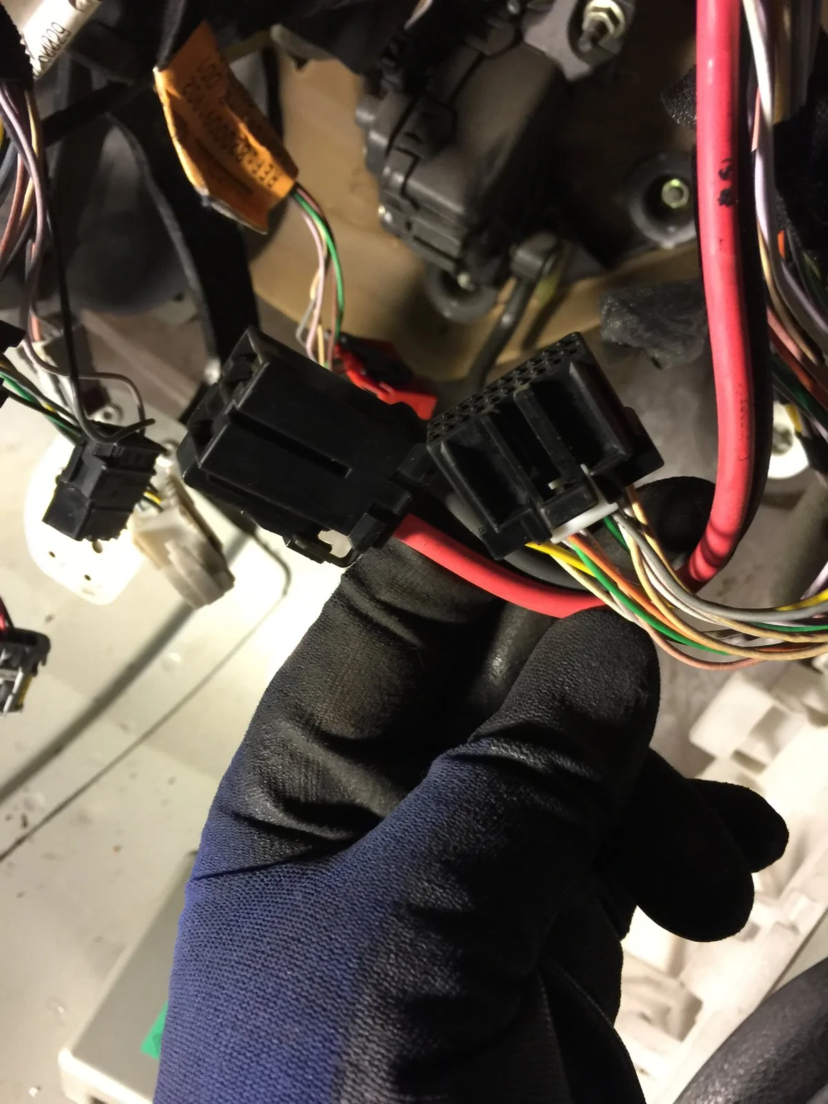

So, I might be dreaming here, but as I was taking the dash frame out tonight, I spotted something on the loom...

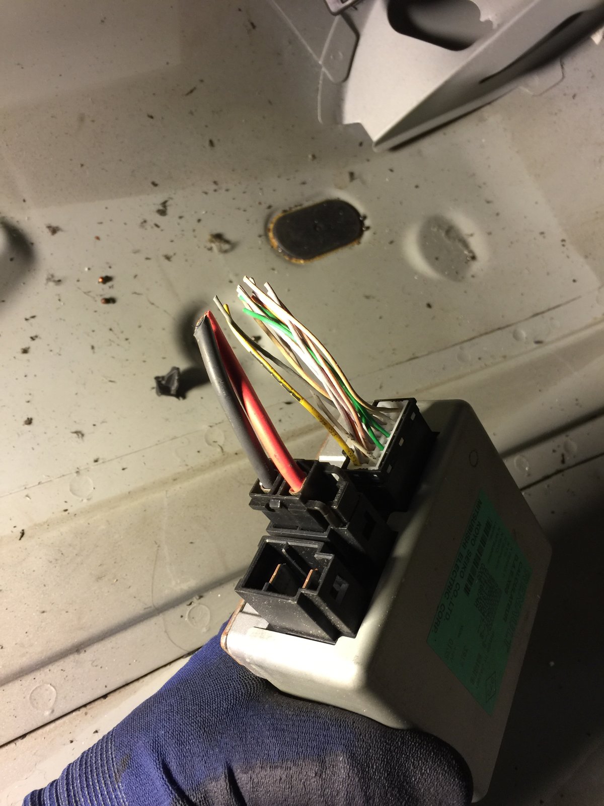

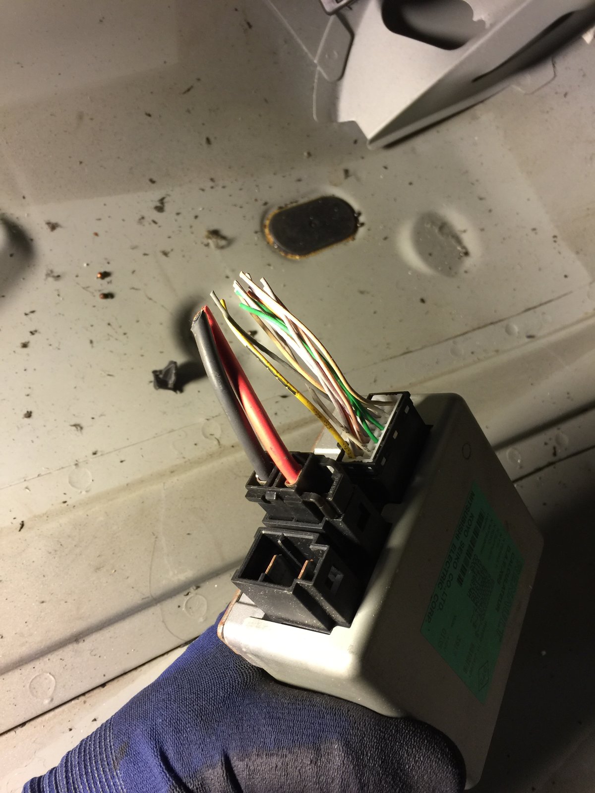

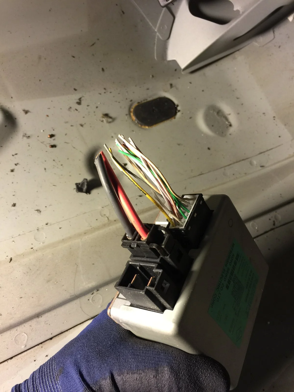

So this is the ECU controller for the EPAS column. I managed to find the 2 plugs and bit of wire the other week up the scrappies...

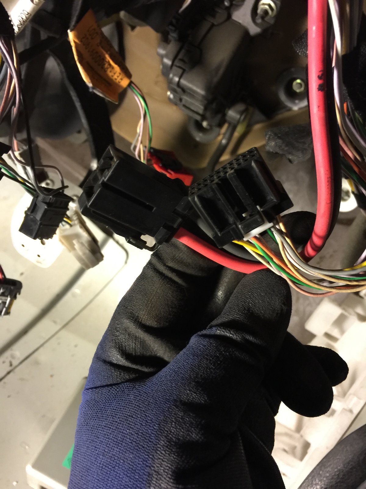

So I take the frame out, and spot a bit of loom all taped up, near the door. Low and behold, it's this.
Now correct me if I'm wrong, but they are the identical plugs needed for EPAS. Does this mean my loom already has the connectors integrated into the loom?!

It certainly looks that way mate yes!

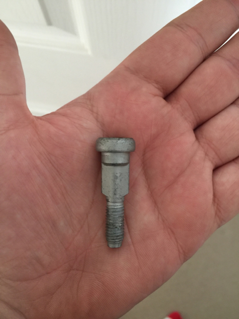

Found it. It's the pinch bolt (I couldn't find) for the steering rack to connect to the column.
Reckon I need to use his or will the stainless but and bolt I fitted suffice?
For the ten minutes it'd take to swap, I would use the Oem part mate.
Will probably be ok as it is, but steering is pretty important. :)
You're probably right. It wasn't difficult to put he new bolt in. Just a bit fiddly.
Should be easier though only having to bolt up one end this time though!
The wiring for EPAS will probably end at the bulkhead connector and need a wire fitting into the engine bay side and a fuse adding to the box.
@GrahamS
Another one! My cup had the epas dash loom already there too! It will end at the engine loom though so you need to get the wire from e3 in the r107 to the fuse box. That does mean the dash light and diagnostics will be wired in though which is good. A couple of the original plug wires will need to be snipped to be soldered to the control box.
Come again?! 😂
Think I might need to call on an electrical wizard.

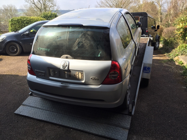

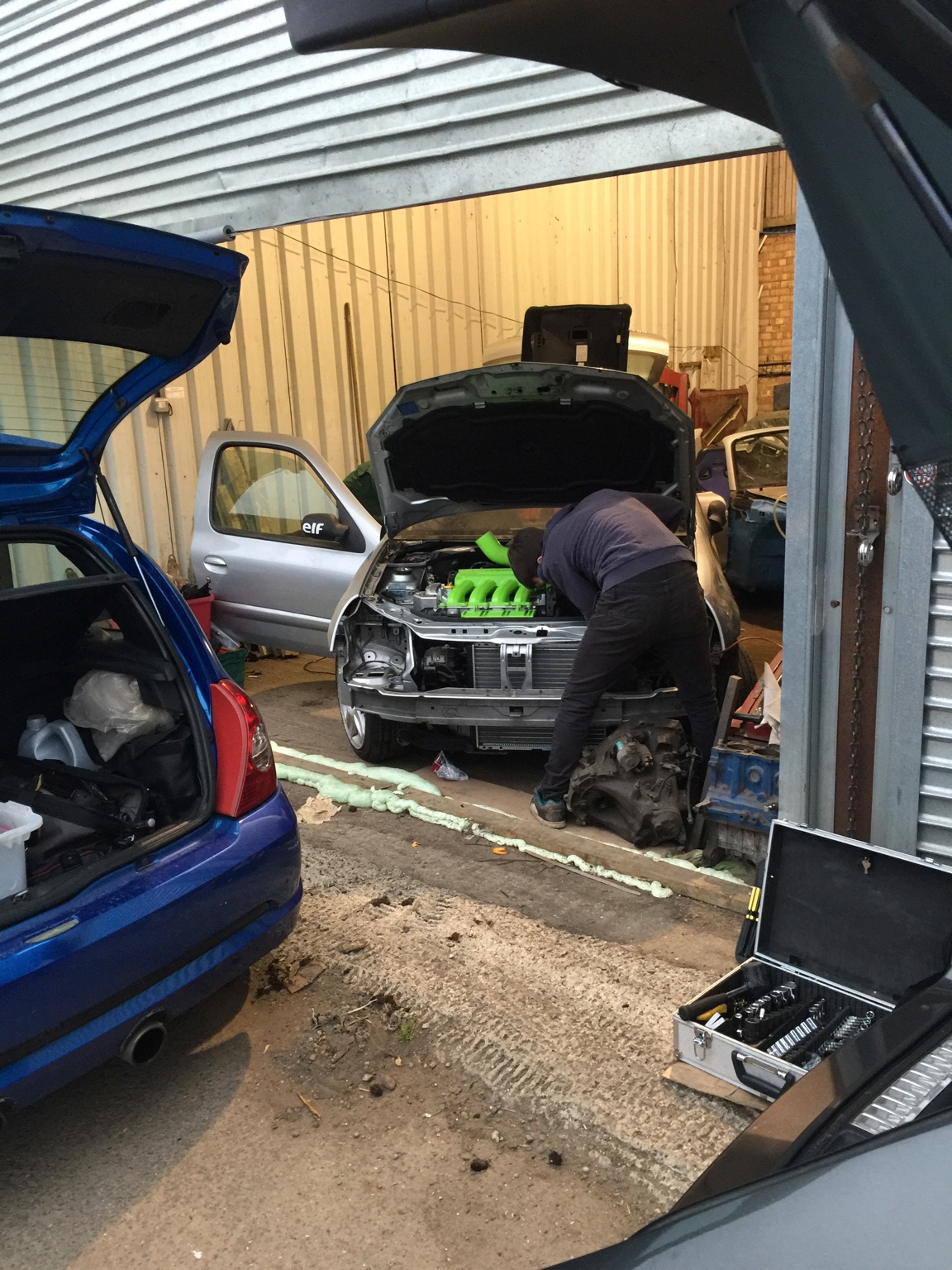

So the car went to Chris' unit last weekend.

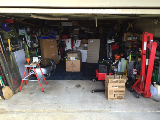

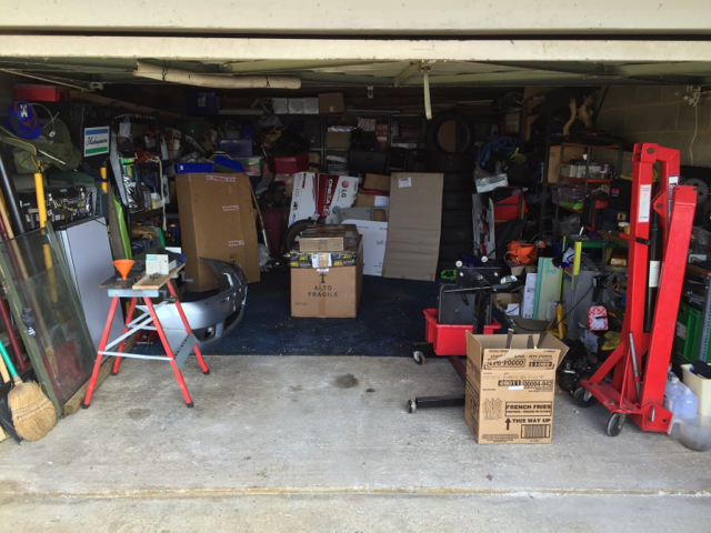

Garage is a bit emptier now. Pile of crap to make it look not so empty...

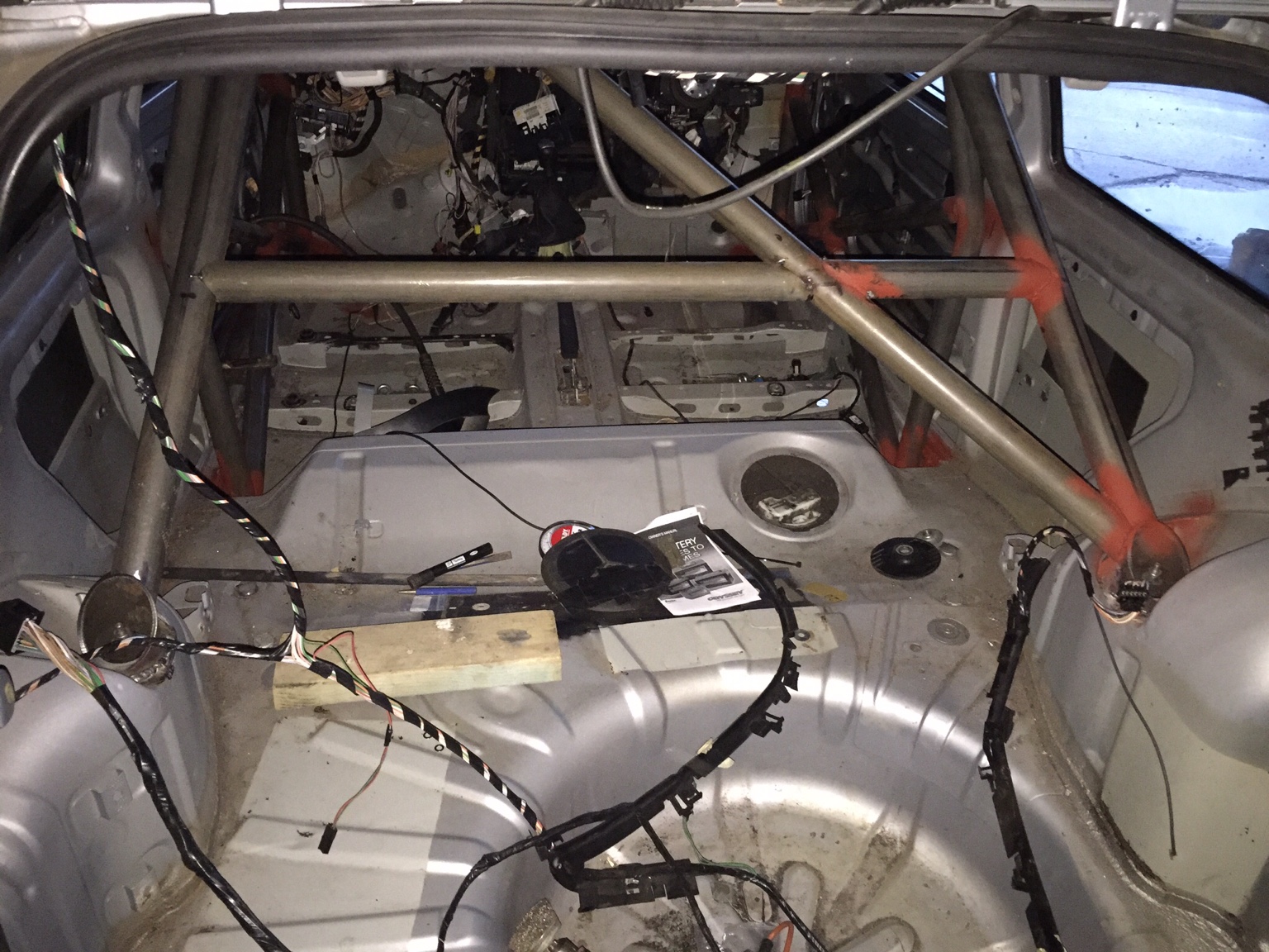

As of now, Chris has racked in the main hoop, main legs (a pillar), screen bar, the 2 rear downward bars, and rear strut top collars. Photos courtesy of Chris.
Custom cages say the strut bar provided is the harness bar and needs to be chopped. Still doesn't seem right.
Oh, and the rear diagonal is too long, so Chris is having to trim that and profile it.

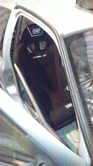

Went up Friday night to get the seating position, rails, and harness plates arranged, so Chris has been cracking on with those since.

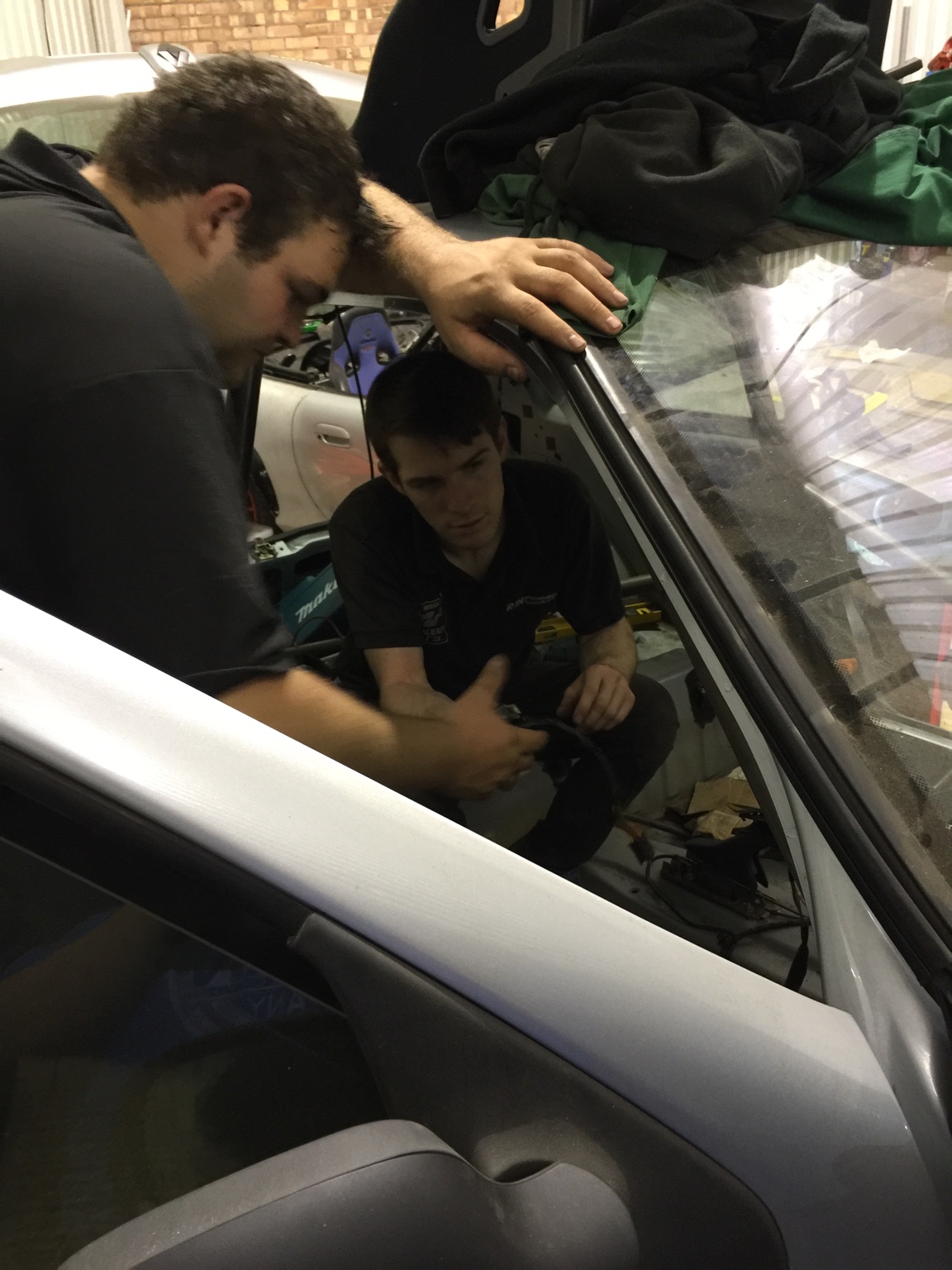

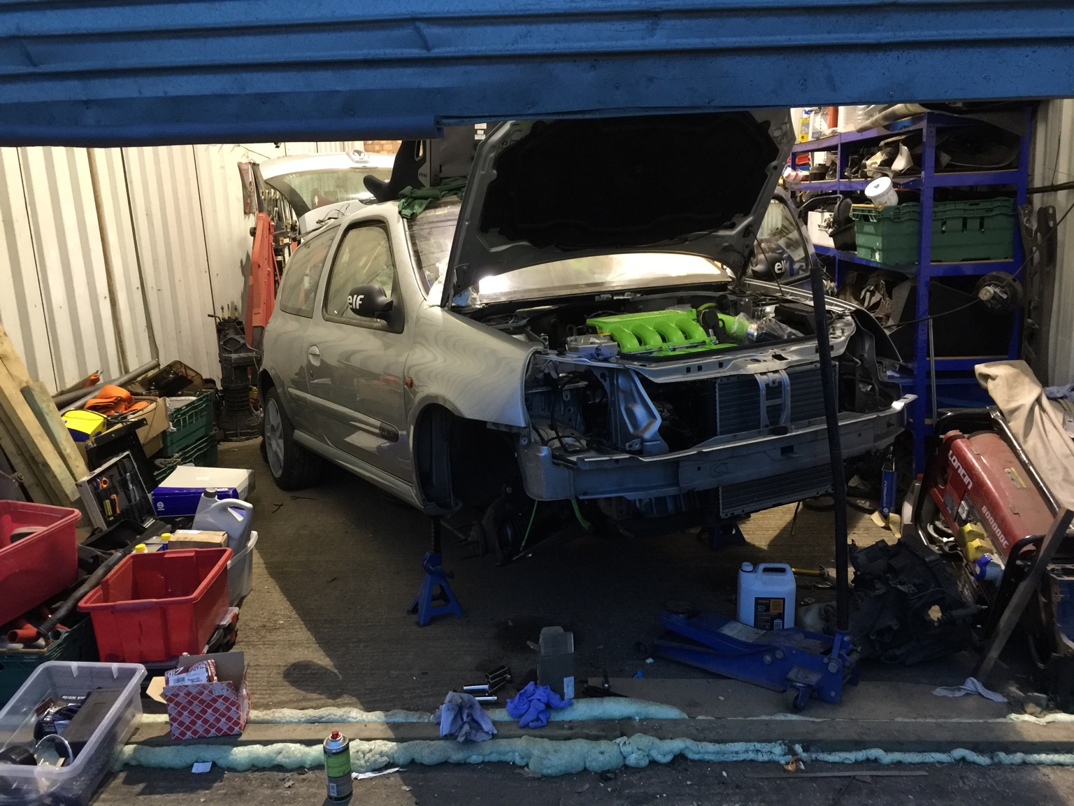

Big session last night. No, no, no. Not the gym.
Returned to Chris' unit last night. Chris cracked on with more welding whilst me and Steven did some work on the car.
Yes, I actually did some work. Amazing.
Front suspension and brakes are all on, along with the studs.
Unfortunately the front offside brake line is weeping, so we didn't get it bled up.
Left the unit at 2am this morning.

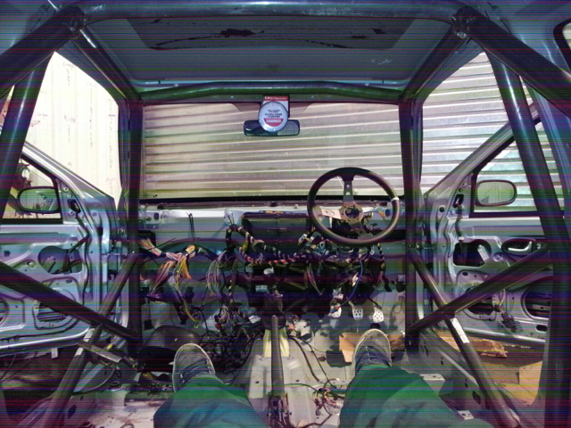

Today, Chris has been back up the unit. Got the rear harness bar re-profiled (due to the fact the harness bar sent from custom cages is clearly not right), and the front half of the cage done.
Got the rear end tacked in but unfortunately ran out of gas again.
So just needs to finish that, do the seat rails.

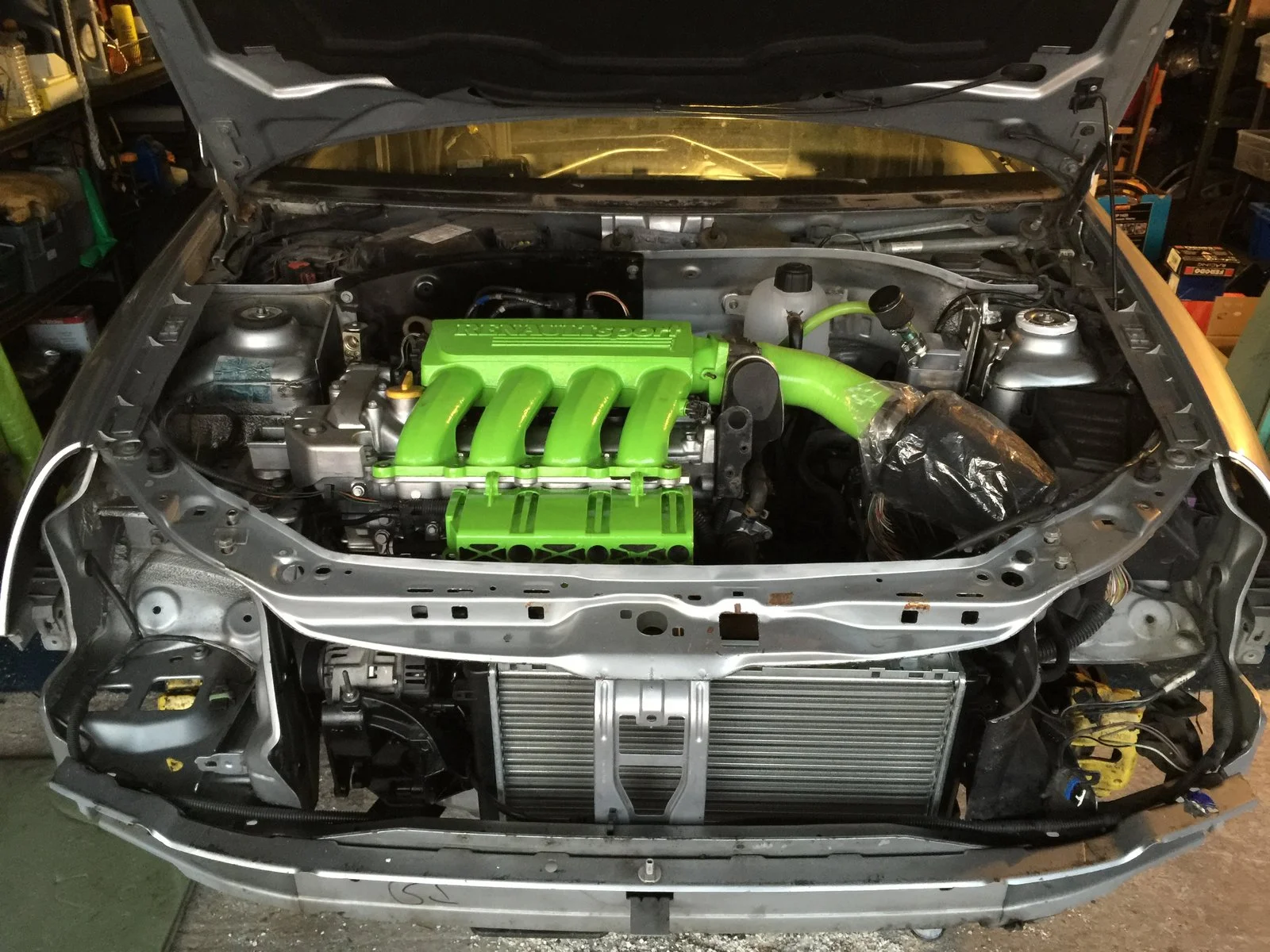

I'm ditching the xenons (partly because one didn't work, and the lack of headlight washers), so purchased some TYC halogen headlights. Not bad for £60 for the pair.
Also got a sunstrip, continuing the green theme.
And a few cans of green paint for the grilles, etc.
